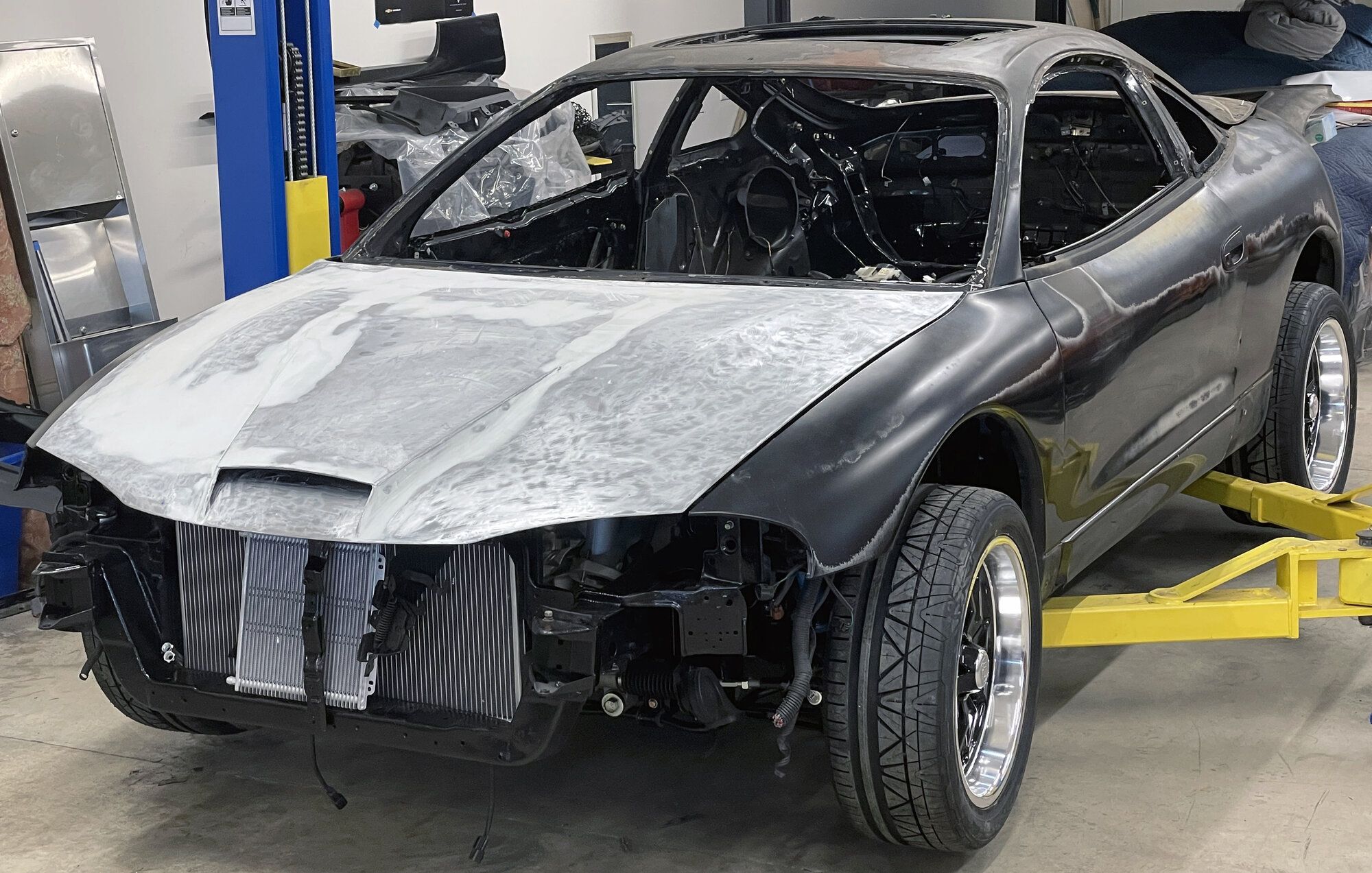

Street Build 1998 Mitsubishi Eclipse (RWD LS Swap)

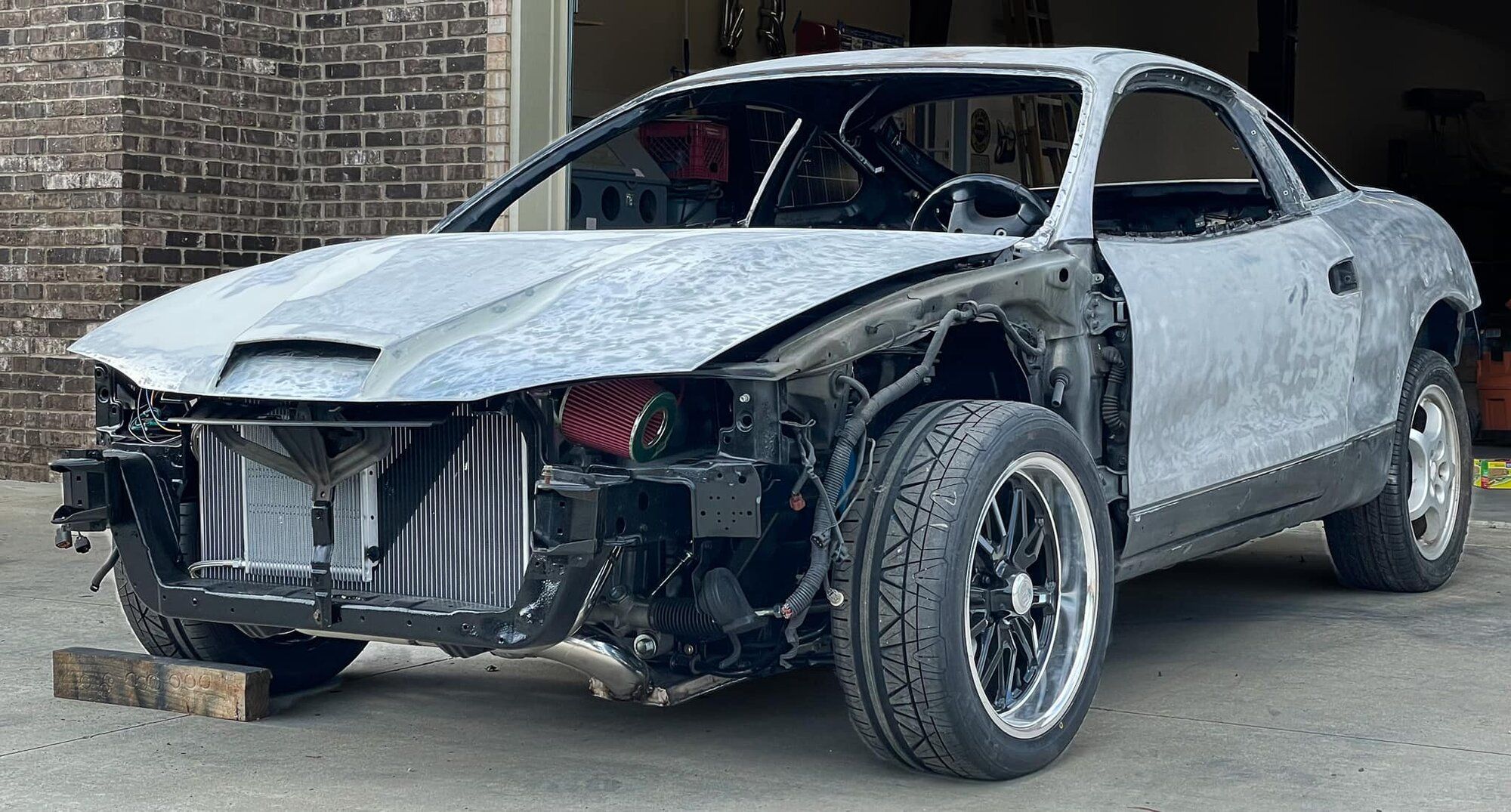

The exhaust is still being fabricated. The exhaust is getting ran all the way out the back to the rear bumper. No side exits.
I think his point was if you did a muffler and side exit it would flow much better than that flat section you had to do to get under the dropped suffrage.
Good to see all the progress and it finally sitting on the ground. A lot of work you guys are putting in. Props to you guys for the follow through.
Constructive criticism wise though with the subframe drop/ body lift I don't think it will ever sit low enough again to look factory. But its not going to be as bad as I first thought when I saw those spacers.

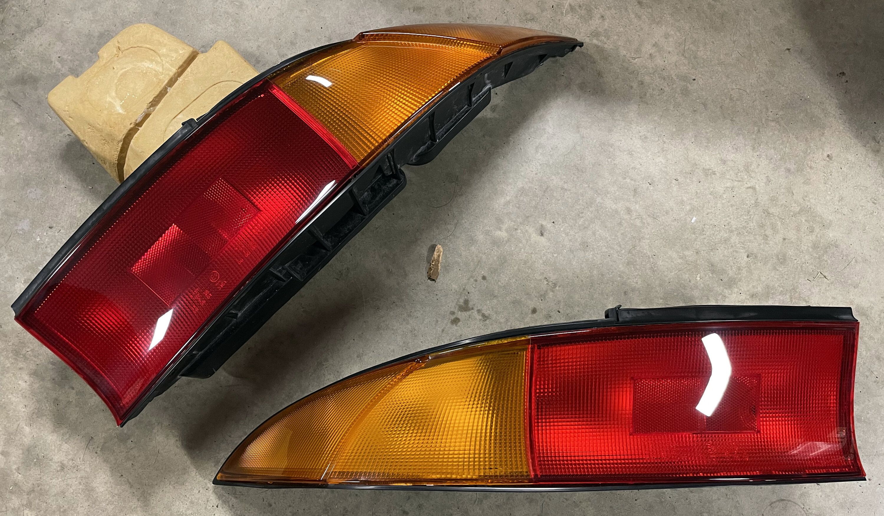

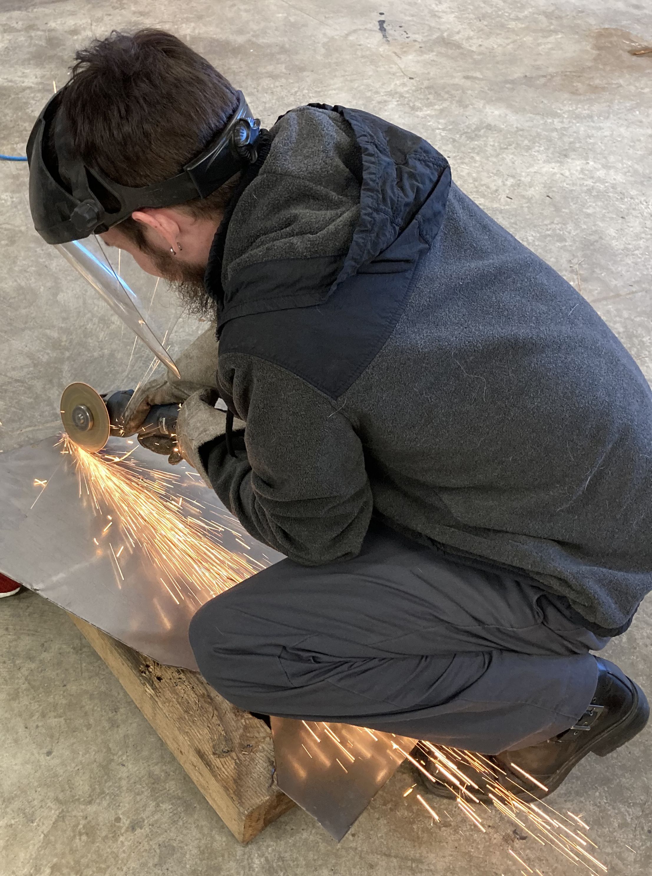

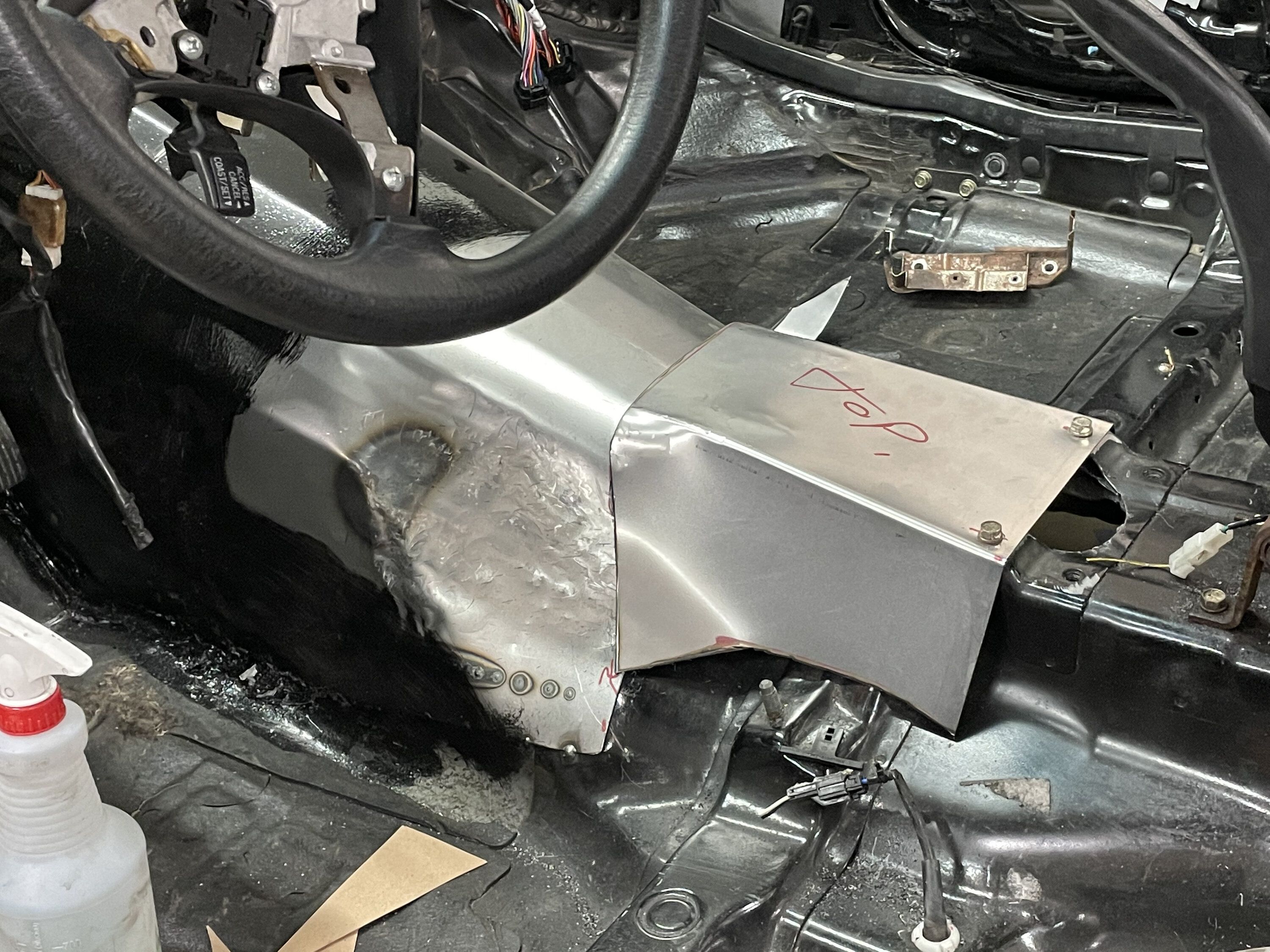

Made part of the transmission tunnel where the shifter is going to sit. Also received my tail lights and side marker lights.

Hey Mike! Yeah for sure, I am always up for constructive criticism. I could have done a side exit but I thought that'd be to easy. I think having the exhaust ran out the back still gives the car some stock character. I know I will have some wild things on the car but, I do want that factory appearance as much as possible. Also the sub frame spacers, meh. It's to early to tell but I think it will sit pretty darn close to factory ride height. I would prefer it to sit that way anyways and letting the suspension have enough travel.

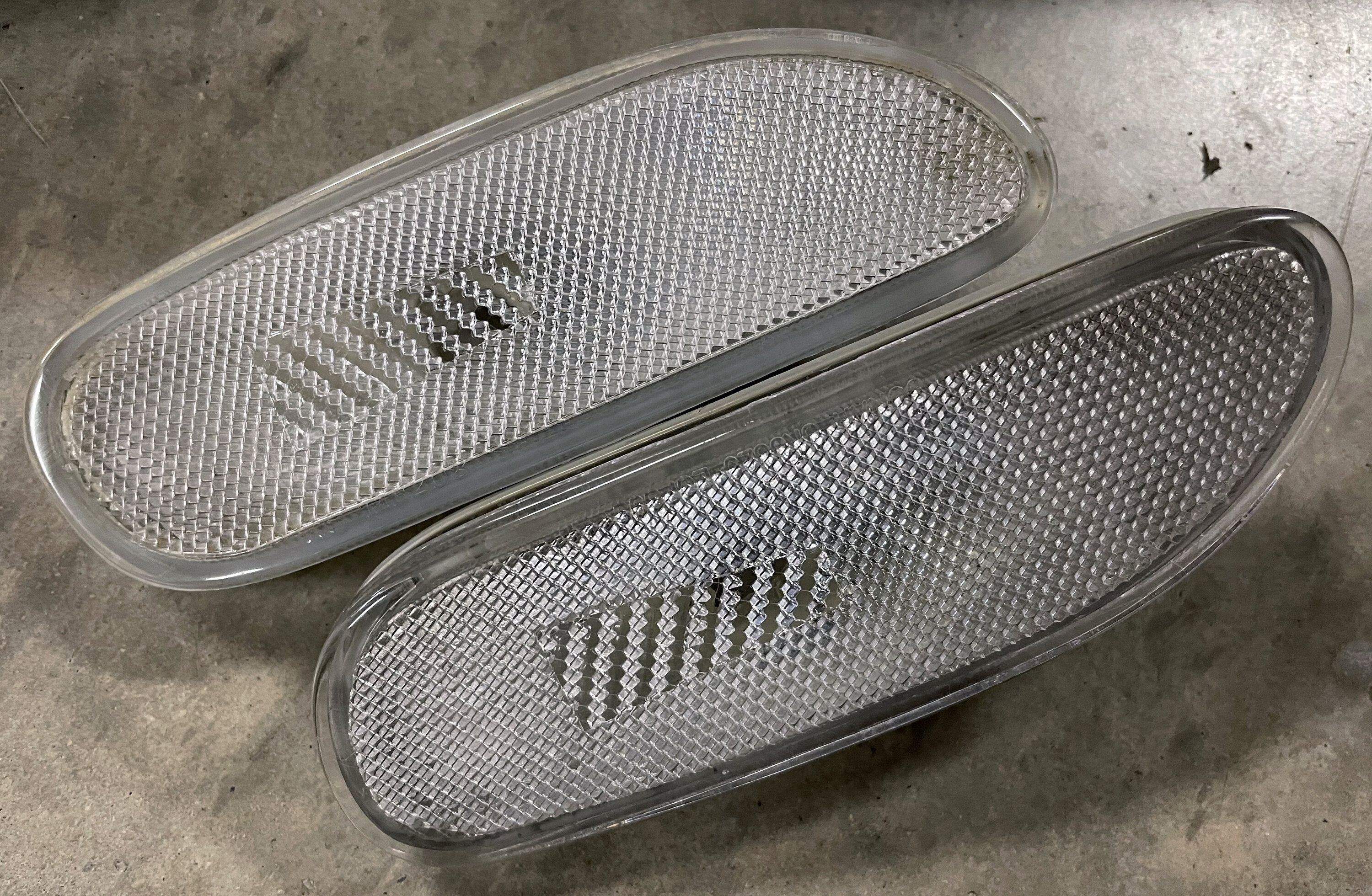

Good call on the Euro style lights. I think those are the 2nd best option for 2g's, behind the full LED customs that few have made.
Oh, you mean mine?
Jake and I were just laughing about this exact topic last weekend. Some LED implementations were higher budget than others...

This is very odd execution. I hope it's what you want it to be when you're done, but the height of that exhaust vs the height of the car means this thing is destined to be a 4x4 without the awd. I guess it's kind like a small truck at this point. I'm not sure why, with all the fabrication you've done, you didn't just channel the subframe so you could face the exhaust manifold backwards. I know it hurts to take things out and put them back in again over and over, but that's kind of the nature of the beast with this kind of project. Anyway, good luck.
