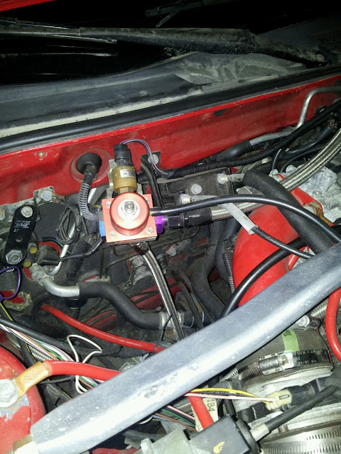

My steel braided fuel line (I believe 8AN fittings) from fpr to the fuel rail has a kink in it and I feel unsafe using it because it could cause a fire if it decided to leak.. My question is can I get by with those dirt cheap $15 "quality" steel braided lines on Ebay until I have more $$ to spend on better lines? Where else can I get cheap fuel lines from?

Is it the outside diameter of the threads (putting a string around it then measuring that with a ruler?), or measurement from where the thread starts to where it ends? And were talking about measurements from that purple piece from the fpr right?

Now that I'm not on my iPhone, I can clearly see those are 8an fittings. Unless you have really tiny fingers... LOL
My fingers aren't incredibly small or big but here it is compared to a penny LOL
Edit: I measured the female threads from one end to the other and got 3/4.. That's 8AN right?

8an was correct.. Now to transfer the fittings
