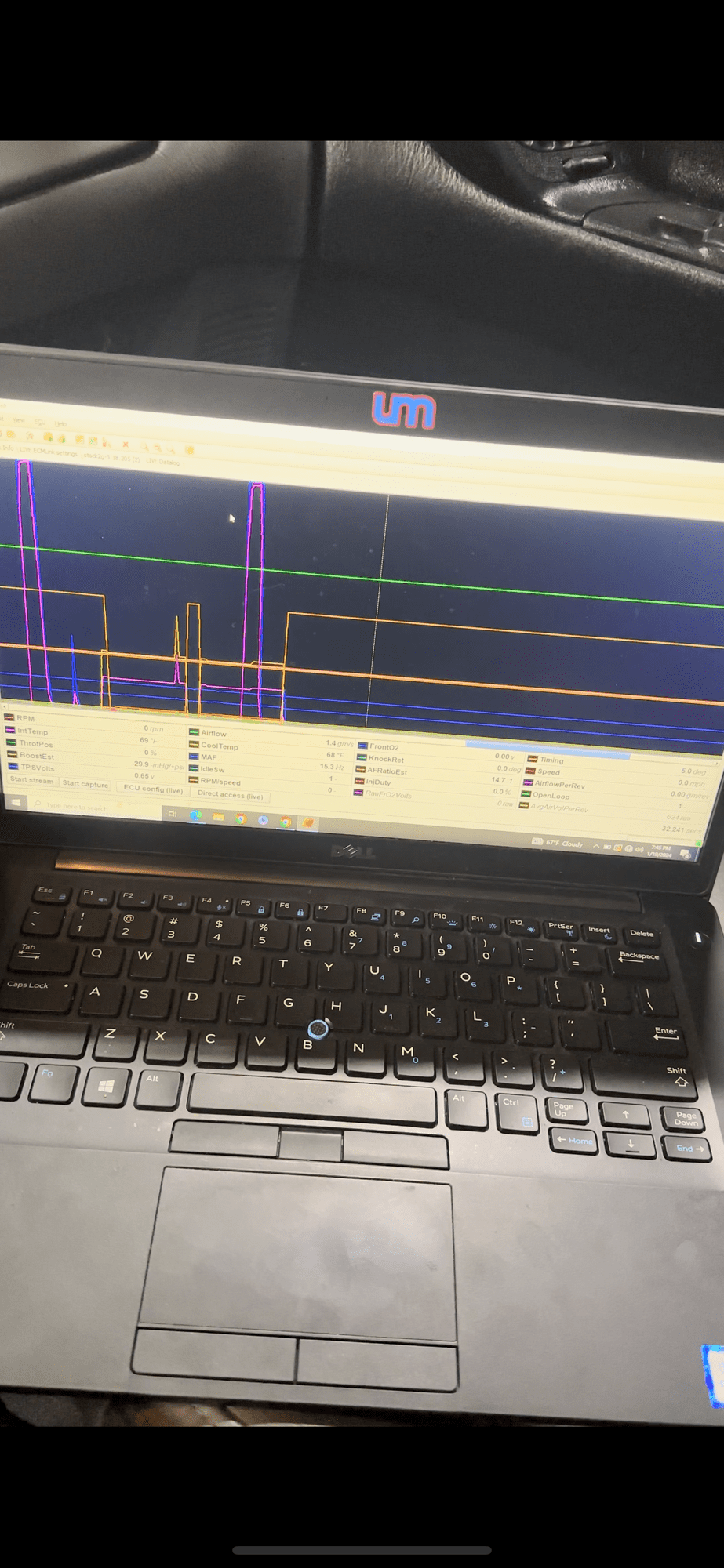

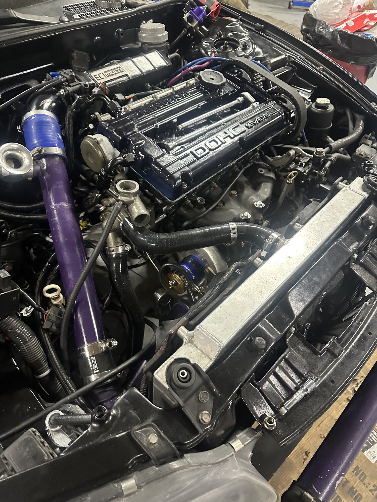

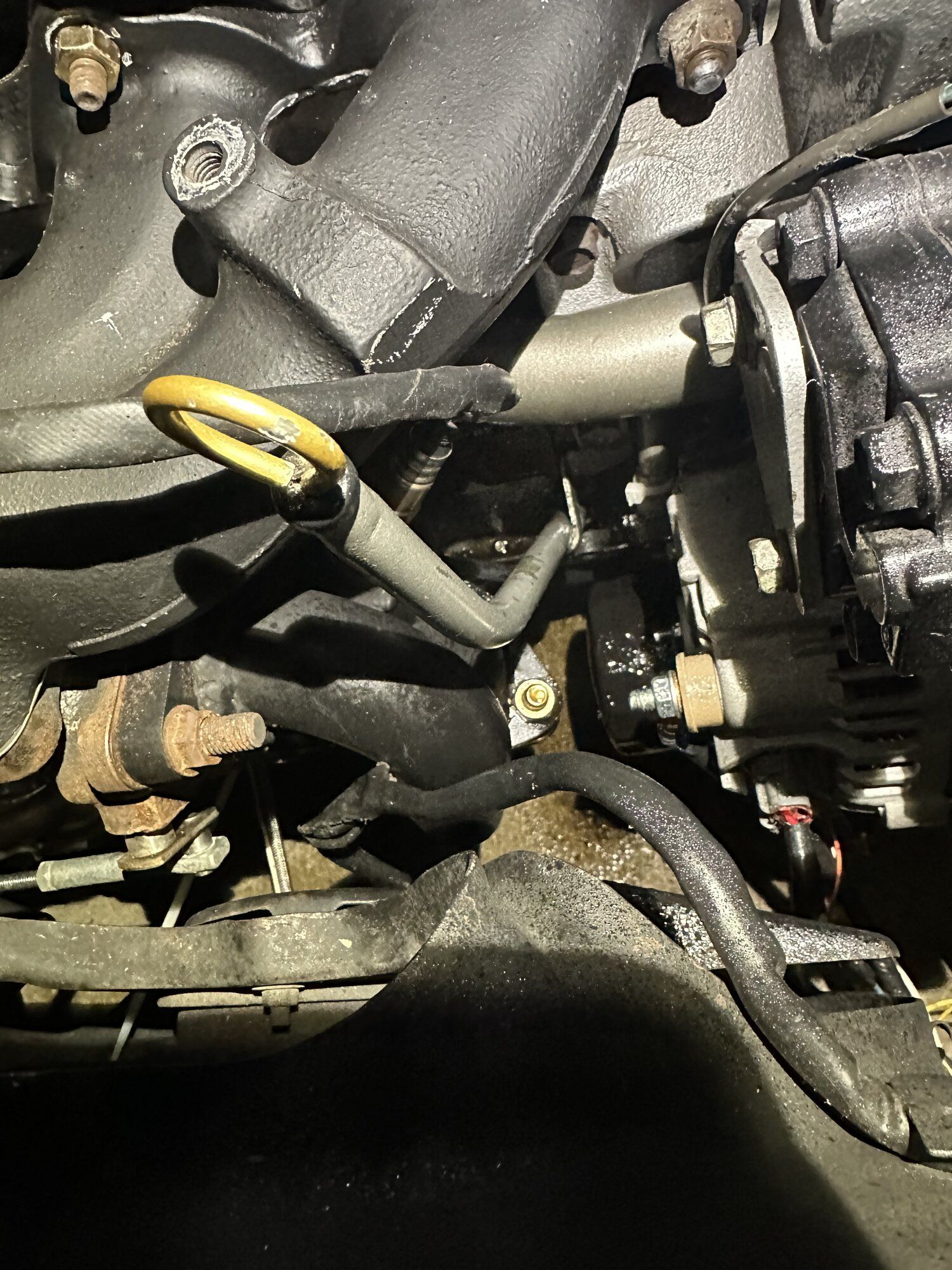

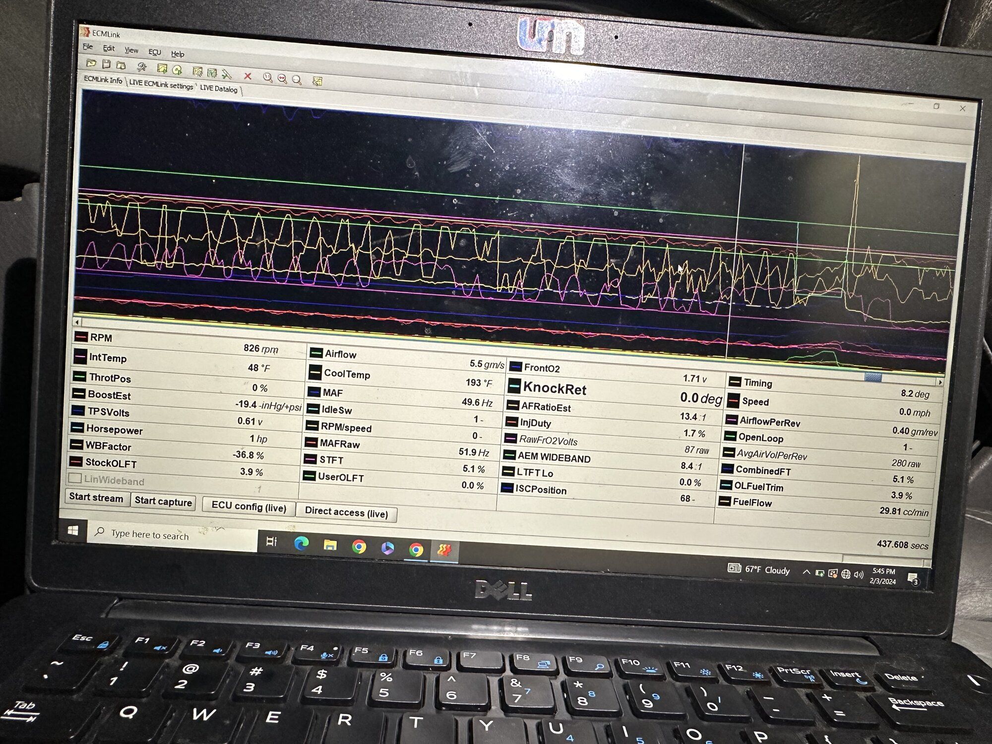

well got it running, worst part i have to take it apart again. if everything was right from spark fuel air then it had to be the timing or tables so i did both, i reset the timing i zero’d everything out on ecmlink and regapped the spark plugs, and bam it started, now i havnt gotten any real starts besides this one so no pressure was ever in any of the systems, so filled the coolant couples leaks off the turbo, got those figured out, then the oil leaks an fittings just needed tighting, but something was coming from behind the exhaust manifold down, so i followed it up and low and behold coming out of the exhaust cam seal 🥲🙃 just when i thought i had everything figured out. i did grab pictures of the live feed too. the air fuel ratio on ecmlink says 14.7 but my gauge goes from 20.09 to like 15,16s
At idle your timing shouldn’t be zero. I still think you should upload factory settings and start there.
-Daniel
i tried uploading the factory settings it wouldn’t convert to the ecu because there 3.18 and 3.19 my ecu says 3.20
well made sure every map was for a stock car
fuel injectors set right for my 660 injectors with a deadtime of 180 per ecmlinks website
i have been trying to get my AEM series x wideband to work correctly too. the “afrratio” moves but the “aem wideband” is stuck and doesnt go up or down? i am still using the factory front 02 sensor.
rpm set at 800 in ecmlink
throttle seems to be working fine 0.63v at idle

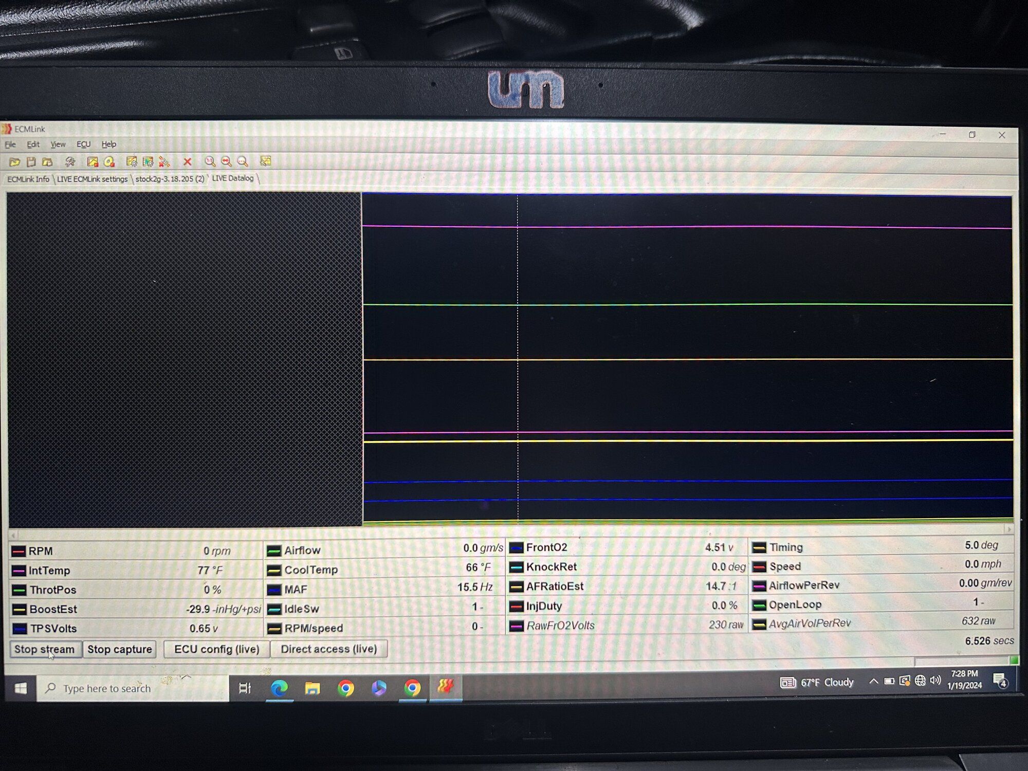

heres a screenshot from my log, while it was idling
i tried to add every captured value i seen others have if i missed any lmk thanks this is all new to me.
i had to stop as im leaking oil from the turbo i believe so couldn’t really get it to operating temp for to long.
Yes! - like that. Closed loop happens when Throttle position switch is closed, and engine running, and narrow band o2 is cycling up and down. There is a moment in the log when the ECU indicates closed loop, and then it stops. Not sure why.

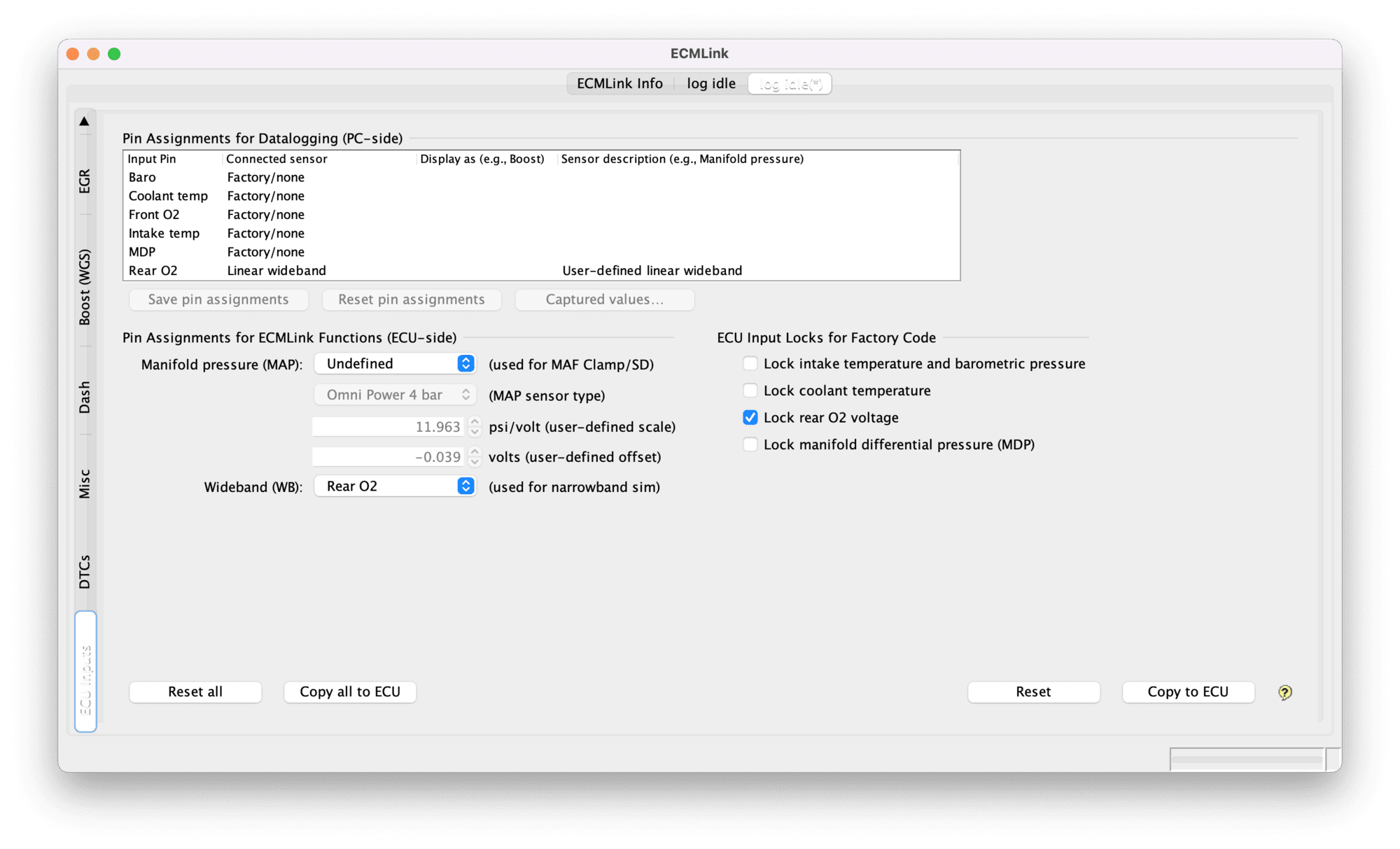

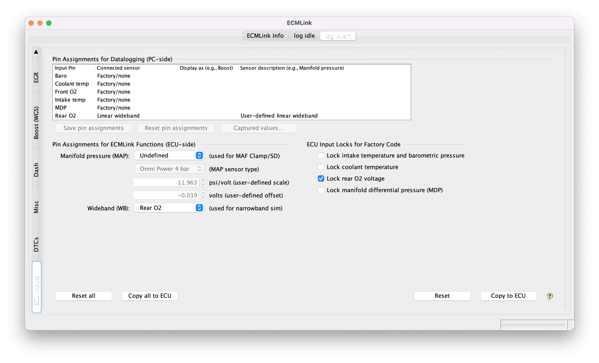

Additionally; Please check that you have the MAP sensor configured in this screen:
Notice, there is no MAP sensor here.

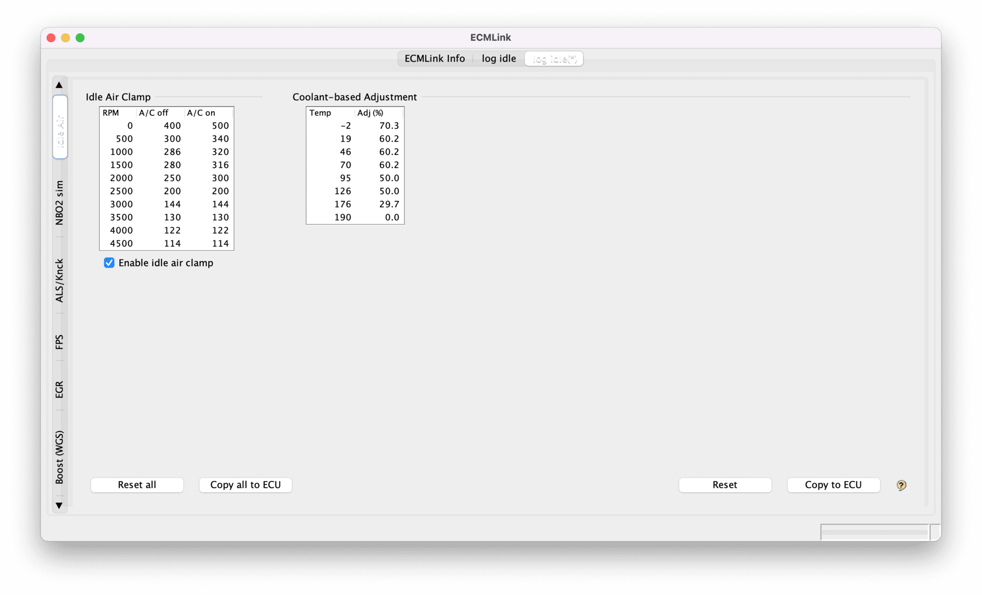

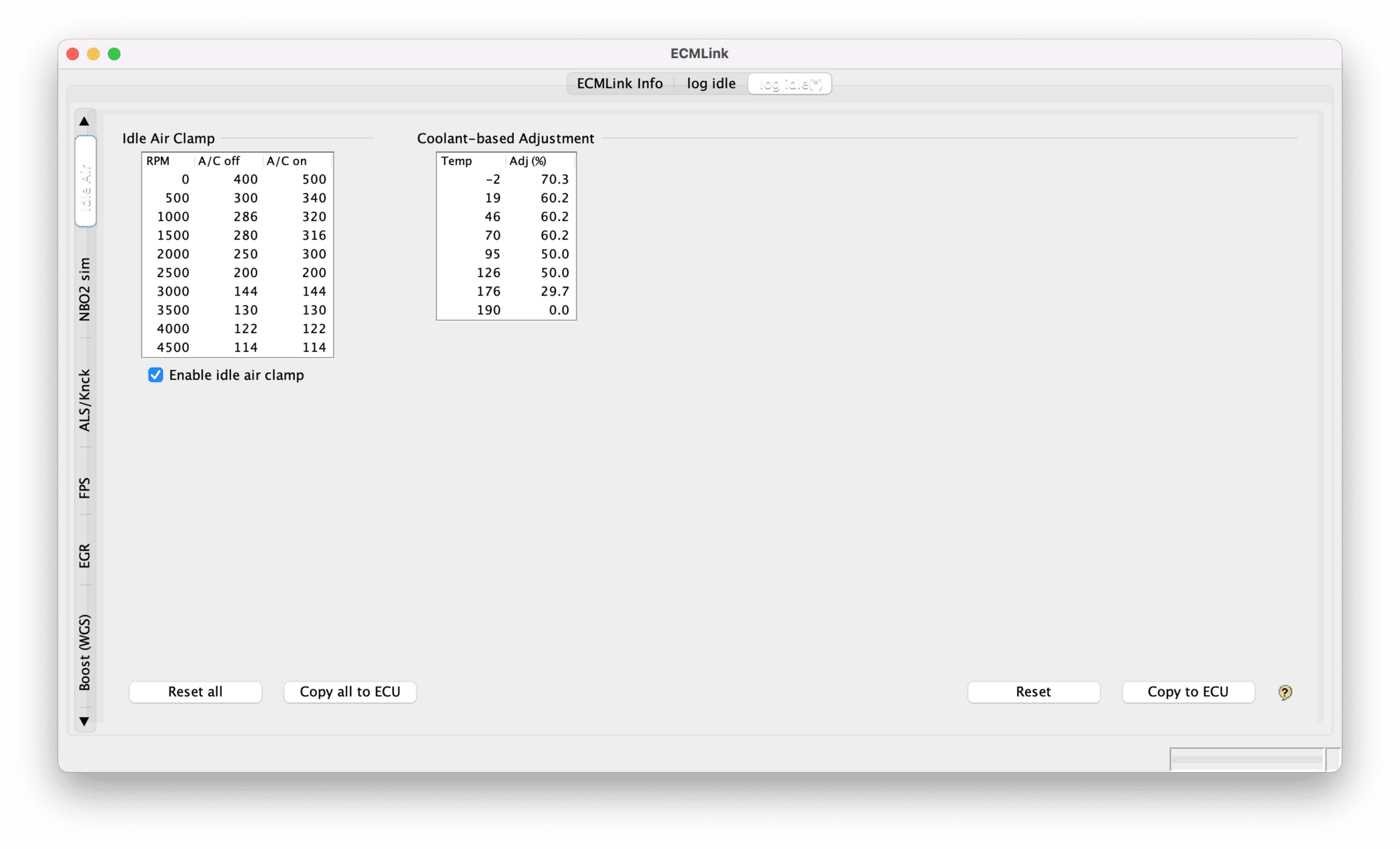

I see you have Idle Air Clamp enabled. Is that for a reason?
okay ill check on the map! and no i dont know what that does, it must have been from the previous owner. should i disable it? im trying to get my car to run “stock” so lmk thanks!

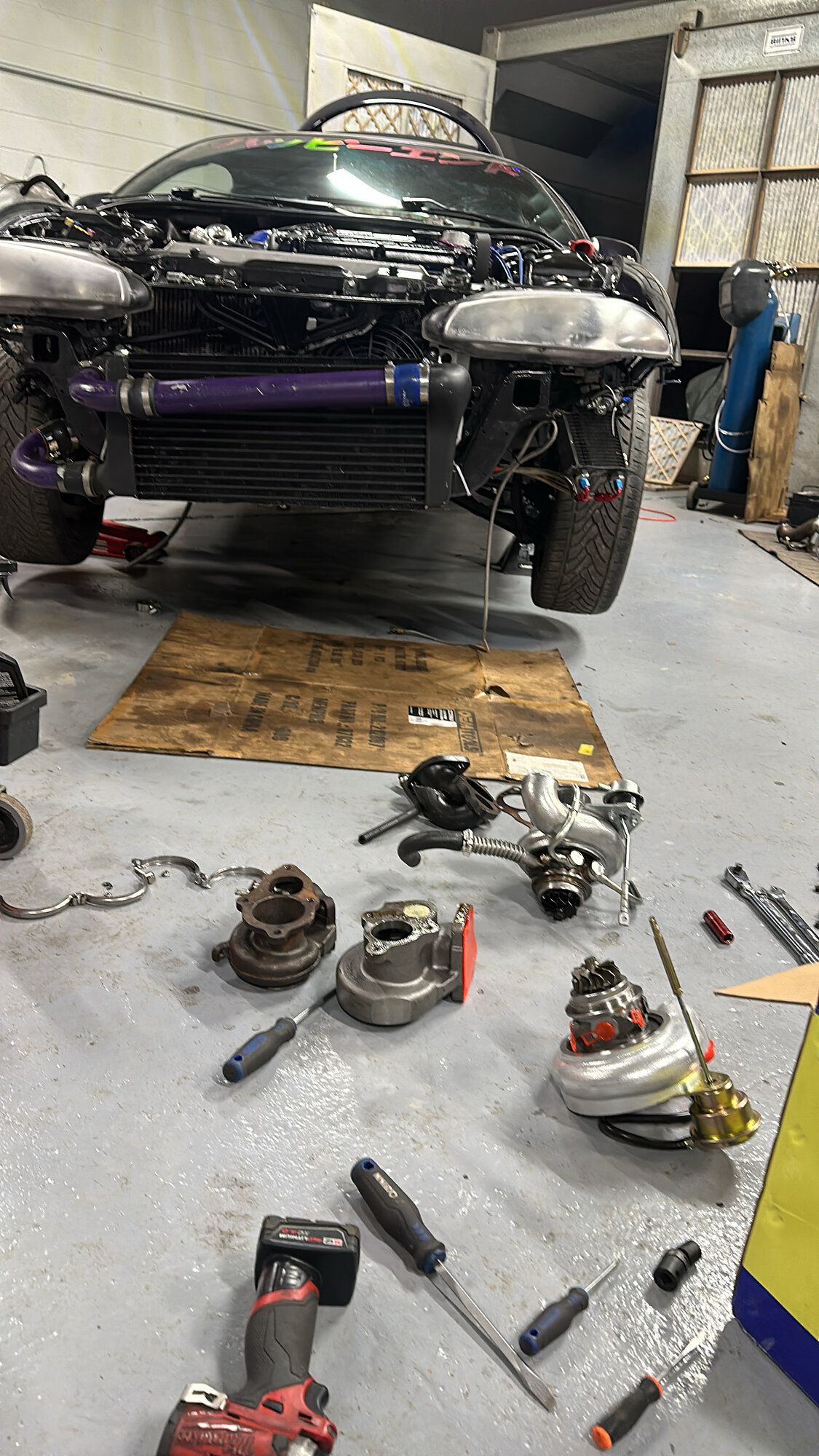

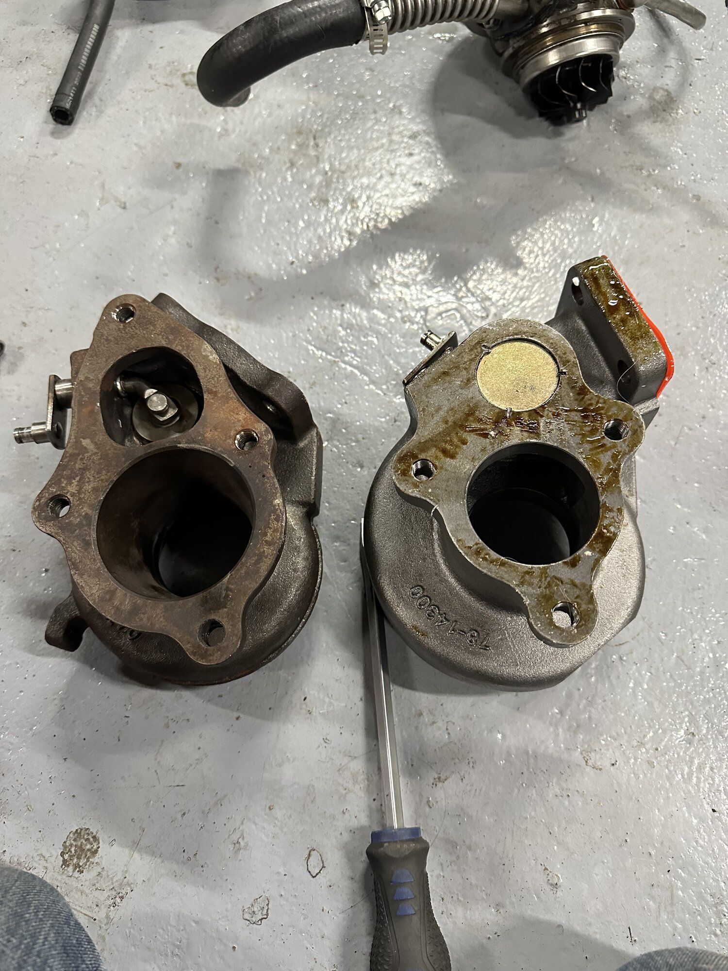

heres the oil leak, im pretty sure im pretty sure im not supposed to be leaking oil thru my down pipe?

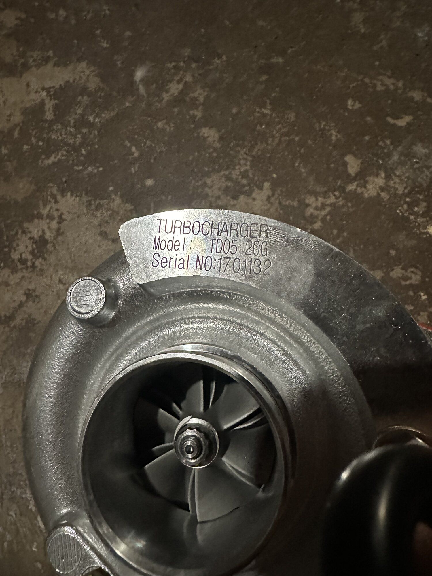

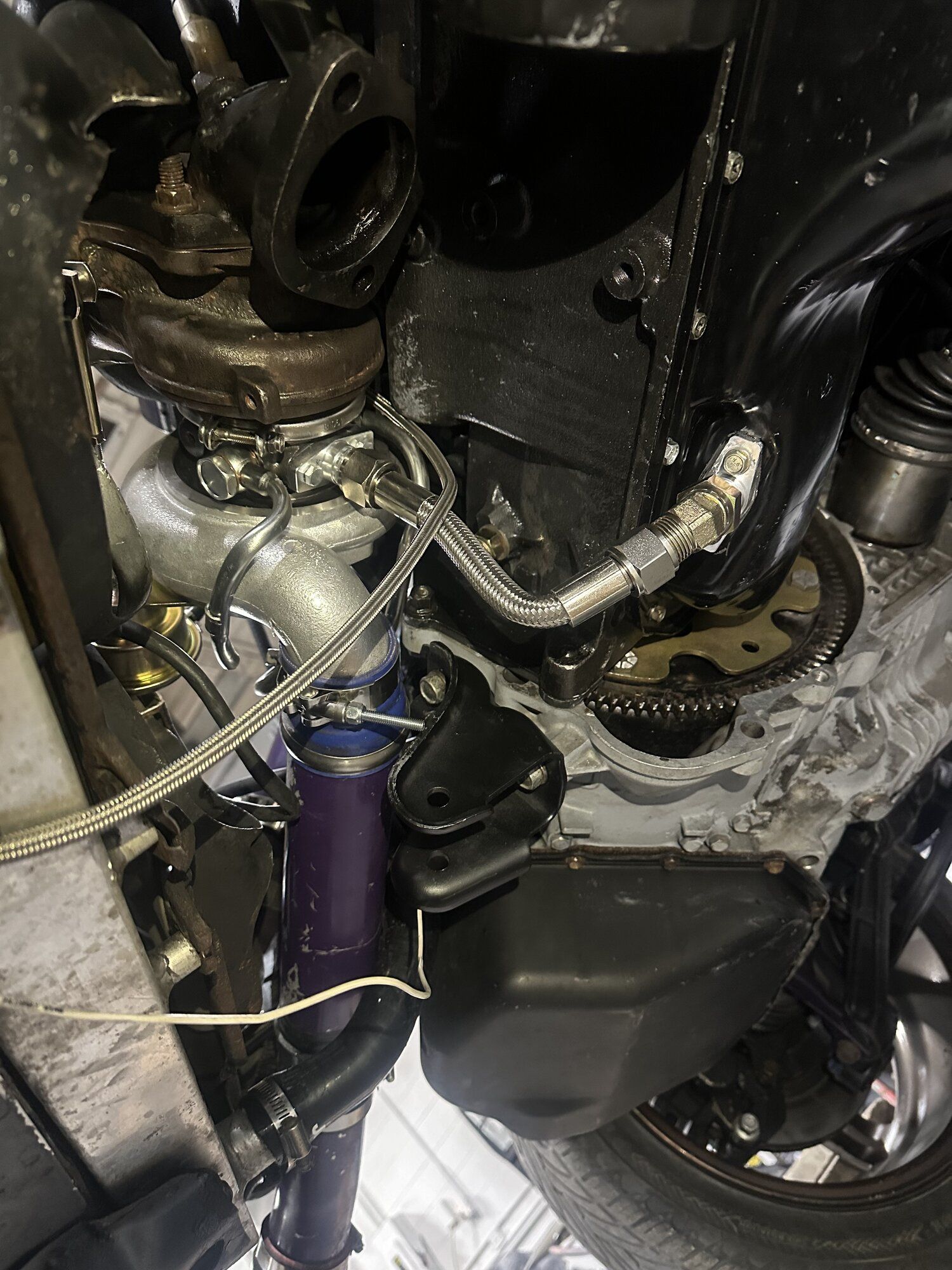

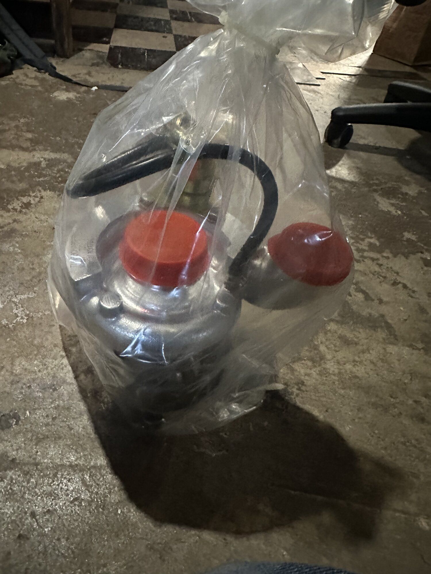

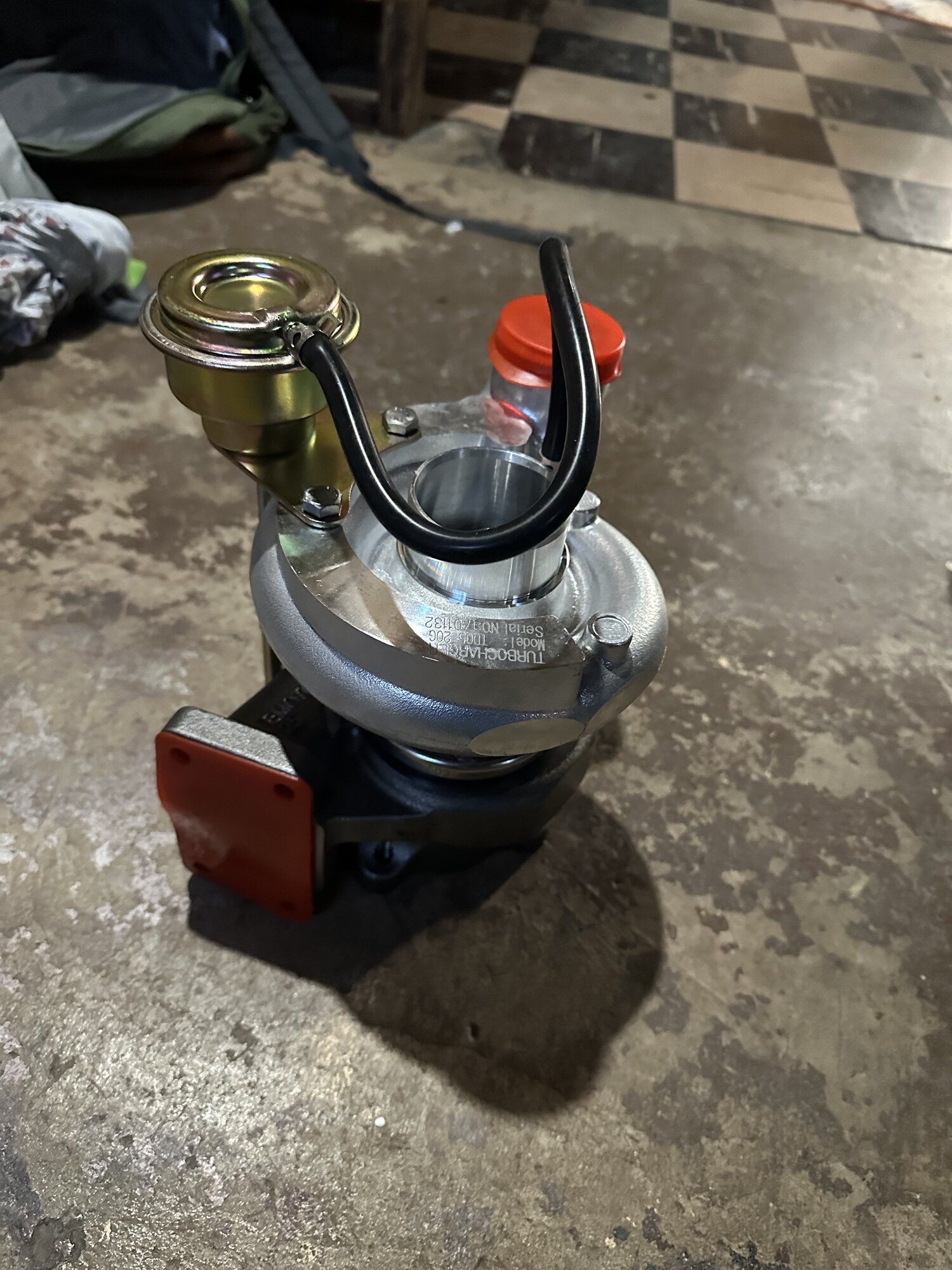

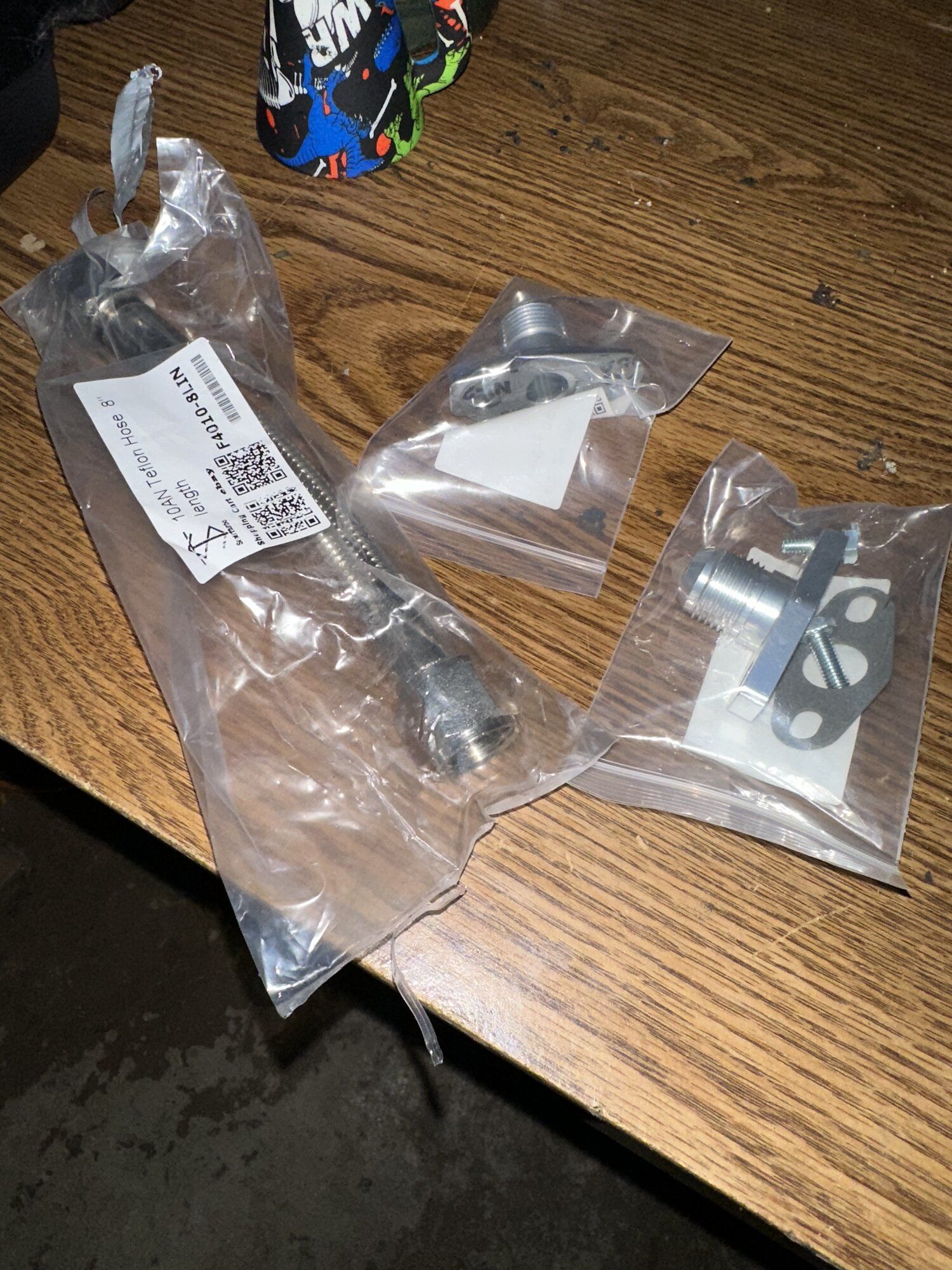

new new 🤟🏼 unfortunately its the ebay special til i can get my built turbo done with justin. didnt want to risk any more issues with the other turbo, if i did rebuild it, the bolt holes for mounting and the 02 housing were all f***ed up anyways, so ill just buy new so hopefully it doesnt have any problems also finally got ahold of a new turbo oil drain all AN shouldnt leak a drop now to just get it all installed tomorrow and hopefully we can run her without oil leaks 🤟🏼

Some people have touched on the oil drain. edit: I looked at the photo again and it looks like you fixed it with the new drain kit!
