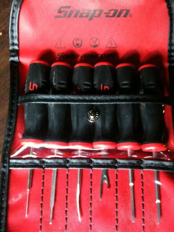

Time to update this thread, last fryday at the shop we had a visit from the Snap-On truck. Just in time for my build since I was looking a kit like this. :D

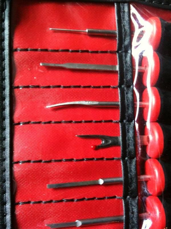

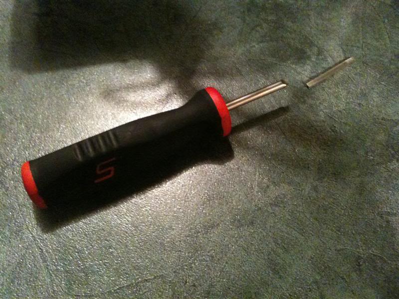

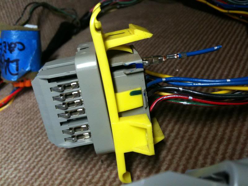

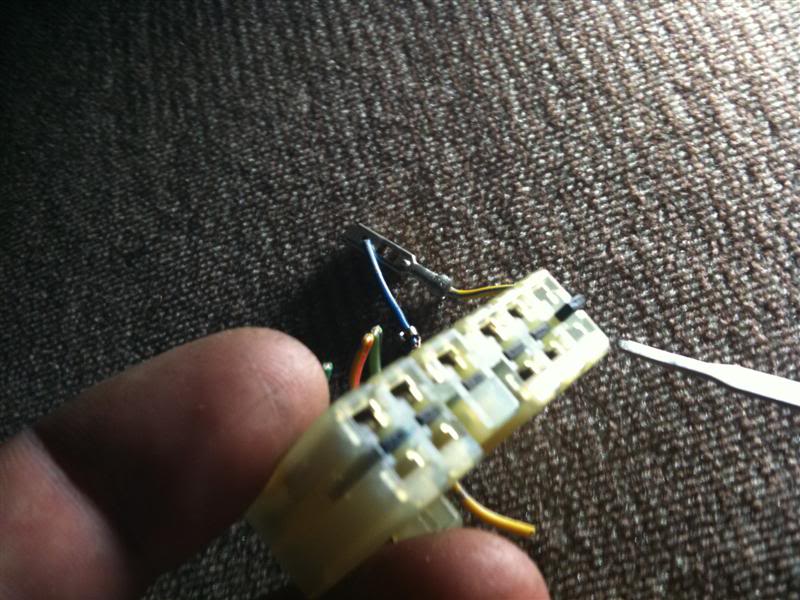

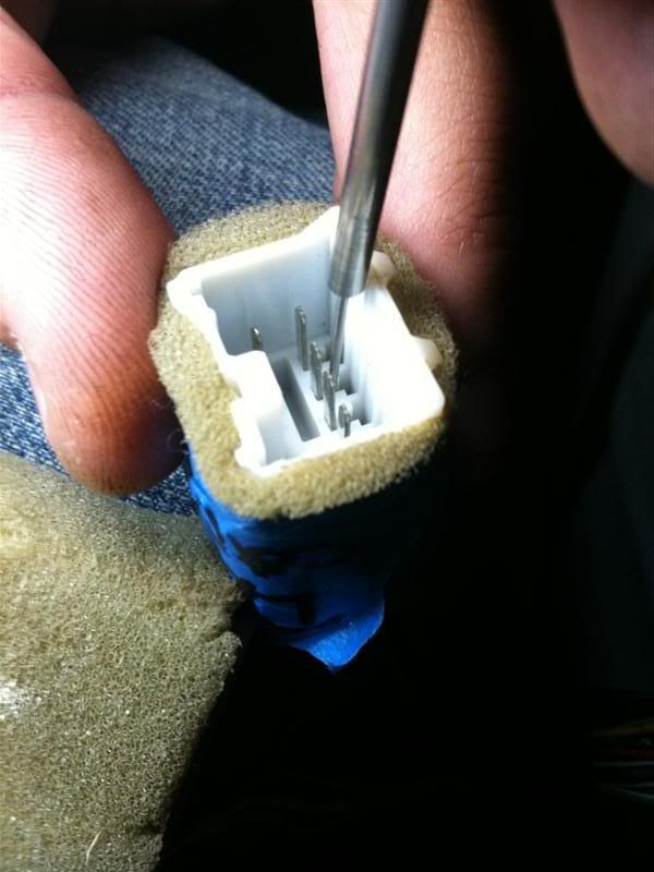

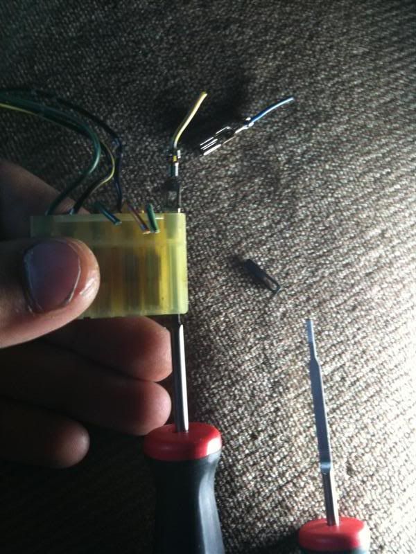

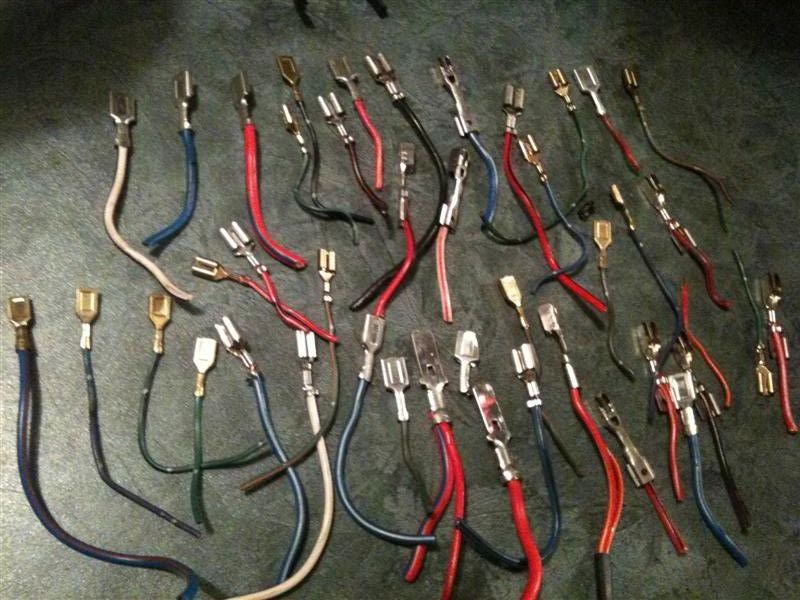

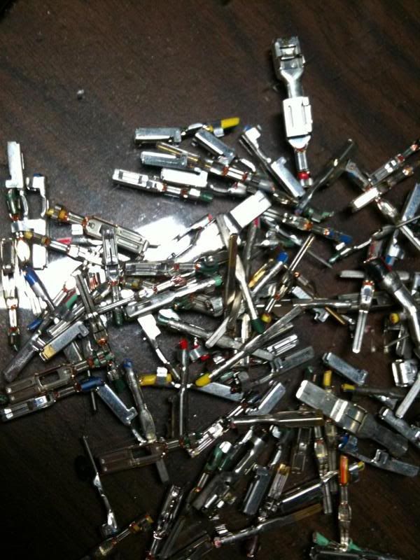

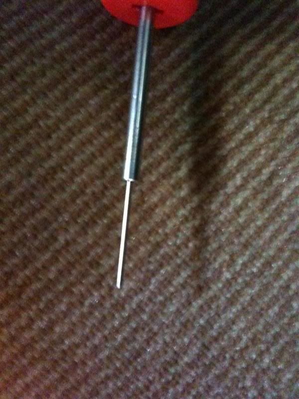

You always have something like a clip to remove before extracting the wire ...
This connector was the biggest pain, takes me 5 minutes LOL ;)

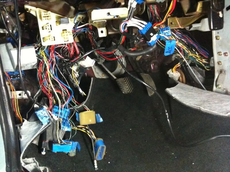

Here is my day of work:
With the right tool it was really easy to do ! Now it's time to start tucking the engine harness. :tat:

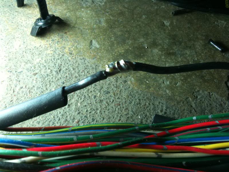

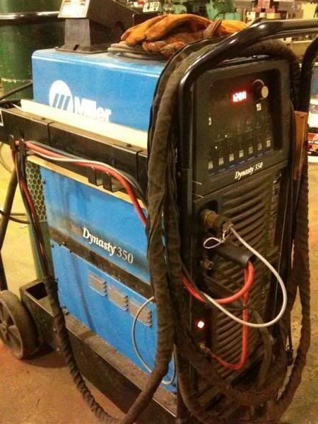

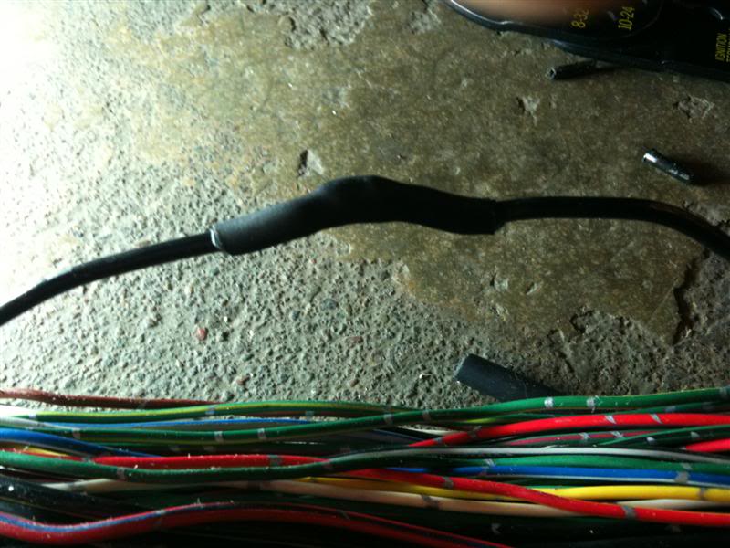

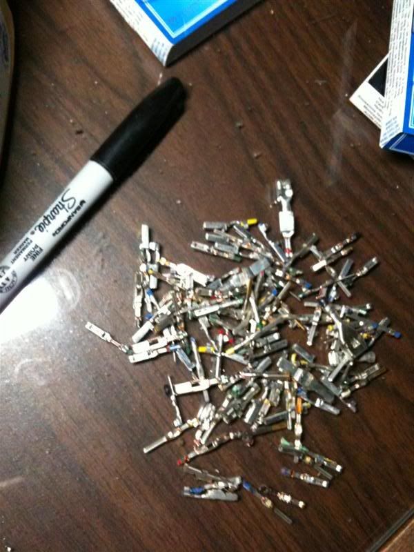

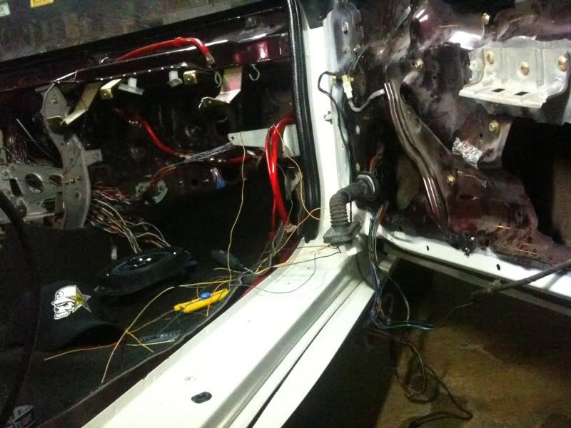

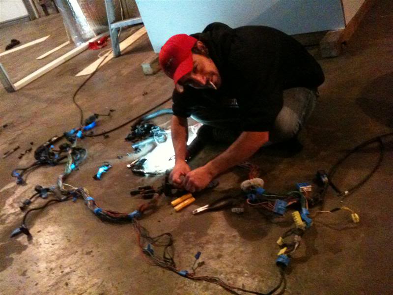

Got some more work done on the wiring, the engine one is alsmot done, it's taking longer since I'm welding every place with tape and stock crimp connector in every harness. I'll have to buy a new gun since it's to long to weld a 14ga with my small heater ...
This is me still working on the damn harness ;)

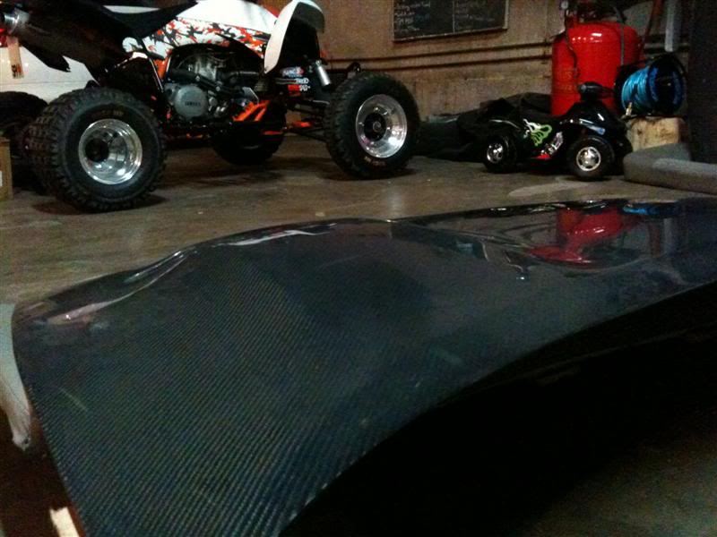

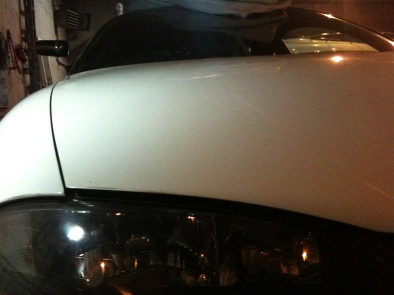

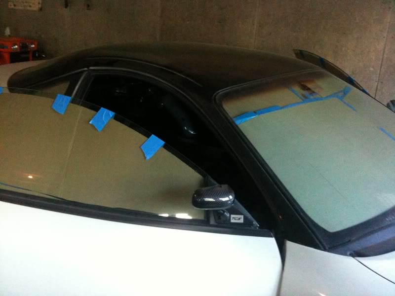

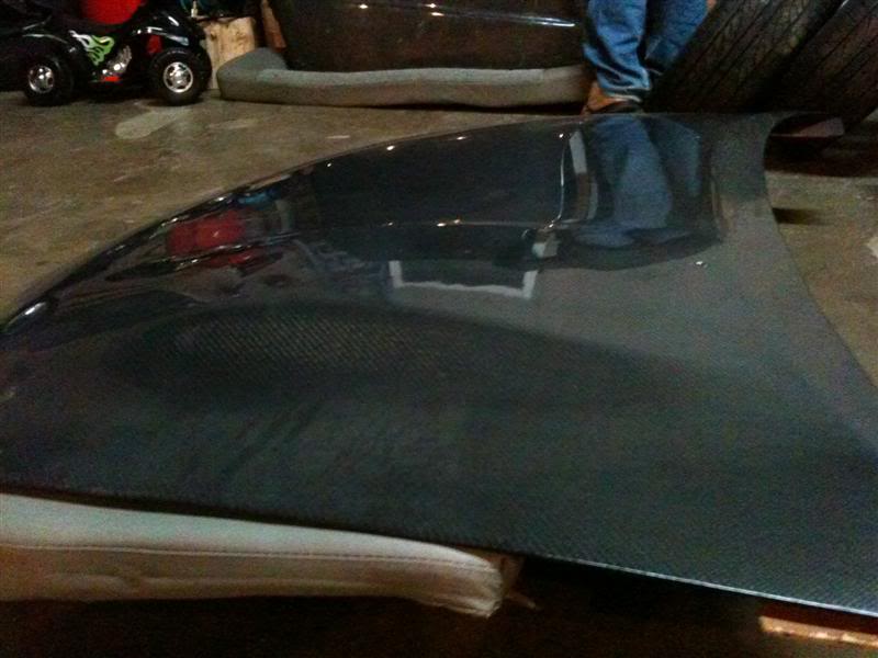

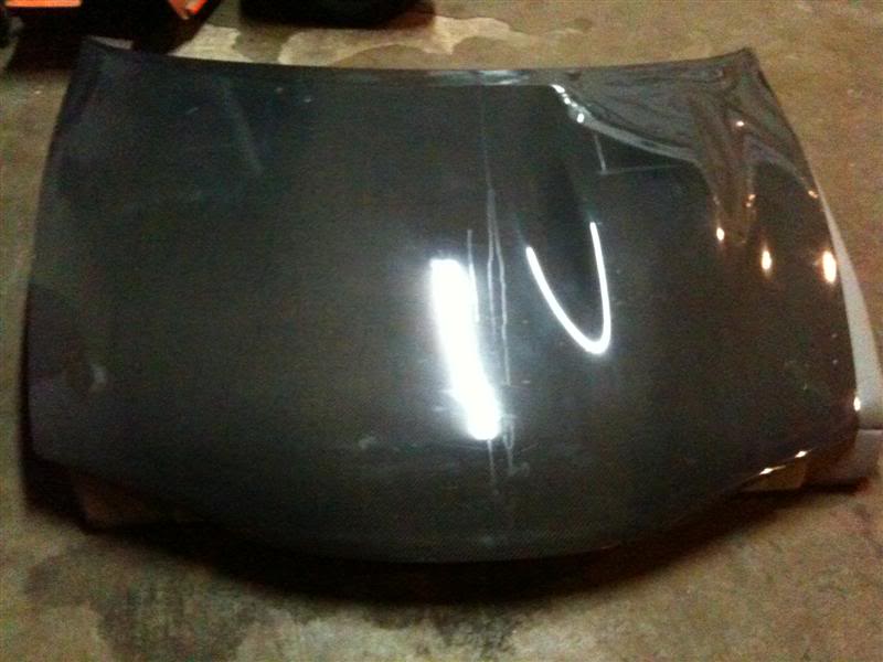

Also last week-end I found an OEM style CF hood ! WOOOOOOOOOT :tat: Long story, the seller had an other one in his house who was cleaner than the one at 75$ so I had this one for 125$. On this one the holes for windshield still block, just what I wanted :D Still need a bit of work but I have all the time to make it shine like new. :tat:

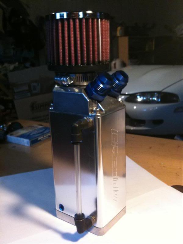

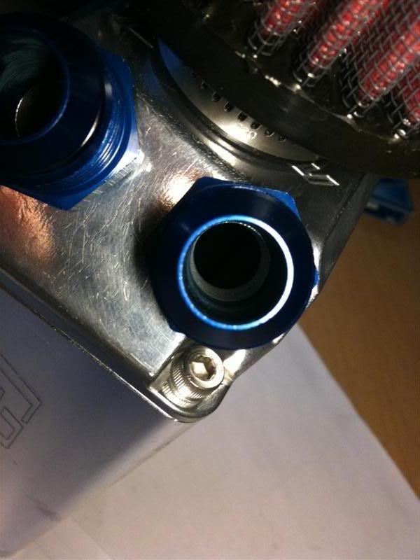

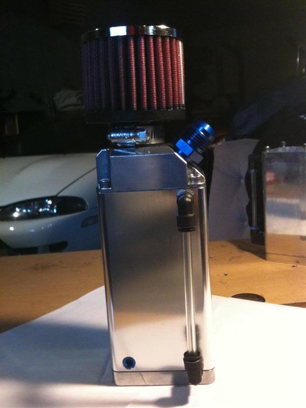

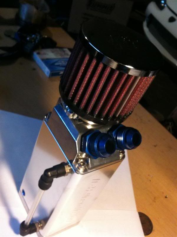

Here is my new GReddy vented catch can ! Modified by me :D
I even redrill the interior of the adapter to get the more flow as possible ... :D

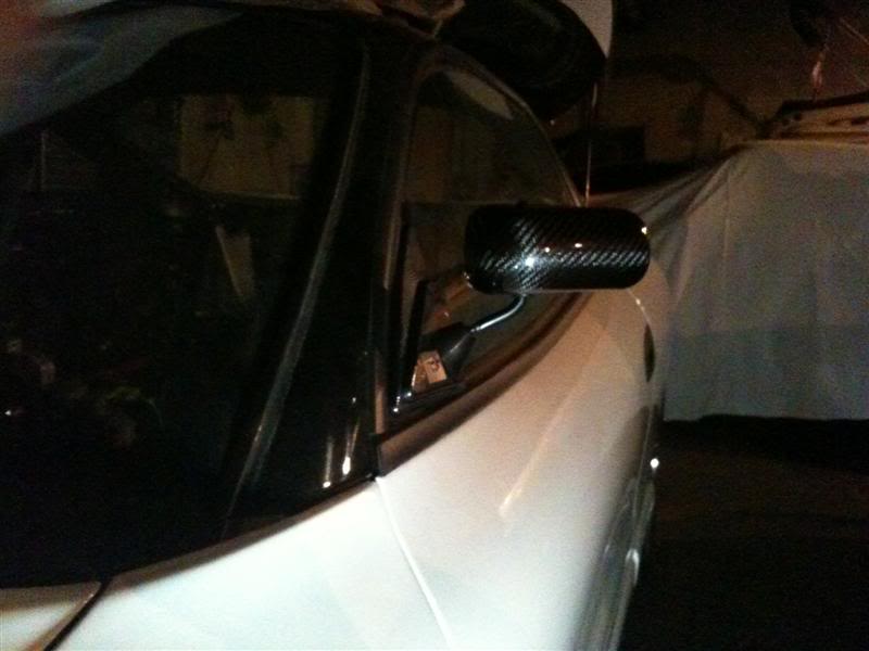

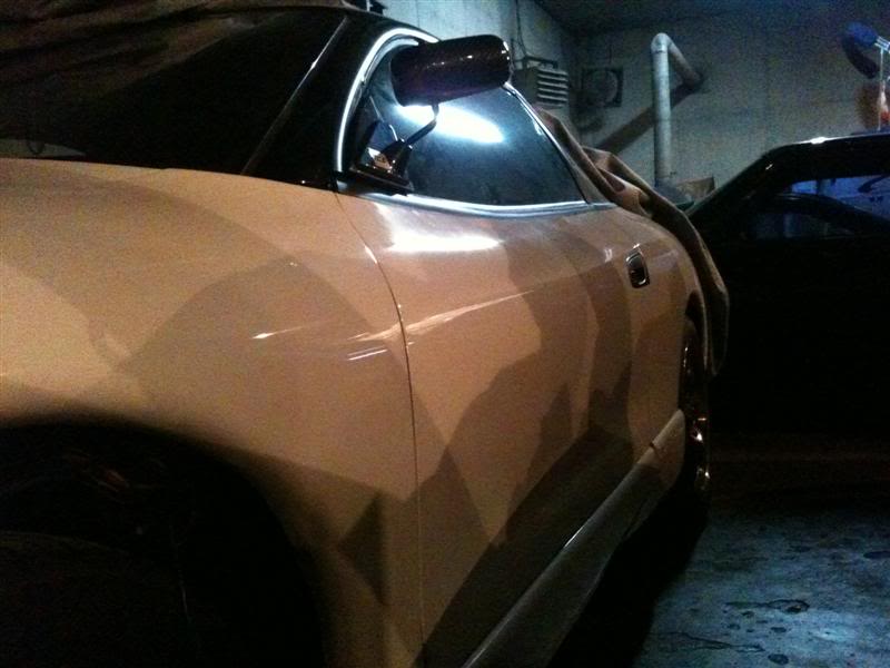

Just installed my TCS CF mirror and no they did not direct bolt on ... I think they look awesome and only paid 55$ shipped to my house. :D
Crappy pictures I know but I wanted to show you. :)

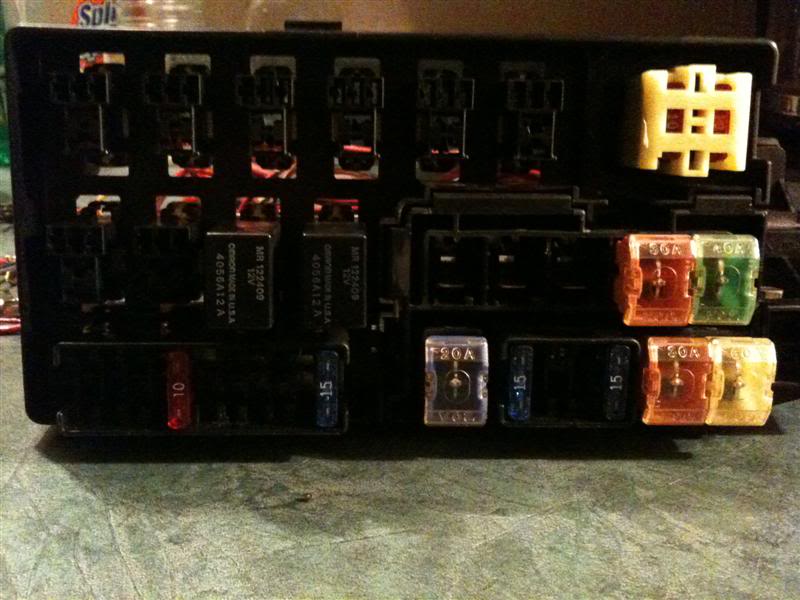

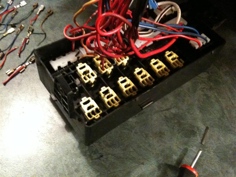

Here is how my fuse box looks now, damn there was some tough connector in there !

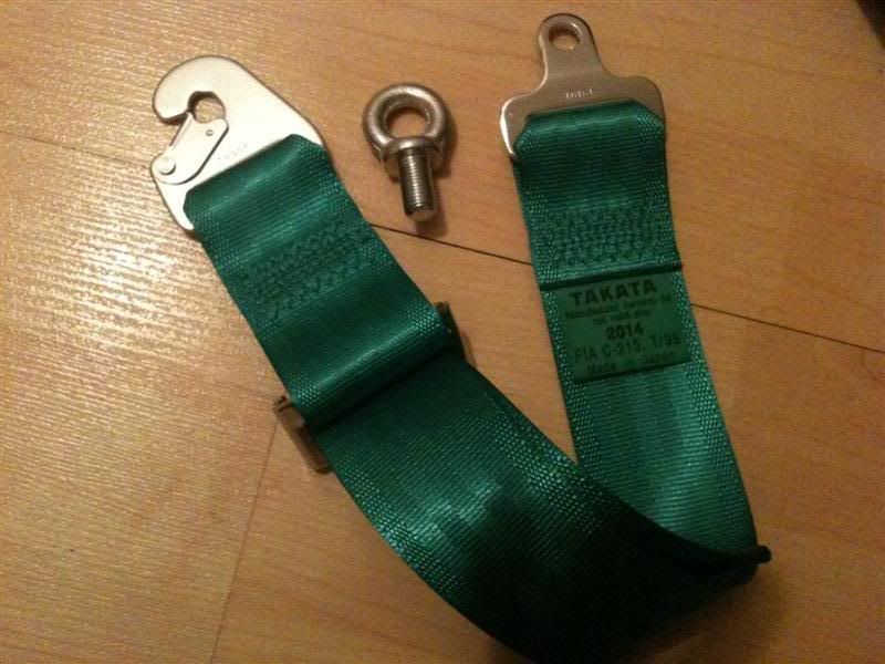

My new Takata 4 points harness, still waiting for the 5 points crotch and seat bracket from WedgeEngineering :)

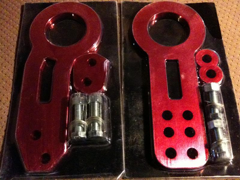

New tow hook

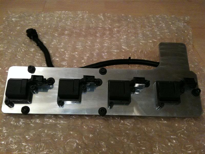

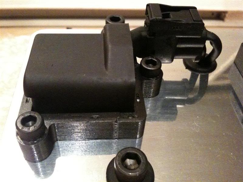

COP setup with 3.5L coil :D

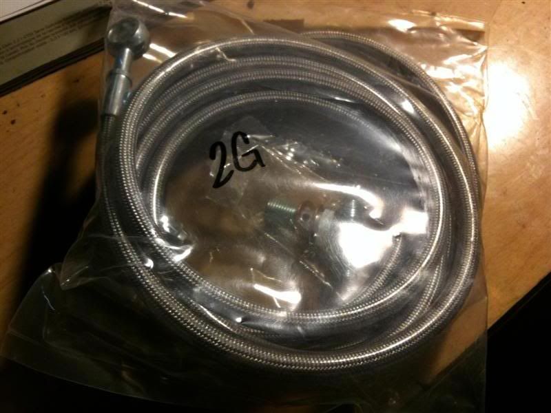

Full clutch line:

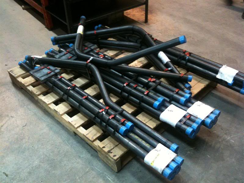

And the big update, here is 4 - 10pts roll cage from s&w race cars and yes there is one for my 2gen ;)

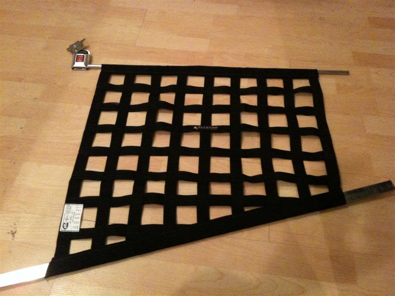

With the cage I wanted a window net so here is an Allstar window net with a G-Force bracket. ;)

Finally received the Takata 5 point

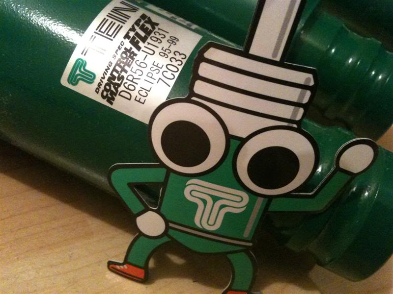

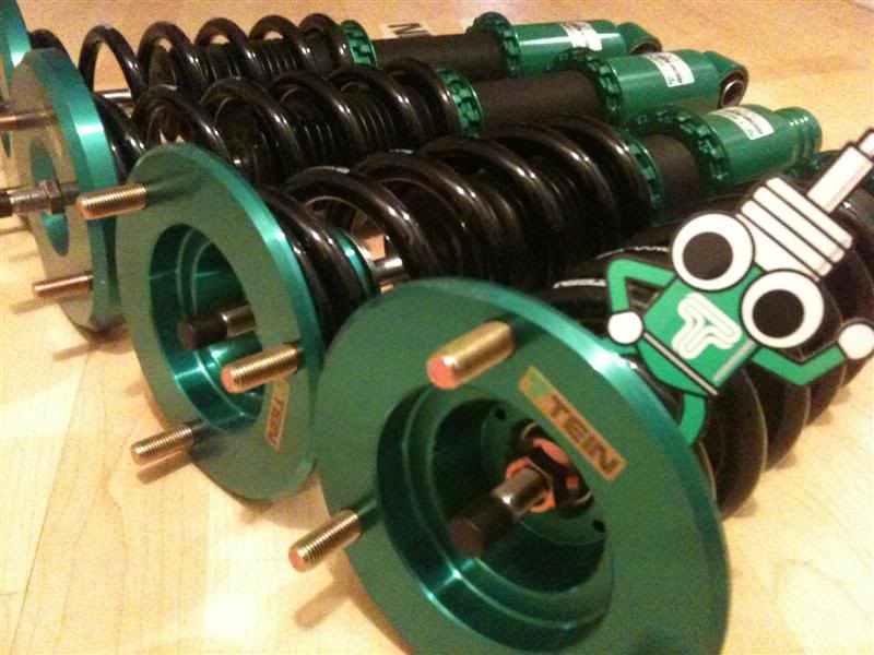

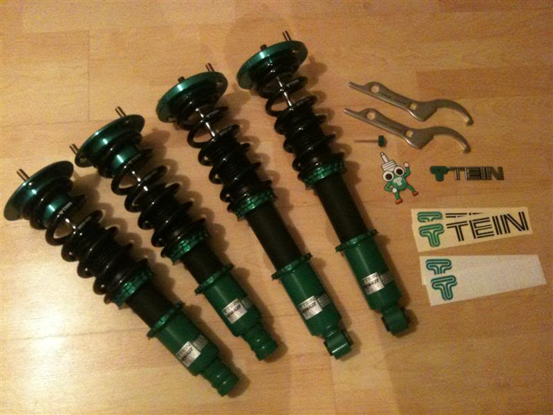

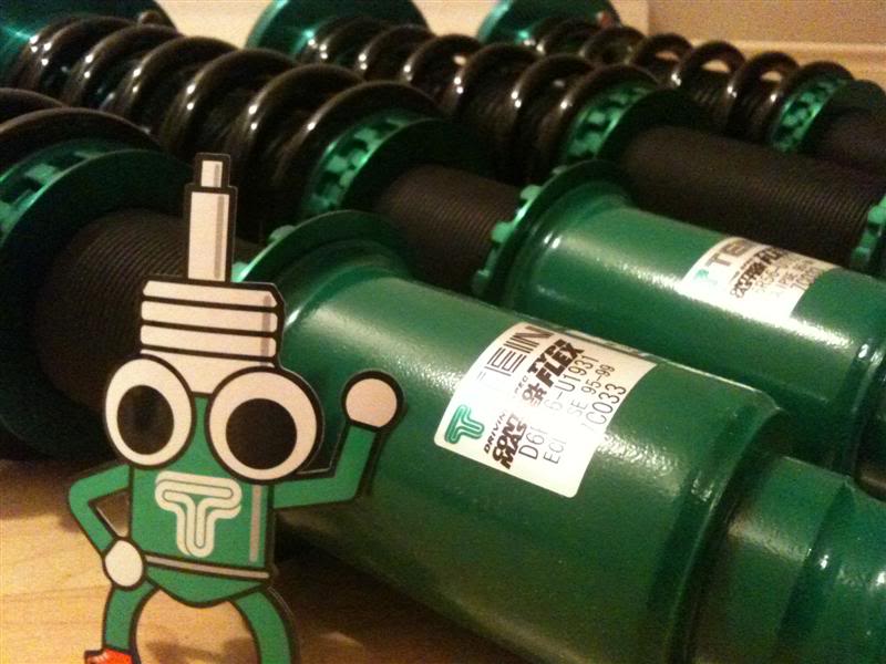

Tein Sexy Flex Coilover ! :D
Igor disapointed since we did not install the coilover tonight ... haha ;)

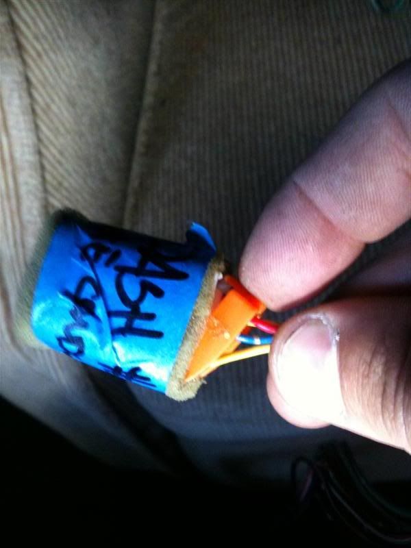

Tucking is almost finish except for the jonction connector ... I was happy as hell to finally remove this body harness from the car. :tat:

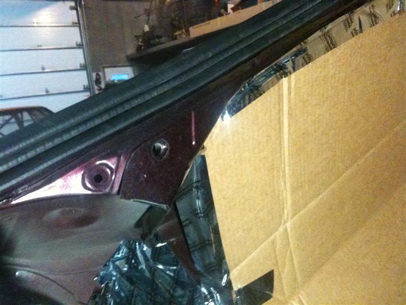

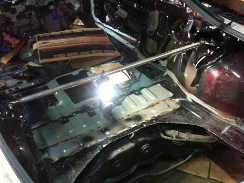

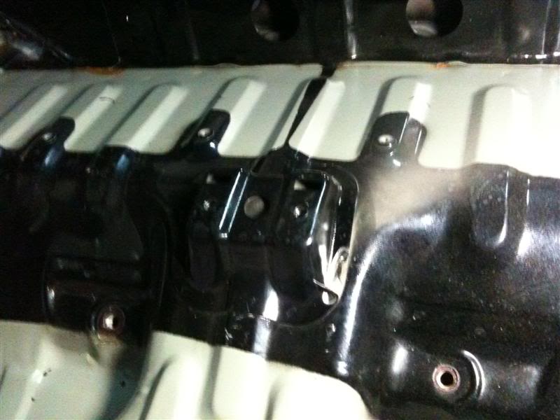

Got some time to work on my car yesterday since we have the wrong a-pillar for the 240sx roll cage. We sold the kit for a civic 98 and guess what, we mixed the a-pillar with the 240sx one ...

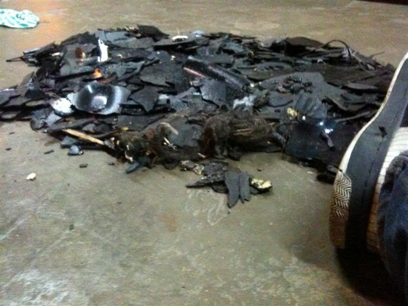

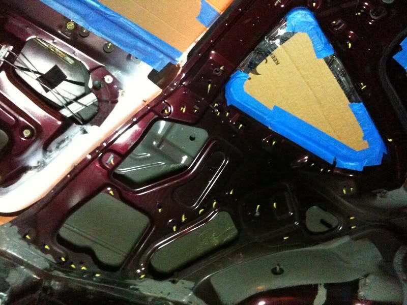

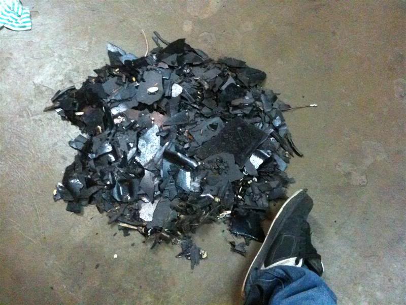

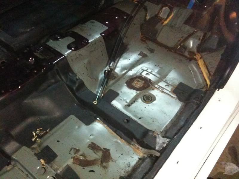

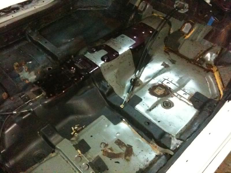

Here's MOST of the deadening mat:
Here's the fugly bracket for the back seat:
Gone ! :D

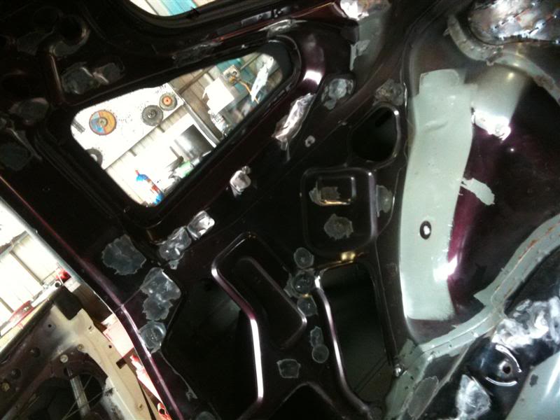

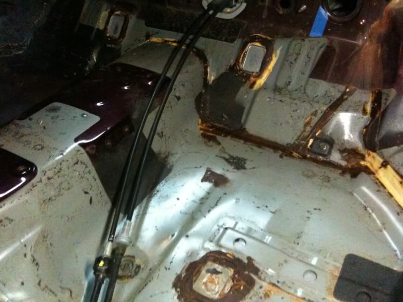

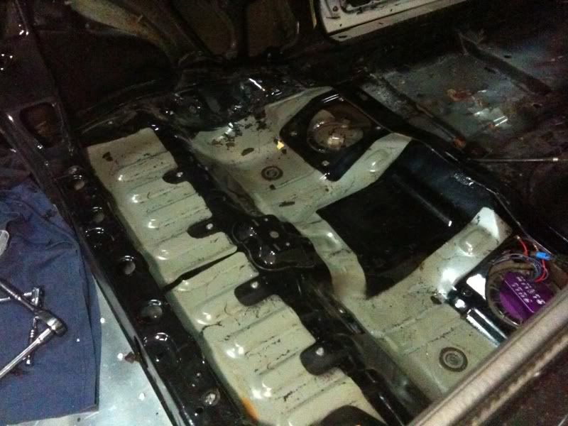

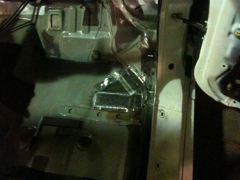

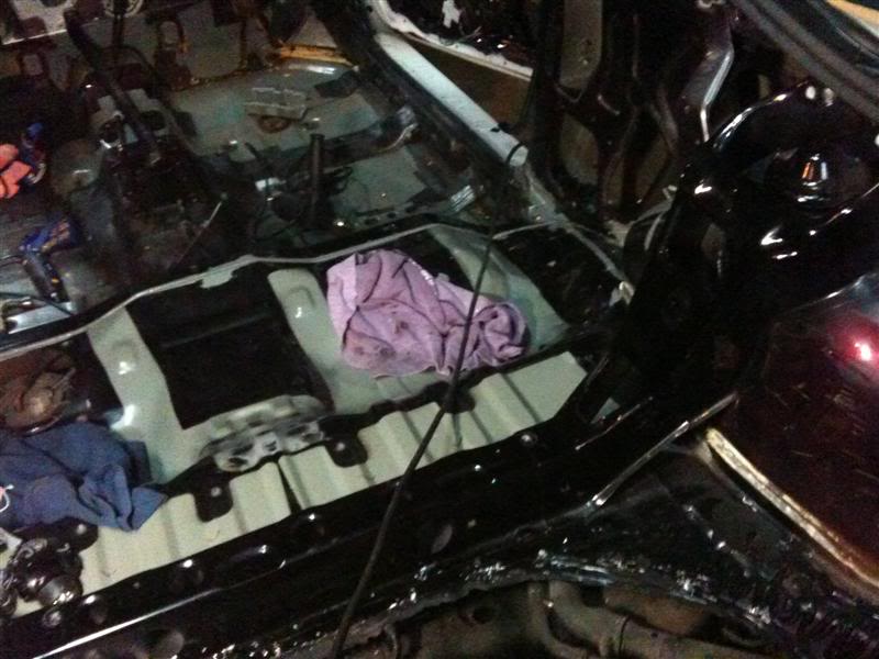

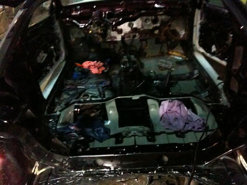

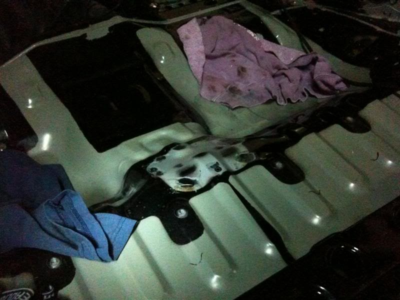

Here you can see no more mat on the fire wall ! Yes it was a real PITA but I'm really happy with the result ! ;)
And the famous rear ! Don't know why but dry ice never worked on this so it took me something like 1 hours each ...
Now here's what I did yesterday, thank me later for showing you this. ;)

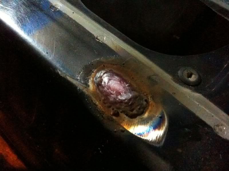

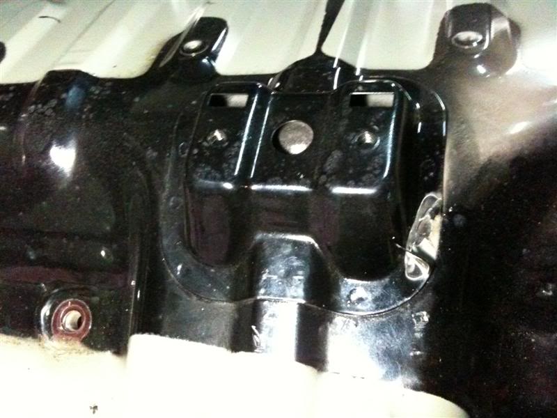

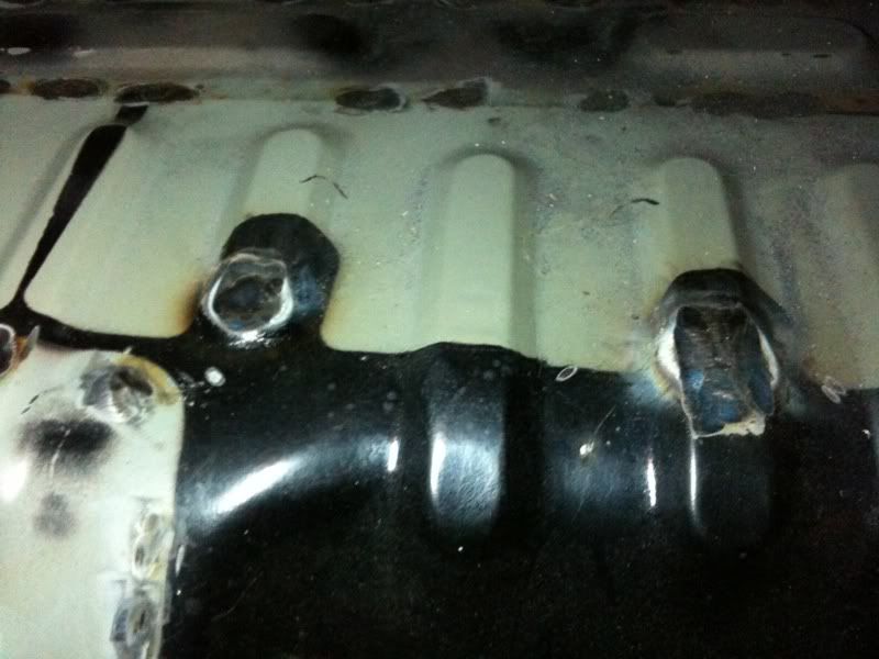

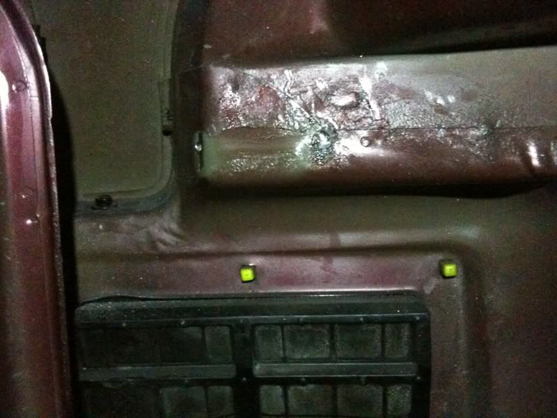

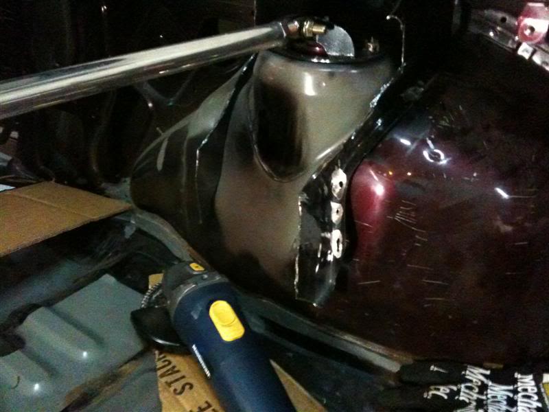

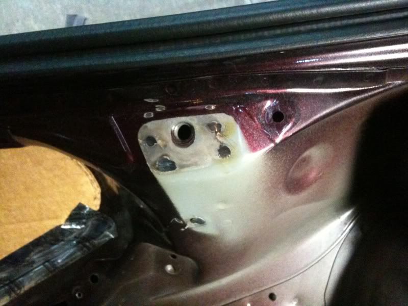

Here you see how to remove this crap, just slowly grind around the spot weld ;)
Still need to remove some, if you want to do it be prepare it takes time.

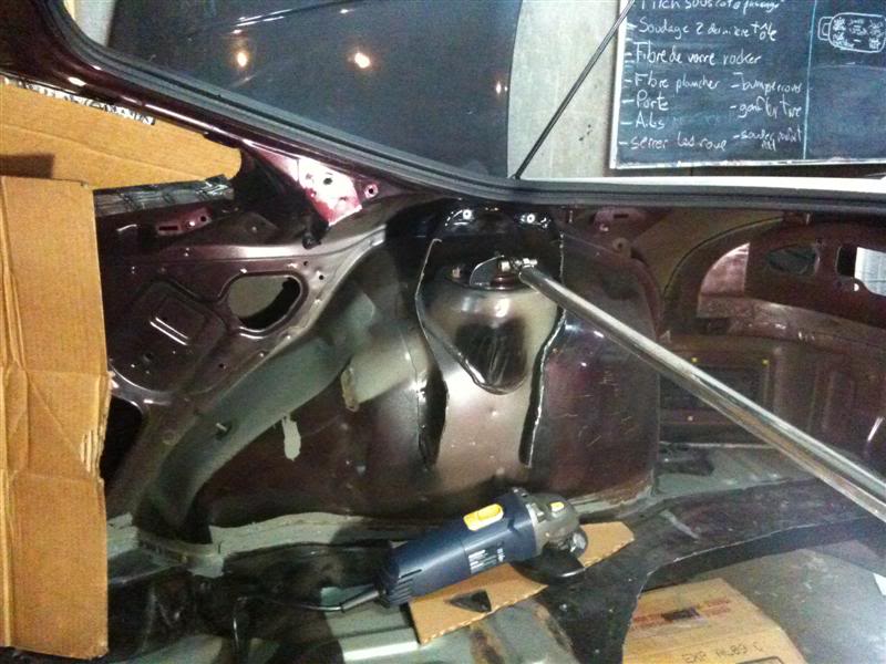

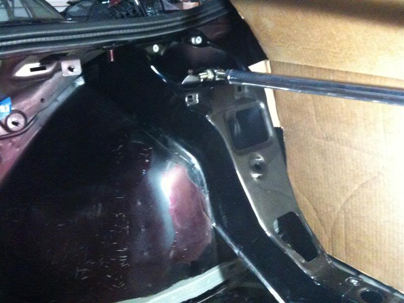

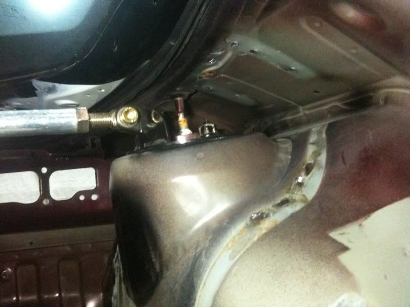

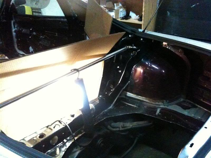

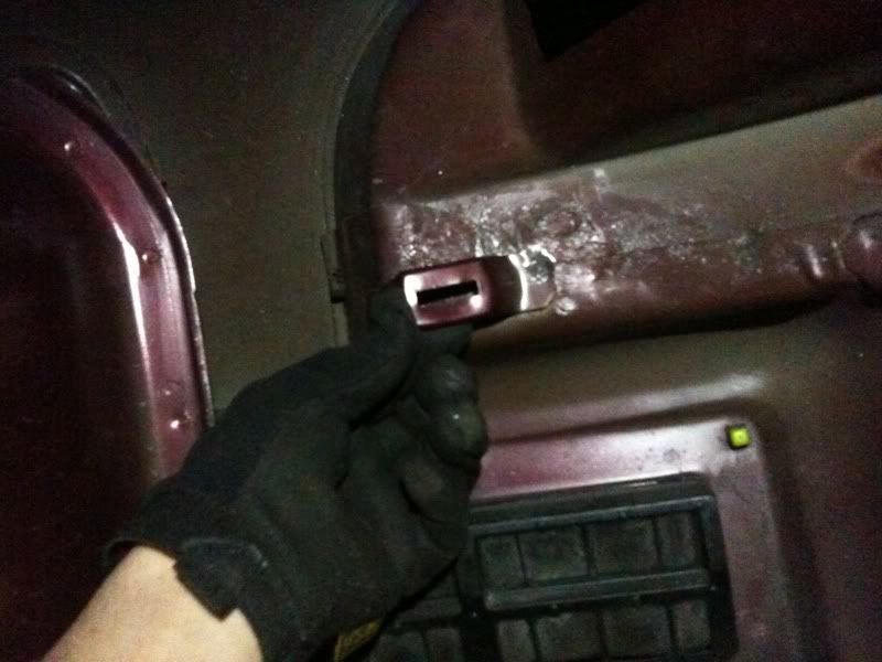

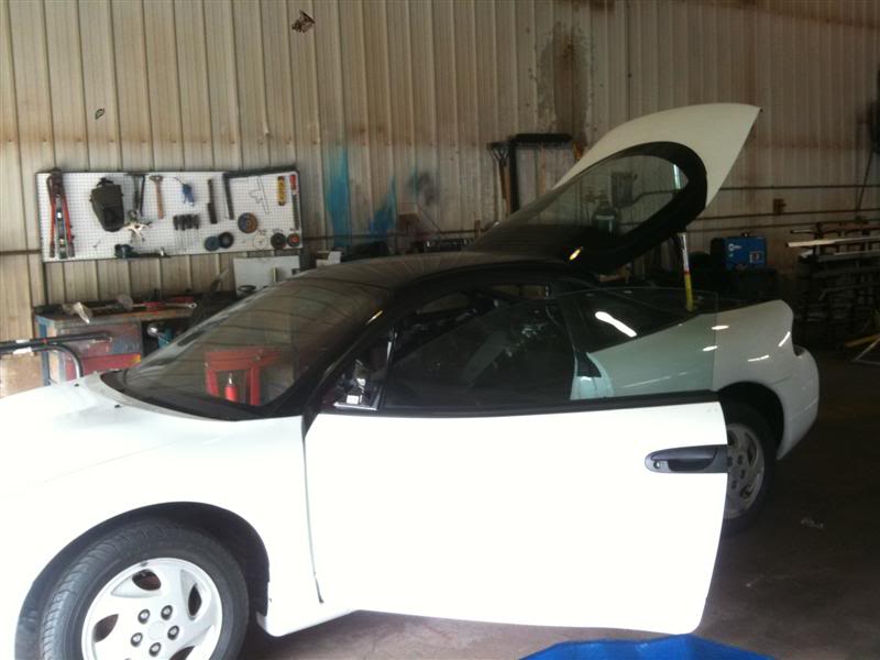

I had to removed the hatch struts since they are brand new and they where pushing on the body to hard. Don't worry I'll weld a new brase when I'll put the cage in. ;)
Here's what I used to remove the last spot weld.

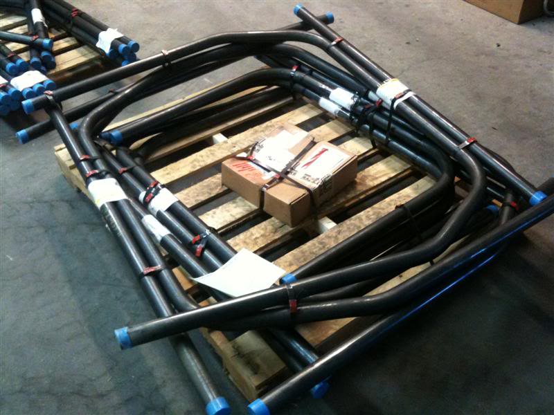

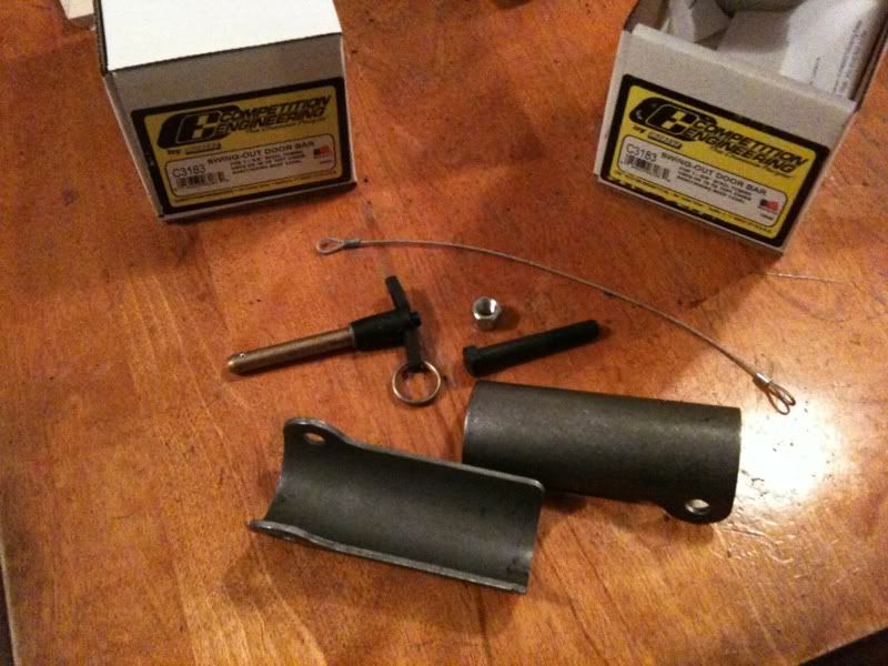

Got these parts last friday, this is one kit. ;)

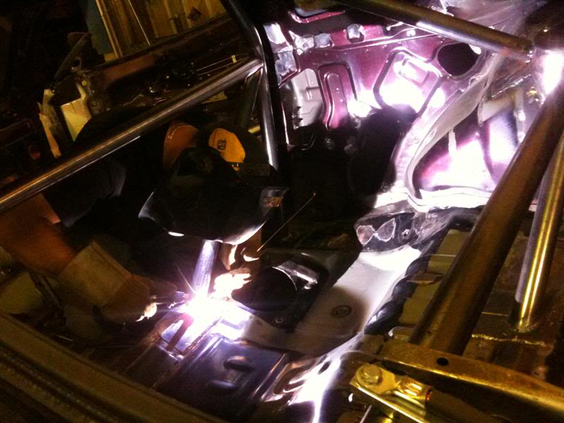

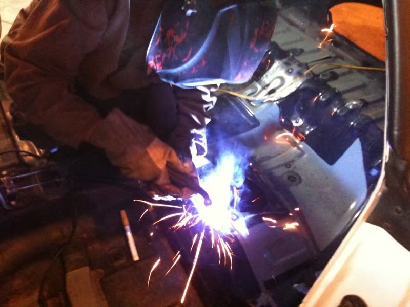

Now it's time to go back to the garage, I'll be done welding today after 100 other holes. So that mean some hours to grind ... ;)

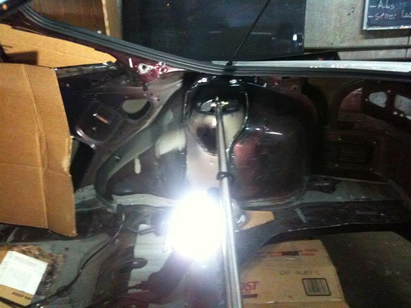

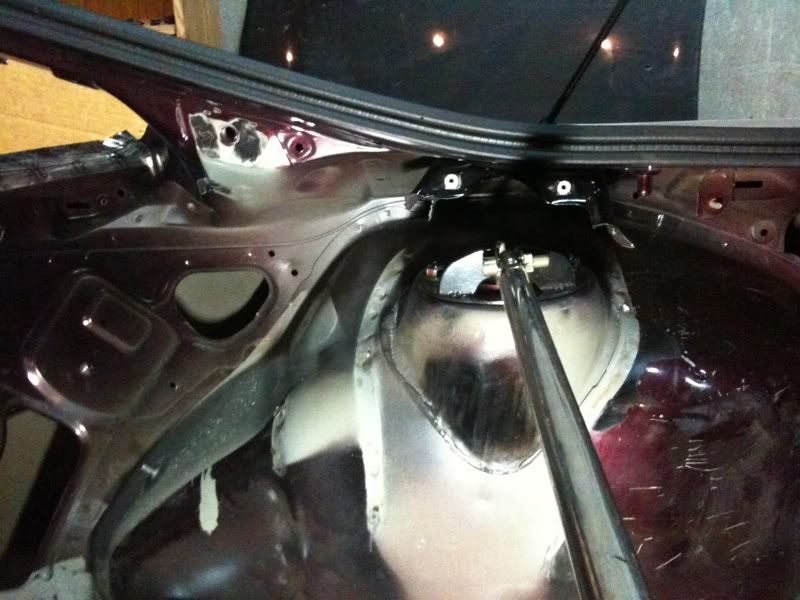

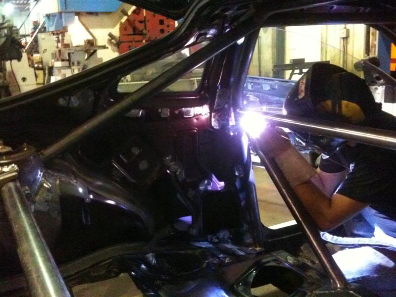

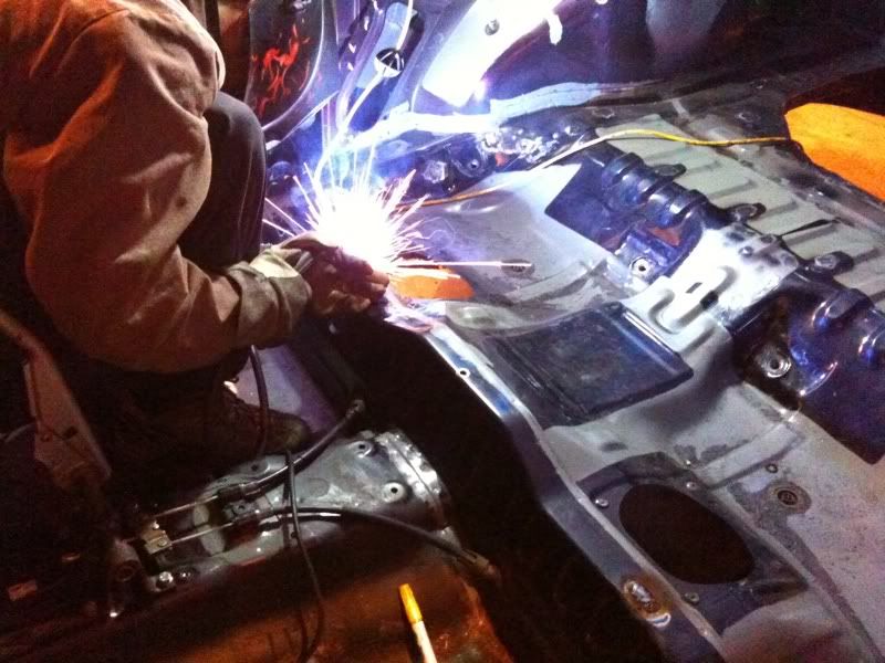

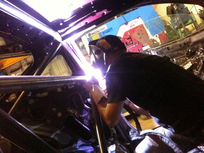

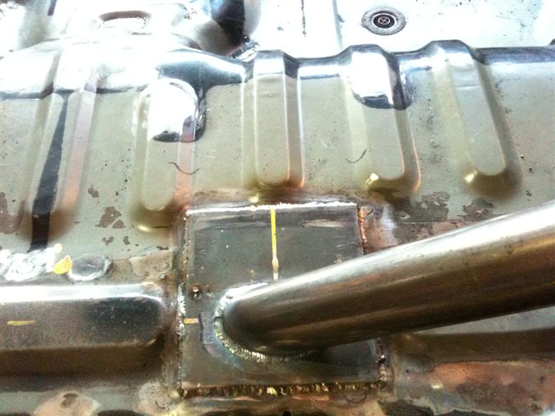

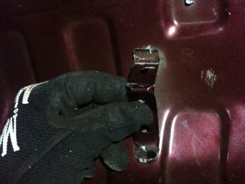

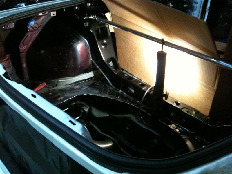

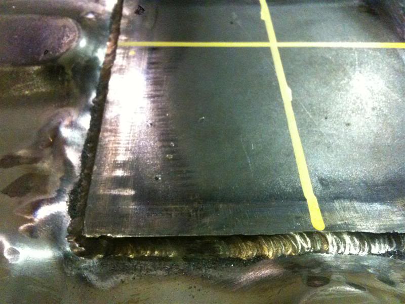

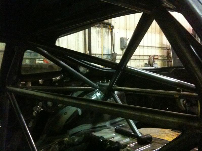

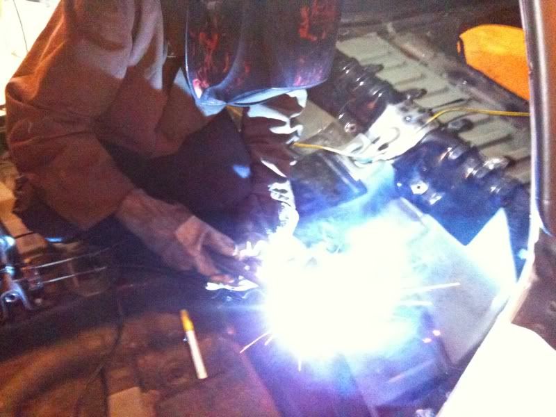

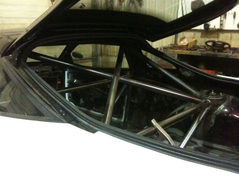

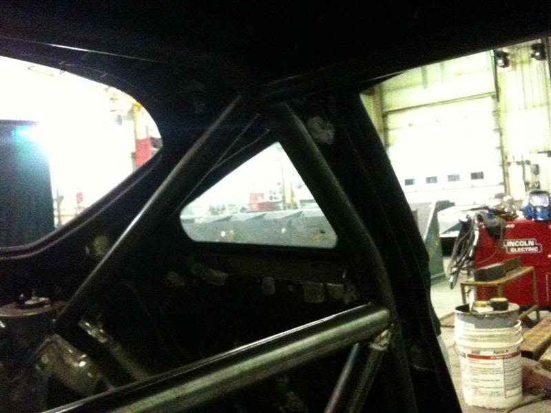

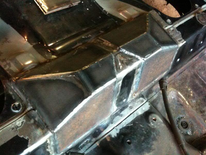

Ok here we go :D

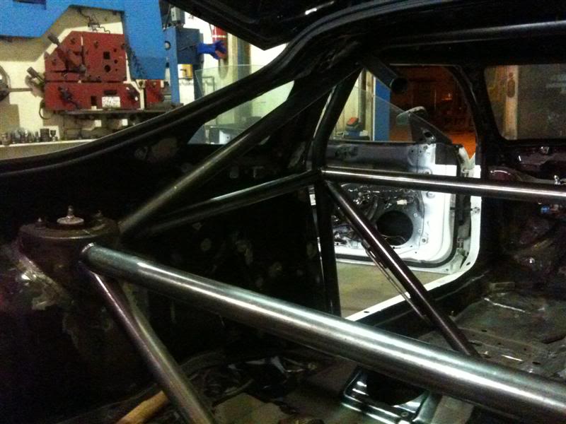

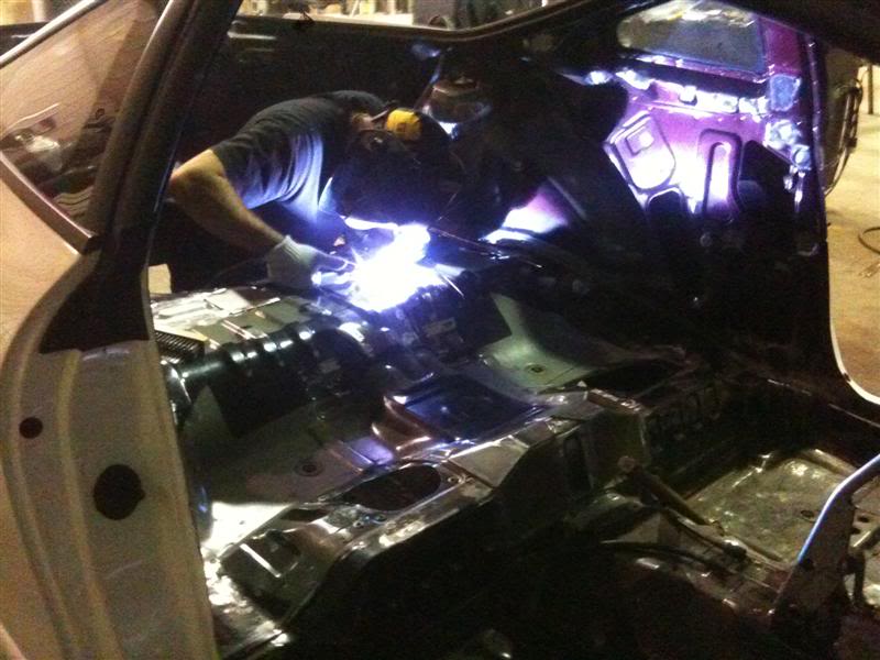

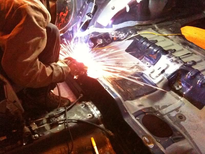

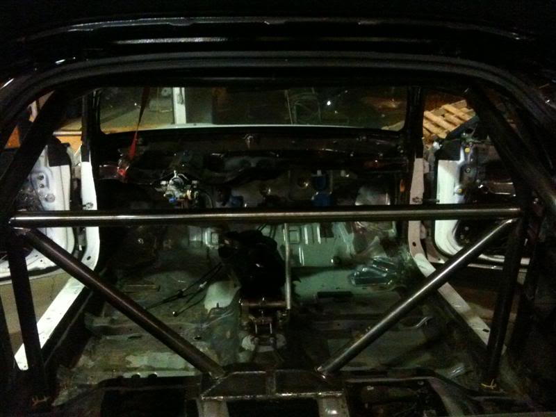

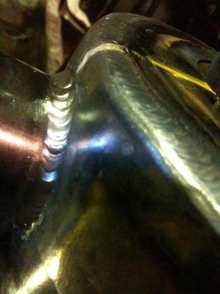

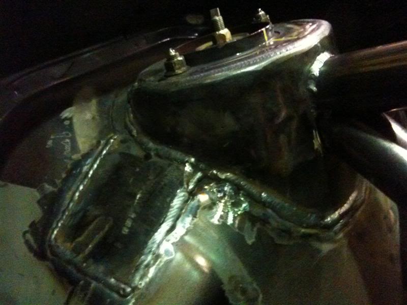

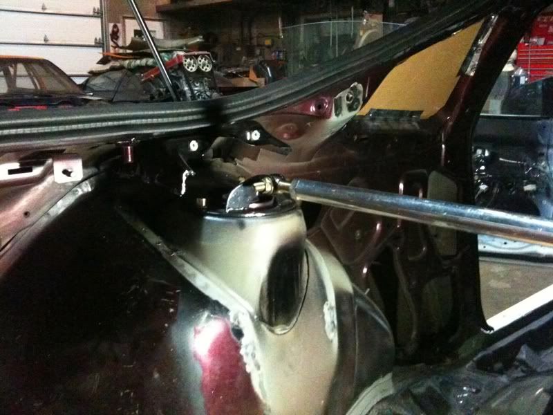

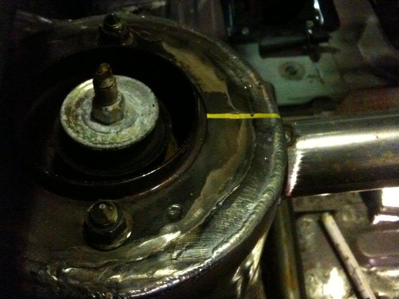

We can't install the cage as fast as I want but a least it will be like I always wanted and welded all around the pipe ;)

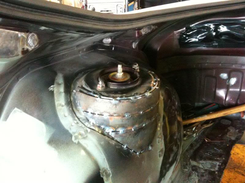

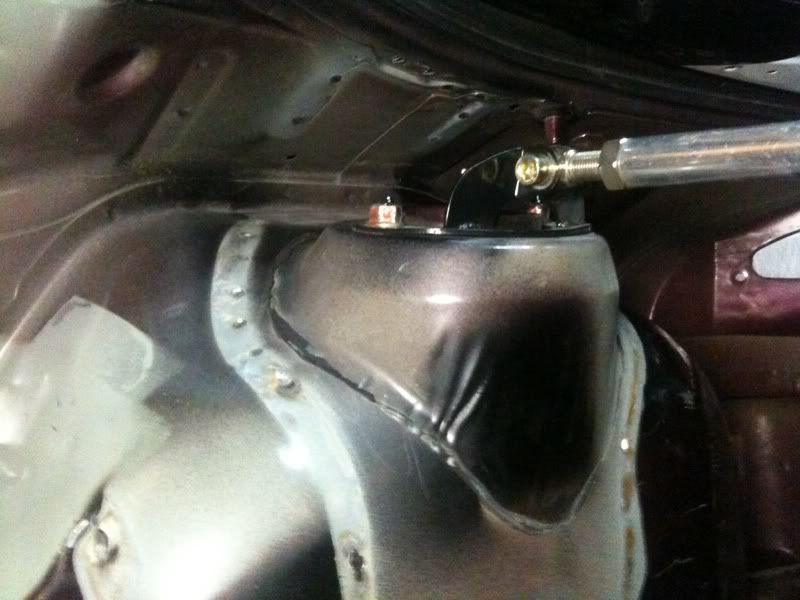

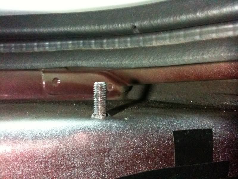

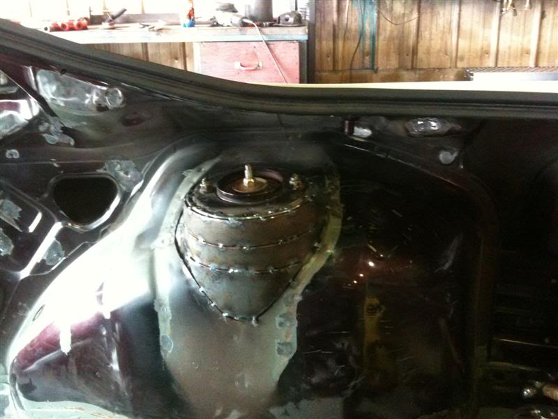

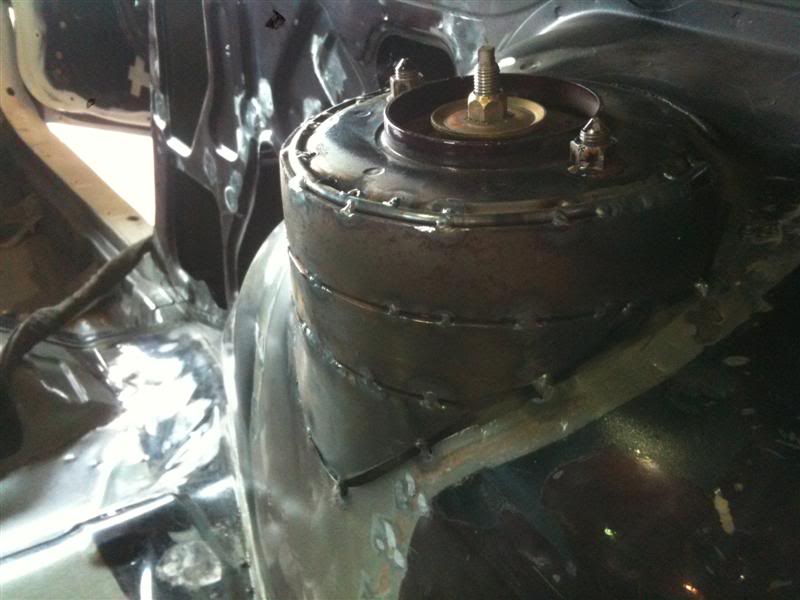

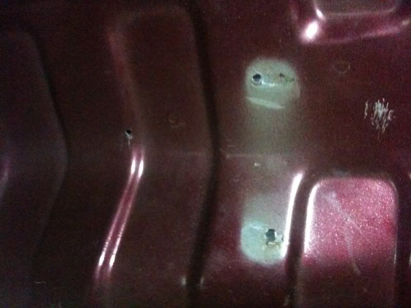

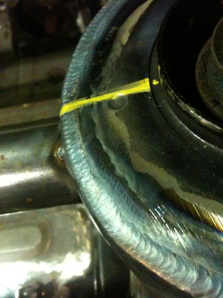

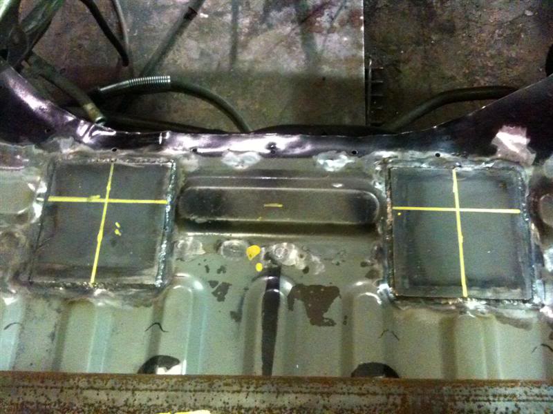

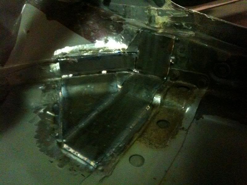

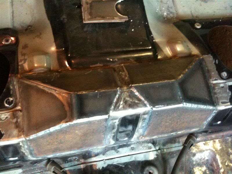

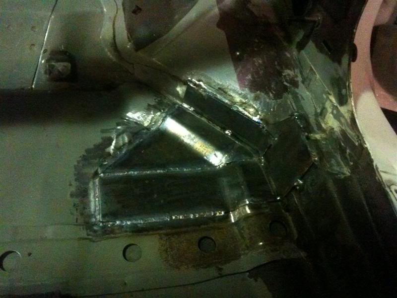

Welded all the holes inside except 4 for my Takata haress ;)

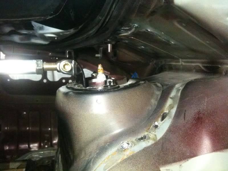

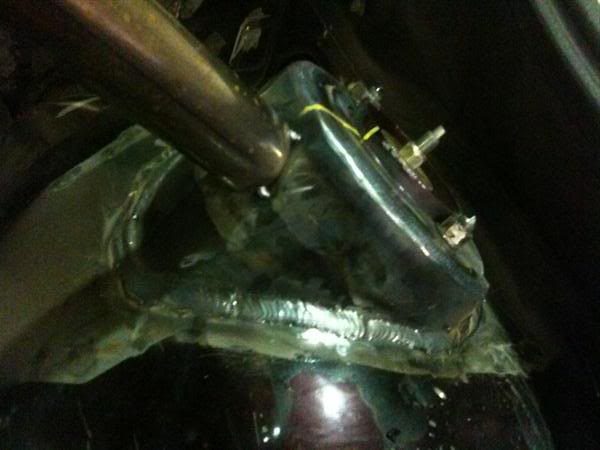

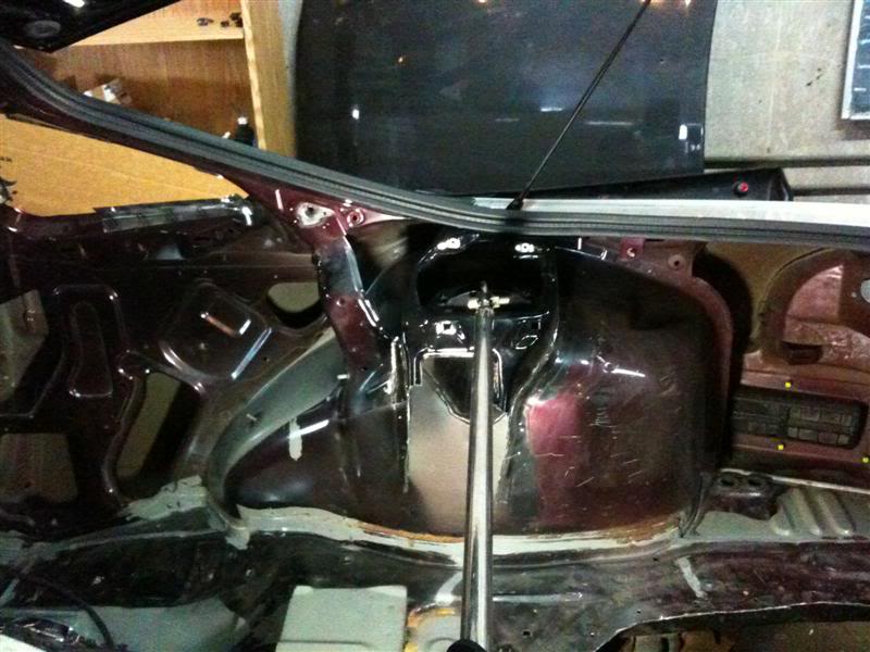

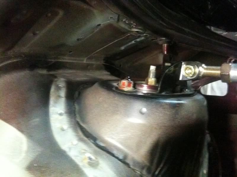

Now the tower, ready for war I can tell you ! :)
Looking good brother!!
Thanks man :D

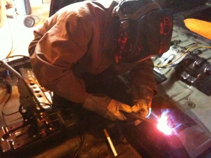

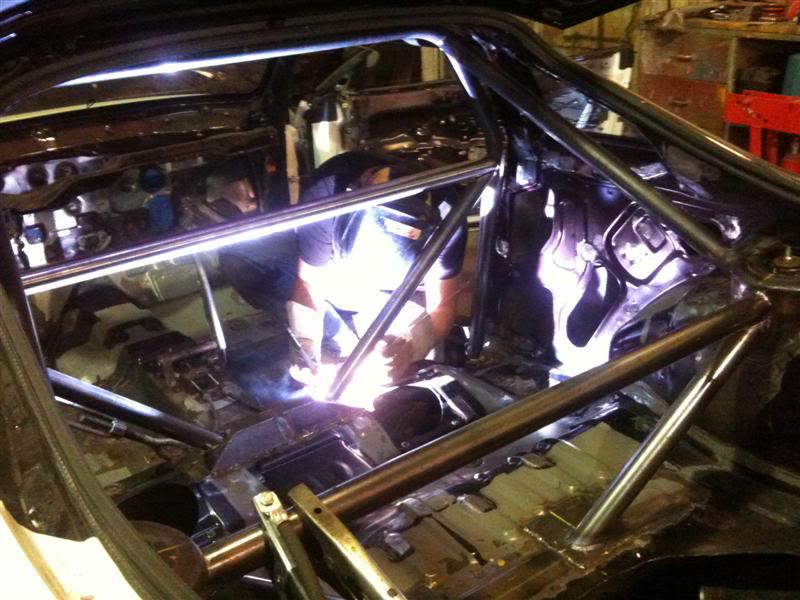

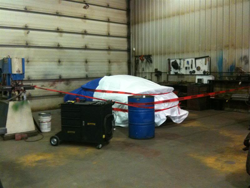

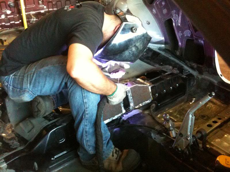

Well my friend is always working on other jobs, that's why we can't go faster ... No other jobs = no money = no shop = no place to build a cage in my car ...

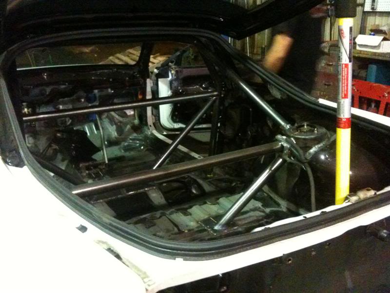

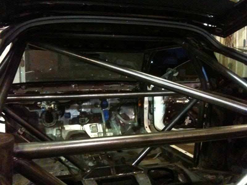

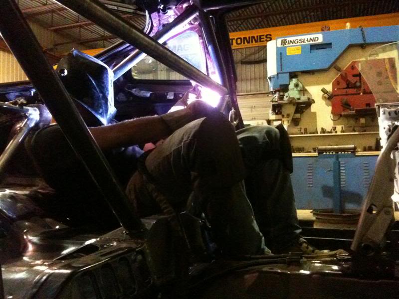

At least yesterday he told me that we need to be done by the end of the weekend since he needs the space. That was good news for me ! Here's what we did yesterday :D

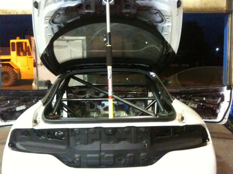

Sorry again for the crappy pictures, I'll post better one once we are done.

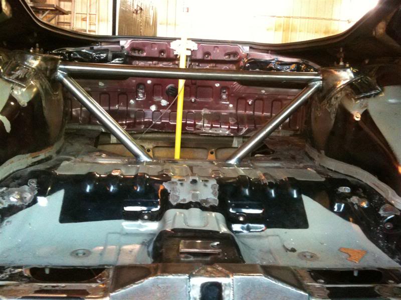

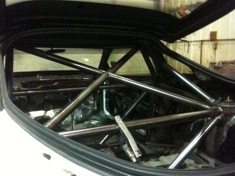

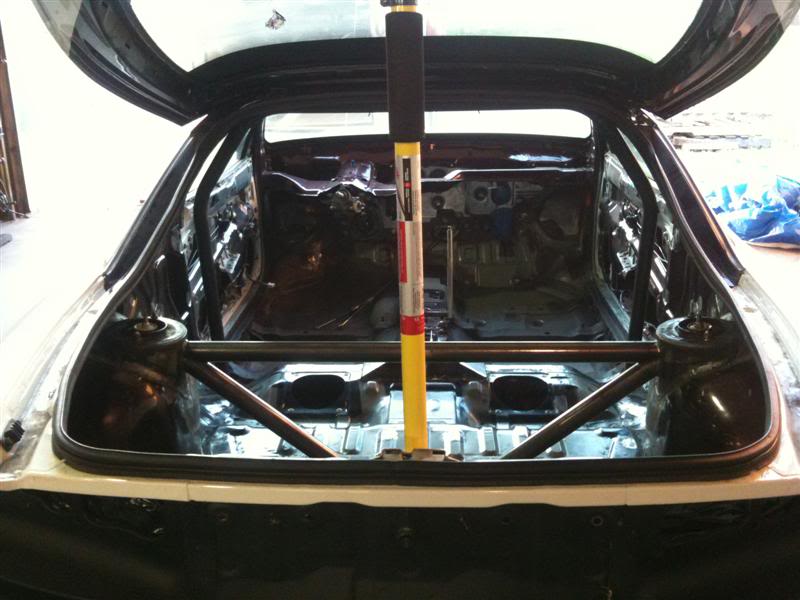

Rear X FTW !!! :D
