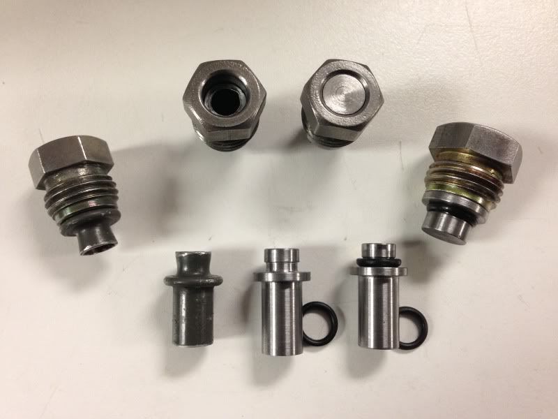

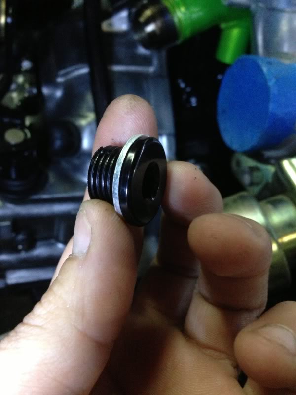

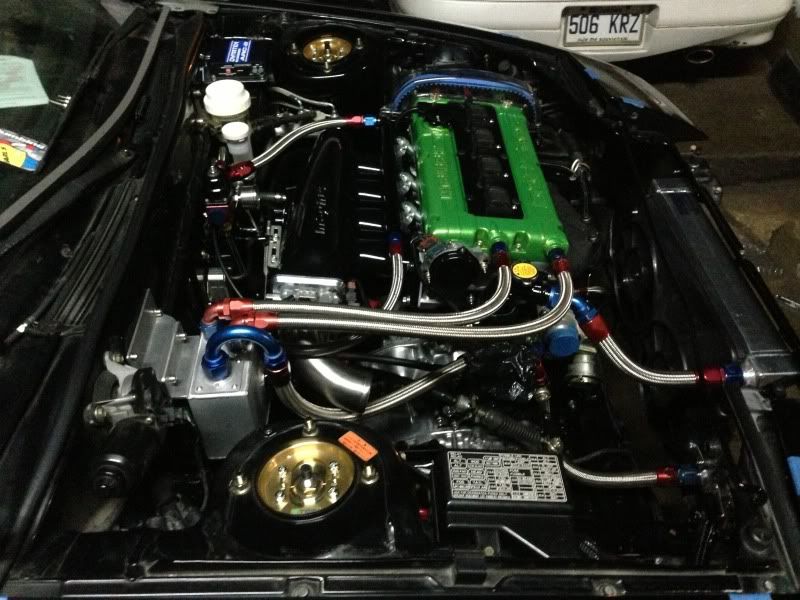

M16 x 1.5 to block the turbo water return

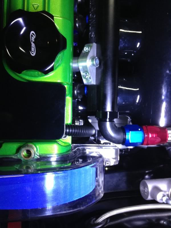

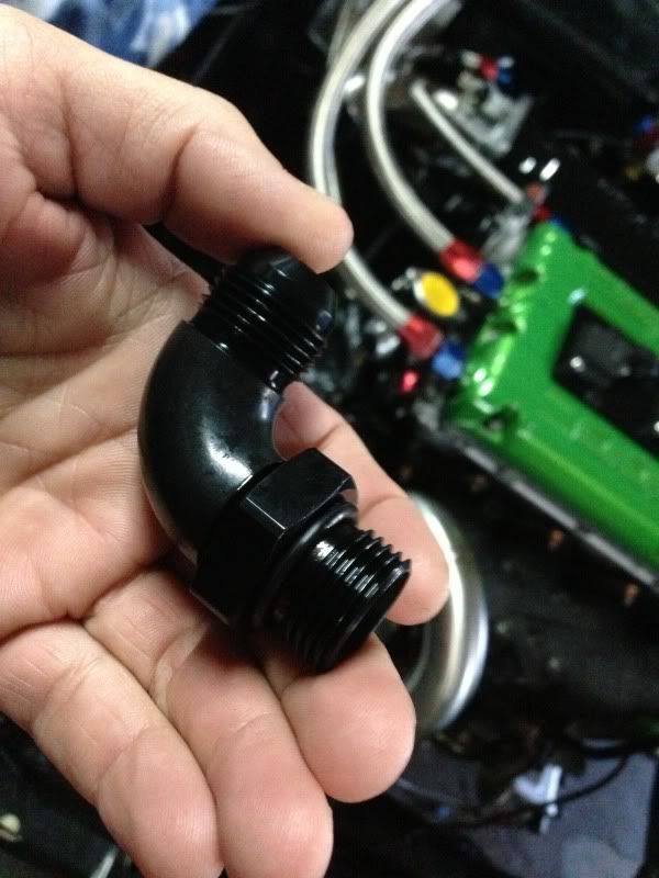

Special SpeedFlow -10AN to -10ORB tube adapter, yes it's me again showing you how to keep your timing cover without hurting your fuel flow. Would have like to see this since it took almost 1 mounth to get the adapter ...

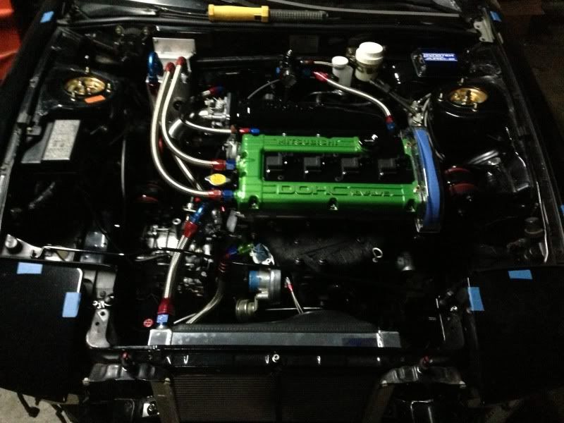

Crappy pics but it's all I have, the upper radiator hose has been changed already. Well I just flipped it around so the 45* is now on the radiator. That gave me clearance I needed to run the 4" FP intake pipe ... You'll see in my next update.
Stay tuned !
Nice, that fitting works perfect! Almost worth buying that Magnus rail just for that. I don't know if any other rails have the threaded return side like that.

That fuel rail isn't available anymore, that the old style one ... Now it's the 1 piece design they sell wich is also -10 o-ring boss at each end so this adapter would also work on the new design. I tryed everything, even a direct port fitting from Aeroquip and it still was too long. Using a straigh adapter with a 90* hose end was even worste ... After talking with Marco I decided to gave this one a try since a hard 90* will hurt the flow (like the low profile Earl fitting), those aren't hose end you want to use on a fuel system ... Now with this tube it's perfect.
If you find an other setup with -10 hose for the return using aftermarket fuel rail with the timing cover on that aren't using sharp 90* adapter please show me because the one I've seen where hacked ...

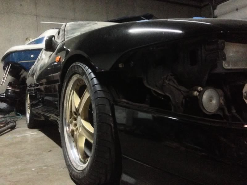

That was one clean 1g, very clean setup. Why'd you do that to the front bumper?
Done the home depot lip for fun. You don't really see it but the bumper needed a paint job and I didn't wanted to do it. I've run the home depot lip for one summer, it was fun to drive and wasn't looking that bad I think ... Anyway now it's gone.
Now I'll be running a splitter. Why ? Because it's my car and I like splitter, simple as that. :p

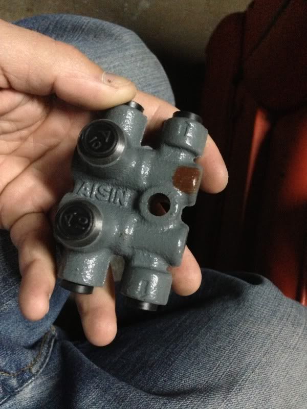

Had probleme with the brake system, now it works fine ... It was a bad prop valve ... So here we go :)

Got my new OEM proportional valve ...

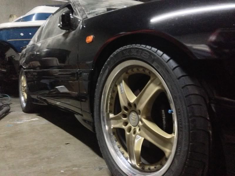

Here how the car sits, Tein at the lowest setting. Still running the 2 lock nut on the coil ...

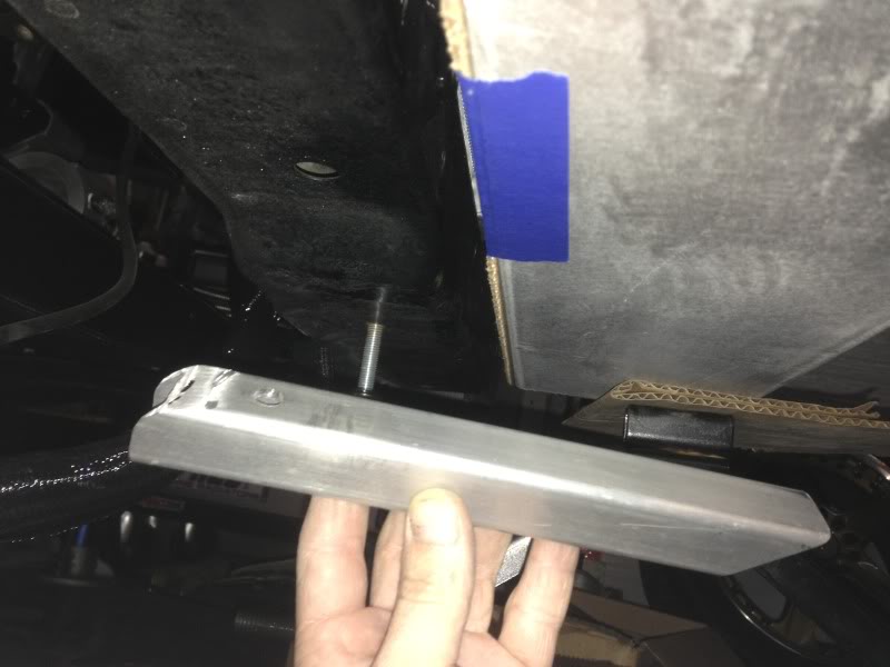

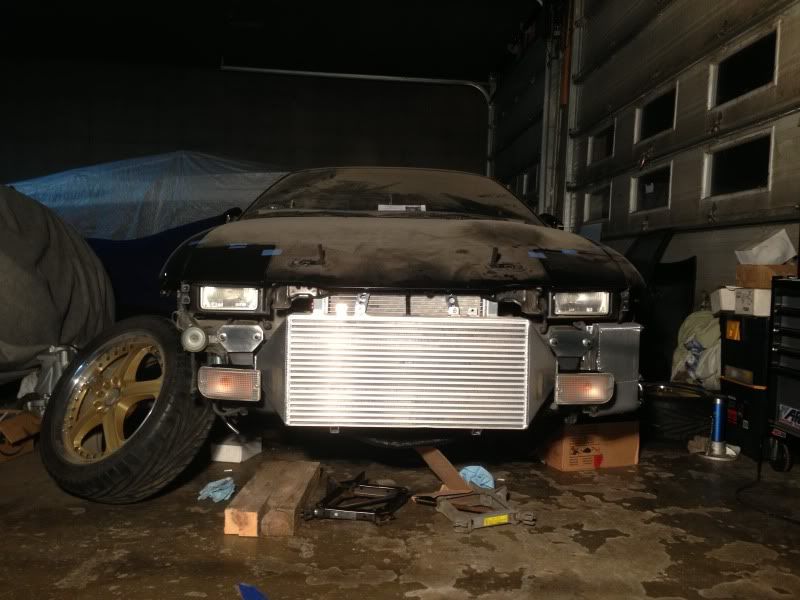

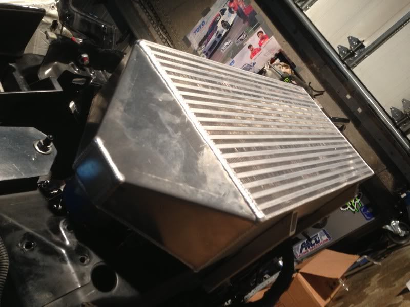

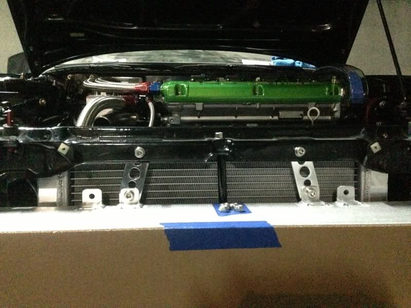

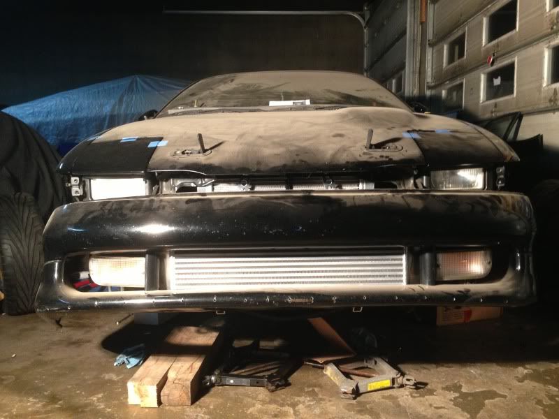

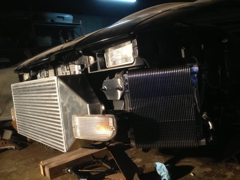

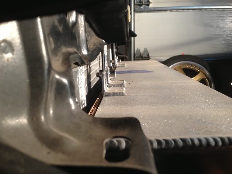

Brackets to hold the core ... Still need to weld something under to hold it ... Damn running out of idea on that one, I'll try to add support like the JMF one. Will see ...

New non-abs proportionnal valve painted and installed. Finally got my damn brakes all bleed up without any leak. For the clutch it was a joke for the first time of my life, took 5 minutes pumping after adjusting the rod. Will see how it does when the engine will run ... ;)

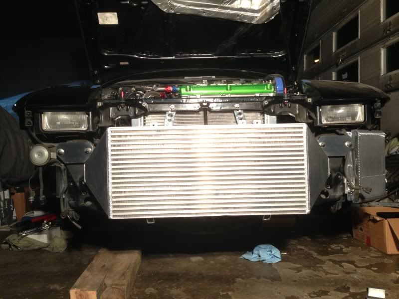

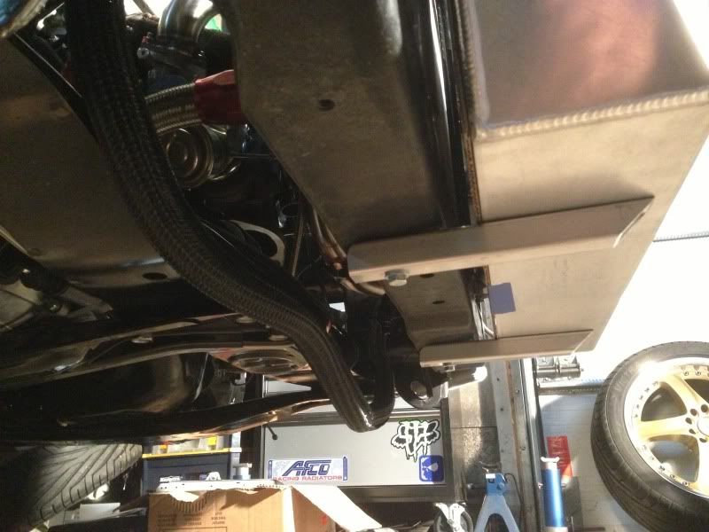

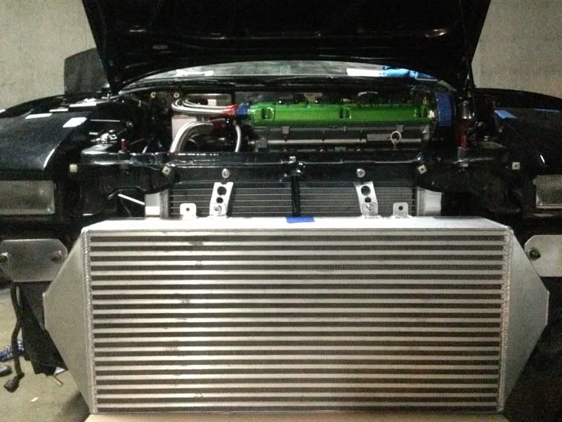

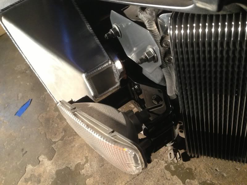

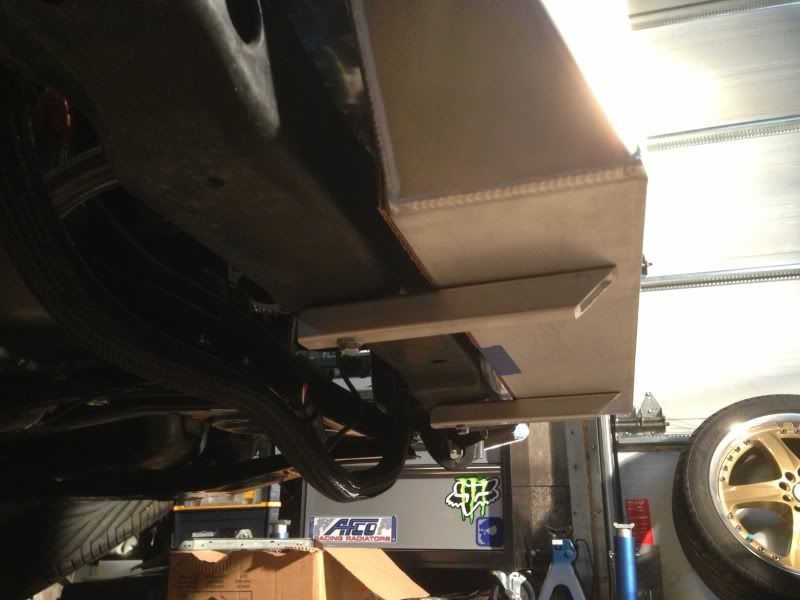

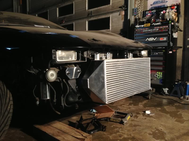

The new lower intercooler bracket are done and holding strong, 2 pipe 1" square bolted under the rad support. Long enough so they kind of pry and make them stiff enough to hold the IC without any worry. I'll take pic this week after I get them welded, we'll weld them right on the car ...

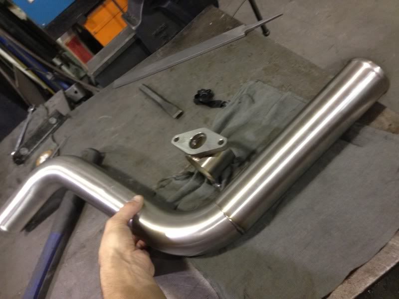

I'll try to be ready for the the rest, upper piping and the bung for the AIT. From what I've seen it should be close to the BOV ? Also my downpipe that needs to rotate maybe 5* at the flange and weld a bung for the wideband.

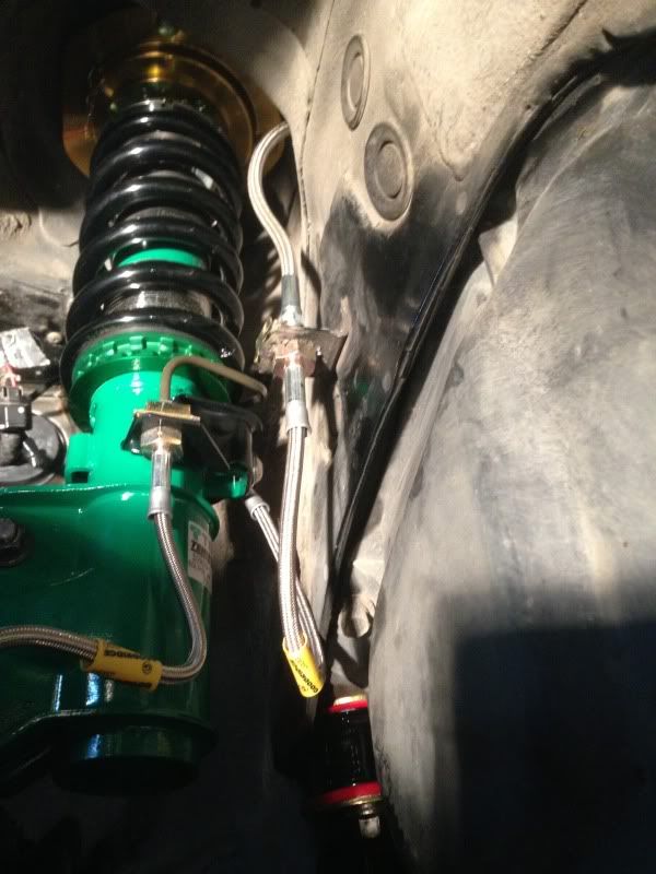

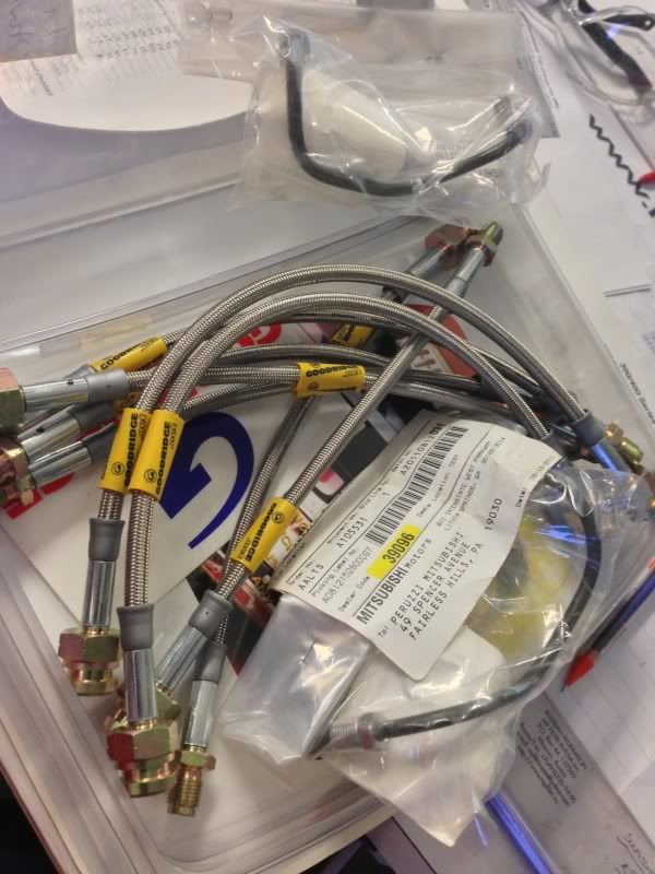

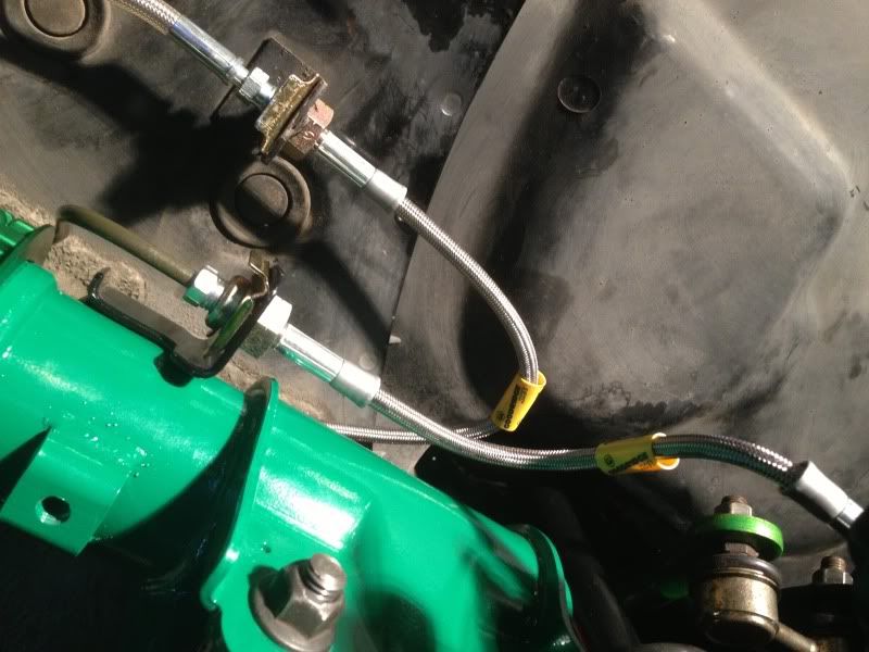

Here's what I did for the car yesterday, also got my new brake lines. :D
It works ! :D
It's not leaking or sweating so far so I'm really happy. The GoodRidge lines don't have a silicon coating so that makes them more flexible. Pics of the lines are bad sorry, I'll take other one.

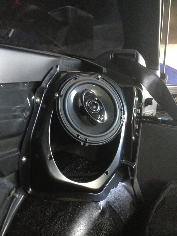

Here are the speakers I had in my 2gen, decided to install them in the 1gen since the 2g isn't running a radio ;)
Fresh front GoodRidge brake lines, don't have pics of the back ...
