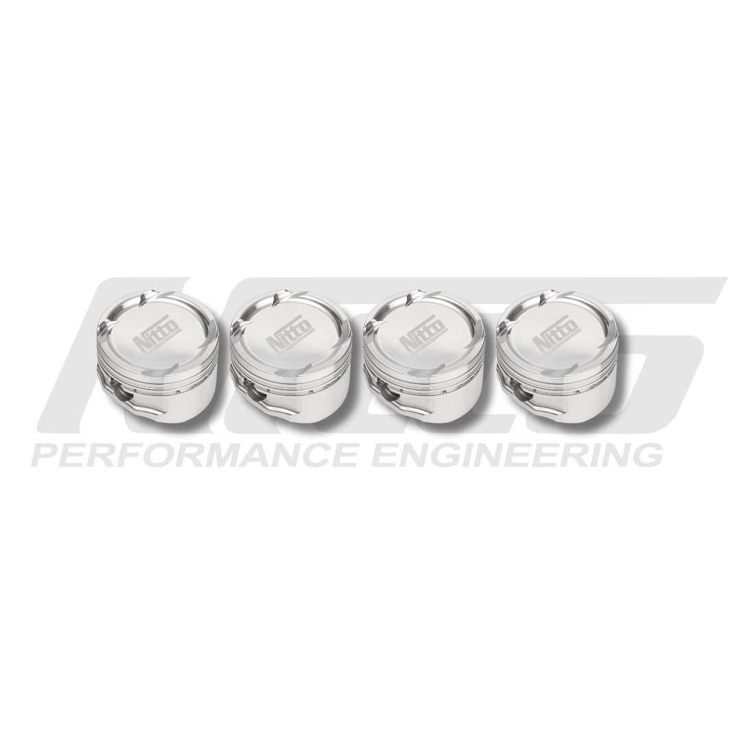

The other option I've come across is Nitto, they are manufactured by CP-Carillo but are meant to be a step above the normal off the shelf CP.
I believe the CP are all full skirt too, which I think will be a good thing. My existing JE pistons are full skirt, and haven't worn over about 15 years of racing. A friend with wiseco stroker pistons has had them crack around the pin several times. Not to the point of failing but meant they couldn't be reused. I believe they have a new design since those cracks though.
These are the nitto, they are about $300 USD more expensive than the CP though!
