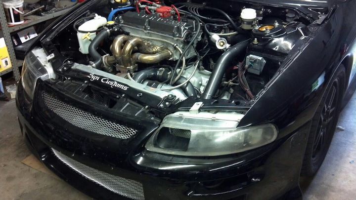

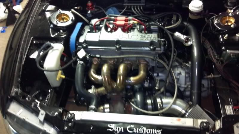

Glowryder: I meant to write 57mm tb but i missed a key. I like the egr for the mpg as this car is still a daily griver my girl uses to get to and from school. I am only running 6 psi through it and the turbo actually spools perfectly in time for the cams to start making alot of power. I guess my impression of fast is tainted because i play with so many fast cars but as a non turbo edz it was able to take on a fox body mustang but not much faster than that. Now that its running 6psi I managed to pretty badly beat a sc ford lightning yesterday from a stop. the cams are crower stage 3 with 272 (what the ad said when i bought them used) i do remember them saying crower. here is a pic of one compared to stock cam
Facebook
i used a stock oil pan cut and modded with homemade windage tray and removed balancer and re arranged the coil and injector wires also ground the pegs off the magnet and rotated it 90 degrees. dual oil filters came along because i wanted more oil capacity. I also have a condensor sized oil cooler in front of the radiator now. total of 6.5 qt oil capacity. all im gonna do from here out to that car is put 440cc injectors in it and raise the boost to 8psi. after that no more mods its fast enough for my 22 year old gf! my supra is the next toy im gonna make fast.

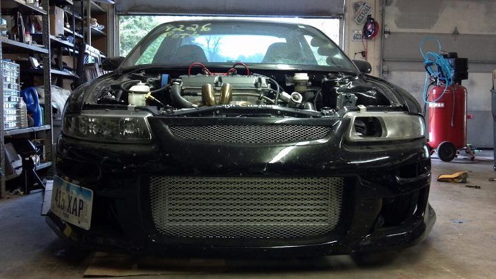

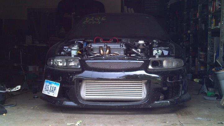

new pix of the edz swap are uploaded now. only 2 though because this site is a pain in the azz
?? You cant do this to a 420a.. its a full swap. : )
Trans and Head are bout the only stuff you can slavage from the 420a to swap in a 2.4

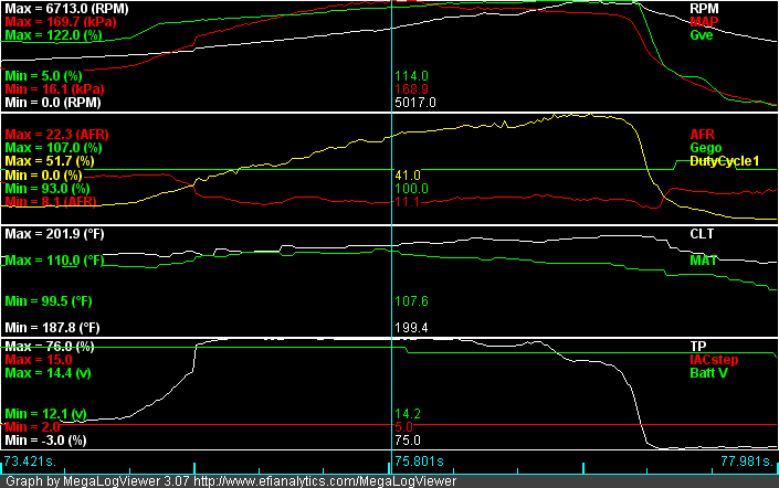

9psi tuned pretty well
Notice the TP.. only 75% :) still needs a little work , and it pulls like a raped ape. I know, i know 9 psi, but i only have 91 octane, so untill i get 93, i wont be pushing it..
i can switch some of the tables and get a snap shot , ill try to post it tonight.Eric didnt push the envelope, but they are set to a little agressive/ what has worked in the past with this cam profile.
