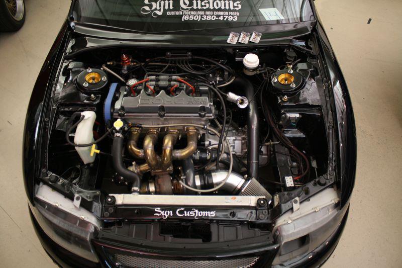

Built and boosted 2.4 Swap Avenger

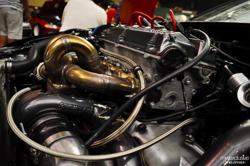

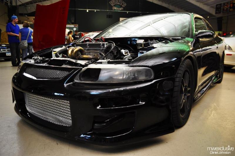

just finished a rebuild on my edz using the stock srt4 pistons and rods with clevite bearings and a .025 reground crank. seems a little more fuel hungry under boost with the lower compression but overall I think its gonna be a real dependable setup and i would rec. this setup to anybody for a budget build :)
Budget swaps are for Honduhs : p. Yea the 8.0 CR your running now will be More fuel hungry b.c its mking the motor work more, your loosing turbo Efficency , but thats a "production" car for ya. Ouch on the crank Journals, I wouldnt push more then 300 ish with that.. What are the Tollerances you used for the Clevites? Did you use the HX, H or P series? That will also limit you depending on what you used and Toleranced. I guess i shouldnt say Limit, more of , define Freqency between rebuilds : )

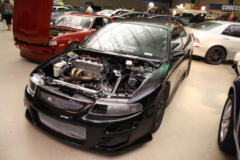

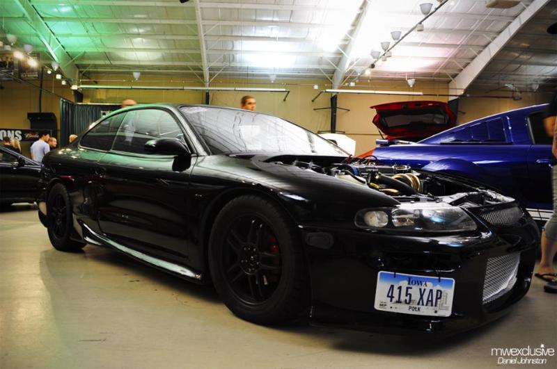

Got her ready for her first show. Took 2nd in best Domestic.
yeah yeah yeah not the super cool xxxxx$ build glowryder is able to pull off but its a great running beast. mains are at .002x rods are at .0015 ptw was .030 give or take a lil. ring gap was .020 top and bottom. I dont care if anybody else would have done this build different it is only ever gonna see 12psi on 440cc injectors. its on a stock 2.0 n/a ecu and doesnt even throw a code unless it sits at its lopey idle too long (p0300) so I must have done something right.

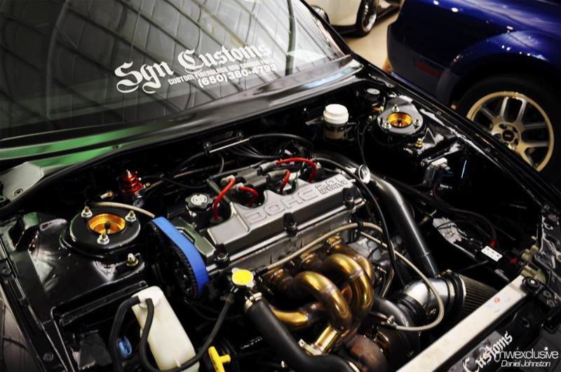

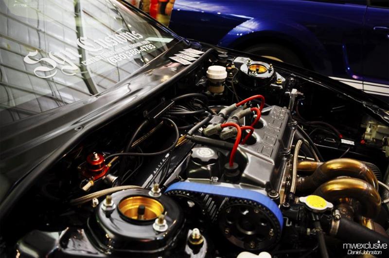

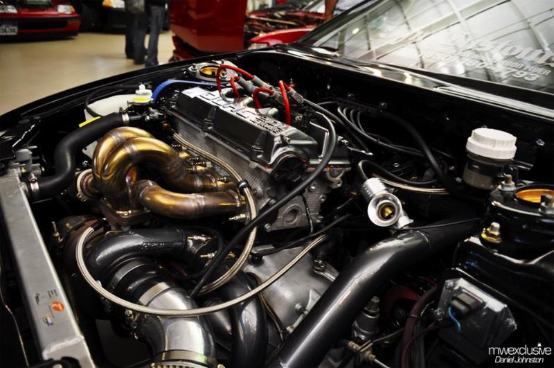

very nice build glowryder, that intake is looking good sir..... cobo chil with talking about your car in this thread as its glowryders build thread..... and your turbo is not a "92mm" turbo sir... that would be just dumb on a 4 cylinder. if u want to know how big your gt45 clone is (im guessing 74mm) take the compressor cover off and measure the inducer diameter with a vernier caliper. whatever your reading is, is what size your turbo is and should be called by.

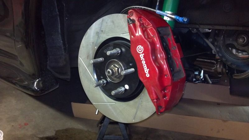

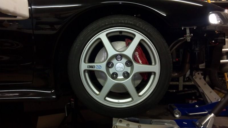

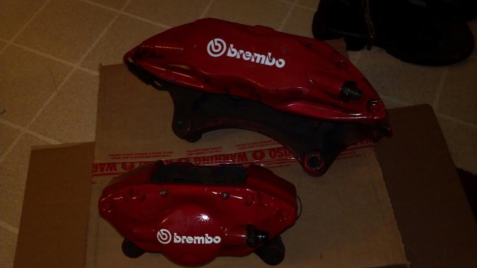

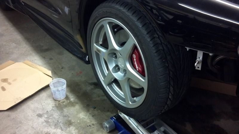

Nice calipers! I decided to go ahead and put mine on. You plan on getting a 3G master cylinder? Got mine (MC & BB) on fleabay for cheap.

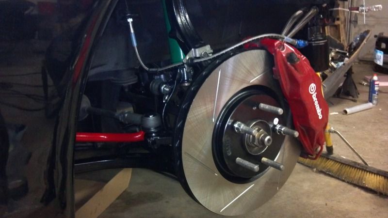

Theres a few in my build log. Im actually making a kit so that others can do this as well.
Not yest, they are still in prototype. Im getting the dwg done, test fit on an eclipse ( you may have to delete your corner marker, not sure if people will be down for that..this is the hang up so far.. we havent found a good and cosmetically pleasing work around other then deleting the side marker. ) then hit the open market. hopefully in spring.
