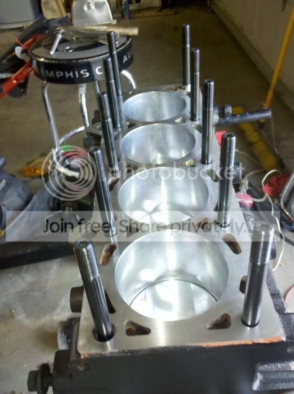

Engine:

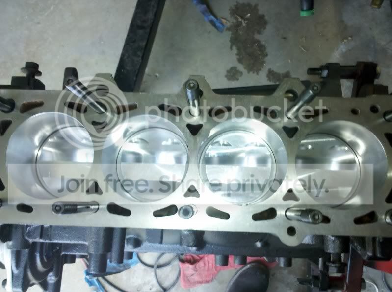

2.4 EDZ block Forged Veniola Pistons, and Rods with total seal conventional Rings with a CR of ~ 9.0:1
The short block assembly is balanced, main and rod bearings are clevites.
SRT4 timing tensioner, with 10 mm bolt mod, SRT 4 oil pump and SRT water Pump
The oil pan is a steel pan fabricated from scratch . The oil filter is setup for a remote filter bracket and line set. the Oil pan has -8 AN fittings for pump outlet and inlet. I plan n mounting the remote oil filter on the pass frame rail.
AMM intake manifold with MP 60mm TB
Hahn 3" down pipe, ans 3" all the way to the rear with no cat

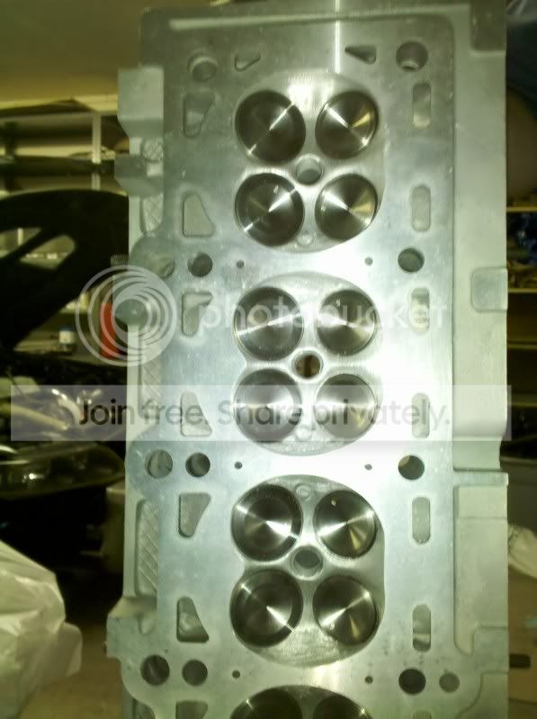

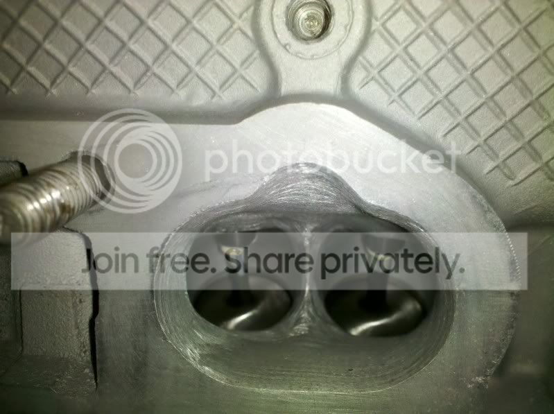

SBR stg 3 Head:
PnP
SS Valves
+1mm on the exhaust side
Crane Springs and retainers
Crower Stg 2 (6446-2) cams
Bronze valve guides
Crane Adj cam gears
PT lifters and 2.7 Rockers

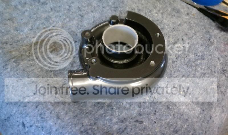

S20g with ceramic coating
Log Mani with ceramic coating

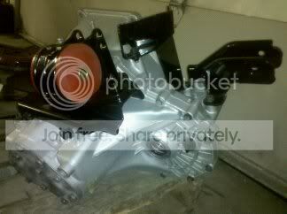

3.55 Neon trans
Quaife LSD
DSS stg 5 axles (off Hahns car)
Soutbend OFE clutch

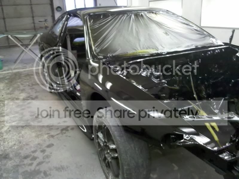

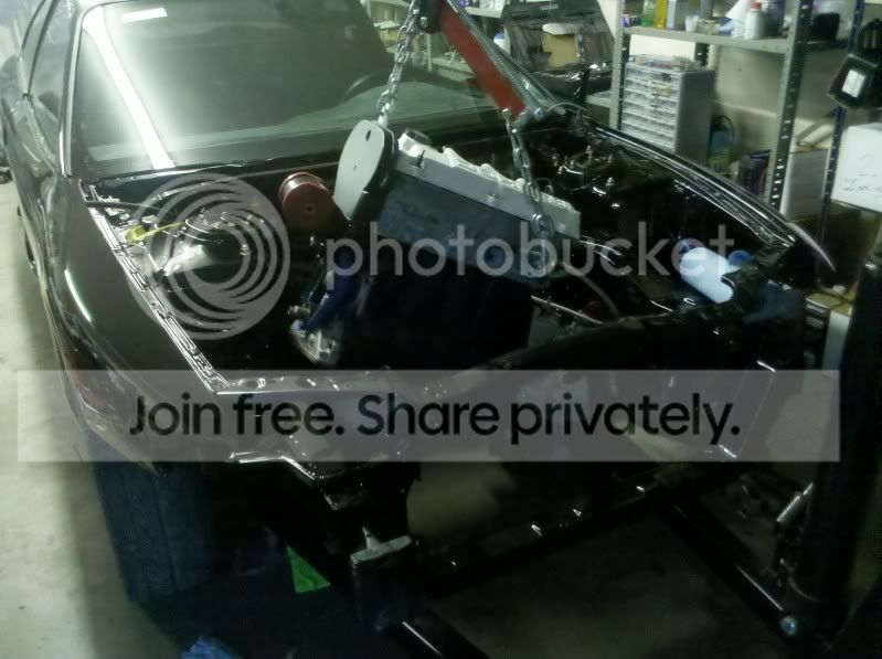

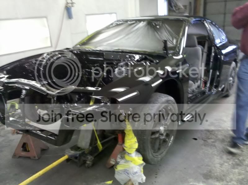

I Started by removing my built 2.0, getting the body ready for paint. Decided on a nice gloss black. Enjoy the pix: )

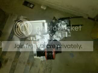

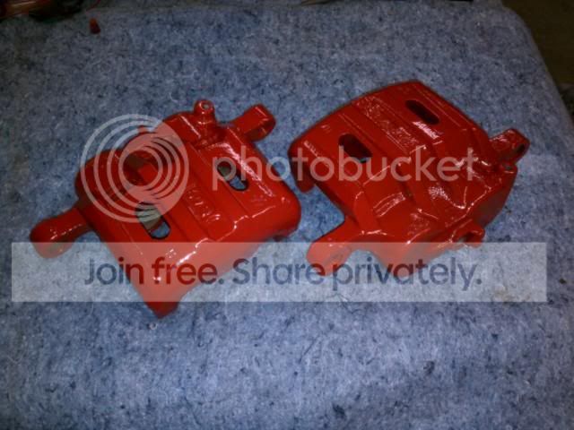

Trans PC'd stuff on
Other PC'd stuff

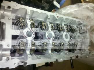

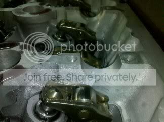

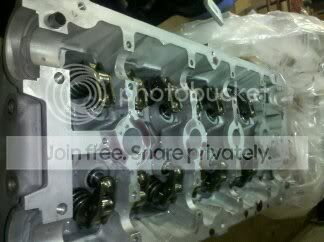

Head
Engine

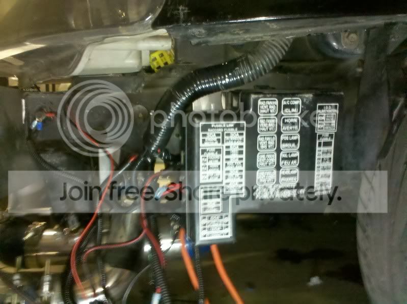

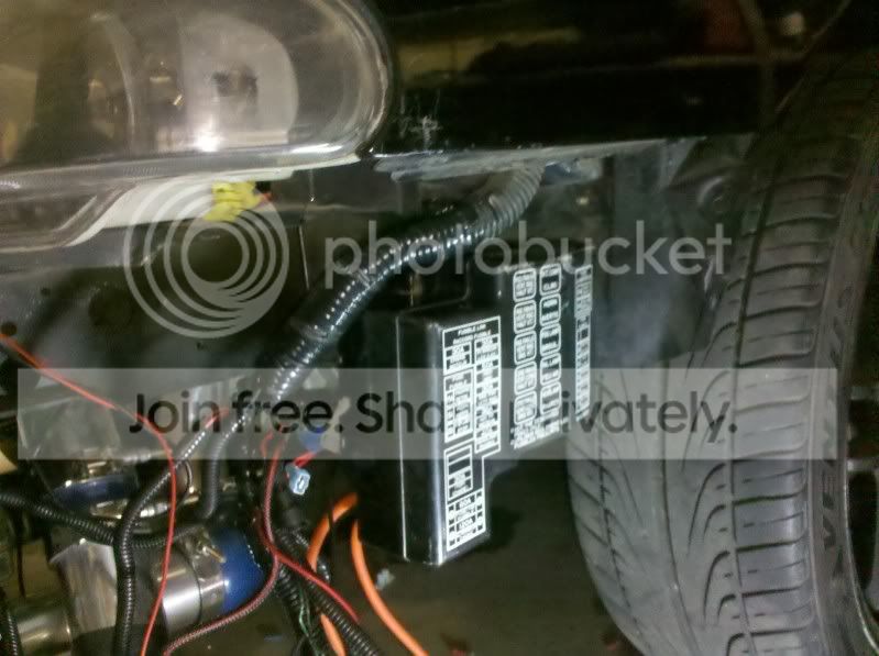

Wire tuck/ fuse box relocation

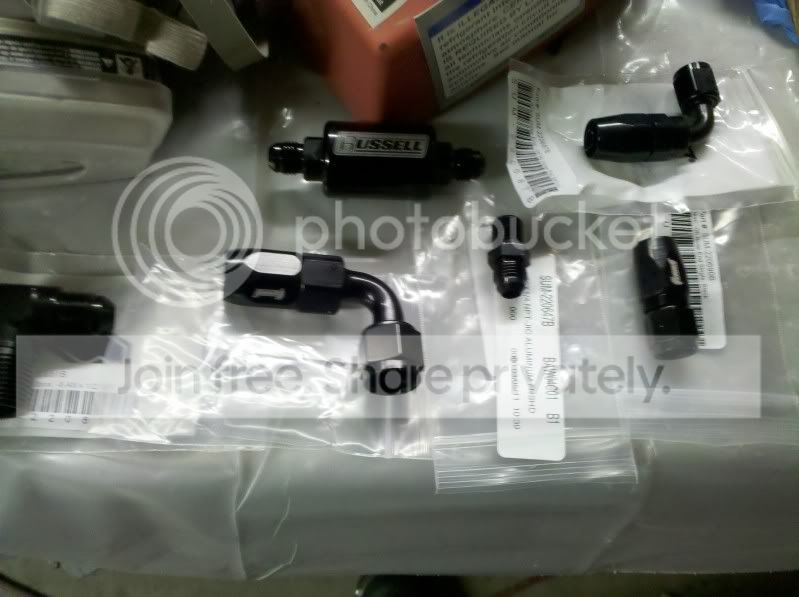

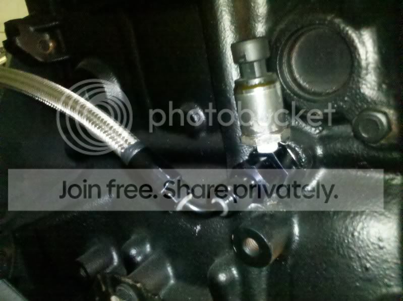

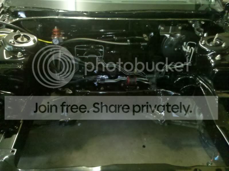

Turbo feed plumbuing.. mm love me some black AN fittings
Finished re0install firewall lines

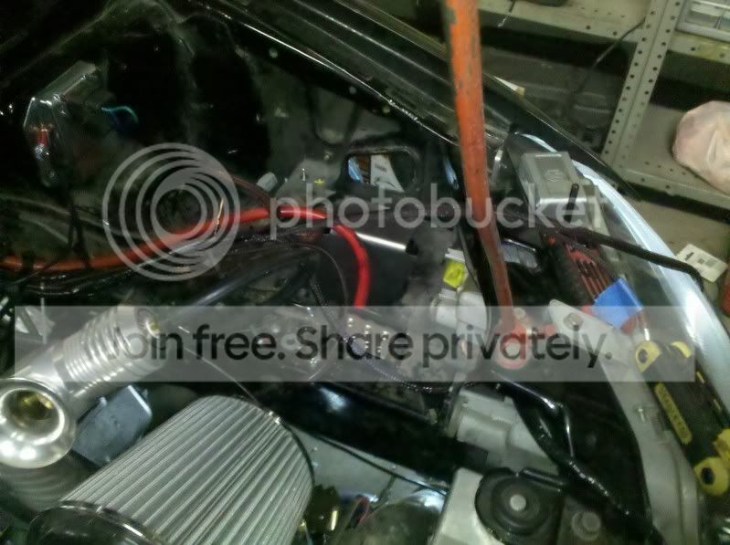

Dropping in
