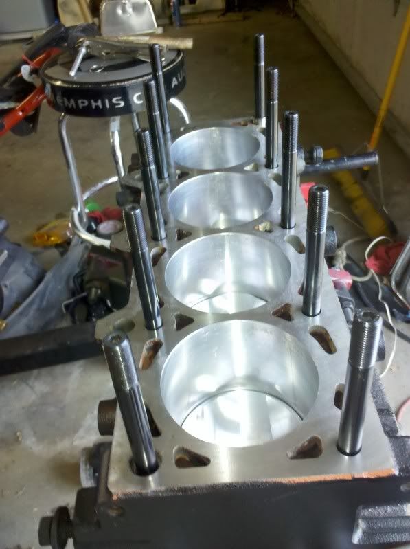

Forged Veniola Pistons, and Rods with total seal conventional Rings with a CR of ~ 9.0:1
The short block assembly is balanced, main and rod bearings are clevites (P series).

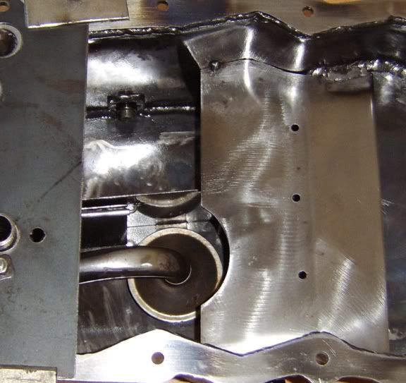

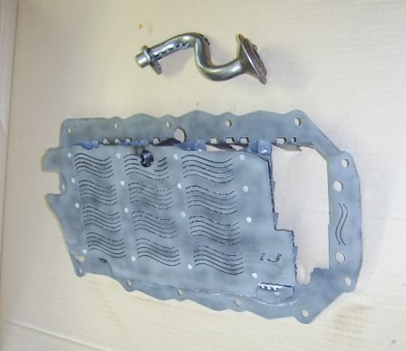

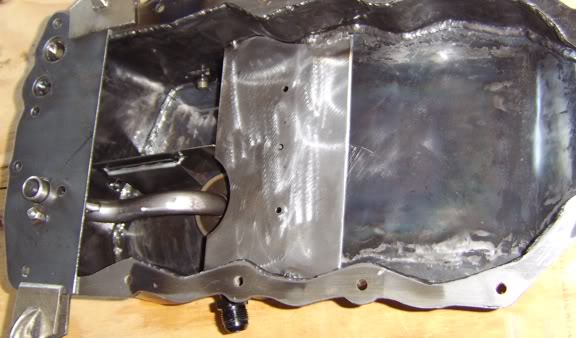

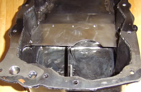

The oil pan is a steel pan fabricated from scratch (Terry)
The oil filter is setup for a remote filter bracket and line set. the Oil pan has -8 AN fittings for pump outlet and inlet. The remote oil filter on the pass frame rail.
IJ one off Scraper, baffles and windage tray

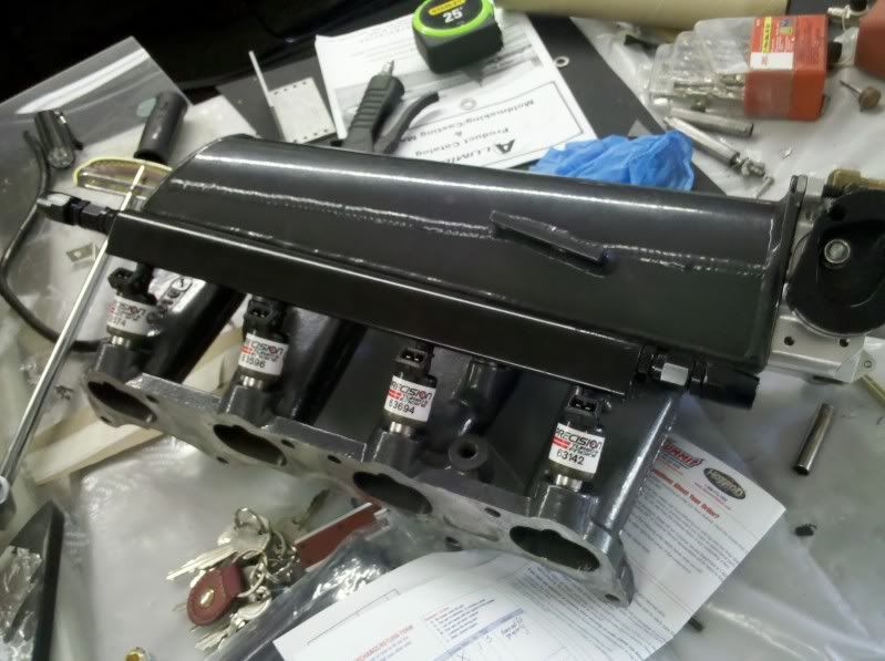

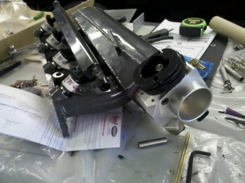

AMM intake manifold with MP 60mm TB

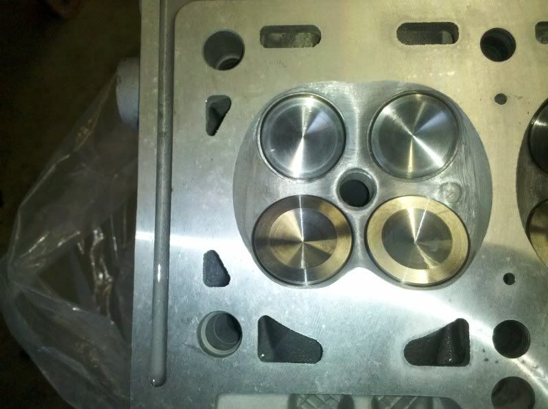

SBR stg 3 Head:
PnP
DCR oil restrictor
SS Valves
+1mm on the exhaust side
Crane Springs and Ti retainers
Crower Stg 2 (6446-2) cams
Bronze valve guides

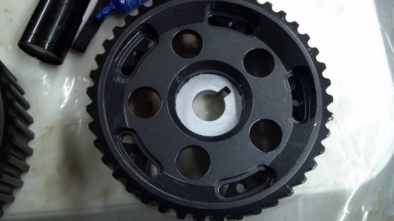

Unorthodox Adj cam gears

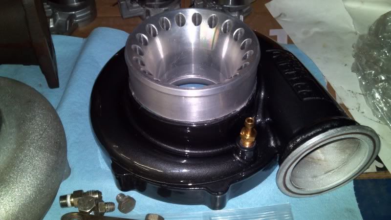

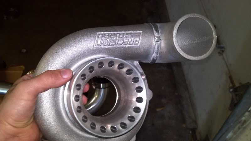

Turbo/Fuel/EMS:

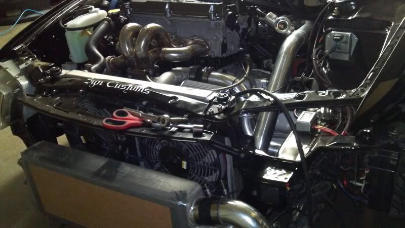

Billet PTE dual Ball Bearing 5857

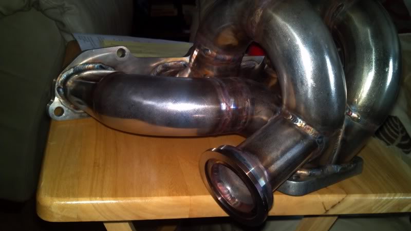

Equal length Tubular manifold

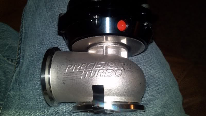

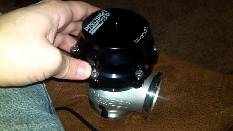

PTE 46mm Wastegate
Hahn FMIC
Turbo XS RFL
2.5” IC piping
PTE 1000cc Low Z injectors
MSnSE running as stand alone with sequential injection
Wally 255 High flow
6AN SS feed from pump to rail
STT aluminum fuel rail

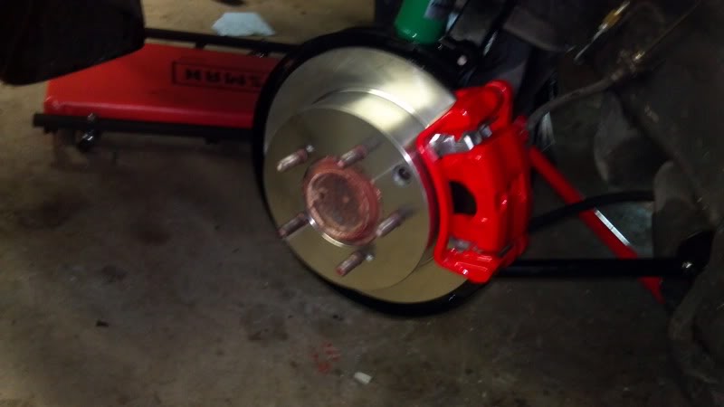

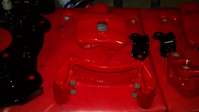

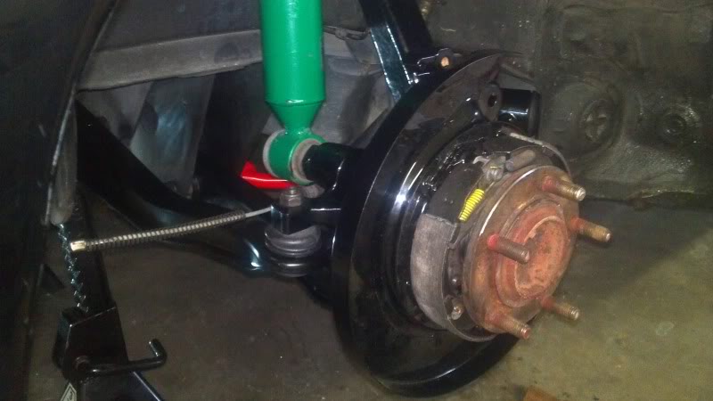

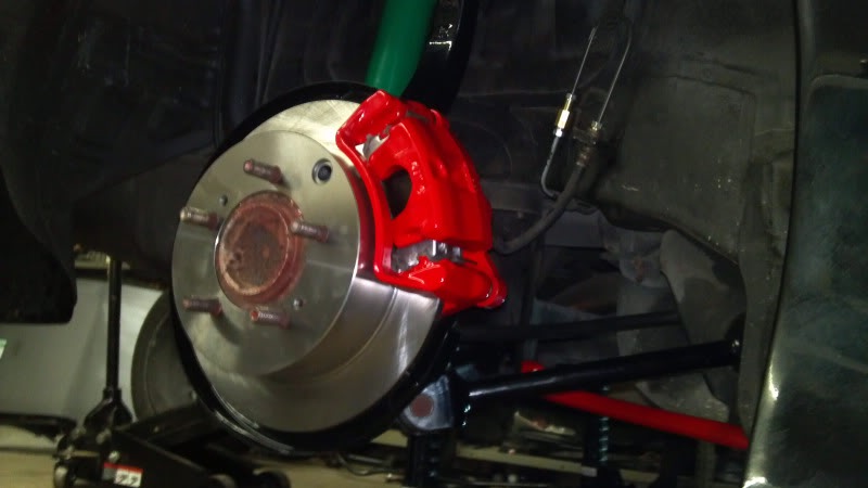

GSX front caliper conversion

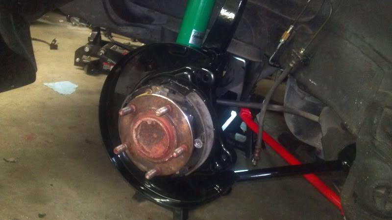

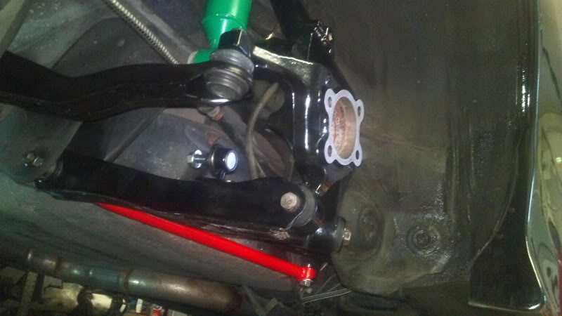

Rear Drum to disk Swap
rdsm sway bars

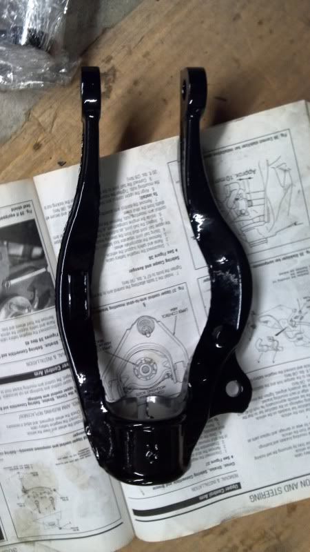

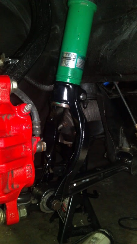

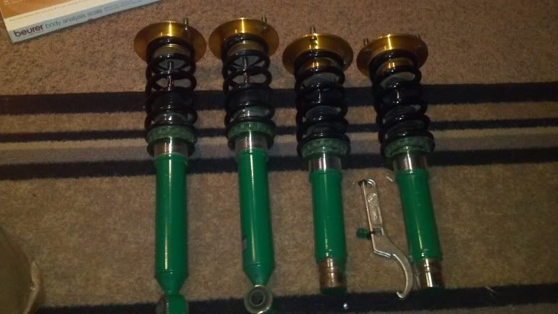

Tien SS coilovers with pillow ball mounts

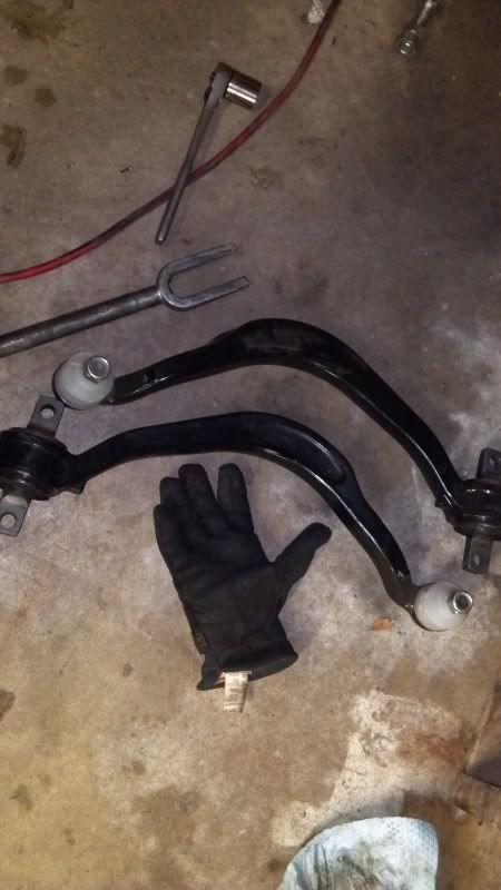

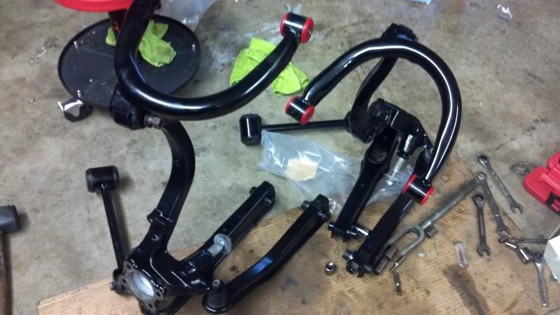

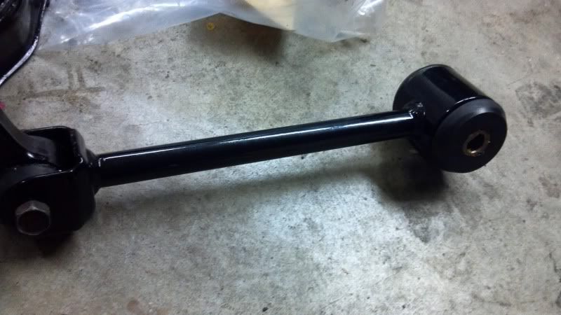

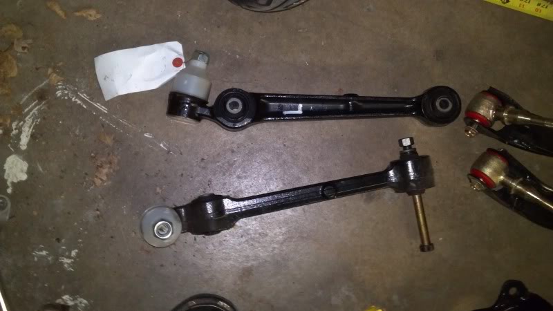

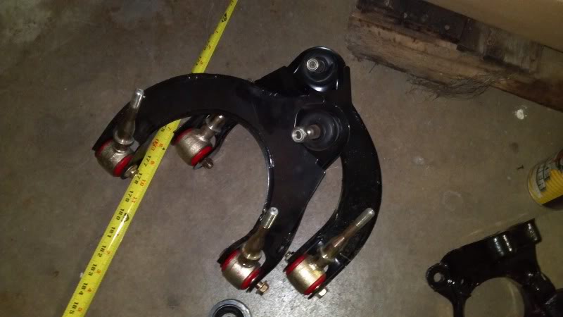

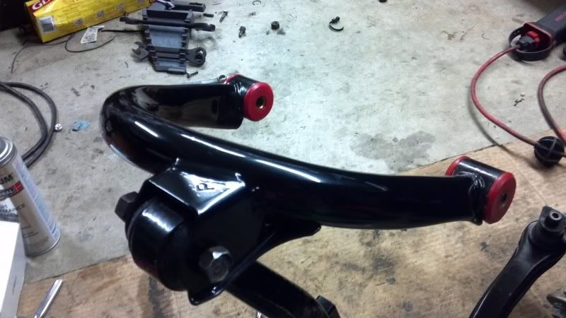

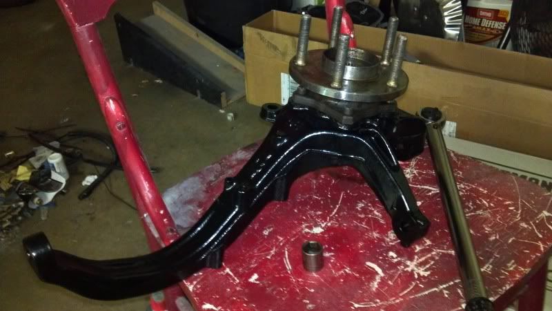

Polly bushings throughout the Arms and Knuckles

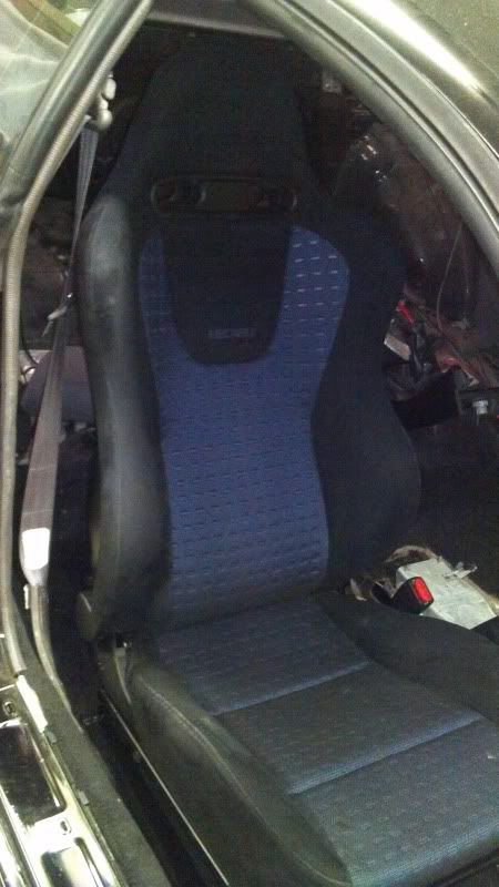

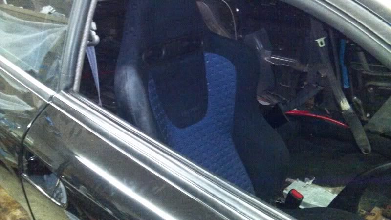

EVO 8 recaro's

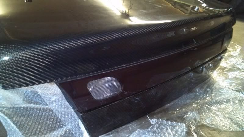

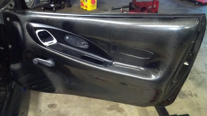

Top shop CF door panels

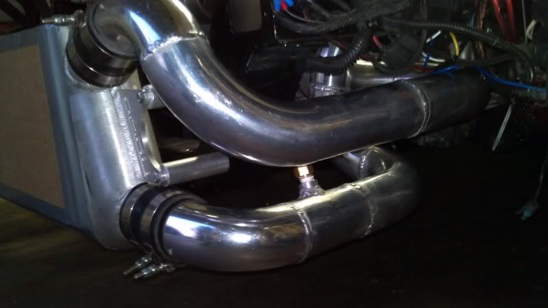

Delta: Its a Hahn Intercooler, designed for the 2gnt so we don't have to route piping on the pass side.
GSTRACER: The rear Tubes are from a 3G eclipse.

Im sorry to bother with dumb questions but can you please tell me what passenger side mount you used? thats all i need I have the rest of the swap in the bag.
custom..they dont make one, nor can you get it from any other car. Needs to be fabricated. Make sure ## level and have the right pitch.

Yea, there is no easier option : / srry sir..
And thx for the comments.. its ran for about 2 hrs then spun a rod bearing.. on 8 psi, it was crazy quick. I need a new crank bla bla. but i took it to a differn machine shop, and they are telling me the orginal machine shop did the tolerancing all wrong. so im trying to figure out how to go after shop 1 for at least some of the cost. At least this gives me a chance to put my ARP mains in : )
