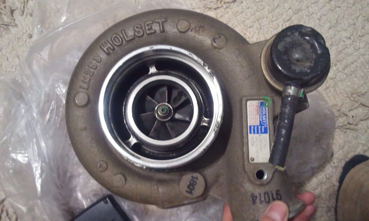

So far I've been working on it weekends and whenever I have the time. I got a good deal on a HX-35 on ebay.

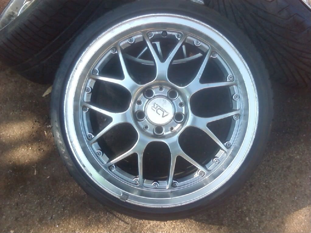

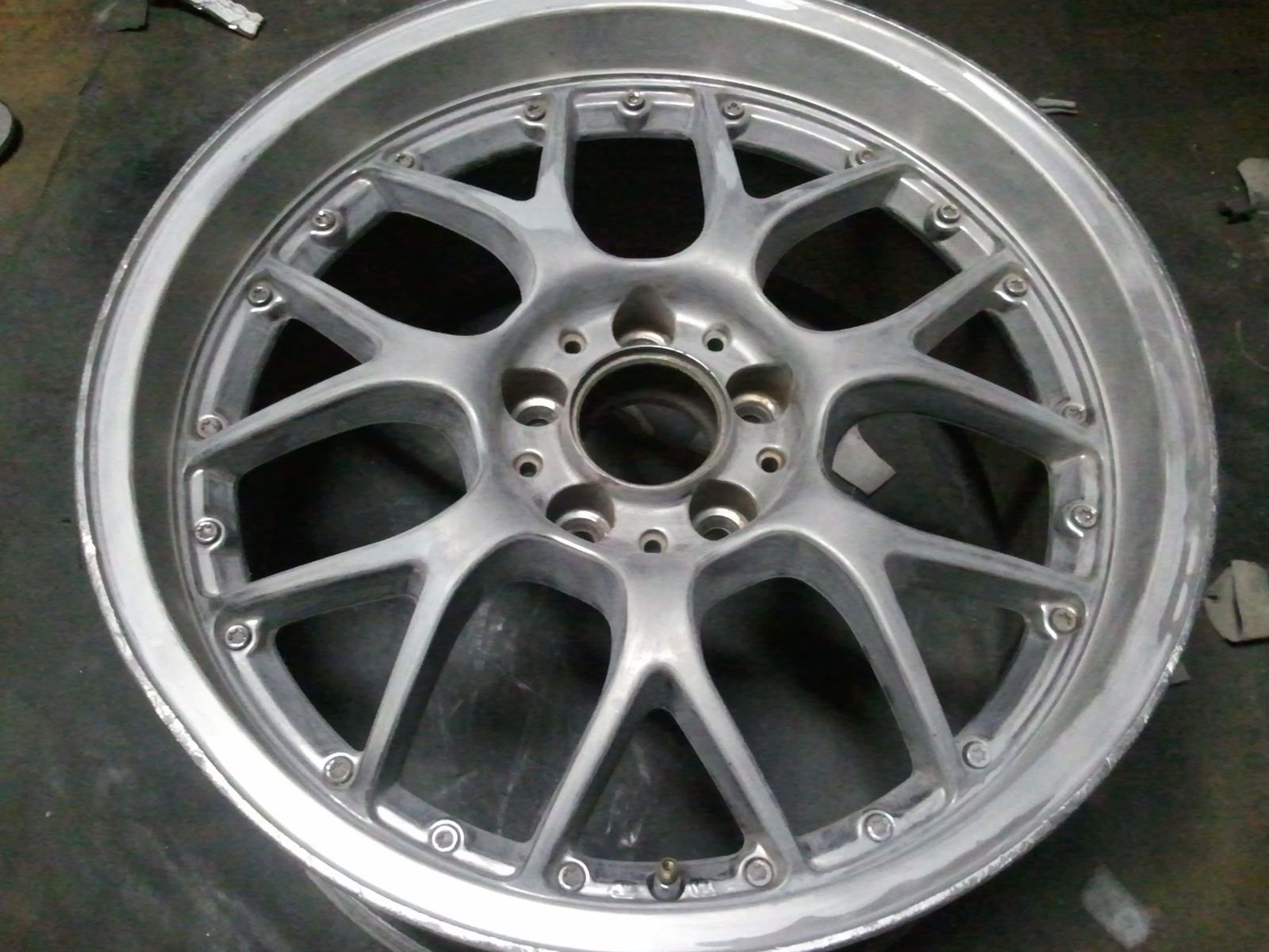

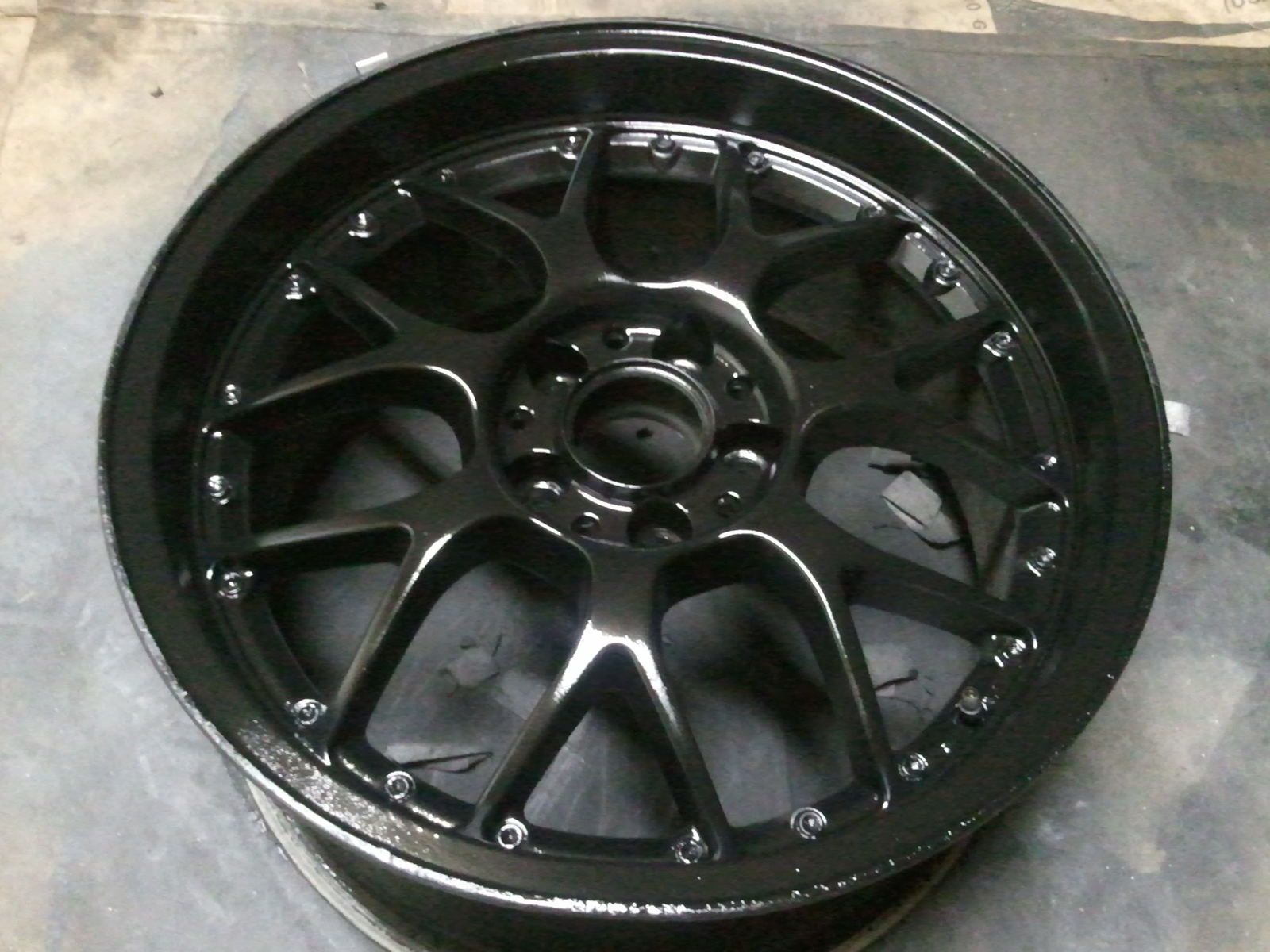

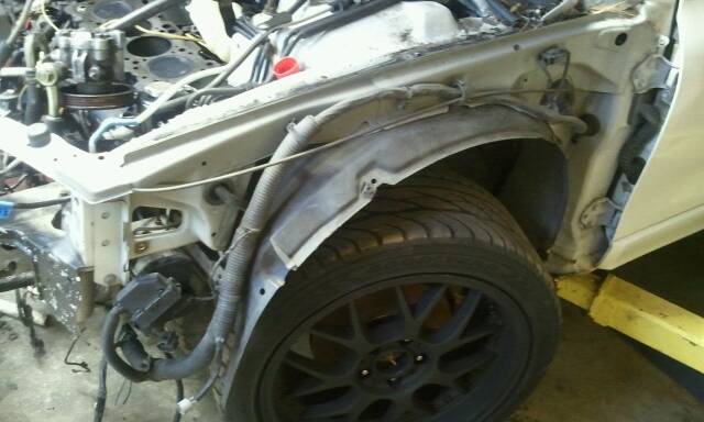

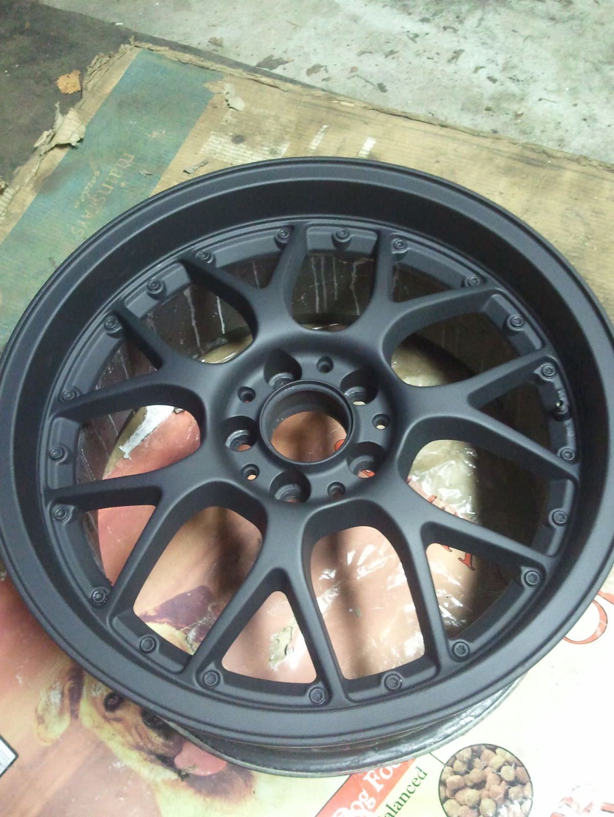

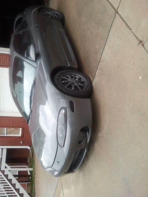

Some better wheels. The 19x7.5 wasn't my cup of tea, so I went with 18x8.5's.

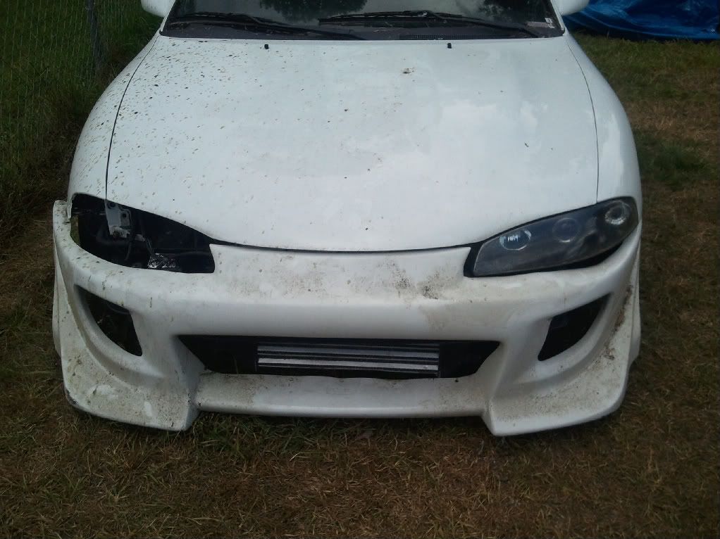

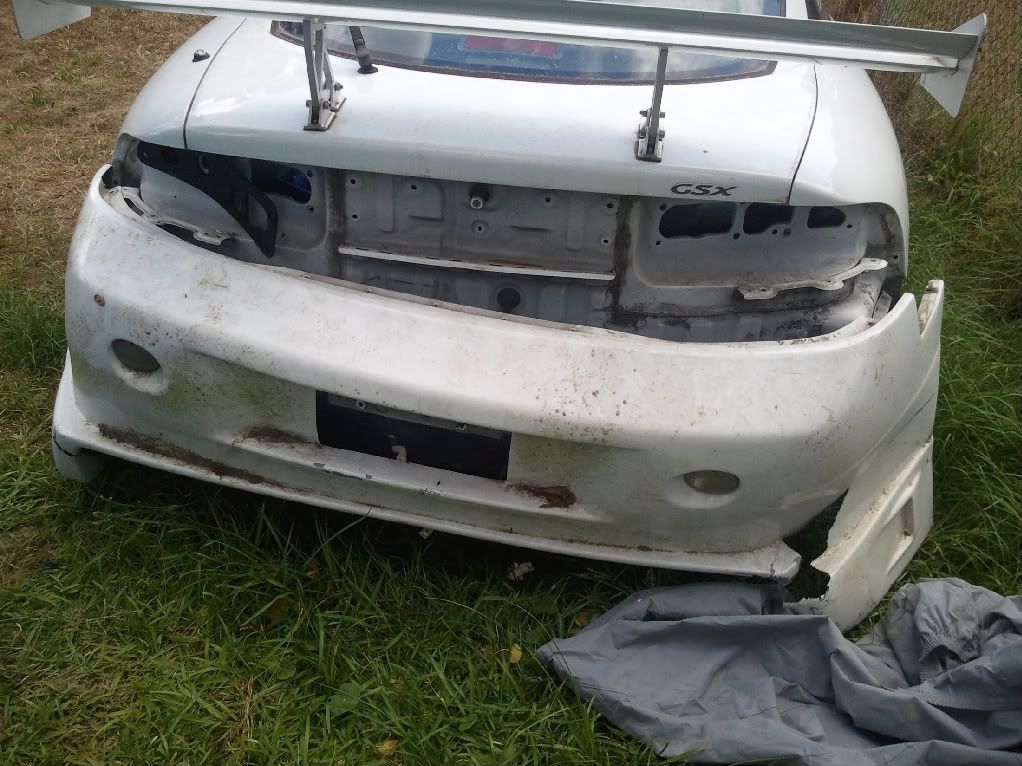

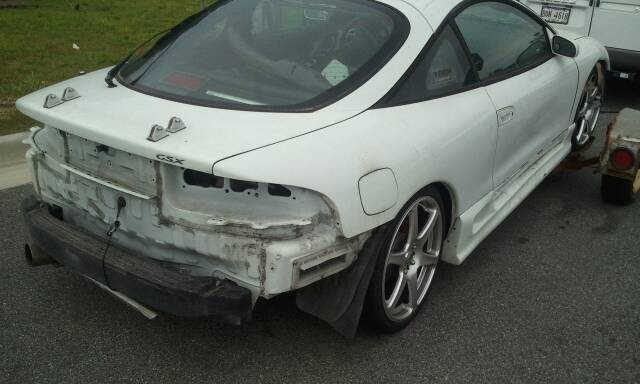

I found a girl parting out her spyder. 1.5 hour drive one way and I finally I can get rid of that horrid body kit.

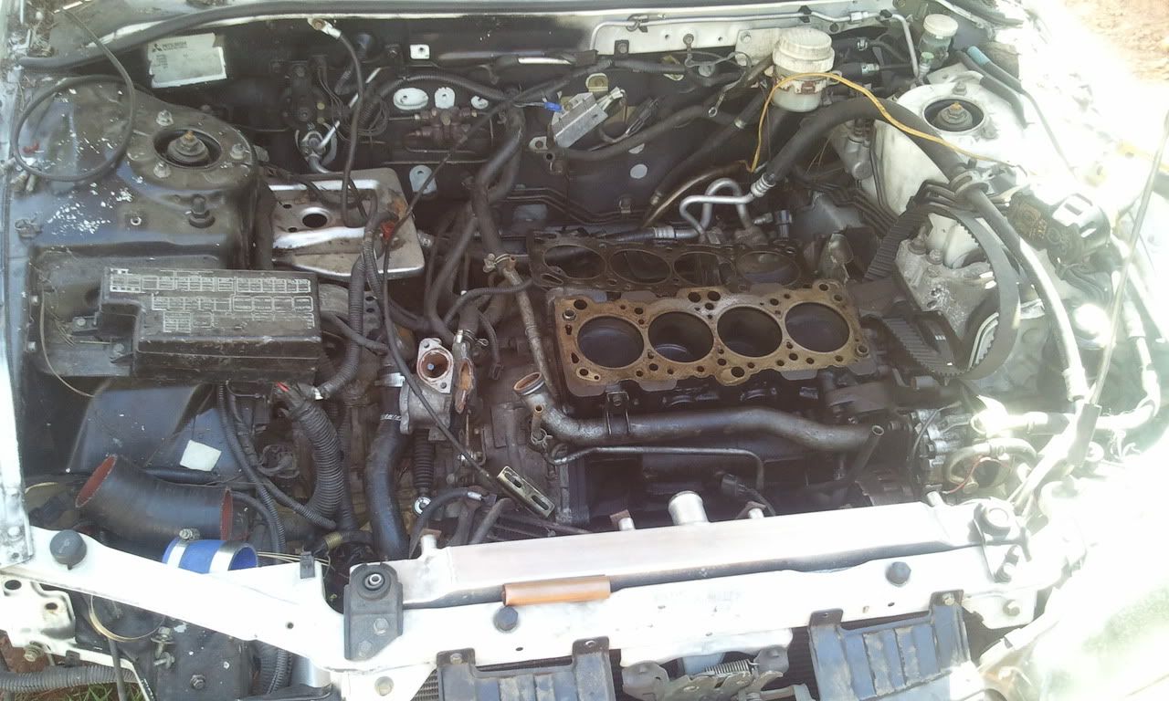

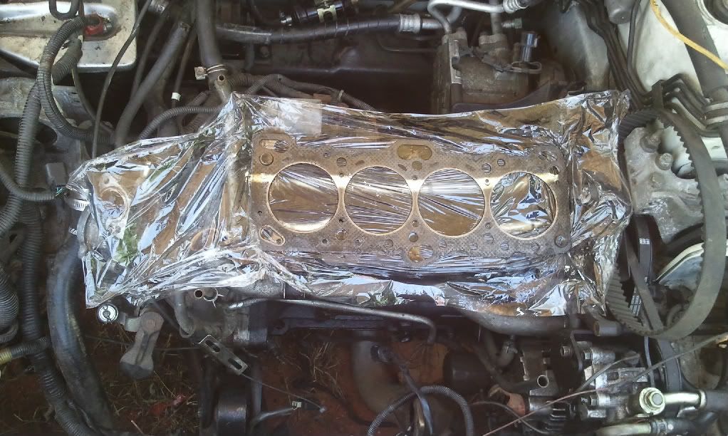

Over the weekend I installed my cruise delete cable, and took the head off. I'll throw in the 6 bolt later.
Keeping it freshly sealed LOL

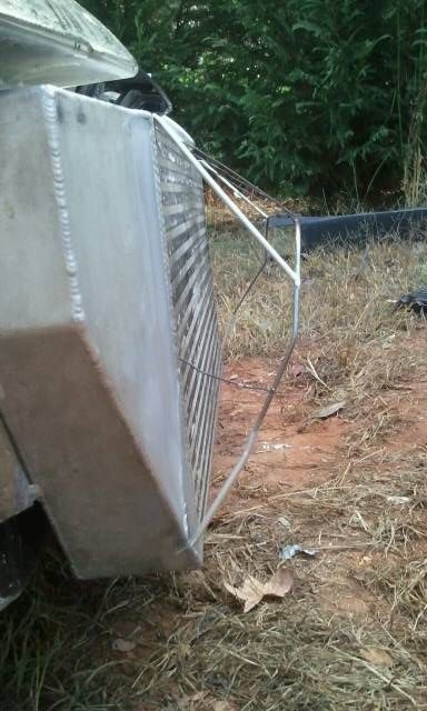

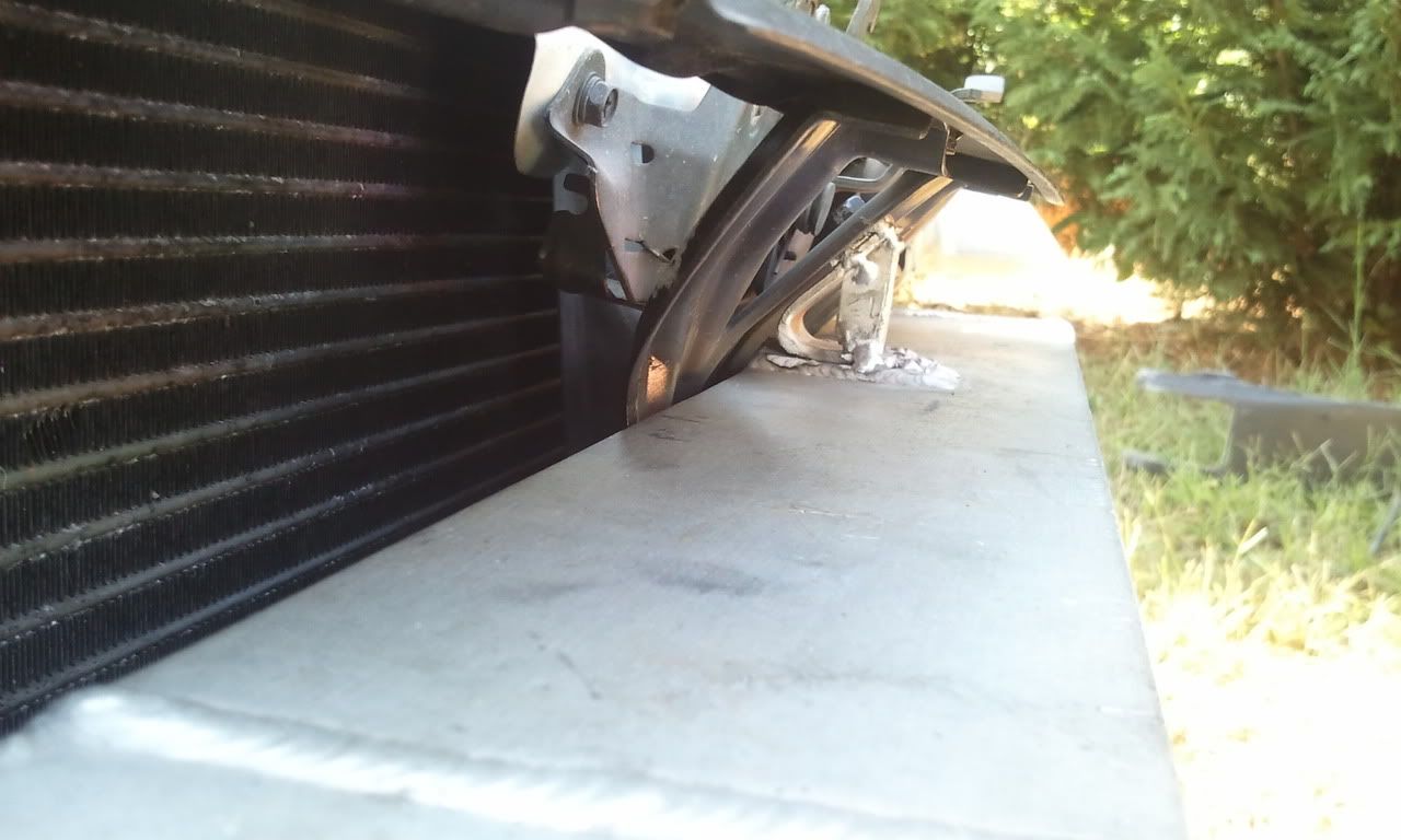

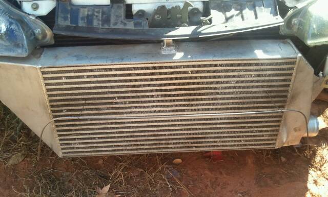

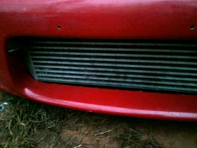

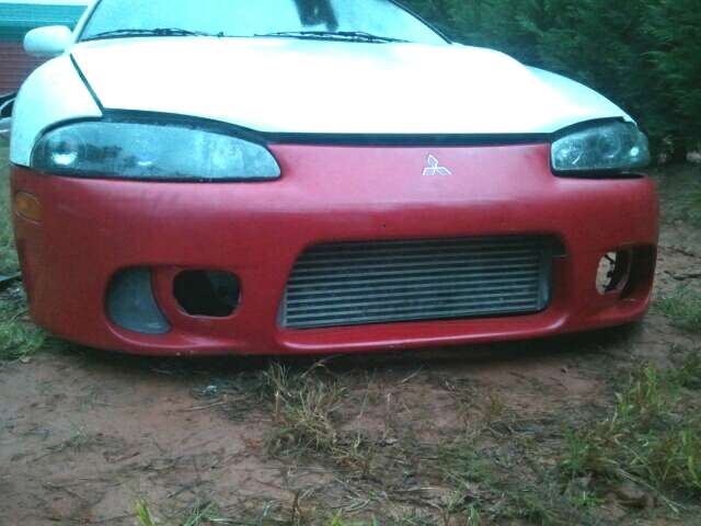

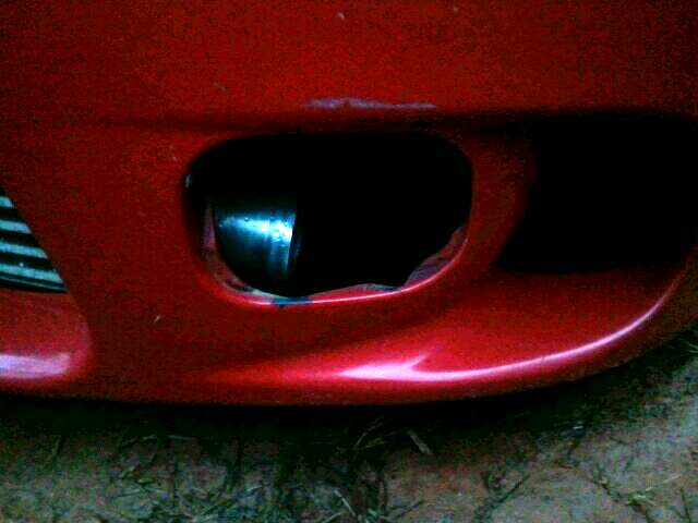

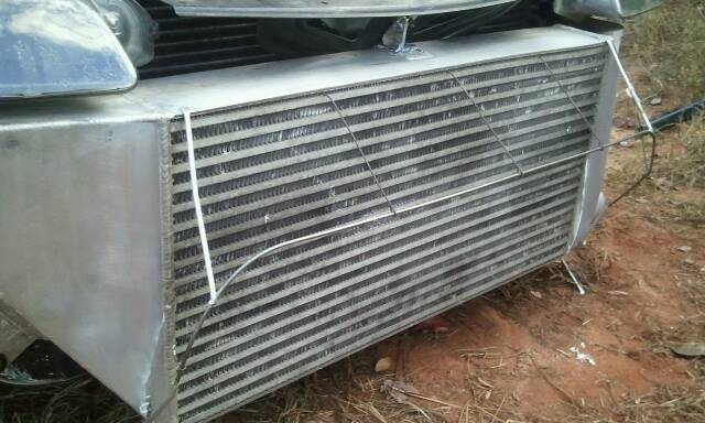

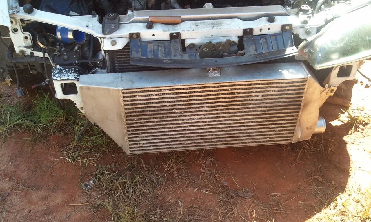

I blindly trimmed an inch from the bumper and cut out the opening today. Surprisingly it fits perfect. Ill add more ducting later to seal the bumper to the intercooler
Here's the latest pics
Just enough room to fit a coupler

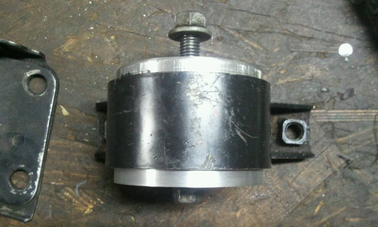

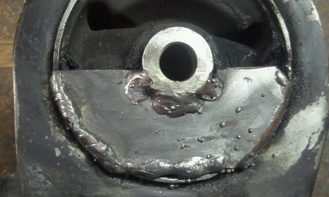

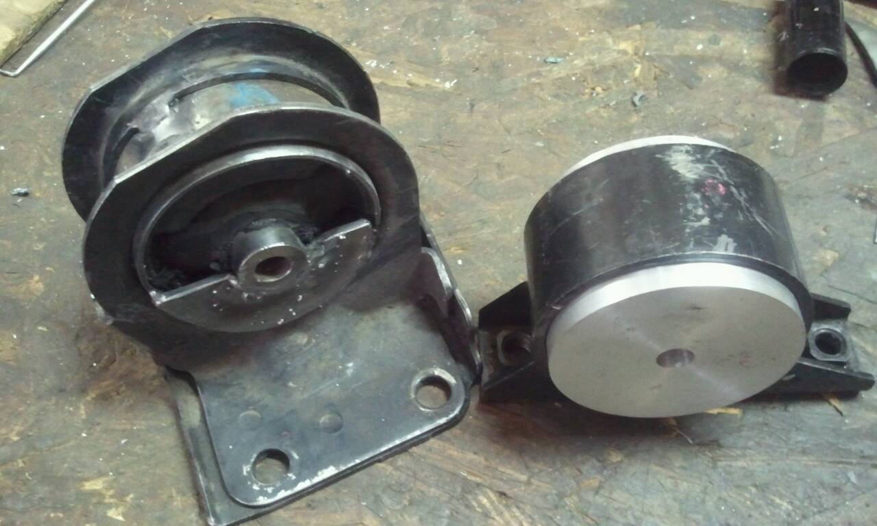

Made some solid motor mounts this week.
The 18's are for street use, They're heavy. I'll have a separate set of tires
It has koni yellows with sleeves. 572f/472r springs. I'll be changing the rear springs rate, when I do the suspension/ alignment

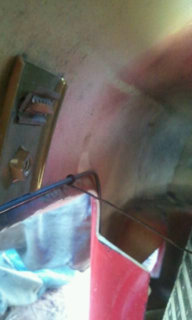

Made a mesh frame for the fiberglass ducting. 1/8 rod for the main hoop and aluminum tube for the bracing. Hope to have it finished next week.

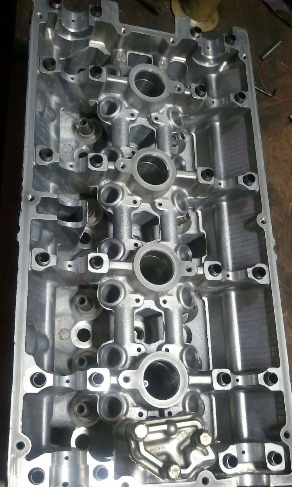

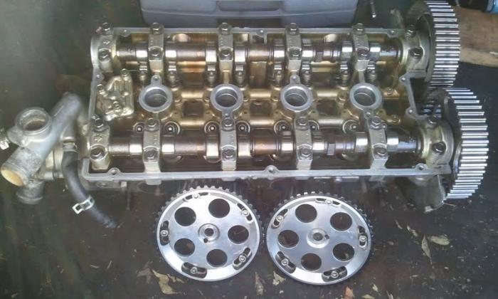

Got the head for $50 and gears for $100. The head skipped time, but the valves look fine. Still a perfect excuse to rebuild it. Just need some dks 272's, and I wouldn't say no to some cheap evo springs

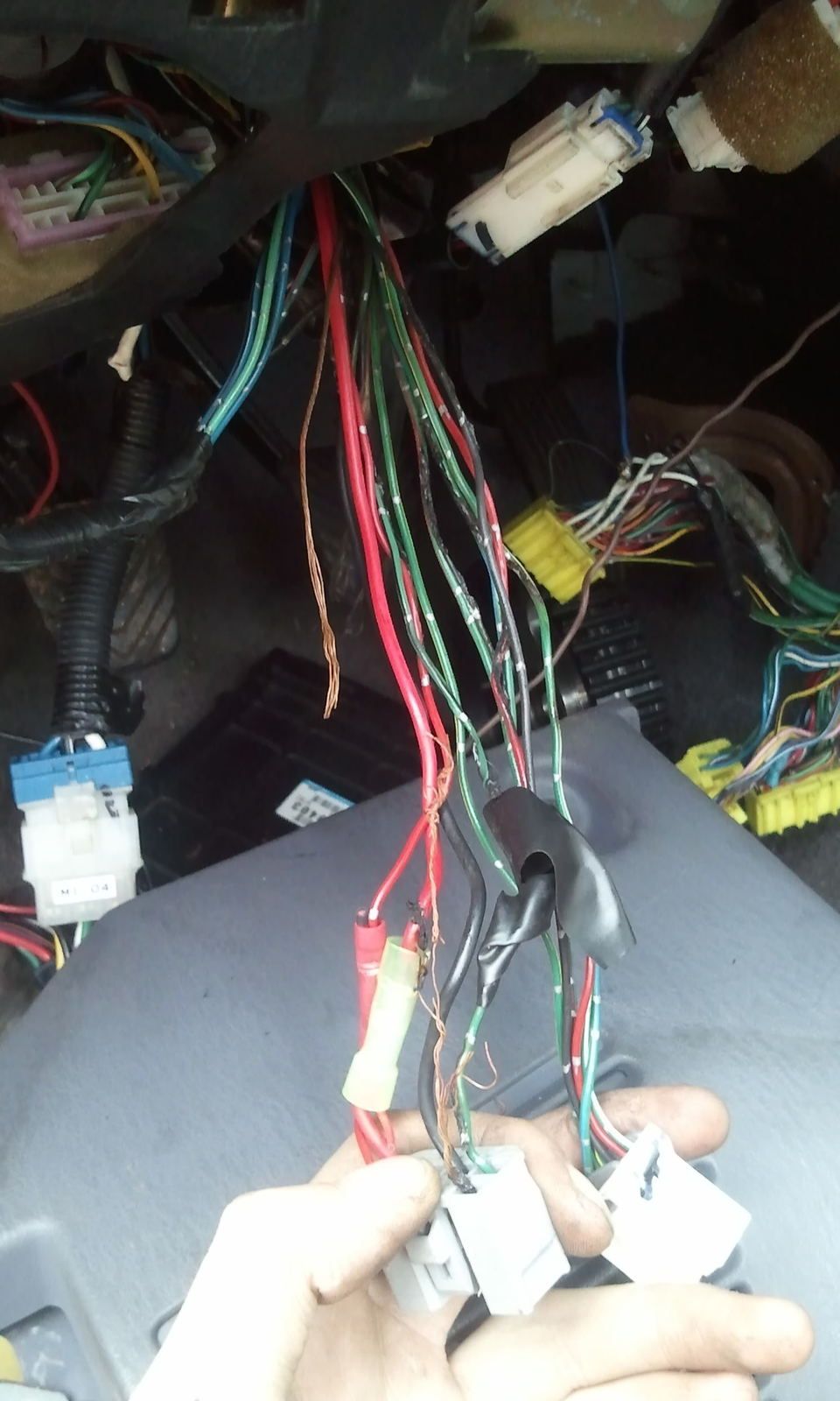

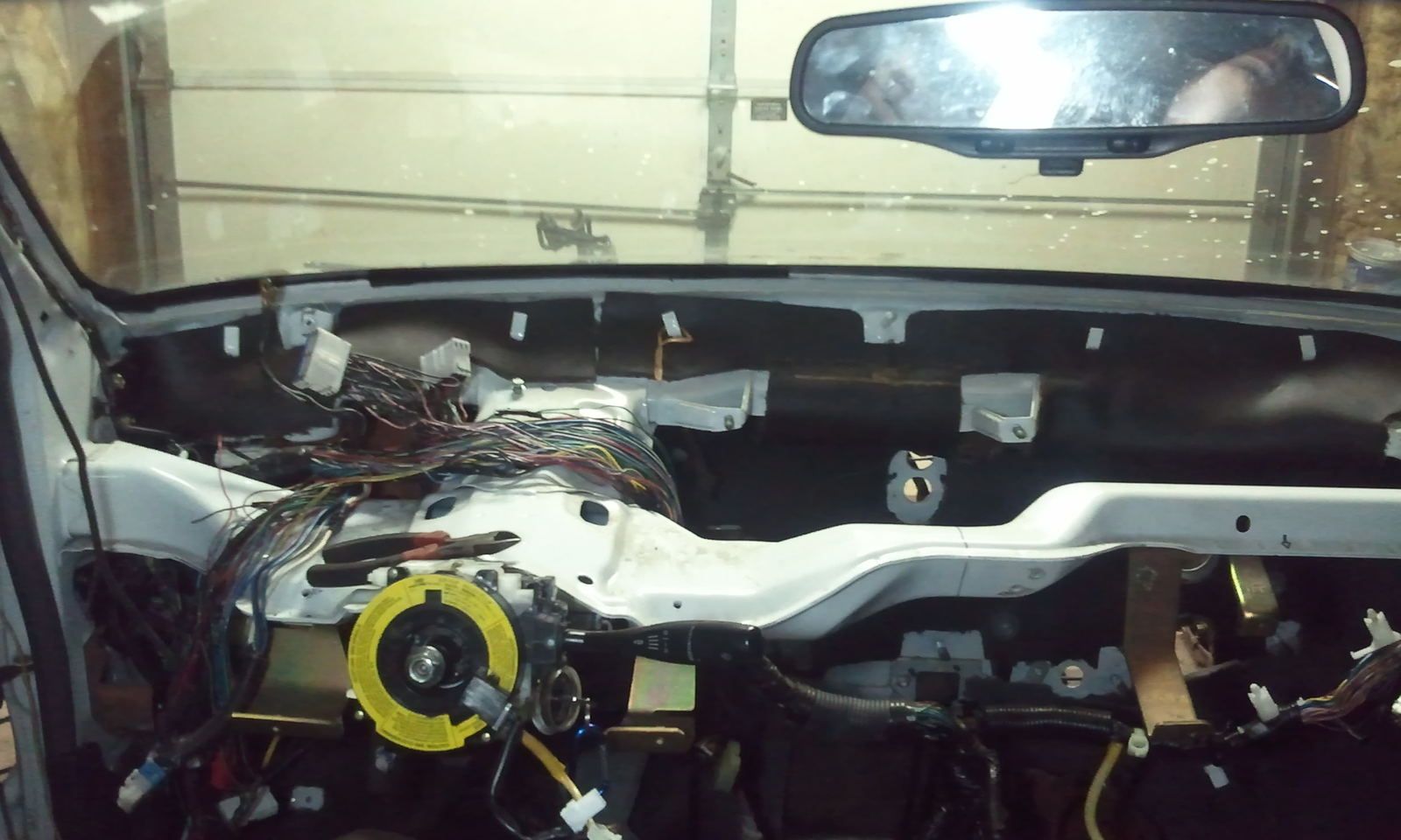

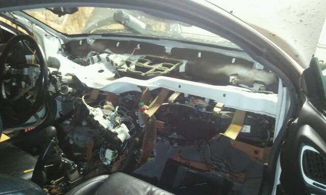

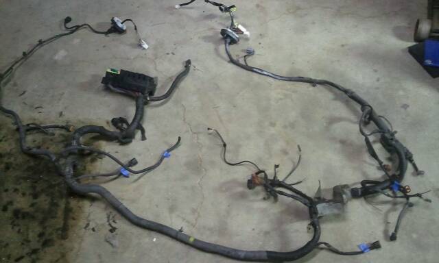

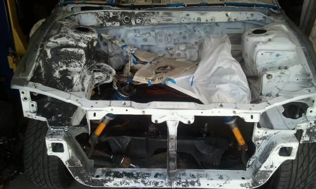

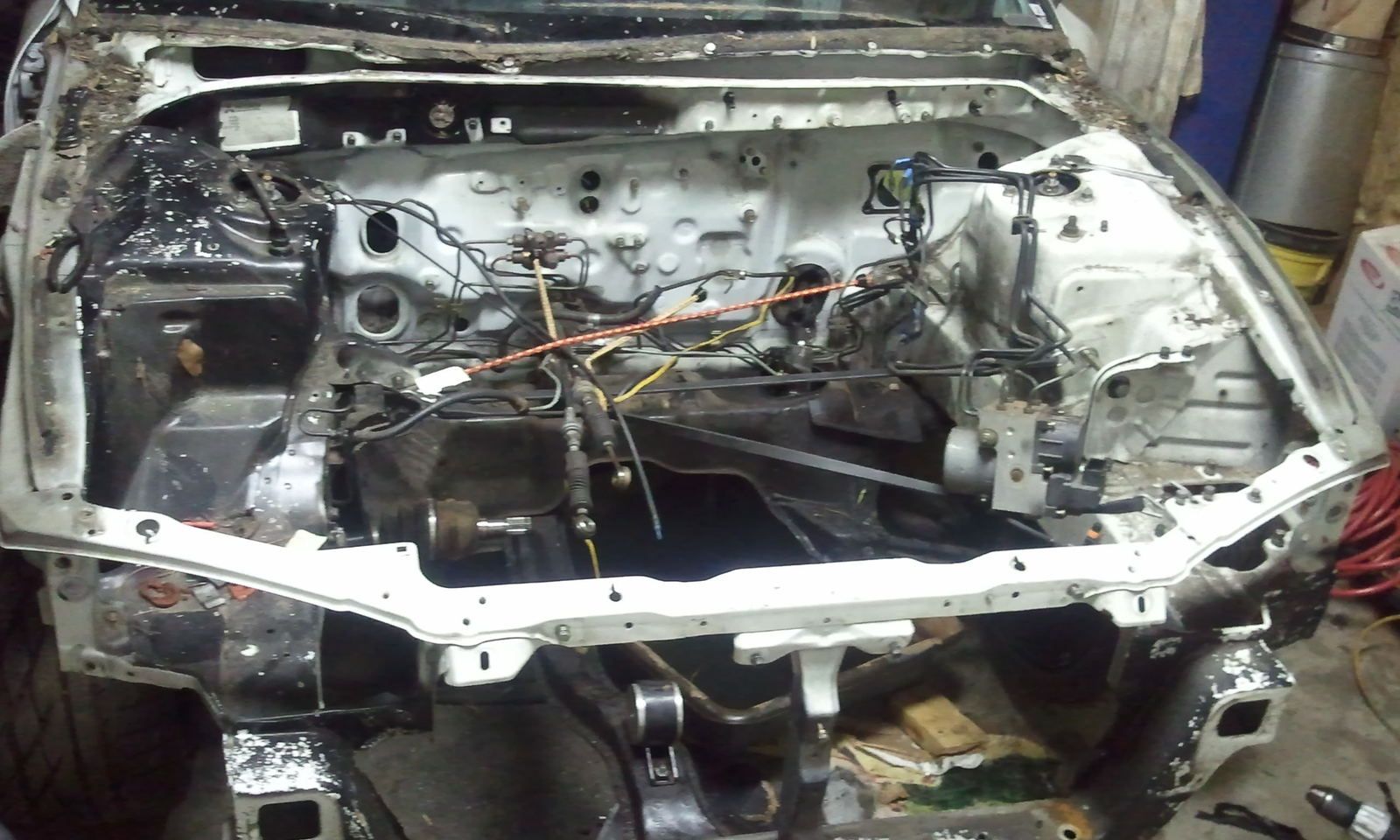

I'm very displeased with the car. I was wiring in the turbo timer when I saw a bare wire hanging. Dug around a bit more and it turns out that wire completely melted out of its sheathing. The worst part is that it's also melted inside the harness damaging other wires:banghead: :ohdamn: The dash is coming off and hopefully that wire only leads to the fuse box (it's a headlight wire) :pray:

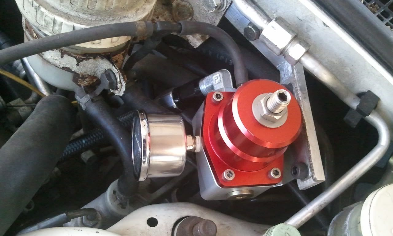

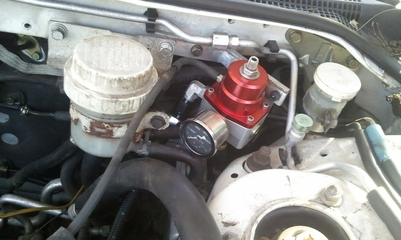

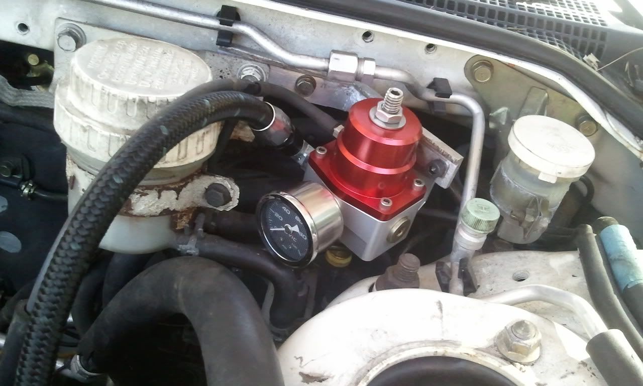

Also made a bracket for my fpr. It clears everything by 1/8" and I'm using the original fuel return line.

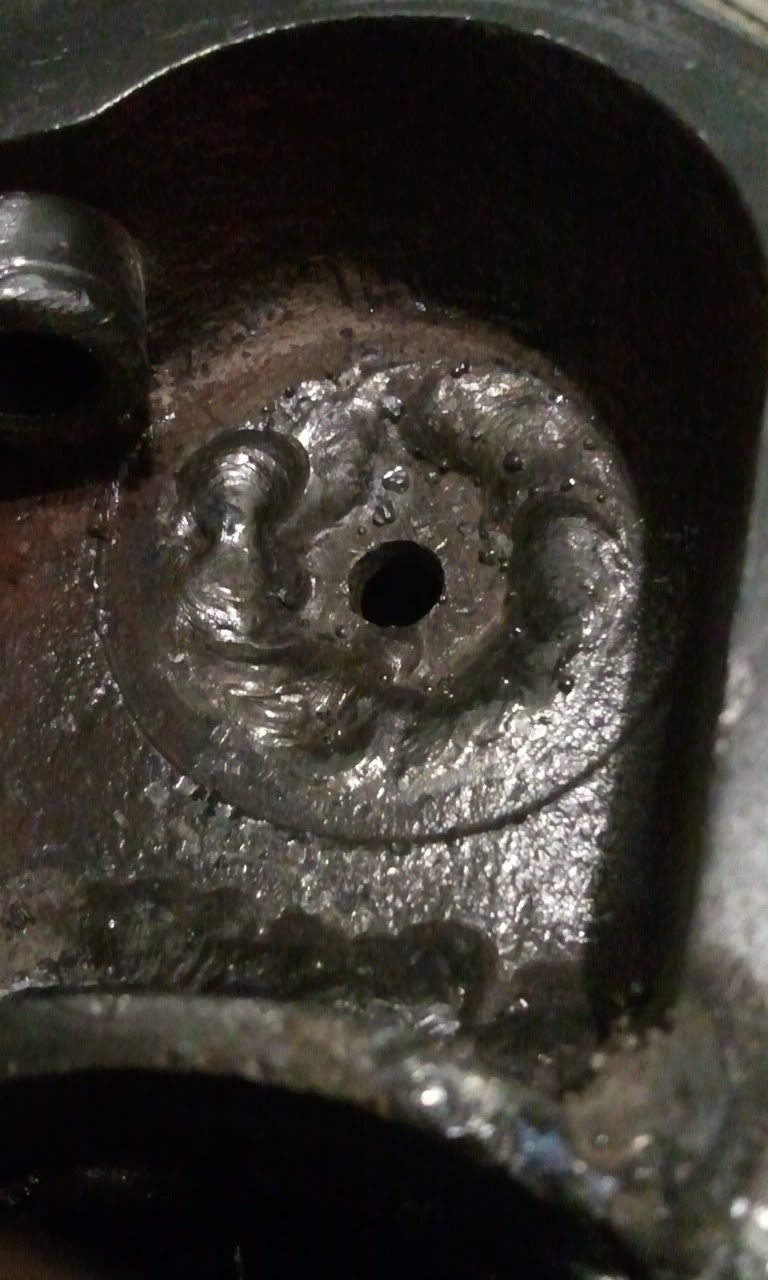

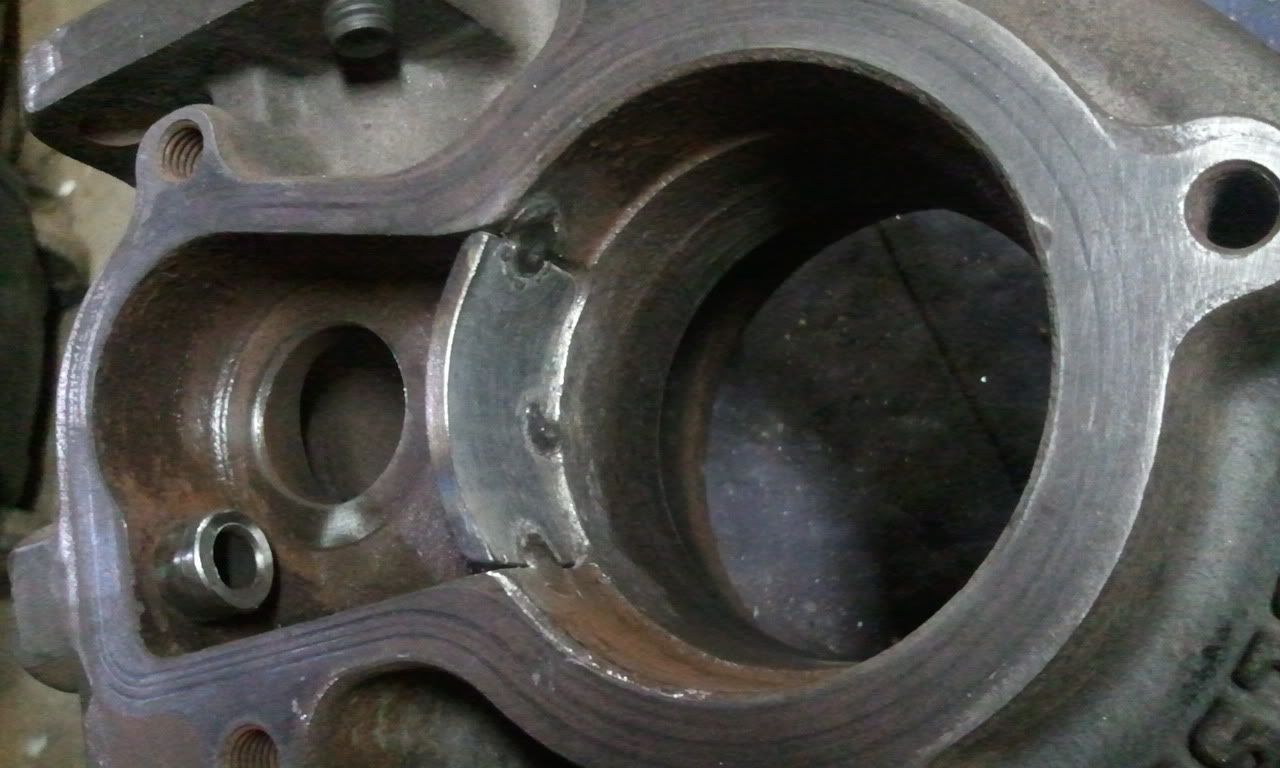

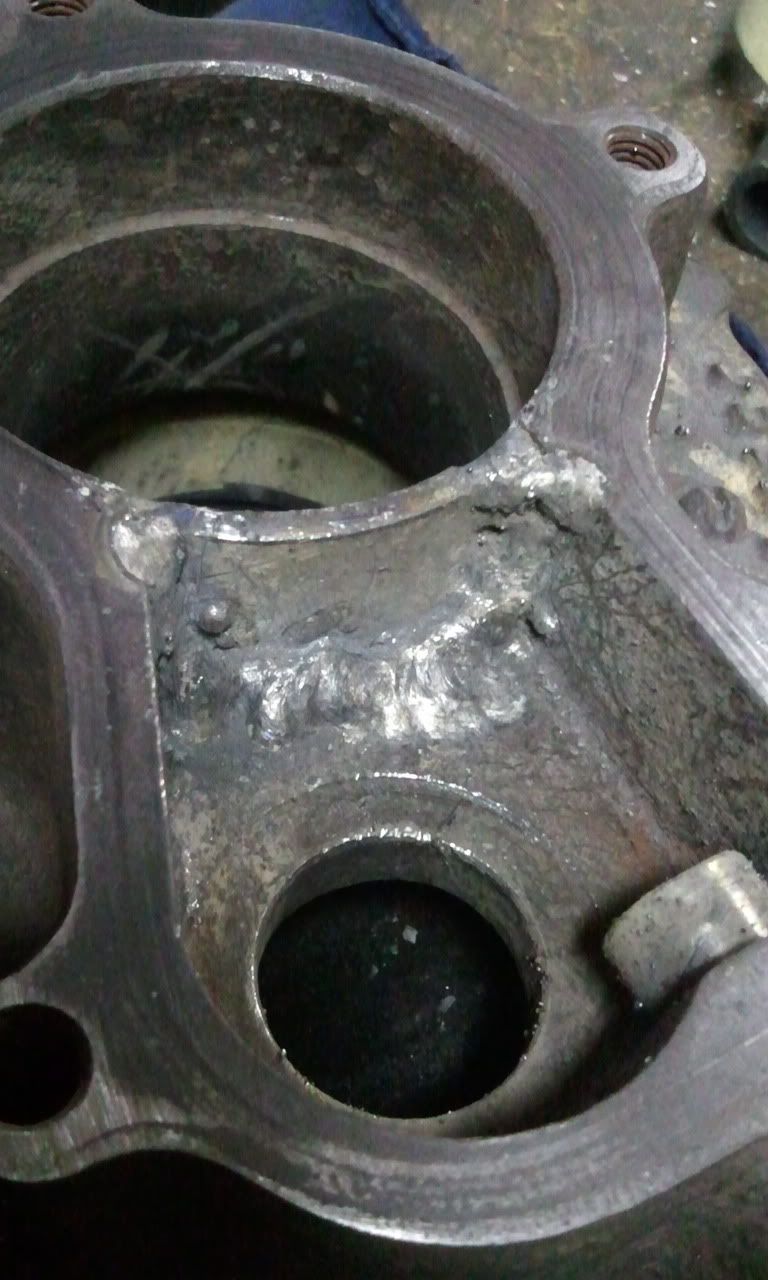

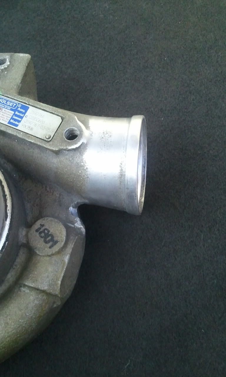

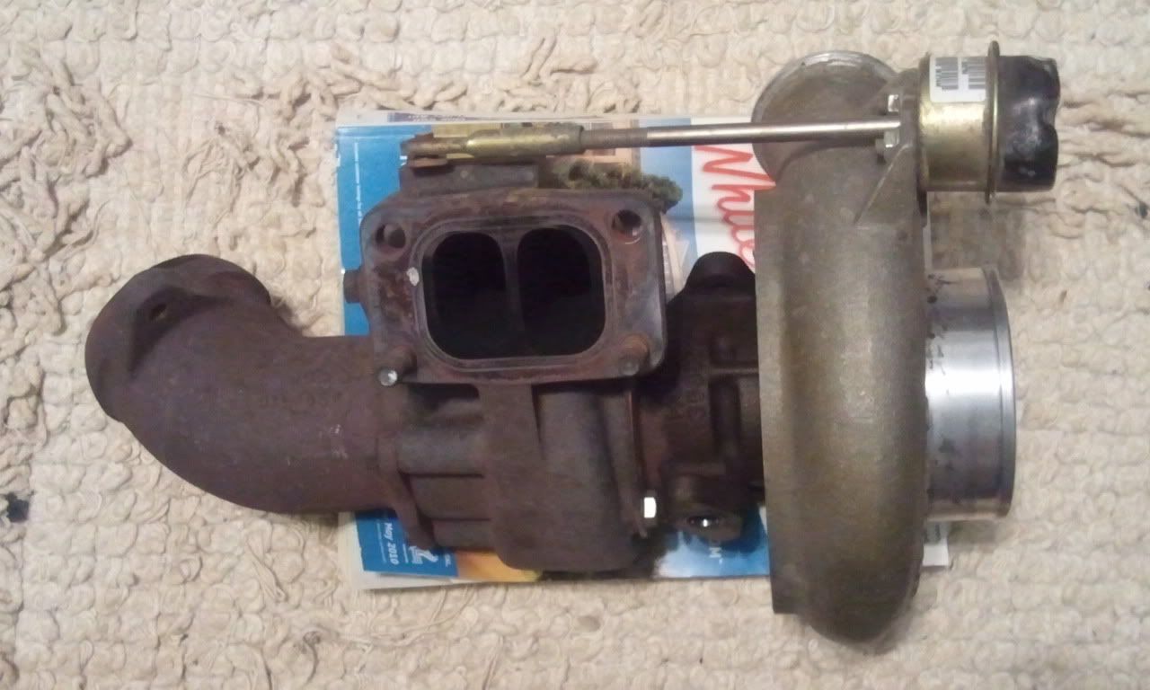

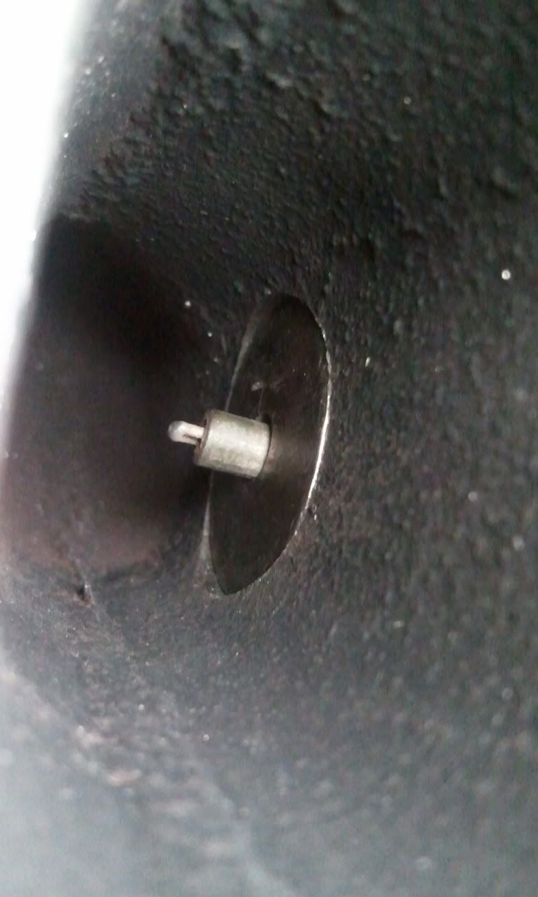

Also welded some on the turbine housing. Welding cast isn't as bad as I thought
http://www.dsmtuners.com/forums/cus...f-wastegate-portion-hx35-turbine-housing.html
Egt gauge will be in the turbine housing.
Also grinded down the vband so I can fit a coupler.

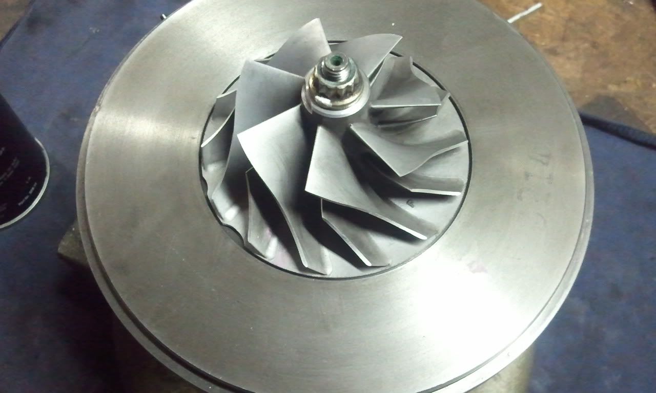

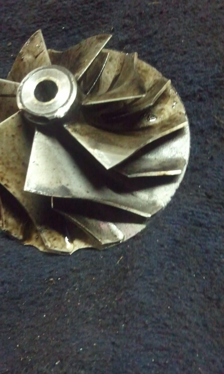

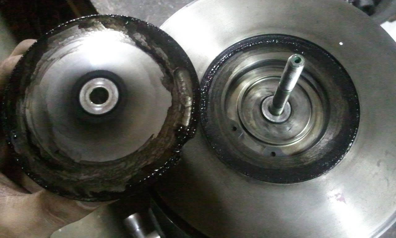

Finished off the evening by cleaning the compressor side. An old brush and some diesel go a long way

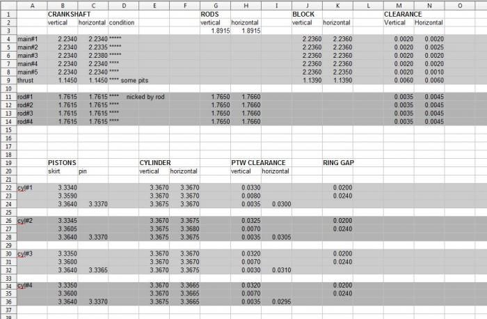

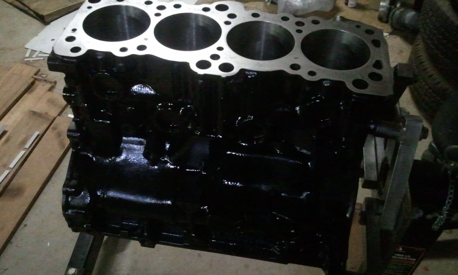

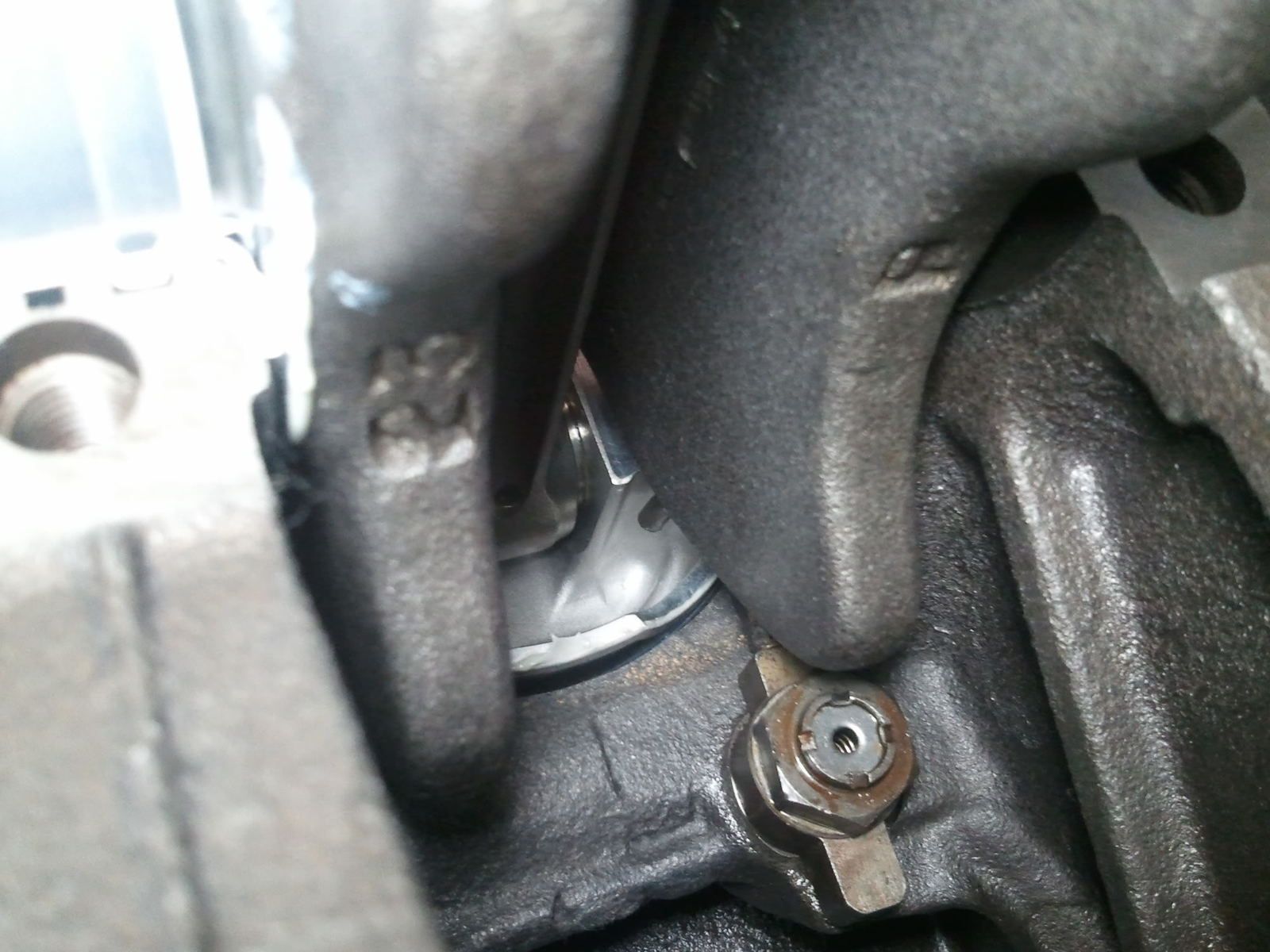

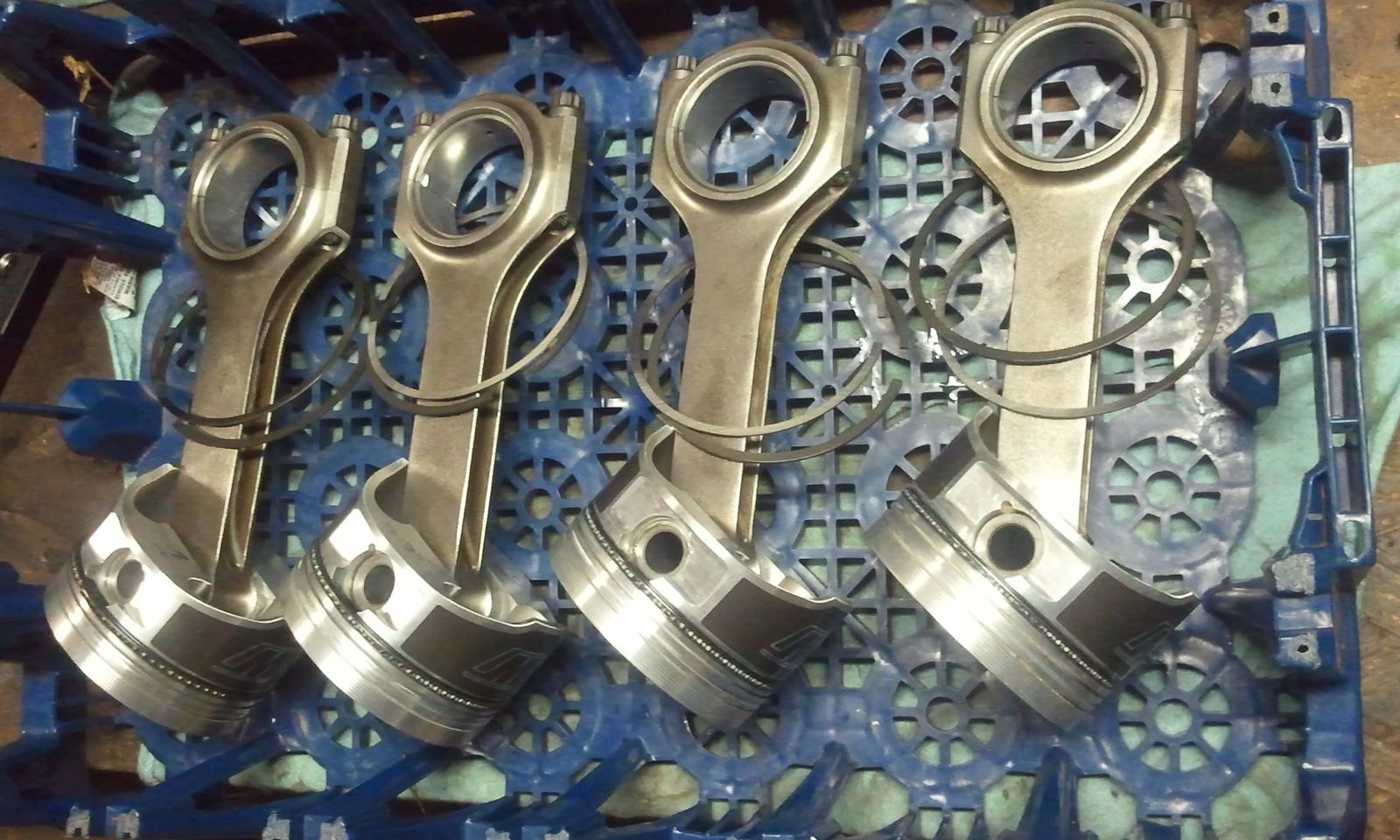

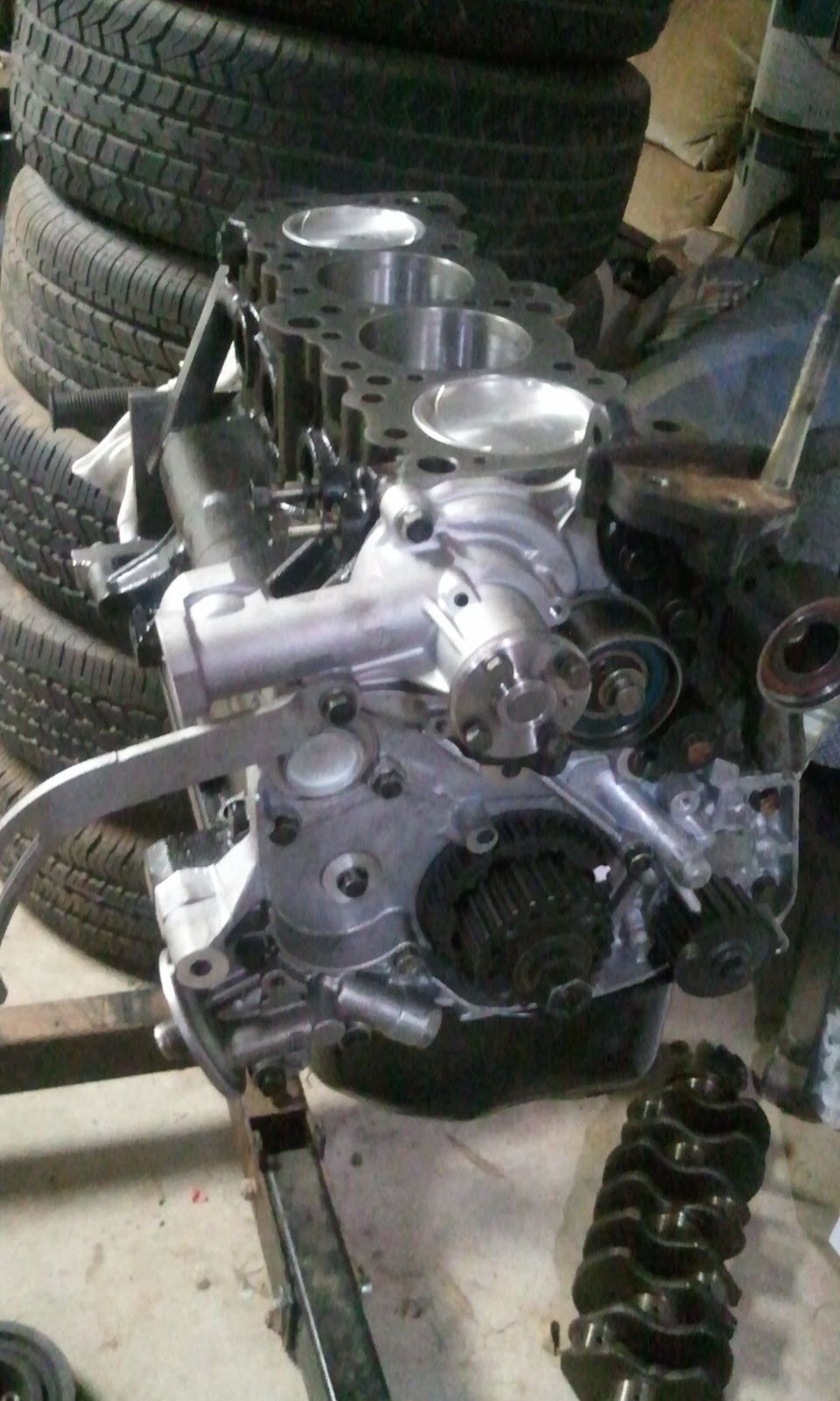

Couple pics of the bottom end.

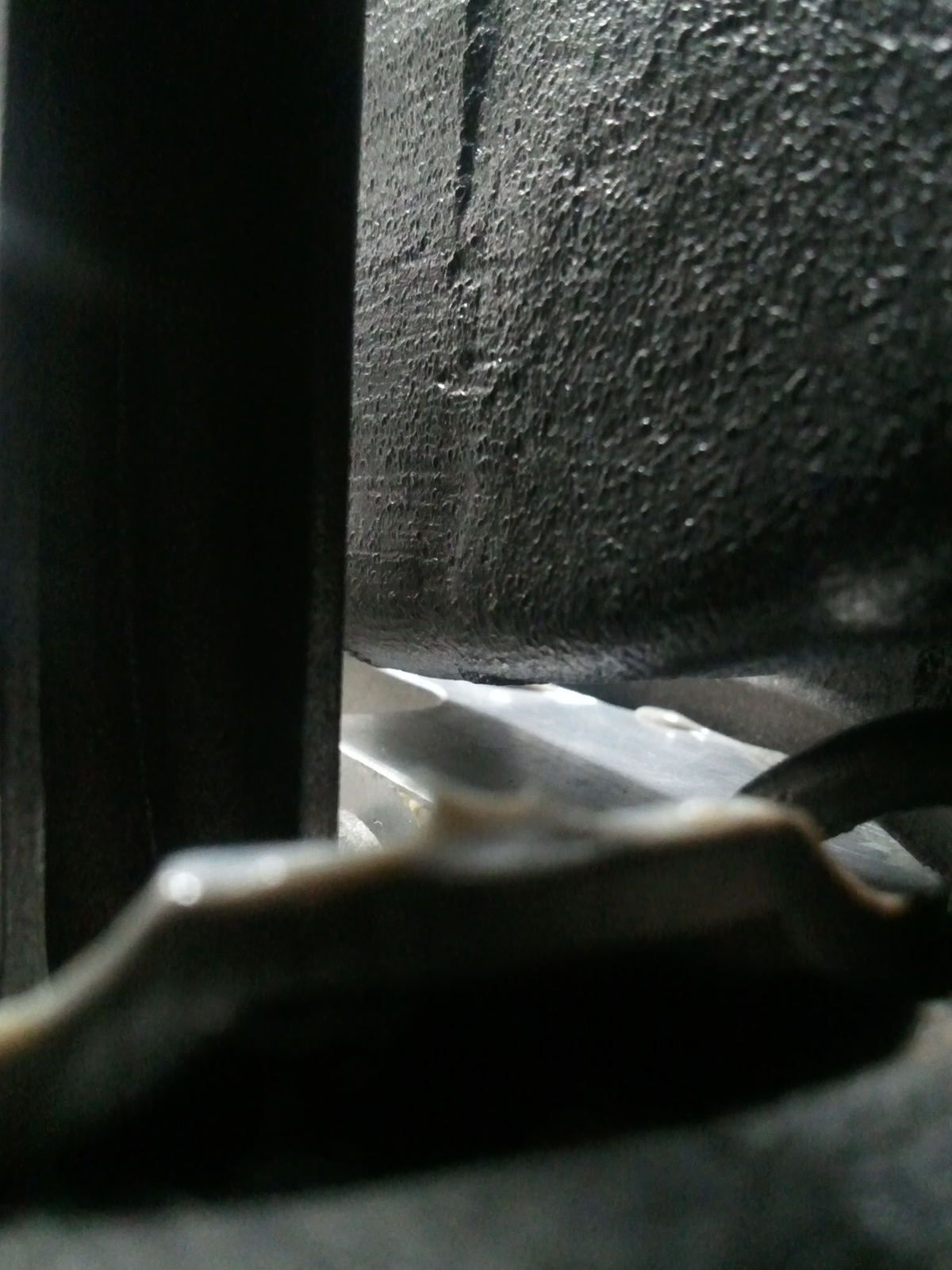

1/8" clearance between the piston, squirter, and crank.

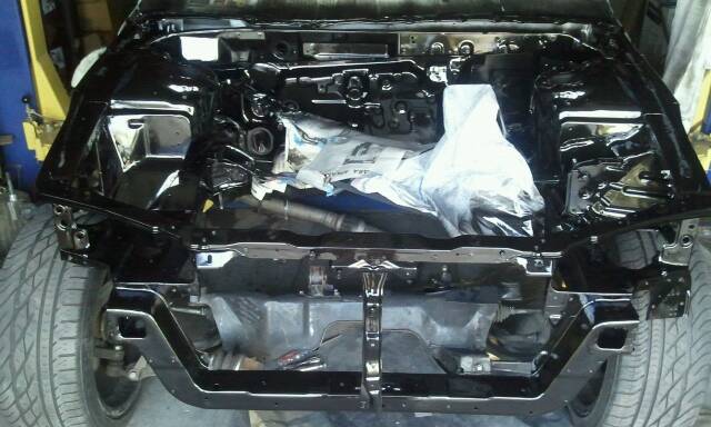

Bottom end done
Build is looking good man, I really like the idea of making fiberglass ducting from the front bumper to the intercooler. I may have to steal that idea, for when I actually get some TIME haha...
dont forget the walls of that rim! LOL. Post some pictures up of the flat black rims next to the car, personally I like gunmetal. But never really saw much flat black.

Around 7-8. I've been helping my dad since I was 10 (he's a mechanic) and I started flipping car when I was 16. I was intimidated by gutting it to this level but the harness just unplugs and taking out the dash is very easy.

damn!! man that color looks sick im a huge fan of dull flat colors hate chrome! thumbs up for that find, and good job getting rid of that nasty ass body kit like the rims tough.
the bay looks flawless nice job. looks like you have a good build on your hands
