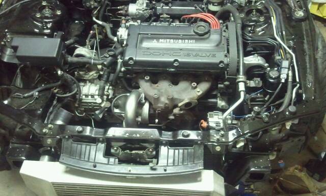

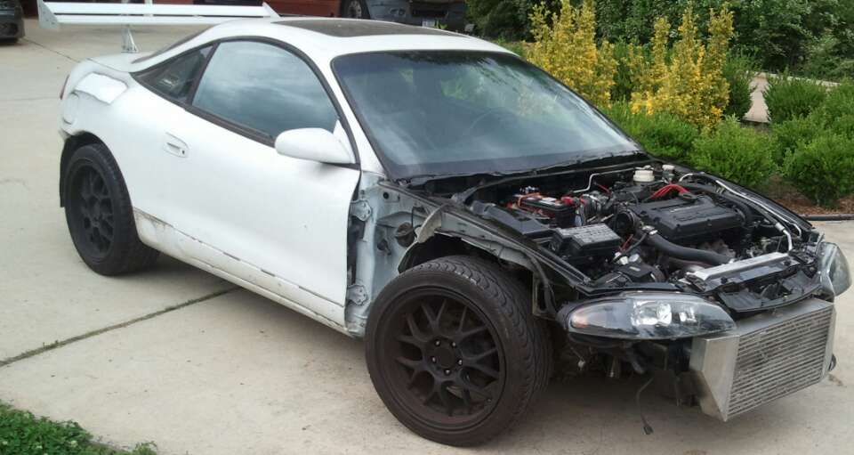

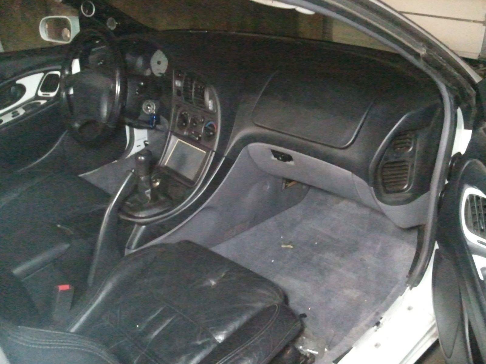

well it's been slowly coming along. interior and wiring is 99% done. Engine should be in this weekend and i can finish the plumbing

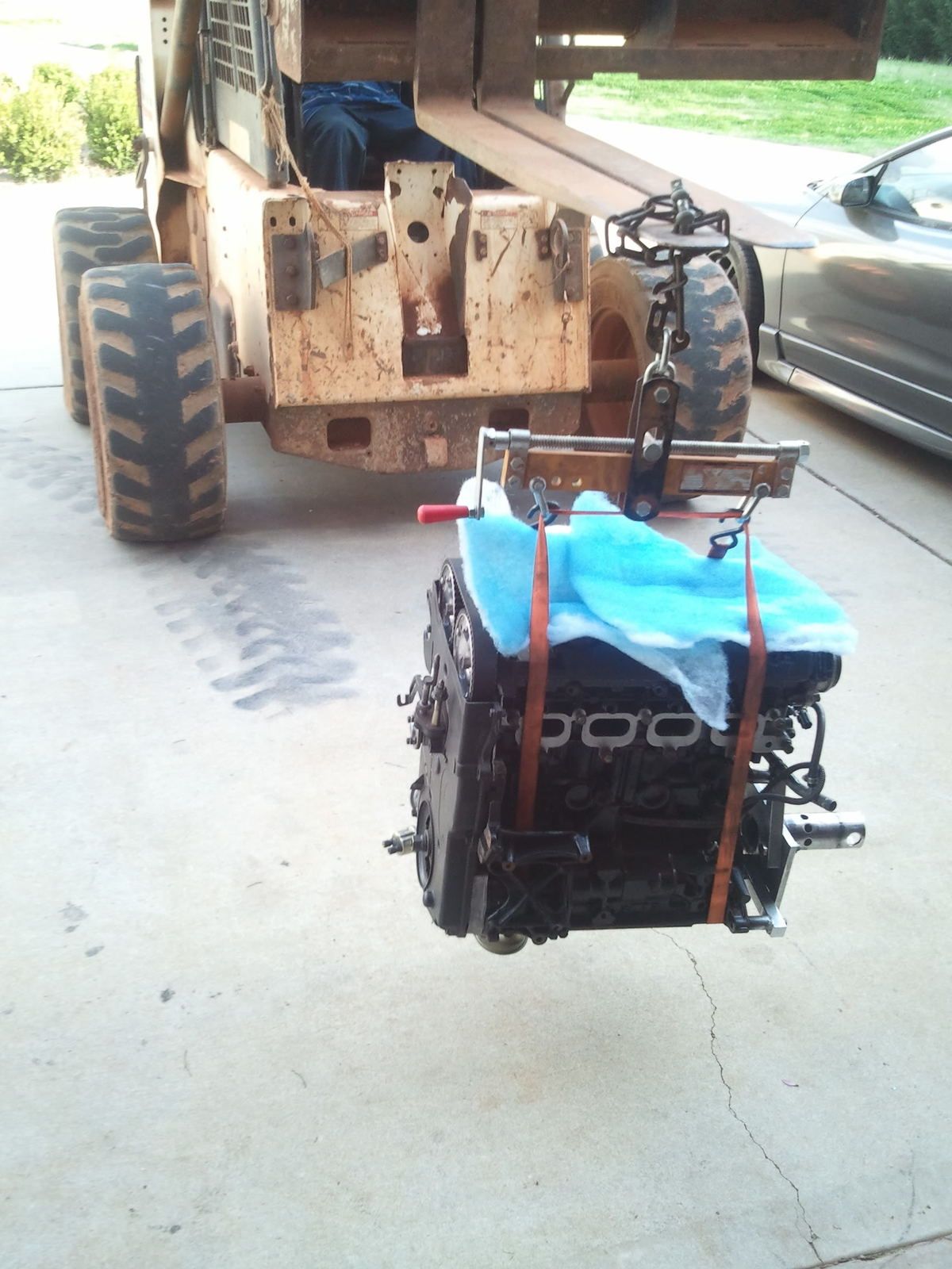

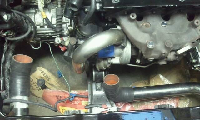

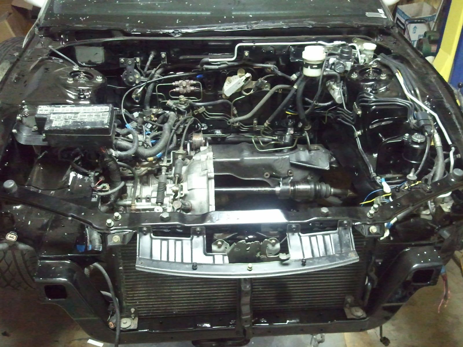

Took the front and rear roll stops out. Also the intermediate shaft. Lifted the transmission up and forward as much as possible (about 30°) and propped it up with a 2x4. Engine went it like usual. There was maybe 1/2" clearance between the block and frame rail.
Shame shame on whoever rigged up the j-pipe. It's in front of the intake.

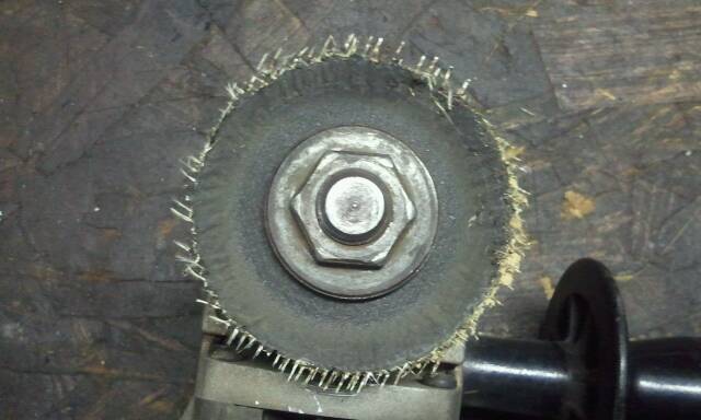

While cutting off the flange I took some shrapnel to the face. Always wear safety glasses :)

I wish I'd seen this sooner to mention this before you put the tranny back in: if you really dragged the car with the rear wheels on the ground (as in the third pic on the first page) and didn't drop the driveshaft, you'll need a new center VC.
I did drop the driveshaft :)

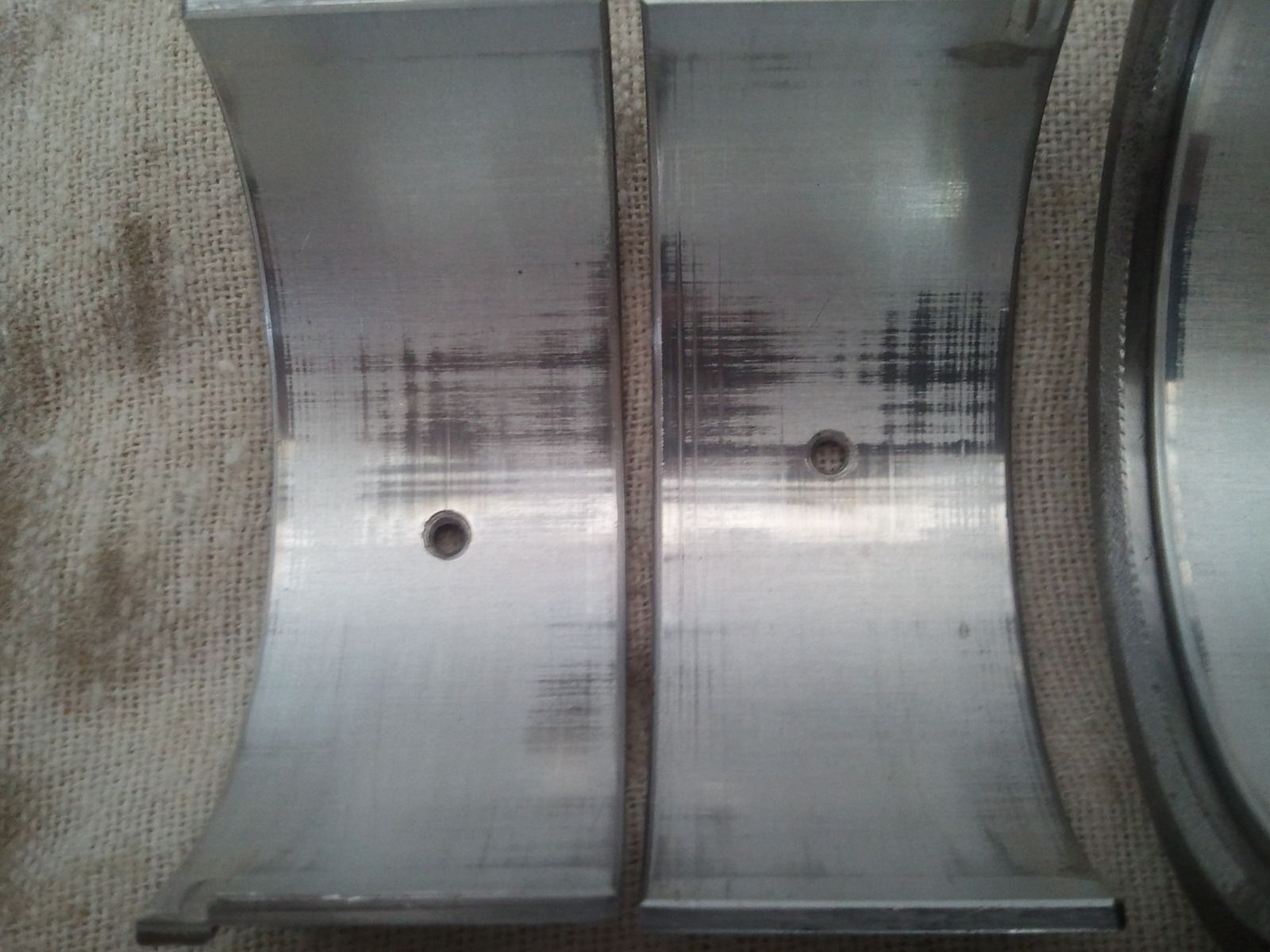

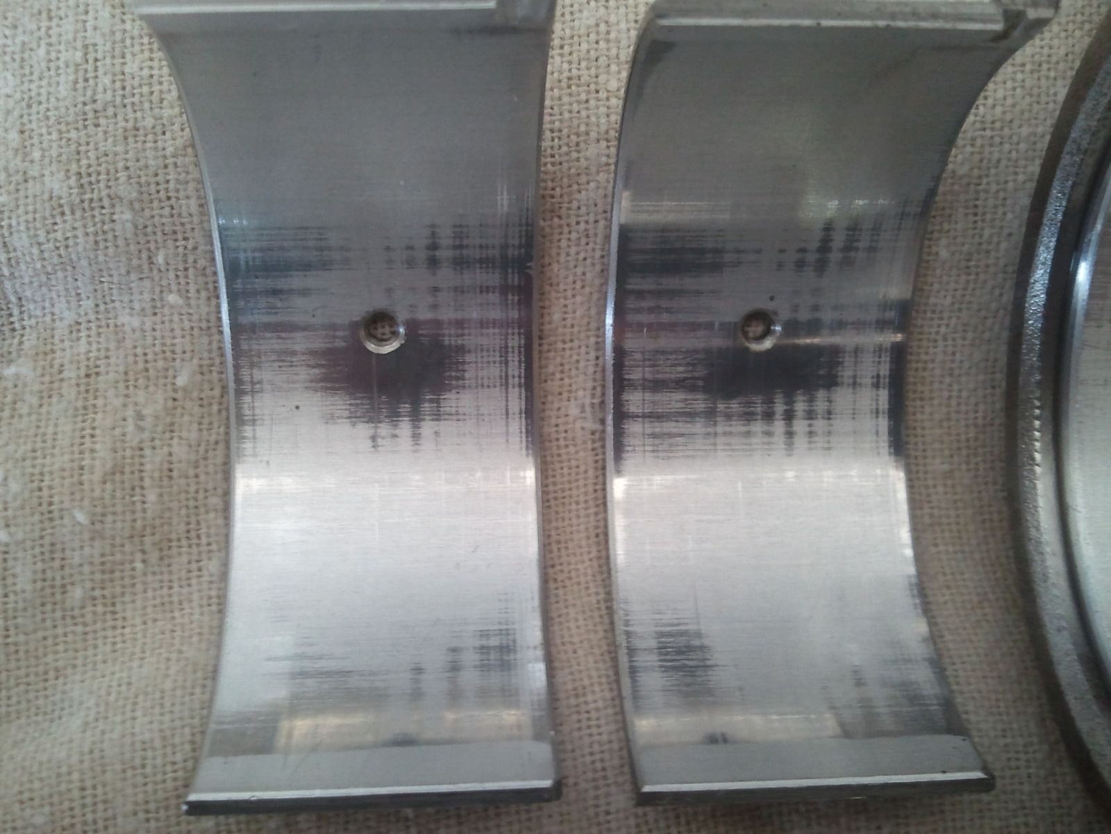

Update on the ticking problem. I took the oil pan off just to make sure it's not the bearings, and everything checks out fine.
2 and 3
1 and 4

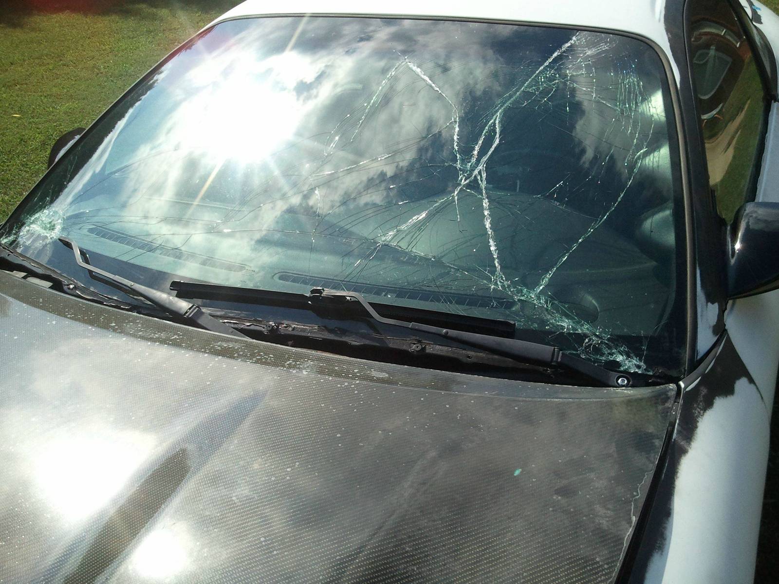

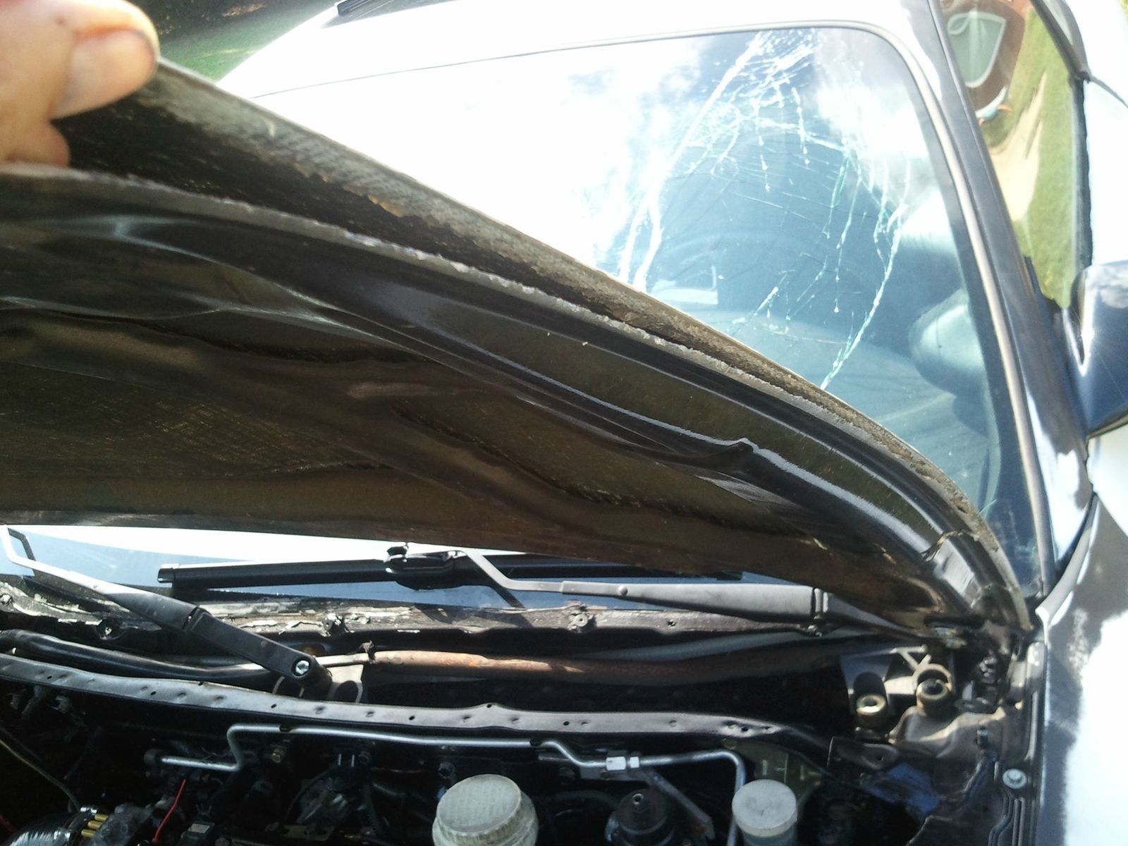

The hood flew up destroying itself and the windshield, and the power steering rack sprung a leak at one of the fittings.

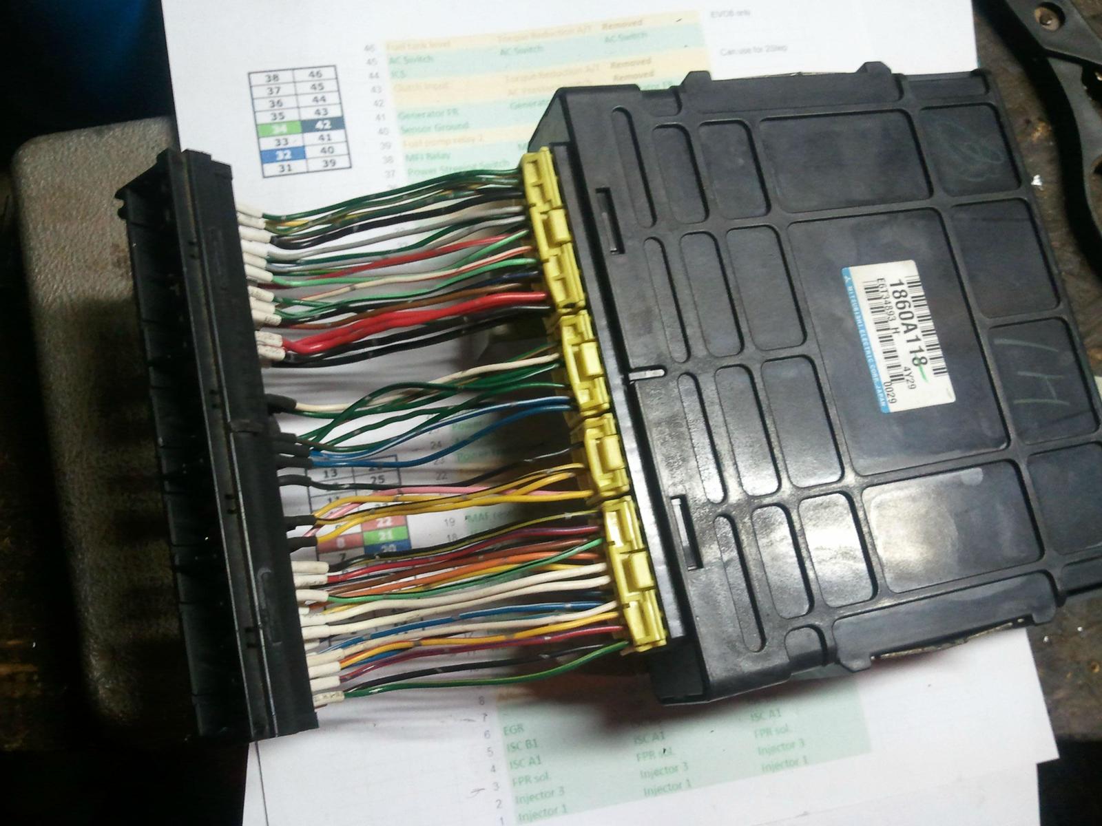

Finished up the adapter harness for the evo8 ecu. 2 wires gets swapped for fuel pump, 2 get moved for the fans, and a couple removed for some misc stuff. If I had to do it again, I'd just swap the pins on the stock harness. It would be much faster and easier.
What sort of benefits will you get with the ECU swap? Nice build btw.

My carbon hood flew up and it cracked a inner rib of the hood itself, kind of cracked the hood end corners and damaged my roof. it didnt affect the glass which was weird.
I ended up repairing it with fiberglass and im about to paint it black, good as new but no more carbon fiber look.
