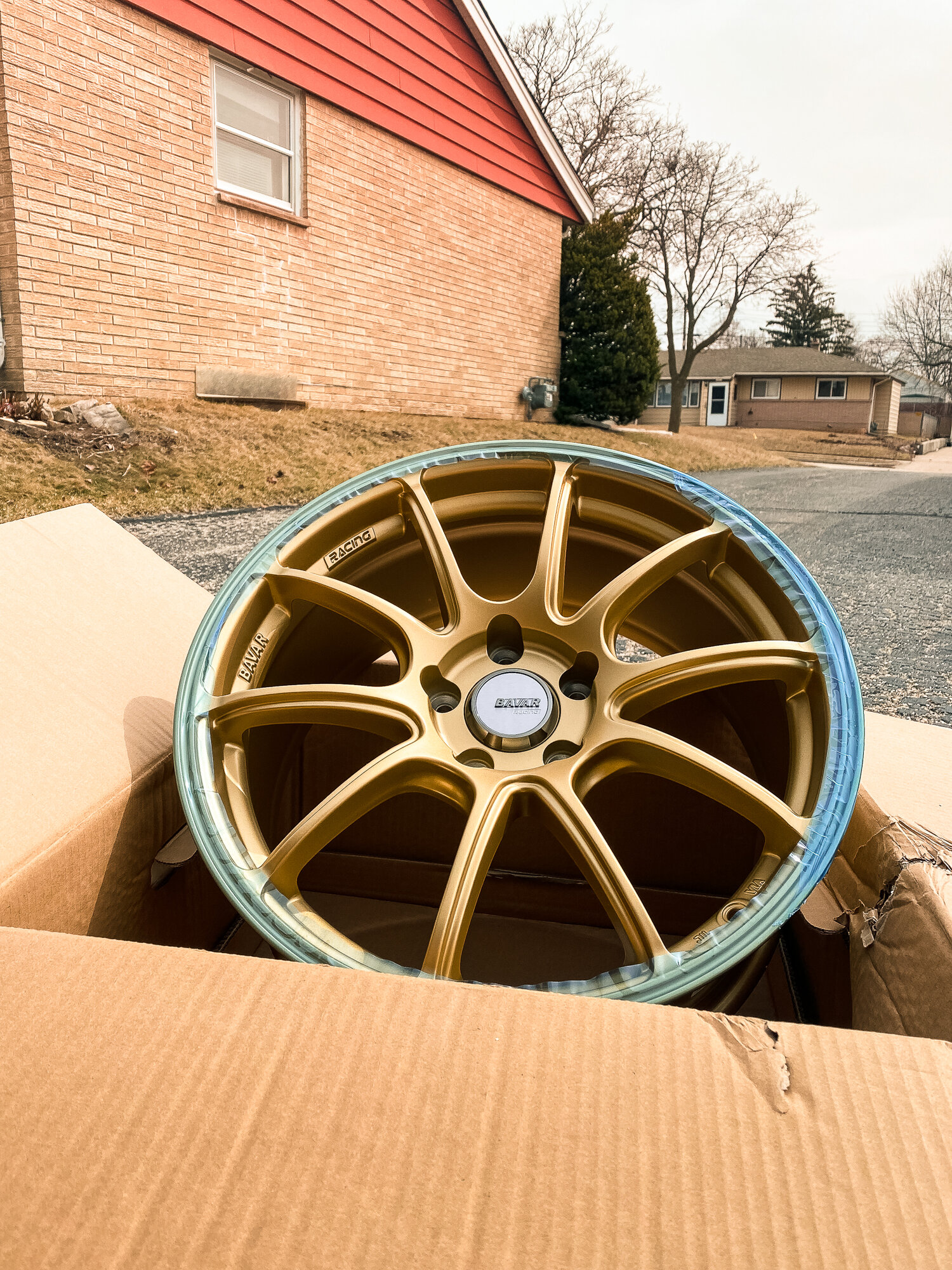

During the prior summer's engine build, I had been exploring wheel options. With my goal of this being a drivers car, I really struggled finding a set of gold wheels in a width that looked good, while also not introducing too much rubbing. Most of the JDM wheels I like don't start having the correct look until the offset is +22 and at least 9" wide. While 2g's look absolutely fantastic like that, it would have limited the drivability. I settled on a 18x85 +35 maximum, and began searching for the right wheel. In the meantime, I tried on a set of Gold Advan's by Cook's house (AGAIN...get yourself a drifter friend. They have stupid amounts of wheels). While this specific set was a bit big with too much tire, it reconfirmed my Red/Gold theme.
As I was searching, I randomly browsed eBay for "18x8.5 5x114" and scrolled through the countless pages of wheels. Somewhere on page 5-8, I came across a Bavar Racing Wheels. I had never heard of them, but the look immediately jumped out to me. They had the correct shade of gold, correct amount of concave to the face, and fit the overall style that I wanted. I did some research and found out they are Flow Formed wheels, and are used by some for motorsports. I'm not the biggest fan of knockoff wheels, but I also believe in using what works the best. I had spent the last 6+ months searching for the right set of Advans, Volks, Works, etc and just couldn't find something off the shelf that I was happy with. Knowing that I still had a lot of work left (and most importantly money to spend), I settled on these for now and hit order. $1,400 later and they were at my door.

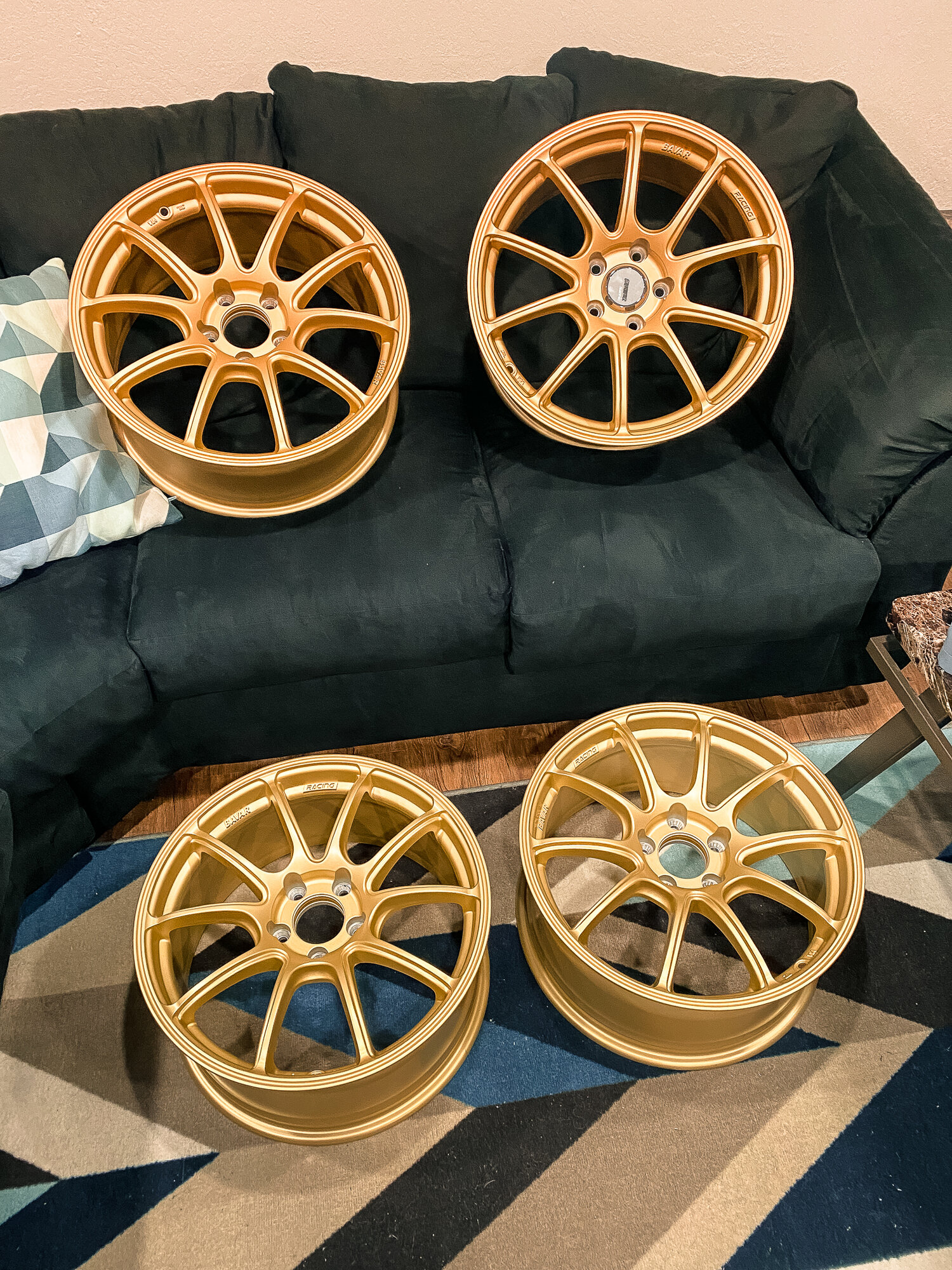

I reached out to my buddy Ned to help me ceramic coat the wheels to help keep them clean. We coated them and I ordered a set of Firestone Firehawk Indy 500 tires, the same ones I had on my Mustang. I find them to be a great all around tire while remaining fairly quiet and compliant for street driving.

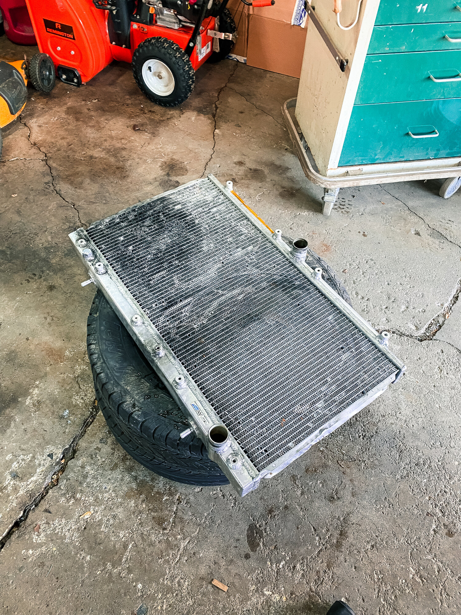

Back at home I had a long forgotten Koyorad radiator from my buddy Stephen's old 2g. while slightly beat up, it was still in pretty good shape and expected to work fine. At this point I really hesitated what to do. I did not want an aluminum radiator in the car, as I felt it would change the look of the engine bay. No longer was it going to be a stock build (with a BOV and filter), but it would change the essence of the build. The next day was the car show however, so I figured I would throw it in and make a decision the following week.
The radiator itself worked flawlessly. The OEM fans and shroud fit without any issues, and cooled perfectly. Even looking at this photo, I can see the moment that the essence of the car changed. However, it allowed me to make the first car show with the car later that day, and it was fully worth it. I cleaned up the car and headed down to the historic Milwaukee Mile Racetrack for the drift event & car show. My friend Brandon, an incredible photographer (check him out on IG @Doystermedia), grabbed a few photos of it under the stormy sky. It's kind of hard to tell from this angle, but we are actually parked on the infield road course of the Milwaukee Mile.

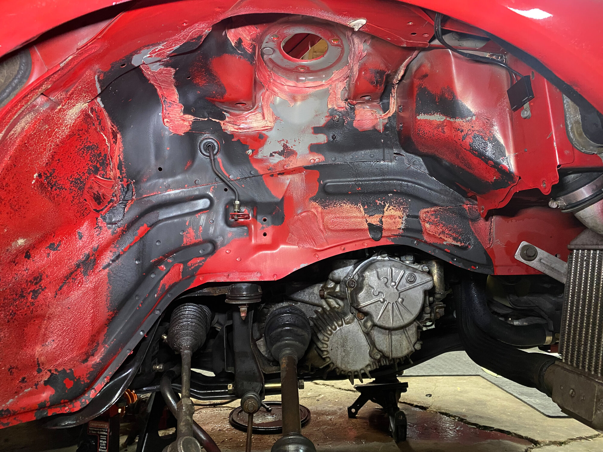

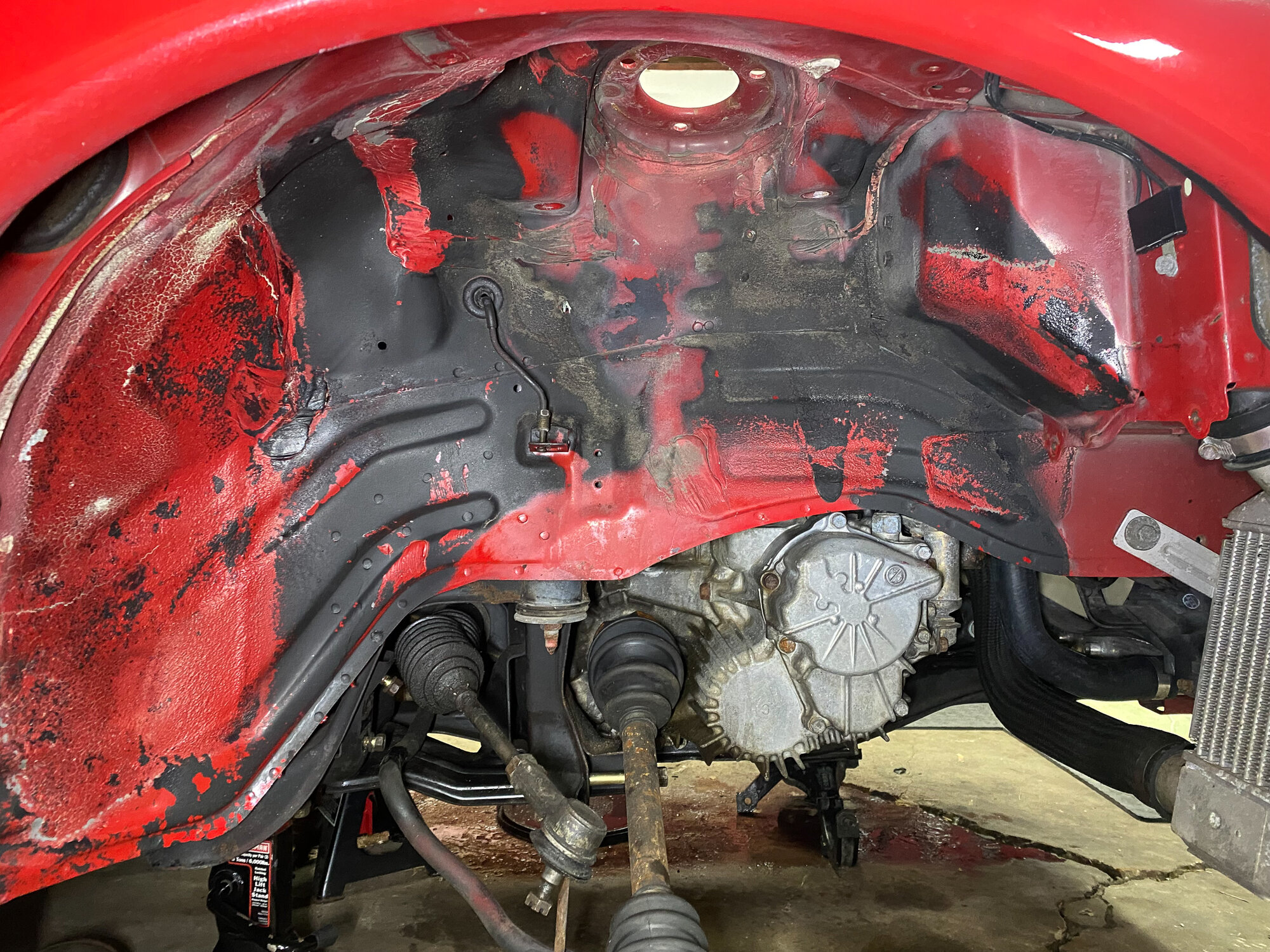

The next major phase of the build began August 2022. While I was extremely excited to get it started, it was certainly a lot of work that would never be seen. The plan was to undercoat the wheel wells, and install all brand new suspension and steering components. The only steering components that would remain would be the rack and the inner tie rod ends, otherwise everything else would be replaced. My buddy Cook had recently undercoated the entire side of his new 240sx project car, and given me some excellent advice. I decided on an aerosol spray can for the wheel wells, and the highest quality suspension components that Rock Auto could muster. I put the car up on 4 jackstands and tore all of the suspension off the car. I began prepping the car by cleaning and pulling off as much old material as possible, and then scuffing the paint.
Before:
After:

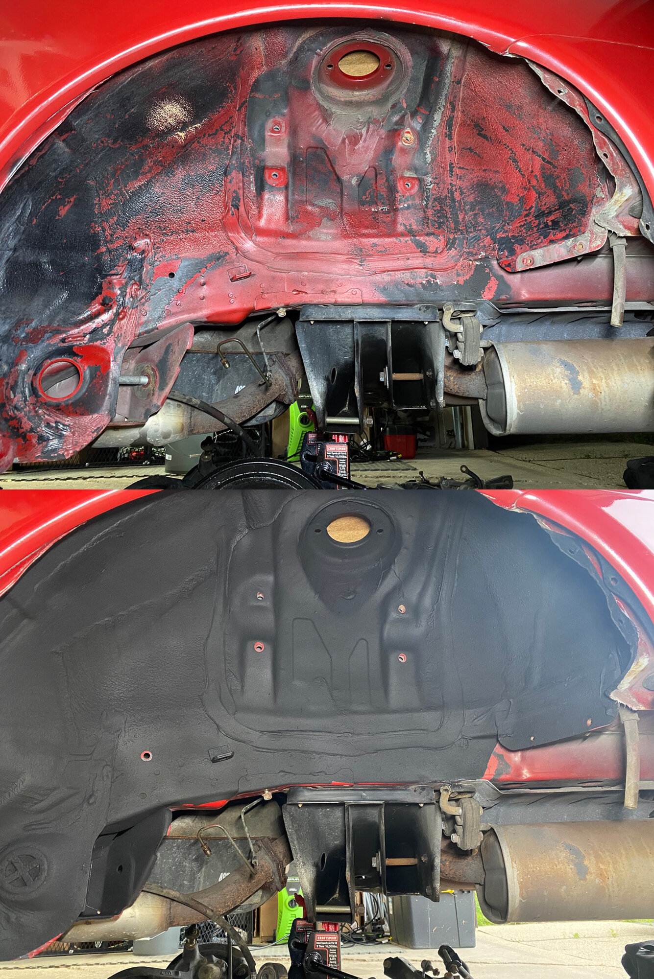

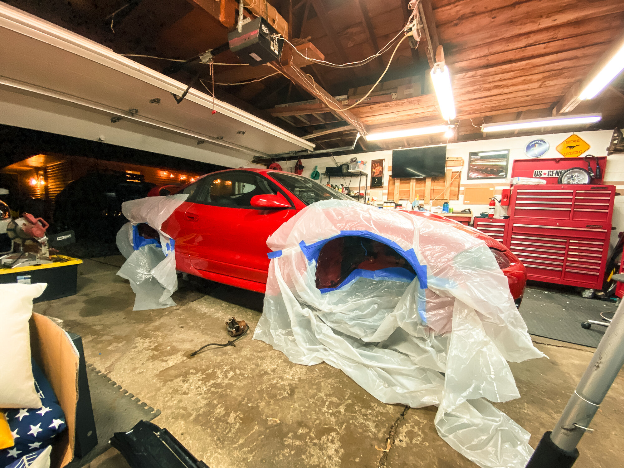

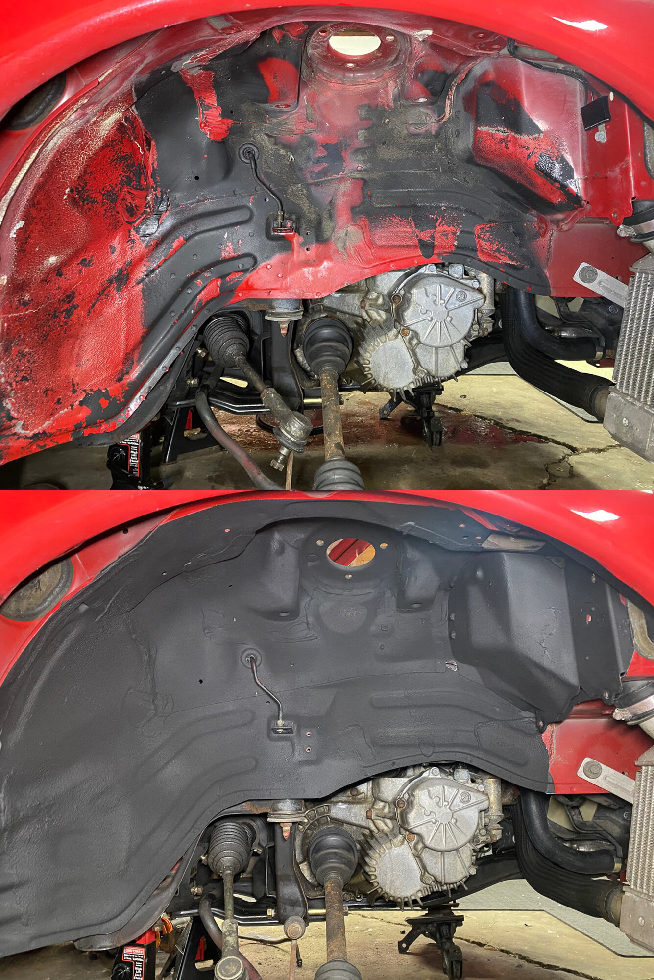

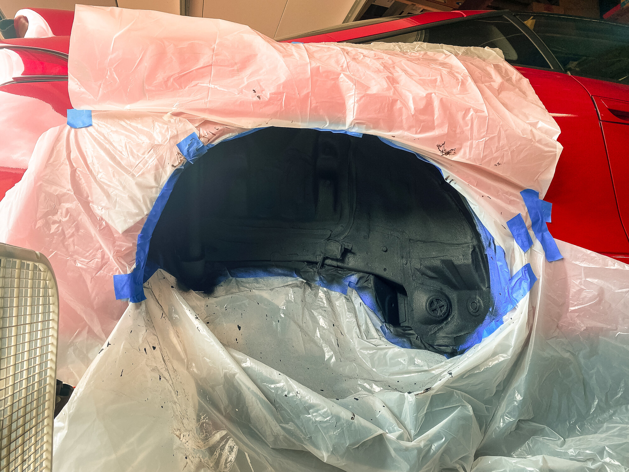

After doing the prep work to all 4 corners, I began the literal worst part of the entire thing, masking. Anyone who has painted before knows that while it sucks, it makes all the difference to spend the time prepping and masking correctly. Car went up on all 4 corners and was masked.
The process is super simple, nothing special about it. The prep and masking takes 10x longer than the actual spraying. The key is to make sure you are consistent and spray it evenly. I chose not to do the entire underside of the car. If I had a lift I would have done the entire underside, but on jackstands it just wasn't worth it.
Some before and after pics after completion.
With the splash shields still off the car it looks only partially finished, but all of the remaining uncovered parts are unseen once covered up. Besides picking black clumps out of my hair for the next week, it was 100% a pain in the ass project, and 1,000,000% worth it. 99% of people will never realize the amount of work spent when they see the car, but that is completely fine with me.

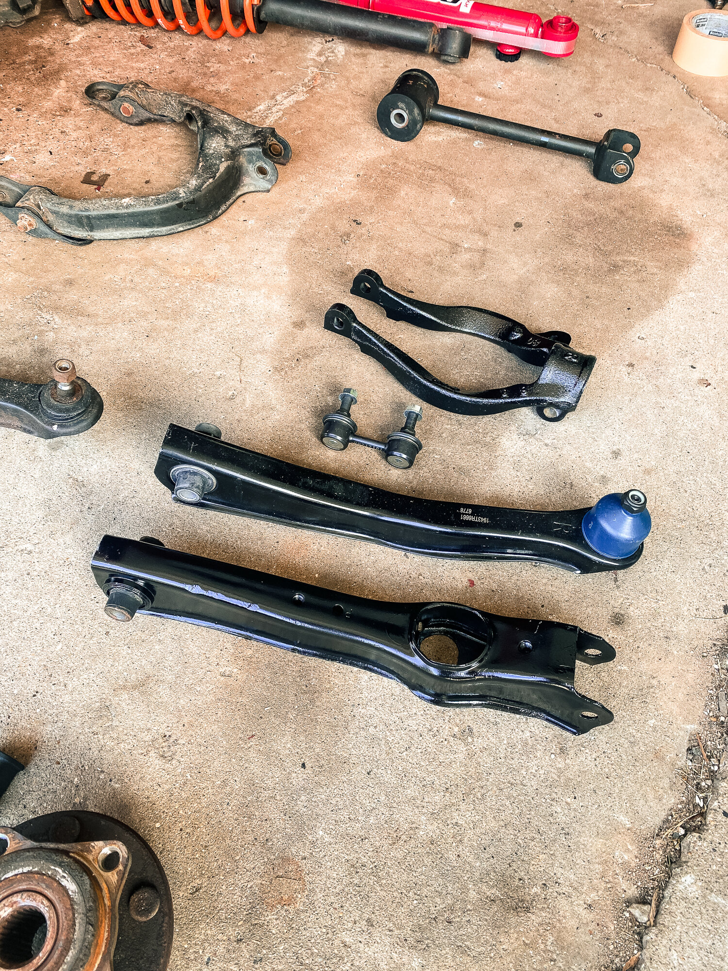

After the undercoating was complete, I moved onto the suspension and the remainder of the underside of the car. I cleaned up the splash shields as much as possible, and reinstalled those.

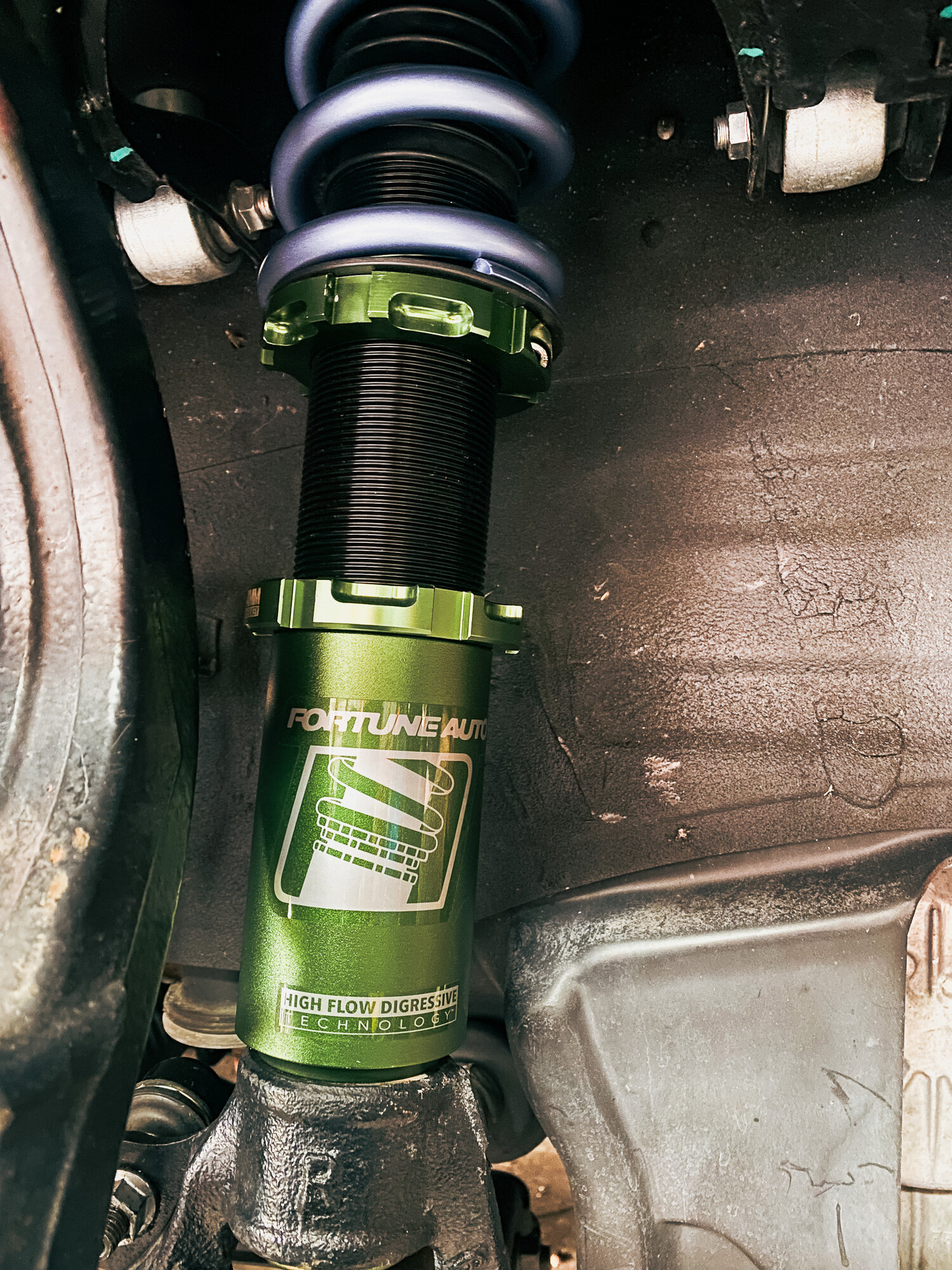

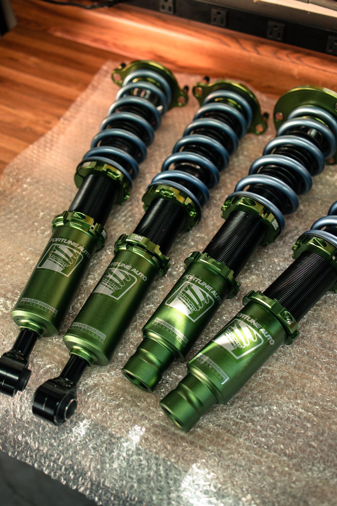

I then focused on installing all of the new suspension and steering components. Back in winter of 2021 I installed the lowering springs on the stock struts just to get the car low. Now it was time to transfer those onto the KYB AGX's that I purchase from Rock Auto at an absolute STEAL of a price. Or as I should clarify, what I THOUGHT was a steal of a price (a bit of foreshadowing possible???). I laid out all of the components new and old side by side and began the installation process.

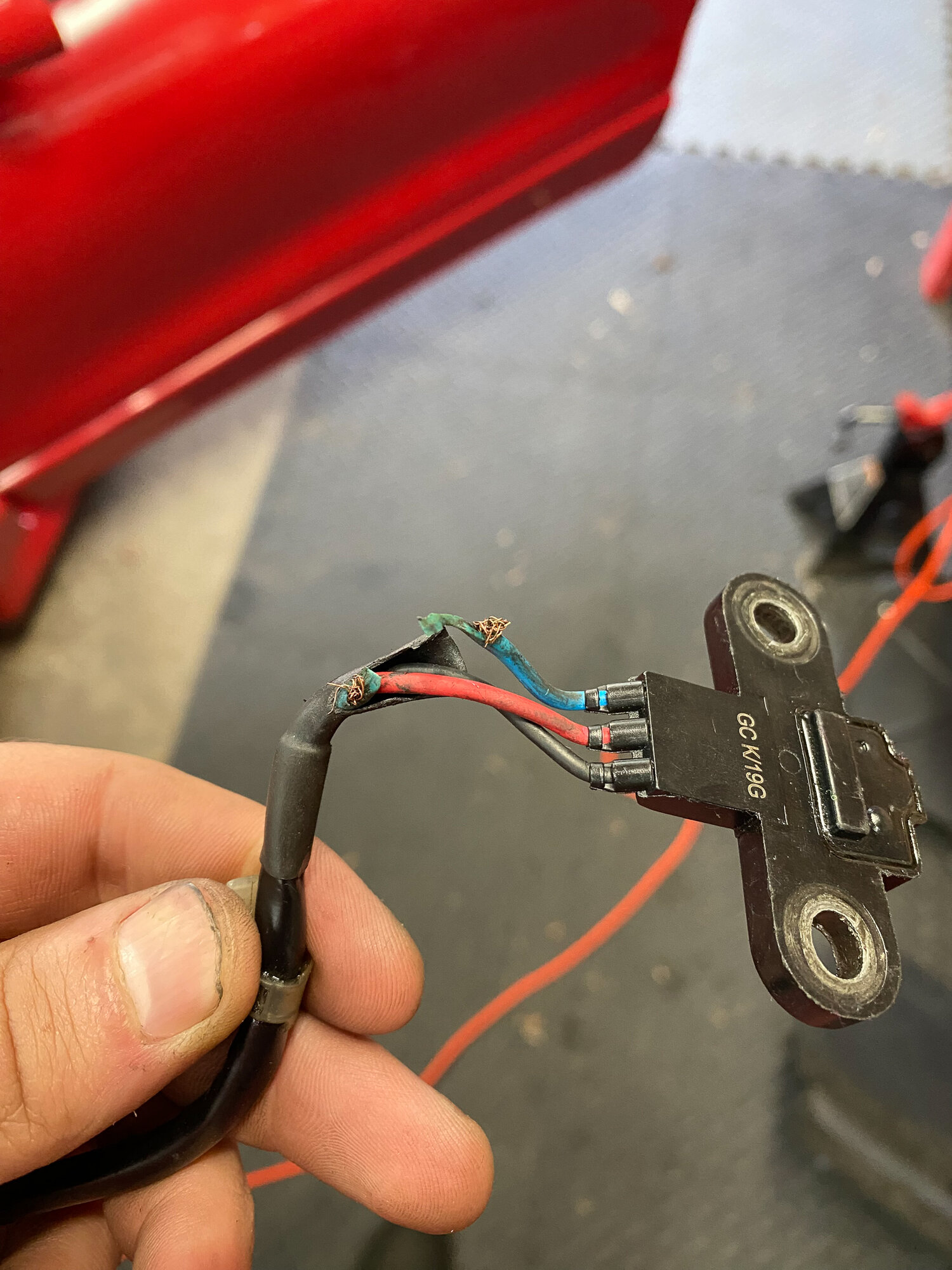

Driving down the freeway with cruise control on, and the car completely shuts off. Reacting immediately, I push the clutch in and coast to the offramp a few hundred feet ahead of me. As I sat there and tried to diagnose the issue in almost 90* temps, I was stumped. Begrudgingly I called my buddy Stephen and asked him to come grab me.
A DSM in it's natural habitat.

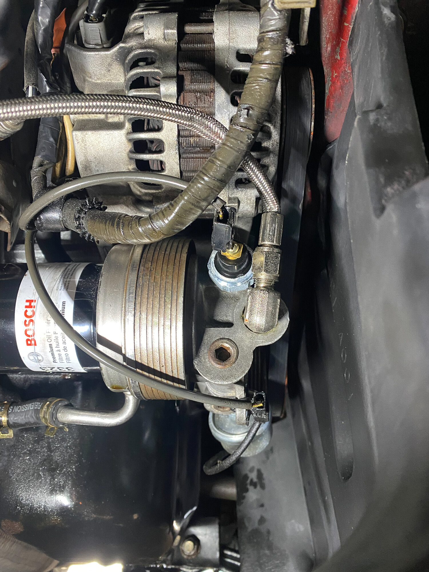

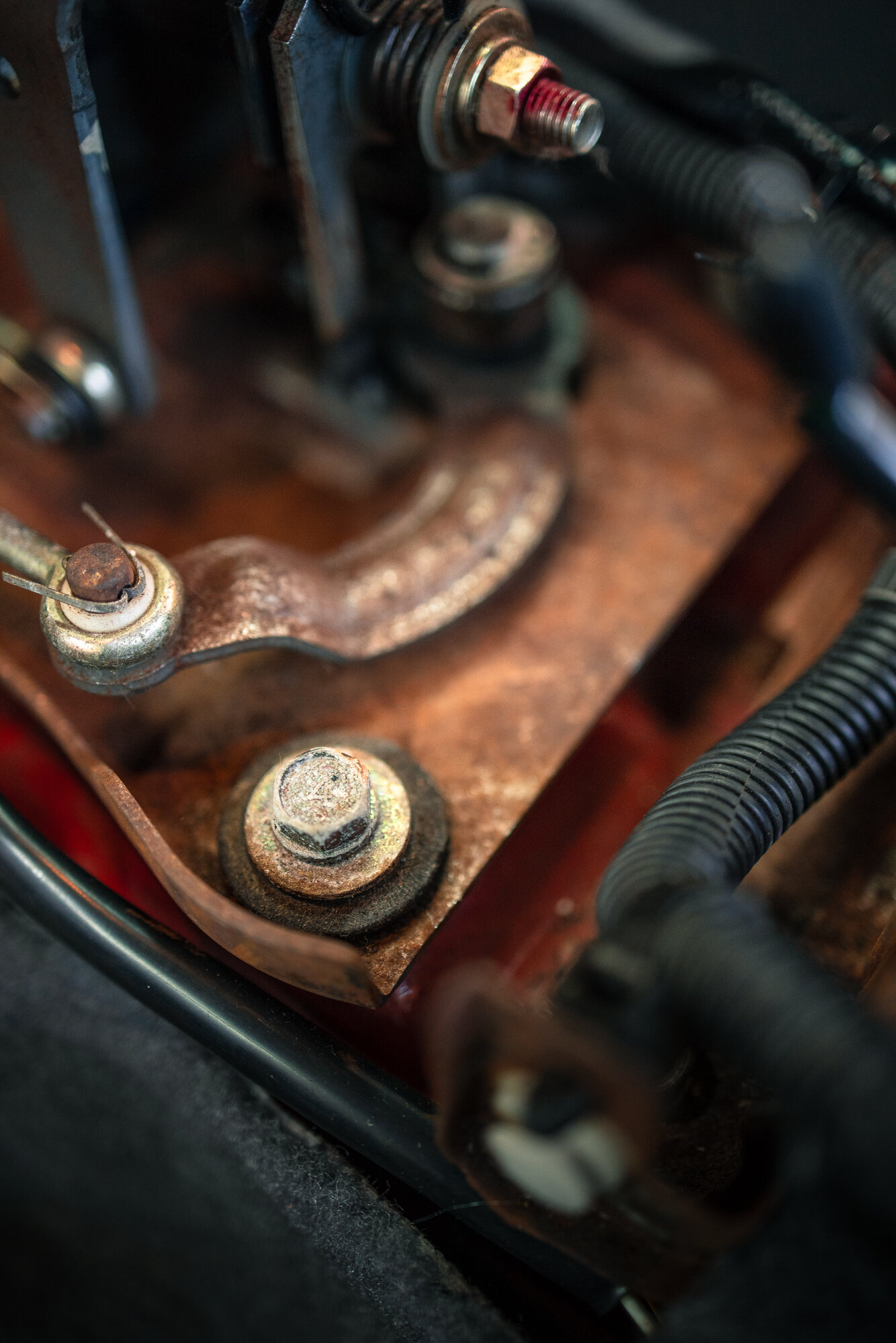

When I got home, I began digging into it more. After borrowing a better scan tool, I realized that there was no crank position reading. Odd, but the data was clear. I dug into it and found this.
It turns out that the wire itself came lose from the valley that it rests in, and just got cut by the belt. The belt itself looked absolutely perfect, so a new sensor was ordered and installed. Car started right back up and all was good to go. I have been extremely lucky to date with the minimal amount of issues to arise, but you can't really expect perfection with a 20+ year old car, regardless of how much you try to prepare.

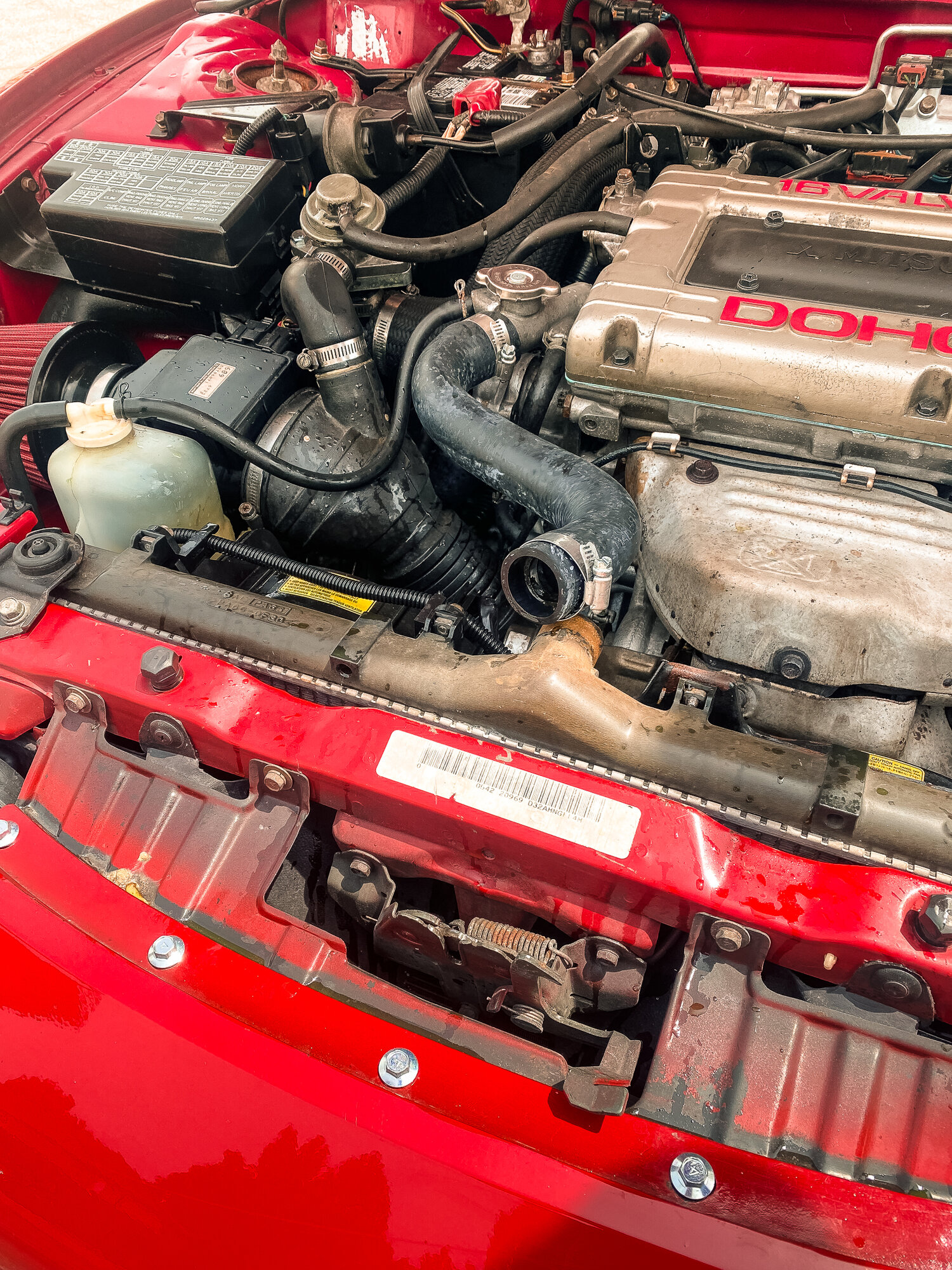

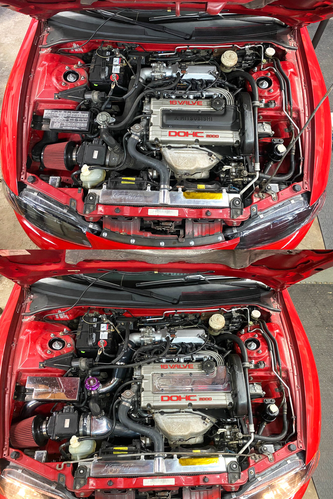

Remember how I said the installation of the aluminum radiator was a turning point for the car? That lead me down the path of sourcing some polished components. The engine bay no longer looked stock with that radiator, so I figured I would dress it up with some period correct pieces. The additional induction noise of the piping and Greddy BOV would certainly be enjoyed as well. I swapped them on to see how I would like it.
Before/After:

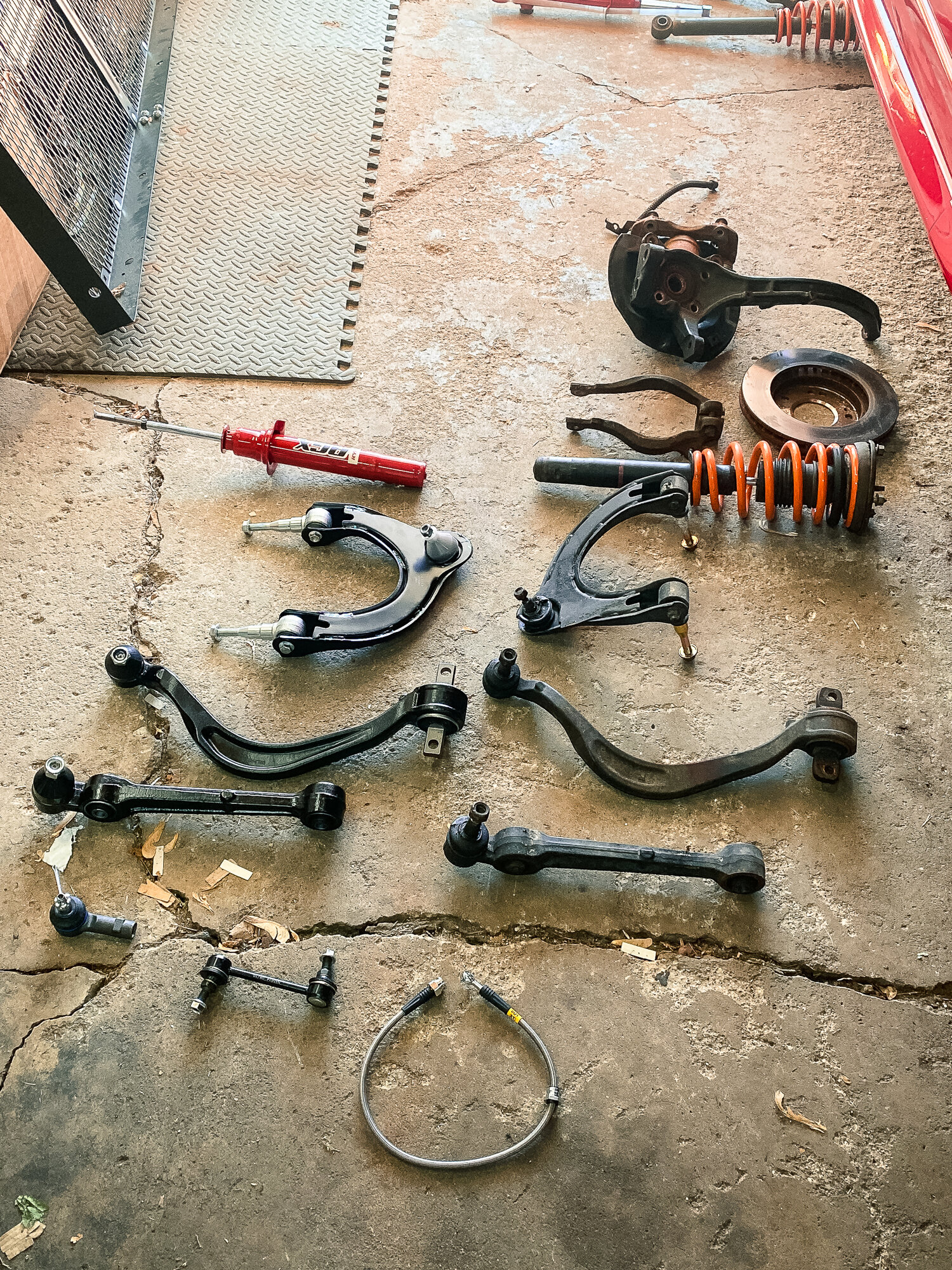

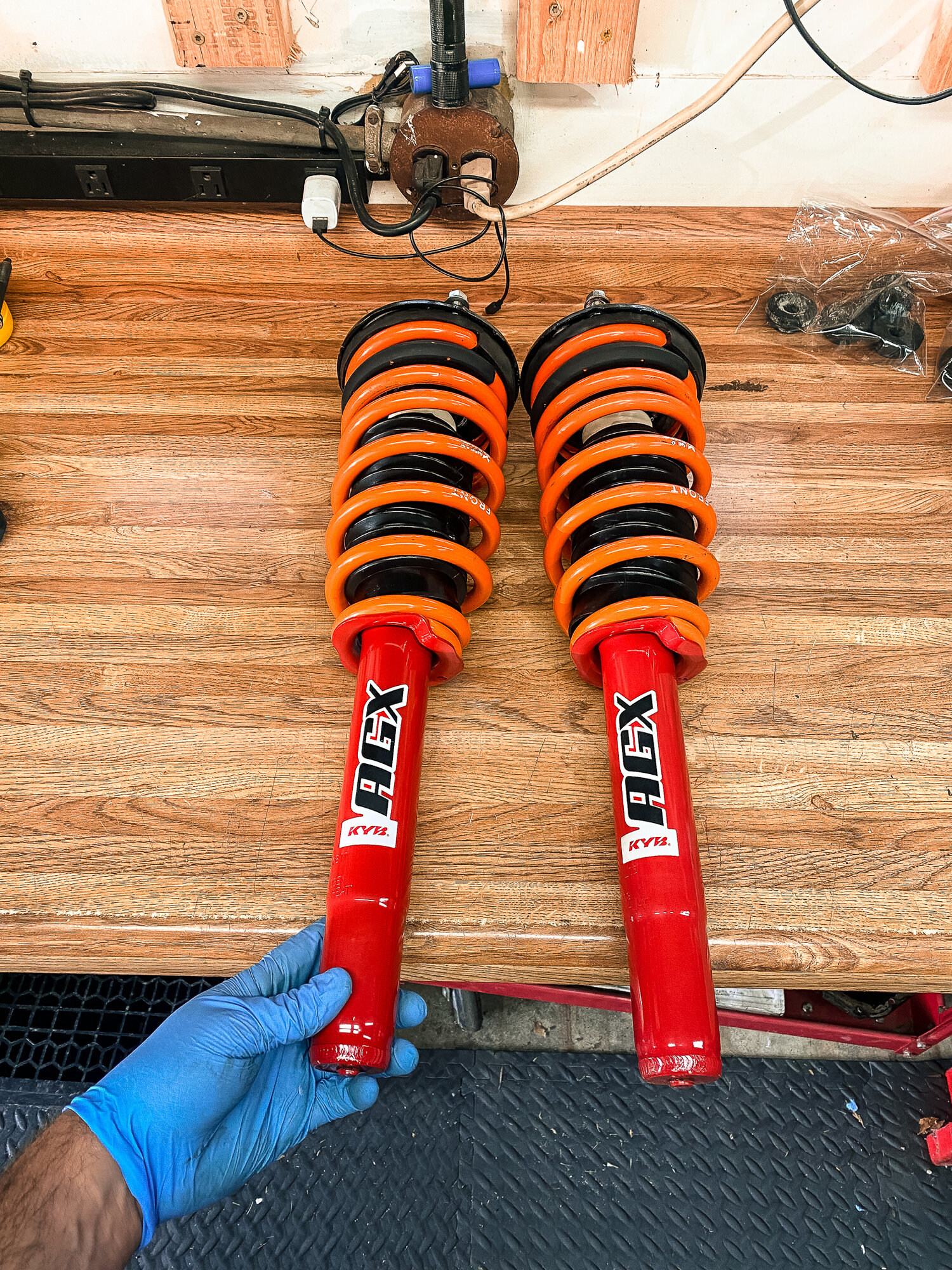

First up was the suspension. Over the winter I spent some time diagnosing the issue by Cook. After pulling some components off the car, we had identified the issue, a completely blown rear suspension. Those AGX's shocks were basically fully blown. Honestly I can't remember if they were bad right out of the box, or if they blew pretty quickly after installation. All I know is that those ridiculously cheap AGX's from Rock Auto came back to bite me. Honestly I was happy with the ride quality of the Megan springs on those, but obviously being blown compromised the car. Instead of ordering a new set of AGX/s and risking the same issue, I decided to go the coilover route. I was beginning to drive the car harder and harder, and figured it would be nice to have some extra adjustability. I did some research and ended up choosing a set of Fortune Auto 500's, and put my order in during winter. After an initial issue with some miscommunication, the customer service was absolute top notch. I couldn't recommend FA enough with helping me out, and I was excited to get them installed and see how it changed the car.

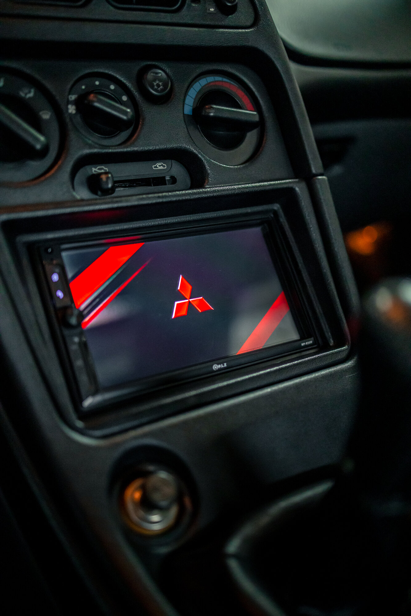

While I was working on the suspension, I also took advantage of the opportunity and got a bunch of other details addressed. First up was a new antenna. Since I bought the car, it had the base, but the motor was missing. After trying to decide what to do, I ended up choosing a micro antenna from Amazon. It does end up sitting at a bit of an angle ,and fits "inside" the OEM base, but it looks better than what was there before. I'm happy with this solution for $15.

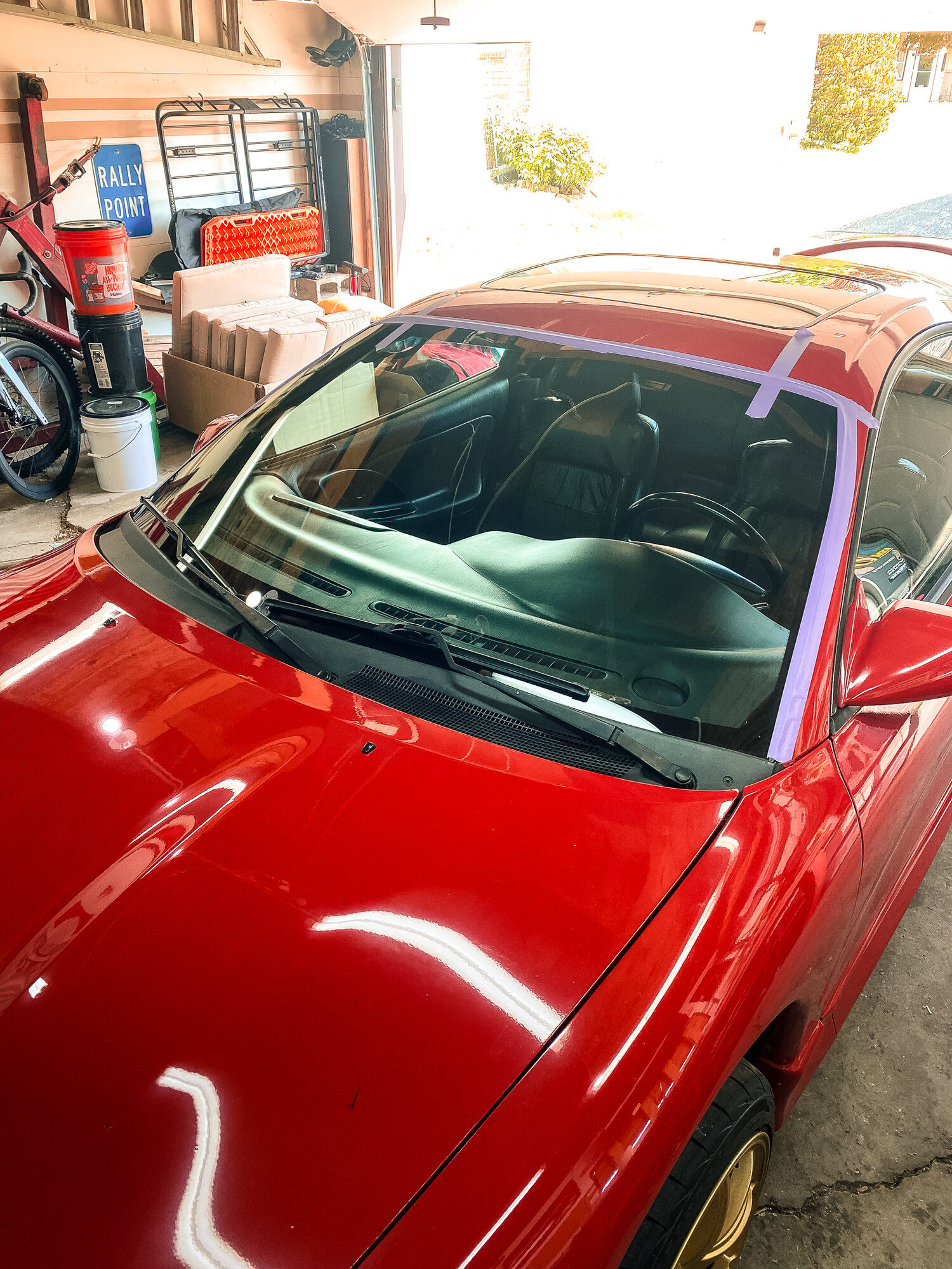

Next up was a HUGE improvement in my opinion, a new windshield. In my opinion, nothing improves the driving experience like perfectly clean glass. The original windshield was hugely pitted and scratched, and I knew 2g windshields were getting harder to source. I bit the bullet and $400 later I had a brand new windshield. Honestly, maybe the best $400 I spent on the entire car.

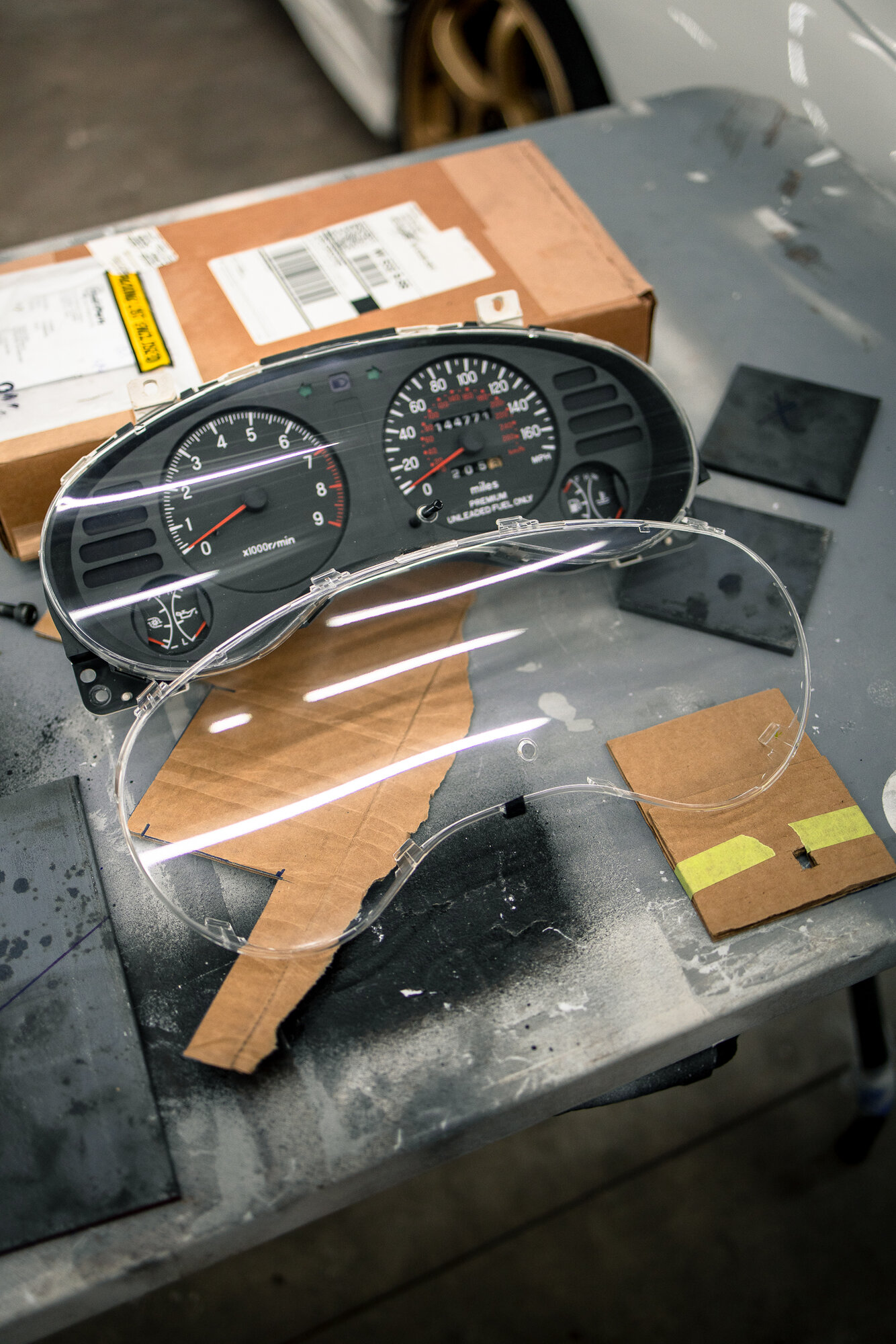

And here is where the little details REALLY bring the car to life. First I started with a new VIN plate made by the one and only Jason.

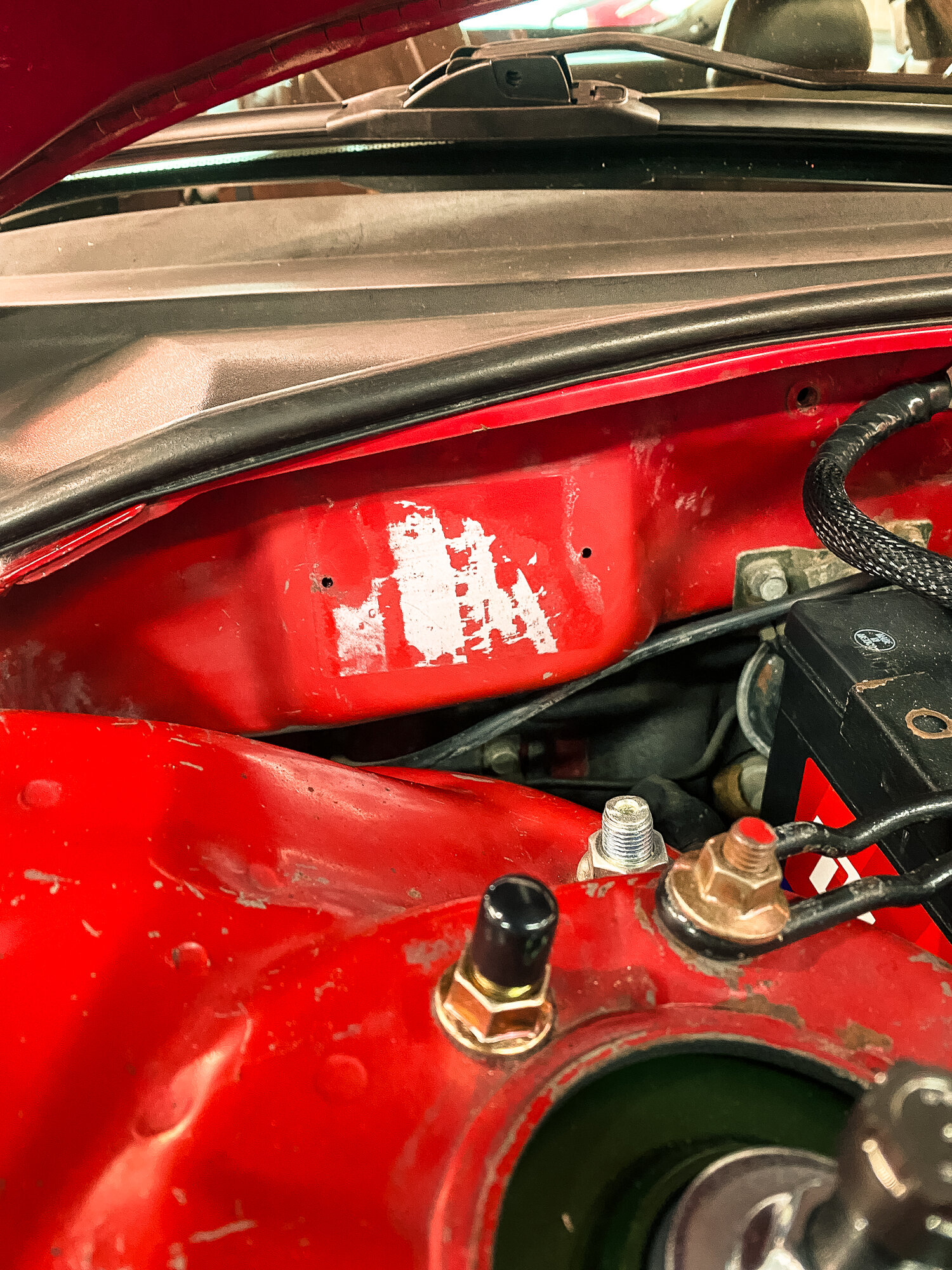

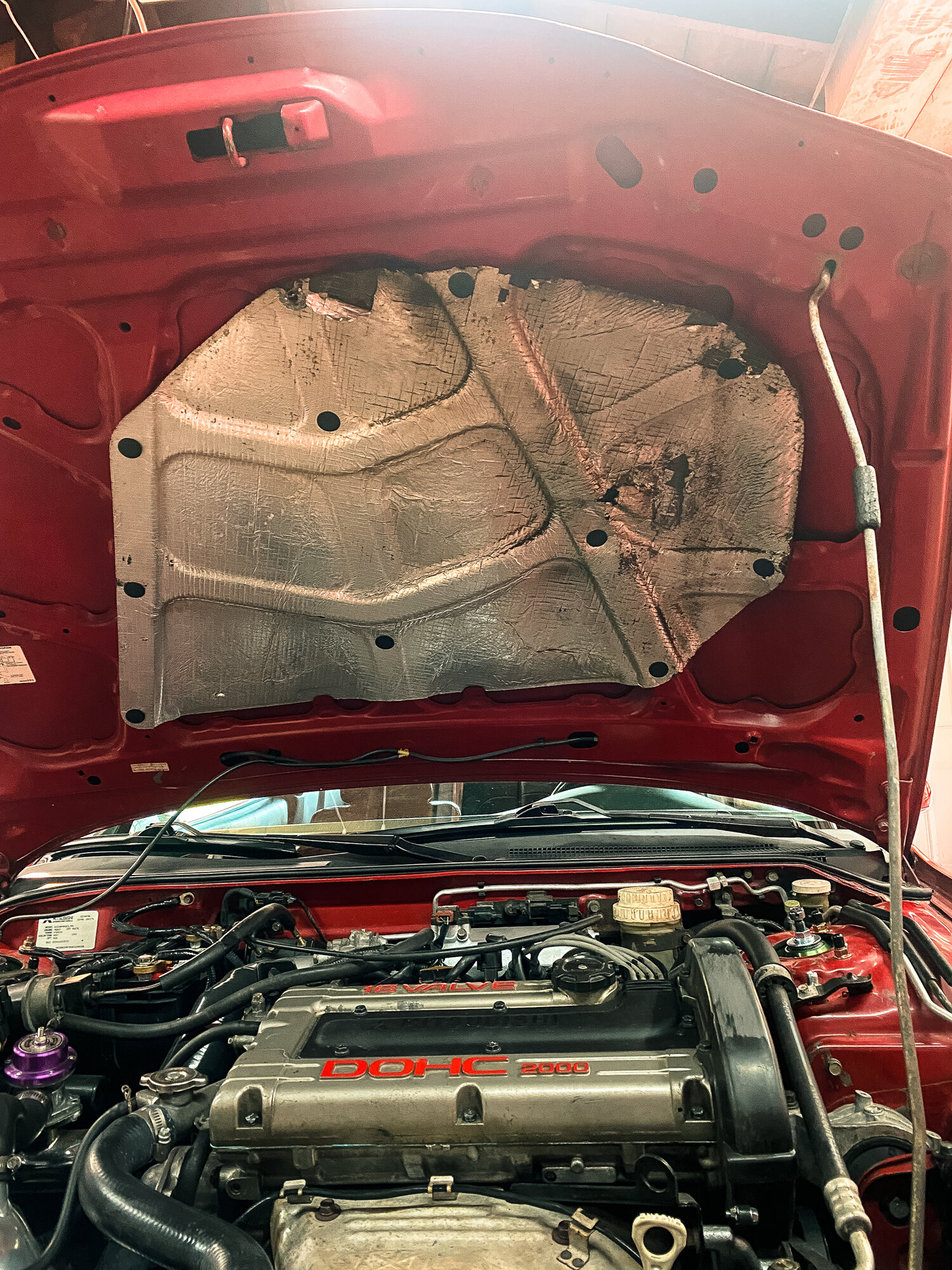

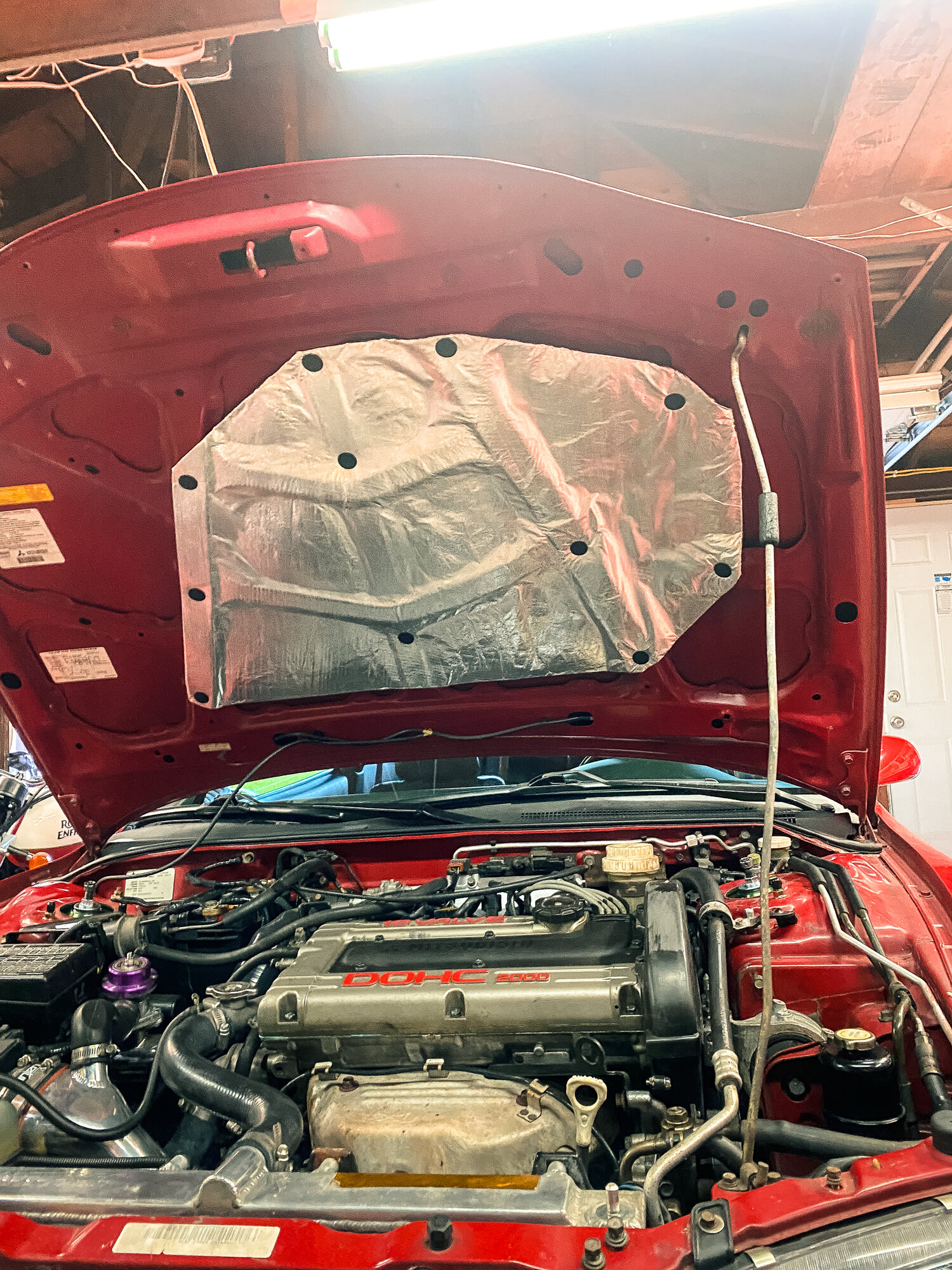

I could not find a new heat shield for the hood, so I redid mine. I used a thin layer of sticky heat barrier and stuck it right over the existing material. Obviously I cleaned it the best I could to get all oil residue off, but the right side (Timing belt) obviously threw oil over the years. That side unfortunately did not stick perfectly, and it was tough to get the elevation change, but for $15 and some scrubbing, it came out as good as I could expect.

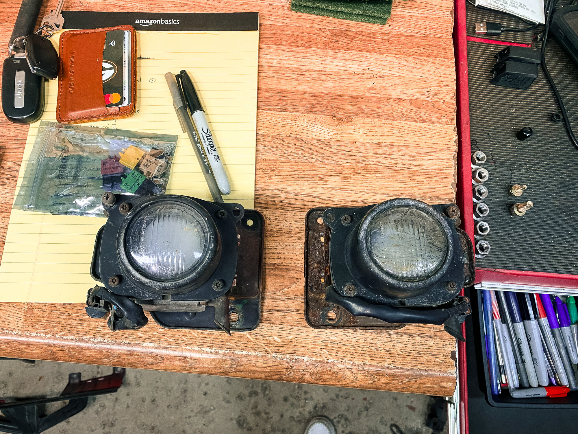

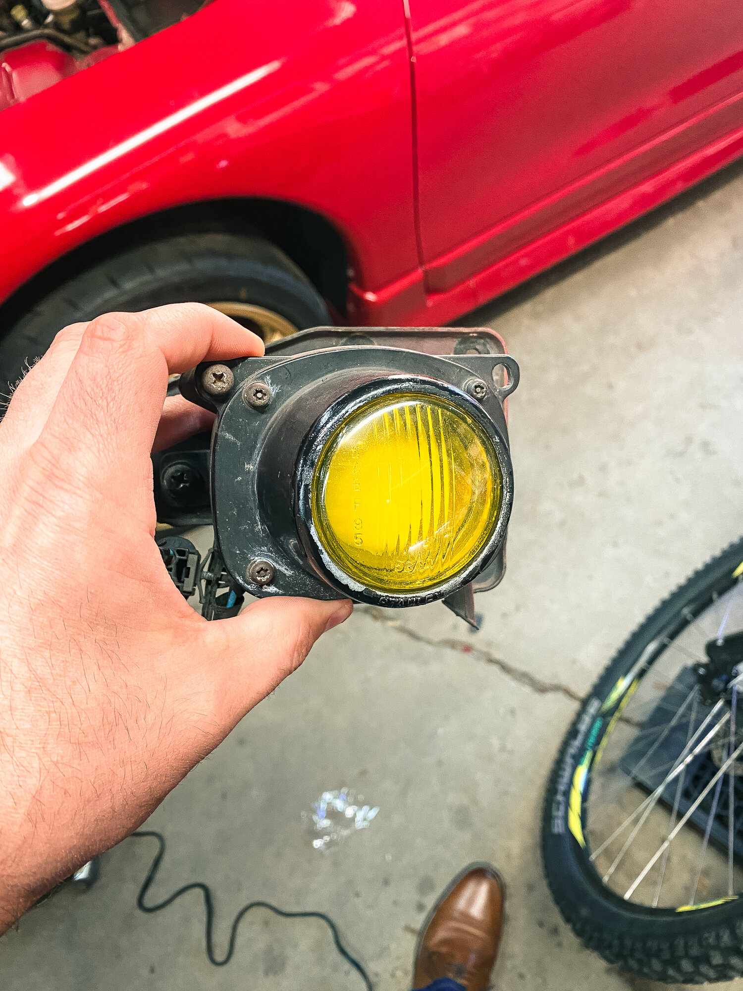

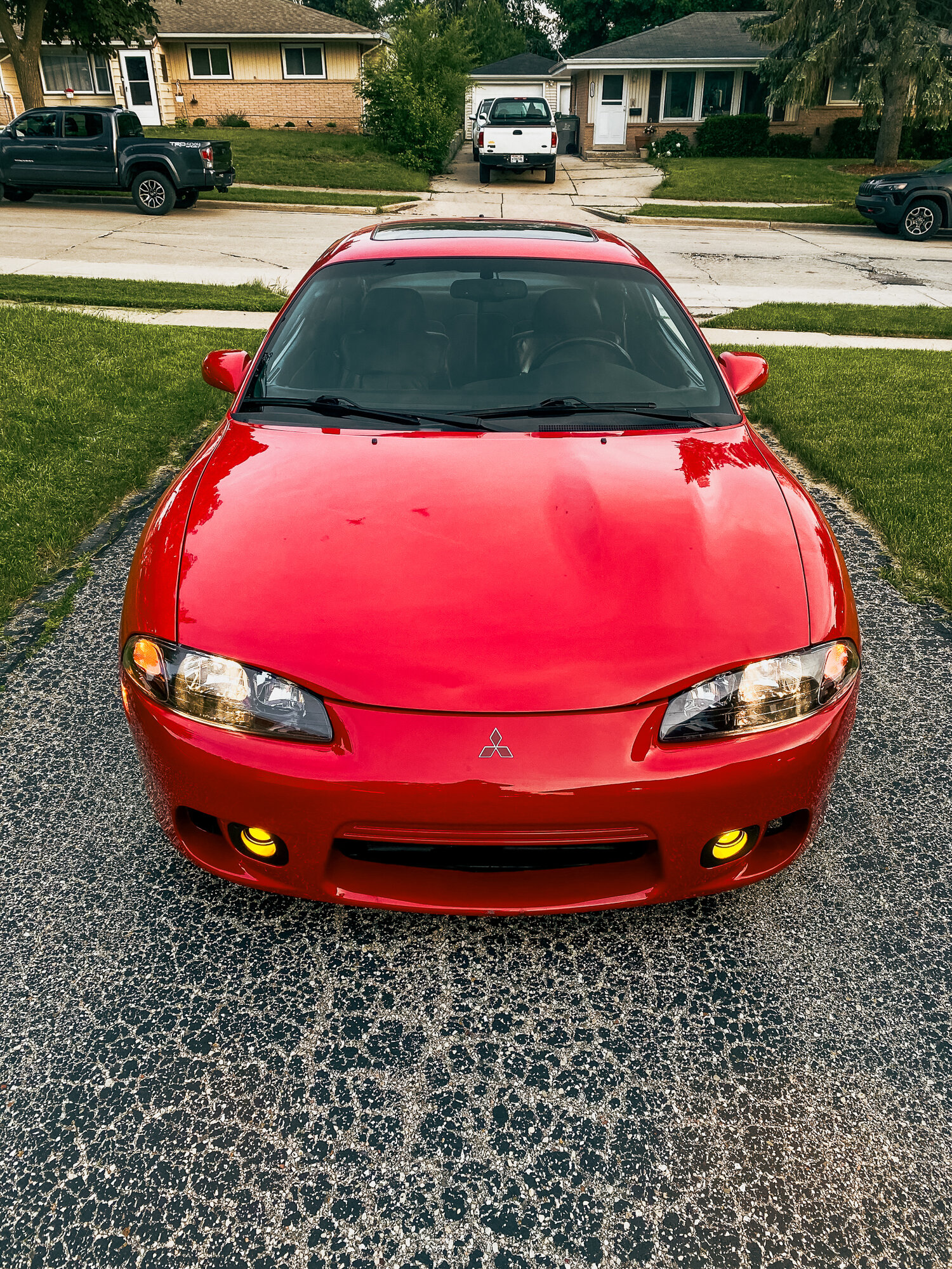

I then focused on the fog lights. Previously they weren't working, so I had taken them apart and cleaned them, and reconnected the ground nice and tight. This fixed the fuse blowing issue, and everything was good to go. Growing up on JDM car's in the 2000's, yellow fogs are a way of life and this was no different. I decided on a set of halogen yellow bulbs, and then a layer of yellow Laminex over the top. I wanted to stay away from LED's on this build, and wanted the lights to remain yellow even when off. I then painted the outer ring with a fresh coat of black nail polish to increase the contrast. This setup created the PERFECT amount of yellow light and tone. The yellow against the red is one of my favorite little aspects of the front end. Maybe one day I will take them completely apart and rebuild them brand new, but for the mean time they look perfect from 5 ft.

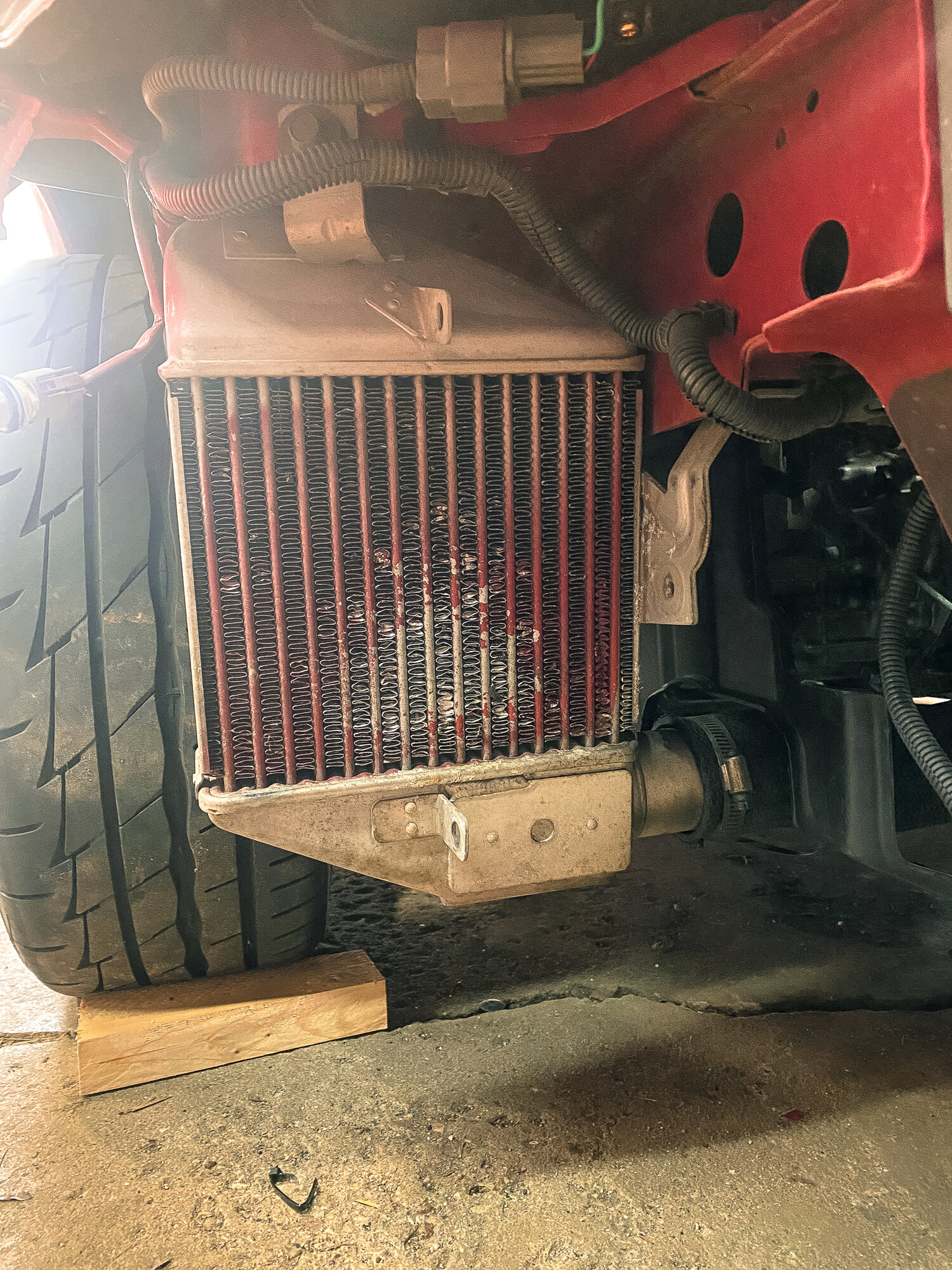

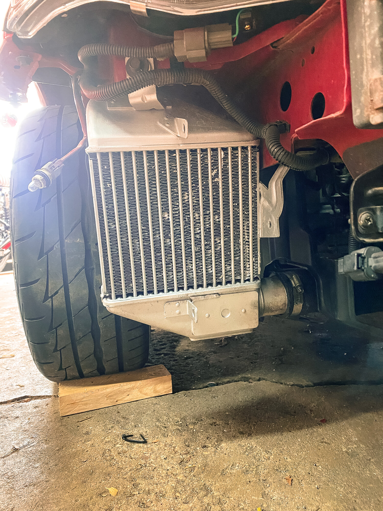

The side mount intercooler had a tremendous amount of overspray on it from the repaint before my ownership. While you really couldn't see it, I wanted to clean up as much as I could. I pulled it off and painted it with some fresh silver radiator paint. I also did my best to try and straighten the fins out, but that proved infuriating and I gave up pretty quick.

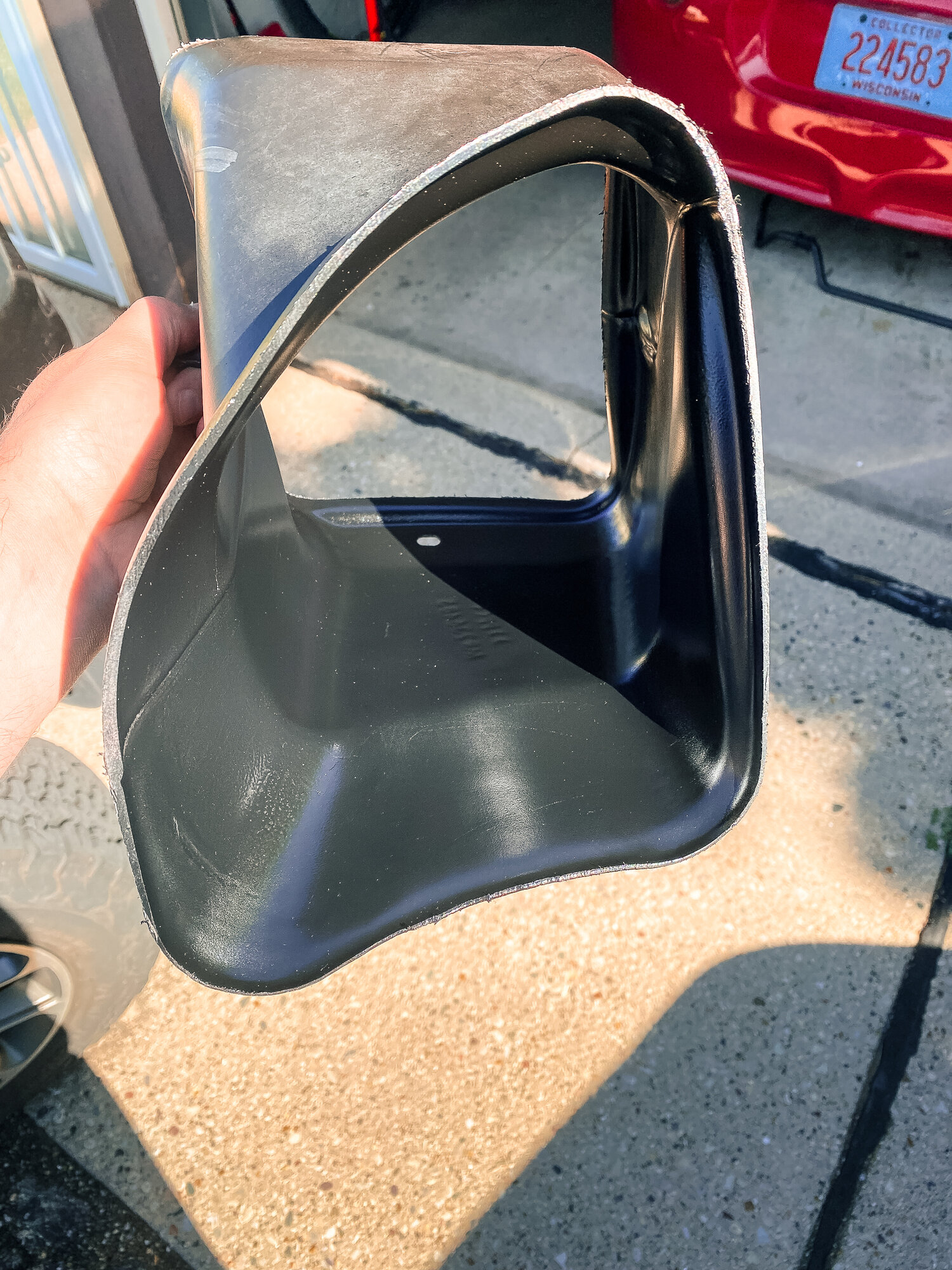

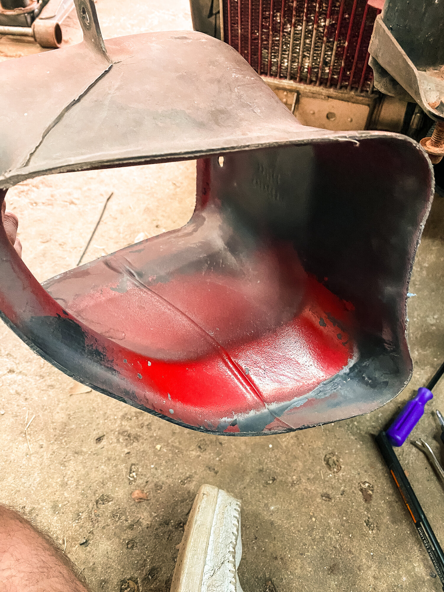

Working my way around the front end, after the SMIC was the ducting. I scuffed that up and shot it with a fresh coat of black.

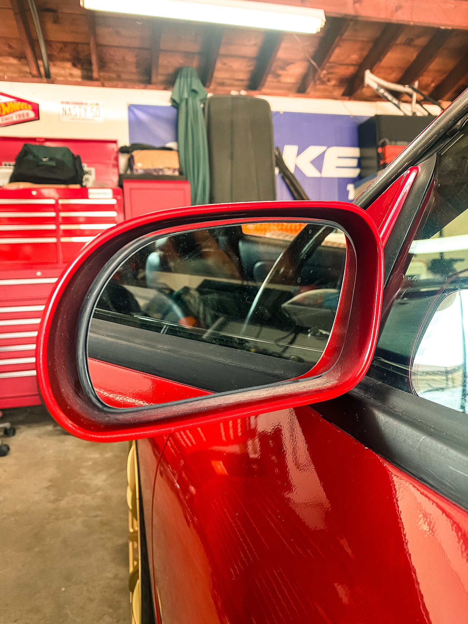

In addition to the new windshield, I wanted new mirrors. Not wanting to paint a new set, I found these stick on mirrors that go right over your existing glass. I added a set on both sides of the car, and the difference just takes it over the top. Not shown, but I also replaced the rear view mirror with a much more fresh mirror purchased used. The entire view out is now perfectly clean, like a new car. This completely livens the car up, and if nothing else, I highly suggest everyone do this to their long term projects.

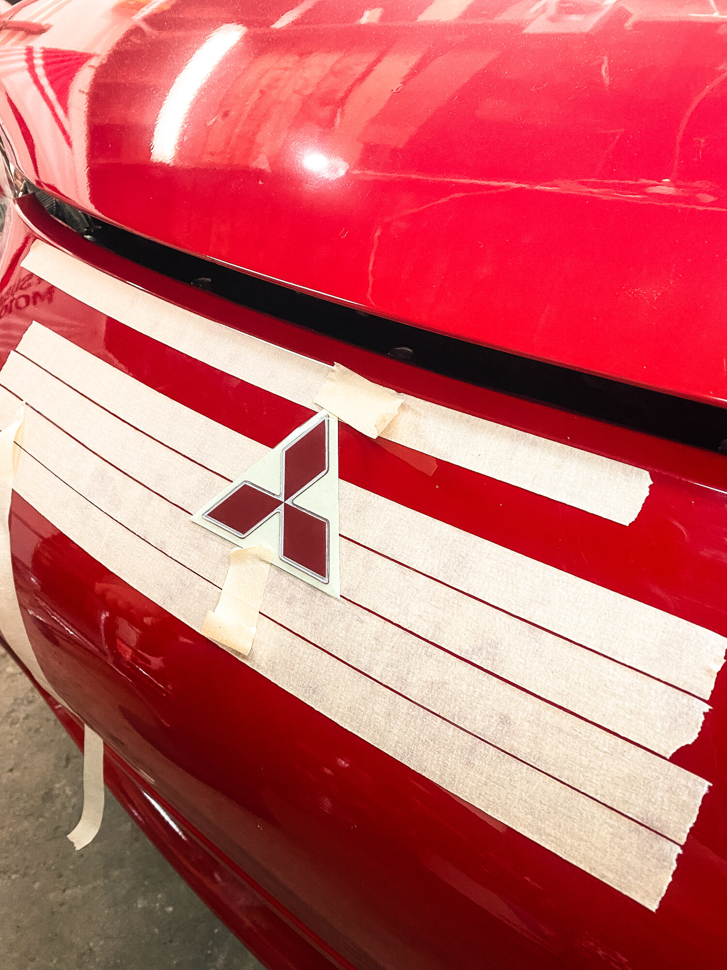

Last up, and most importantly, a new logo for the front bumper. Obviously the bumper isn't OEM, but without the Mitsu logo it looked bare. I decided on a 3000GT logo (MB814979) and had my buddy Ned install it. I am way to OCD to handle these small details myself, and would second guess the placement for the rest of my life. Better just to have him do it.

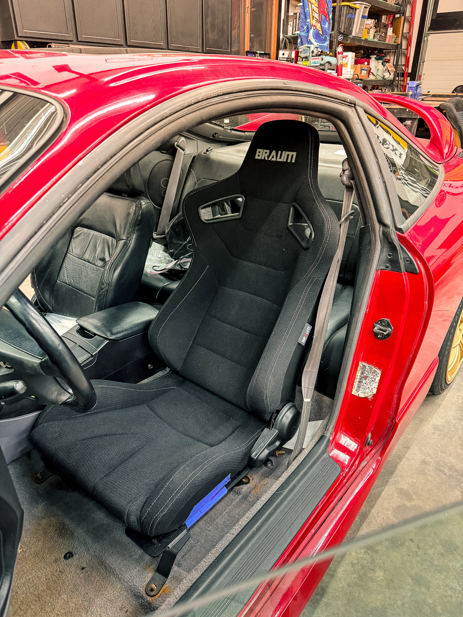

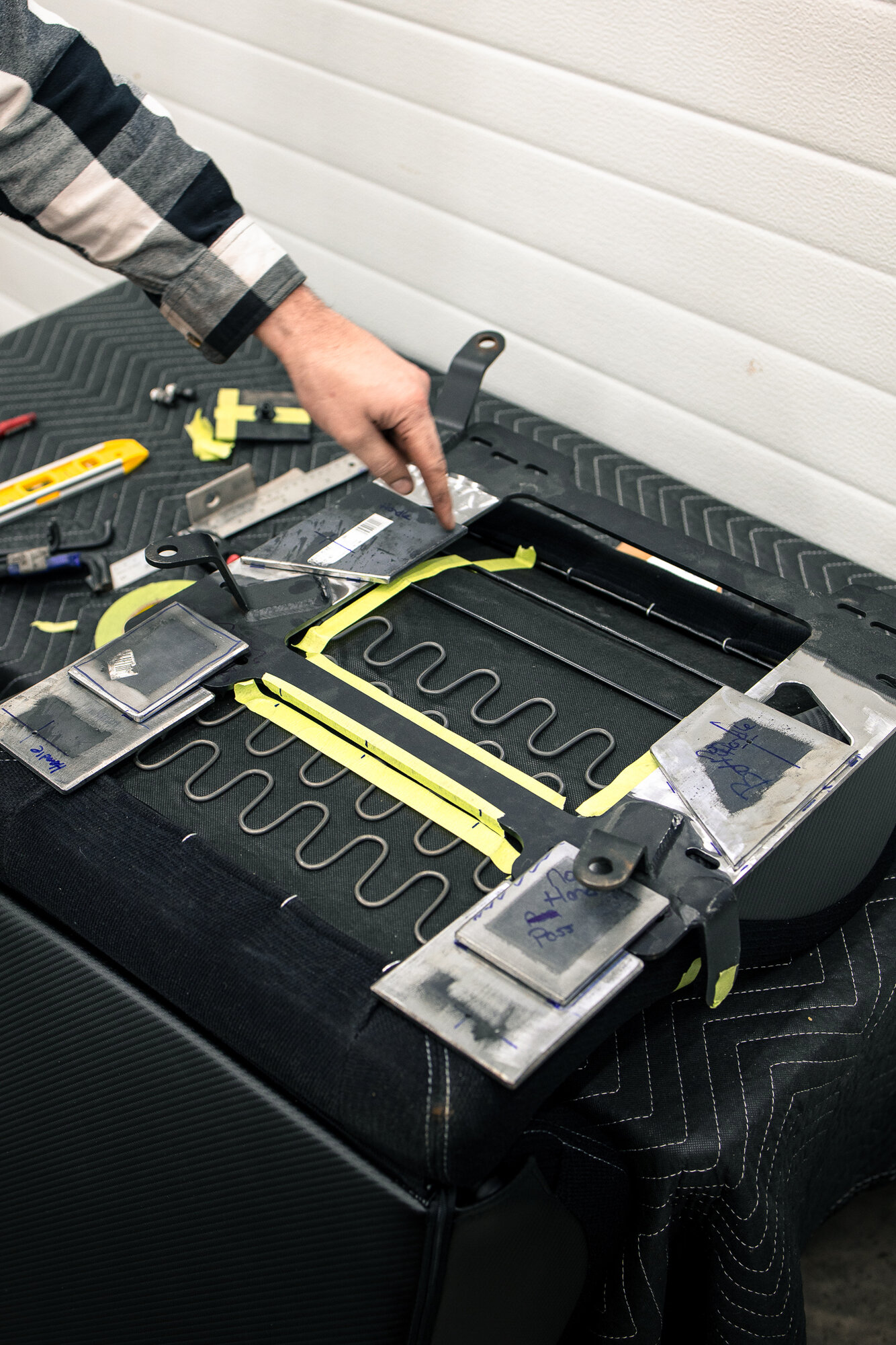

Over the years with the car, there has been one nagging issue. The seats. While I love the look, the driver seat has lost all support. Driving for more than an hour and my back begins to hurt beyond all comprehension. That Arkansas trip, while a blast, was absolutely miserable. It may sound extreme, but I have gotten to the point that if I can't figure out a comfortable seat solution, I'm not sure I will keep the car. I considered redoing the stock seats, but that is quite expensive to end up with a 20+ year old seat. Comfort has come a long way, and I'm only getting older. I had been eyeing up a set of Recaro Speed seats, but $2,500 on seats is a lot of money to drop not knowing if it would make me happy. I'm looking for comfort rather than bolsters, and that is tough to find in the small seat size we need, while also not looking completely out of place as most modern seats do (Looking at you Recaro Sportsters).
This summer was going to be the period to finally figure out a seating solution, and I caught a break. My buddy Stephen had a set of Braum seats he wasn't going to use. Knowing that I was so undecided about what to do, he threw them at me and told me to test them out. While Braum wouldn't be the long term plan, free seats are better than nothing, especially since it would allow me to confirm that getting a higher end seat would fix the issue. If these seats don't improve the feel of the car, difficult decisions will have to be made.

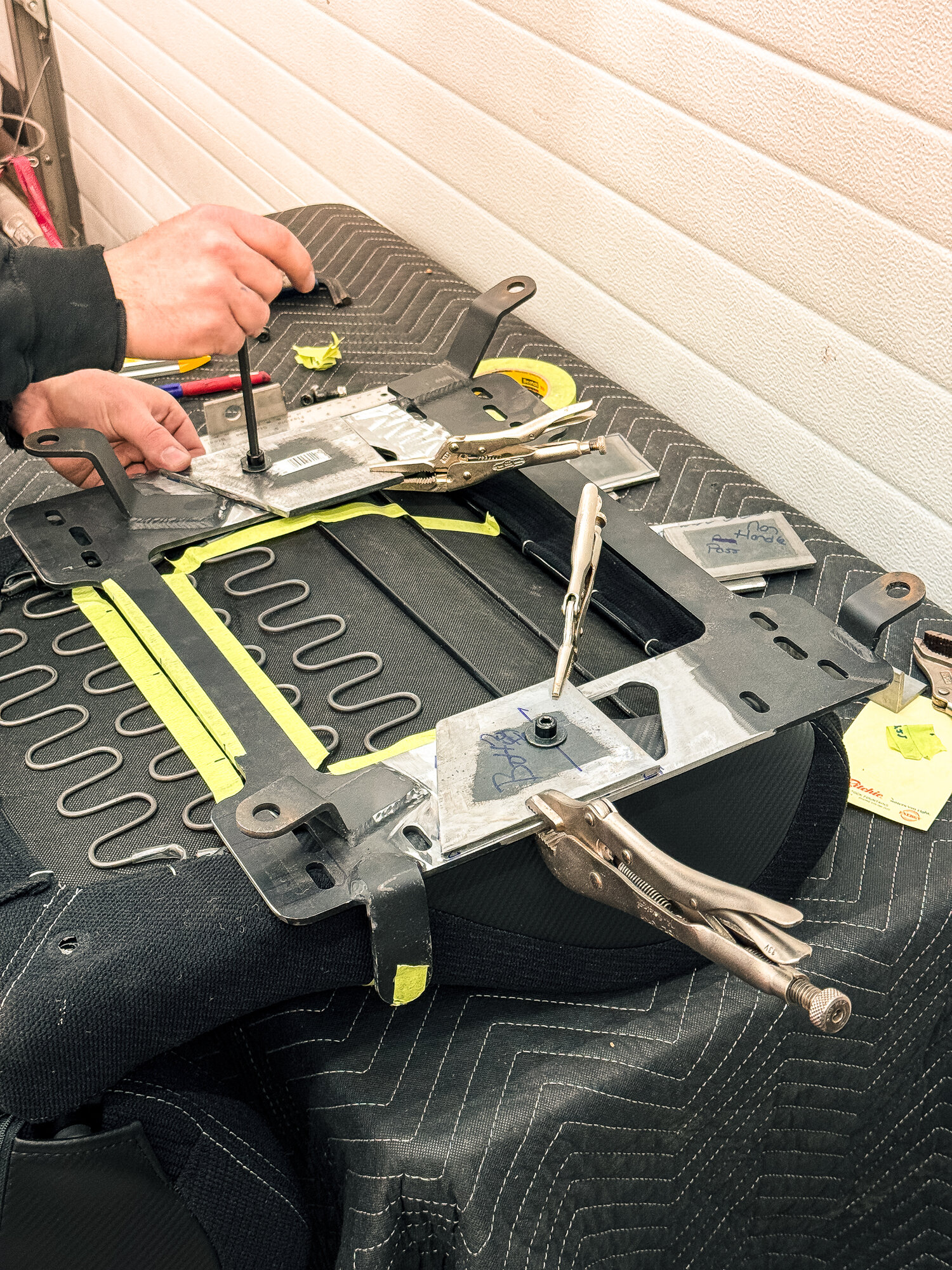

I went ahead and ordered a set of Planted seat brackets, and began the install. I was well aware that the sliders might be an issue, especially being over 6ft. We began the install and immediately realized it would not work. Using the Planted bracket, the sliders and the Braum seat, my head rested against the headliner and the steering wheel touched my legs. No matter how far back I tilted the seat, it just wasn't going to work. We proceeded to take the sliders out and install the seat directly to the bracket, hoping it would give me enough headroom. I was ecstatic to sit inside and have enough room to move around safely. All was good with the height, however we noticed another problem. Even with the seats mounted as far back as possible on the bracket, the steering wheel was in my stomach. After some measuring and using some wood blocks for bracing, we determined that in order to fit the seat, we were going to have to modify the bracket by adding metal to the back. We proceeded to rework the bracket to fit the seating position that I need.
Test fitting the seat.
Yours truly doing fab work (I have absolutely no idea what I am doing).
Modifying the brackets by adjusting the location of the front holes. You can see how far back the seat has to move. Initially the front seat holes bolt in the very front of the bracket. We are talking a good 8-10" rearward.
And the most difficult part of the process. The rear bolt holes ended up roughly 8-10" off the back of the bracket, and we needed to build support. We butted a piece of steel against it, and then braced it underneath with another. Knowing what I know now, I would not have bought the Planted brackets and simply built my own (Or bought cheaper ones and reinforced it myself). But now it is done.
We almost finished the fab work, but ran out of time. I sent the brackets home with Ned to finish the welding. In the mean time, I also swapped in a brand new gauge cluster cover, completing the view with new glass all around. It's hard to get a photo of it, but in person, it is a huge difference.

Lastly, it was time for my annual wheel fitting. This year was extra special, a set of OG bronze TE's. Unfortunatley they are a bit small, but beggers can't be choosers. I wish TE's at sub 9" had this concave face, but alas they dont. This setup looks so unbelievably good though, and gives it an aggressive look.
I also tested the new bronze that TE uses for the TE's. Just not the same IMO. These were also 18's though, which I think is more "street" style than the smaller 17" meaty setup in the first pics.
Before/After:

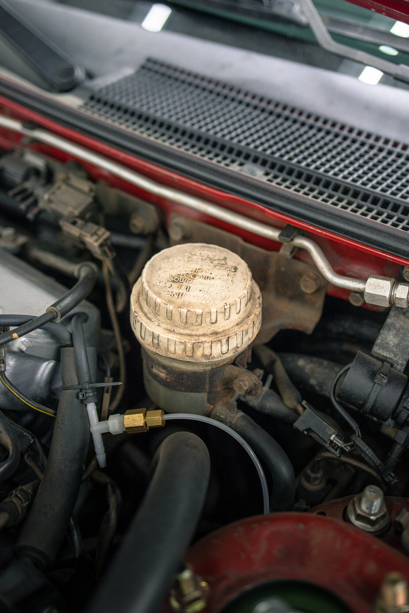

April 2025
I headed up to Cook's in mid-April to install the seats and bring the car home. I also took the opportunity to throw a few replacement parts to clean the car up.

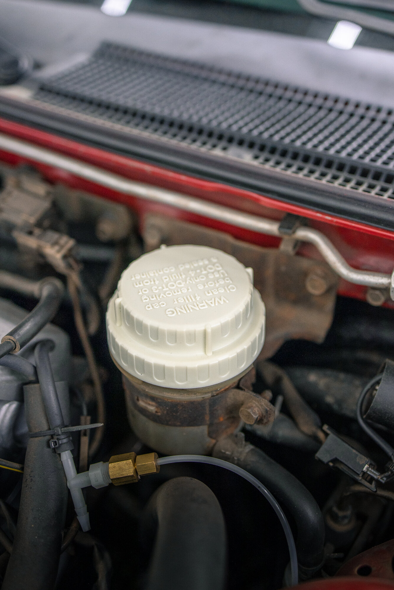

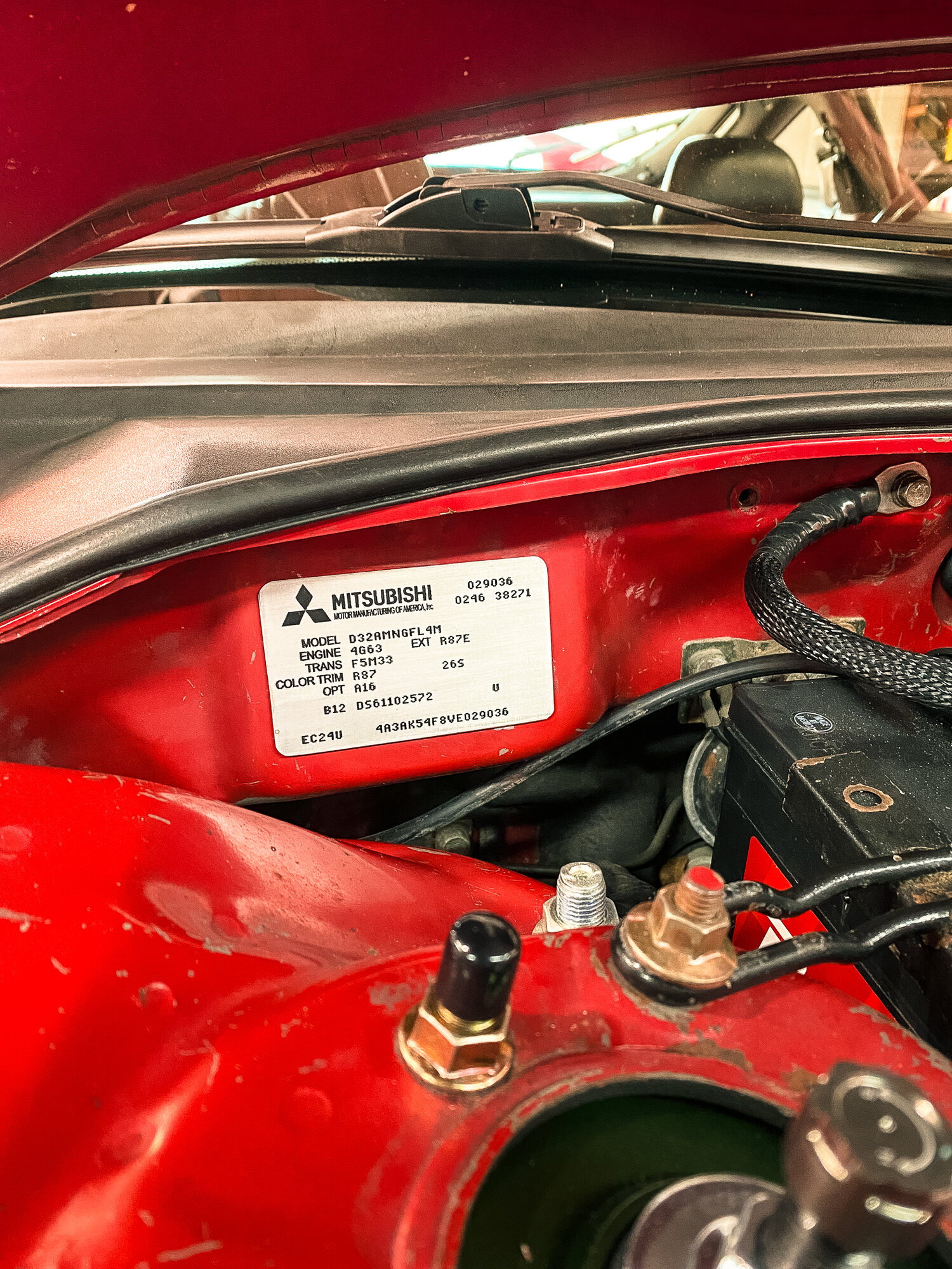

I still need to clean up and paint more brackets in the bay, but at least this cap looks much better.

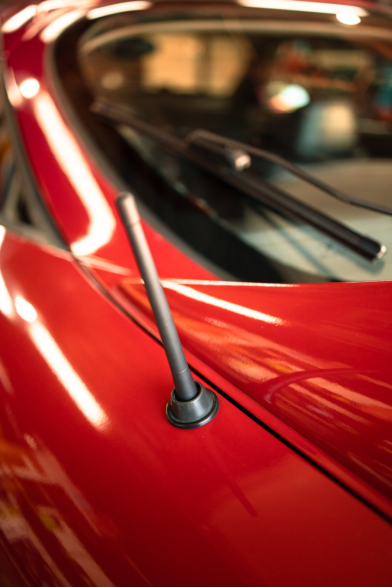

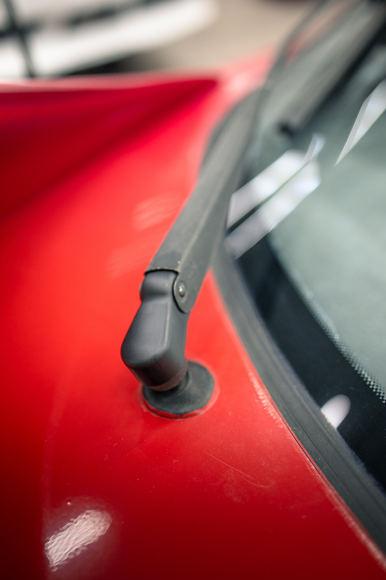

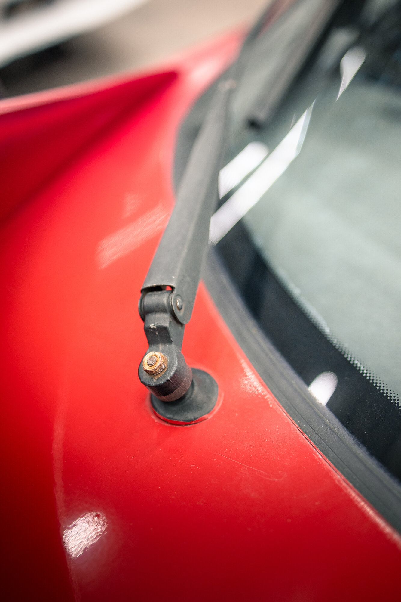

New wiper arm cap. Luckily this is a new OEM piece as it is the same as comes on the Montero's. I will be painting the wiper arms with SEM Trim black this summer. You can also see the horrendous overspray from somewhere in the cars past.

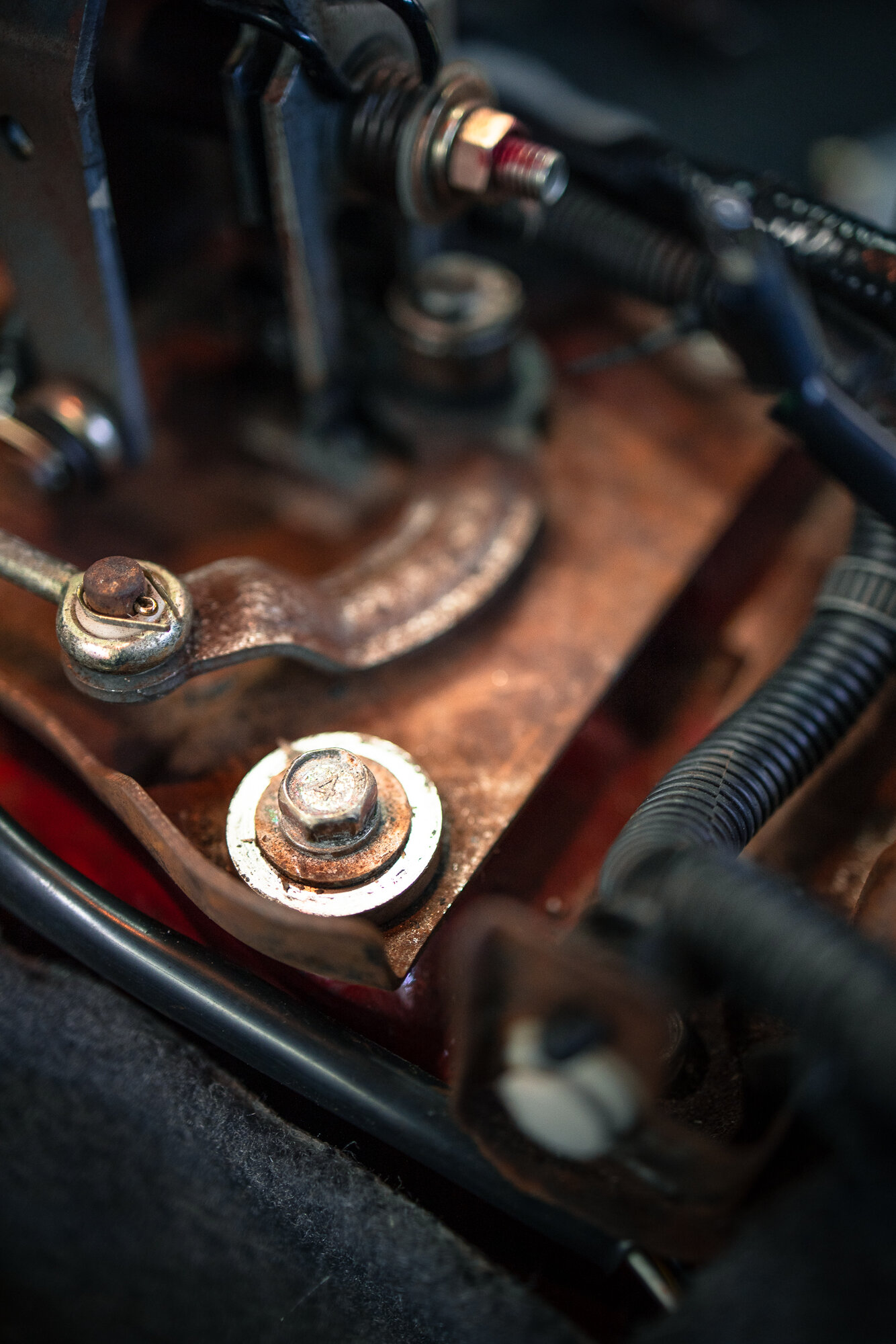

While rummaging around the garage, I came across an old set of solid shifter base bushings. Between these and the underhood bushings, it really tightened up the shifter feel.

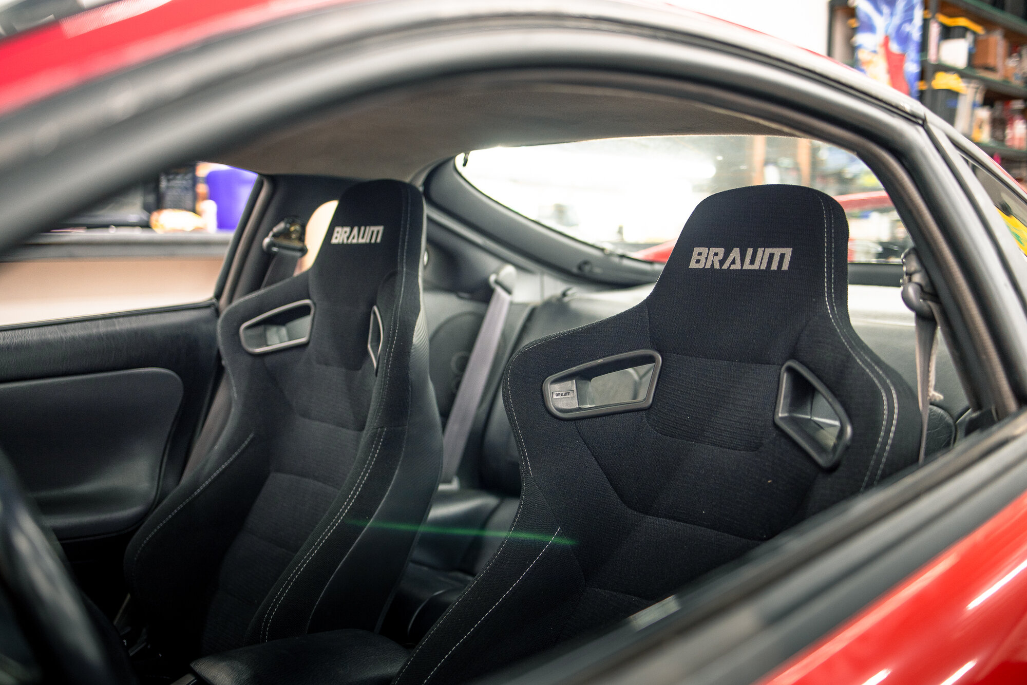

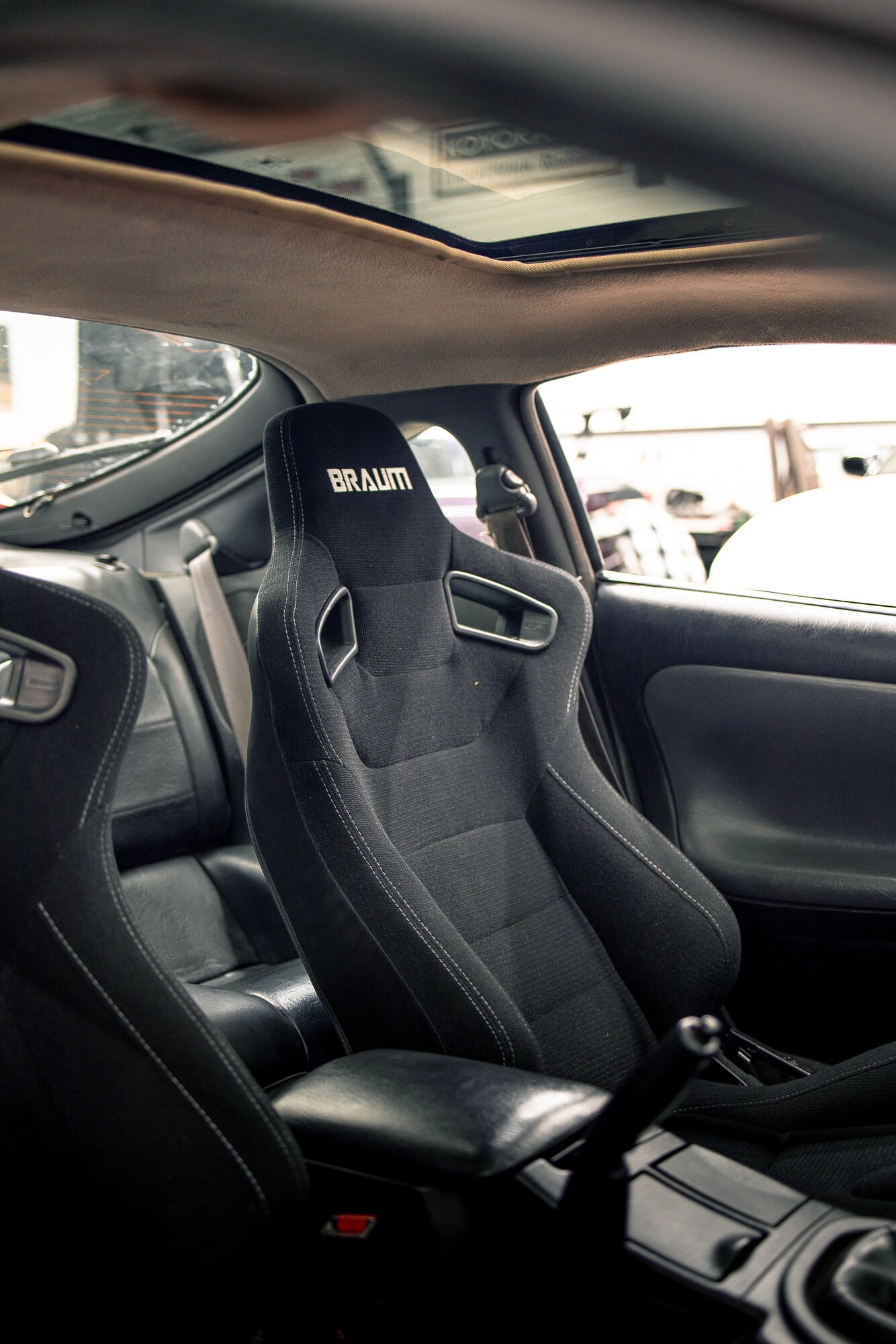

The big change was the seat installation. The brackets were finally painted and welded, and the install went decently smooth. The only issue we had was that the rear mounts now hung over the rear bolt holes, so you have to wedge your arm underneath to get the bolts in. To help speed this process up, I actually installed another stud on the passenger side rear of the driver seat. Seat install is now much easier. The seats are super firm, maybe almost too firm. If they had a 1/4" of padding on the top it would likely be the perfect amount of supportive with a cushion layer. However as they sit, they are much more enjoyable than the broken in stock seats. The bolsters hold you in more, and overall they just improve the "sporty" feel of the car. It definitely changes the overall feel of the car, which I will get into more later.
Overall, a huge improvement.

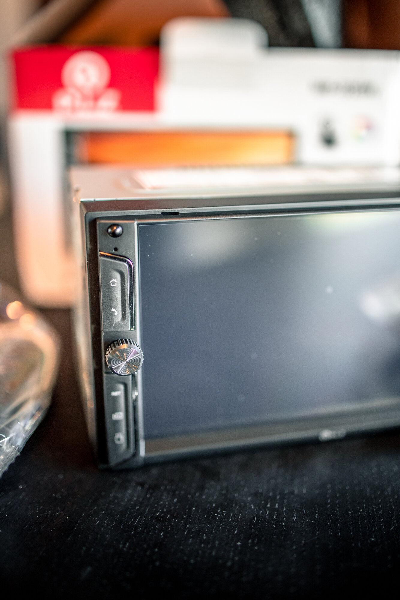

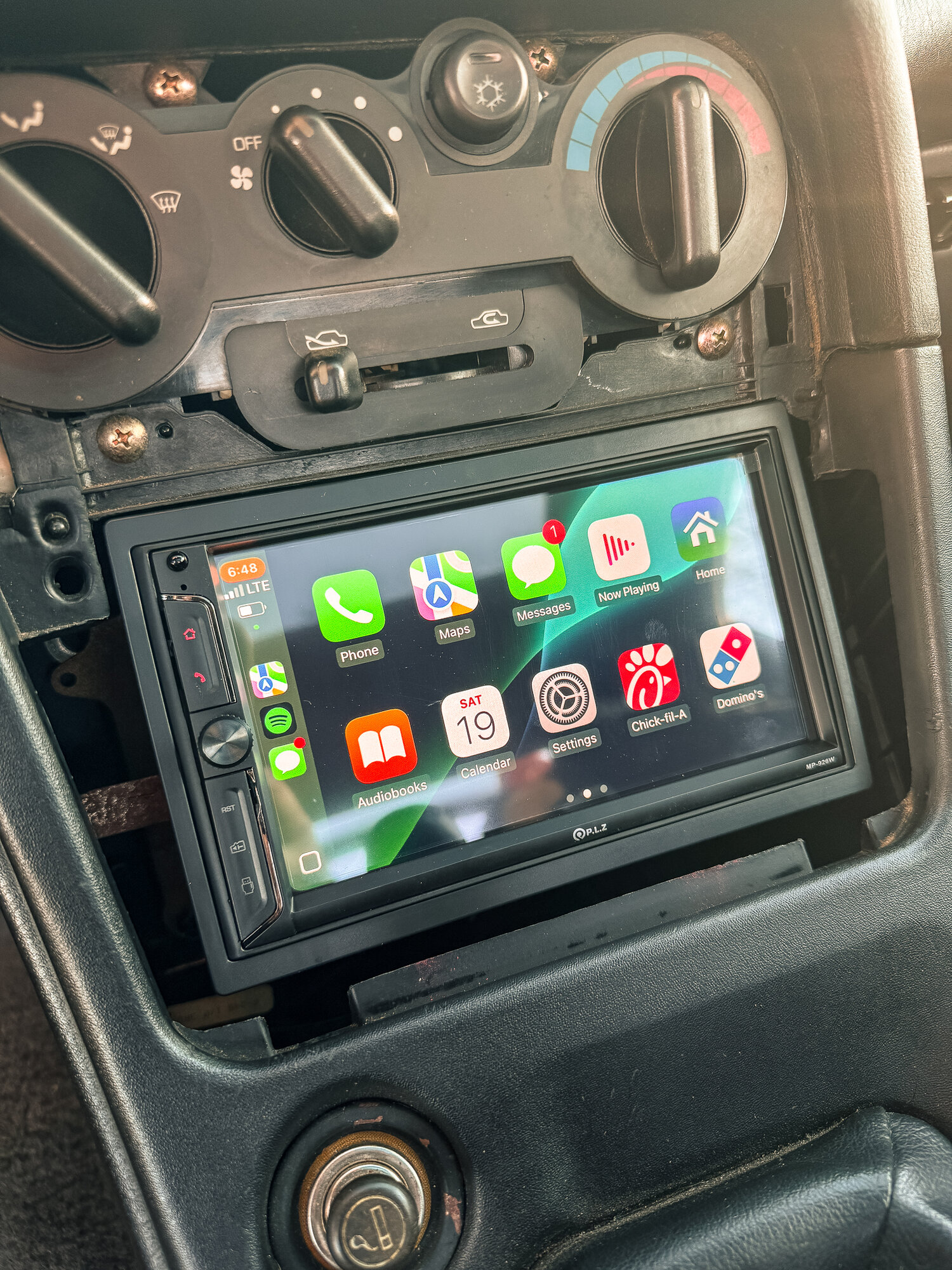

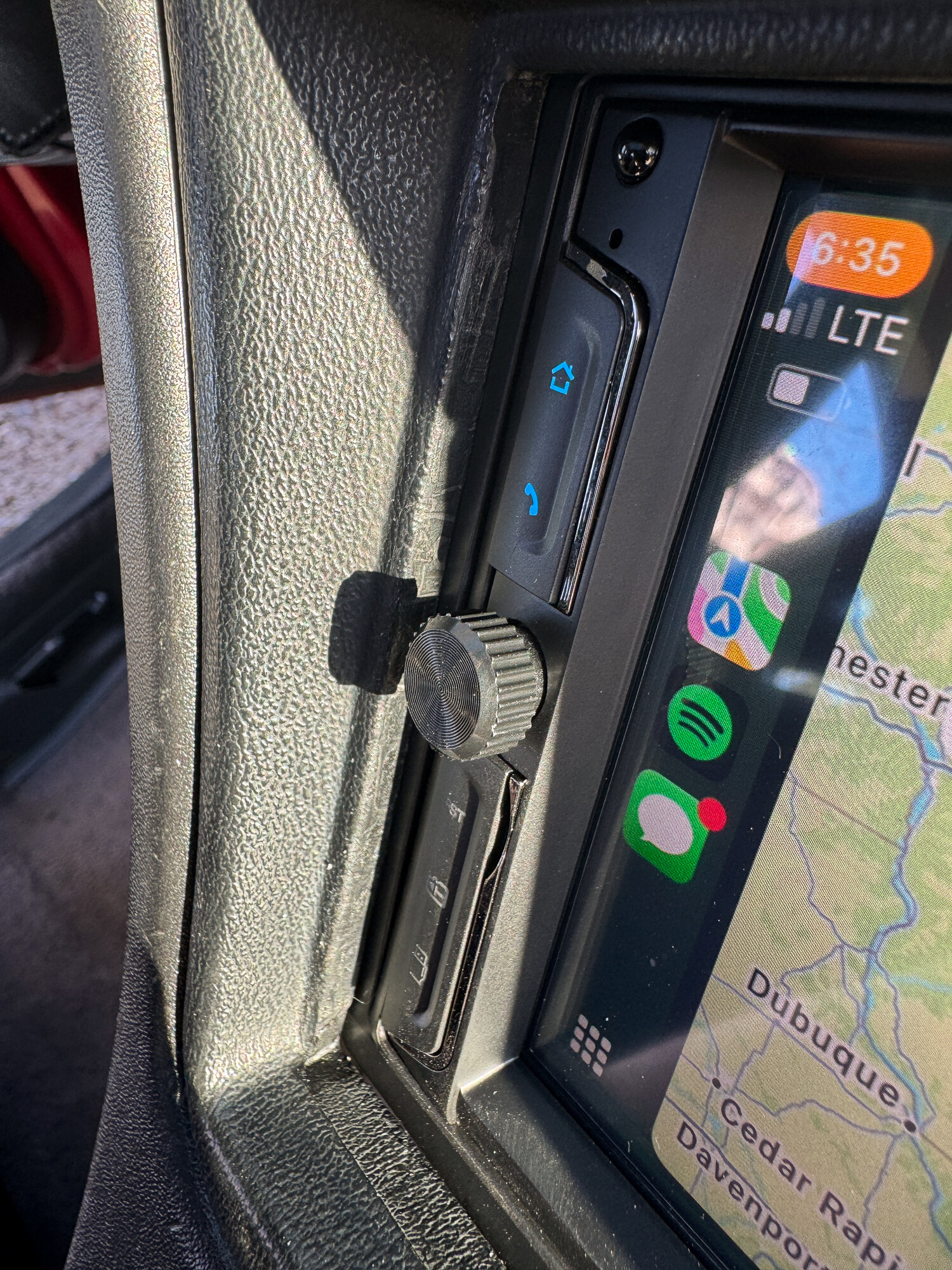

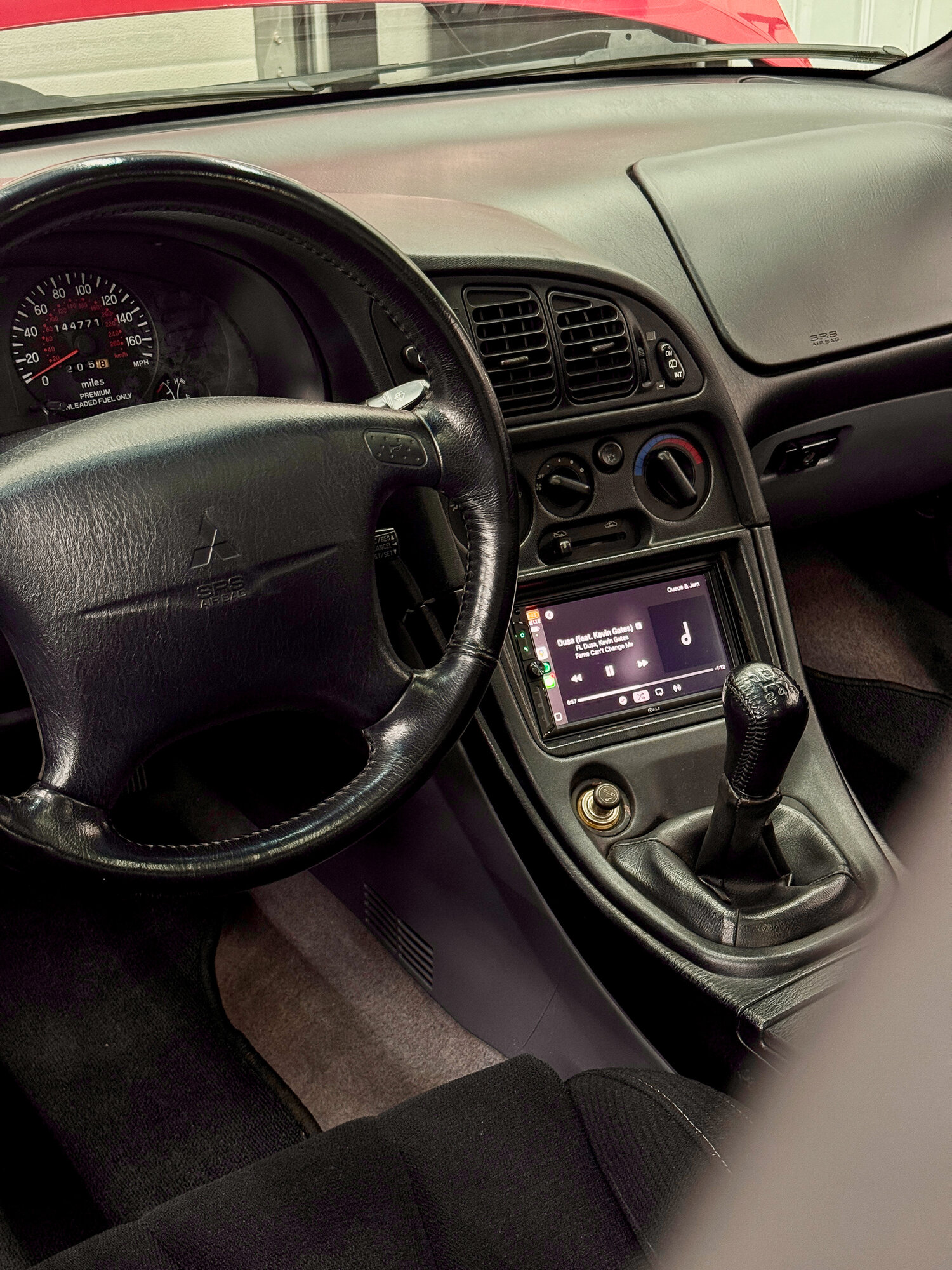

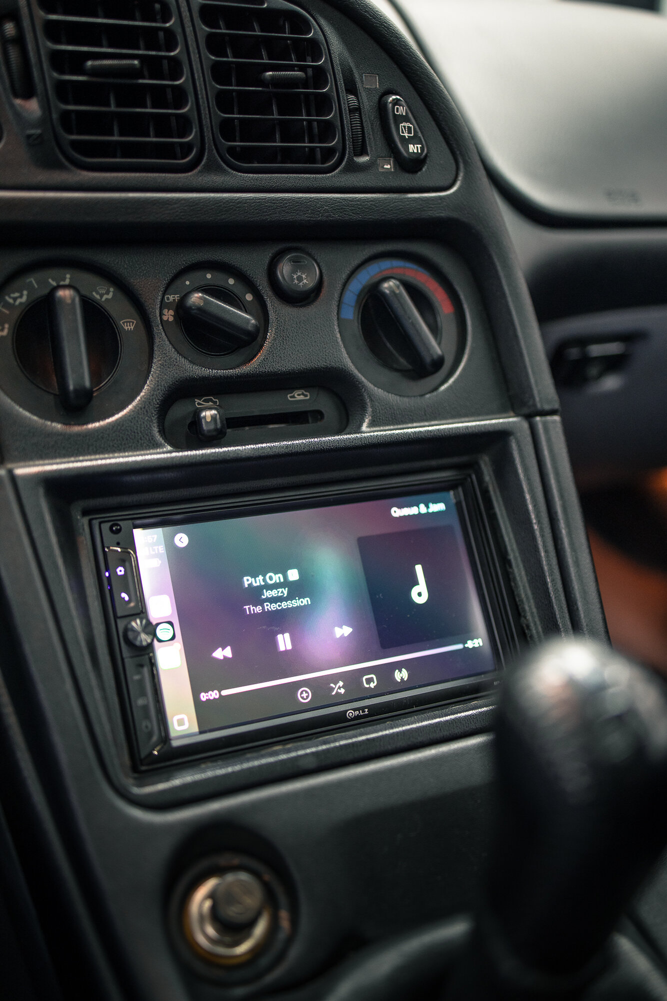

First up was to swap in a double din car play unit. Partially for convivence of navigation, and partially to update the interior, the new touchscreen is phenomenal. I ended up choosing a PLZ MP-926W unit. OLED with wireless Apple Carplay, and a price tag of $160 is everything I could have ever wanted. It took a little bit of work to get it to sit decently (some washers behind the bracket to space it out), but the end result is pretty good. A well designed 3D printed radio bezel could make it fit perfectly inside of the trim piece, but as it sits it fits flush up to the back of the trim. The amount of work it would take to get a new custom made trim piece would be much more than its worth, with how close it fits now. Additionally, the manufacturer allows you to put a custom boot screen on the unit. I only have a few hours using it so far, but it seems to work quite well. It does take about 15 seconds from key on to fully loaded with Car Play active, but the actual responsiveness of the unit while using is quite quick (that was my biggest concern). I'll continue to use it over the summer and see if it breaks down at all.
Finding a double din with a volume knob is surprisingly hard. I understand as on my daily I only use the steering wheel controls, but it severely limited the options for this car.

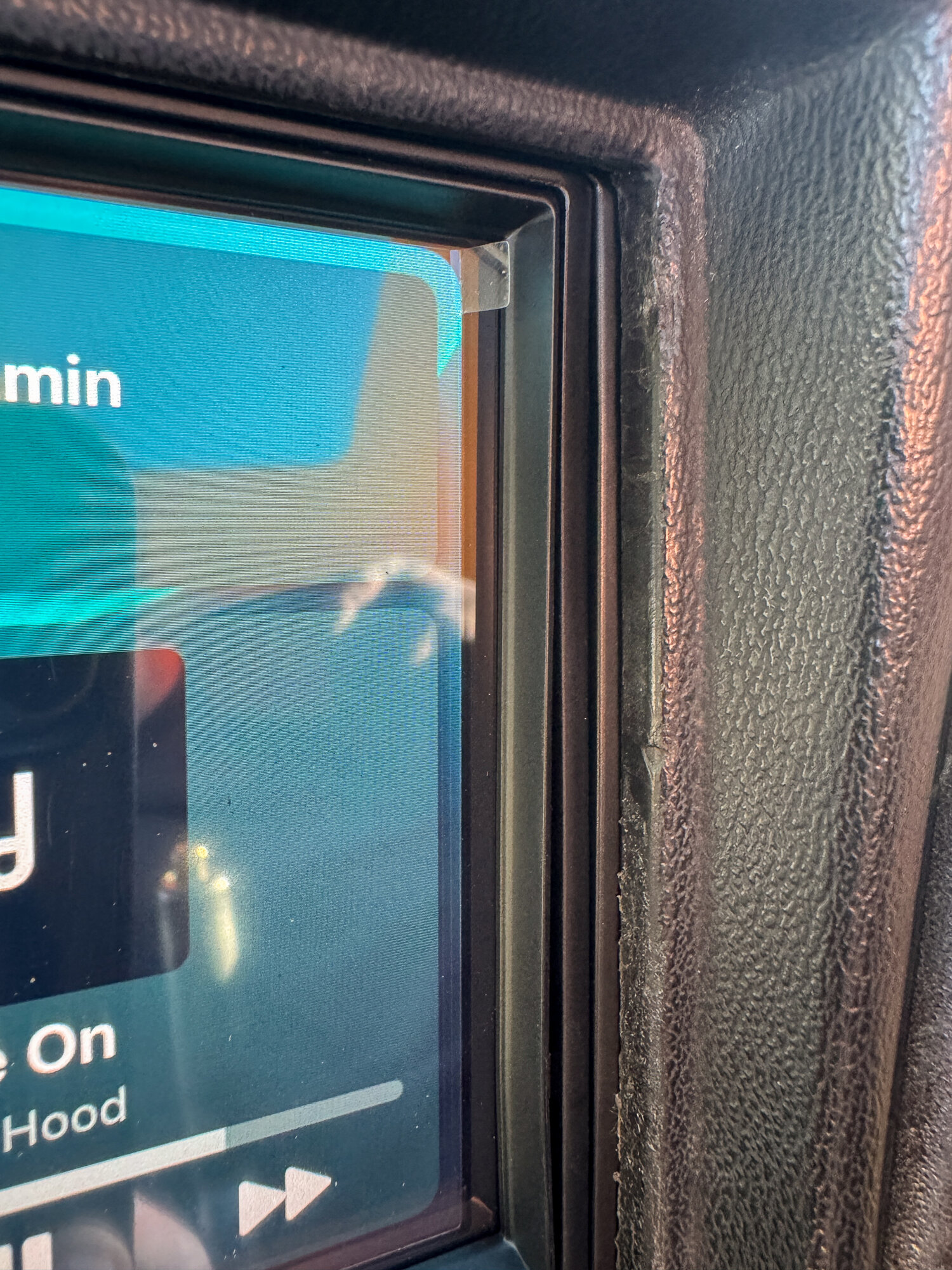

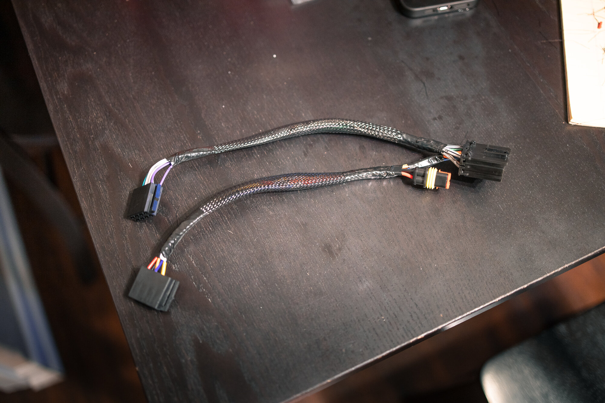

I wired in the harness to an existing adapter I had in the garage, and made a quick connect for the subwoofer and ground. I enjoy the process of wiring and routing to keep things clean.

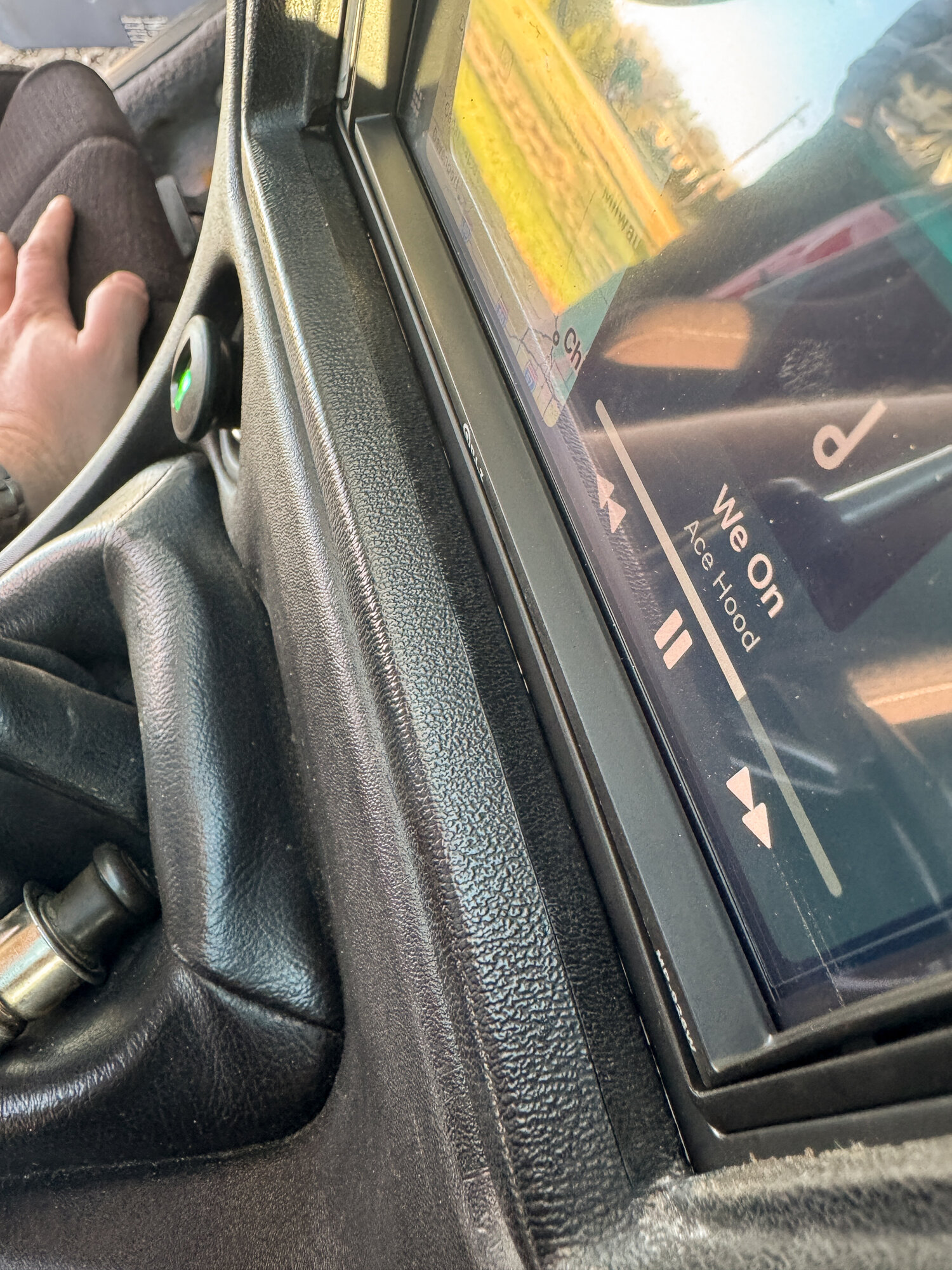

And finally the result. Boot screen only stays on for a split second, but it adds such a nice touch.
Closer view of the installation along with fitment to the trim bezel.

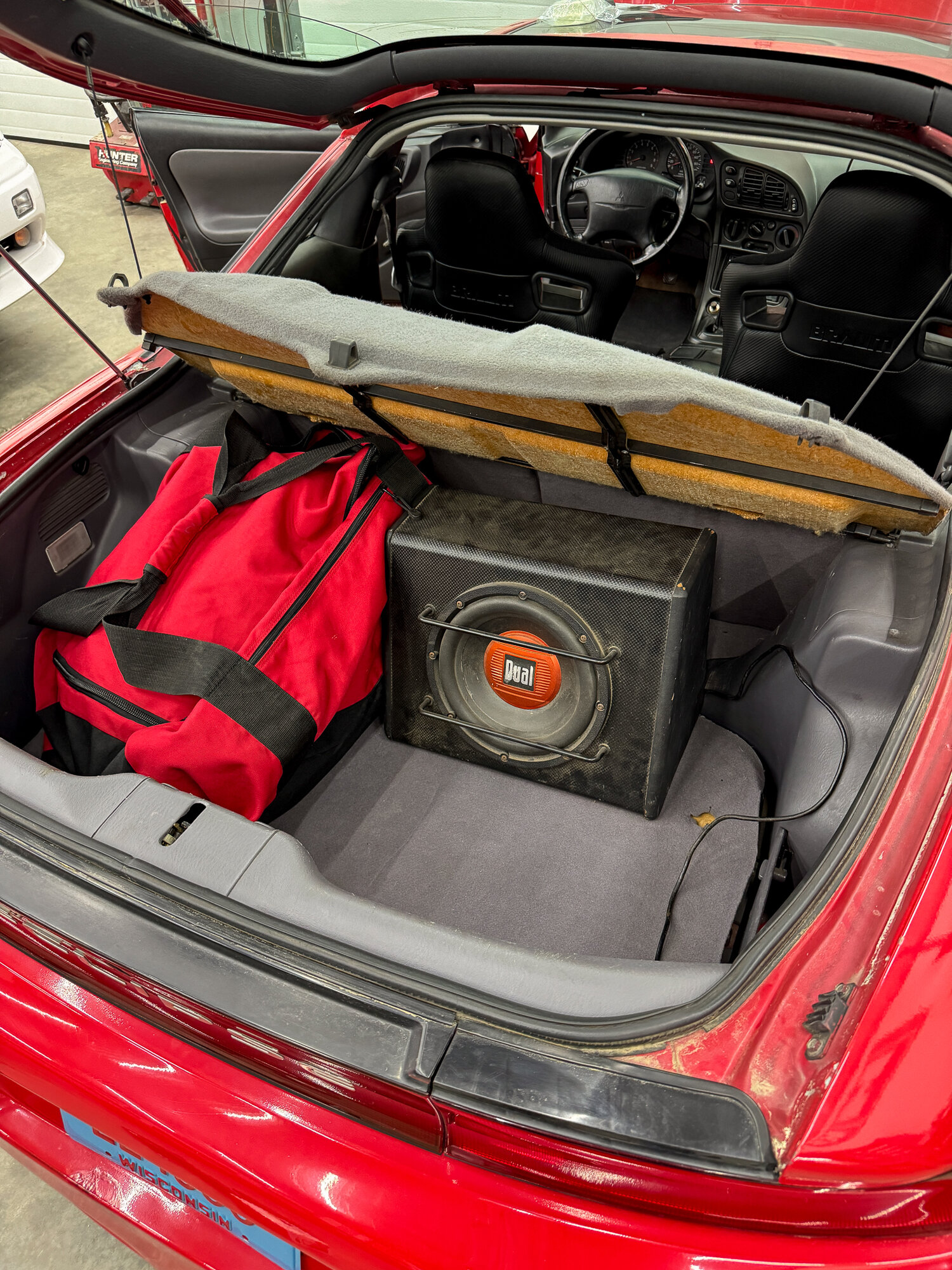

Another reason for the new double din was to utilize the subwoofer that I had laying in the garage. With a built in amp, its the perfect balance of bass, ease of removal, and most importantly cost (free). Here it is mocked up to make sure it works. This summer I will be working on building a new wooden trunk floor and securely mounting the subwoofer with a quick connect for the wiring.
The installation of the seats and the new stereo completely changed the feel of the car. No longer was I concerned about keeping the car stock, but I now felt like the car was starting to become MINE. As I began driving the new setup around, it reaffirmed my new feels surrounding the car. It wasn't time to make the car stock, it was time to make the car mine.
