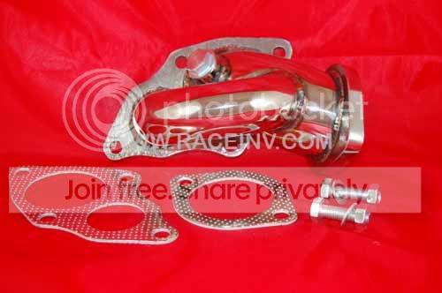

An Ebay recirculated o2 housing. For the price, these things are beautiful BTW...

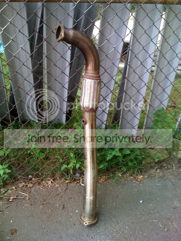

A 3" downpipe I bought off another member.

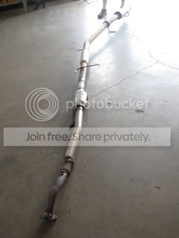

And a 3" Cat, to keep things as legal as possible.

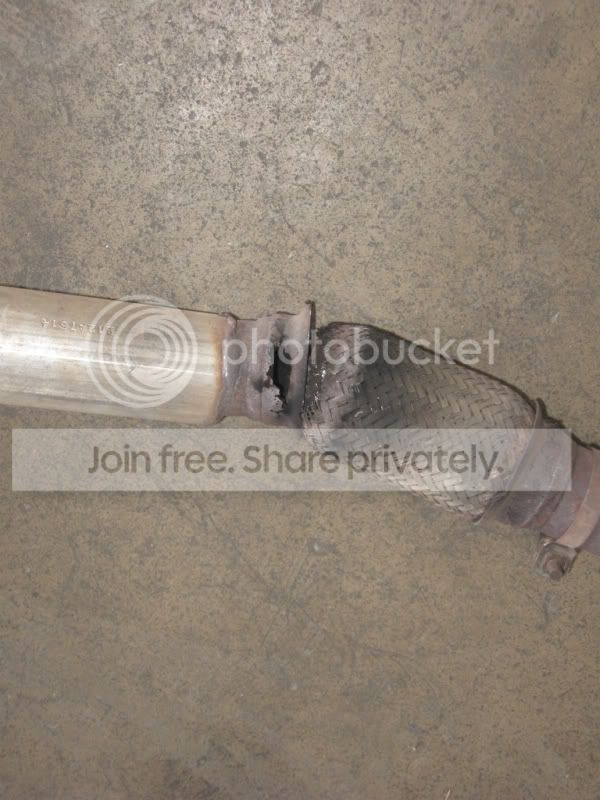

When I pulled off my old exhaust, I found that the small hole wasn't so small...

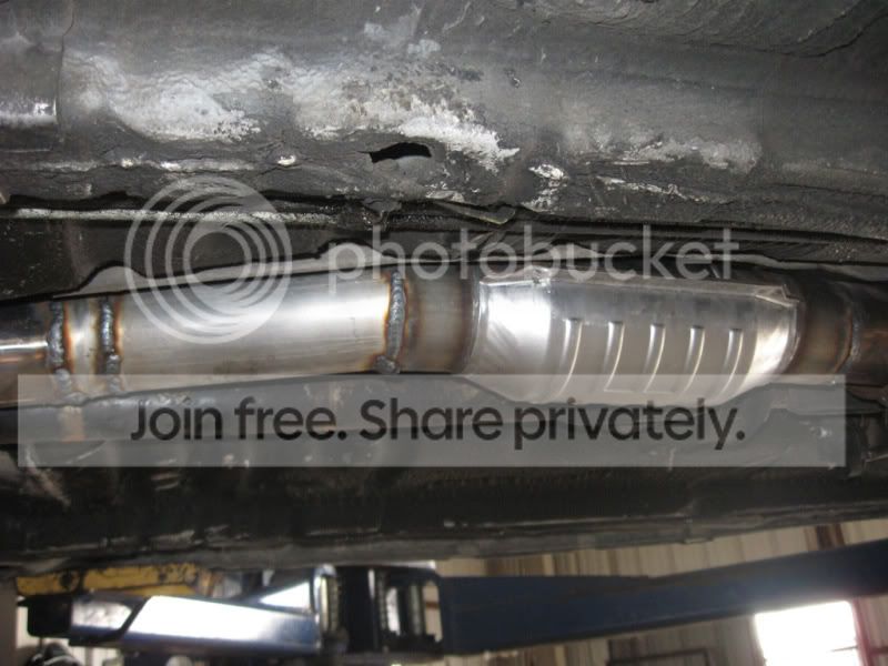

Unfortunately, due to time constraints, plus the fact that I was paying by the hour, I didn't get many pictures. The welder on site seemed very good, though I Don't know much about welding. He did put a hole in one of the welds, but filled it in nicely IMO. For some reason there was a tricky bend. I decided it would be easiest just to cut off the flange on my downpipe and go all welded.

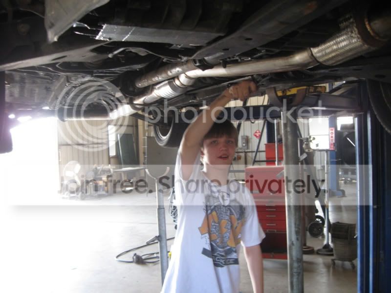

Here my step son gives me a hand with the bolt on the downpipe hanger.

Yes a megan 3" catback was previously on the car. I didn't notice much more umph, but the car still has some issues to take care of. I guess I'm just lucky here at Ft Hood, they seem to have everything. What do you guys think of the weld quality?
My grandpa owns his own business as a welder for all the farmers in our area. He has done welding and metal fabrication for years. Growing up around that i can say that those welds look really clean from the pix. Maybe a couple spots could have been a little more transitioned, but like you said, there was a couple tricky bends. I have been interested in ordering an o2 housing off of ebay, but just never really knew wut kind of quality they would be. i didnt want to invest in cheap parts, just for them to fail and have to pay for a better qulaity one, which i could have put my money toward to begin with. So from the little time that you have had yours installed what do you think about it?
Well from what I can tell, the o2 housing is great. Welds look perfect, everything lined up well... I would assume it is just as good as the $300 housings you see elsewhere.
