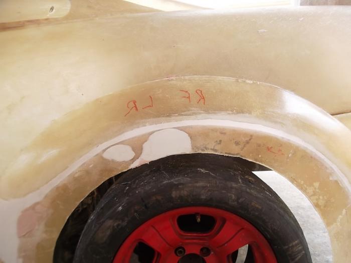

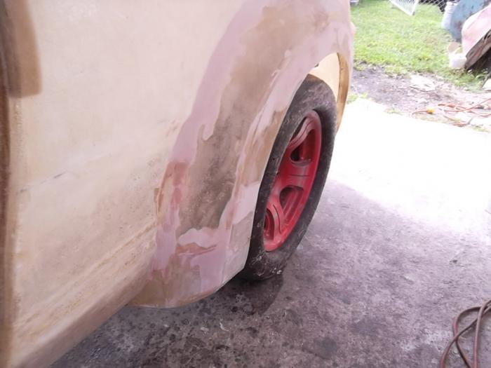

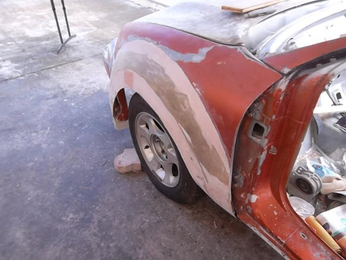

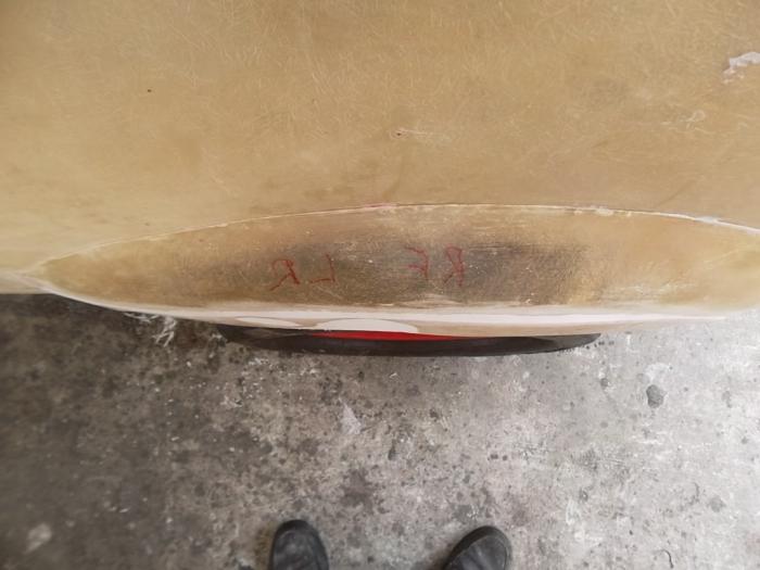

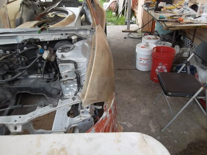

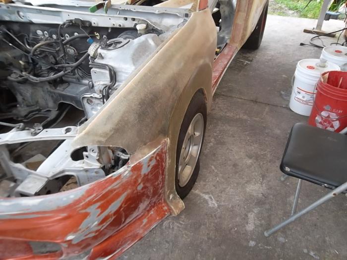

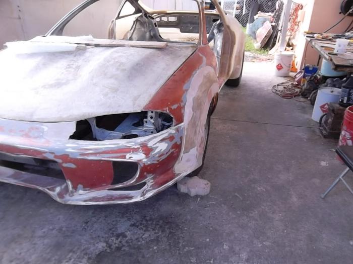

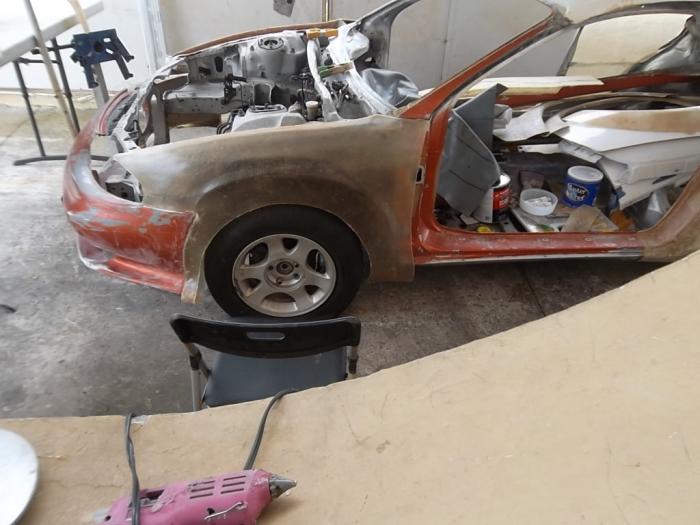

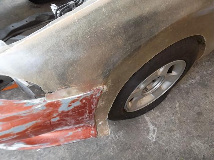

Meanwhile I have started on the flares, front and rear, I have done one with a 4 inch addition to the top of front fenders but have decided against it as it would involve more work than I want to do now.
Rules require that tire most be covered when looking from the top.
I have found this car to be very difficult to make flares for, the lines of the car being so peculiar, it is hard to make something that is functional and still look decent.
Hope to use this on all 4 wheels
It covers the tire pretty well
15 inch rim, tire is 23 inches
This front flare and fender I will not use
It would be perfect on a 205 tire
This we will use on the other project
Would like comments positive or negative.

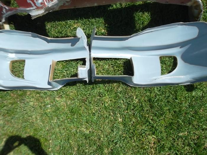

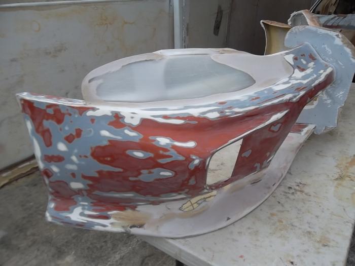

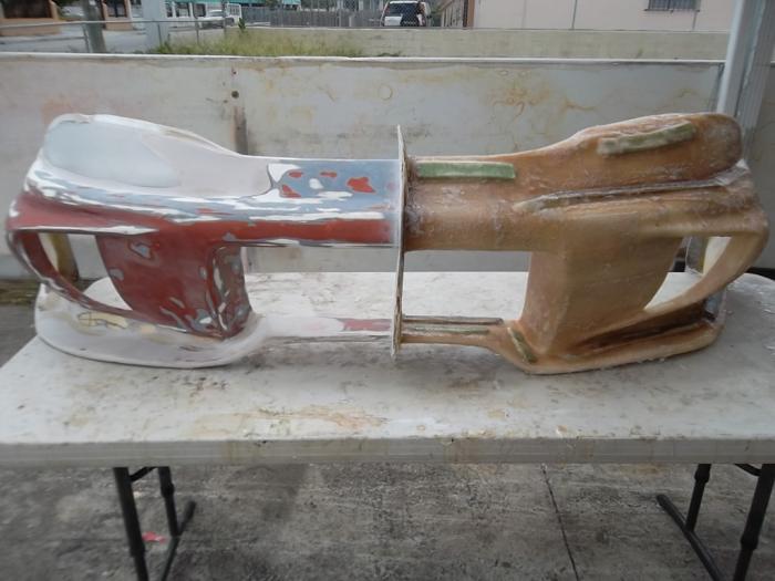

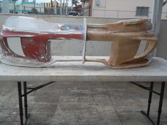

Still working hard at it, I have a lot of work lately, but I am almost done with the fiber, making a mold now for the front bumper, yes my ugly one, it is a split mold since I have to be able to make changes to it so it can be used in the other project.
My buddies have kept me busy, just finished set of Miata doors and now making a set for a BMW 2002 model not year since they are very hard to come by.
I will post pics of the mold later, I want to finish this as soon as I can so I can make the front flares.

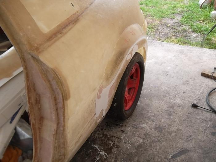

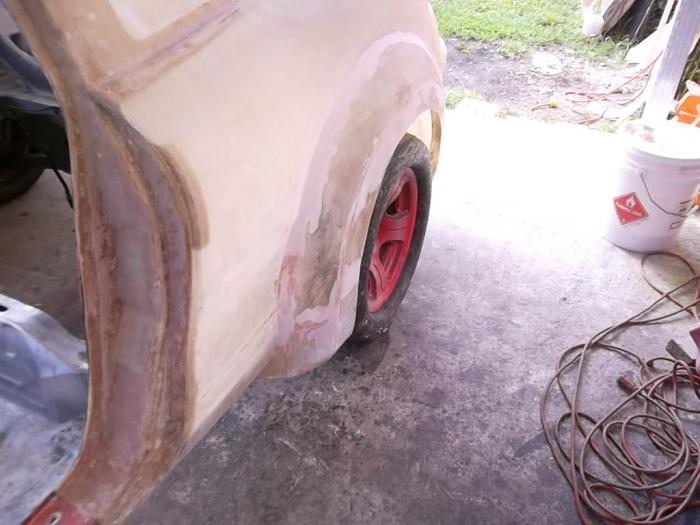

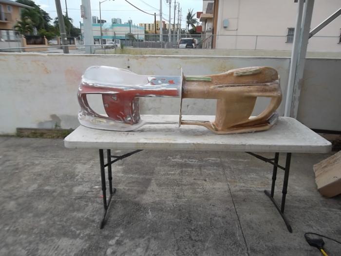

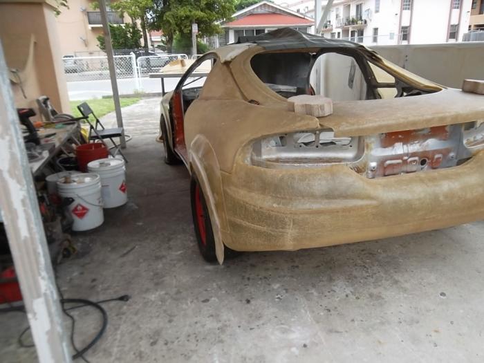

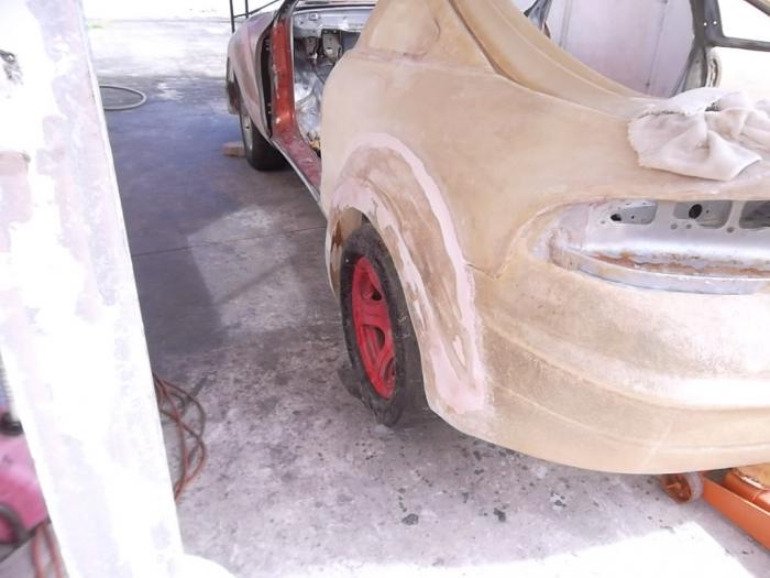

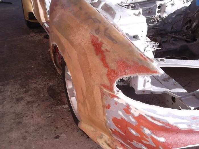

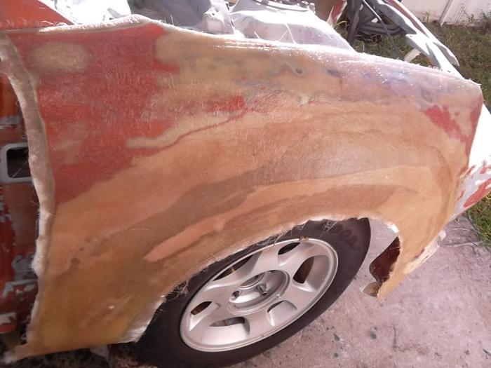

Long overdue update.
The flares shown before for the front will be used on another project.
I have redone and mod the rears that are shown before those.
These are the ones I will be using and molds have been made.
The front will be fender and flare one piece.
This will not my final one, I really dont like it very much, but i will use it for now until I make my wide body one. but that will be in the future.

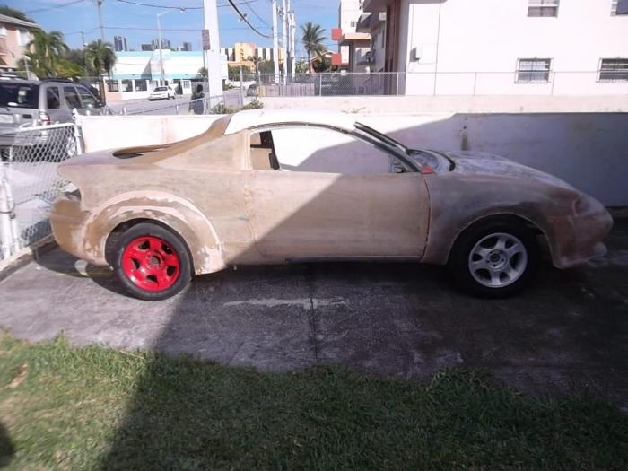

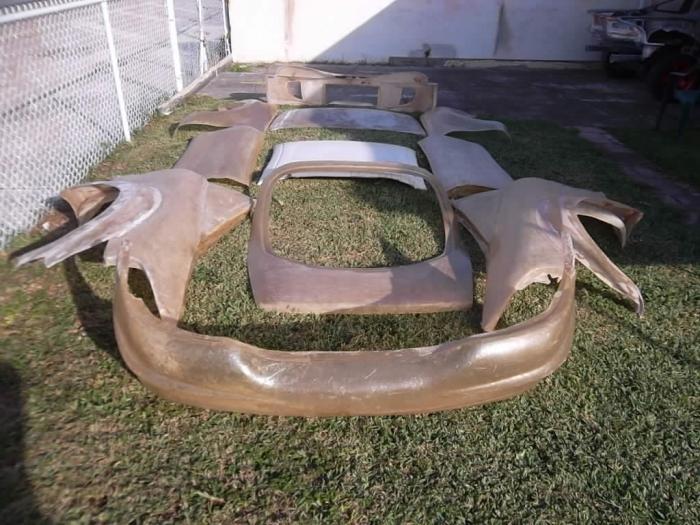

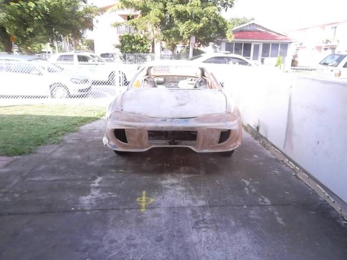

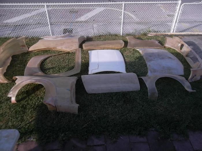

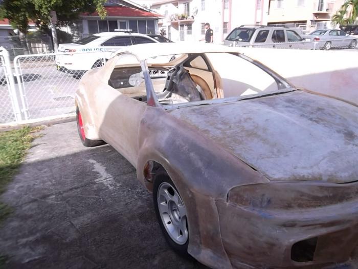

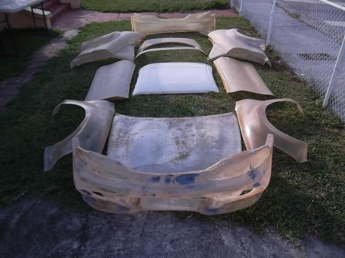

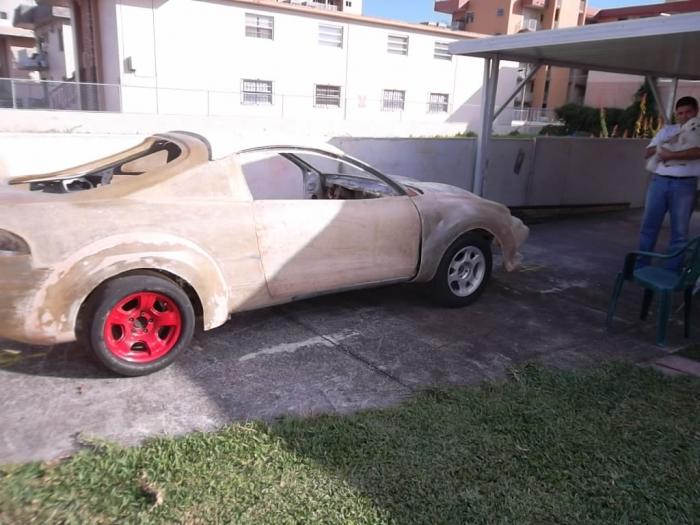

Long time between updates, but still making progress.
I have finished the exterior glass work, when the car gets done with roll cage and mechanical work, it will all go back together for final fitment and paint.
I know some people like to get the painting done first but I have always left it for last, since my experience has been if you paint first you will end up with a bunch of dings and scratches, I know painting first is a great motivator.
I have received a couple of prices on having the car wrap but they are very high and also very heavy.
Next comes cutting from the strut towers front and rear and making bumpers and rad mount out of aluminum.
On with the show:
As always comments, good, bad, ugly will be welcome.
