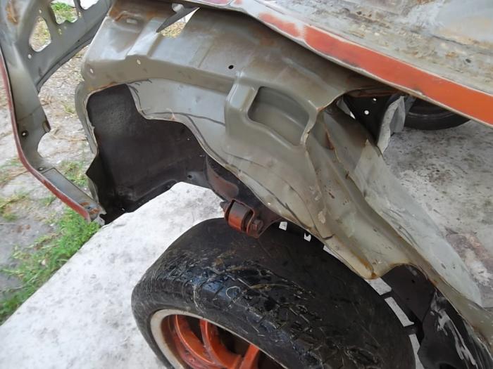

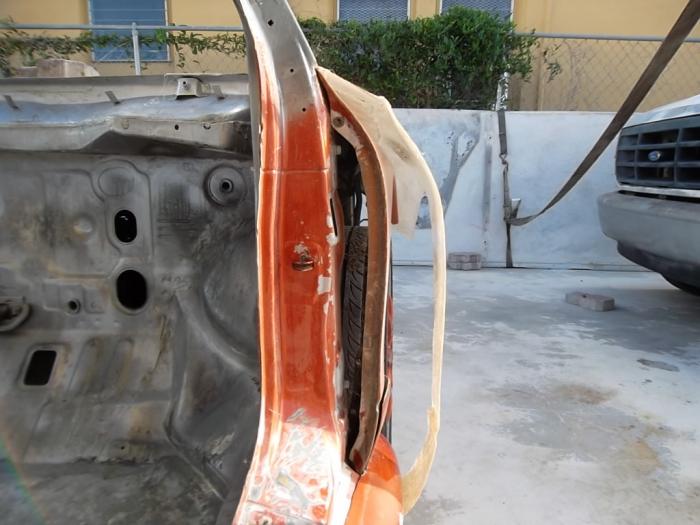

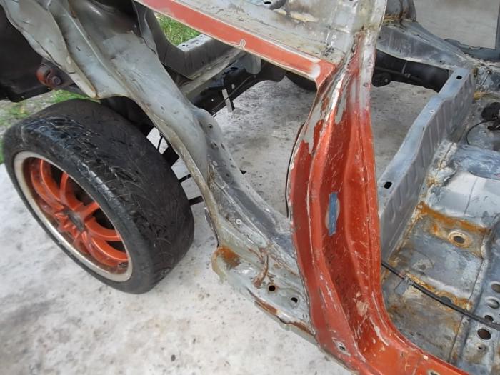

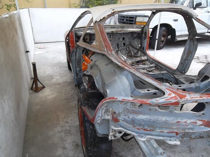

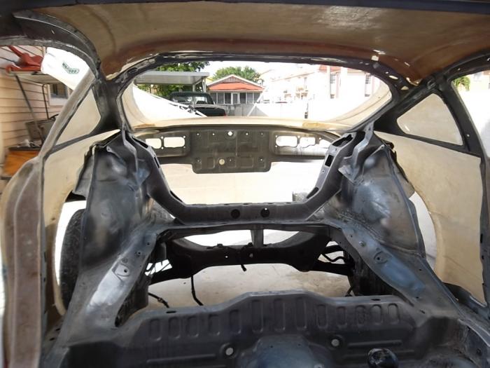

Removed both 1/4 panels and trial fitted the new parts they are going to go on fine.
The weight removal was not much 40# both sides.
There was a lot of work involved and for some people it may not be worth it, but like I have said before I am a weight nut.
I also removed the Apexi turbo back pipes to the bend on the drivers side the rest I had done before. Although well built It is very heavy this section alone weights 38#, I also took out the heat shield at another 7#.
I still have to widen the front fenders and add flares to it.
I am getting close to start doing some mechanical work which I will enjoy more than my fiber work.
Here are some pics of where I am now, hope everyone enjoys and please feel free to comment or ask questions

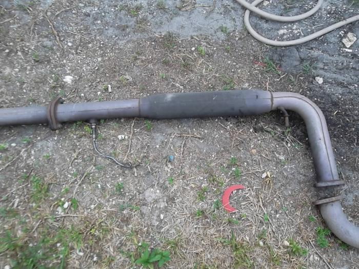

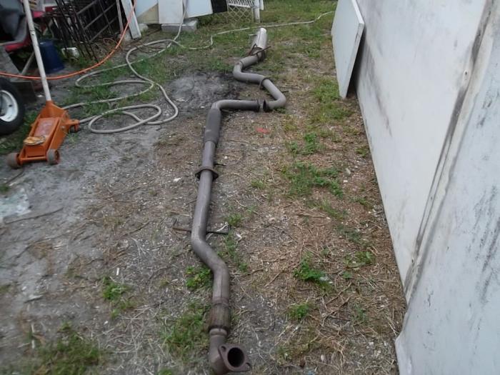

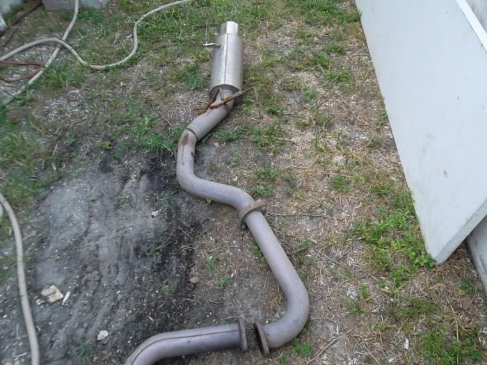

Starting to do some mechanical work, took the complete exhaust system out and it is very heavy from manifold to tip it weights 63# and this does not have a cat just the test pipe I guess with a cat it must be around 70 to 75 #, it is one heavy piece of pipe.
It is not going back on, it will be replaced by aluminum and it will come out right behind the drivers door, I dont have any idea if it will pass a decibel test, I
can save another 50#, plus the shield which weights 6#.
This system comes out 2 1/4 from manifold to flexpipe, from flex pipe to about 12" before muffler it is 2 1/2", the last piece of pipe that attaches to muffler, the 12" piece, seems to be 3", the muffler is an APEXI.
Is this the standard replacement?
If I want to come out from manifold with a 3" pipe to a flex joint also 3", does the flange still has to be 2 1/4 and then expand to 3"?
I am sure the answer is somewhere in the forum but did not find it, also looked at the apexi catalog.
I thank you in advanced for any input.
That's about a normal replacement for a performance exhaust most get a 3 incher but the downpipes will always be 2.5 at the flange
Your building a race car so why not a race car exhaust basically 3 or for inch exhaust out the side.
Do you mean coming out the side in front of car?, If so, I cant do that, all road racing groups rules specify the ehx. must come out behind driver.
I could take it out the side right at the bend that goes towards the driver side but that would lower my height, the other option is to go straight back from there, like the normal system and run the 3" all the way back.
Thanks for your input and if you have any other ideas please let me know.
I remembered about that rule after i posted, but i have seen another car on here that was running the exhaust out the side and it came out threw a hole in the rear panel section in front of the tire.
like this but of out the quarter panel instead of the door. you would need a fuel cell instead of the stock fuel tank to do this.
Fuel cell is mandatory and already have that, We have another car where the pipe is also coming out the door but had to built an enclosure around it.
I have to get under car again, but taking it out the rear quarter almost to the wheel well may be the way to go, not sure yet, I want to avoid bends.
Thanks.

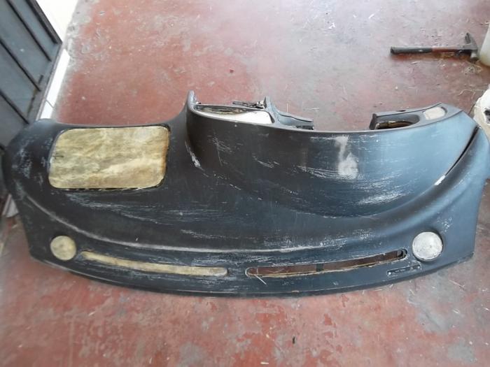

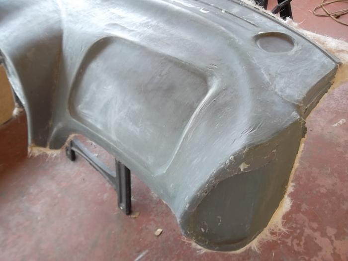

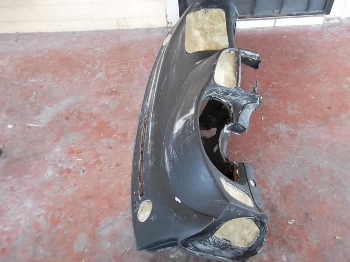

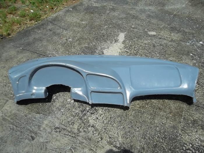

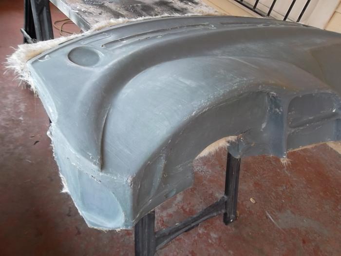

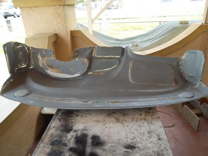

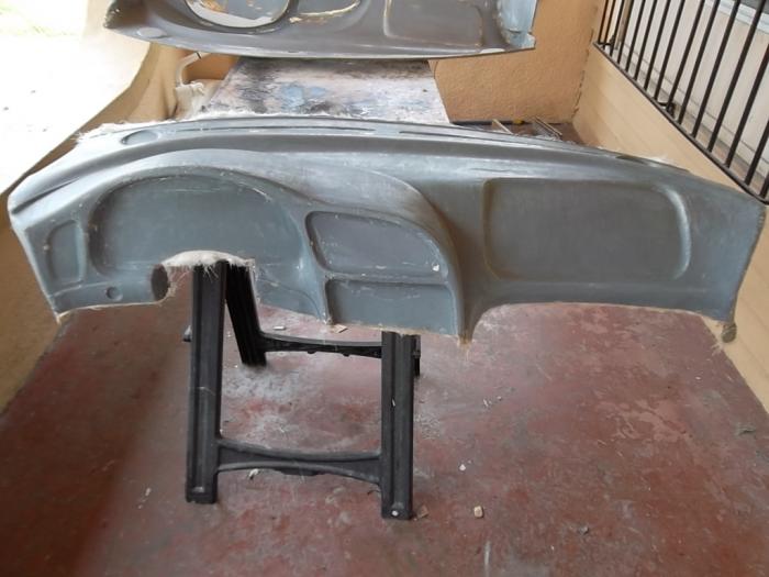

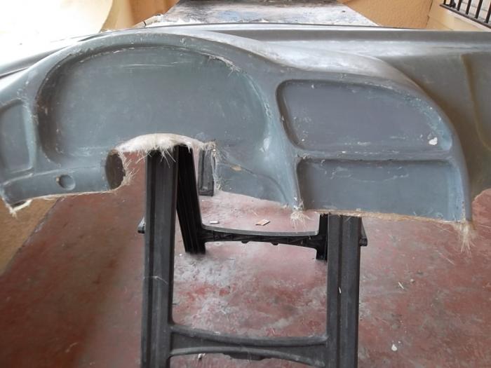

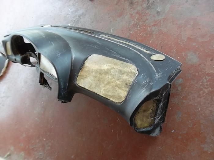

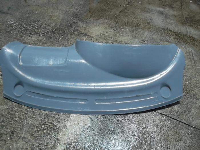

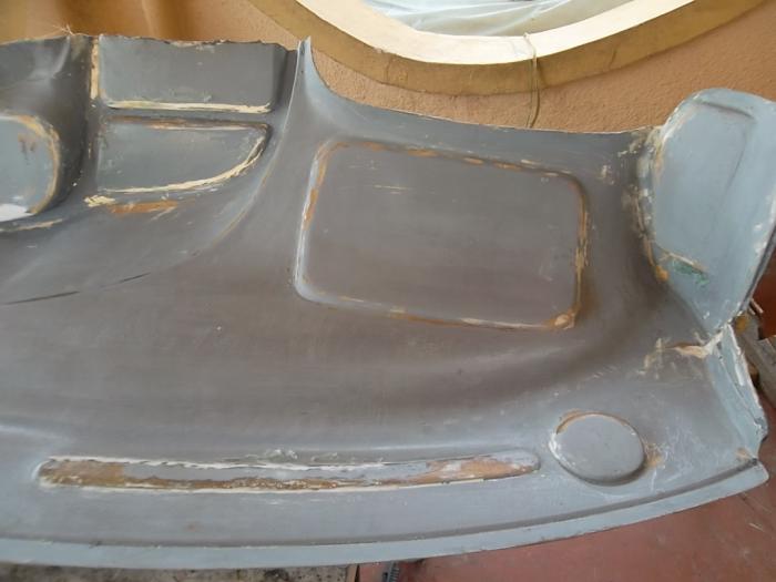

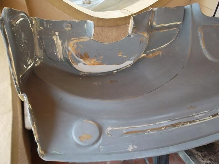

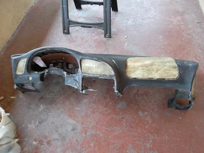

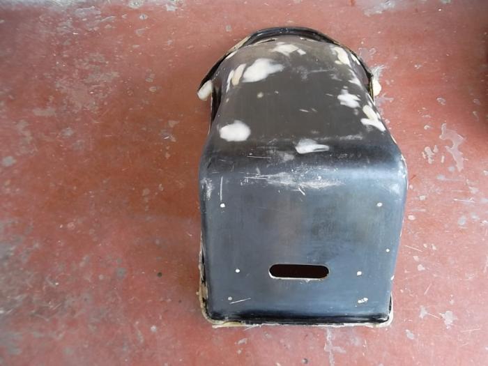

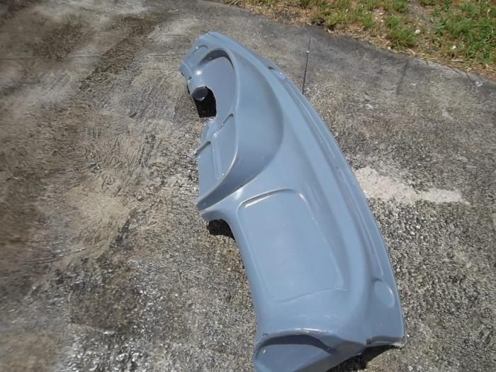

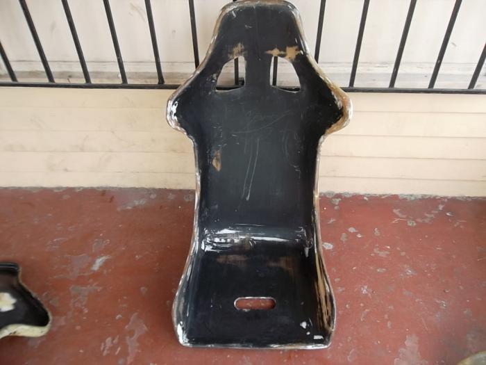

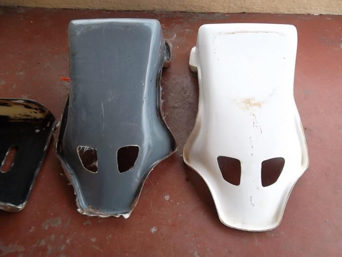

Have been pretty busy lately. Here are some pics of the dashboard which I finally made, it turn out better than I expected, some wrinkles but not bad at all.

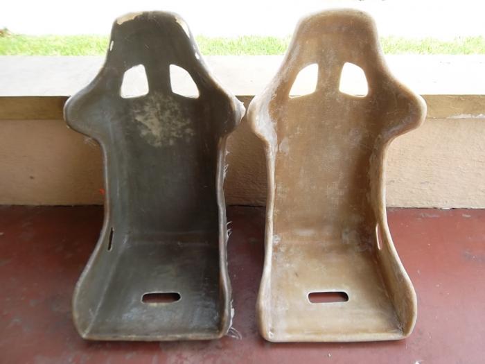

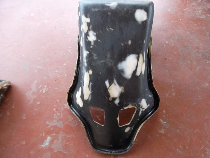

Also pictures of the 2 seats which I also made, and the plugs and molds.
Will work next on front cap as I have to widen it about 4 inches on each side and add some flares.
I have made a change in plan, and now more than likely, I am going to go with a 1.6-4g61, since they added a break to the class, I can now run this engines in the lower class and be in the same class as my son and some of my friends also will be cheaper on maintenance.
So if anyone has one of these engines please let me know.
This is the plug for dashboard
Since I cant see the pictures I can not tell where I am
I think this is the mold
This is the part
I hope they come out in order

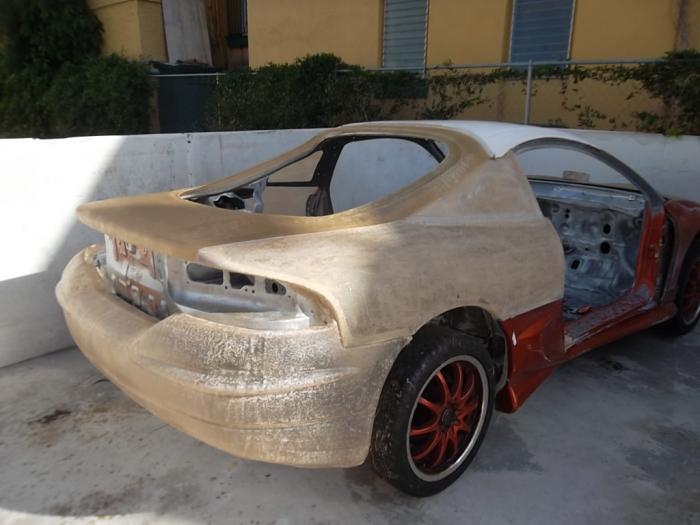

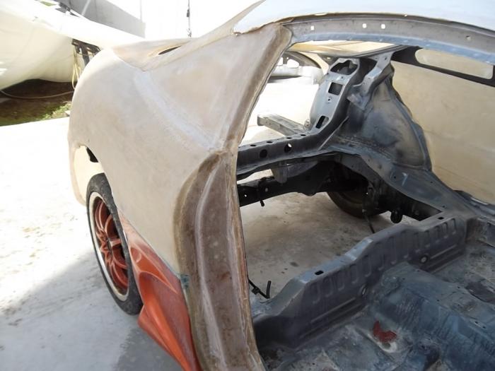

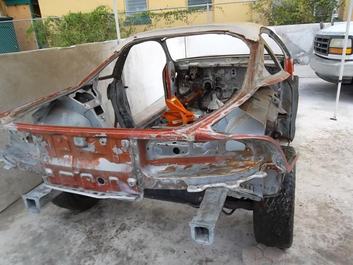

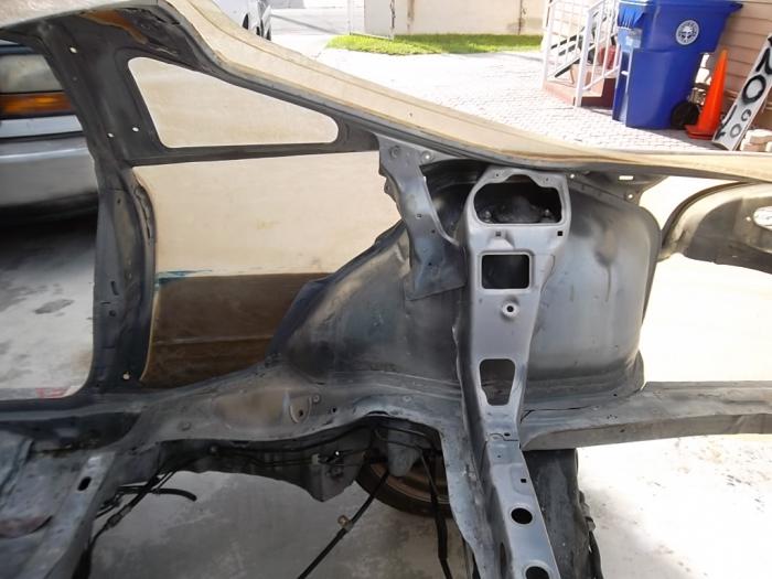

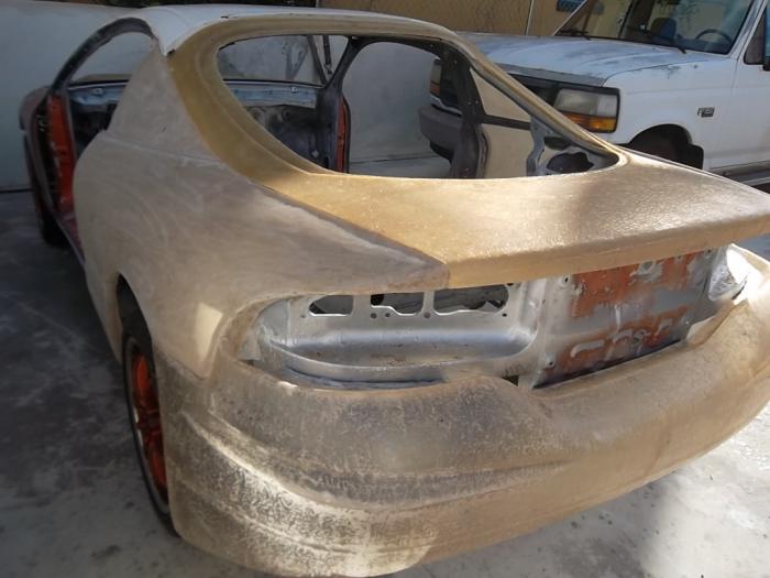

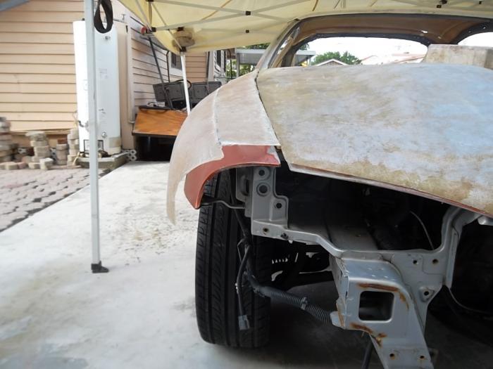

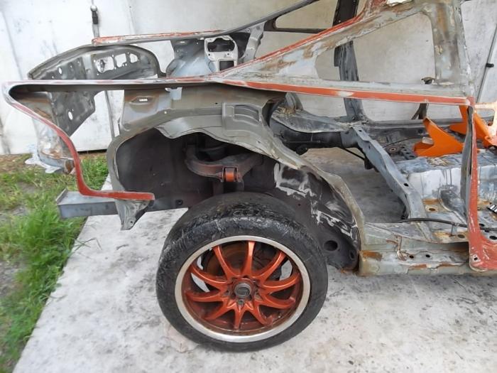

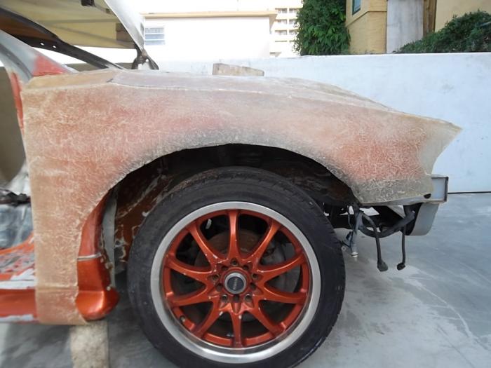

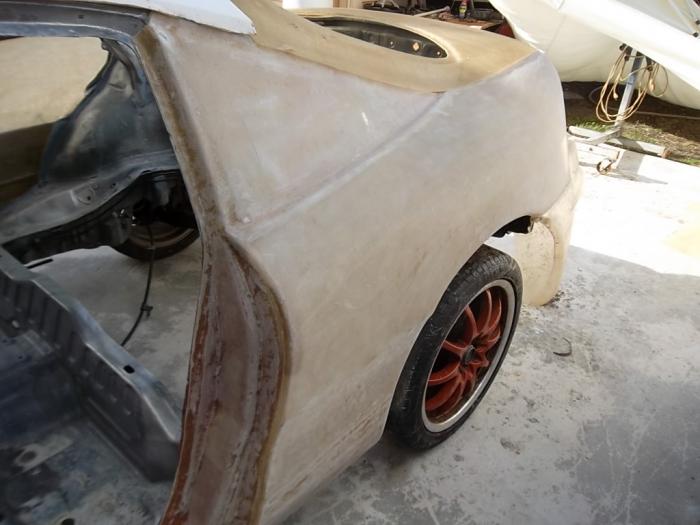

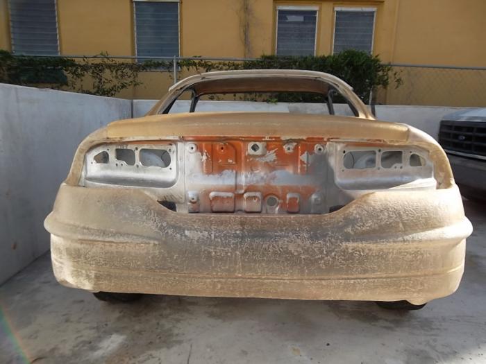

It has been a while since my last post, I have kept busy doing what I can to the project in my free time.
I have started to trial fit the pieces I already have made, everything has gone into place fairly well, there are no fasteners on any piece, except for some glue just to keep them in place and take shape.
The next step is doing the front fenders spaced out 4 inches to get proper clearance for tires.
Here are the pictures and if any comments or question you may have,I will be glad to answer.
