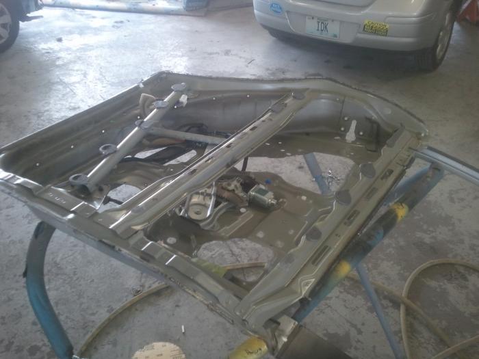

Yeah like removing a door skin.eccept with the hood and instead of a metal skin a fiberglass in its place. It wouldnt be a wieght reduction more cosmetic.

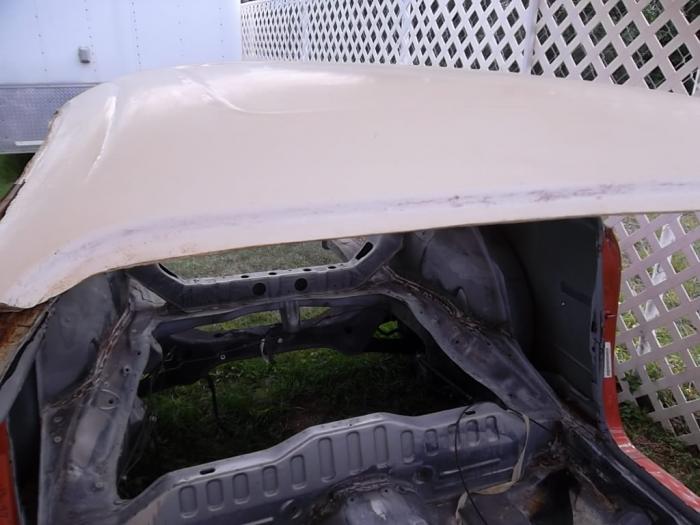

did you mold the roof? mind sharing info on what kind of weave/ounce do you use for the doors/roof/hatch?

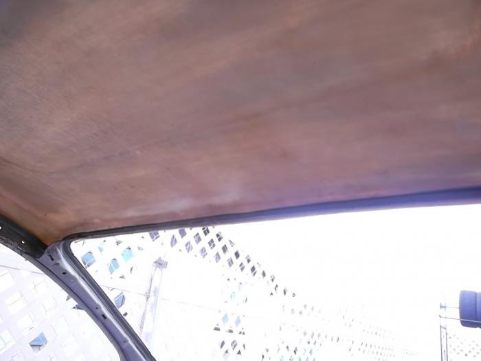

The roof was a beneficial mistake, it started out only as an overlay, and since I had to do this outside , the sun came out and the person helping me left some bad bumps on the surface, seeing that it was too bad, I am kind of picky sometimes, I went ahead put more glass on it, reinforced it and that then became my mold for the roof, the white one you see is a cast of that NEW mold.
This mold does not conform to what a regular mold is, as it has no mechanical gel coat and the surface you would be casting on it is just resin.
Let me explain this, any overlay you make will be a mold on the opposite side, "the part you are casting against".
Since a lot of these parts are prototypes and they are going to be changed, modified or altered, I will make a thin overlay and then do all the changes to it,
it will already be fiber, I make them very thin so they could even be cut easily with large scissors or box cutters and sanding, then after all the changes I will cast a final mechanical mold, if required.
Usually on the overlay only, my 1st layer is 3/4 mat, 2nd another 3/4 or 1 1/2 mat, 3rd the ligthest cloth usually 4 oz. that I can find, this is most important since this is what I call my sacrificial finish, since this layer will almost disappear when you are done sanding it, then I go to the back of it, sanded it
to brake the glaze and reinforce it.

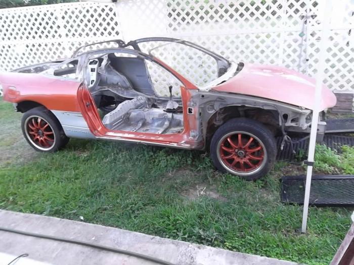

Here are some more pics and a little progress.
I was finally given a date by the chiropractor. It will be this monday, I am getting a little anxious since I cant make much progress w/ car being on trailer waiting, I been keeping busy working on dashboard mold, and seat mold, the dash I think will come in at about 5 or 6 lbs.

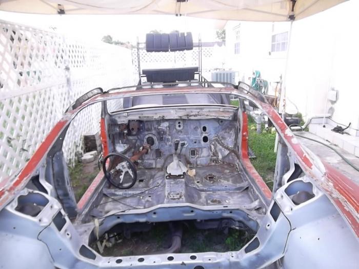

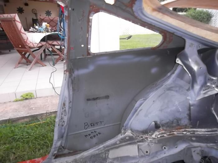

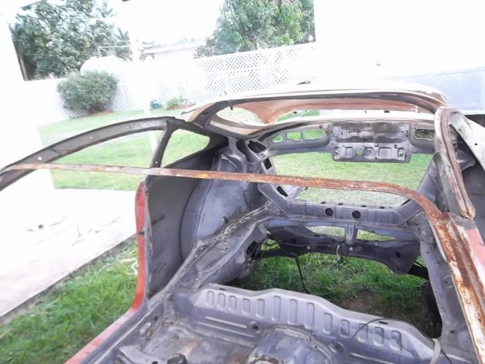

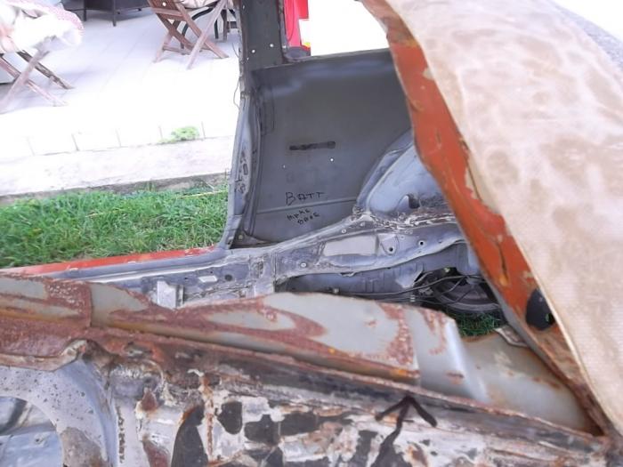

This "DOWN TIME", gave me the chance of taking a closer look at the bottom structure, from door sills down, and the floor pan from the bottom, this car is weak, like most unibodies, the reinforcements below the door sills are bad, and the strips of thin metal from front to back are a joke.
Those in particular with the age of these cars have been torn off, or bent up from going over curbs or whatever, since I will be removing most of the rear strut tower brace and nothing beeing at the underside of car I will put some extra braces there.
Have not seen so far sub frame connector bars advertised for these cars and it should be a most. This would be good whether,RR or drag these is where this car is weak. This car probably folds as easy as a taco.

Yoour best bet would be to rehang the doors and adjust them then if it is outa wack use somthing like the dsm jack on a piece of angle iron on the rocker pinch weld. Then u can weld in a piece of steel from the bottom of the a pillar to just above the door latch area. Then run one from side to side from door latch area to door latch area.
Yes. And to keep you from being the meat in the taco. Put something under the car while u are working on it. Just for support.
Yea, for sure, as a matter of fact this happen to me many yrs ago even having my vette on supports but it slowly roll off and since the car was so low the frame almost broke my ribs, so even on supports you still have to be careful good thing my friend was there w/ a jack.
My doors are not going to do me any good remember they are fiber skins.

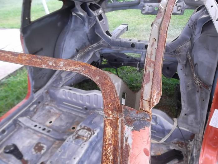

After I get the car check on the frame machine I will start welding my cage, the cage will have 2 bars from main hoop to front hoop, an underdash bar from A pillar to A pillar, 2 from underdash bar to front strut towers, 2 from main hoop to cross bar at the rear bar that ties the 2 rear strut towers, all of this is a normal 12 point roll cage , but will have to add either on the inside another bar from A pillars front hoop to main hoop, or go under and run them along rockers pinch welds and an X under floor to tie everything side to side.
The roll cage will take care of any flex on the top part but this car needs reinforcement on the bottom, since there is a large span still from front subframe to rear subframe.
I think we agree that this is a very week section.

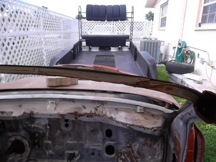

Well finally today, I was able to have car checked at the body shop.
MAY say the following. whoever starts to build these cars for even spirited driving. and do not correct any problems that the car may have with the unibody they are going to throw their money away.
I was very lucky as mine has a small deformation in back of fire wall, what they call banana shape, this can be noticed by small humps right at the footrest on the floor by the A pillar on both sides or only one.
ALL my other measurements were within factory tolerances.
Some kind of subframe connector. either below or above floor must be made.
