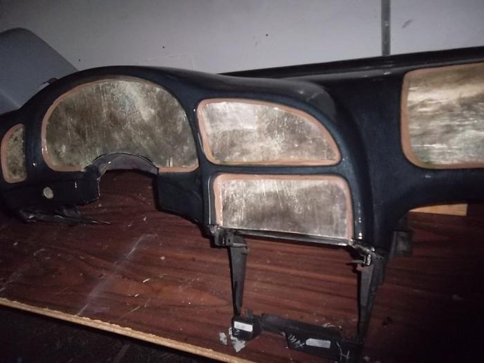

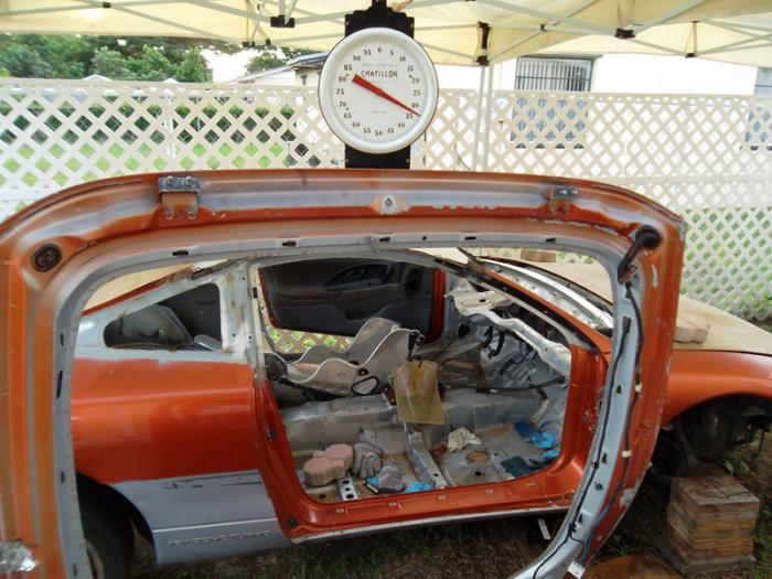

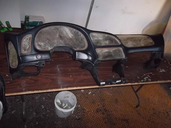

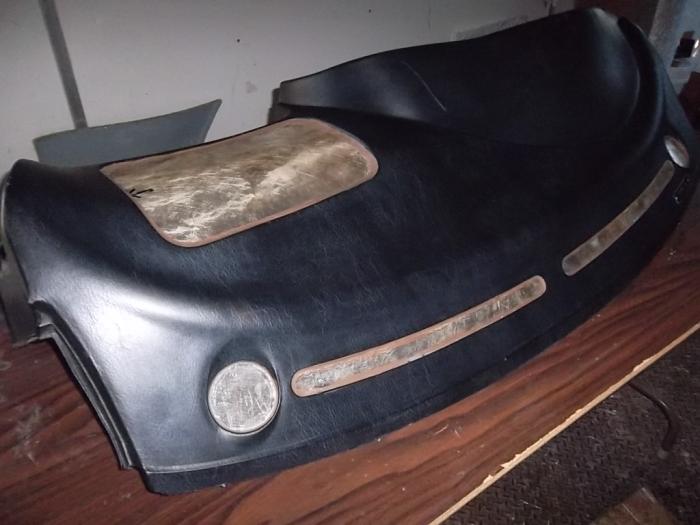

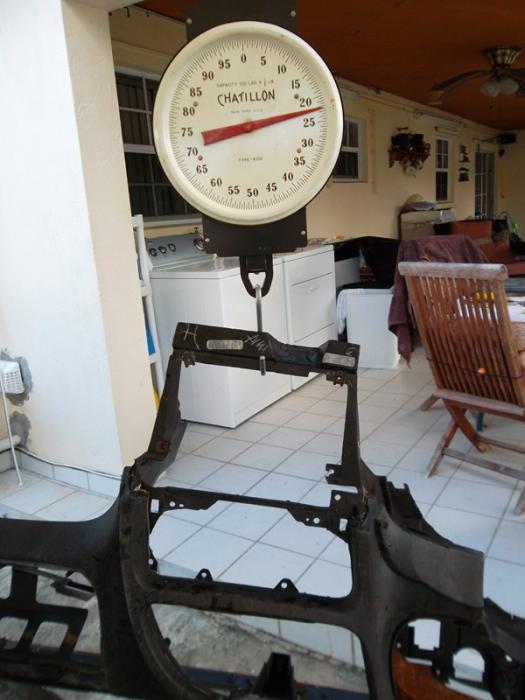

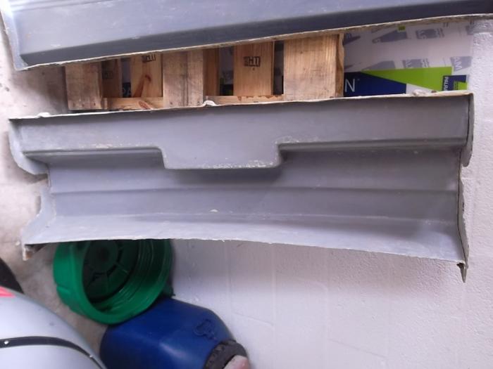

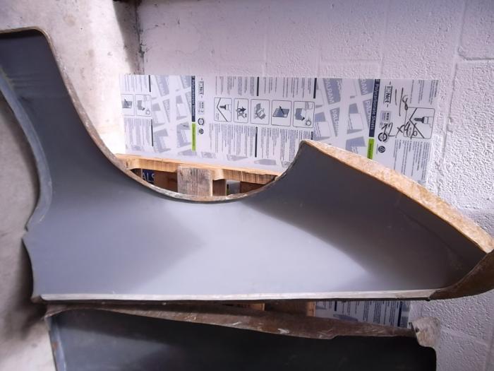

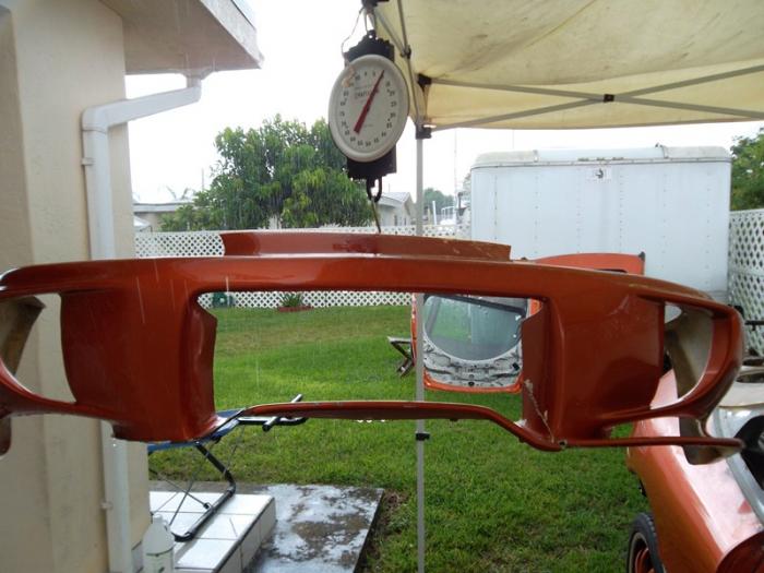

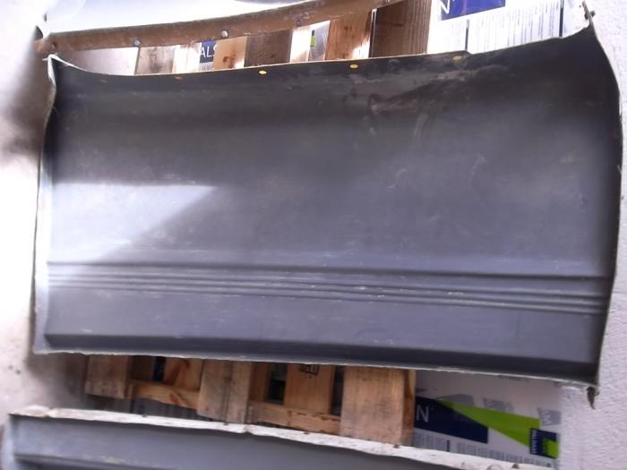

Here are more pictures of some small progress and found other places where I can save about 12#.
Waiting on body shop to give me date so chassis can be check.
I dont want to touch rear quarters until car gets back.
Probably make front end one piece except for hood, will eliminate front head lights,
to be replaced by glass and incorporate into 1 piece front end, will see how things fall into place.
Dont really like front bumper but it is what I have, will modify for cooling ducts to radiator and brakes and oil cooler and attach splitter, still lots of work ahead, was thinking of not doing fenders since they are only 6# each, but by taking measurements tire will be sticking out about 2".

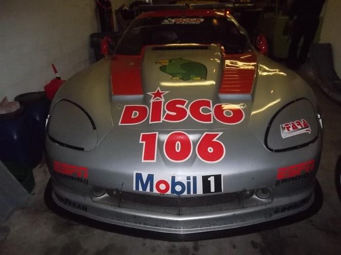

These are the molds for the Olds that was in a crash at Homestead

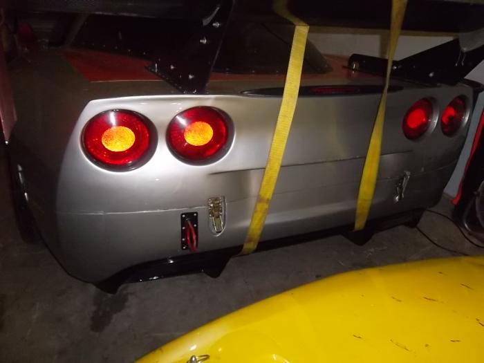

This corvette is being shipped to Chicago for a TRANS-am race, I am going to make spare front spoiler and rear bumper w/ diffusser.

very motivating work, what's the target weight you are trying to hit?
I have not set a target weight, as I keep finding places to take weight off, like I mentioned before, I want this to be the lightest car I have built.
My 69 corvette was 2200, fully caged, big block 427 ci, and all the things that go in a race car, but it was not my lightest, so I will see where I can take this to.
I have read many times that these cars are pigs, heavy and so forth, they are really not when compared to similar cars if you compare to a civic, yes but not many more. The structure of the car is also very solid.
There will be a lot of weight put back in, full cage, fire system, fuel cell which is heavier than stock tank.
I have to get this as light as I can as my economic resources wont allow me to spend a lot on go fast goodies and I have to improve on my power to weight ratio.

Dam nice im going to have to hit u up when im ready to do my bodywork. Im wainting to customize my front and rear bumpers. The stuff the oem bumpers are made of dont hold up to customizing, and have repaired fiberglass but never maid anything out of it eccept a patch. What are using for a release agent?
There is mold release wax, many brands available, the wax will take care of a lot of small imperfections on the part, but it is just like doing prepping when getting ready to paint the better your surface the better your final is going to look like, I do about 6 coats of wax and if the part is virgin I do more.
Then a coat of pva with this you have to be careful it does not puddle on bends or angles if it does then you have more sanding to do on your final, this is a green liquid, make sure you have adequate ventilation when using it.
