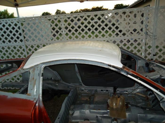

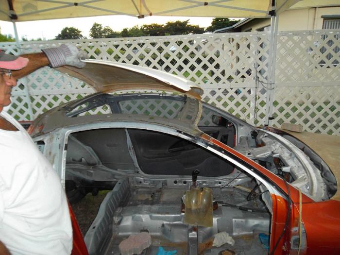

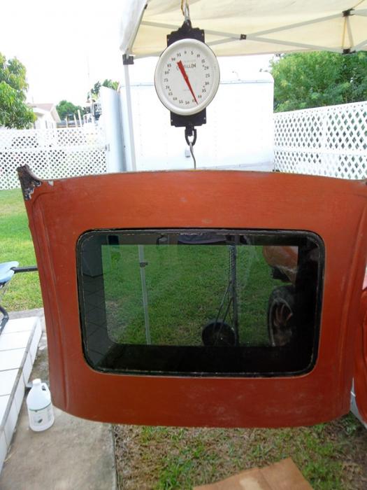

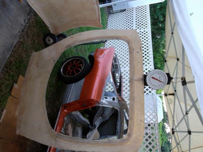

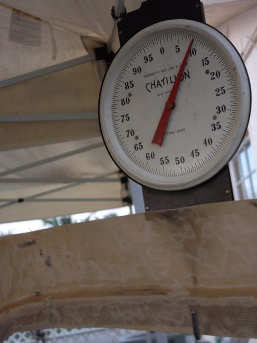

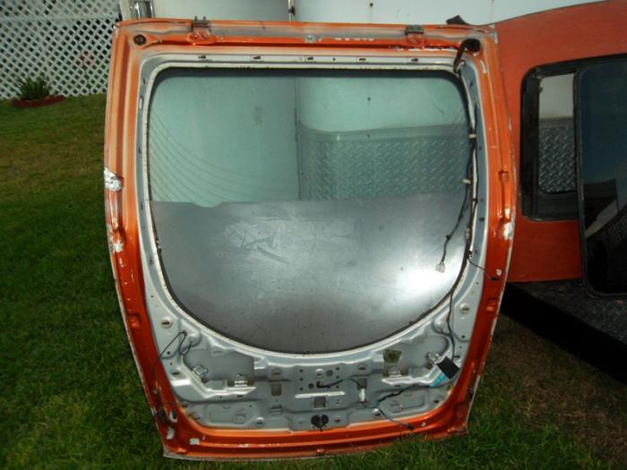

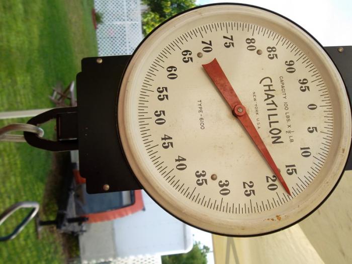

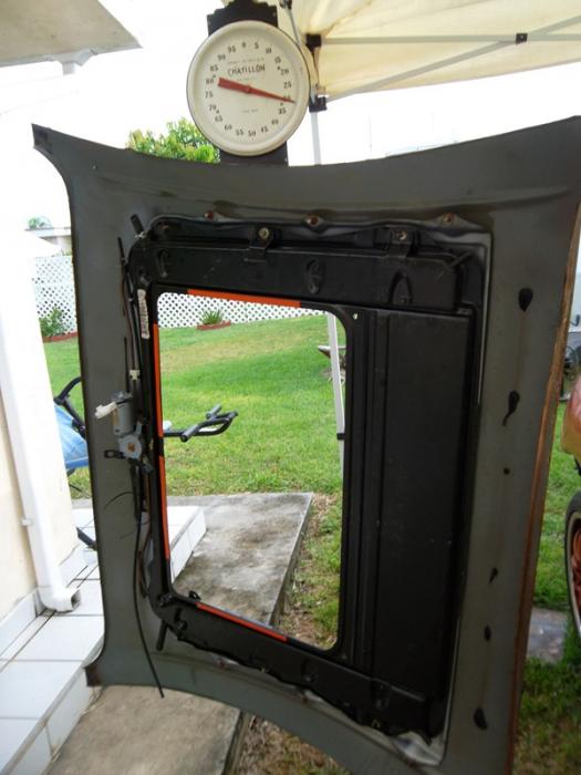

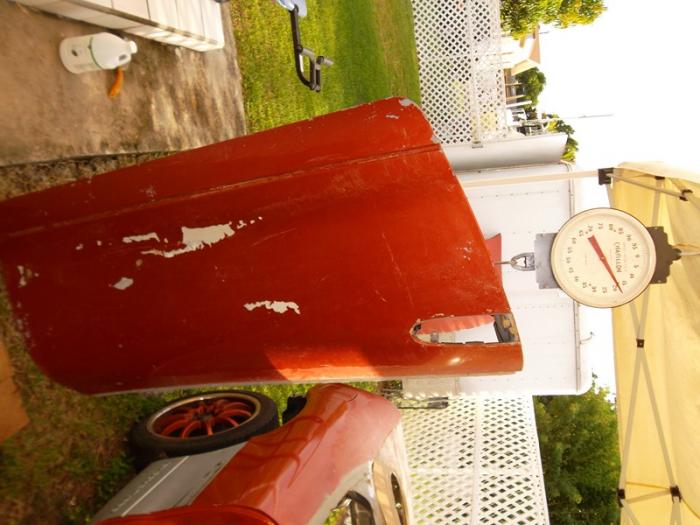

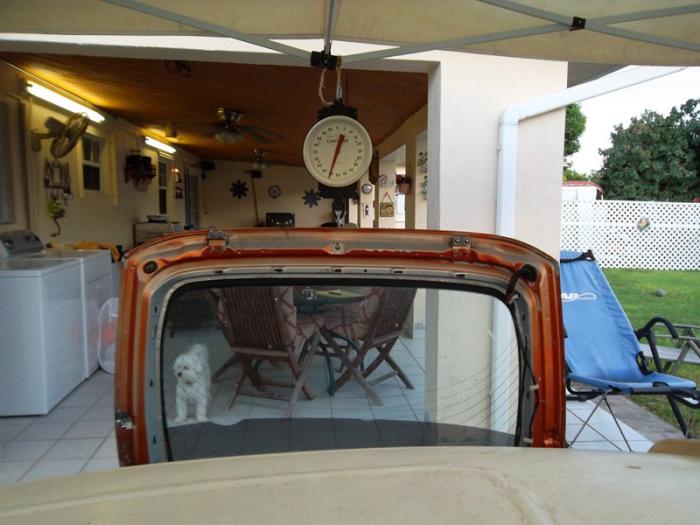

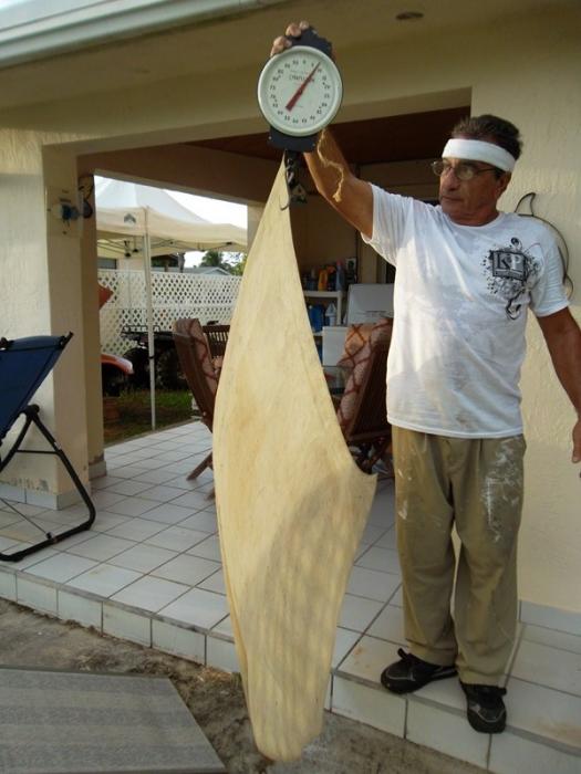

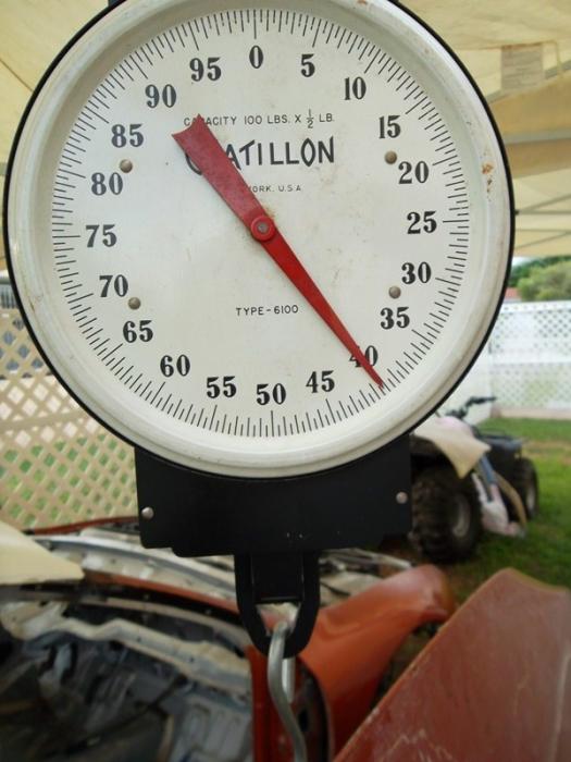

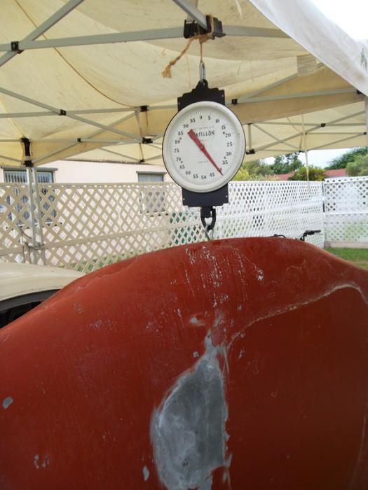

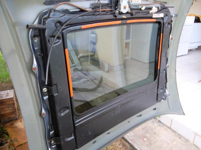

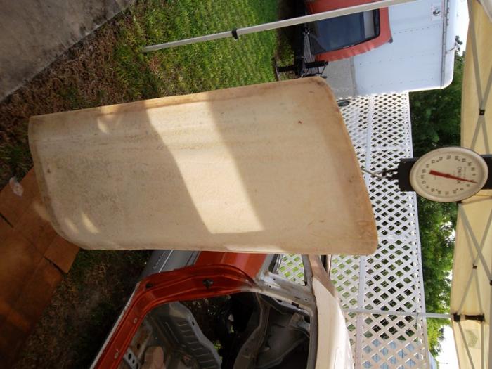

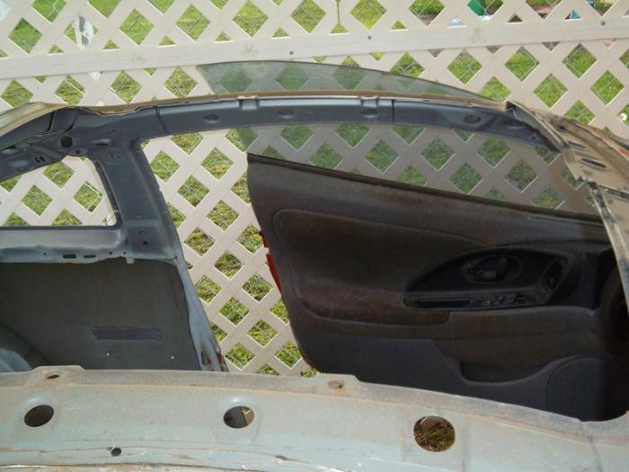

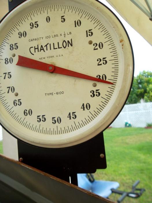

These is a small update with some of the parts and the weights of the original part and in the case of the gutted door, I cleaned up the original door as much as I could have, but still came out at 18# way too heavy for me, as you can see the fiber door is just about half, sometimes it feels it is going to take forever since I am making all the parts and I do it all by myself.

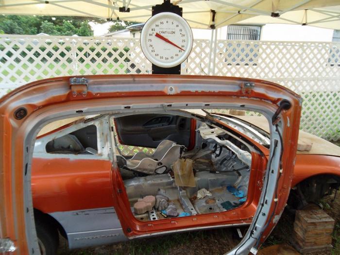

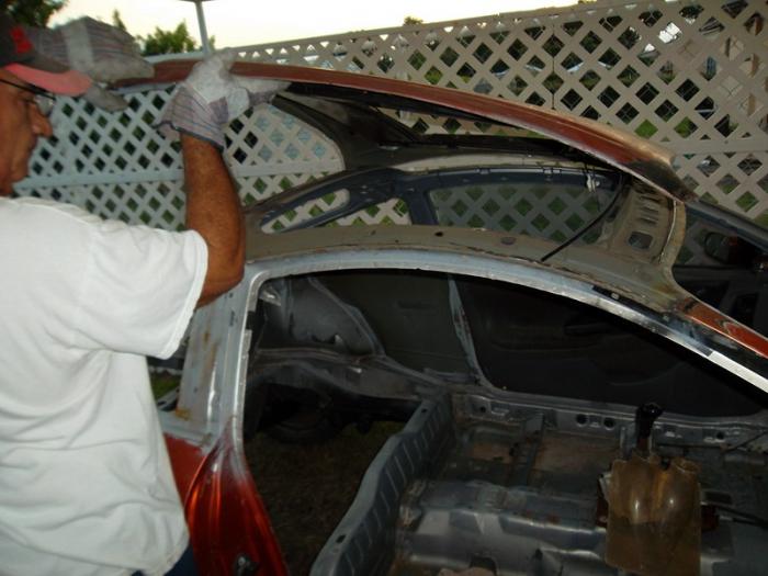

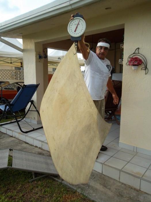

Slowly, but surely the weight keeps coming off

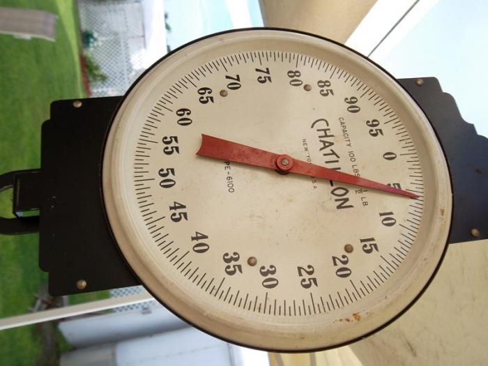

Also I am almost done with the dash board mold, it actually turned better than I expected, I will have to do some touch ups but nothing major, the part itself will come in at about 7# close to a 35# saving.

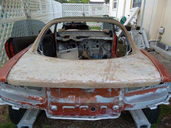

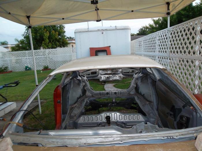

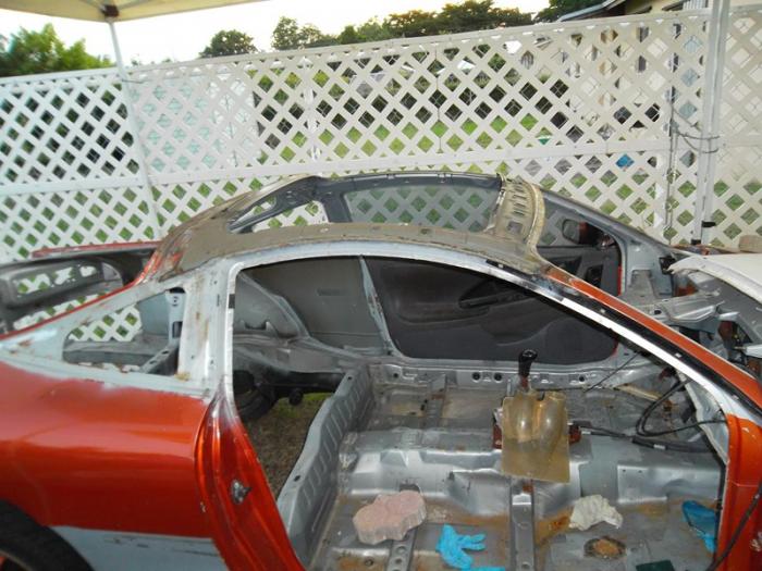

Well getting car ready to go to body shop to have it check out, the car does not look like it has ever been hit and everything I have measured falls pretty close to what they should be.
I have to do this before cage is installed and any welding is done this way I make sure I am working with a body that is not even slightly twisted or not tracking properly and if any issues come up latter I wont go crazy trying to figure out what is wrong.
This is an expense well worth it.
A couple of more pictures, things have been going slow with the car this past wk
