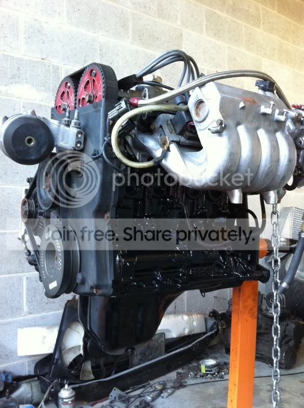

I am going to be freshening up the motor before it's put back in. New timing belt and all the parts associated with doing a timing belt, balance shaft delete etc.

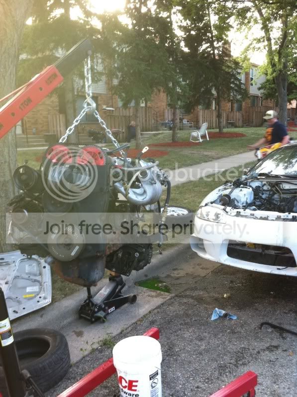

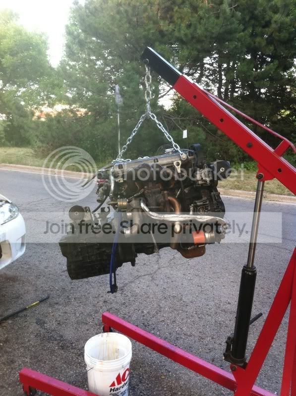

Pulled the motor and tranny this evening. Started at 5pm had it stashed in the storage by 8pm. A lot of work but easier than expected.

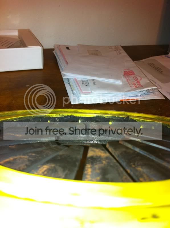

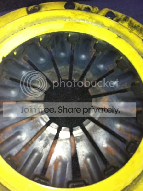

Unexpected thing; I knew something was wrong with the clutch. Wasn't sure what it was. Still felt like a clutch but didn't work at all. Turns out the OEM TOB ate itself and then ate into the fingers. So I gotta buy a new ACT clutch even tho this one has less than a hundred freakin miles on it!
the clutch was the unexpected part. I thought maybe I had broken all the bolts that hold the clutch to the flywheel since I way overtorqued them. Turns out the OEM TOB ate itself. It wore an almost 1/8th inch grove into 6 of the fingers and bent them down. Sucks since I have less than a hundred miles on this clutch.
