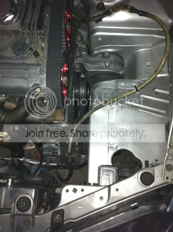

I'm not sure what to do. I had a problem when I was removing the front subframe that the one stud just spun and spun. I'm running into the same problem now that I've reinstalled it. I made a couple exploratory cuts with a dremel tool and it didn't work at all. I'd have to cut thru another layer of sheetmetal to get to anything. And I'm not willing to do that. I will get the removed and cut pieces welded back in but I don't want to do anymore cutting... I don't want to sacrifice the structural integrity. I'm kinda stumped as how to fix it. I thought there would be a large 4 side nut on the top of the stud bolt.

Balance shaft delete done! Kind of a pita! Water pump replaced which was a good thing as the original one looked like it had been hitting itself and scoring the wall. Replaced the oil pan gasket, all front case seals and gaskets and oil pump gaskets. Everything went pretty smoothly. I had a helper who has done about 40 timing belts on DSMs so it made it much much easier. Couldn't have asked for better weather or a better helper. Going to put tranny back on motor and drop into GSX shell Tuesday.

I broke the mid timing belt cover while doing the timing belt. Not going to run the vented cf hood until I have full timing belt covers on it. Going to get one of those Zak Lee clear covers if they're still being sold.
