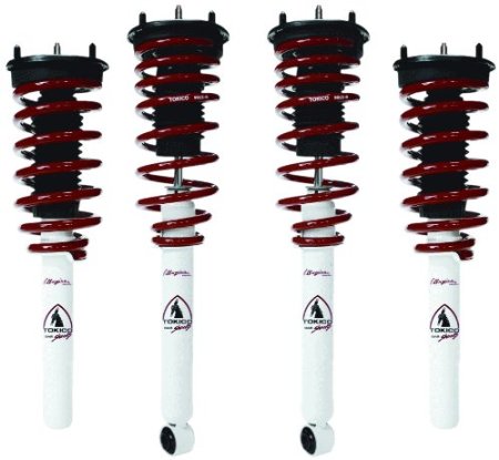

Does it matter what kind of spring you put on the strut? I bought on from amazon and it only came with the strut itself, and im not sure if i can use any kinda spring
Just a stock replacement strut? You should be able to use your stock springs no problem or any lowering springs available for the fwd 2g eclipse/talon.
my stock strut busted and i bought this one and it didnt come with the spring and in the pic it has four but it only came with one it says that it has 5 adjustable ways so im not sure if i need lowering springs or not?
The 5 way adjustable is the dampening setting of the strut.
I as for spring figment I know tokico makes springs for them. I would assume any eclipse spring would fit them.
So you only got one strut not all 4? The car is going to feel very awkward with 1 new strut and 3 old ones. You typically replace them in pairs. Fronts or rears. Or all 4.
yea i know im not putting it on yet im waiting till i get all 4. i feel like those aren't really good so i might try to get a refund and buy some different ones what do you think? are the good?
Personally I have not used them but there are plenty of people in this community that have and the general consensus is they are a decent setup for the money.
You might be able to find a whole set forsale on here. They pop up from time to time.
I run tein basic coilovers. I like them. They are stiff and not really adjustable but I also got a great deal on them slightly used.
