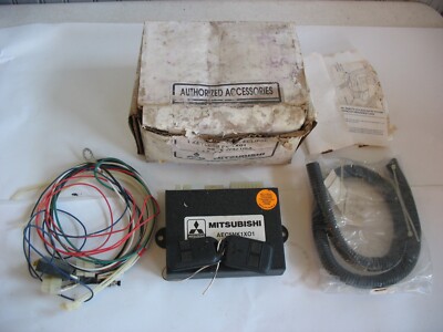

No idea what that Mitsubishi black box is though, The connectors look like something for an alarm or stereo.
I was interested in that too. I have never seen one in any of the DSMs I have worked on.
It appears to belong to a genuine Mitsubishi keyless entry retrofit like the link below. Just when you have thought you've seen it all...
You’re a legend for this, I also have never seen it and I’ve torn several cars down
