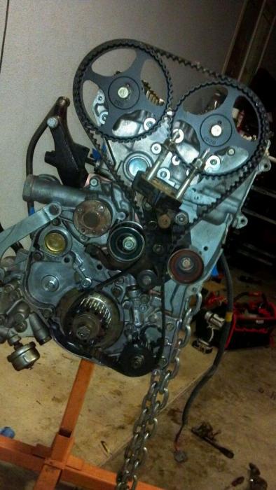

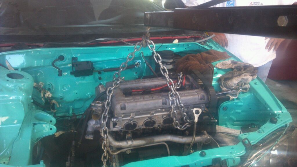

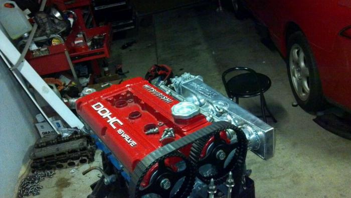

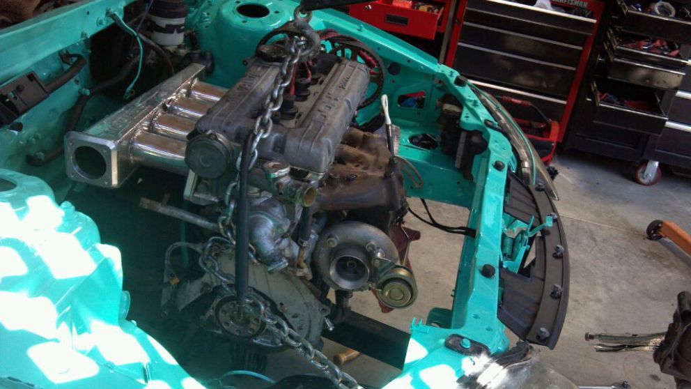

Here's few pics, installed motor to mock up the harness and to know how much/and where to cut to shortned harness.

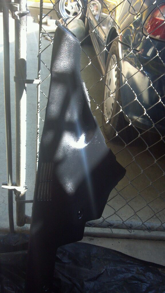

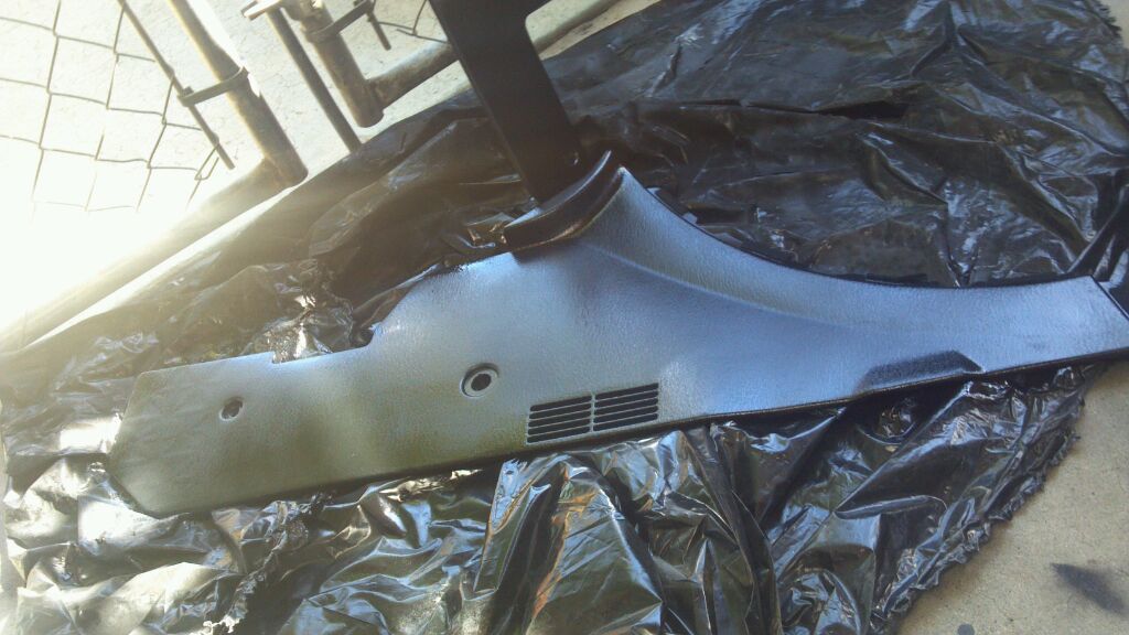

1st coat of black on the interior trim

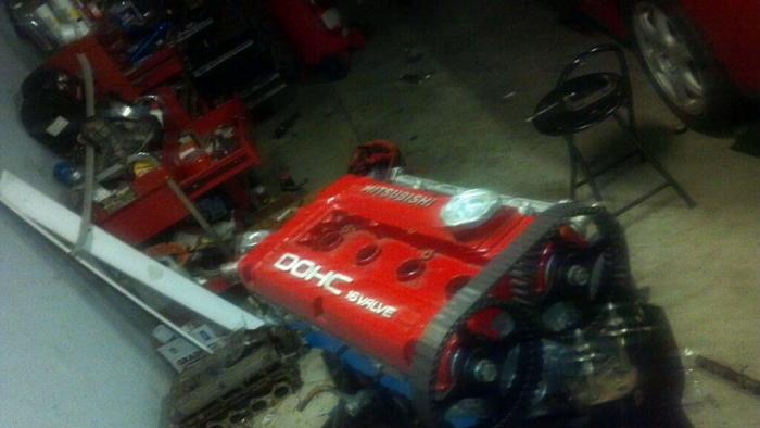

Yea it is. Well actually i had already had the cams, injectors, Turbo, pretty much all mods, only think i struggle for is paint,loom, and electrical tape Haha..its pretty much done, just need buy a bsek and finish painting interior trims

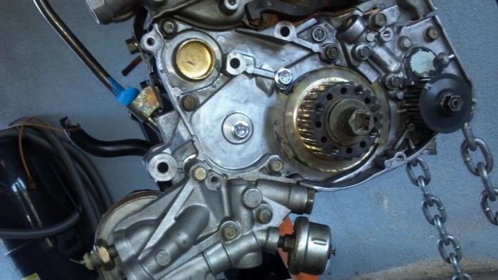

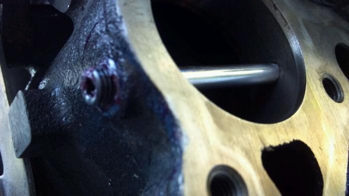

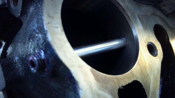

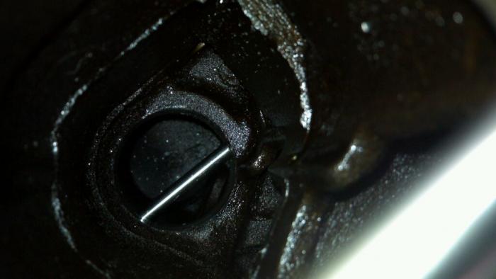

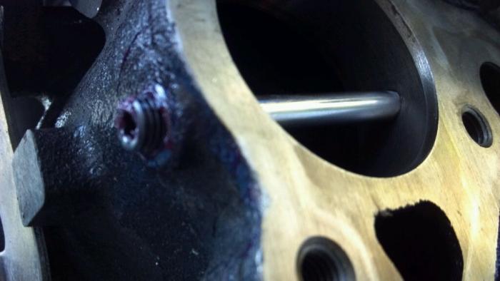

I know making you go back is not going to happen but that Balance shaft metal block off seal is said to be a no-go. instead people use the OEM rubber one which allows flexibility to prevent a leak. Maybe it will hold as good as a freeze plug... who knows.

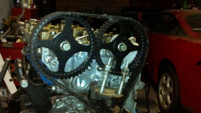

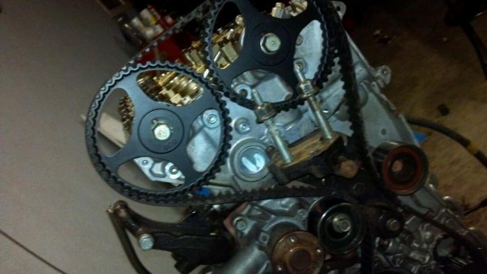

also since we are on that note, did you make sure your stubby shaft has the oil groove and its not solid? again watch out for non OEM stubby shafts. you dont want to tear everything down again because of cheap parts (or expensive low quality parts for some people who dont know how to shop LOL)
Yes it will hold. Its an actual freeze plug pressed in with jb weld. All motors ive build and done bse ive used these metal freeze plugs..Also the stubby shaft is oem..I ordered all my parts through our local Mitsubishi dealer.Thanks tho

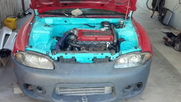

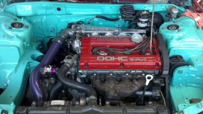

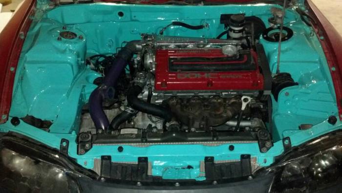

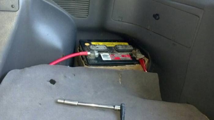

Damn, I haven't posted on this thread in a while. Sorry bout that guys. Just been busy with some other stuff. But I started working on the project these last 2 weeks and finally got it done pretty much. Everything's plugged in. But i need to do some little fixes here n there. Re-do my fmic piping, and other little things. I got anxious today, and wanted to start it, make sure I had spark n fuel after all the cutting and soldering I did in the past year, that was my biggest fear , some kind of short but thankfully, it started right up after little more than a year of the motor just sitting. Anyway, I started it without a downpipe. But so far so good.
Enjoi the pics, lmk what you guys think
