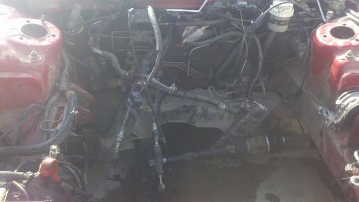

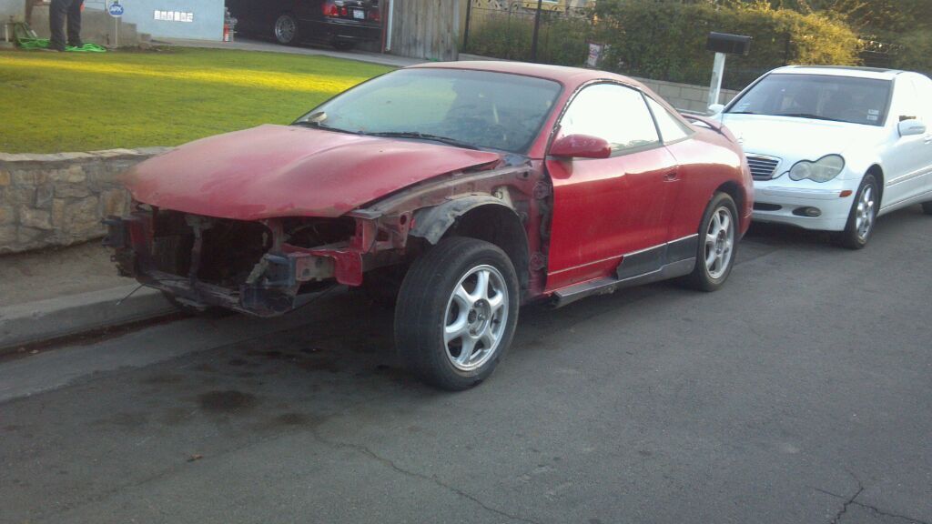

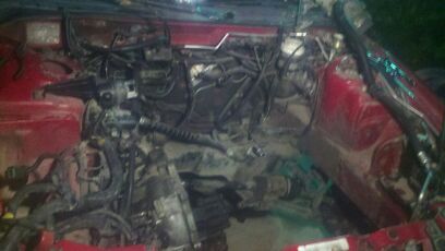

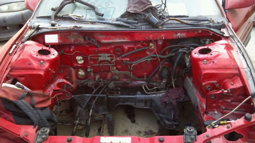

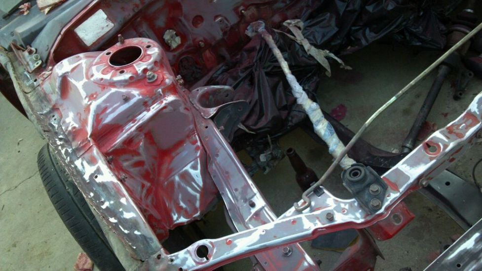

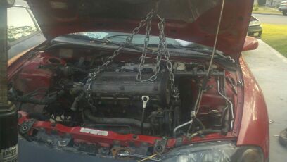

So today(all by myself :cry: ) i removed axels, transmission, engine. thats all i was able to do since it got dark. here's a few pics
ill take more pics tomorrow and depending what time i get off school, im going to start pulling entire harness out and brake lines including brake booster. also start sanding away LOL.

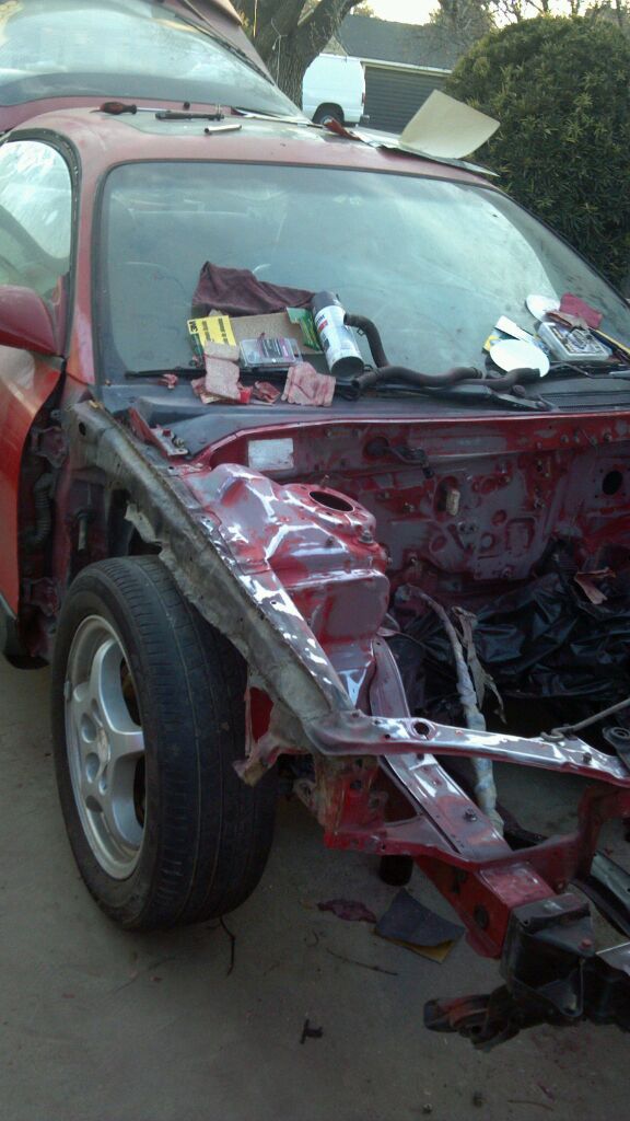

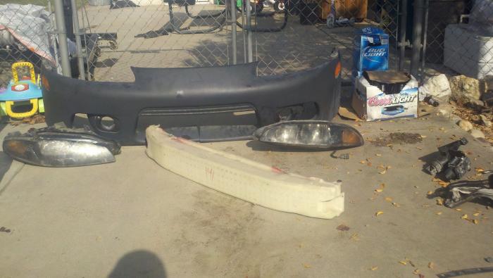

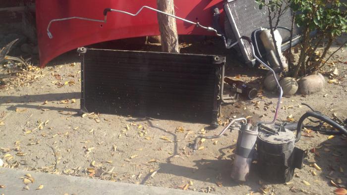

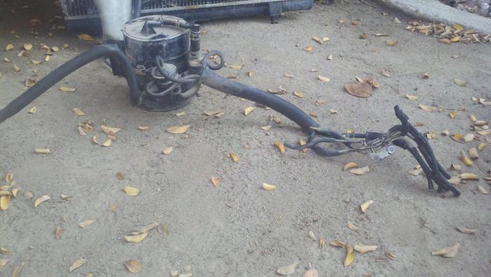

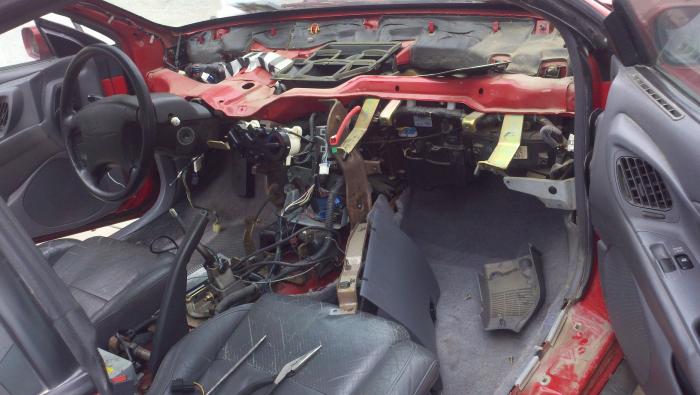

UPDATE: So yesterday i removed the following
:emissions
:everything a/c related
:clutch line
:brake and clutch reservoir
:headlights, bumper, bumper support
:engine harness
:chassis harness
:dash
:shocks and springs
..here are some pics, enjoii....

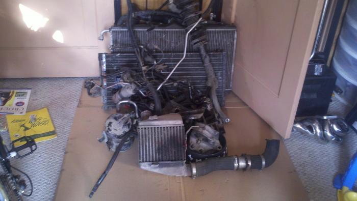

EDIT: well i cant upload the pictures for some reason:cry:, it says to inform the administrators, but once i can i will upload them on here

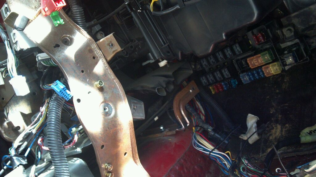

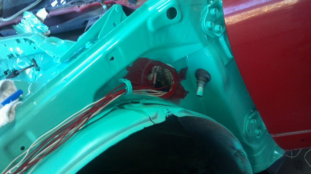

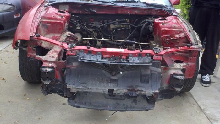

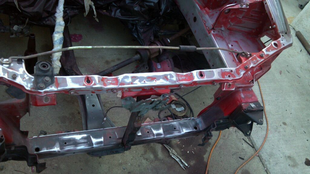

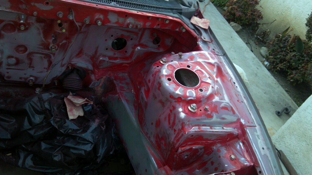

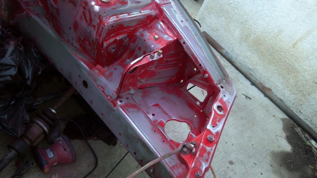

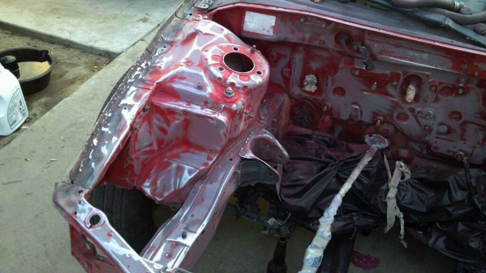

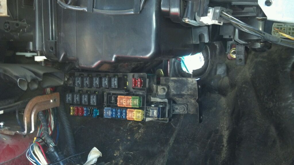

finally, it lets me upload pics. well anyways, this is from wednesday i think, maybe thursday. today i started on the fuse box, tomorrow im gonna mock up the engine harness and cut/delete the sensors im not going to use..

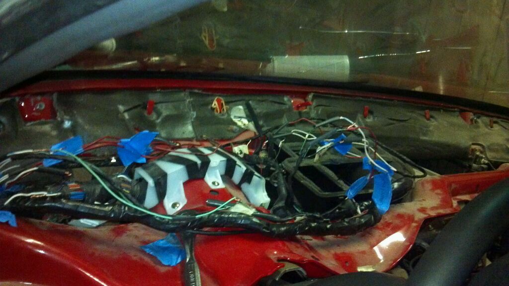

sorry guys, i havent had time to update these pics but these pics are like 2 months old..right after the previous pictures..unfortunately i had to stop because thats all i could do, due to unsufficient funds because i am unempolyed LOL..i just need primer and the paint so i can finish my build..wire harness is pretty much done. ill post pictures of that later on today.enjoii

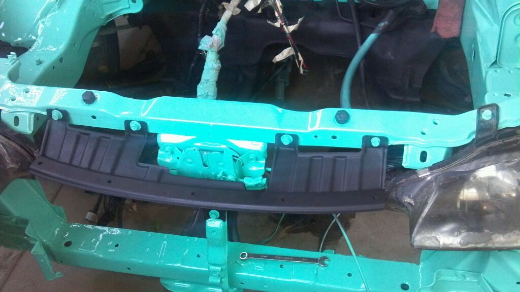

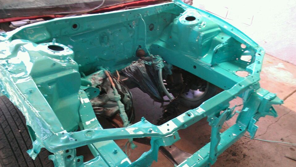

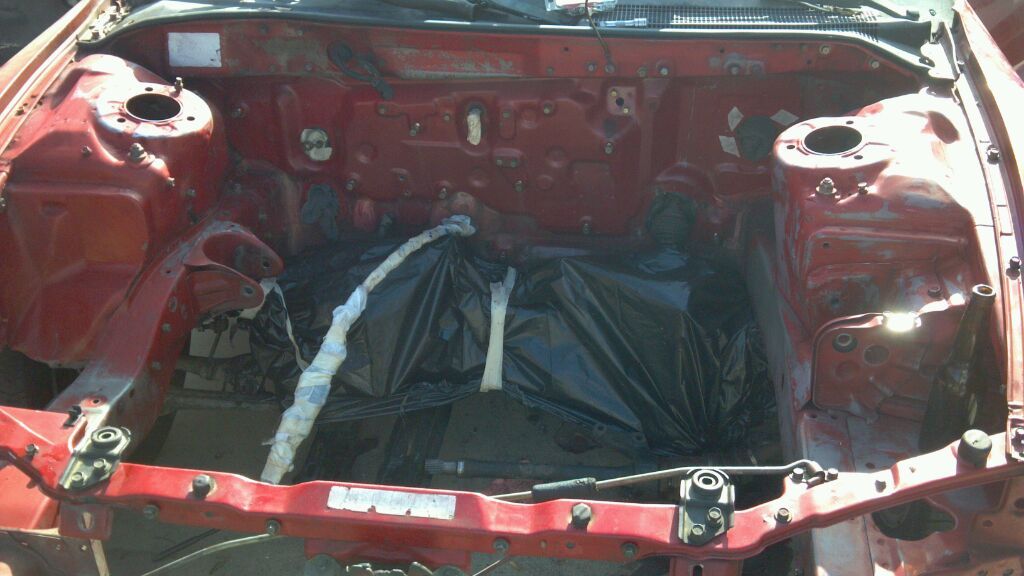

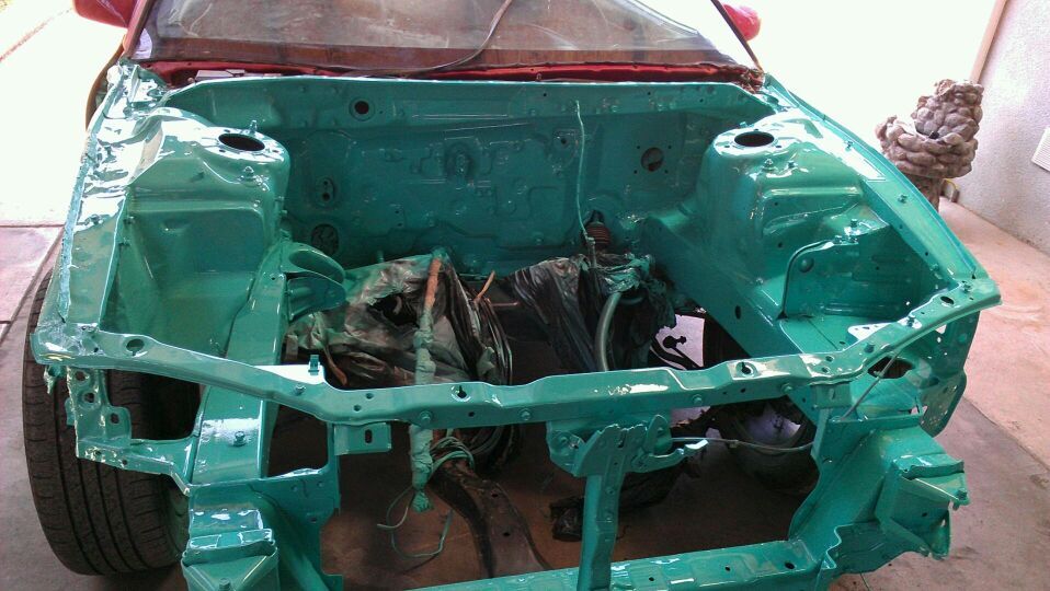

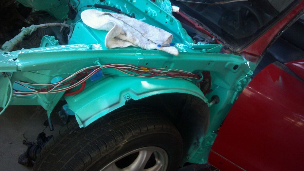

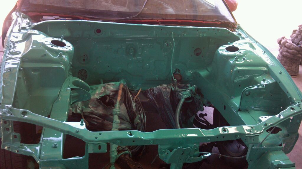

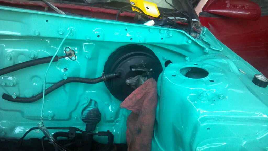

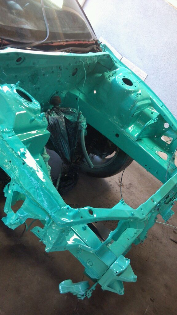

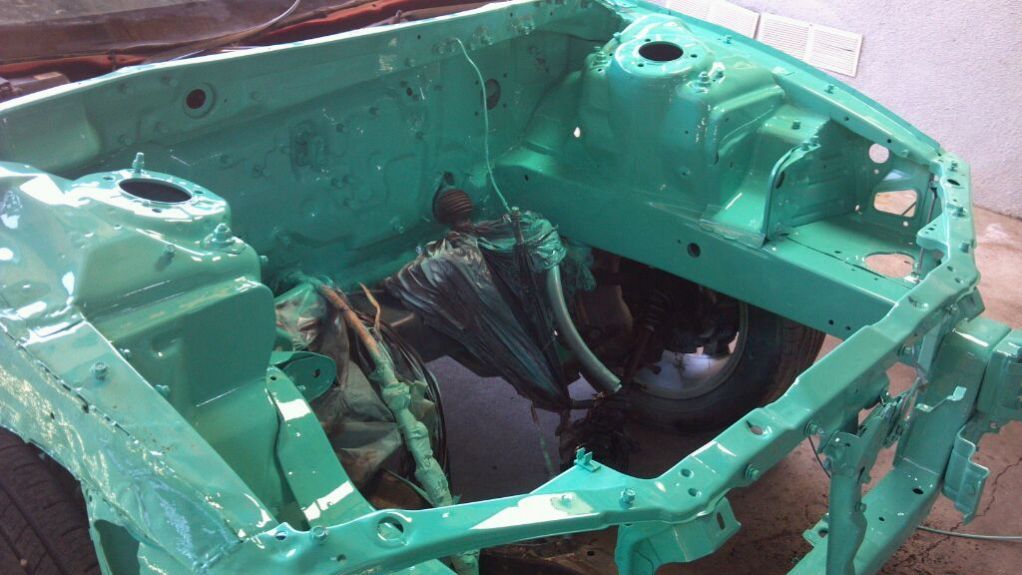

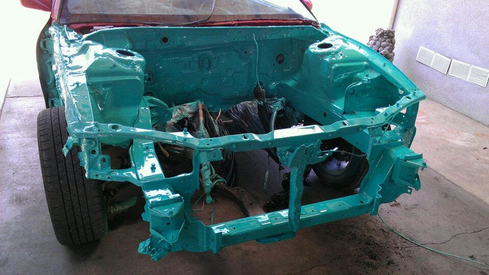

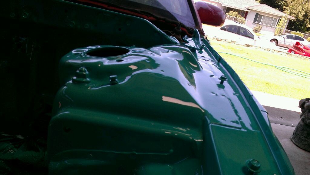

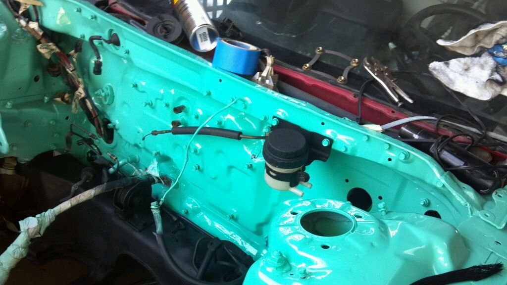

Wats up people, sorry about my build being a slow one but like i said, currently unemployed and going to school so its kinda hard to gather some feds... Well anyway, little update. I'm towing the car to the paint shop to get the engine bay finally painted. Once i get it back, im drop the motor in to mock up the engine harness so i can know exactly where im going to run my harness through and hopefully i dont have to re-solder any of my wires from harness ive already cut and soldered..
Heres a pictures of the color im going with(gs530), might look darker/different in picture than what it will look like omce painted.
and here its waiting for the flat bed
I'm not trying to knock your build or anything, but why would you take all the time to clean up the bay and then paint it, but not take the time to remove some things like the horn, bumper brackets, or bolts?
Im not running the horn so i didnt even bother to take it off yet and didnt care if it got painted over. The bolts i left on but unscrewed to were it's only like 2 threads so paint can still stick on firewall while the bolts can be painted all at once.

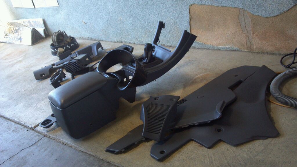

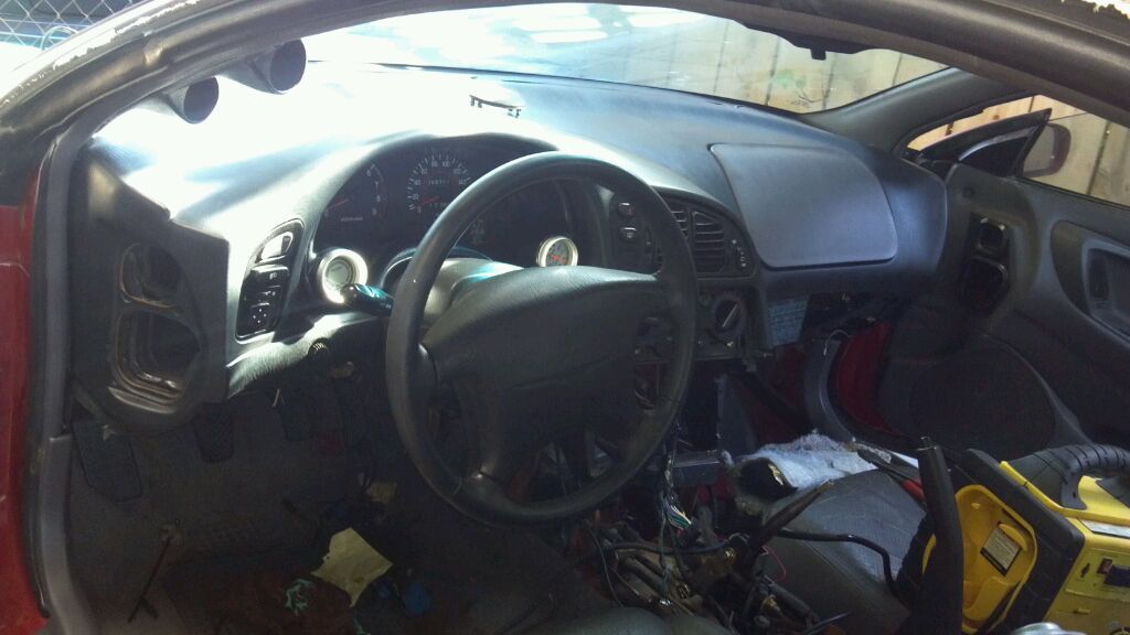

Got the black dash on, hooked up the battery to make sure i have power to everything and make sure lights work,windows, and sure enough lights,dash lights, windows, and tail lights all work..my biggest fear was that id have a short somewere where my lights wouldnt work haha..next is painting interior trims black and dropping motor in =]…pics coming soon
