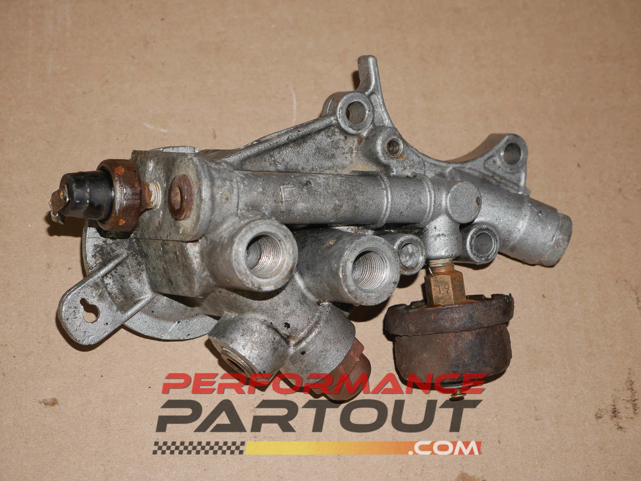

Will this switch on the right be fine? It does not look the same as the OEM, picked it up from auto shop near me. Threads appear to match, the switch currently on my talon has the connector missing and previous owner decided to put a screw into the switch for some odd reason.
The big old one is the oil pressure sensor the new one looks like an oil pressure switch. The cars have both but the one measures the pressure where the other just tells you that the pressure is below something like 7psi. (gauge vs idiot light)

It's all good. Right now I'm a little confused as to where to install my oil pressure gauge, I only see oil plugs where I'm supposed to have the oil gauge connected, none of them seem to have the right size threaded hole. Maybe I am missing something, I can snap a picture in a little bit and see what you guys think
I'm wondering if I need to make my own T fitting like I've seen other users describe when trying to figure this out. Bare with me I'm still pretty new to the 4g63. I appreciate all the help gentlemen
I'm far from an expert on oil filter housings but that one doesn't look like the standard 90 style remote cooler version MD132912.
p1220314__21777-1510868743-jpg.595034
Yours seems to be missing the tang up front where the wires usually clip to and the boss in the back where the pressure sensor goes.
Perhaps someone who knows the options better can answer.
