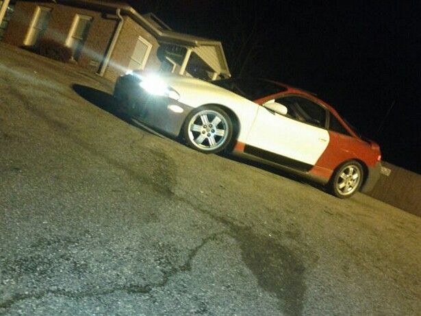

So basically to start I have always like road course races and autocross. LeMan races are the kinda thing I like to watch. I wanting to build my 95 GST to be one bad street\road track car. I do not wish to make it an awd. Maybe on a different build on a different car but not this one. I am intrigued by the challenge of making the fwd stick to the road. I wish to build it to be very agile. The ultimate cornering machine. I have a long road ahead of me. As I am currently only 20 and don't make a whole lot of dollars right now. Only current mods I have right now are from the unfortunate wreck of my much prettier 95 gst. Which are AFPR, 3" apex'i exhaust with no cat and apex'i N1 muffler, ebiach lowering springs, Greddy upper side mount intercooler elbow, and a .40 cylinder bore done with the rebuild. The current engine I do not wish to really build but I have another one with a hole in the block that came with this car and have another block for it. That will be the one I will build then swap in. I want to make it a stroker, port the head and install cams to increase max rpm limit to 8k-9k, use my evo 8 turbo probably with the revshift header or a custom header to give me the twin scroll setup for low end power and fast spool. Still have alot of researching to do on building it but am starting this journal from the very beginning of the long road for this project.

Oh yes engine is new man barely broke in just over 3500 miles on it. Complete rebuild pistons, rings, lifters, valves, hot tanking, bearings everything. Stripped it to bare block then back together again. All necessary machine work to head and block was done. Cylinders were bored .40 over as well. Just need a new turbo and all will be well. It is lowered with eibiach springs and camber kit but the rear is spaced out with thick spacers and longer bolts but the camber is still noticeably negative. Coilovers are a deff thing and will look into kw's. (but what does kw mean? sorry LOL) I'm sure I'll know when you say it. And i definately want to change to poly bushings and motor mounts to. What's a good supplier to get these from? Also want to change to drilled and slotted rotors with gsx calipers or do an evo brake conversion kit for just over 700$. Why change the brake fluid though? Higher boiling point? I'm currently running 225 on 3g wheels but hopefully will be getting another set of vx1's soon and will run a wider tire. They are 17x8 will 245 or 255 fir on these? Thanks for all info given.
also on the sway bar am I looking for a thicker rear sway bar? I'll be doing calculations and research on everything but would like personal opinions on the subject as well.
