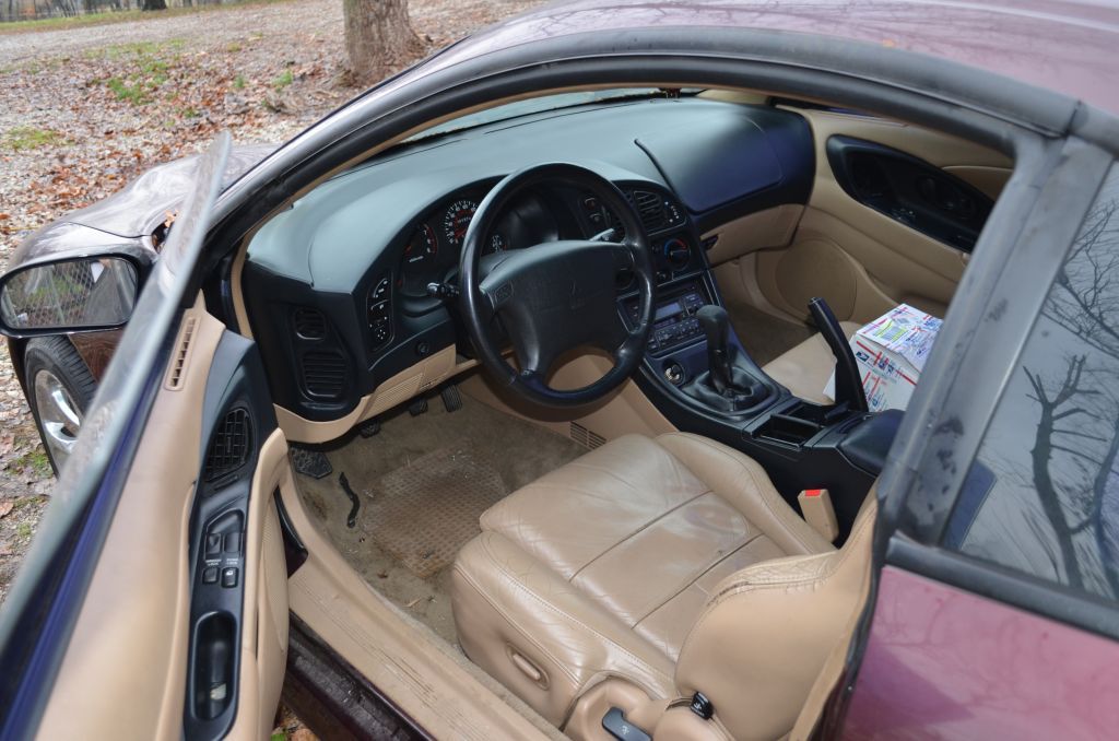

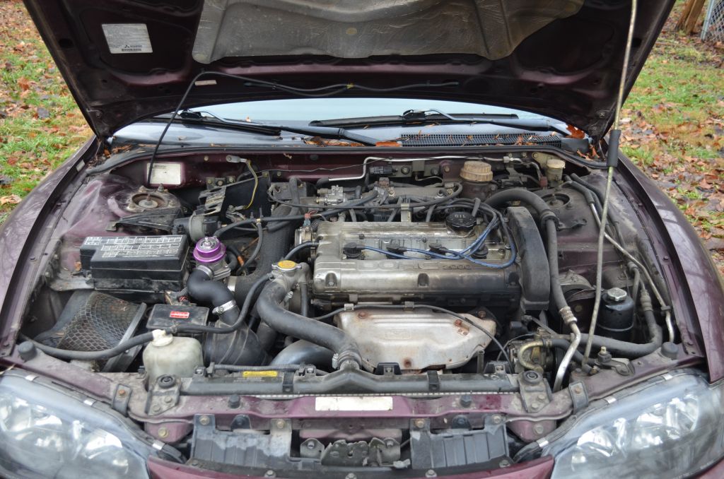

Okay now some pictures of the car, she's a dirty girl but it sat outside for over a year, nothing a good bath can't clean up.
Let me know what you think. Any ideas or suggestions, I'm open and look forward to sharing this build with you all.

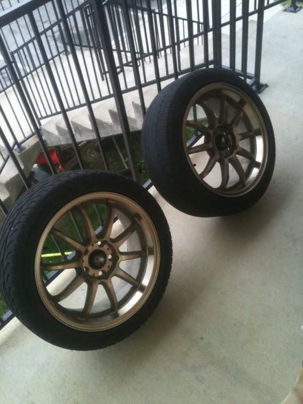

Also, what wheels and tires do you plan on running?

Never thought at this. I don't plan on going stupid low, just a little lower than stock, but if I run into a problem I might do something like they did in the other posts. I have some 17x7.5 HD Clutch Rims, Bronze in color. Tires on the rims right now are 215/45R17 Goodyear Eagle GT's. Probably going to change, don't know but my step-son runs a tire shop so I can get a great deal on tires :thumb: . Here's a picture of the rims. It's not the best but gives you an idea.
