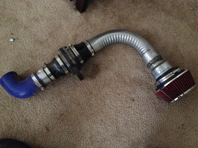

Picture update/Intake Manifold Gasket/GM MAFT/LC-2

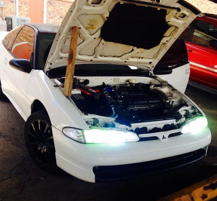

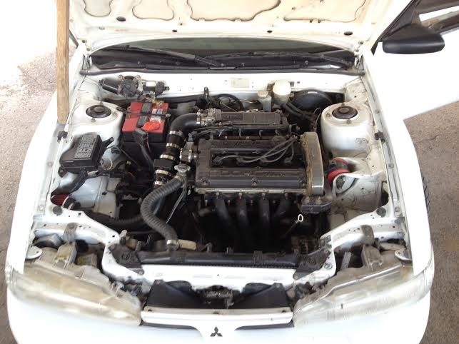

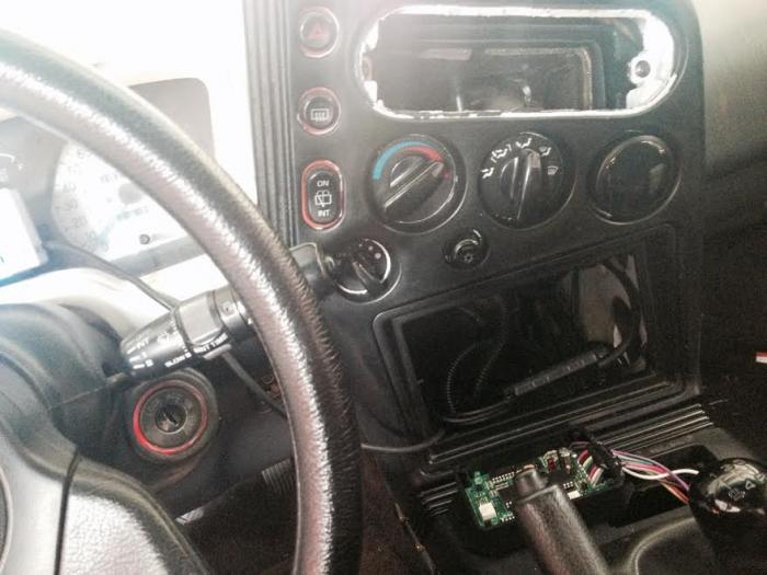

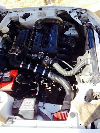

-Engine bay after the GM MAF and Translator installed. Translator is installed inside the cab.

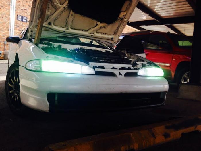

-Had some extra HIDs laying around' so I hooked it up to the brights.
-Without brights on.
-Wider view of engine bay

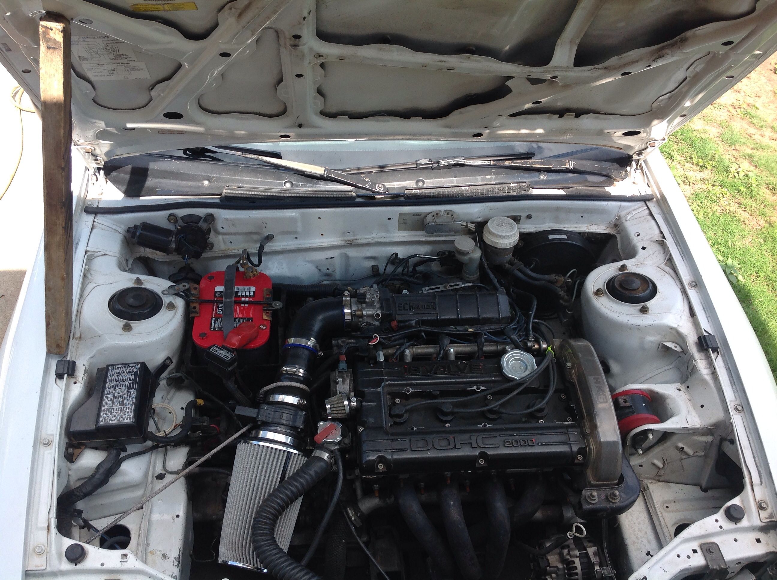

-Open hood - Don't mind the wood :p
-Close up

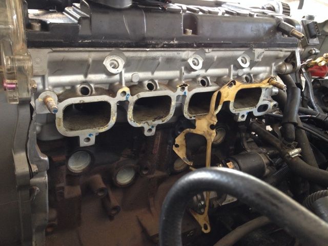

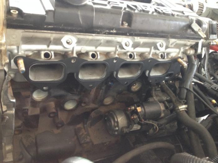

-Old IM Gasket
-Cleaned and OEM Gasket
-First Interior Picture of the Build!

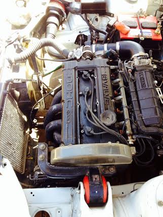

I feel like the blue 90 coupler and Red battery are throwing my bay look all out of whack :notgood:
I'll see what I can do about that... I also plan on coating the intake pipes I have black. I like the idea of a stealthed out bay. :ninja:

Intake Stealthification :ninja:

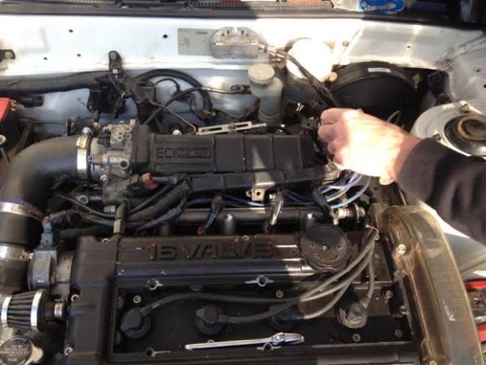

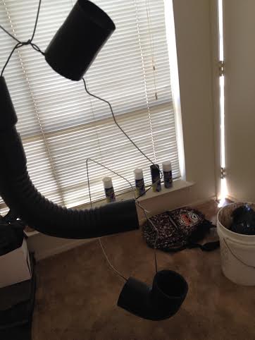

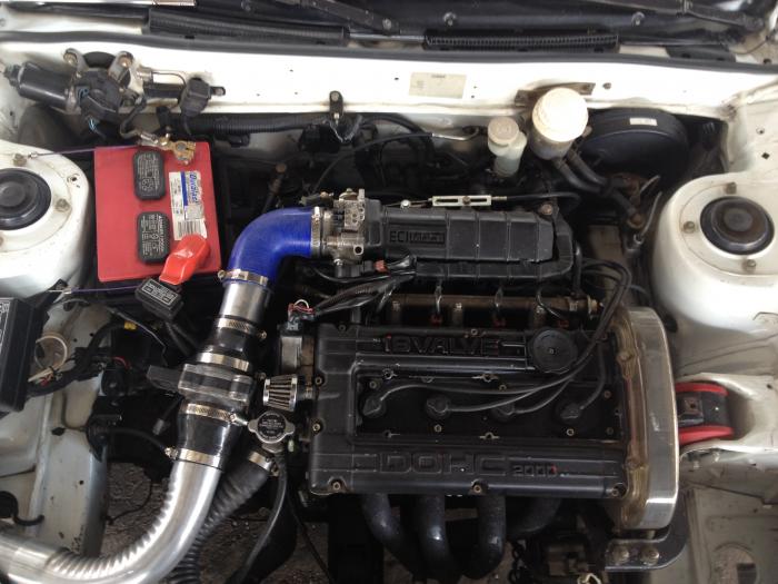

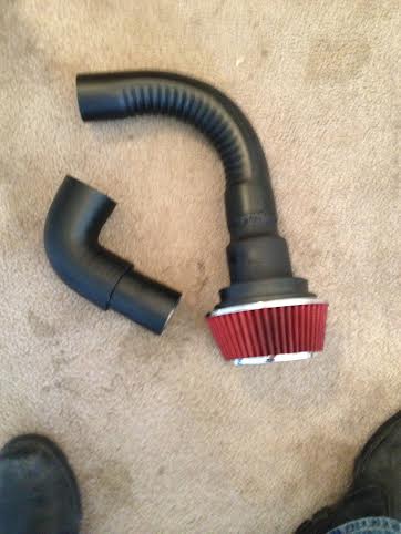

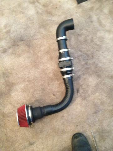

So I decided to address my discomfort with the look of my intake setup, looks a little thrown together. Here is the whole setup from the throttle body. I welded up the reducer by the filter this morning. I need more welding practice they came out ooogly.
Took everything inside, disassembled it and washed everything. Except the MAF of course.. After the cleaning I gave the piping a 2 coats of header paint, than 2 coats of my favorite stuff. :sneaky: The blue 90' coupler I sprayed 3 coats of plastidip. Everything came out pretty nice but it's still drying.
Now we're getting somewhere..
Ahh, much better :thumb:
& Reinstalled.

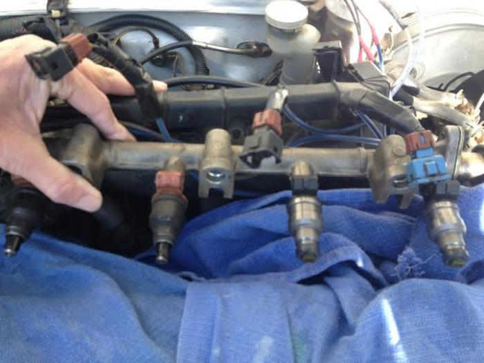

450 Install, First logs

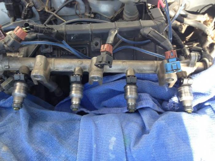

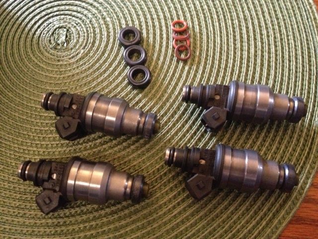

450s arrived, along with new O-rings and insulators, resistor pack, and my ECMlink cable.
New O-rings and insulators on
Old 240s on left, new 450s on right.
All new

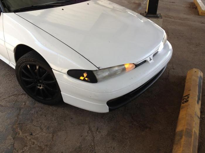

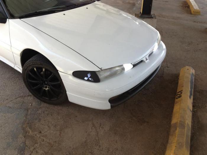

I didn't like how my corner's looked way newer than my headlights, I still haven't found a set of clear headlights. To deal with that, I decided to see how it would look to paint the corner lense black with a Mitsubishi emblem showing the light, with some careful taping and preparation they came out pretty nice..
Running lamps, no headlights.
Right turn signal.
I'll take some pics tonight to see how they'll look at night.

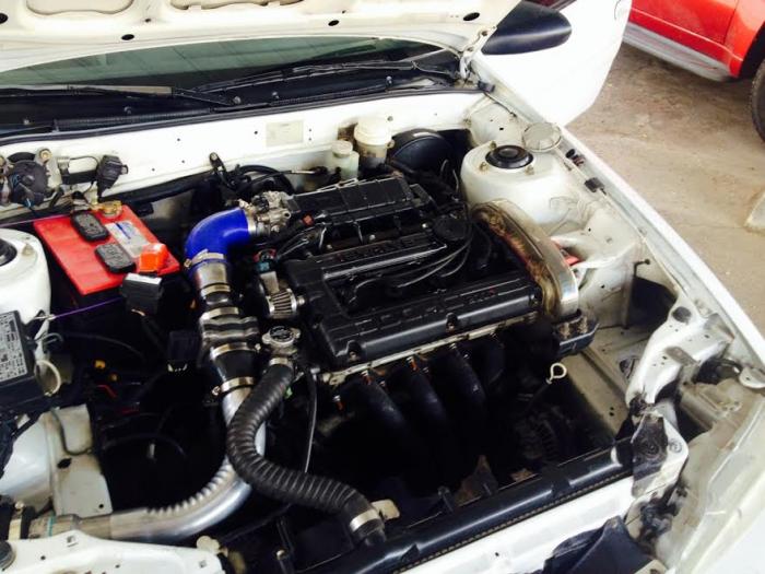

Got rid of the 90° 2 1/2" pipe for 3" diameter I'm running directly off the GM MAF. Also got an Optima from my work for a good deal. My old battery was leaking. Plus it was from auto zone :barf:;)

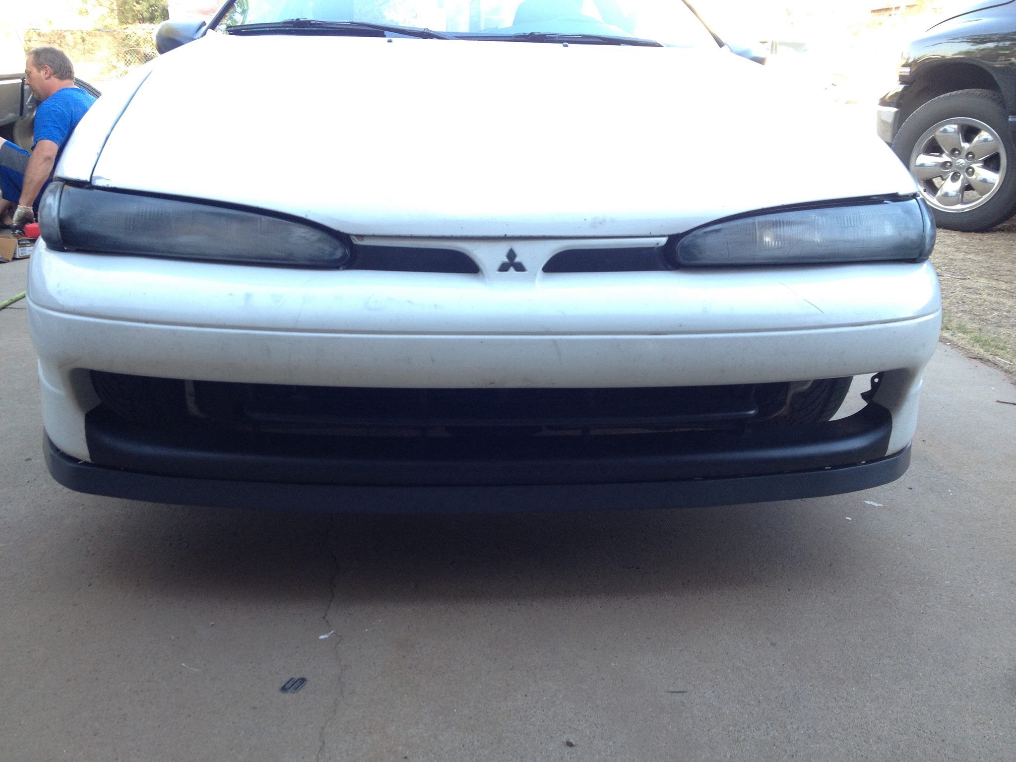

Also got rid of the diamond corner lense, just left 'em a little smokey.
Front lip anyone? Turned out alright. 10256787_303492679813742_4557551847224020026_o.jpg

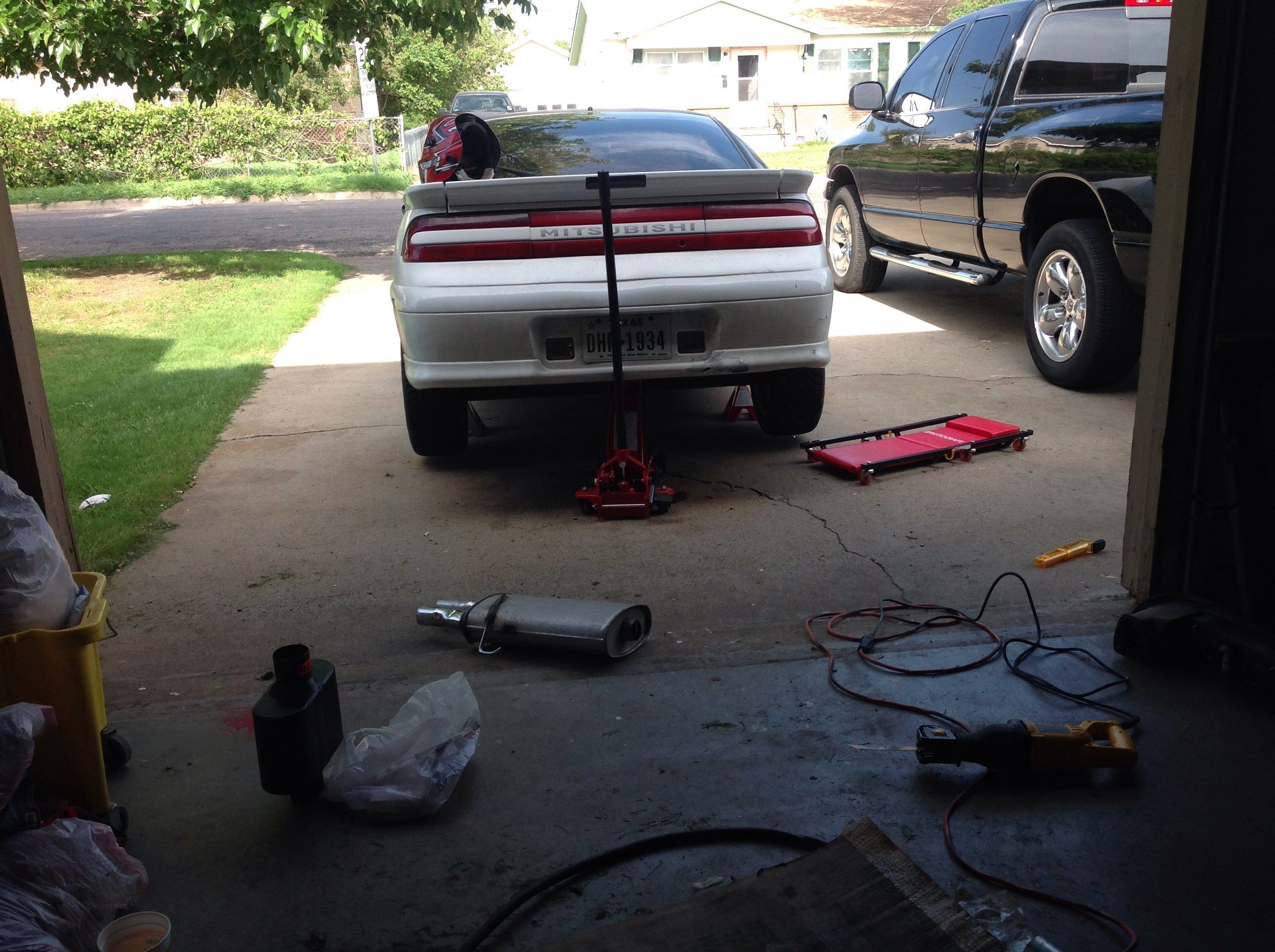

Also found some tailights at the junk in damn good condition, picked 'em up for 60 bucks. I changed mufflers from the unknown brand, it was sounding as little raspy at certain Rpms and I didn't like the dual exit. Switched to a Flow 10 series which is a little loud. Thinking about putting a resonator in line to tone it down a bit.

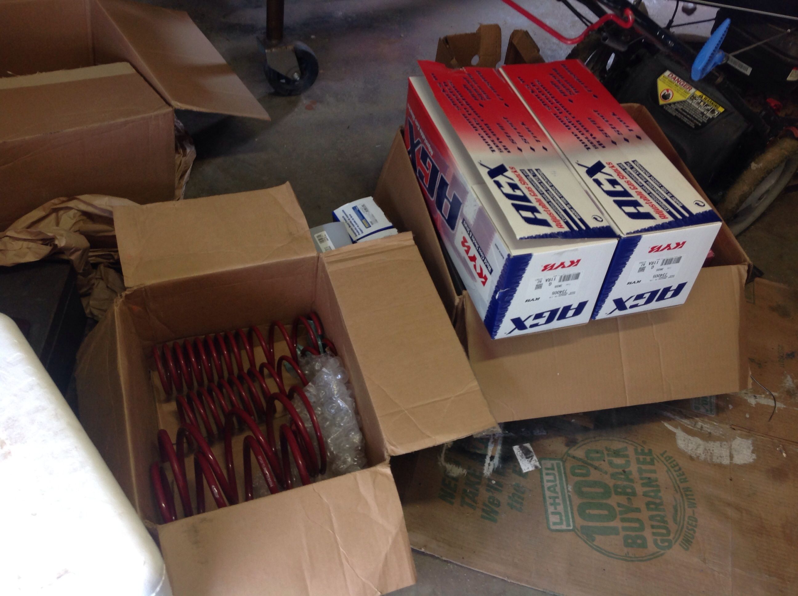

Suspension stuff finally came in today!!
Got the new springs and struts installed. Gives a nice subtle look without dropping it too much, I like it !
