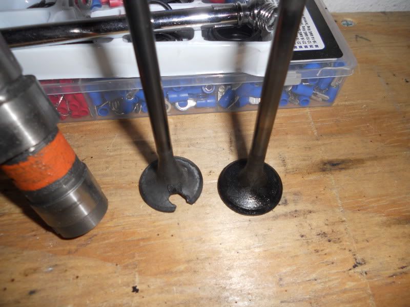

When I bought the car, it ran, but ran EXTREMELY rough. Due to the way it idled and didn't rev up very well, we knew there was some form of "vacuum" or air leak of some sort. Well, when I pulled the head off, here is what I found:
I would have to say the leak was found! So I took the engine and trans (along with everything else except the wiring) from the engine bay and interior to lighten the car. Eventually I will cut down the wiring as well to save even more weight. If I want to go for the record, I'll have to shave every ounce I can. The previous owner before my buddy let the car sit out for a while. It was shaded very well, so the car isn't in bad shape, but there was tons of dirt and mud and spider webs everywhere on the exterior and engine bay. About three weeks ago, I decided to go ahead and clean up the engine bay and all the doors and hatches.

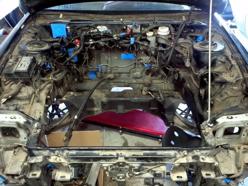

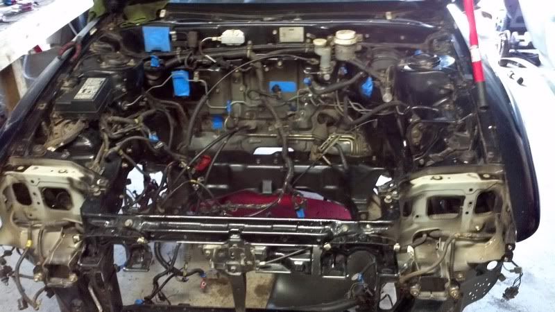

Engine bay before cleaning:
Engine bay after cleaning:
Came out pretty well. I just used some light spray cleaner and cleaned it all by hand. Considering I didn't remove the wiring, I was happy with how it turned out. The rear hatch and the door trim came out very nice as well.

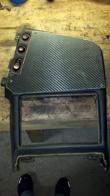

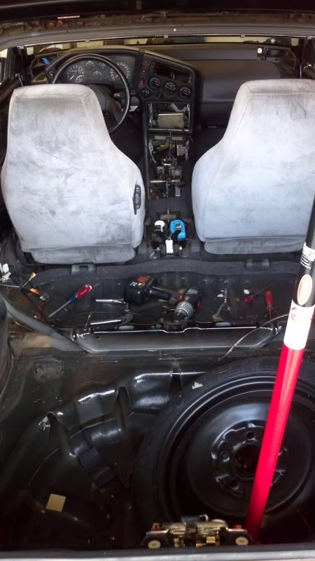

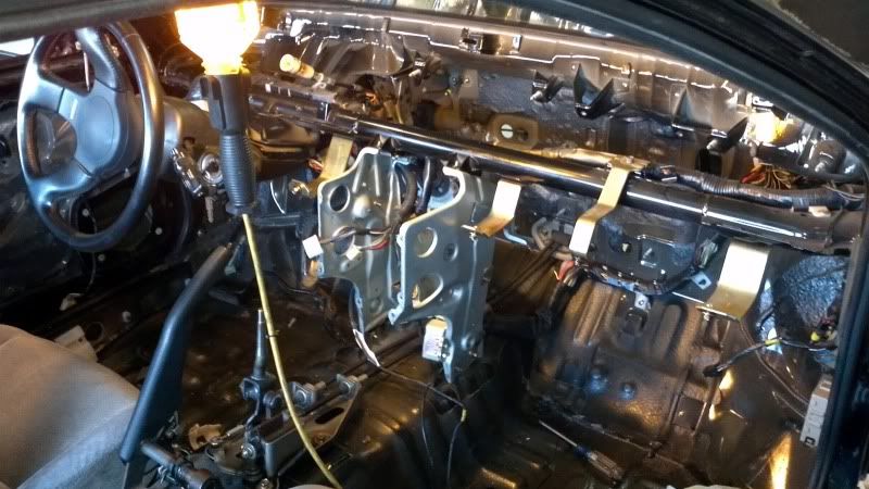

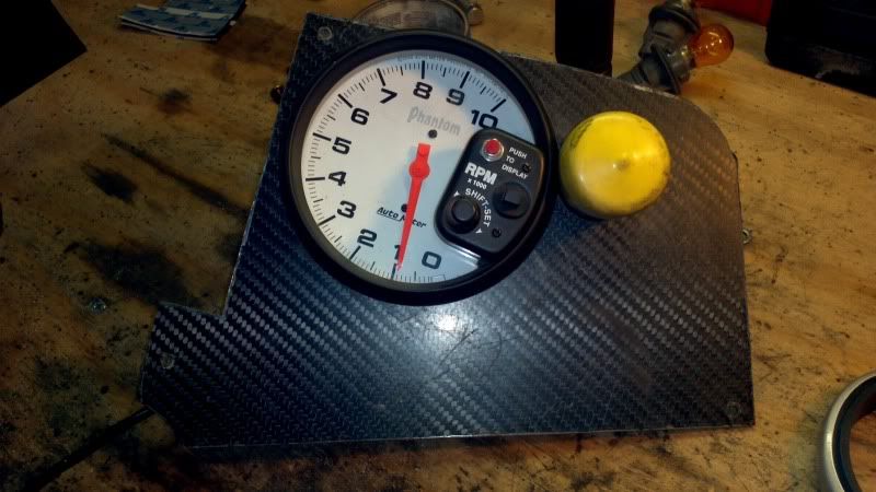

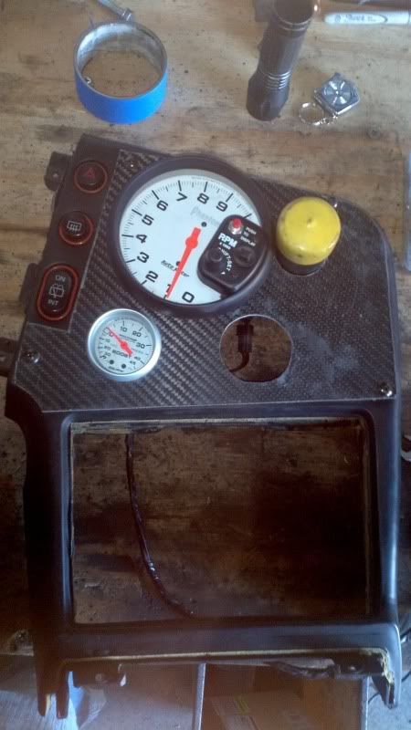

For the interior, I didn't go too crazy yet! At least that's my feelings. I have removed most everything that "bolts" into the car. I reattached the stock gauge cluster, gauge panel and the radio/dash panel. I wanted to integrate a 5" tach with shift lite, a boost gauge and an AEM wideband. I didn't want to just bolt down the gauges to the dash, so I made a custom gauge panel out of carbon fiber. Here are a few shots of the interior as well as my gauge panel. Feel free to post up any comments. I'll be posting more when I get my motor, trans and quite a few other parts over the next couple of weeks!
Interior pics:
Gauge panel pics:

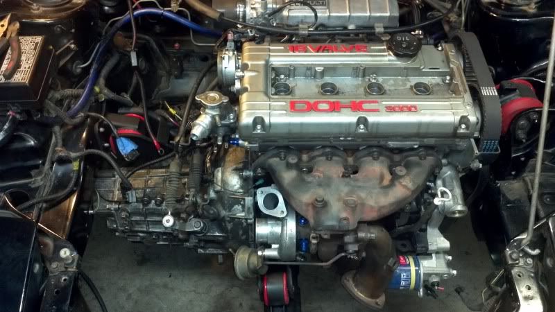

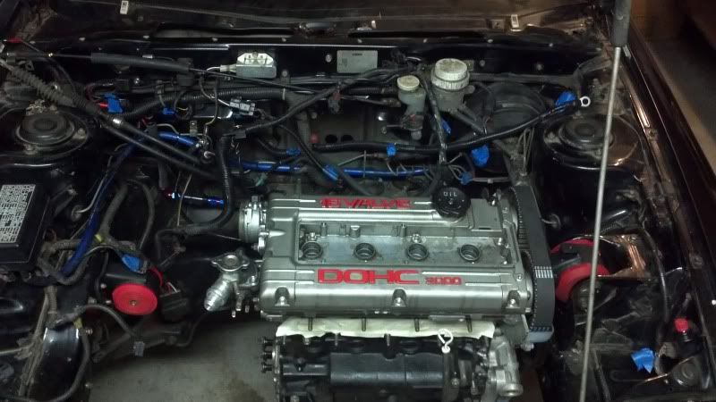

Here are a couple pics of the motor installed. Got it installed along with getting the new fuel filter with AN fittings installed from the stock feed line. I really like how the engine bay is looking, but I do plan to do some work to the valve cover to make it stand out a little bit. Not sure what "scheme" I will go with, but I'll figure out something!
Pics:

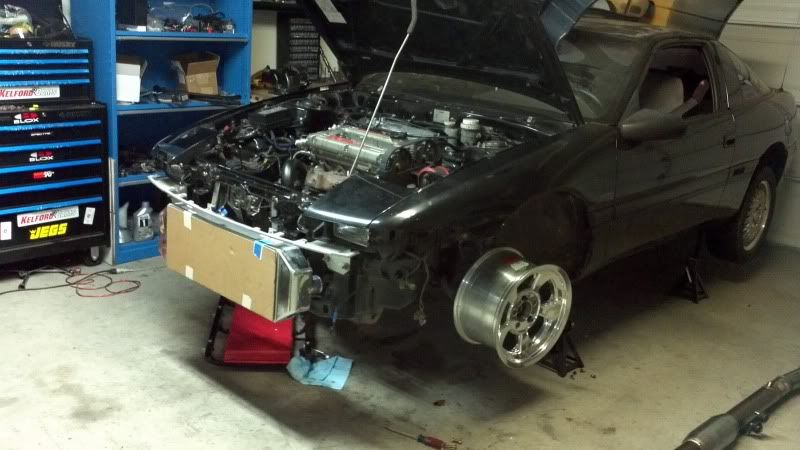

The last big item left was an intercooler setup. On my Laser, the front bumper doesn't have a front lip, so the front bumper is VERY short. That said, with the SBR intercooler installed, it would hang about 2" below the bottom of the bumper. The intercooler measured at 12" tall. Enter the ETS race intercooler! They measure in at 10.5" tall, so it should fit very well and have at most a 1/2" of core hanging below my front bumper. And at $599 shipped with the cast end tank cores for a full intercooler kit with all piping is an awesome deal. I ordered up the intercooler kit yesterday with an IAT bung and TiAL bov flange! Can't wait to get all the parts delivered so I can get it together!

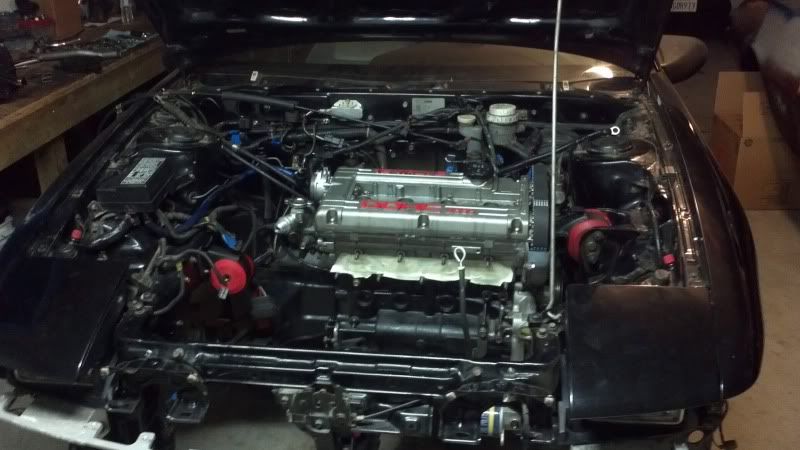

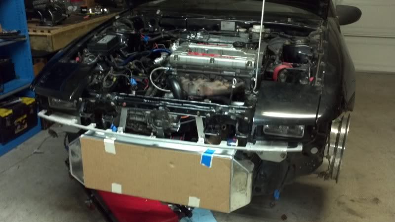

More updates. Spent about an hour or so on the car last night and a couple hours on it tonight. The one thing I wanted to work on was getting the fmic and piping 'mocked' up to get the mounting brackets cut to make sure the intercooler is ready to be installed when that time comes. That said, I just temp installed all the pipes (no clamps) and put the intercooler in place with some supports underneath to hold it up. This allowed me to get the intercooler where I wanted it and figure out where I wanted to mount the brackets (flat aluminum). I think it turned out pretty good. Here are a couple of quick pictures of the intercooler mounted with the cardboard still in place to protect the fins!
Also thought I would throw up another quick shot of the engine bay as it currently sits (minus the piping).

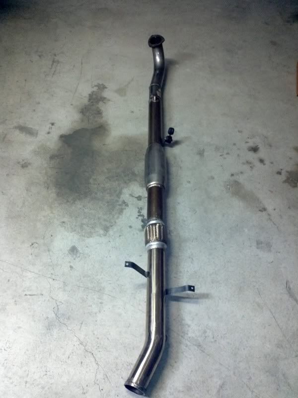

Last thing I wanted to talk about and post a pic about is the exhaust I fabbed up. Very simple, all stainless steel. I might have to get a second resonator installed to make it a bit quieter since I still want to drive on the street from time to time...however, if I sink much more money into the exhaust, I'll probably just have an aluminum exhaust made with two decent sized resonators. Shouldn't weigh too much. This exhaust is about 7' long from start to finish and weighs about 25lb.
Let me know what you guys think.

I got a good bit done over the last few days. Finally got the bumper cut to fit the intercooler, finished installed the fmic and piping with corners lights and front blinkers, made brackets for my radiator and got it mounted. Also got the coolant lines made for the radiator. I decided to go with all AN fittings and hoses. I got all the water/oil lines for the turbo made and installed. I reused the stock battery tray, but just mounted my mini battery on it...just used a stock tie down. I cut a chunk out in the middle of the tie down so it fits snug on the battery...then I welded it, sanded it and painted it. I also painted the tray black. The last thing I was doing tonight was putting the gauges on a switch. I have no reason for the gauges to be on 100% of the time, so now they don't have to. I also put a momentary button on my gauge panel in case I decide to go with a push button start....not sure on that one yet.
I'm down to just a few things...getting/installing axles, boost/vacuum lines for MBC and BOV, waiting on a coupler for my 2g intake pipe, get fluids put in, get the exhaust put back on...and get a good base map to drive on. That's about all that's left. Seems like a good bit, but most of it can be done in a couple of hours.
