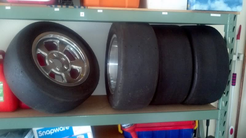

Picked up the slicks. Very nice tires with a LOT of life left.

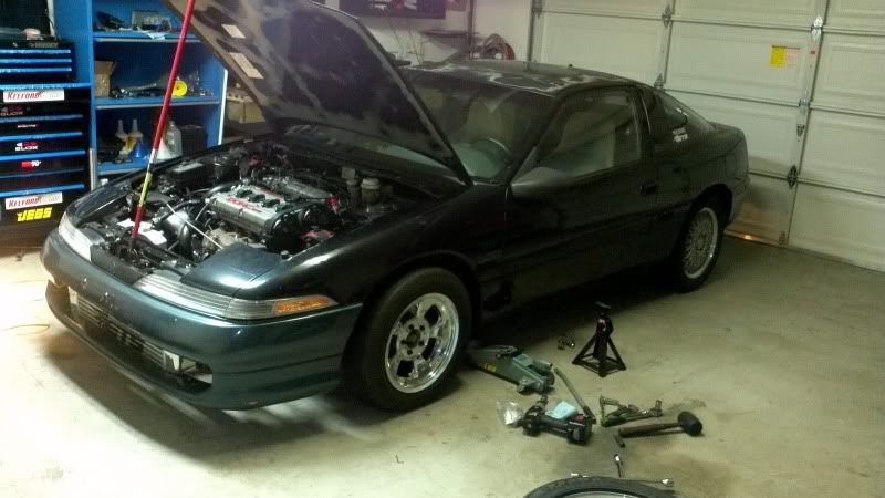

Here is a picture of the wheels/tires on the car. Don't hate on the hood prop! :)

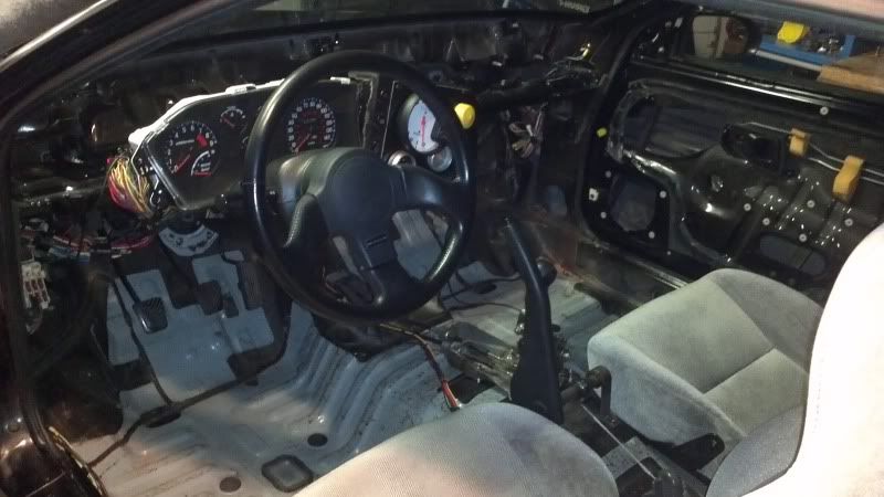

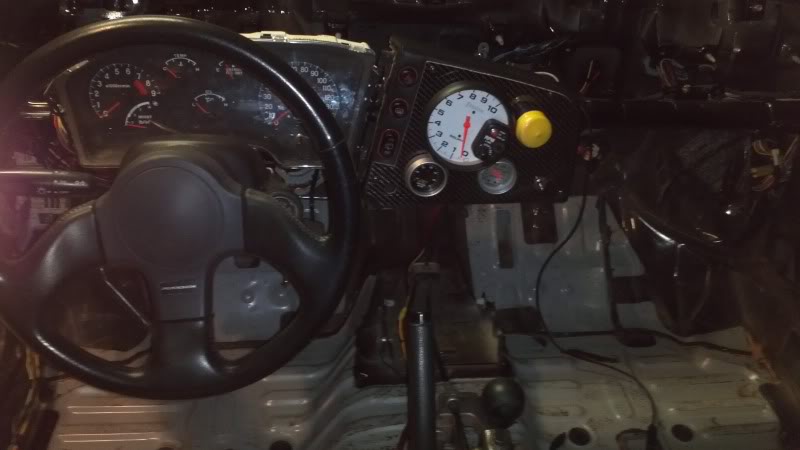

I also got some digital scales from a friend to get the true weight. In race trim on Mar 18, the car weighed in at 2169 lb. On the 22nd, I removed another 24.6 lb of wiring, brackets, etc from the interior. So the car now is down to approx. 2145 lb without me. I still have quite a bit left to remove to shave a bit more weight as well!!! Here are a couple quick pics of the updated interior!

I have been wanting to make some dash panels like that to put my gauges in for my car, nice work. :thumb:
And thumbs up for the color of your car. :thumb:
