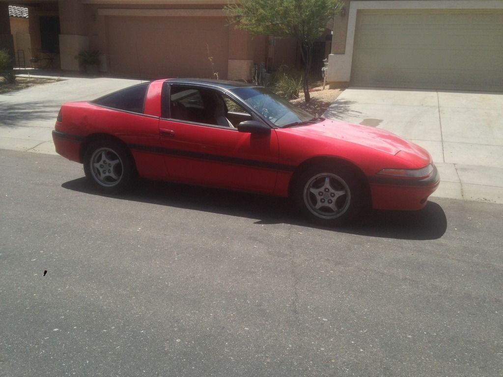

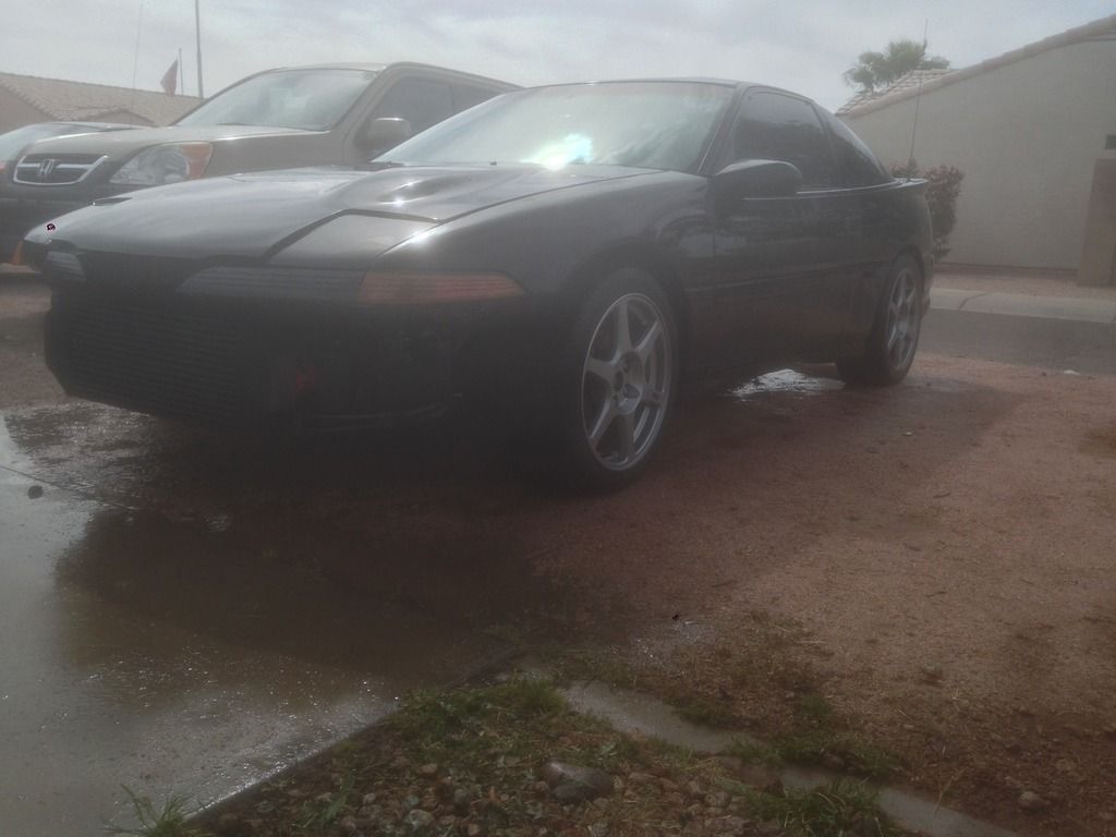

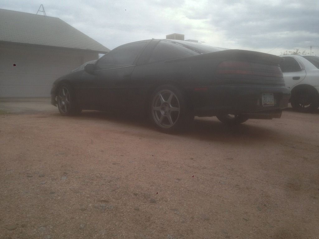

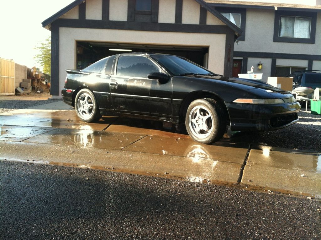

Hello Tuners im starting a build thread for my GST I call the Black Widow I started this build back in 2013 I had some ups an downs in life an had to put it on hold for a while.

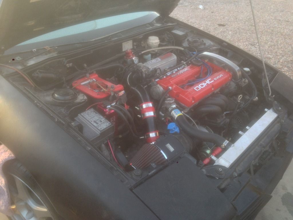

I picked up the car for $300 came with a trans an complete head no motor. The plans for this car is to DD it but have some fun with a cyclone intake an a 20g or 16g havnt decided yet plus a few other goodies. Heres the pics an thanks for checking out my thread.

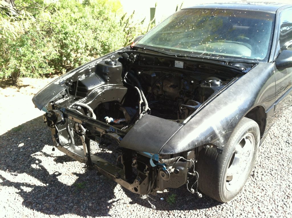

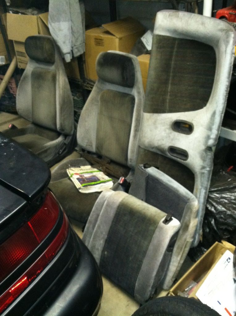

The following pics are of how I got the car.

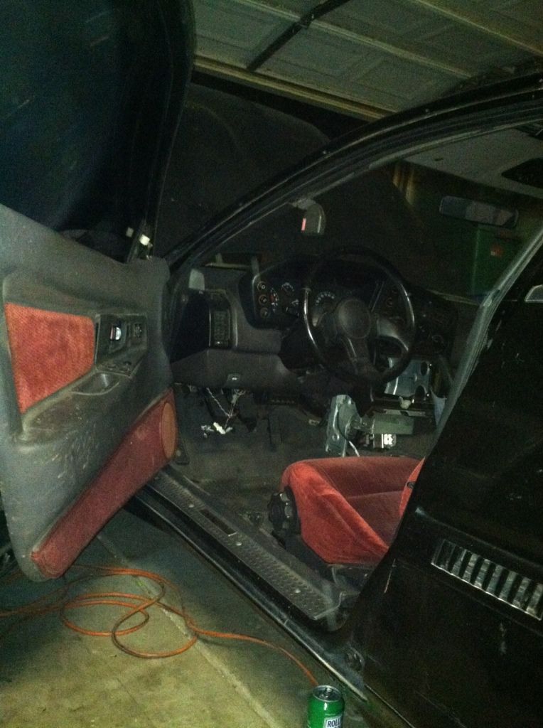

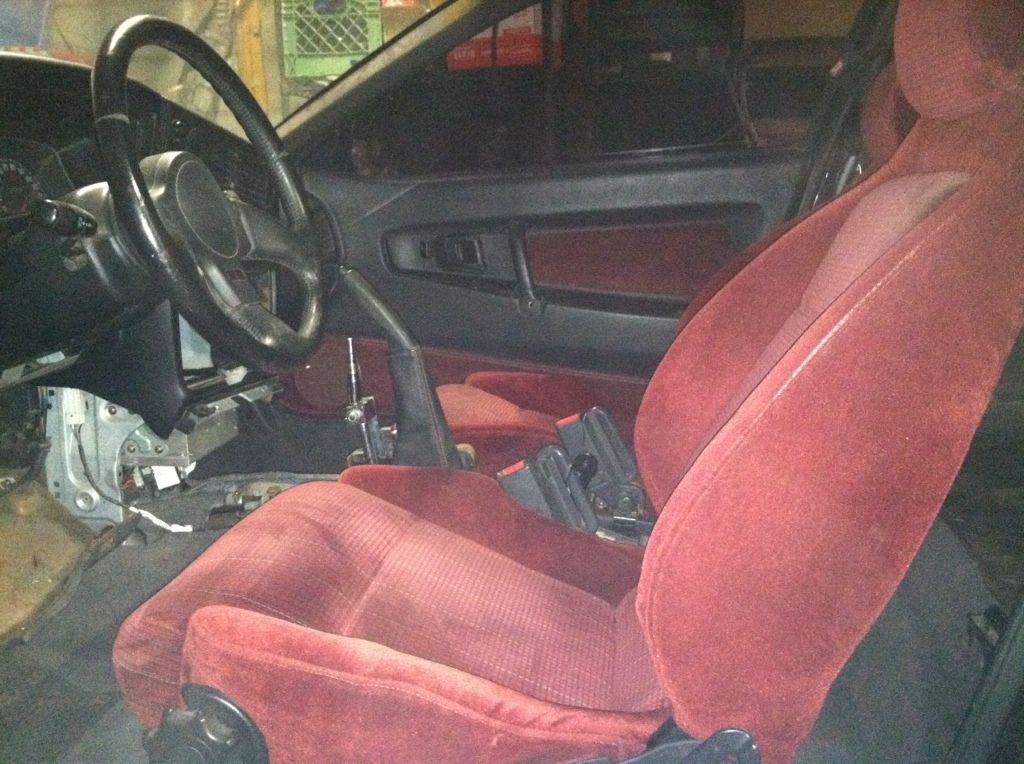

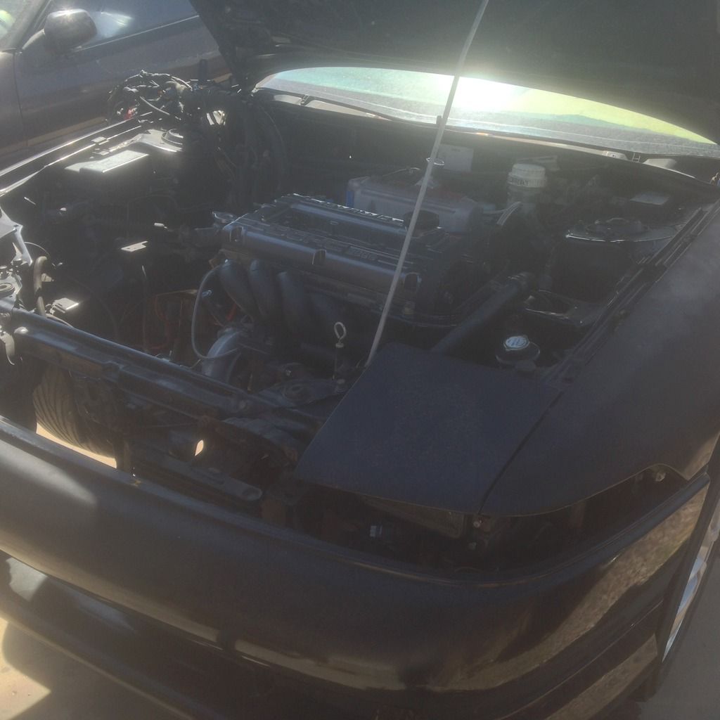

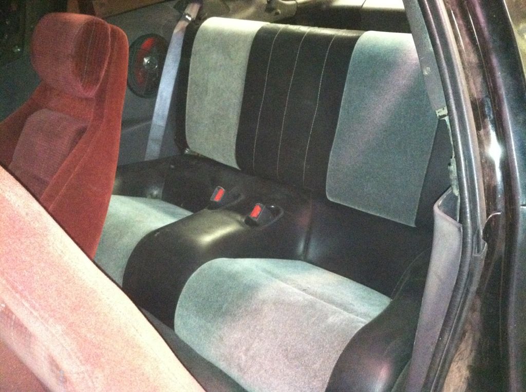

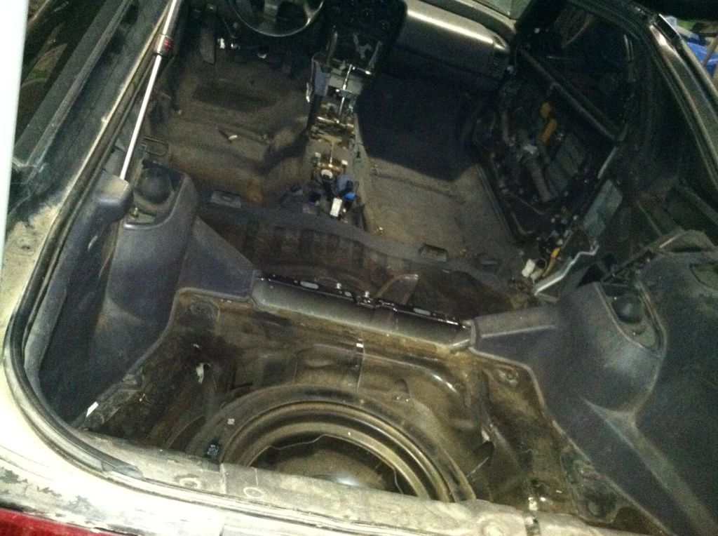

Pulled the seats

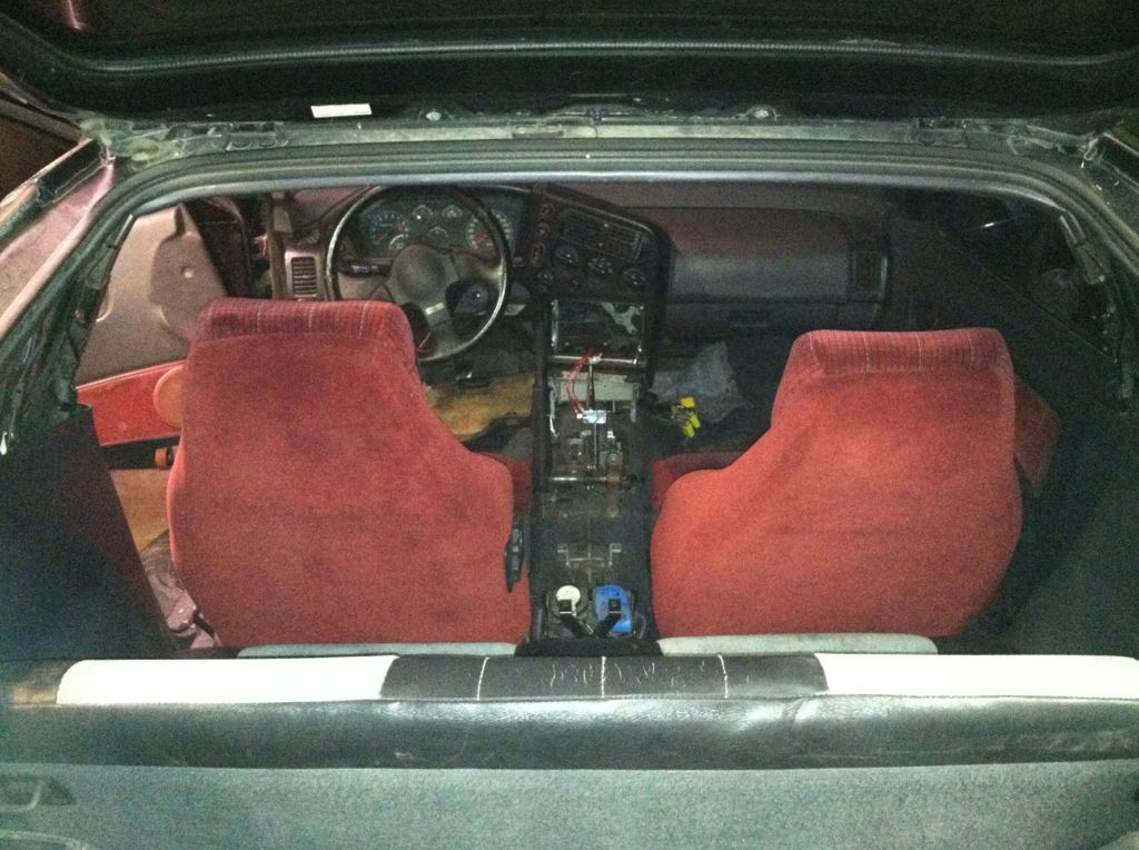

Red interior in

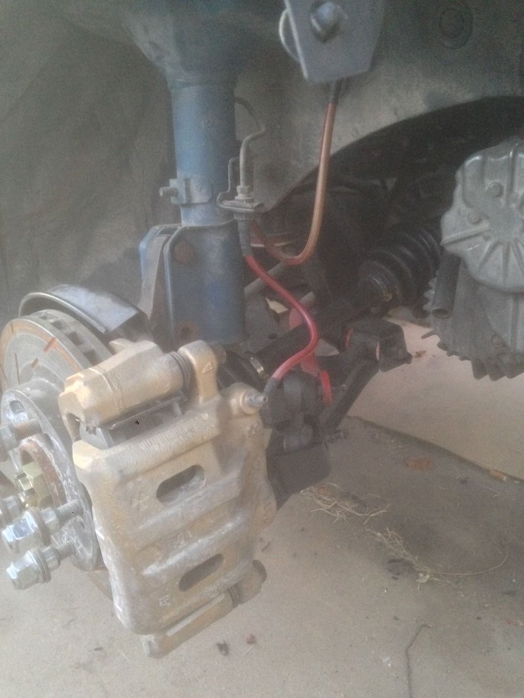

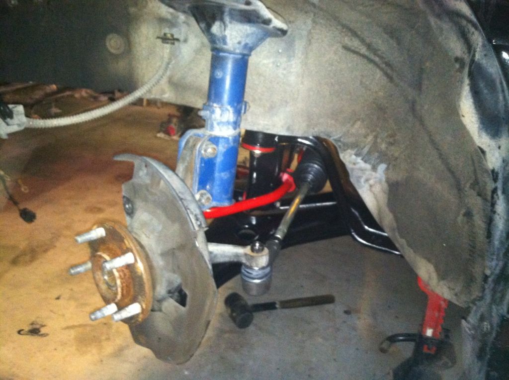

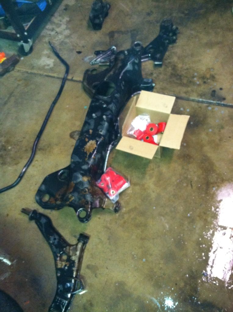

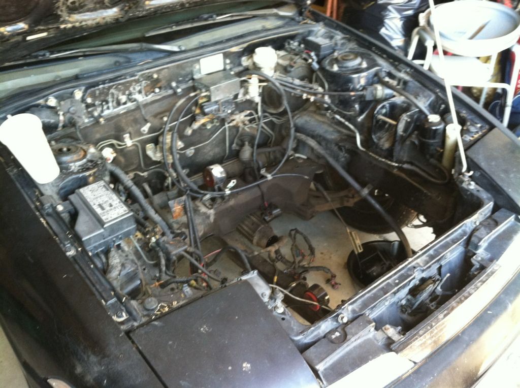

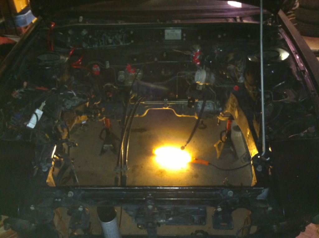

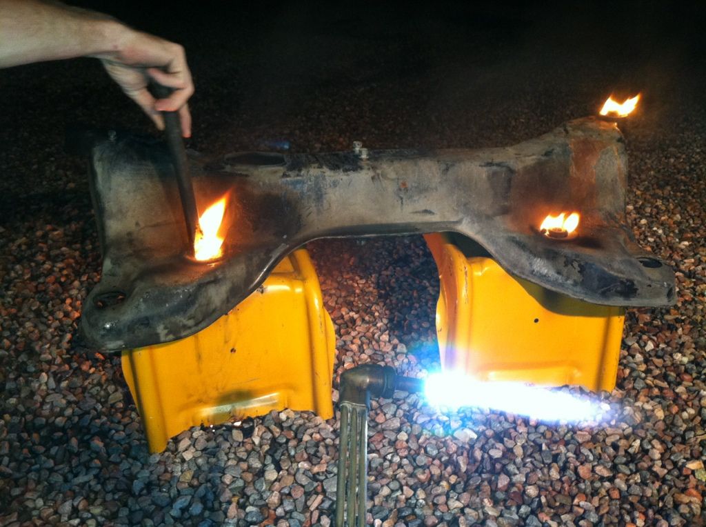

Front subframe pulled

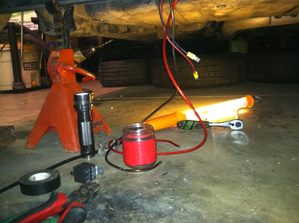

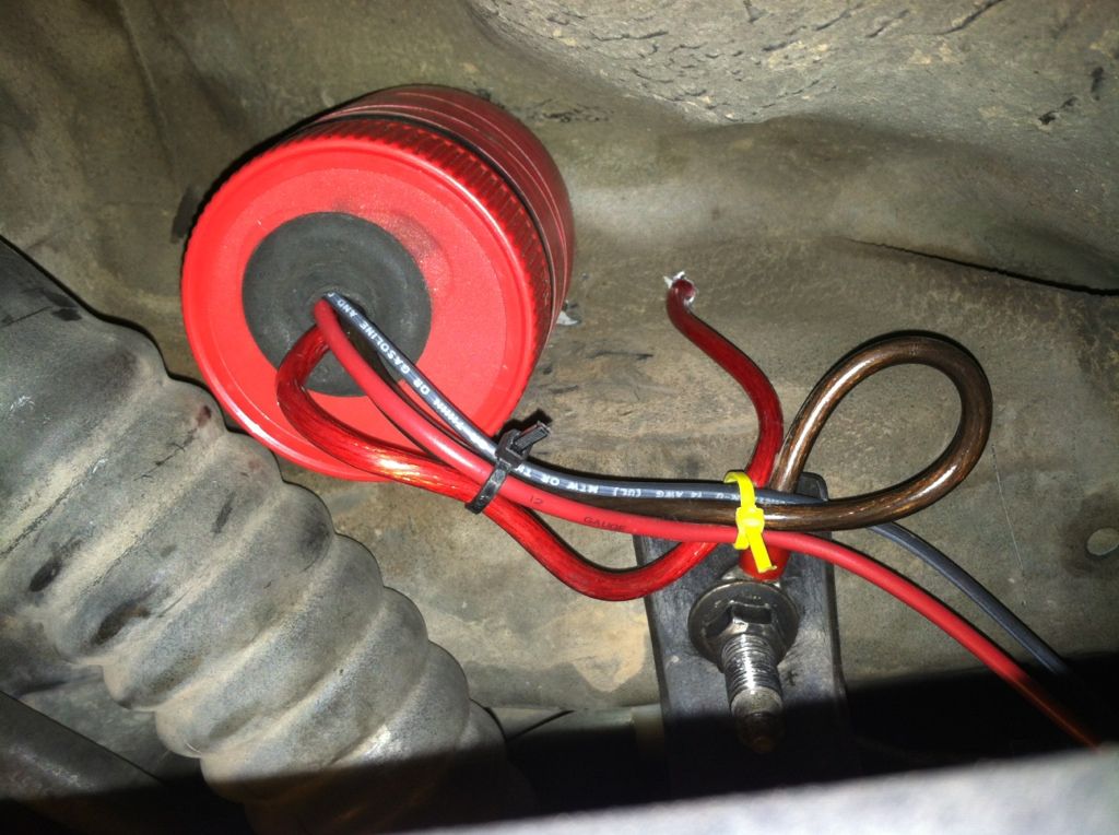

Fuel pump rewire

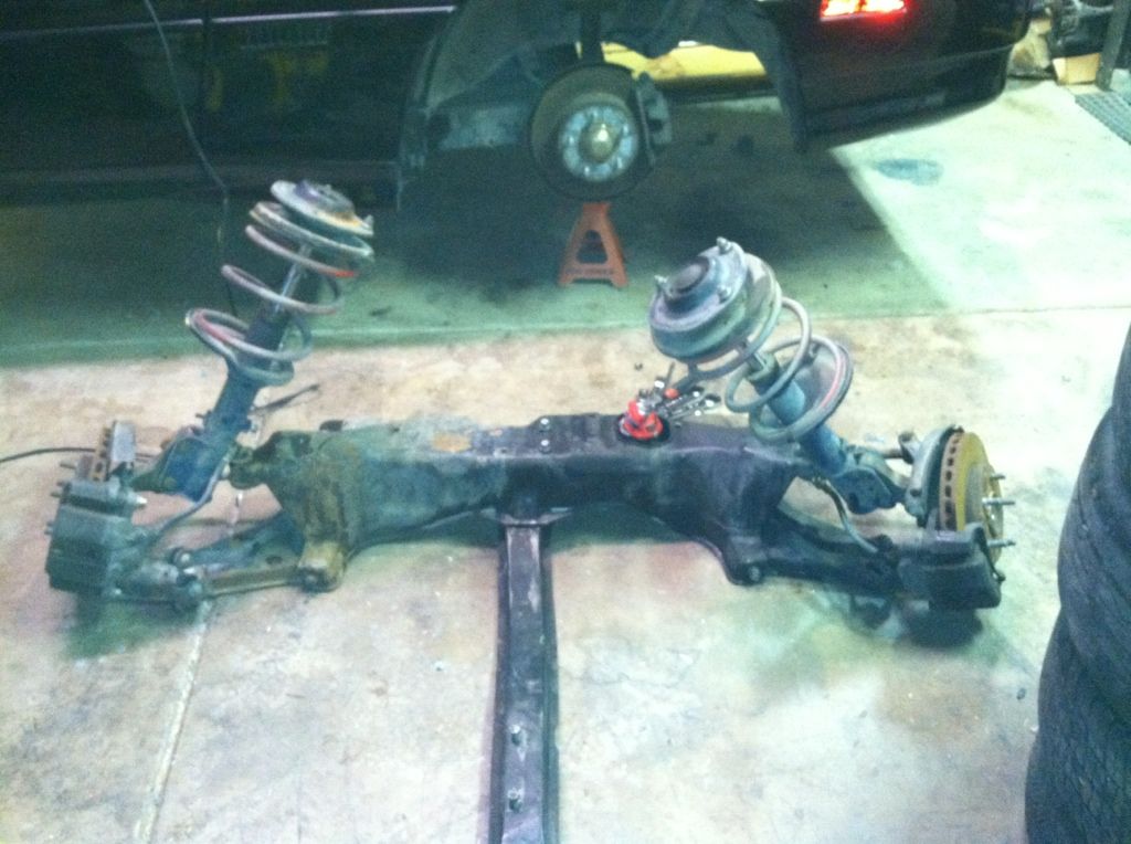

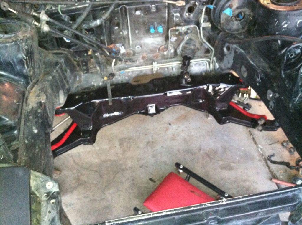

This is what I do when I cant sleep an stay up till the early morning hours in my garage drinking beer. Front subframe cleaned an rebuilt new boots, ball joints, tie end rods, end links.

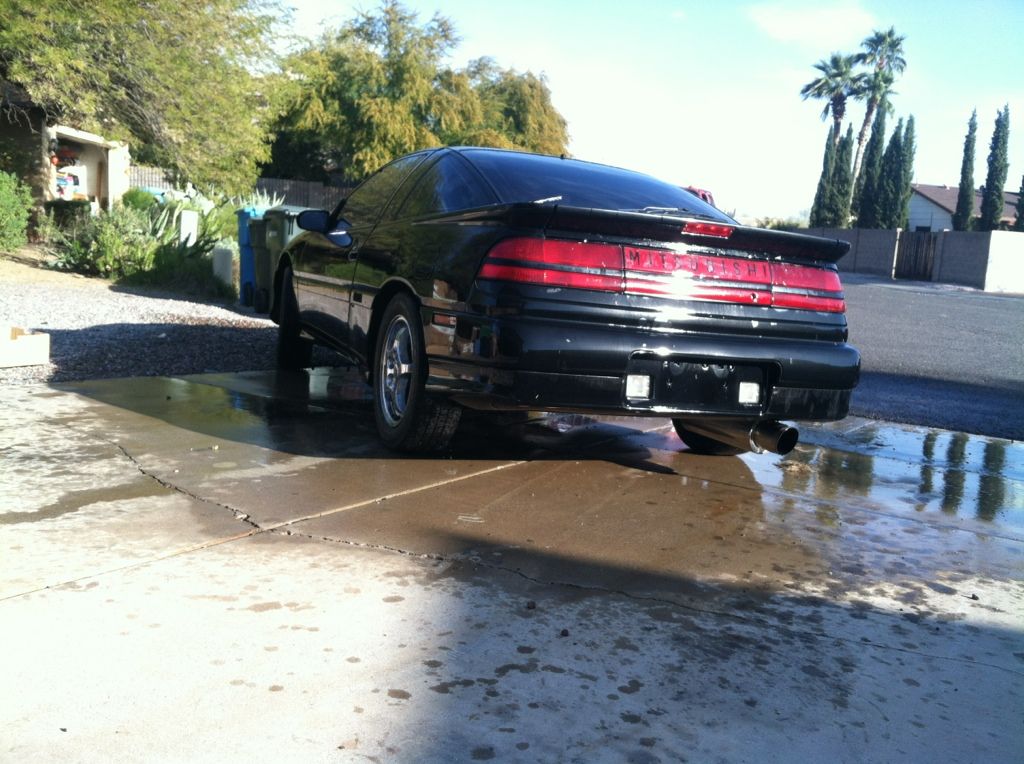

Ready for some road action.

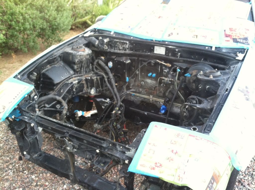

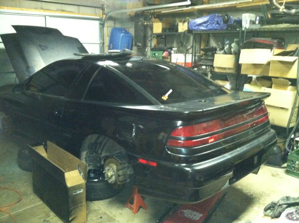

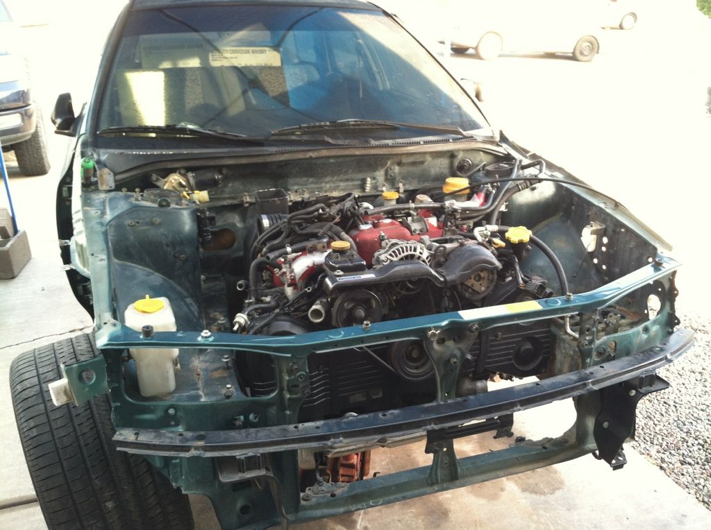

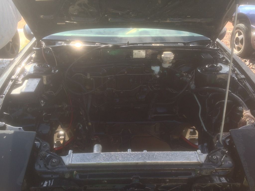

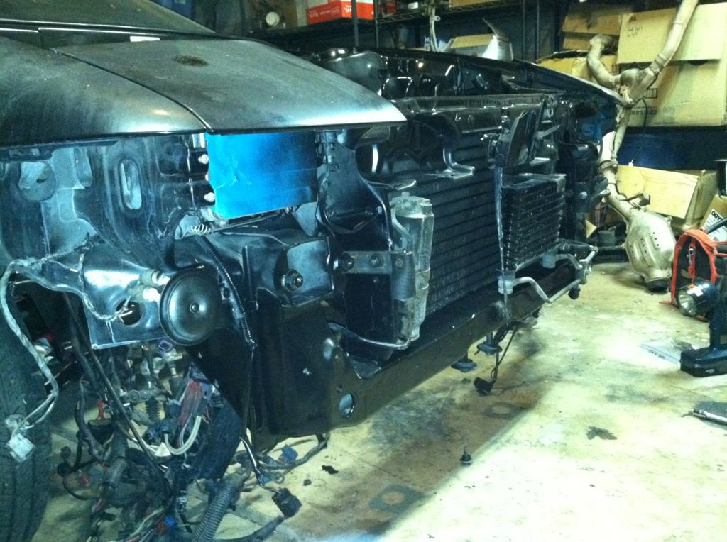

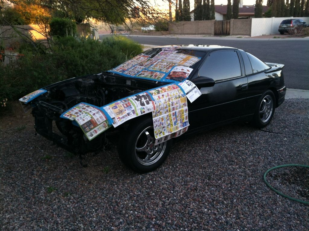

I had to push the eclipse out side needed the garage to pull the trans on my impreza an since it was such a nice weekend I cleaned an painted the bay.
Before
After

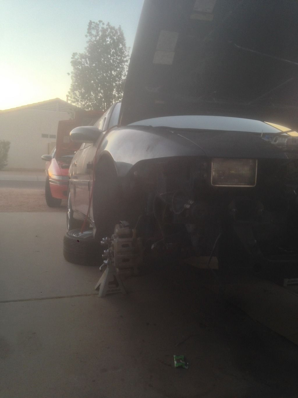

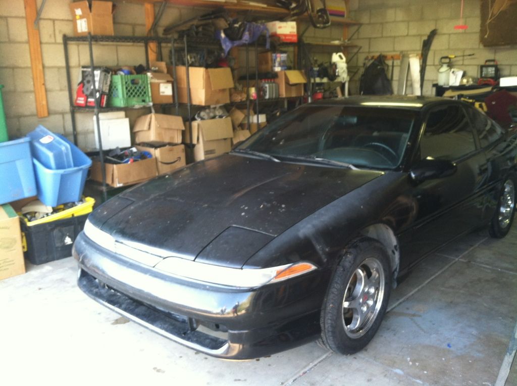

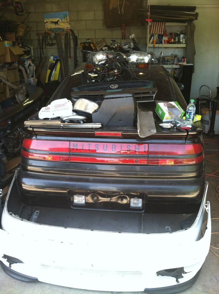

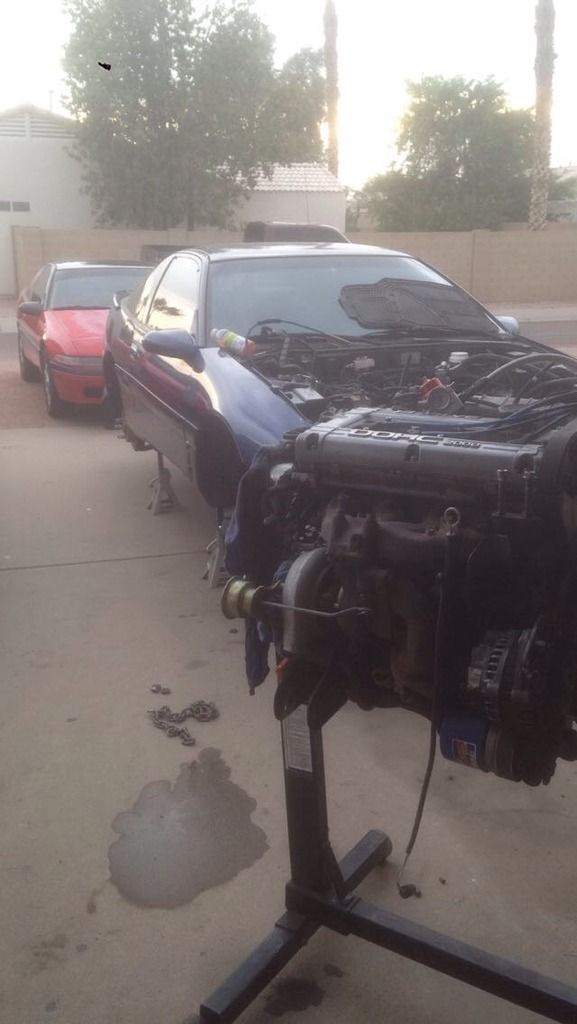

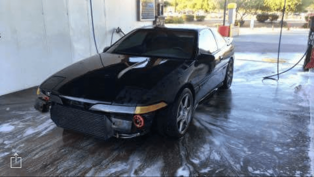

So I have decided to put my talon on hold an finish up my eclipse, I picked up an 92 talon awd with a nice list of goodies on it the only down fall was some one had put a body kit on the car an repainted it a different color :chair:

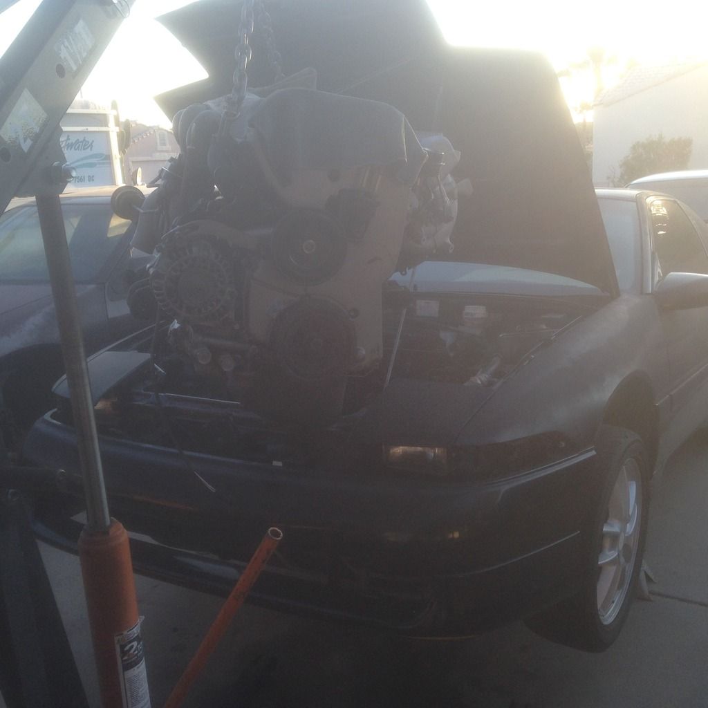

So I decided to pull the motor an goodies an drop them in the black car :cool:

- Fuel pump rewire

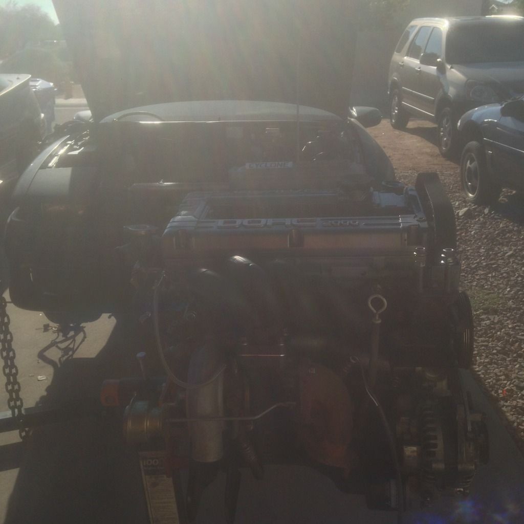

91 GST BLACK WIDOW

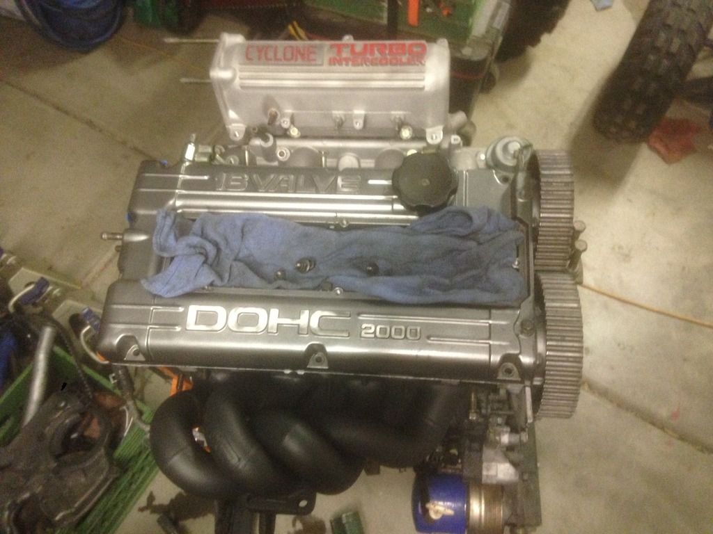

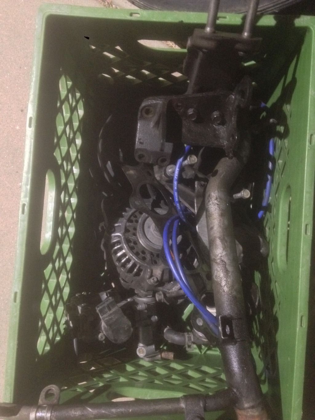

Motor pulled from 92 talon doner :tree:
Stripped it down an gave it a bath

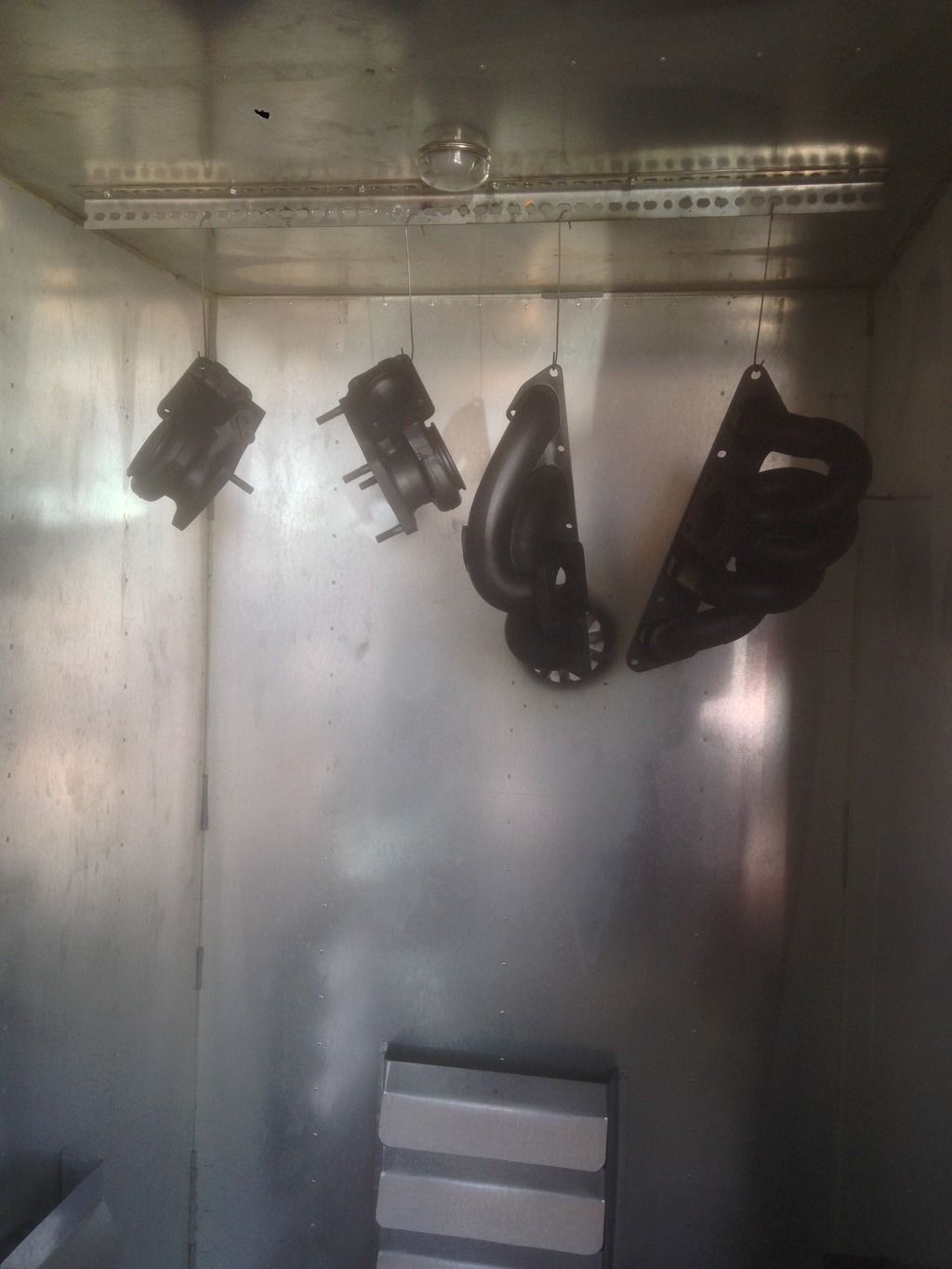

I got the exhaust manifolds an hot sides coated

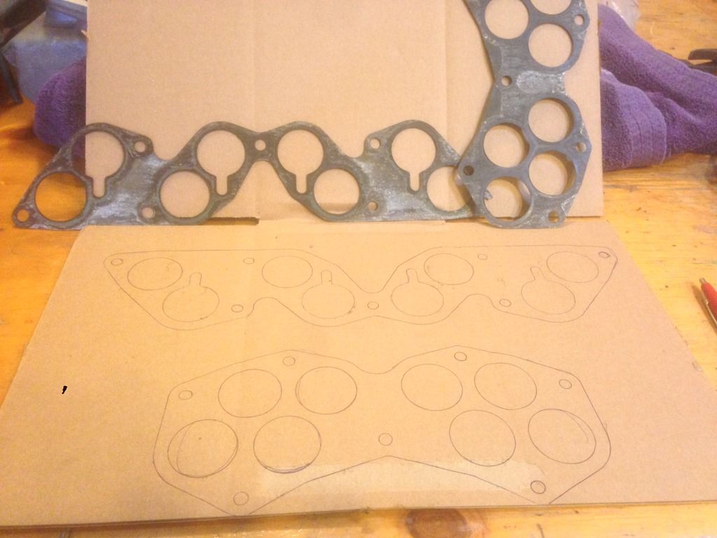

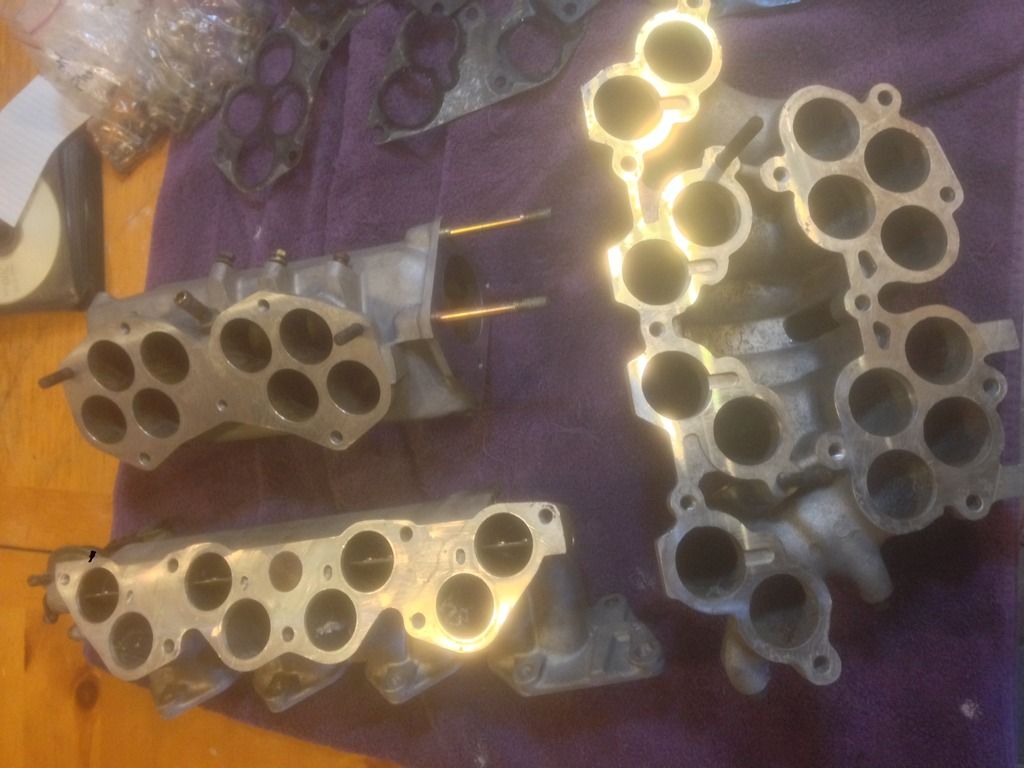

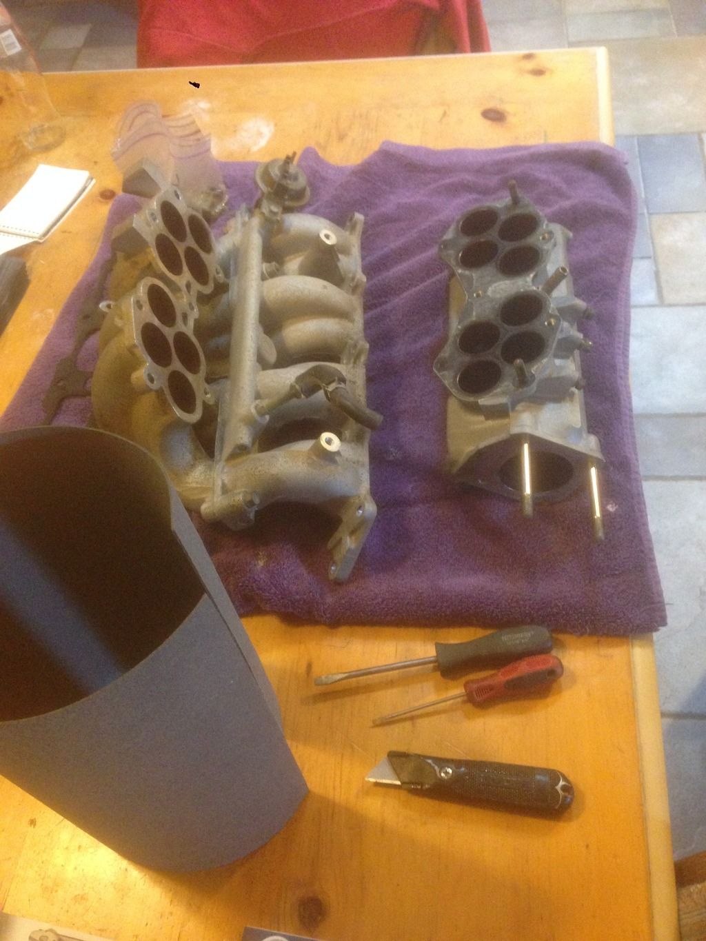

Took apart the cyclone manifold to give it a nice cleaning an new gaskets

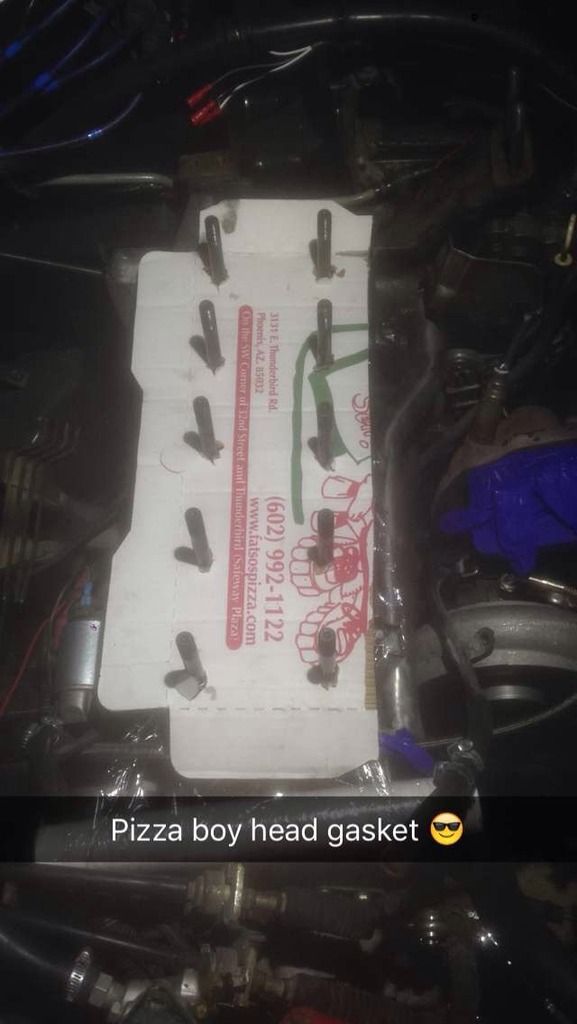

I was able to salvage the old gaskets an make a template on card board i may look in to getting a few sets made since the gaskets have been discontinued by Mitsubishi

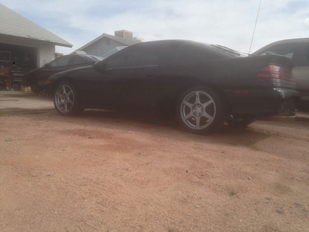

Oh I also picked up this turd a few weeks ago
90 laser fwd turbo $900 stupid clean besides paint an zero mods :D

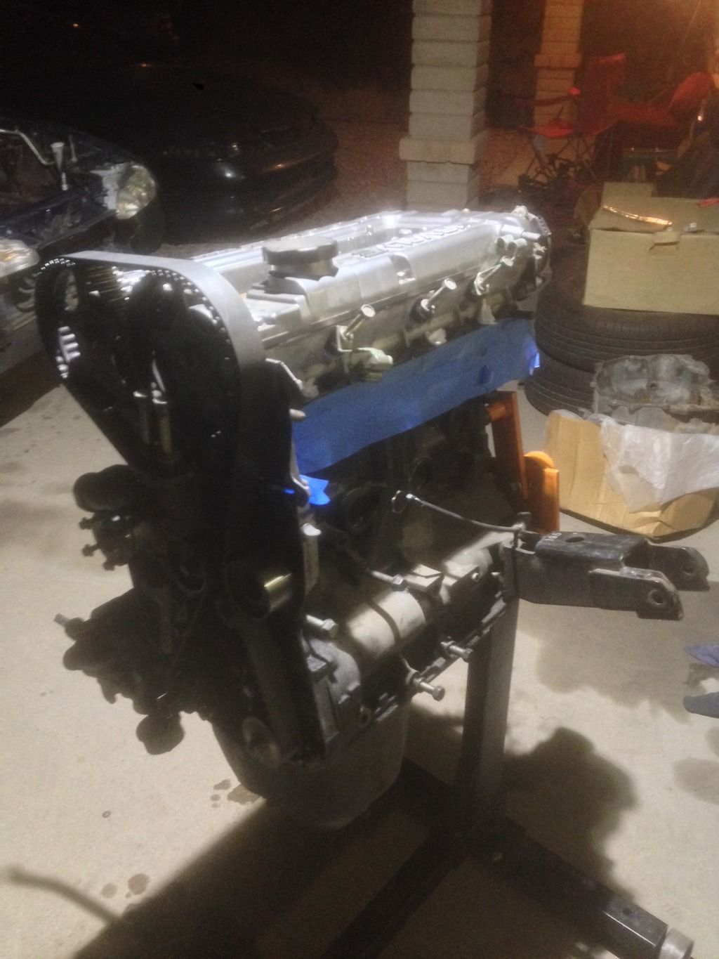

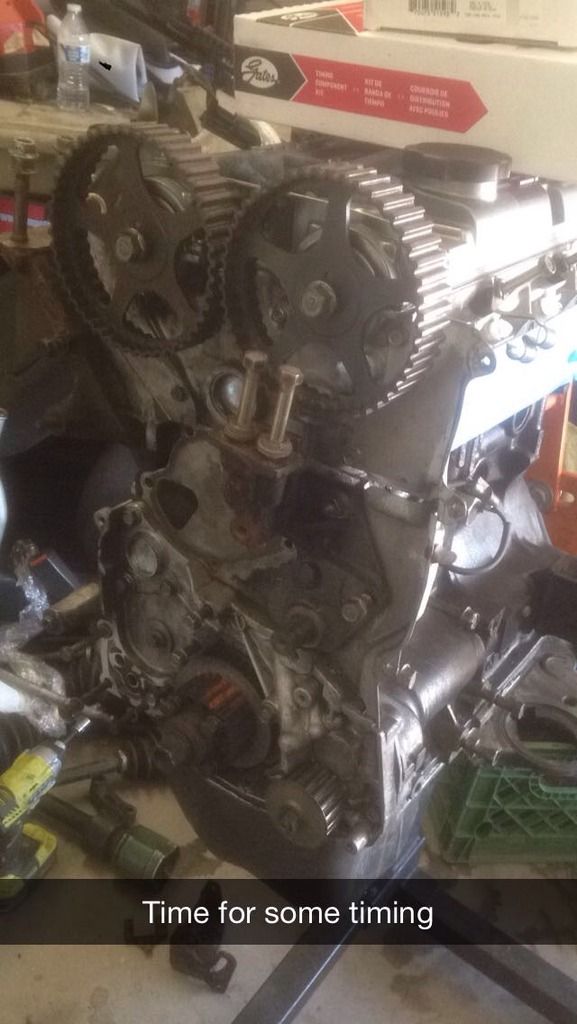

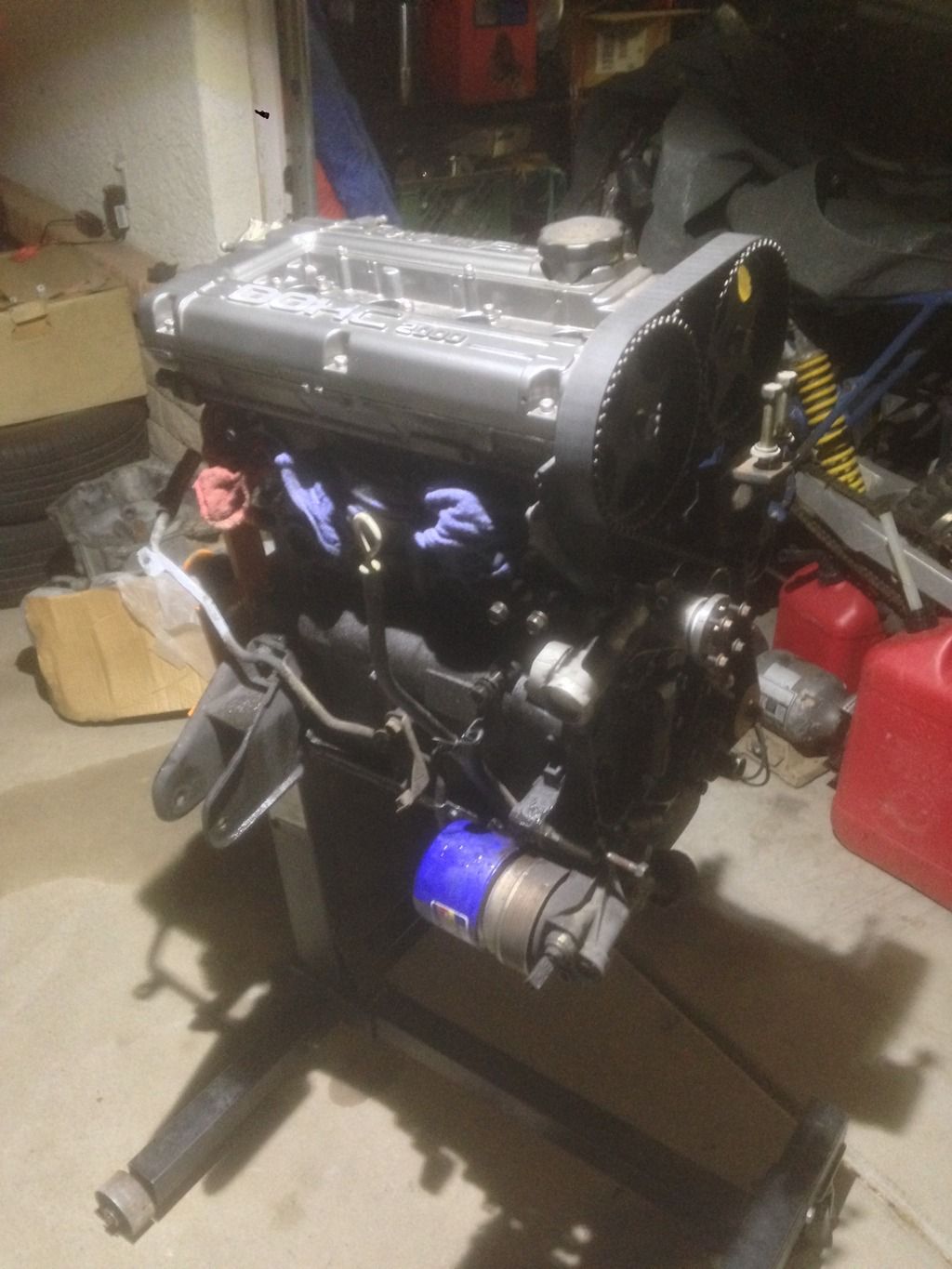

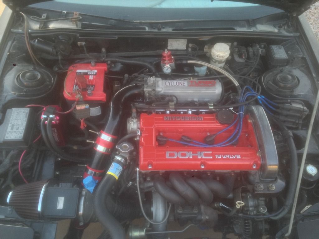

Got the cyclone rebuilt an installed

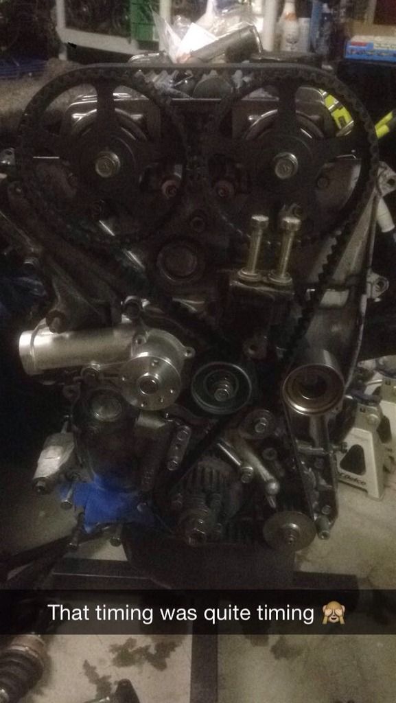

Cleaned an re gasketed the timing side
New timing kit an water pump installed

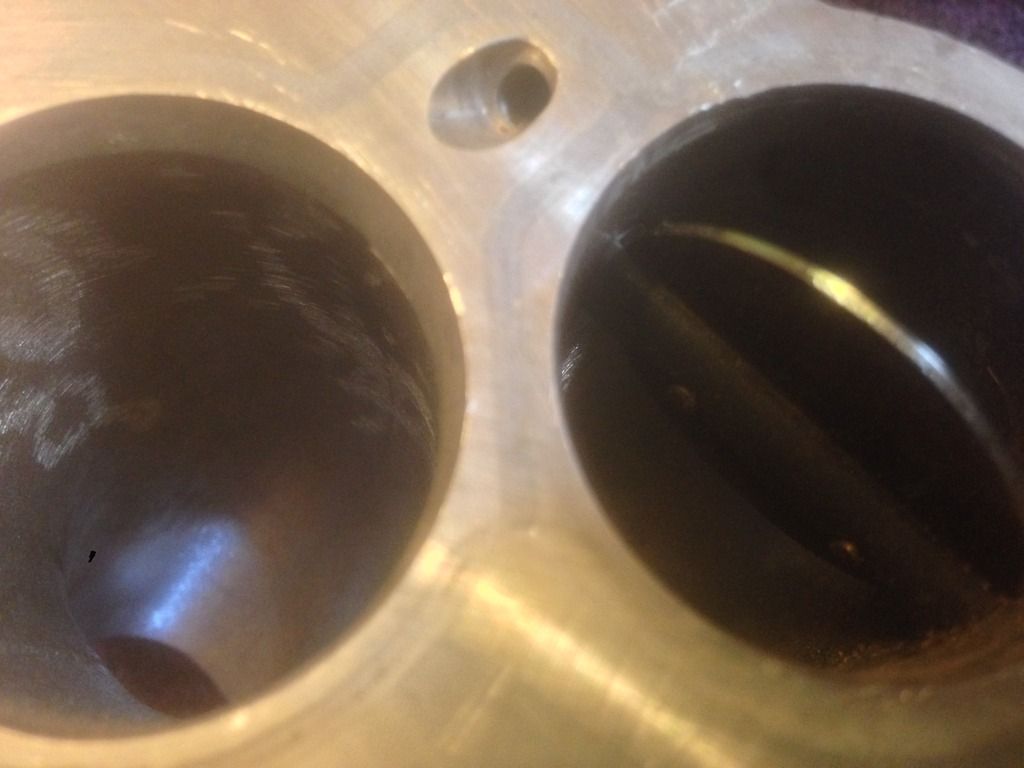

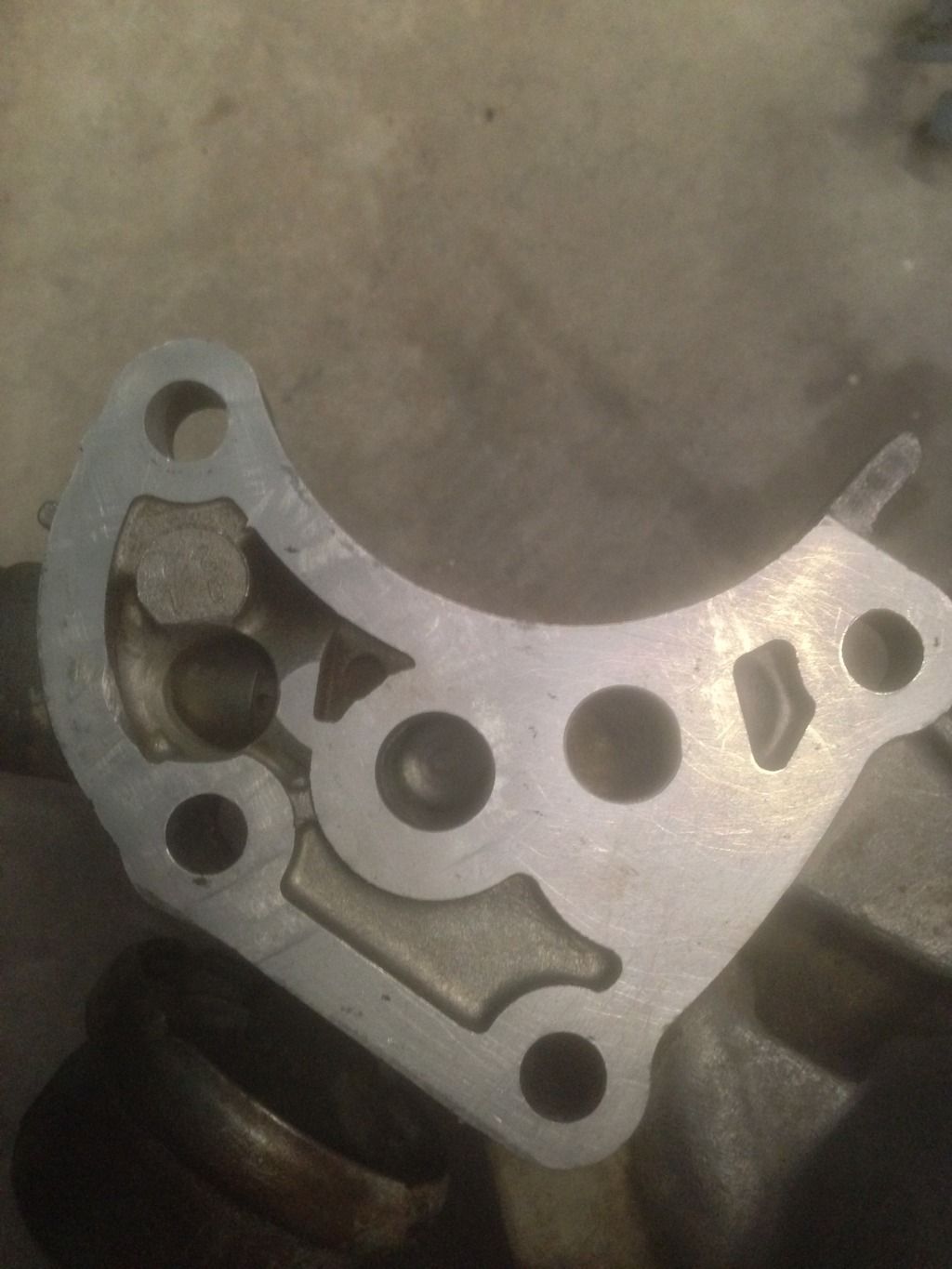

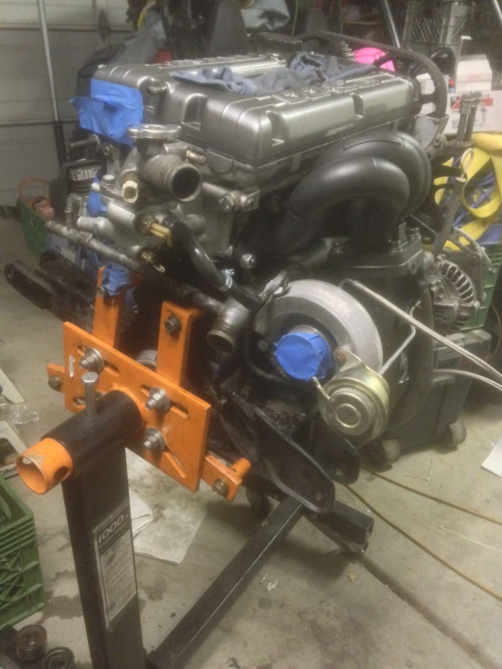

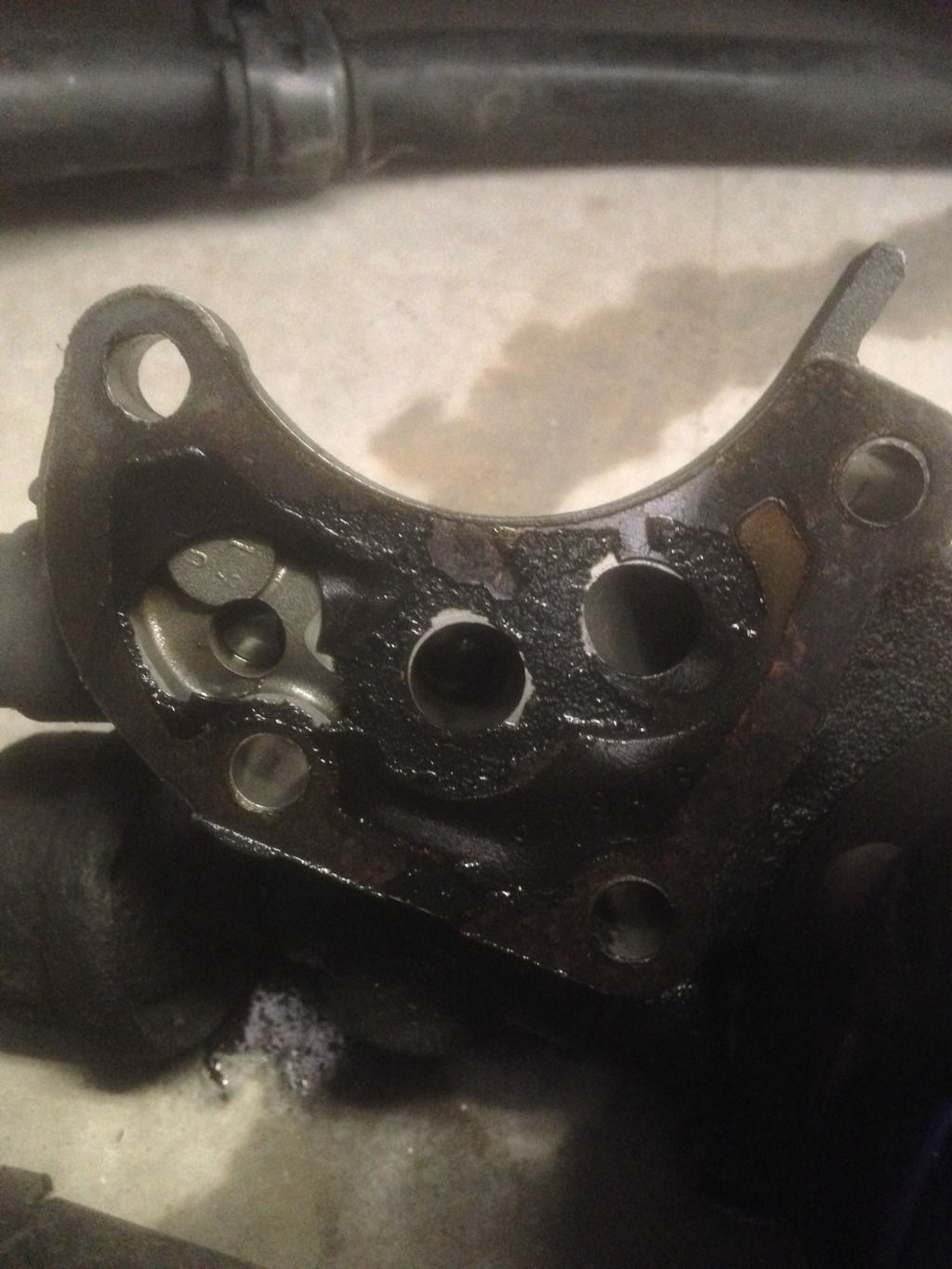

Ported the OFH relief valve. I also switched to a 90 OFH so i can run a external oil cooler. Before
After

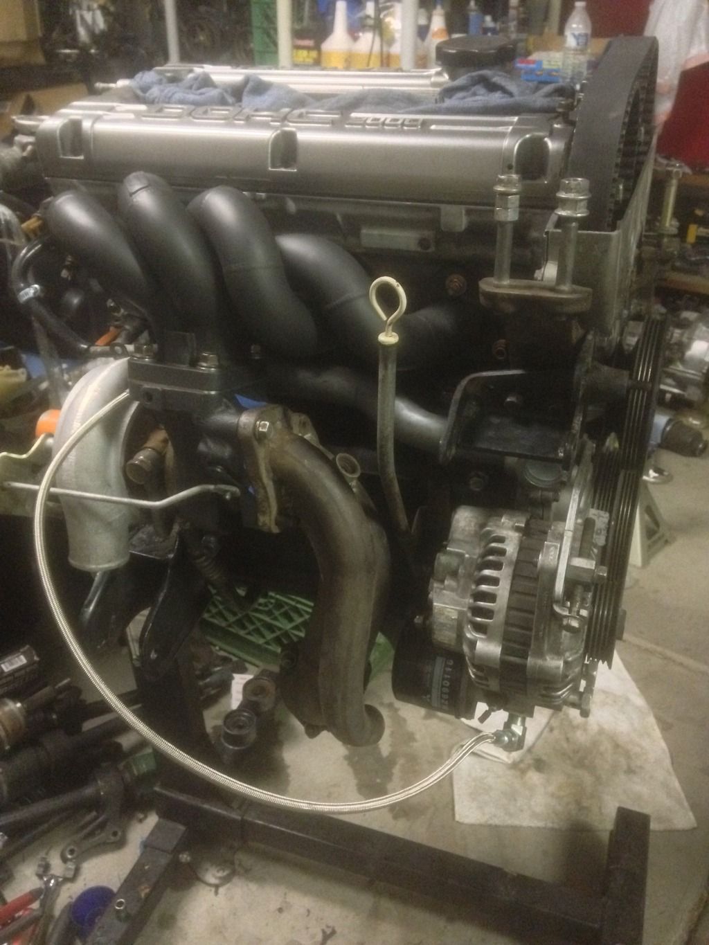

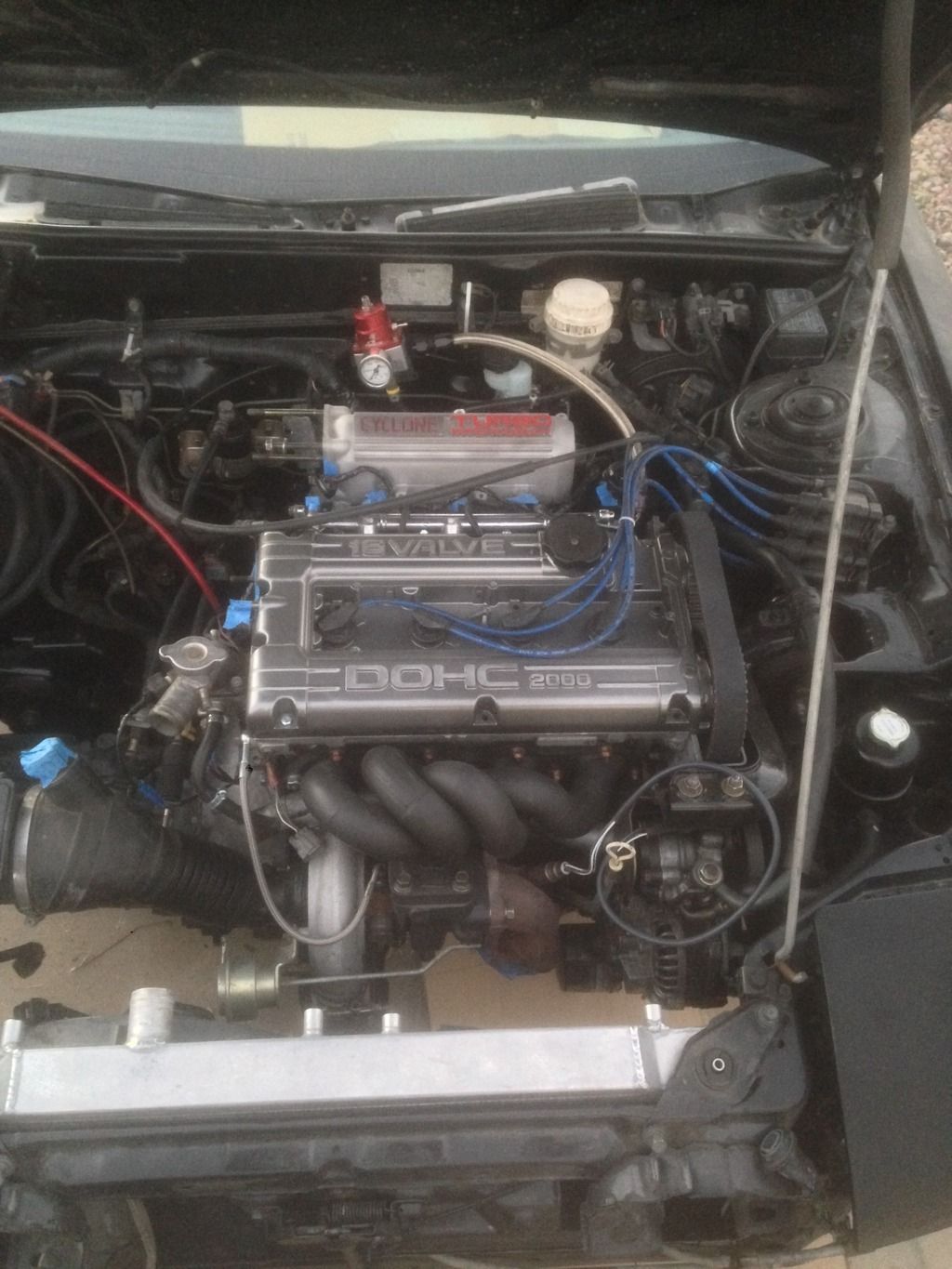

20G installed
Gave every thing a nice bath since I live in the desert :tat:

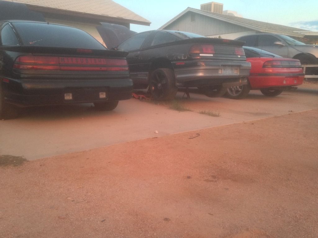

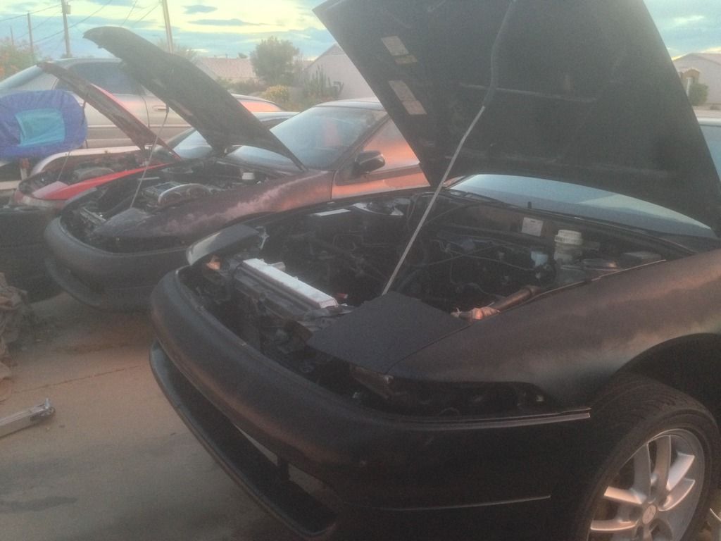

All three ladys an the parts car :D
Eclipse Talon Laser

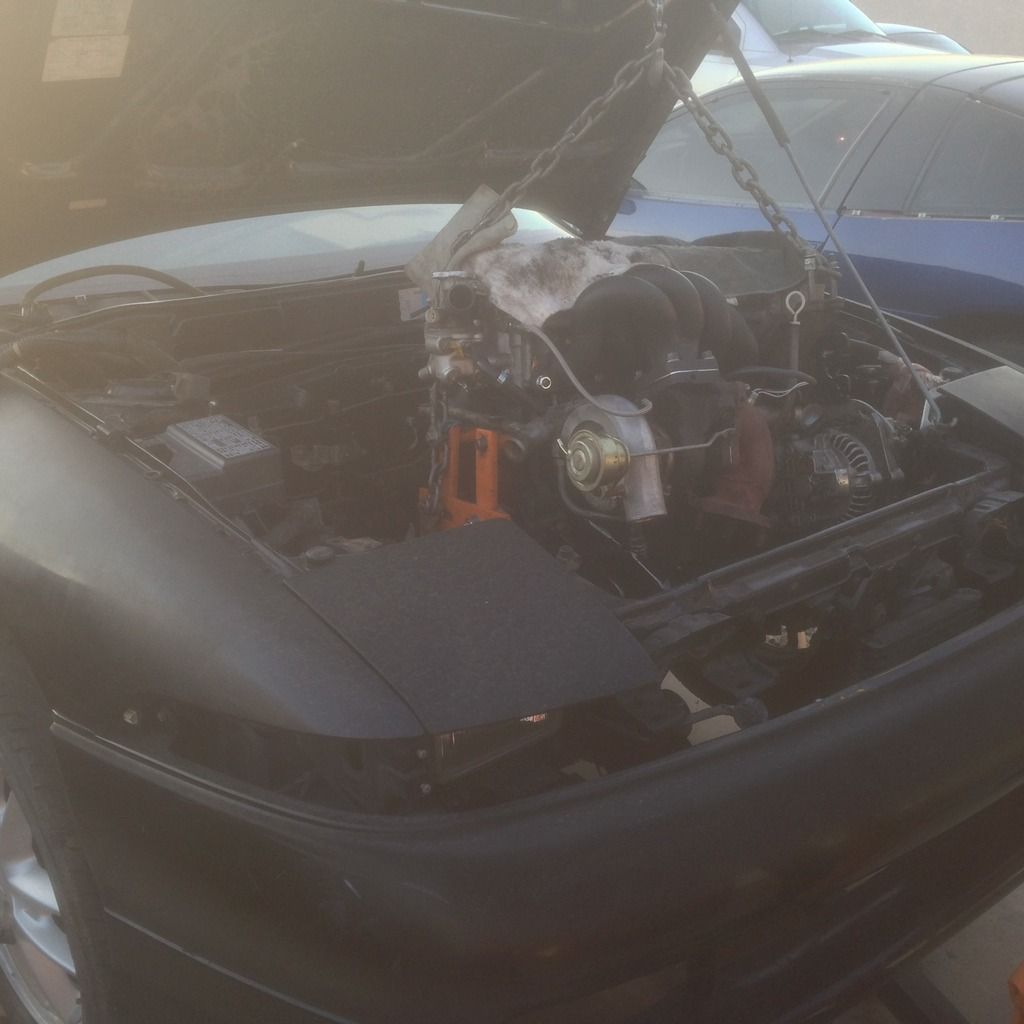

An finally the motors in :)
Im pretty excited to get the motor in should have more to update soon thanks for check in!!

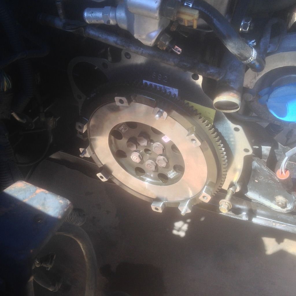

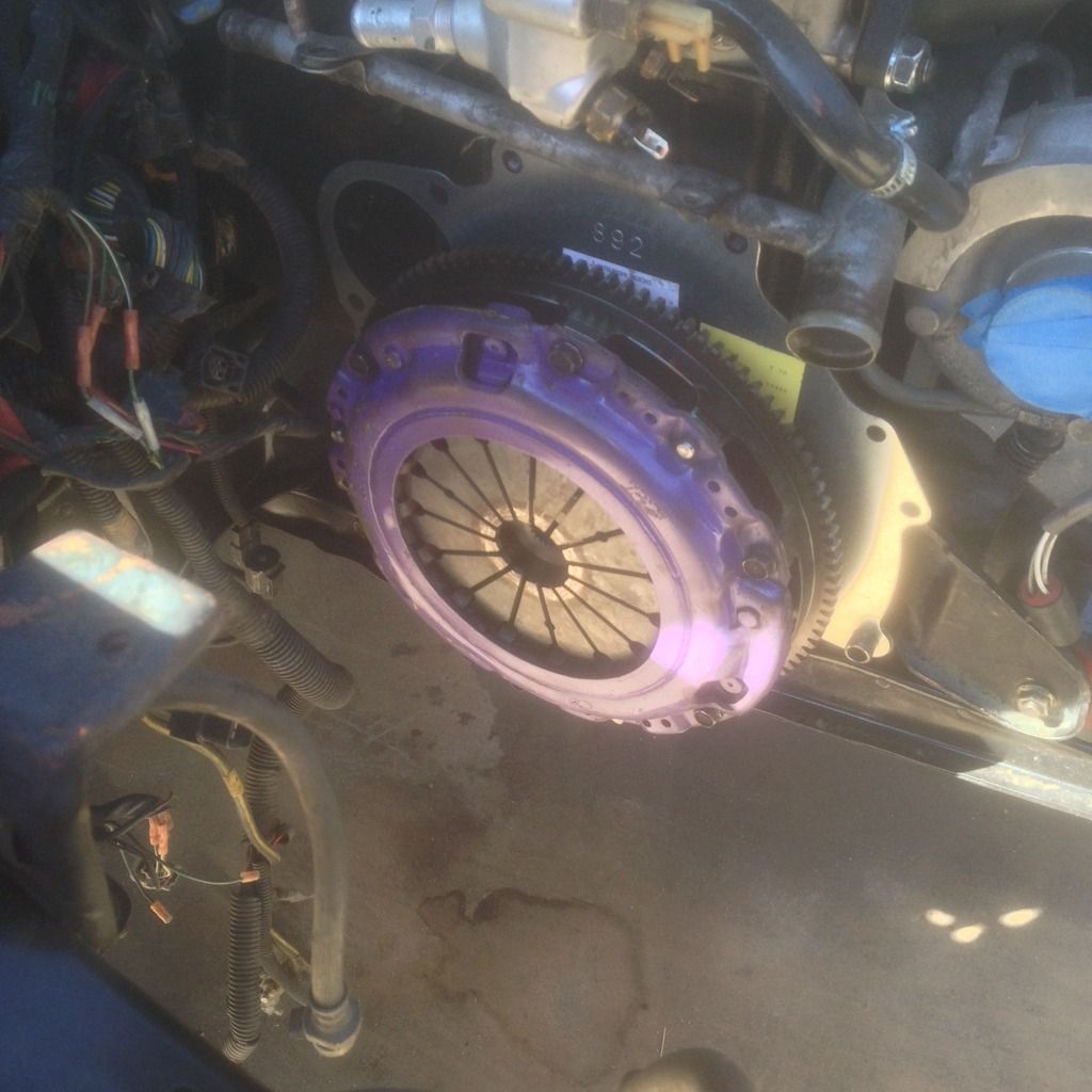

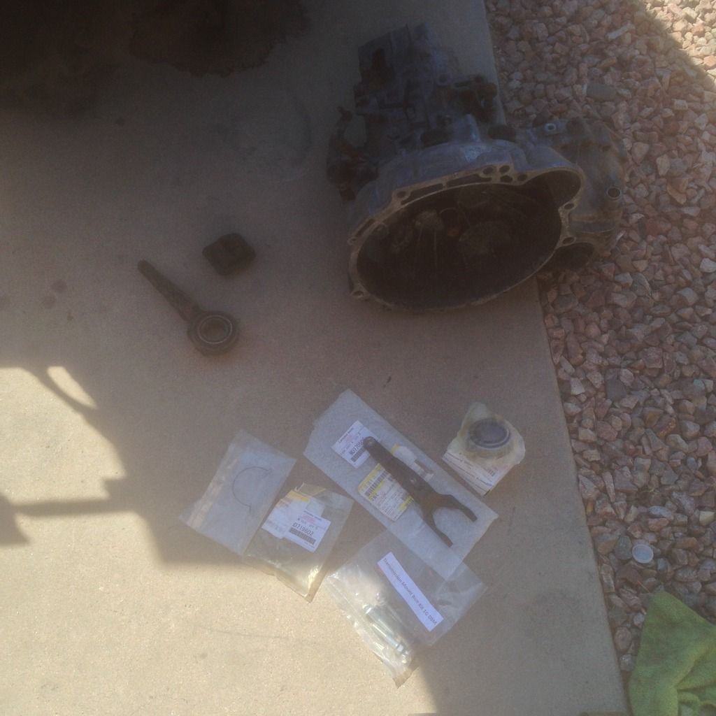

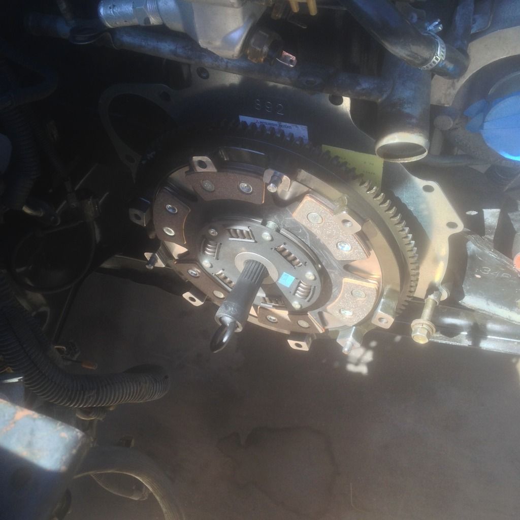

ACT flywheel
Competition clutch
Gangster purple ACT pressure plate :D
New goods
Possibly a built trans... I hope :rolleyes:
I did get the trans in just forgot to take a pic :chair:

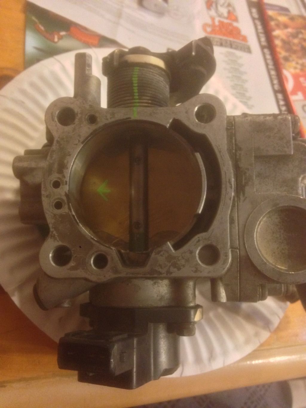

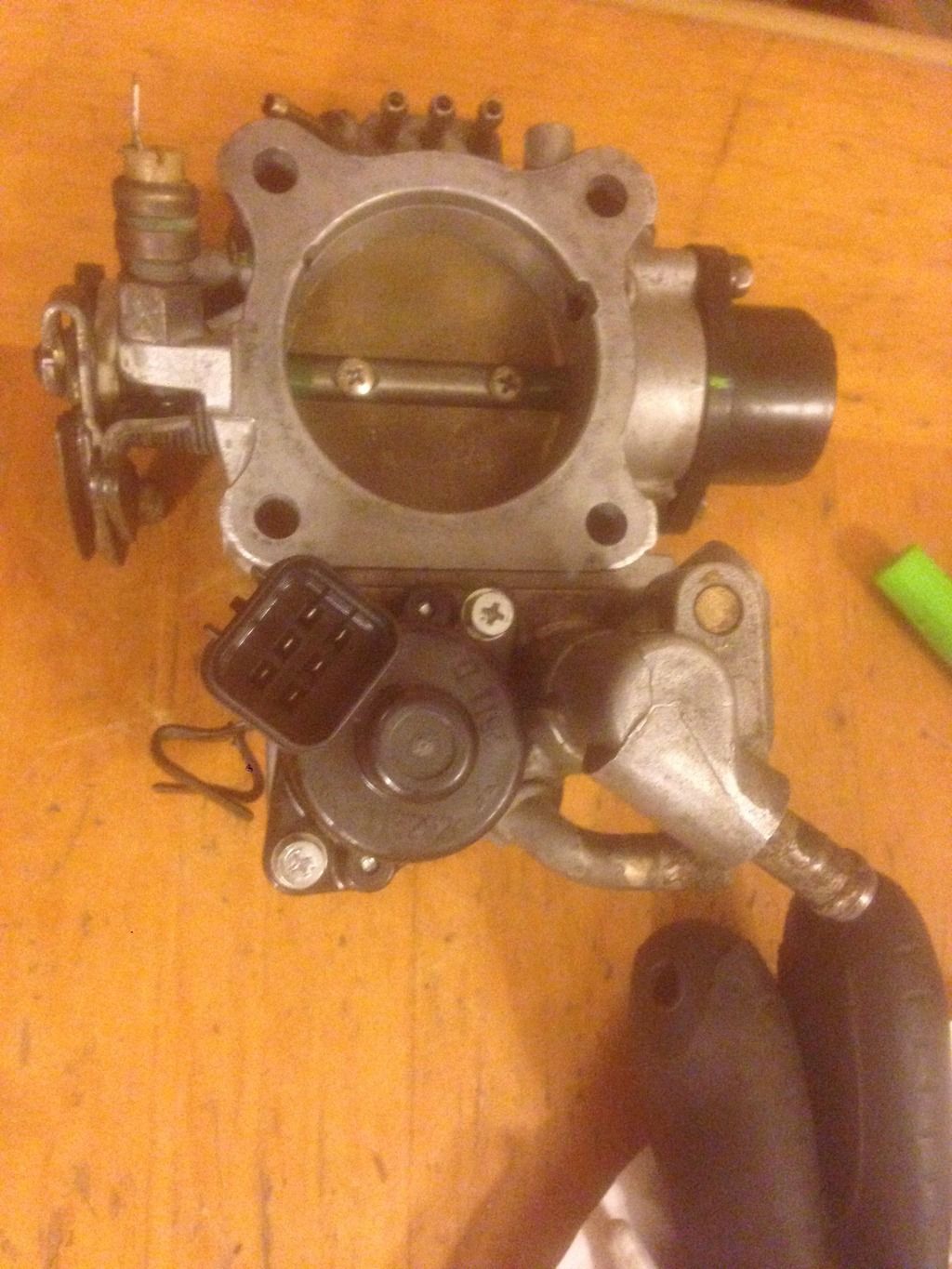

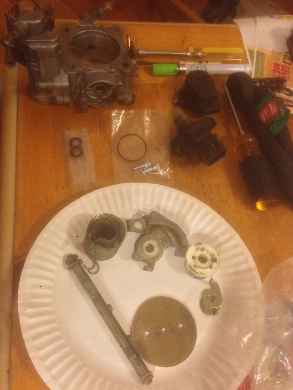

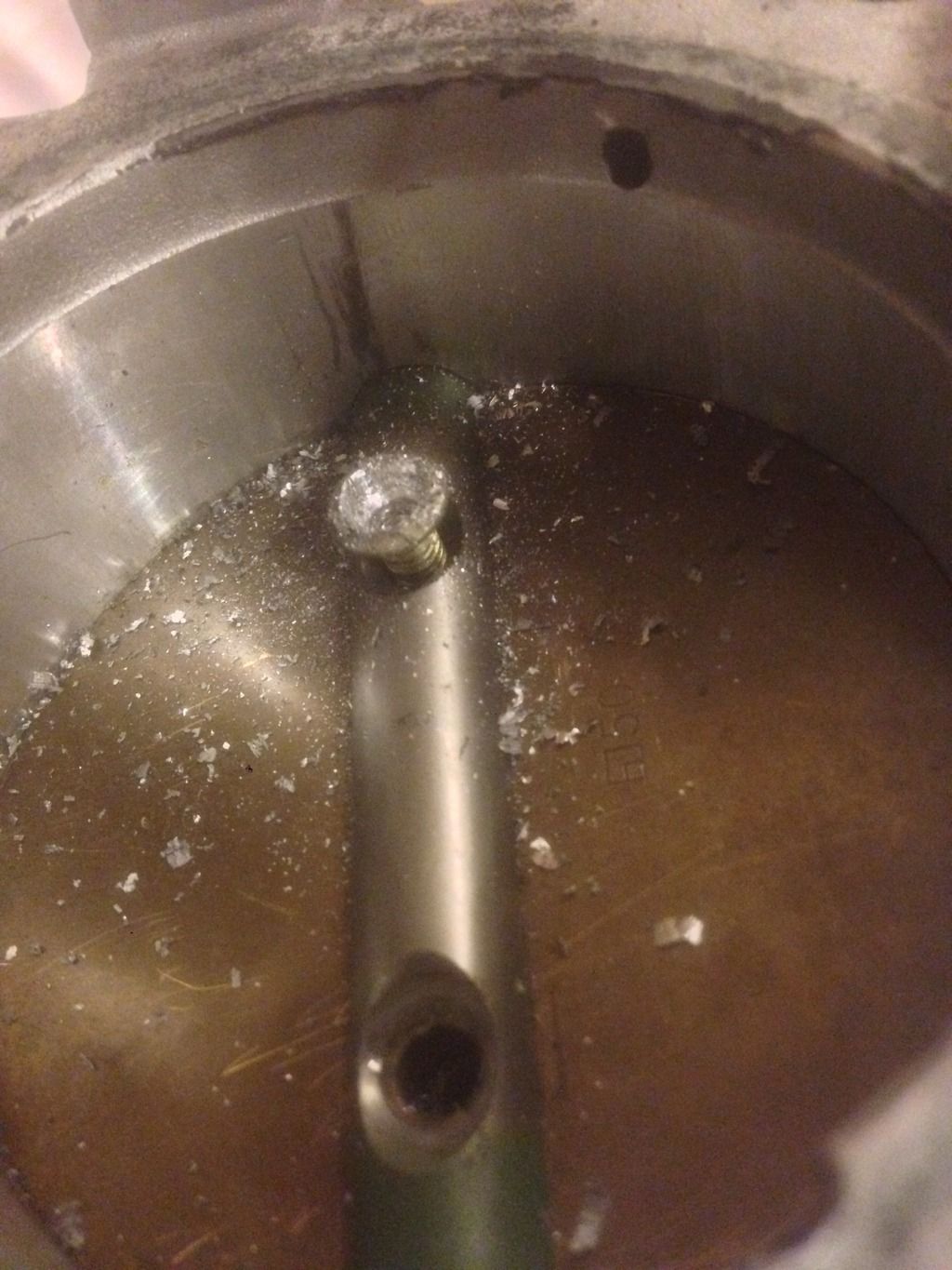

I rebuilt my throttle body the other day, pretty easy. Shout out to Red for showing me where to buy the correct seals.

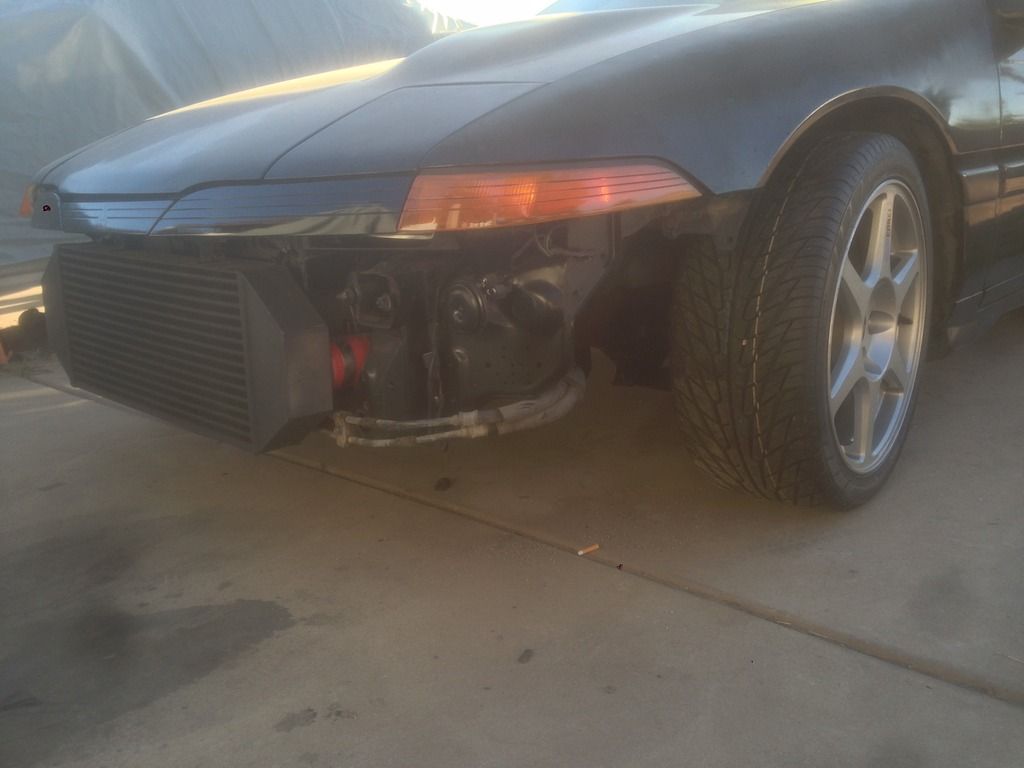

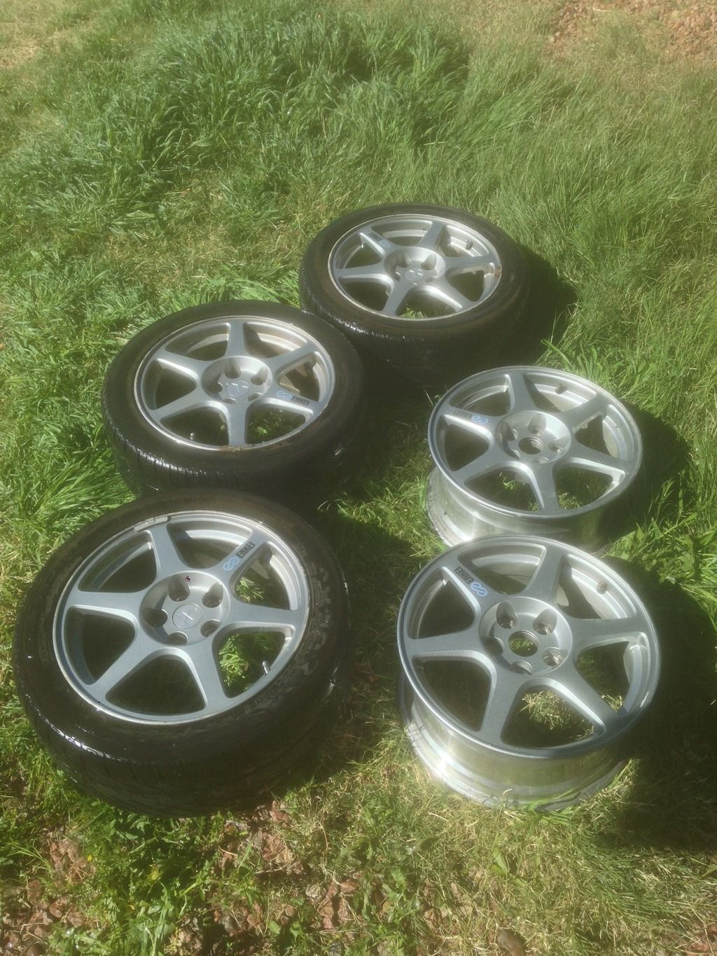

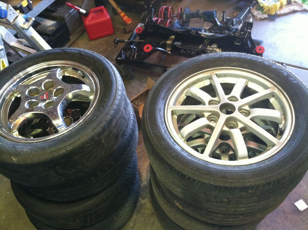

Had some wheels an tires stashed away that would be perfect for this car :cool:
New yet old school tires, do they even make these any more?

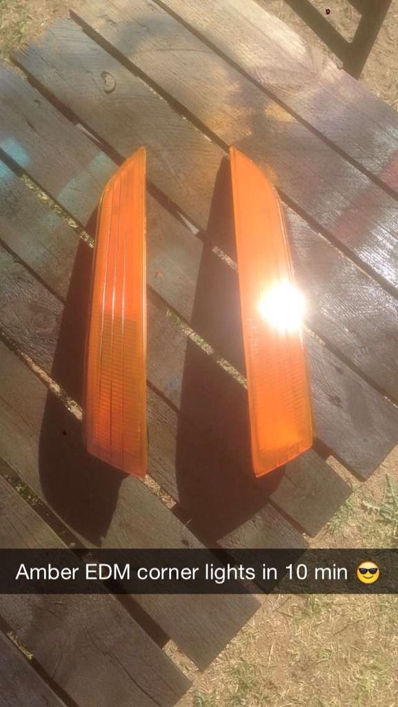

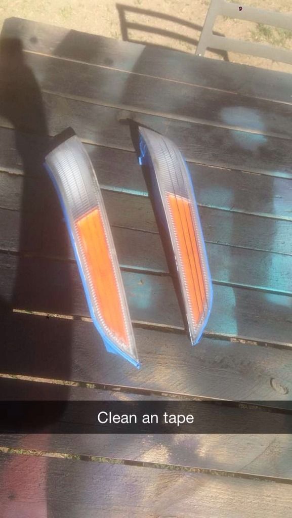

I didnt want to pay big money for a set of EDM amber corner lights so I made my own for $10

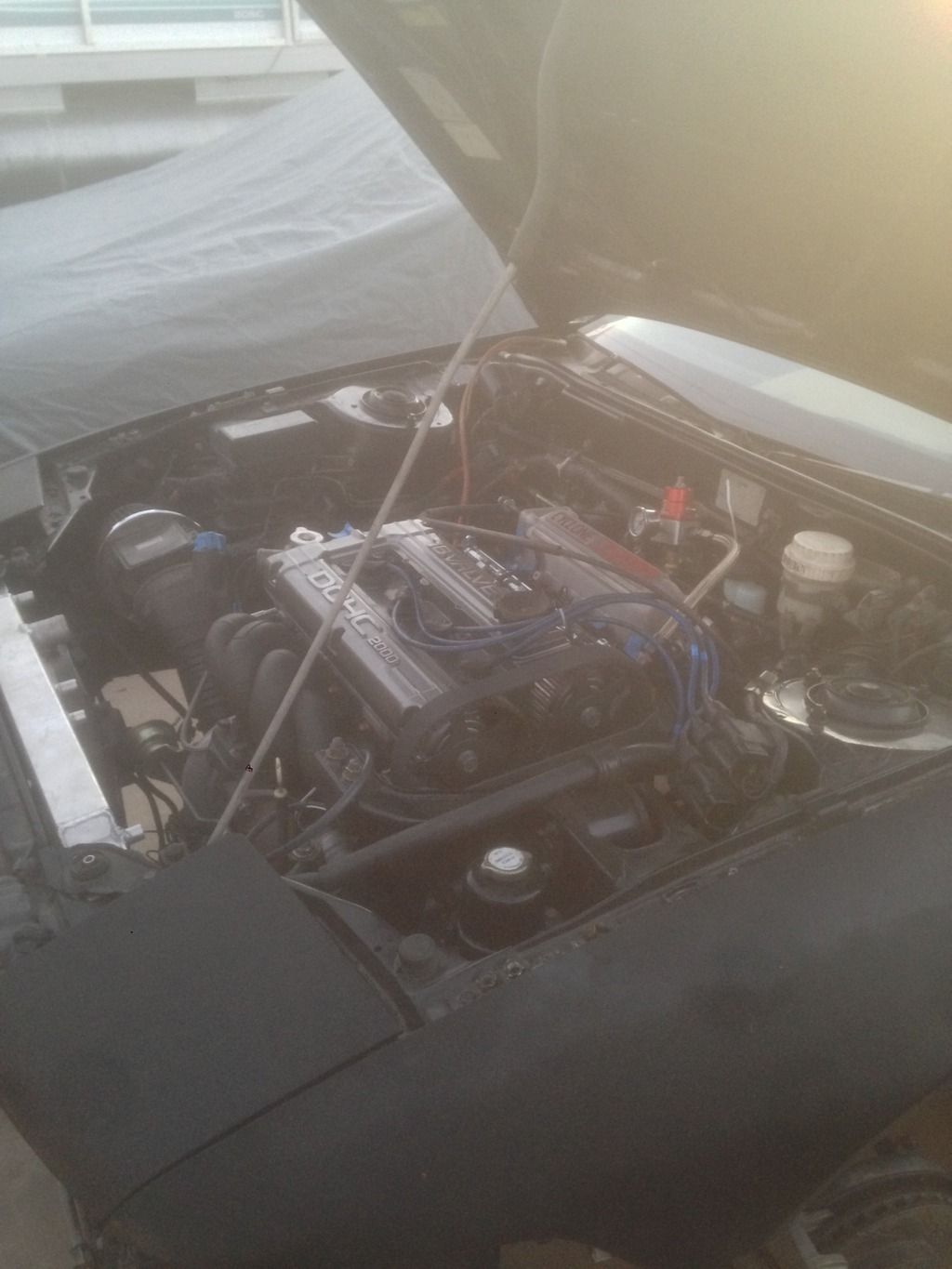

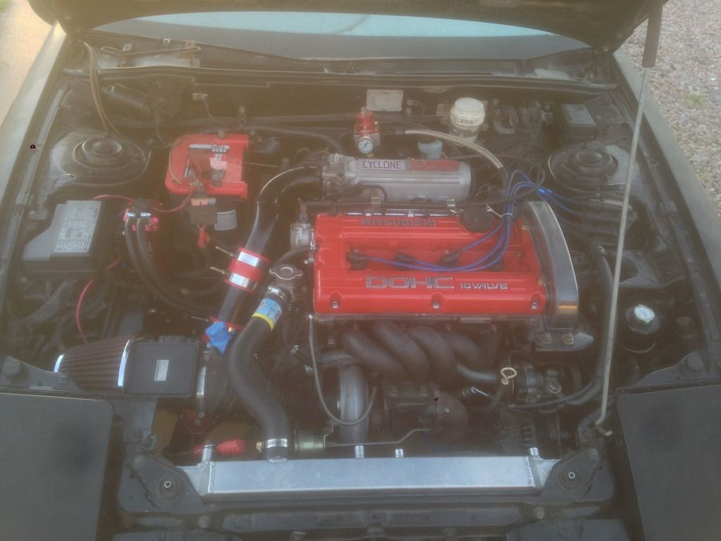

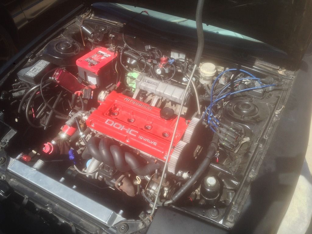

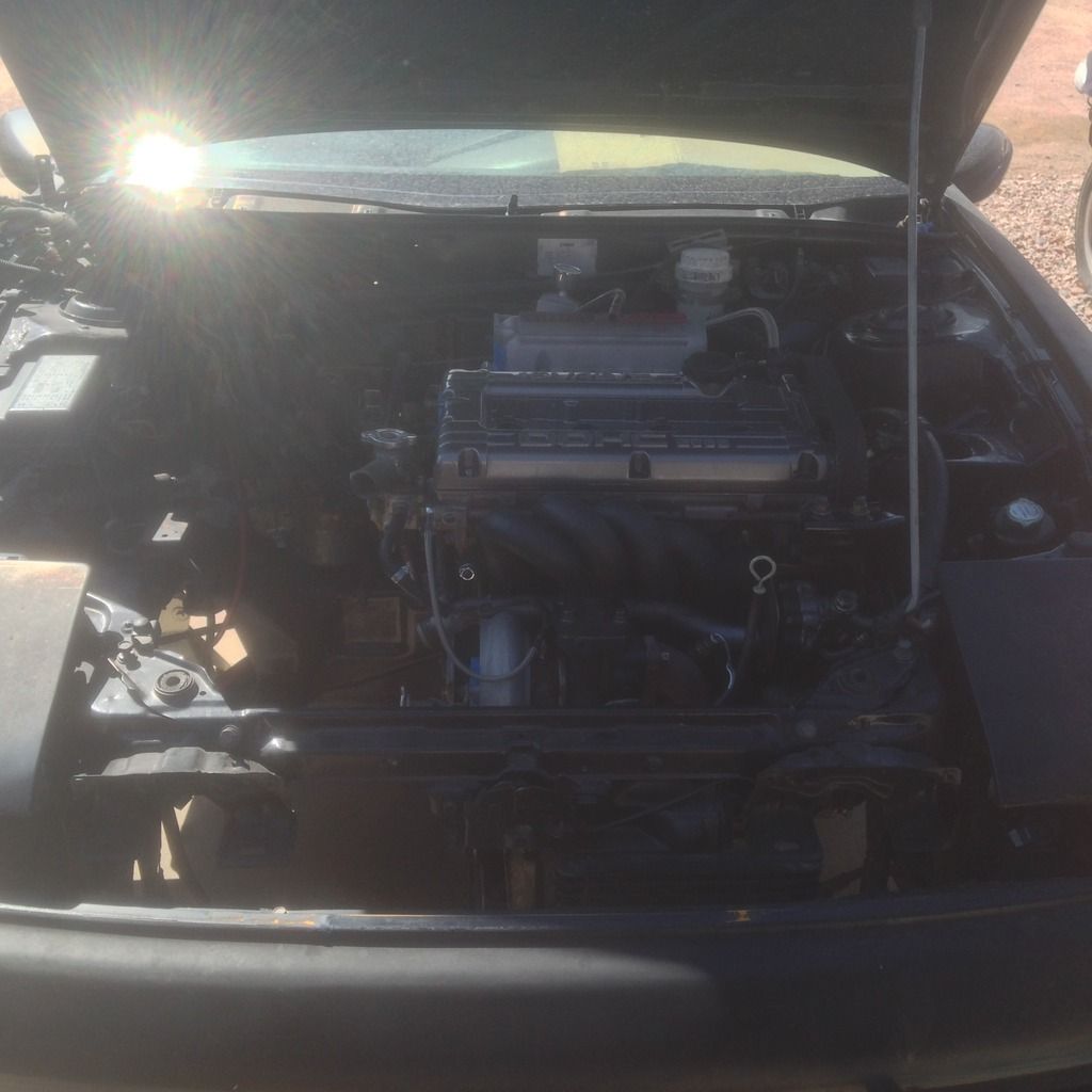

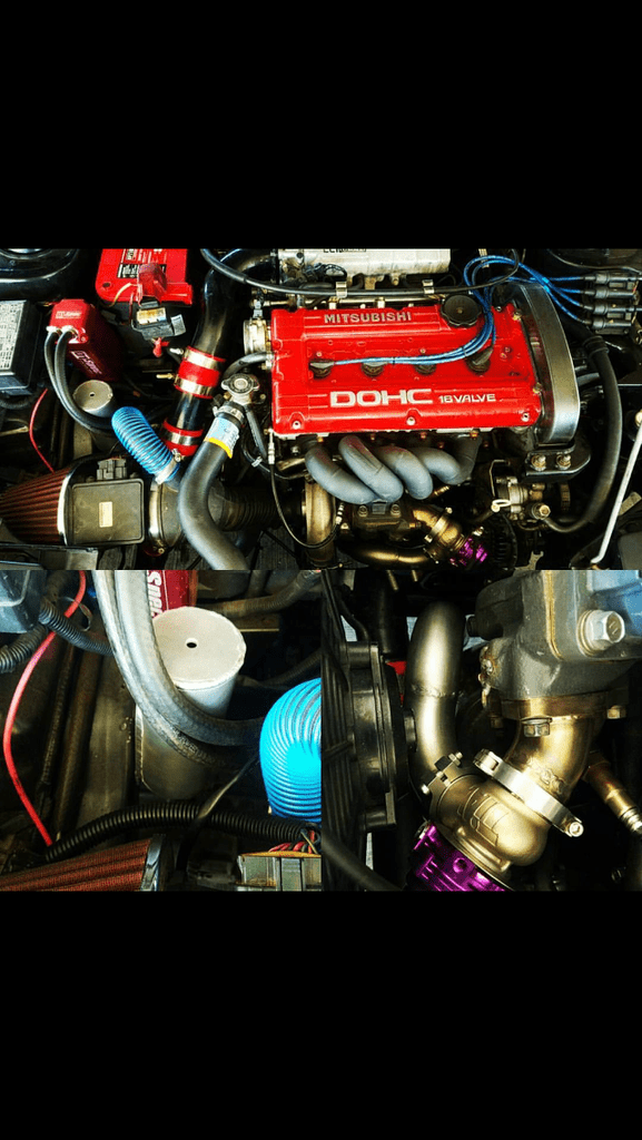

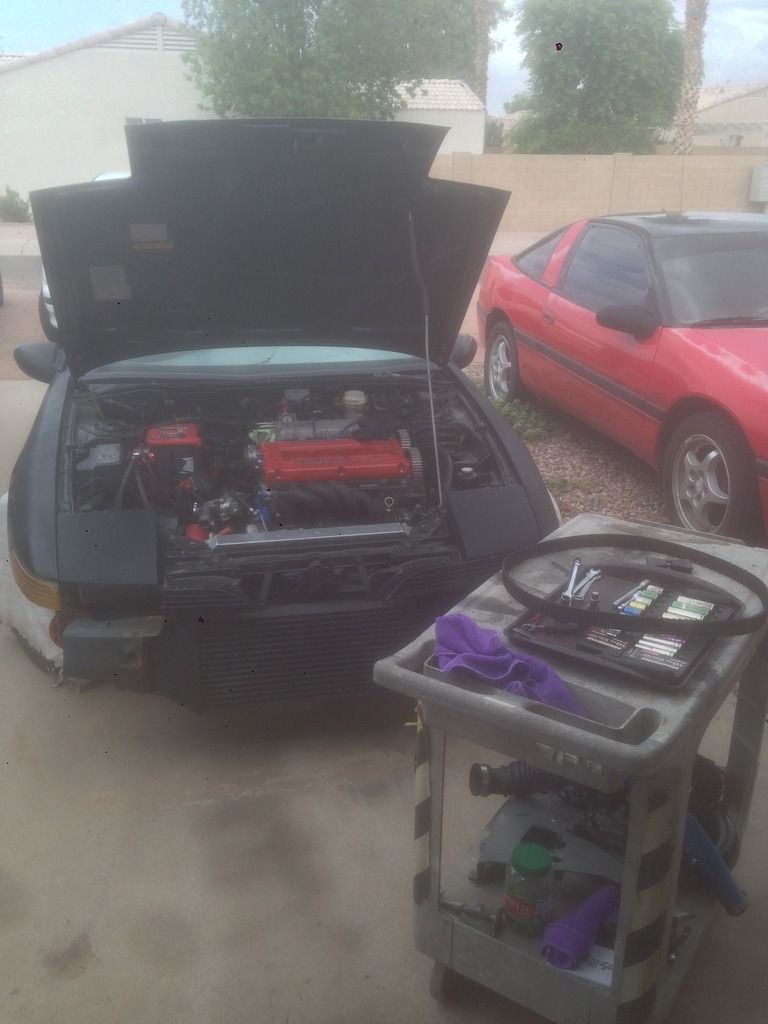

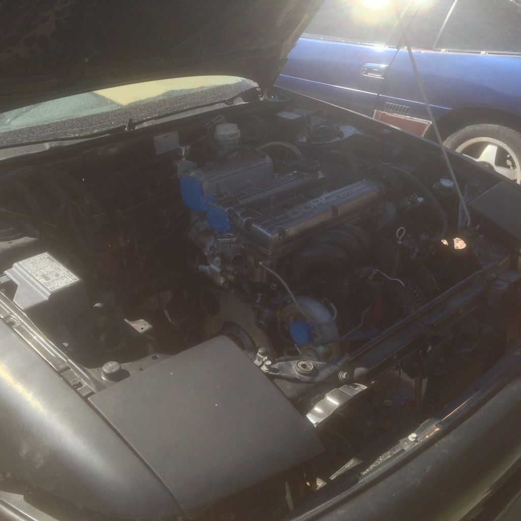

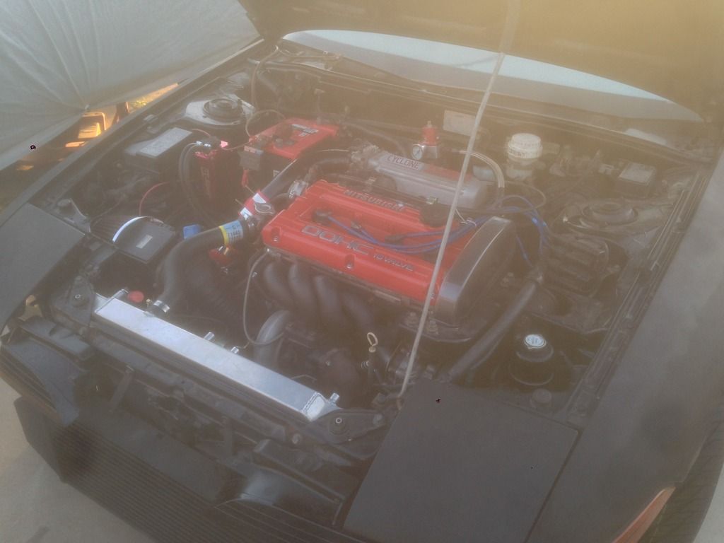

Some bay shots about 95% done

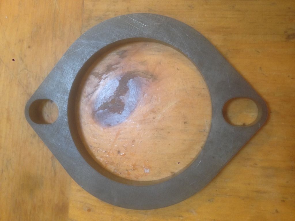

Also a shout out to my buddy Troy for hooking me up with some nice exhaust flanges for dirt cheap :hellyeah:
Im hoping to have the car running soon just waiting on a few small things.

Exhaust is done an welded up it has a Megan down pipe to 3 inch cat to OBX muffler. Nothing fancy but its all 3 inch an looks clean.

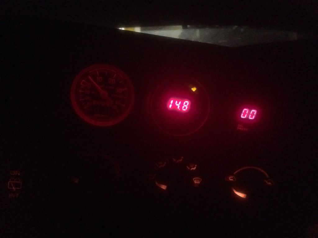

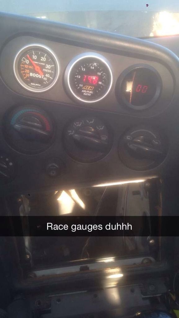

Gauges installed. Auto Meter boost. AEM wide band. Cyberdyne oil pressure.
The boost guage looks better in person my phone has a hard time focusing red light.

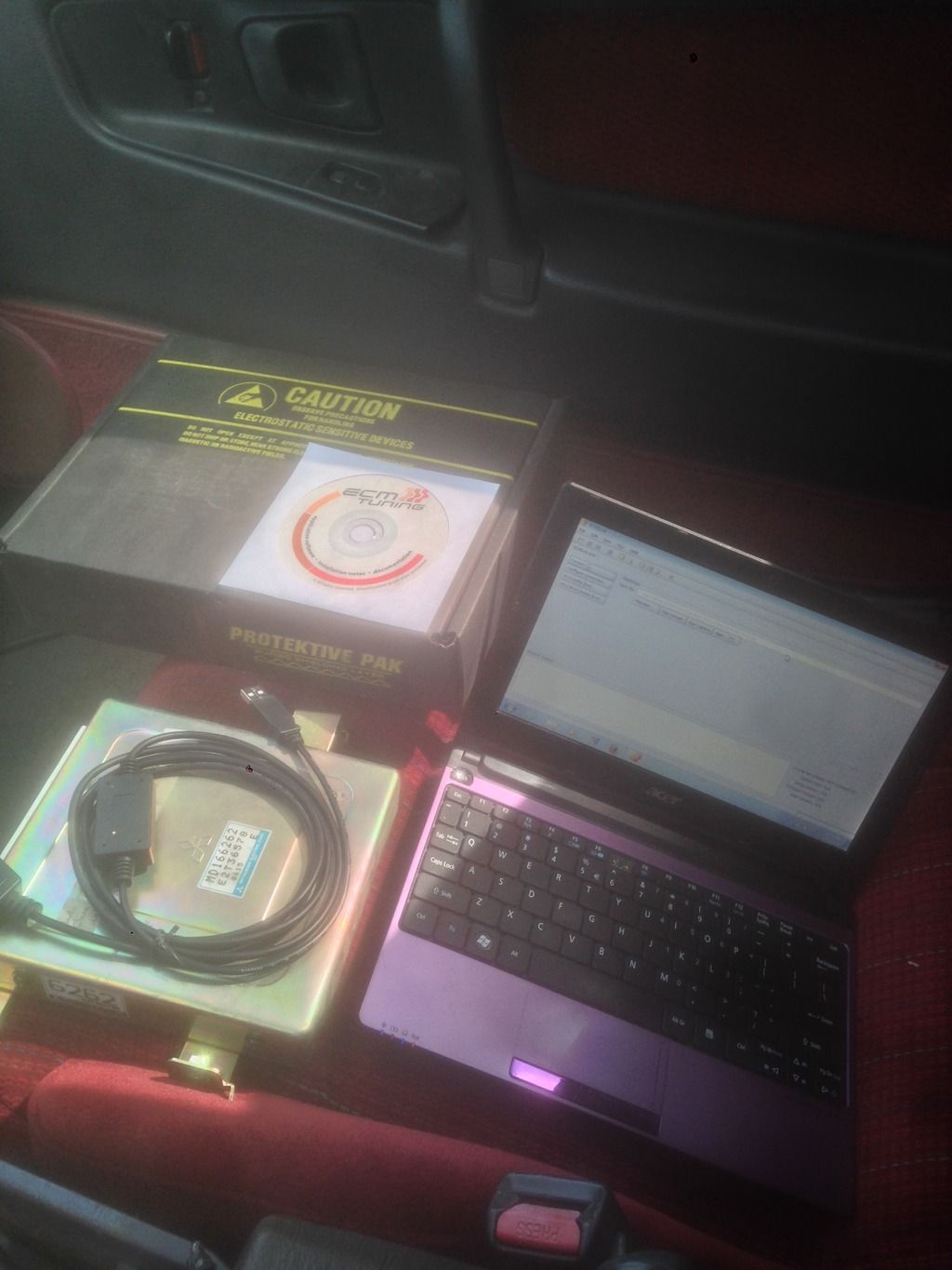

Dsmlink v3 :D

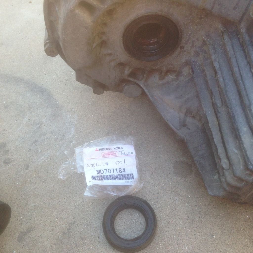

I filled the car with fluids an double checked every thing. I have a small gear oil leak coming from the passenger transmission seal.

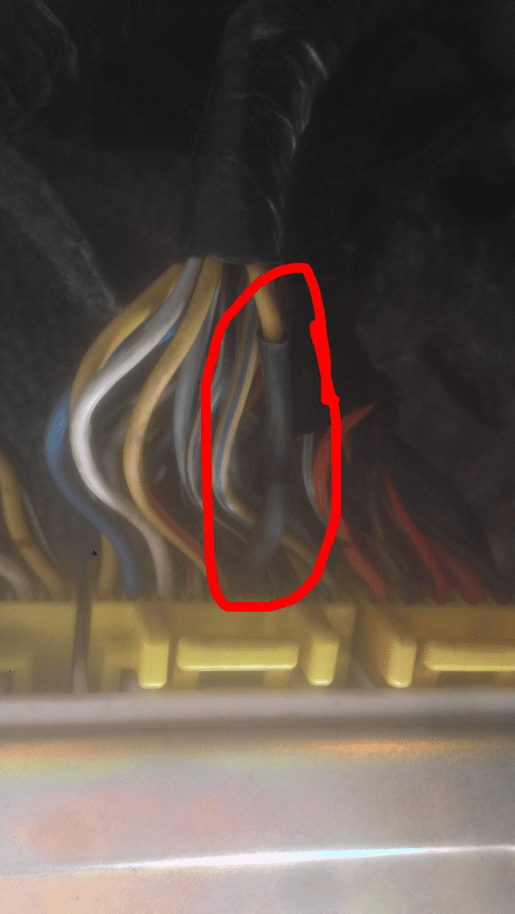

With the help of a local DSMer and tuner, N8tune we got the car started the other day but im having problems with cylinder 4 an 1 not getting spark. I have swapped the transistor unit, coil pack and CAS with used ones an get the same problems. It seems like this problem comes an goes as it will only run on all four cylinders when im the only one around :nono: When I show my brother or friends the car runs like shit an sputters on two cylinders :banghead:
I need to get my volt meter out an check all the ignition voltage an see if I can source this problem. Im guessing its most likely a loose wire or bad connection some where.

I found the problem to the spark issue. It was a bad solder connection :rolleyes:

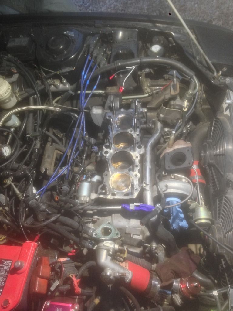

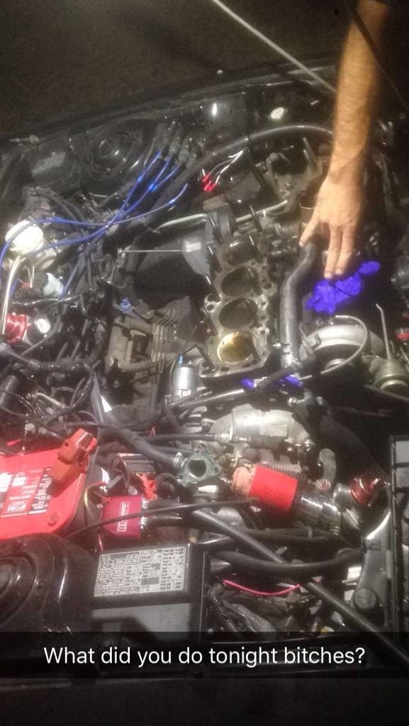

Ok got the car running on 4 cylinders every thing was going good then BAM air bubbles in my coolant WTF??? When I replaced the timing belt I swapped the stock head studs for ARP one by one. I will never do it again or recommend doing it LOL you have been warned! DONT DO IT

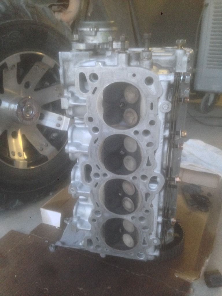

So the mad scientist an I tore this bish back apart. Notice the steam cleaned piston.
Got the head decked picked up a MLS head gasket an checked the ARP head studs and got to re assembling.
Got the bish all back together towed it to N8tunes shop for a tune. Nate was able to get 26psi an 360hp on 91 pump gas in 99 degree weather!! :tat:

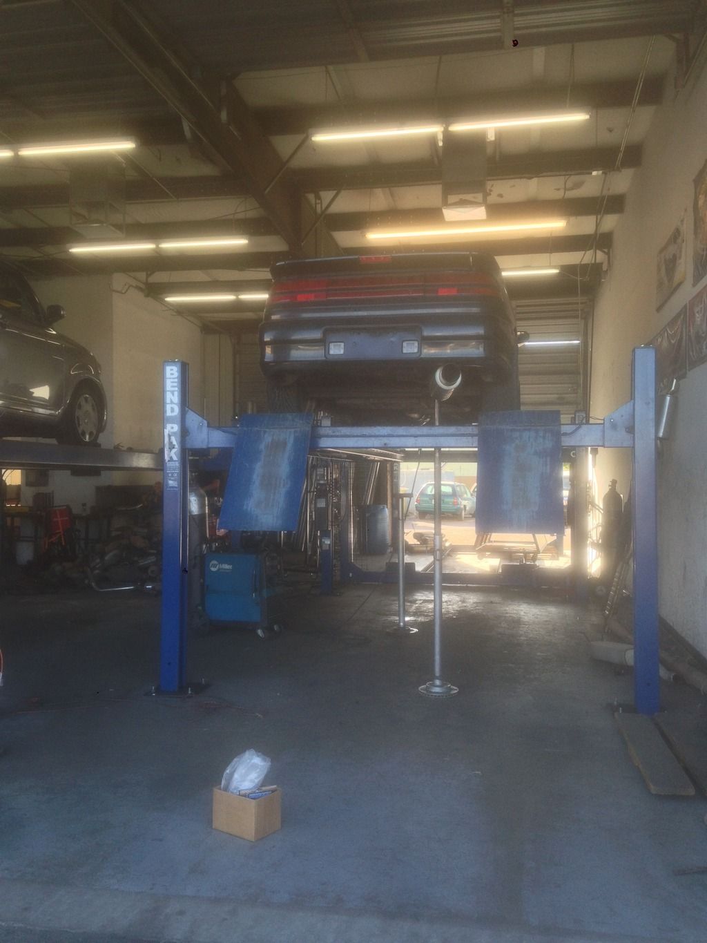

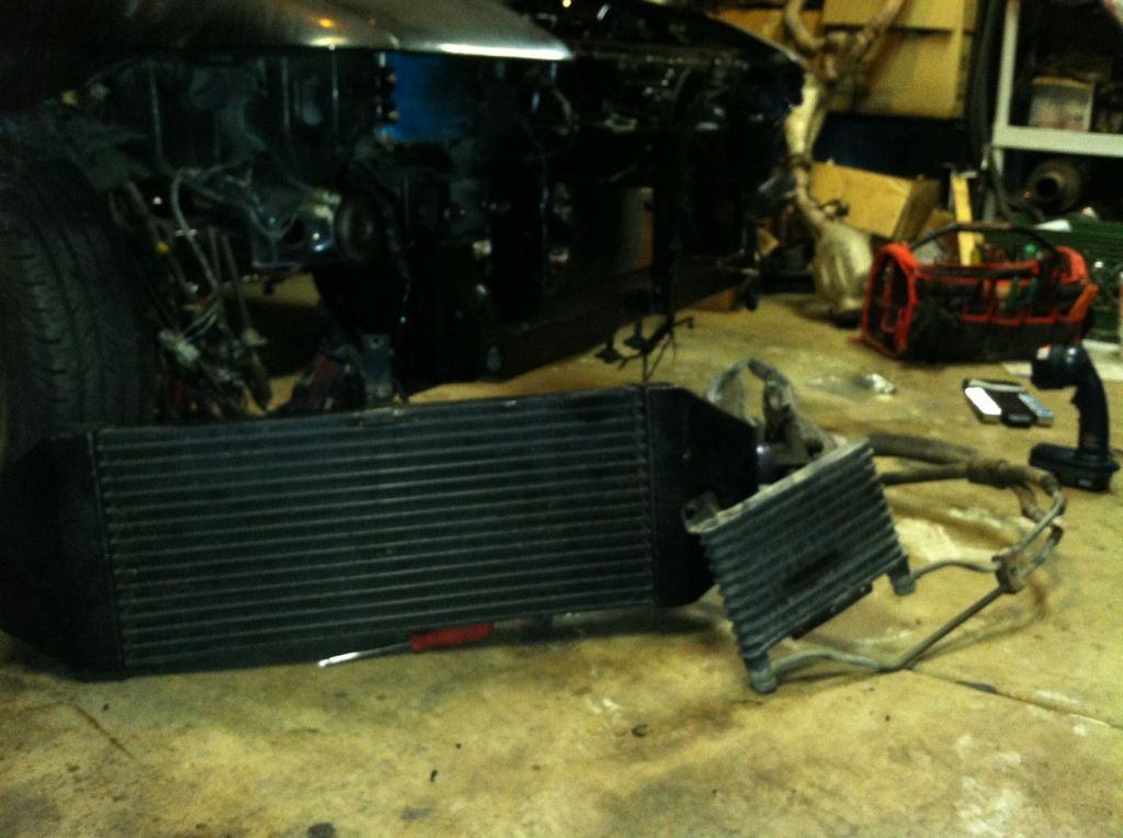

Whats going on Tuners I have a small update to add on the Black Widow. I had the car towed back to the shop to have a Tial 38mm wastegate installed and fix the oil leaks. The cars now pushing 24 psi an 350hp on 91 pump gas. It started leaking power steering fluid from the rack boots today so looks like ill just order a rebuilt rack an swap it in. Heres a few pics an videos enjoy an thanks for checking in.
