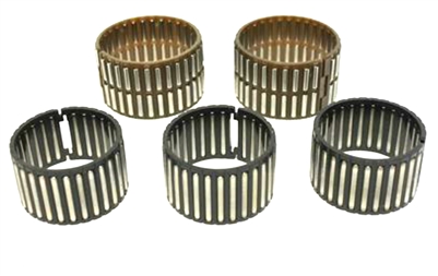

Well, as a heads up, the input shaft inner bearing (bellhousing TOB sleeve bearing with integrated input shaft seal and shaft bearing) is discontinued, along with the end case shaft roller bearings. The BK414AWS / BK414WS kits are basic parts. I would strongly suggest finding a new set of OEM shift forks, and gear needle bearing set. The "hard parts" kits are all gone.

The shift fork pads were once available too, you can still find them in other random kits, otherwise new OEM forks are your only option for worn out pads. 5th/Rev fork is discontinued.
*New 1st/2nd Shift Fork4796650
*New 3rd/4th Shift Fork4796649AB
There are essentially zero gears, shafts, hub and sliders, shift rails, etc remaining for this transmission. Which is sad because it was used in about 5 million neons, cirrus, stratus, pt cruiser, eclipse/talon, etc equipped with a 420a LOL.
