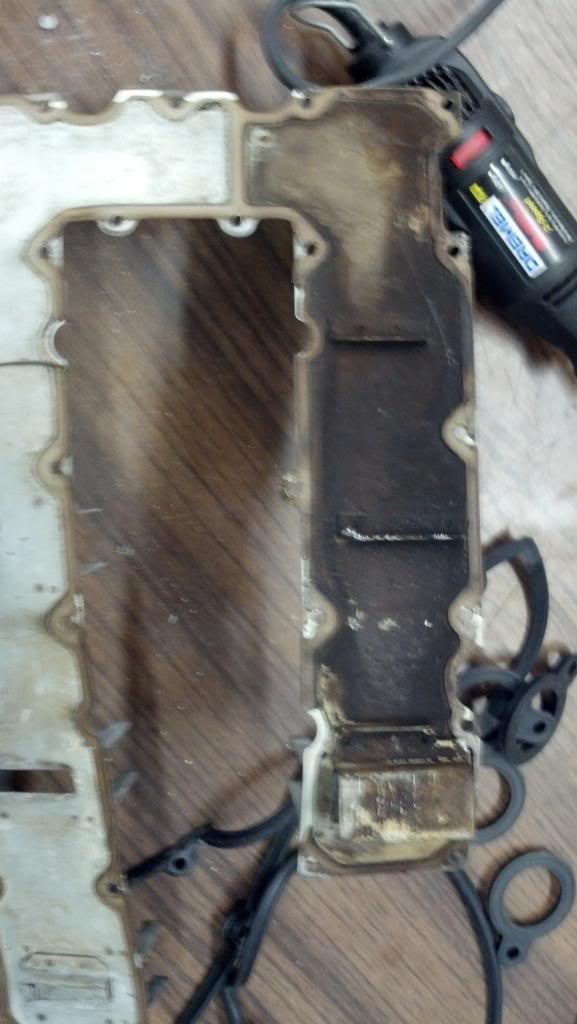

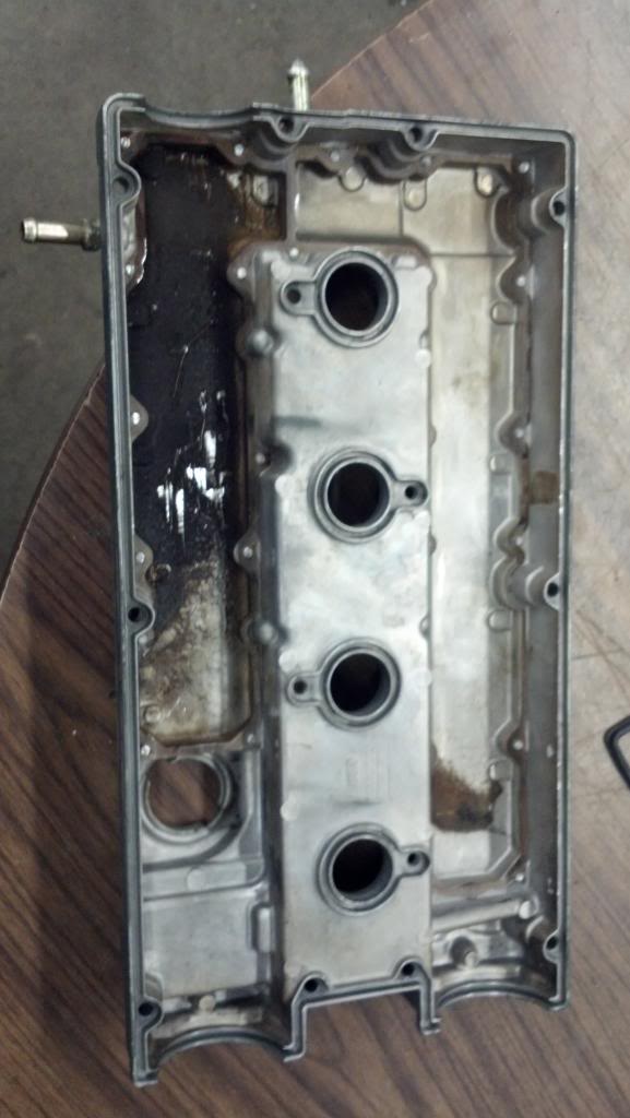

Today I decided to pull the baffle on a valve cover that was powder coated and low and behold:
The exact reason why you always want to clean it out and pull the baffle. As you can tell the media from sandblasting is still in the corners along with some build up. Easiest way to kill a brand new build in a few miles.

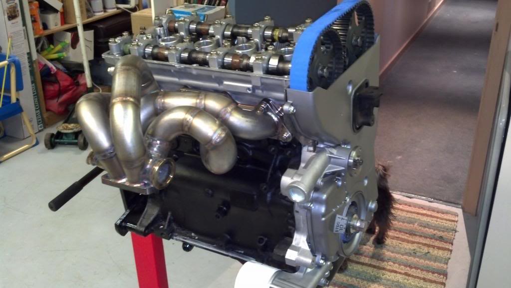

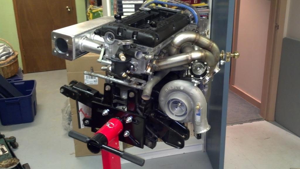

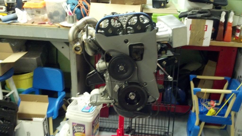

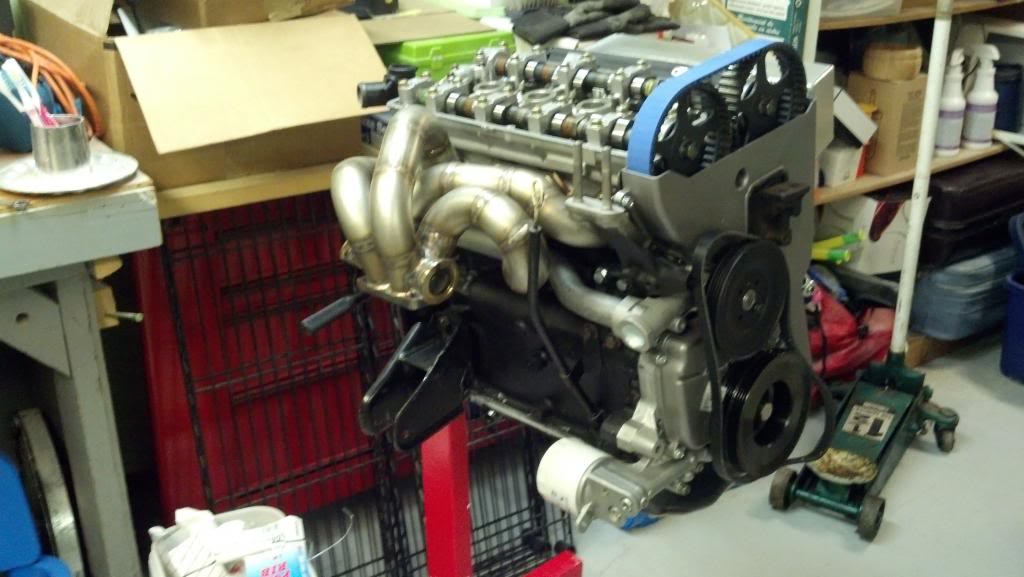

Few pictures of the engine on the stand. Expecting the last of the hardware to show up this week so I can complete it and mount the transmission.

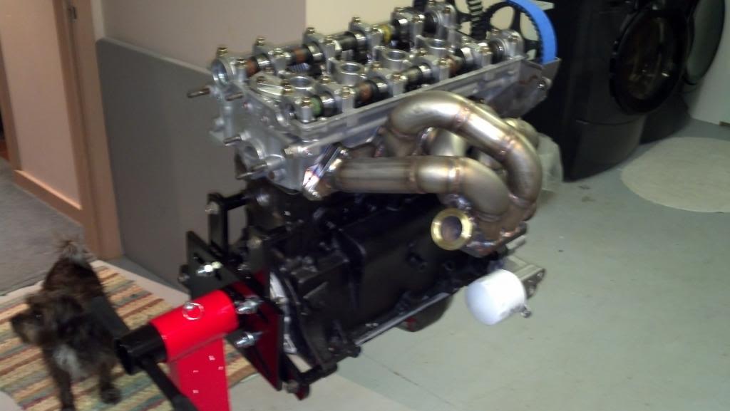

Just a few more updates. Finally getting the rest of the longblock put together. Machined out the holes on the valve cover as well for the 8an boss fittings so I can weld them in tomorrow.
Coming down to the last few weeks before I get to turn this beast over and get it tuned.

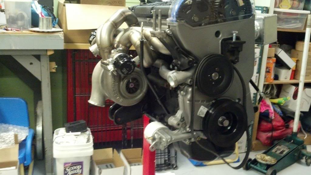

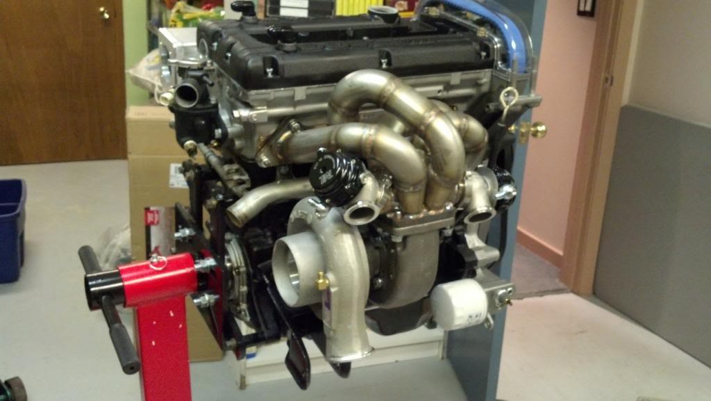

Just a few more updated pictures. Been slow going but getting there. The belt that jay racing sent me apparently is for the stock harmonic balancer pulley and not a fluidampr, so I need to pick up something that's a few inches longer. Also the bolt for the mount (lower a/c outboard side), is a bit too tall for the bracket, basically running into an issue where the alternator is rubbing on the bolt and can't pivot all the way down to be adjusted. I also had to drill out the two spacers a bit so the bolts would fit and not strip.

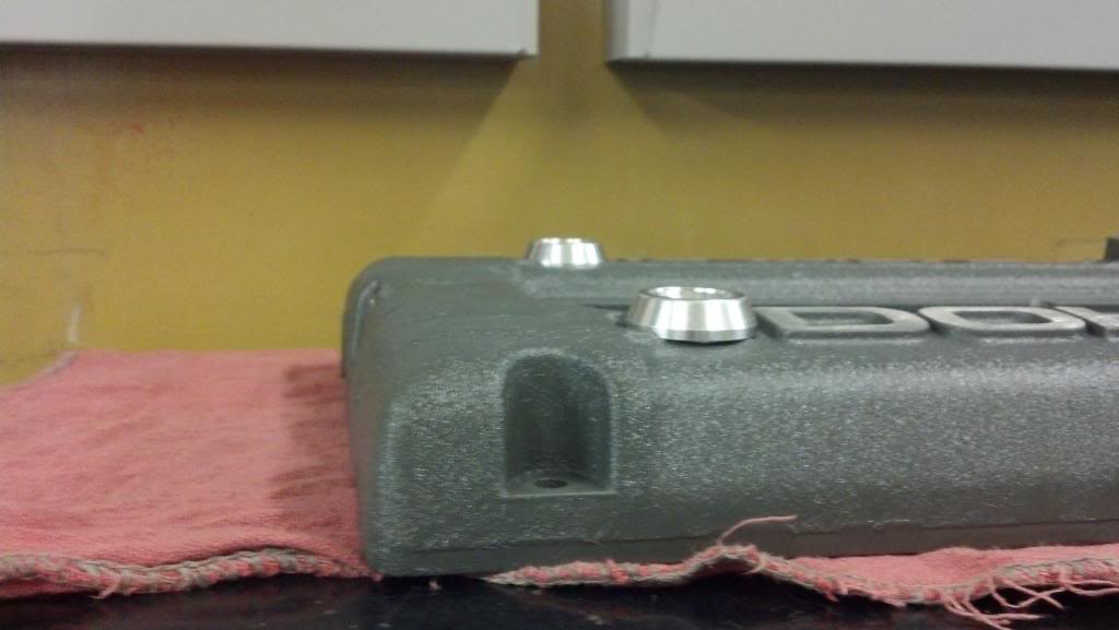

For the Hx40, it looks like if I'm going to run any kind of exhaust I'll need to cut and re-weld the dipstick tube bracket so it hugs the block. Otherwise there's no way a 3.5" exhaust would fit. I painted the valve cover wrinkle black and welded two 8an orb fittings onto it.
