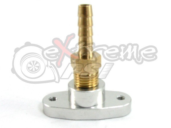

I'm looking at getting an Weapon-R. 501-112-101 Intake Manifold but the only thing is looking at that it might not work if it doesn't have the spot for the 4 bar the pics don't show a spot for it why asking . Is there way u bypass the 4 bar idk if a standalone would fix that. I'm just guessing. if someone has one let me know please
You would use a standard GM style 4 bar or a thread in style like the AEM 5 bar and a vacuum hose.
If you mean that the intake manifold doesn't have a provision for a MDP style 4 bar MAP sensor, then your options would be the ones mentioned above, or the easiest way would be to use an adapter like in the link below.
If you're trying to formulate a plan I would suggest making a new post. We can help you. Modding is great fun but it can be very disappointing if the results don't turn out like you hoped. You can also post in your profile build so we have an idea of what you're doing.
