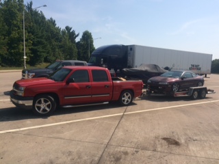

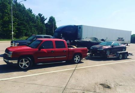

I loaded up the car hauler and set out to get this car. I got there and was surprised the car was being offered by a Mitsu/Talon enthusiast. He told me everything he knew about the car and set me on my way.

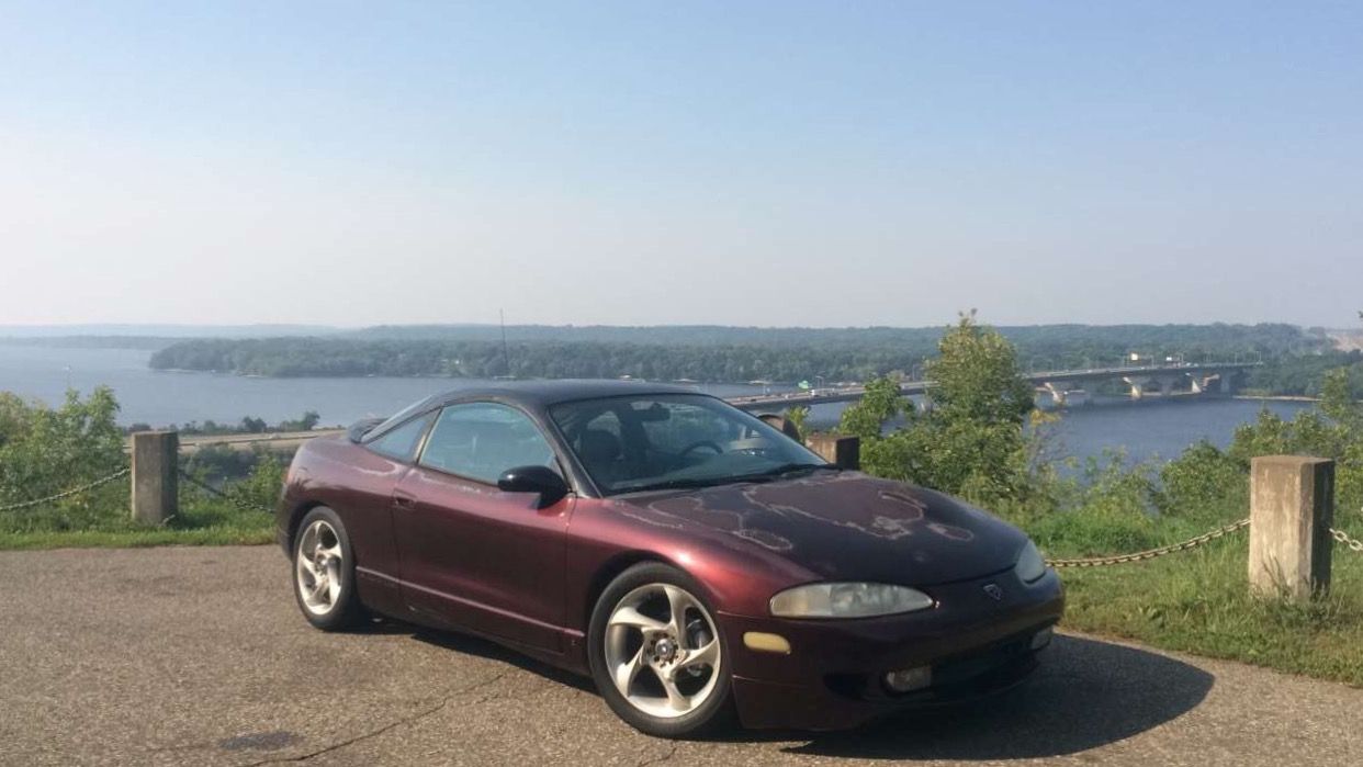

This little guy doesn't need a whole lot but I would like to set this thing back to as close to daily driver condition as possible to include (not in any order):
1) The straight pipe 3 inch exhaust is kind of much - when I test drove this car I asked myself "who would drive this thing" and bought it anyway.
2) It's low.. it has two inch lowering springs which makes for a rough ride, the purpose was definitely for looks over function (to each his own).
3) 2G Window rattle
4) Failing head liner (Done)
5) The clear coat on this car has seen way better days
6) Sway bar bushings
6) It develops a "wobble" after about 80mph. I did notice that the outer tie rods had been recently replaced as well as the ball joints on the control arms, so maybe it's the wheels, inner tie rods or alignment?.. idk yet, to be determined.

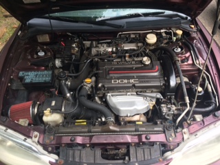

I was going through the vacuums and noticed that the waste gate solenoid was connected to the compressor outlet meaning the car was only boosting at 8psi (GASP).. So I returned the vacuum lines to the factory waste gate solenoid and pulled out the restrictor, now the turbo is spoolin away!
