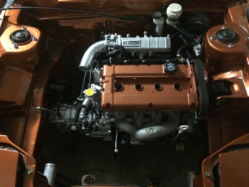

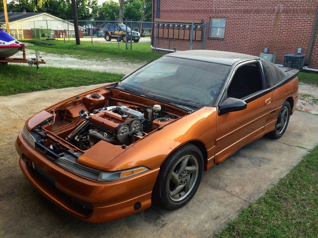

Fixed a few more sagging body parts. Made a bracket for the front bumper to keep it from drooping, and made a new way to bolt the third intercooler mount on. I guess something from the core support area has been removed by a PO.
Still need to fix the driver lower door molding, and the side skirts, as you'll see in the pic.

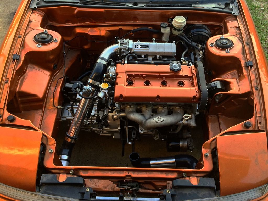

I've got all the fuel, and vacuum lines made and connected. (except the booster, still have to clearance the alternator a little) All engine bay wiring is done as well. Just need to shorten the throttle cable, and get a nice stainless braided clutch line so I can hide the only remaining visible component on the passenger side of the bay.
Still really dirty from sitting for so long, but I'm loving how it's starting to look.

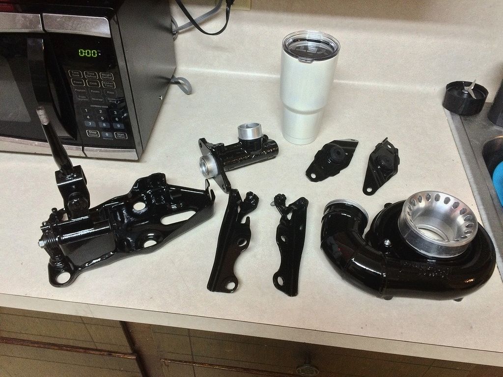

As for last night, I went ahead and made some new radiator bushings, and coated the brackets, my hood hinges, and shifter assembly. ( If you are curious how to get the new bushings, check my write up here: http://www.dsmtuners.com/threads/1g-radiator-bracket-bushings.503187/ ) Rebuilt the shifter with the Symborski kit, and "new" plastic bushings that were in my buddies parts car.
