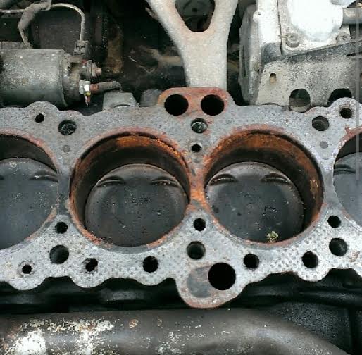

I bought my first DSM the christmas of 2013, it was a 91 Eclipse GS the interior was mint condition, the engine had surface rust on the cylinder walls but after i removed the engine and stripped the interior I had to make the decision to bring the Eclipse to the junkyard so I could get a GSX, I wish I couldve got someone to buy the GS because I felt a little guilty on bringing one to the junkyard where 9/10 chances it will just sit and rot..

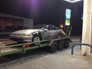

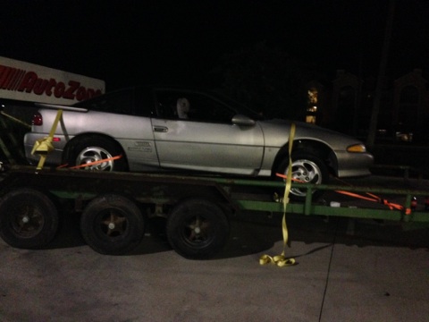

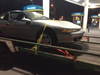

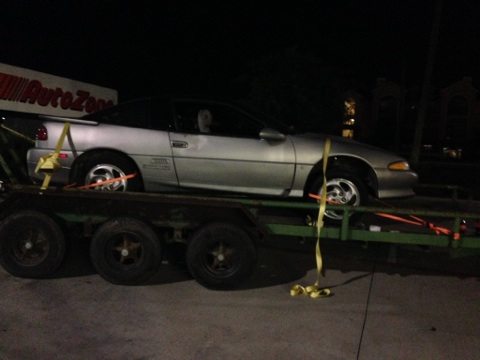

On May 16, 2014, me, my dad, and one of my good friends went and picked up my Talon. Words cannot express the happiness I felt. The whole way back home I couldnt help but keep my eyes on the beatup beauty on the trailer more than the road. What was supposed to be a 4 hour drive turned into double that because the GPS had some how relocated to a whole other area, and I hadnt caught on until we arrived at on a dirt road and it was telling me to take a left onto "offroad"..

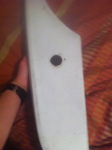

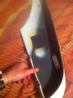

My first thing I wanted to do is replace the wing with the Eclipse's 1ga wing, I didn't want to ruin the hatch on the Talon so I just replaced the hatch with the one that I had salvaged off of my parts car.​

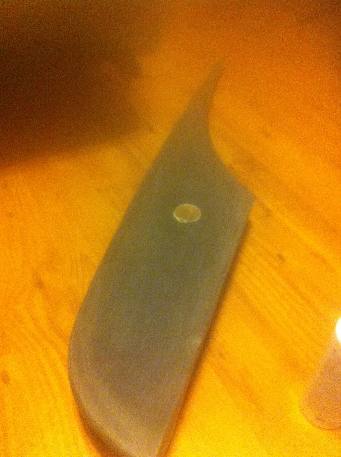

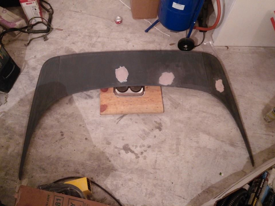

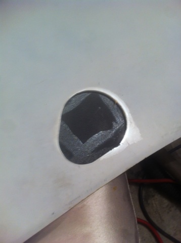

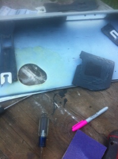

I decided to shave the antenna and rear windshield wiper, I used plastic cutouts and cemented them to the underside of the wing and the side piece of the wing, from there I used a fiberglass filler and sanded them down. I am still in the progress of finishing them because I have been caught up at work. Here is some photos of the progress.

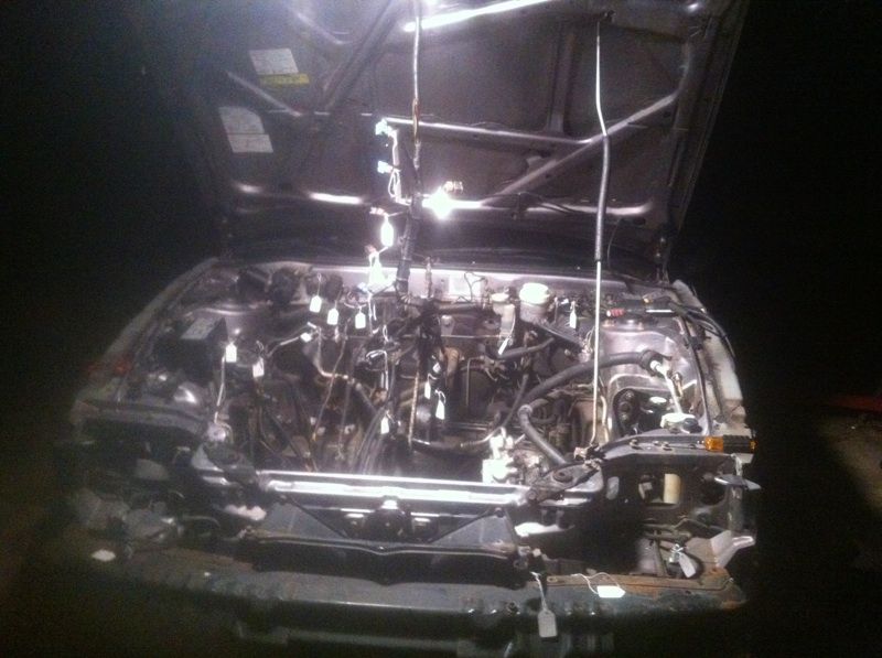

Fusebox Relocation

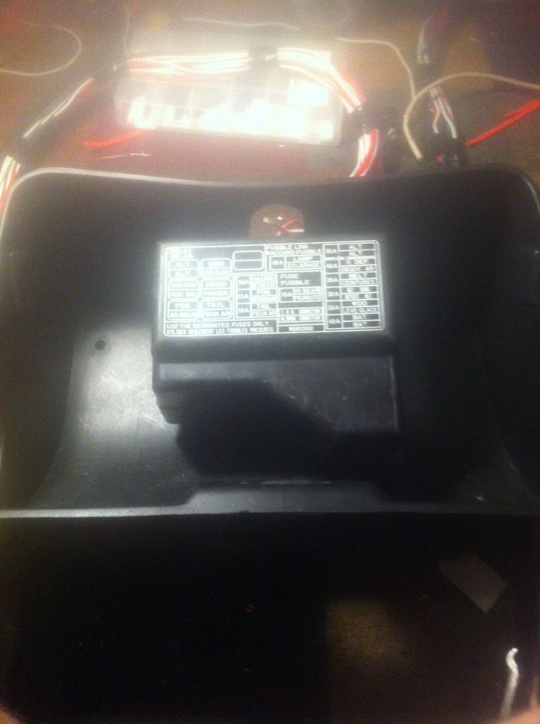

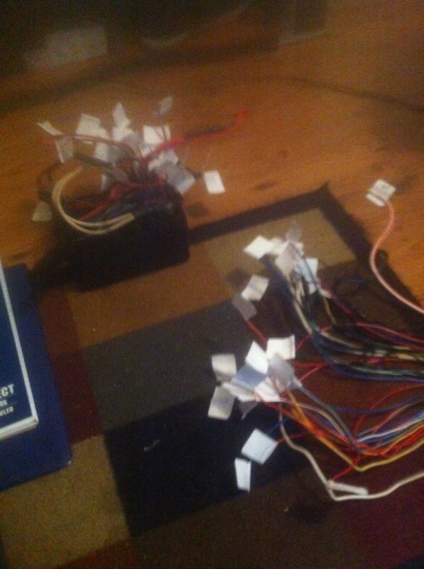

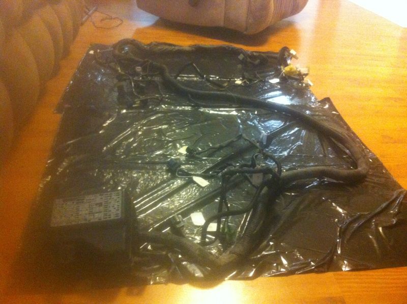

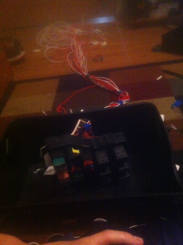

I havent been able to post lately due to summer school and work and when im not busy Ive been working on my fuse box relocation. I extended all of the wires by 5ft, it took way longer than it should have but I'm in no rush. Today I started looking at where the wires are going to run at, here are some pictures of my progress.

Its totally okay and I wouldn't consider it off topic as it is a great question, personally I didn't see a step by step post I had a friend who did this with his 240sx and I just followed what he did, after I pulled my whole harness out I tagged each connector with their correct tag and I also got a spiral notebook and wrote down what each labeled tag was, when I tagged all the connectors I looked in my spiral and marked next to all the connectors i was deleting when that was done I would look at that connector and I followed each wire all the way to where they went to, to make sure it didnt connect to anything i mightve still needed. It actually surprised me when it didnt so i cut the wire out of wherever it lead to and when it was all done I had all the connectors I needed and there was no stray wires, when that was done i moved on to extending my wires, I spliced them 1 by 1 extending all of them by 5 ft after that was done I again had to splice the wires in two close to the fuse box so i could fit it in my glove box i labeled all of them so i knew which wire would come back together by labeling one side "1" and the other side "1" then go to the next wire and label it "2" and so on. I made a reasonable size template for the fuse box where to run the wires through, I used a dremel to cut it out, when it was cut out I fit the fuse box where I wanted it and put the wires through the hole then reconnected them all. after that I ordered some wire loom and some clips that came in handy for tucking them under the fenders, I will link them at the end of this post. I ended up using 3/4" and it worked very well but yours might be a little bit thinner around it all depends really. as of now I have fitted it back up and it looks good, Im unable to take pictures at the moment because my phone is trashed and I am waiting on a new one. If you have any more questions please let me know and I'll help you to the best of my abilities. good luck buddy!

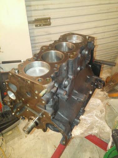

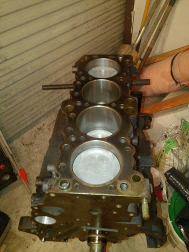

I started off with a 6bolt block from a 91 GS, I bored the block .20 over and used 2g NPR pistons on 1g stock turbo rods and crankshaft, I also used ACL trimetal rod and main bearings.
This is the block when I pulled it and how it sits now.

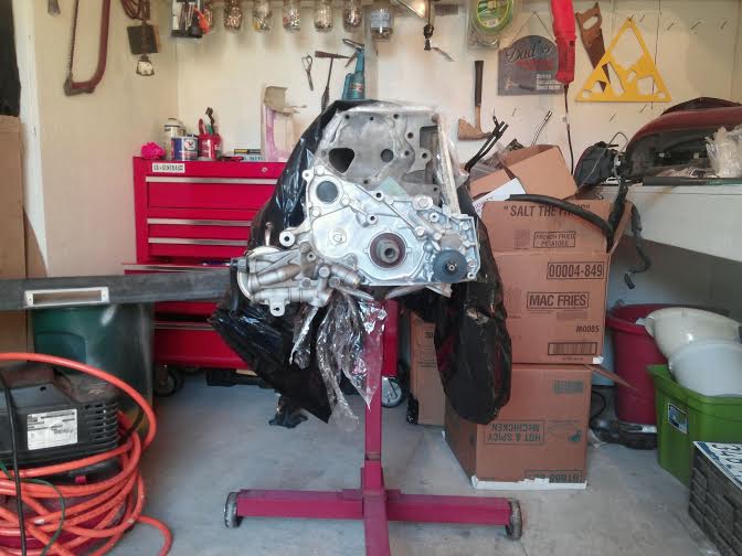

I finally got around to doing some more work to the block. I installed a brand new front case, oil pump, gears, balance shaft elimination kit, and oil filter bracket with the oil cooler sandwich.

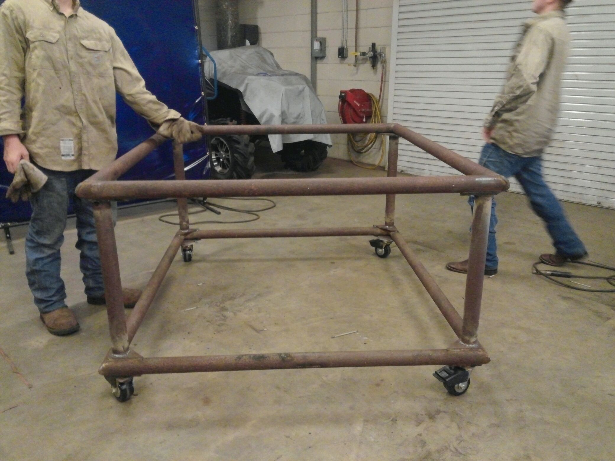

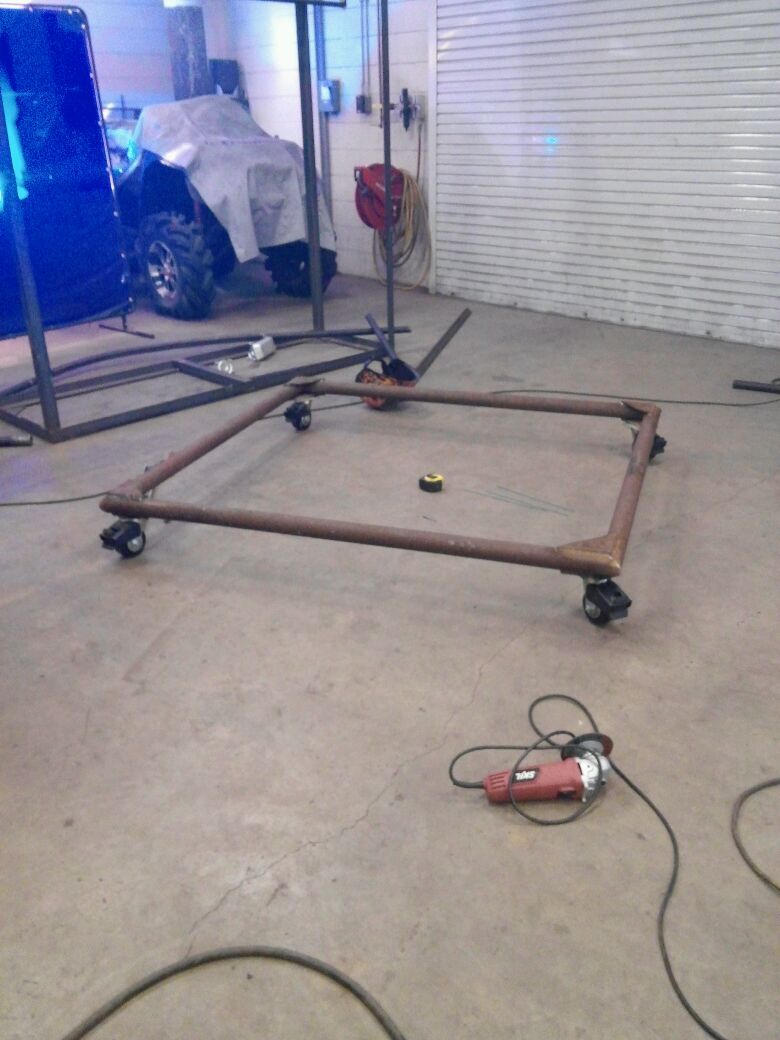

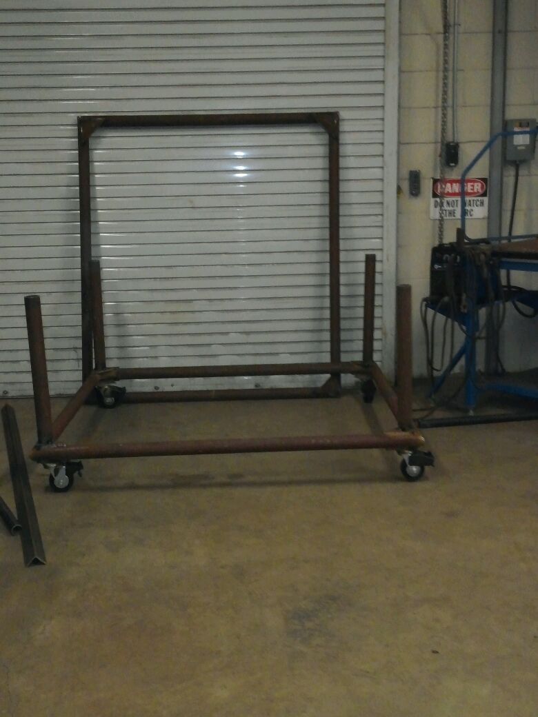

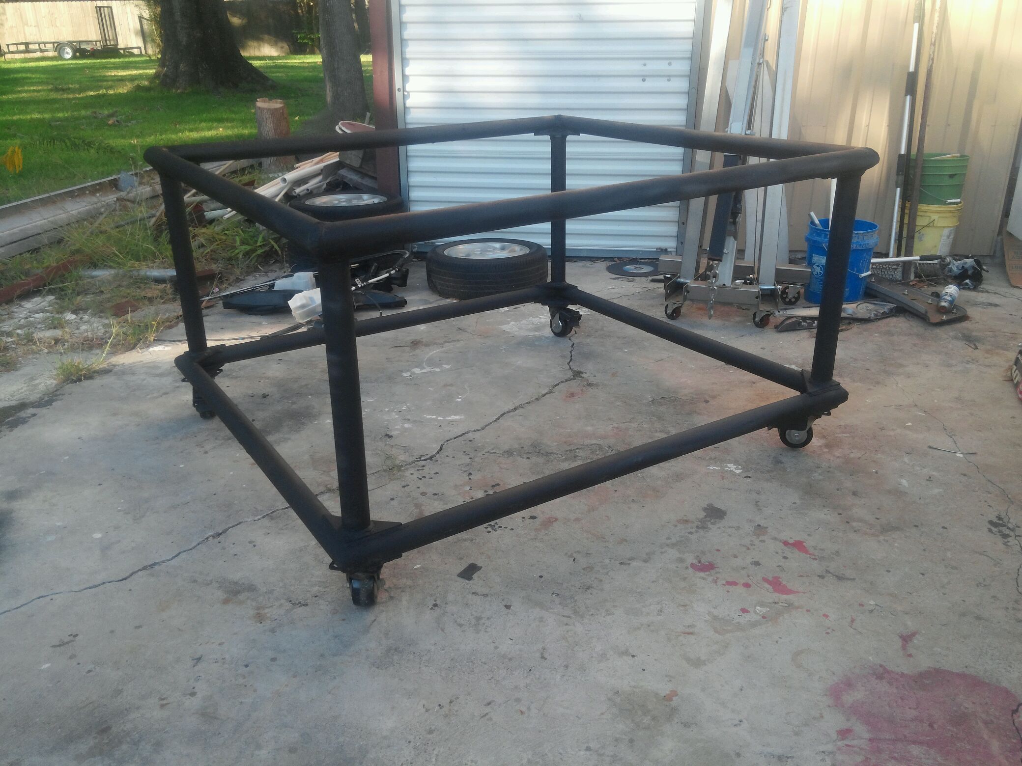

With some inspiration from Green Goblins car stand I decided to make my own, I will be using it so that I can abrasive blast and paint (won't be for a while) and to do my suspension and clean under the car. It might not always be useful or a "waste of time" according to some people but it was more than just building it for the car, I got to put my welding skills to use and I guess engineering skills too.

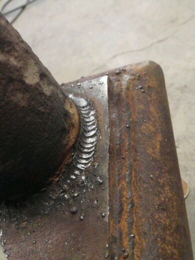

Just a 6010 root pass taken before it was cleaned of slag and residue
