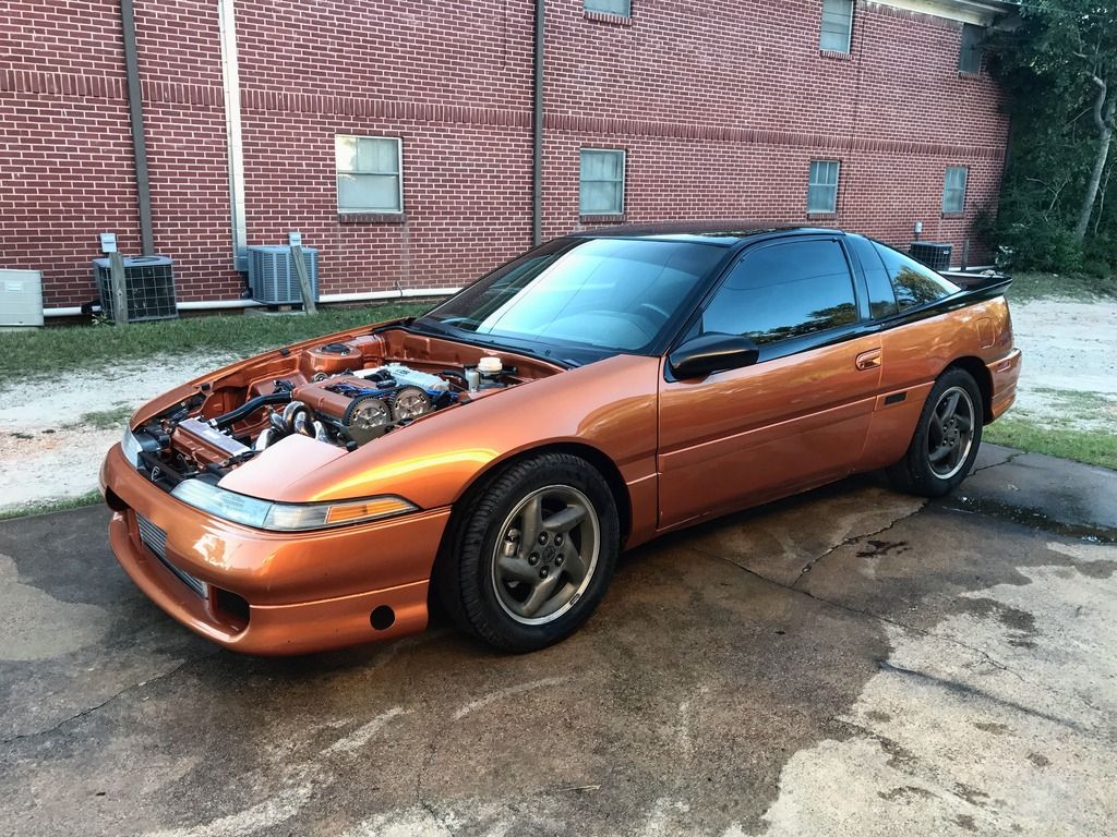

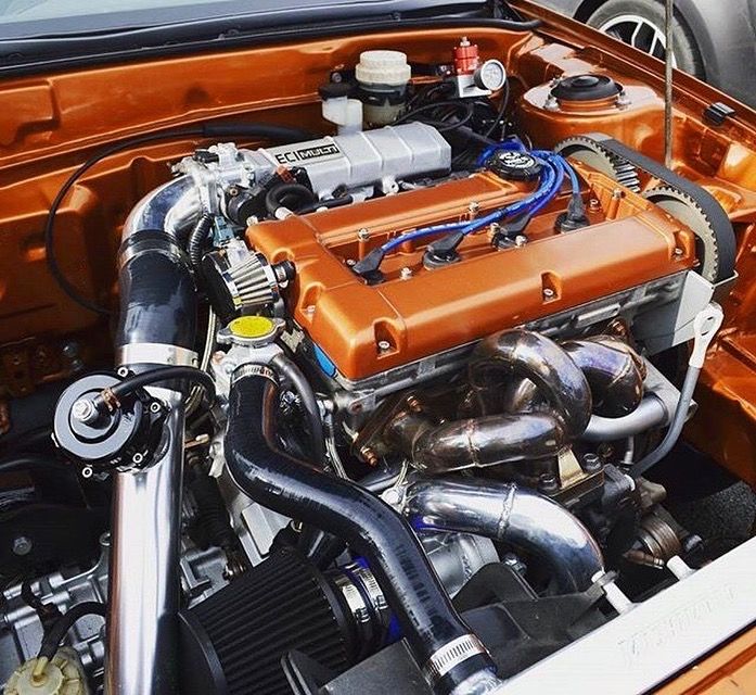

I'm absolutely stoked at how nice it came out. It still needs a few things done to complete the tuck, but I still think it looks incredible.

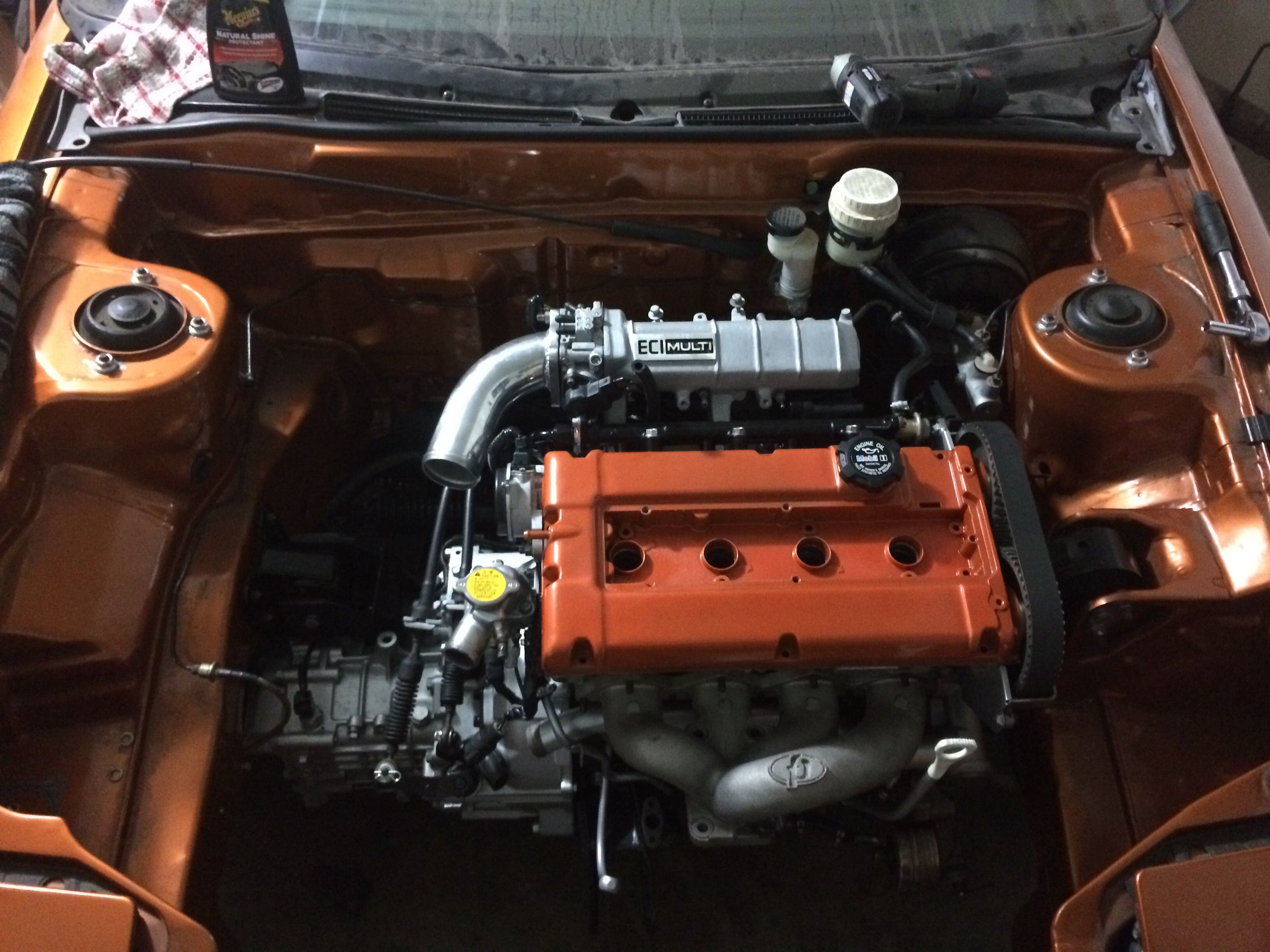

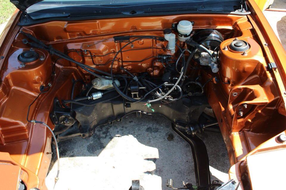

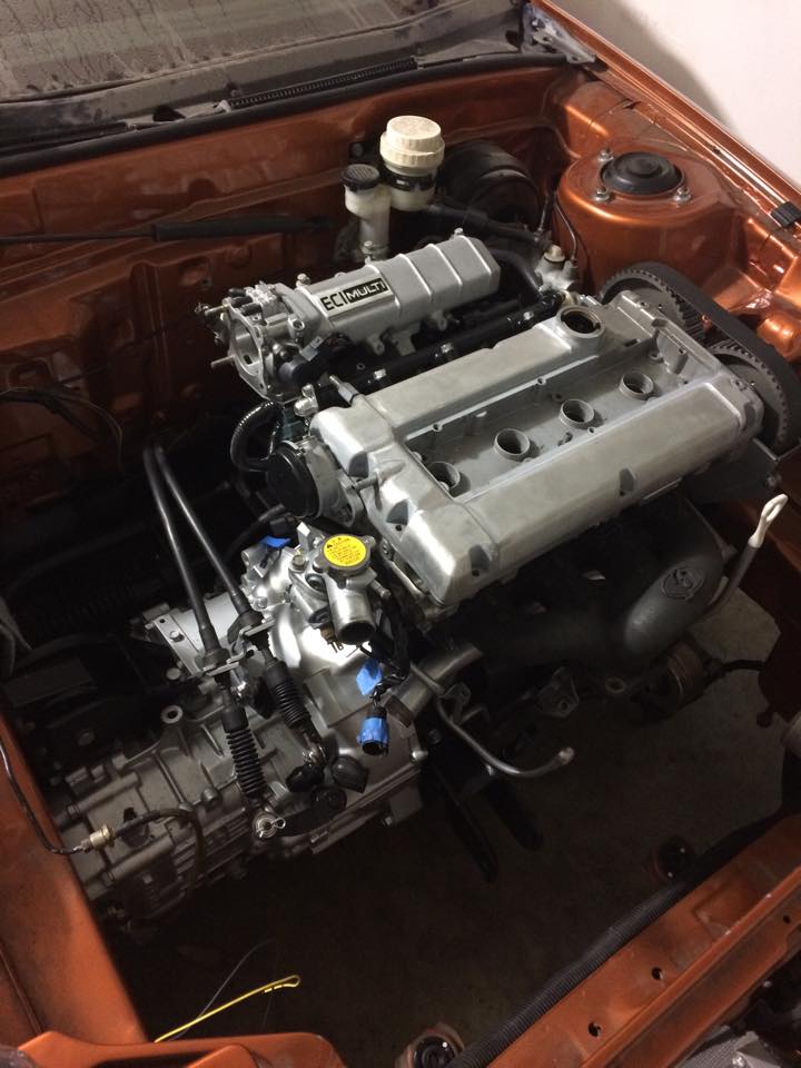

Here's a picture of the engine bay with everything in it:

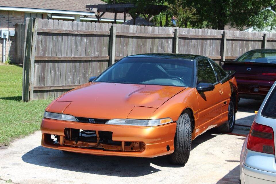

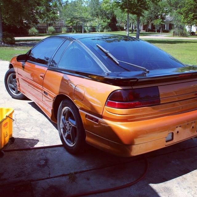

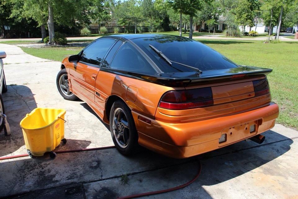

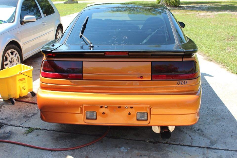

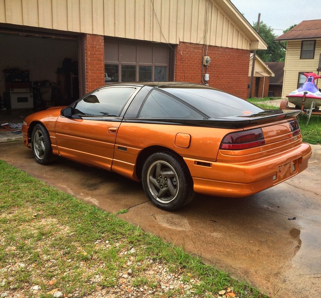

Finally got to wash the car (what a satisfying wash it was, to remove 2+ years of dust)
Still need to address the few body panels that are messed up.

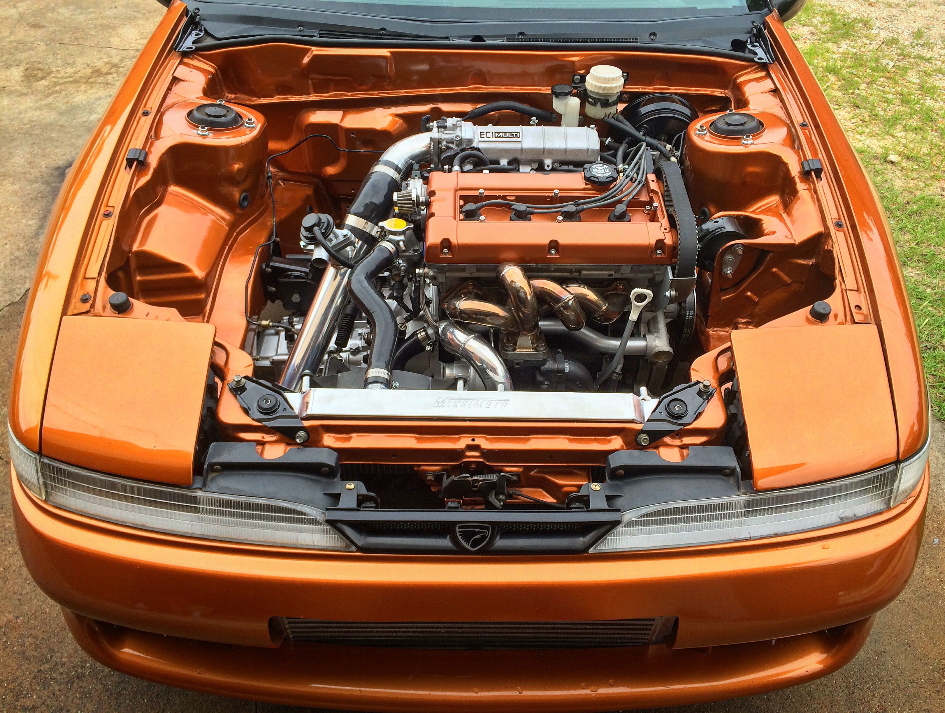

Looks great man, let us know how it feels with that subframe
Man Logan, that looks awesome! The engine bay it to die for. Great work!:applause:
Thanks man, I really put a ton of time into it!
I can't imagine it will be a pleasant ride LOL. It already vibrates a good bit just revving it

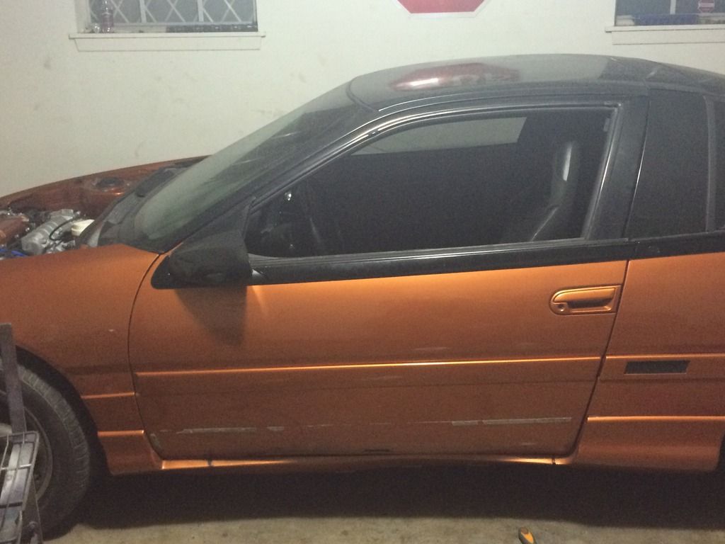

  • Fix the body panels that are sagging

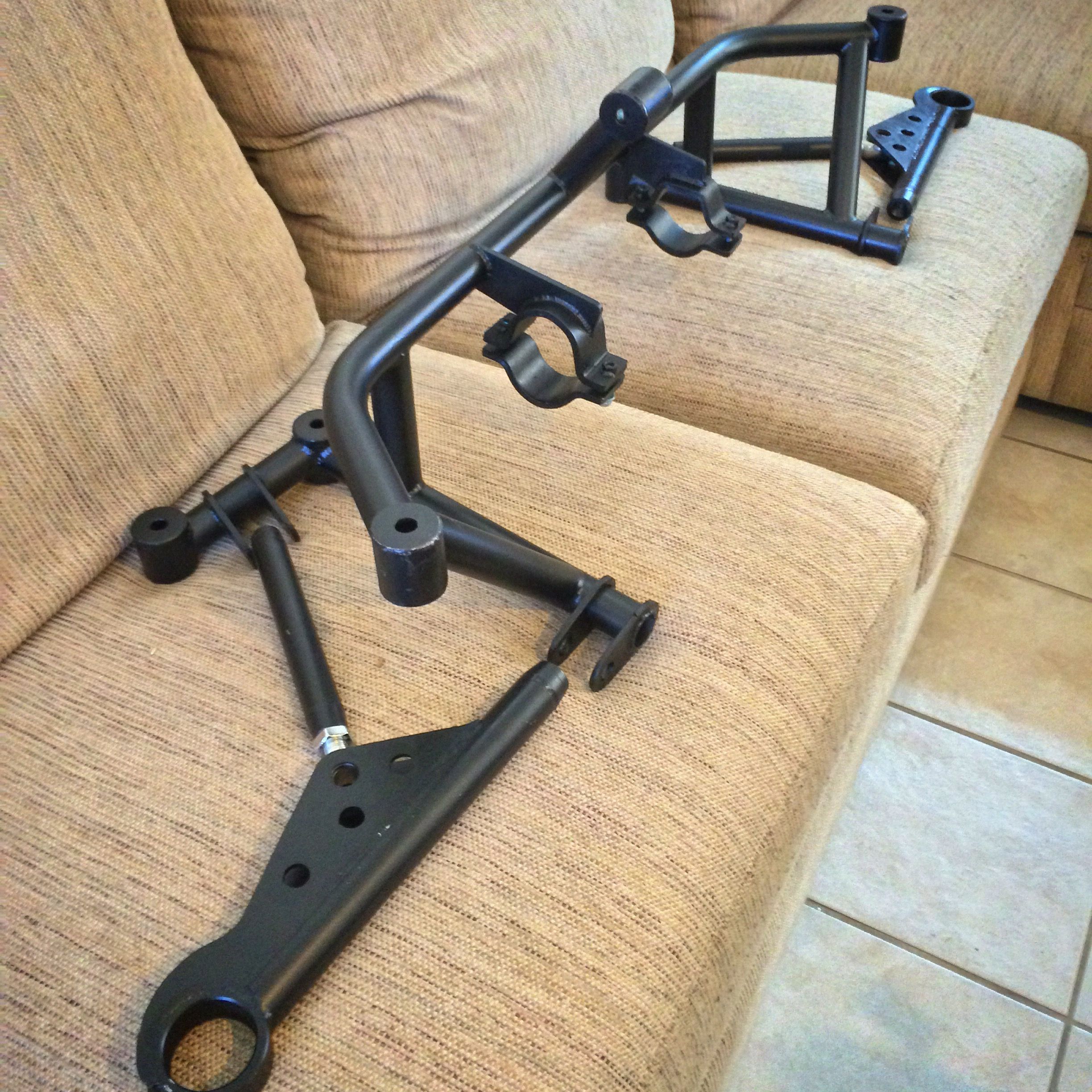

Do you coat everything yourself or have it done? Awesome build!
Yes, I powder coated everything myself. I have a small setup and have been doing parts for people for some time now. I actually quit my tech position at my old shop and am doing powder coatings (and cerekoting firearms) full time now.

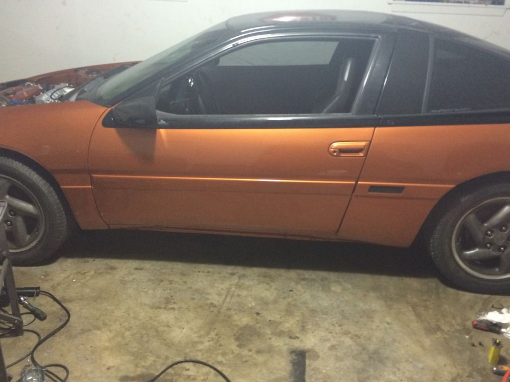

We are now AWD again! Cleaned up and re-greased the axles, got em in and torqued everything down.
Also got the toe set much more close to where it needs to be. Put the new 90* fitting on the fuel line so it clears the axle properly, and bolted up the crossmember. (apparently I lost the motor mount bolt -_-)
Going to try and back it out of the garage tomorrow. Will be the first time it's moved under it's own power!

Man super happy for you, I know how much work it takes to get even to this point. Great job love the k member and lower control arms... super jelly :pray:;)

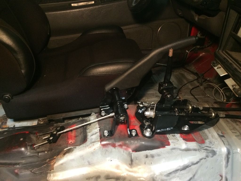

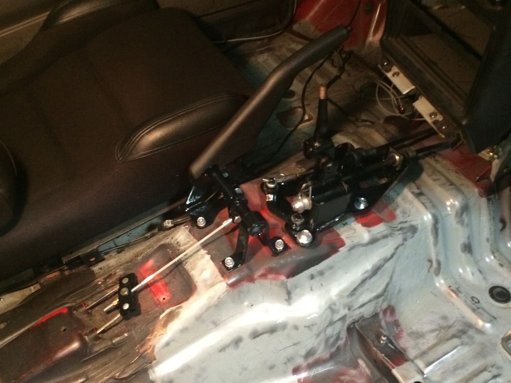

New plastic bushing for the shifter. These are the pieces nobody should ever have to replace, but I'm an idiot and powder coated my whole shifter assembly not thinking there was anything meltable. So it's all rebuilt and looking good. Solid mounting bushings went in as well. Gonna have to pull them out again once I add carpet, but it's going to look great.

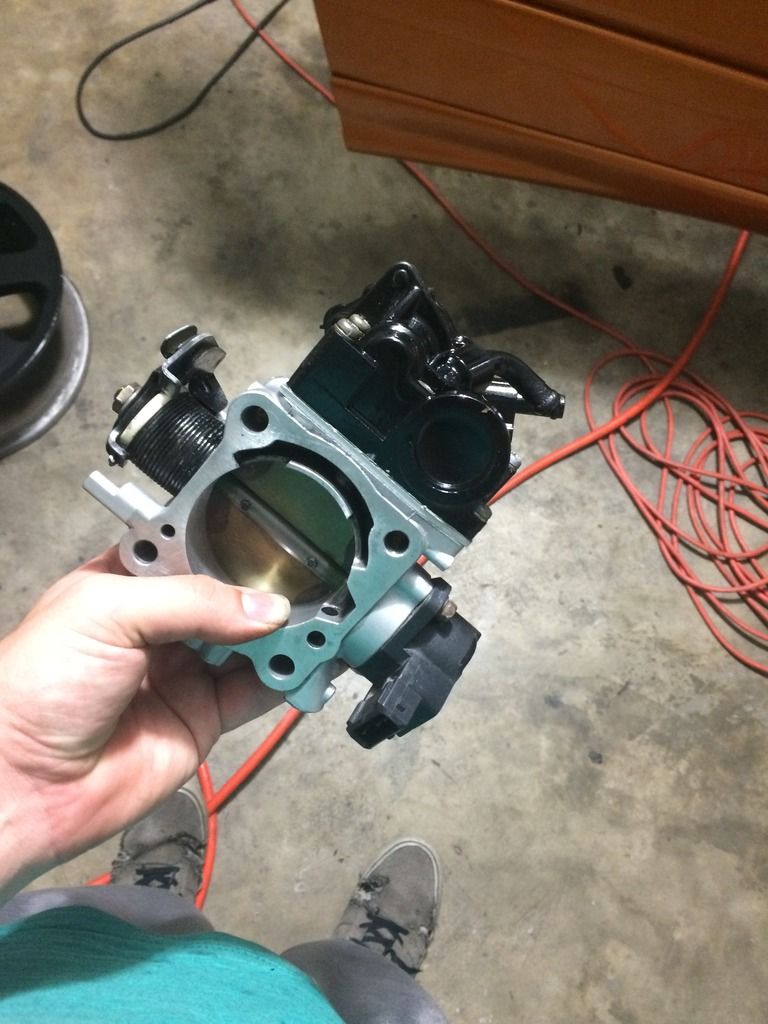

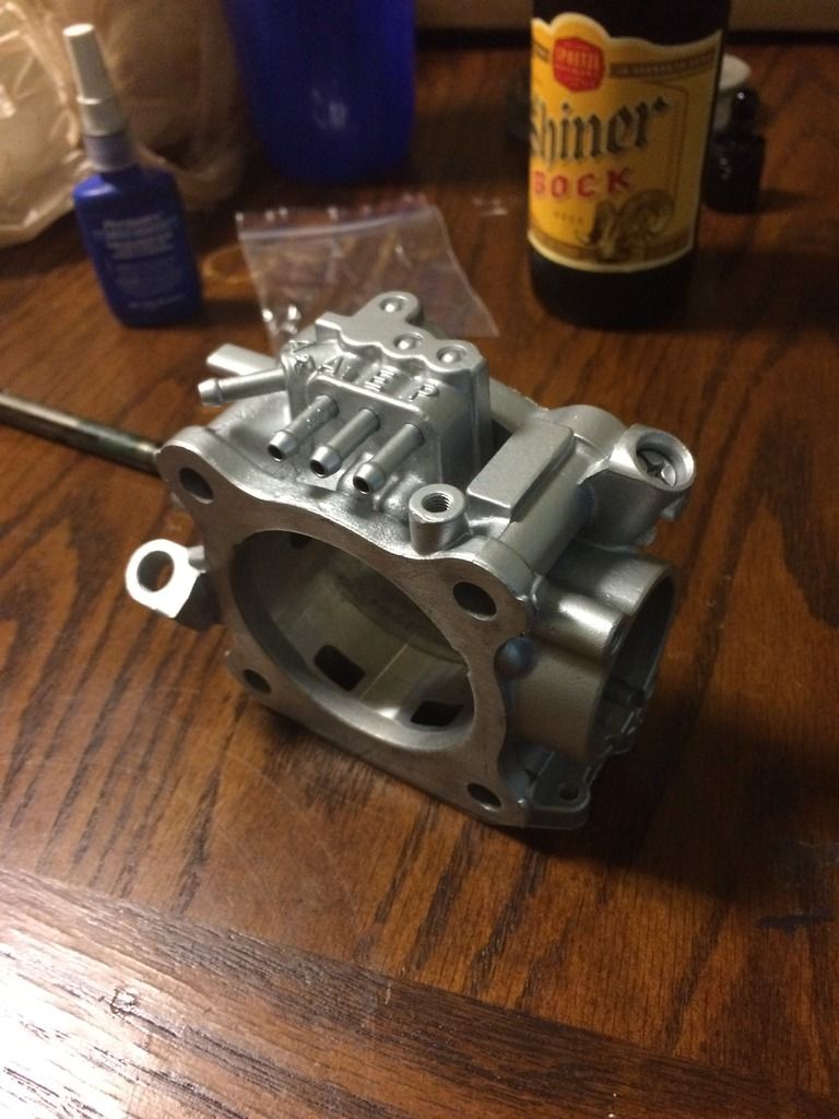

Throttle body shaft seals, and biss screw/seal. Went back with IAC, but will have to extend the wires to make it reach again. Hopefully this helps with idle.. At the cost of uglying up my bay.
Apparently the vrsf throttle body elbow isn't made all that well anymore. It was hitting my idle position sensor base on the throttle body, not allowing it to fully seat correctly. Ground it down and it's nice and sealed now.

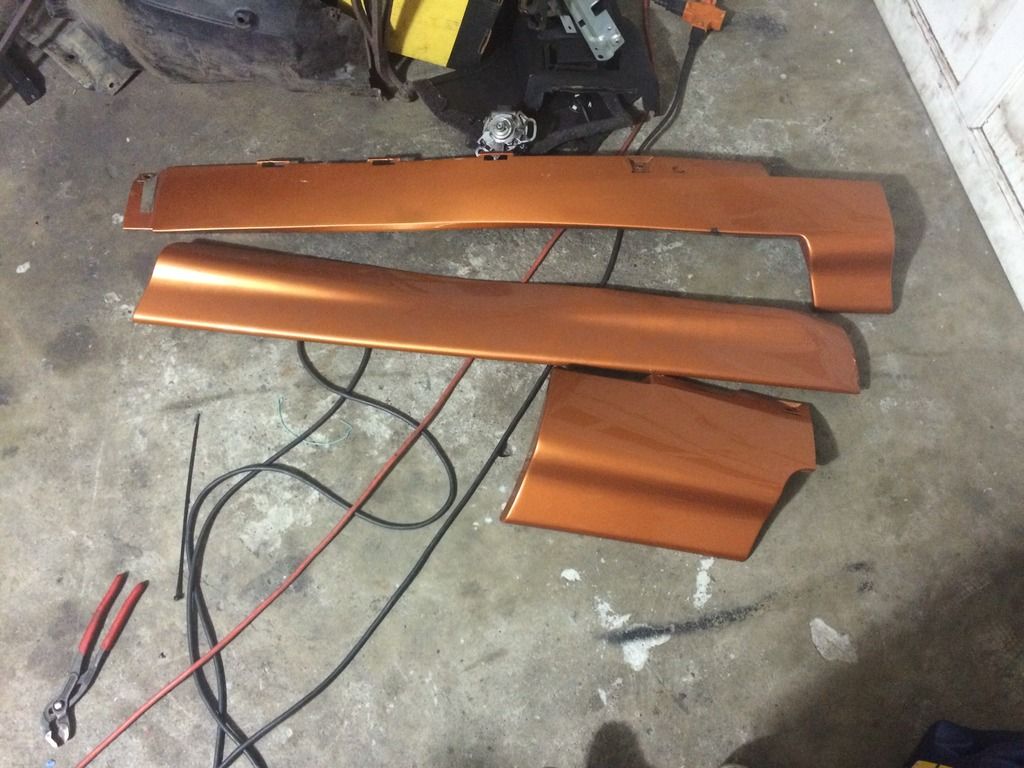

Started on the body panels. Tons of double sided tape everywhere. Takes forever to peel off, but almost finished.. I'll get them put back on soon. Only one left to fix is the center tail light piece, around where the lock cylinder is. (Kill switch in my case)

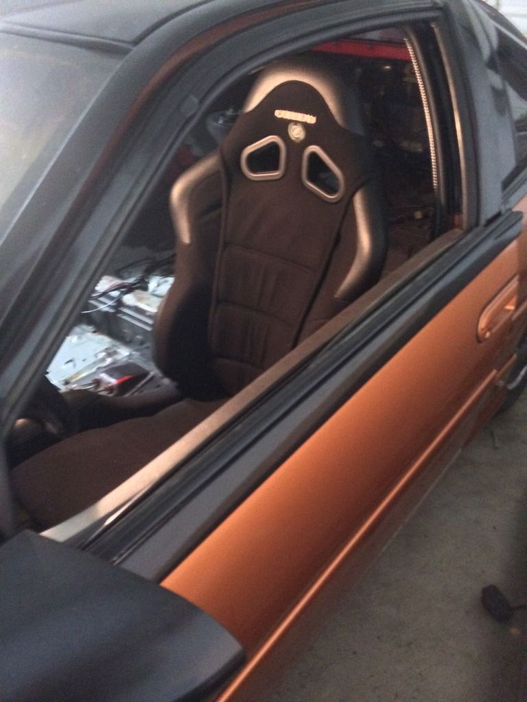

Got one of the seats bolted in, and was checking the bracket fitment, when I stumbled upon how bad they fit. I'll have to chop the rear mounts and weld some new ones, at least on the driver seat. Haven't checked the passenger yet.

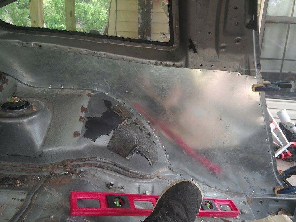

Here's a better shot at the sheet metal panels for the interior. I was planning on just using these, however I've been watching a lot about how to make carbon fiber parts at home, and I think it would be pretty cool to replicate these in carbon. These panels can easily be used as molds, so the hard part is done. We'll see.. It may be too expensive to buy all the rolls of twill.

It was made by Joshua Callahan out of Pennsylvania i believe. He's primarily on Facebook. Very, very nice guy but his customer service is extremely lacking. He's just overwhelmed by the work he's got I think. I'm still waiting on the tubular crossmember with the front motor mount.
Do you know if Joshua Callahan make 2g front subframes?

He does make 2g front and rear subframes. I have one of his rears and I had to modify where the diff bolts up for it to fit right. I think its luck of the draw if his products turn out the way they should. Some people have had good luck some people(my friend Matt Kruger) has now been sent 2 front subframes for his 1g and neither of them fit. BTW, nice build looks so clean!
I got lucky, mine was #10/10 so he had made the revisions prior to mine being built. I really want a rear subframe as well, but I just don't think I can order from him again.
