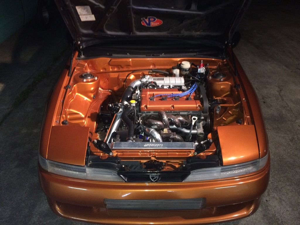

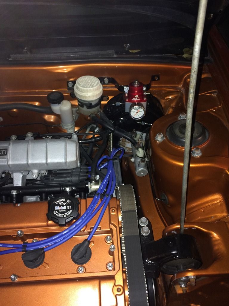

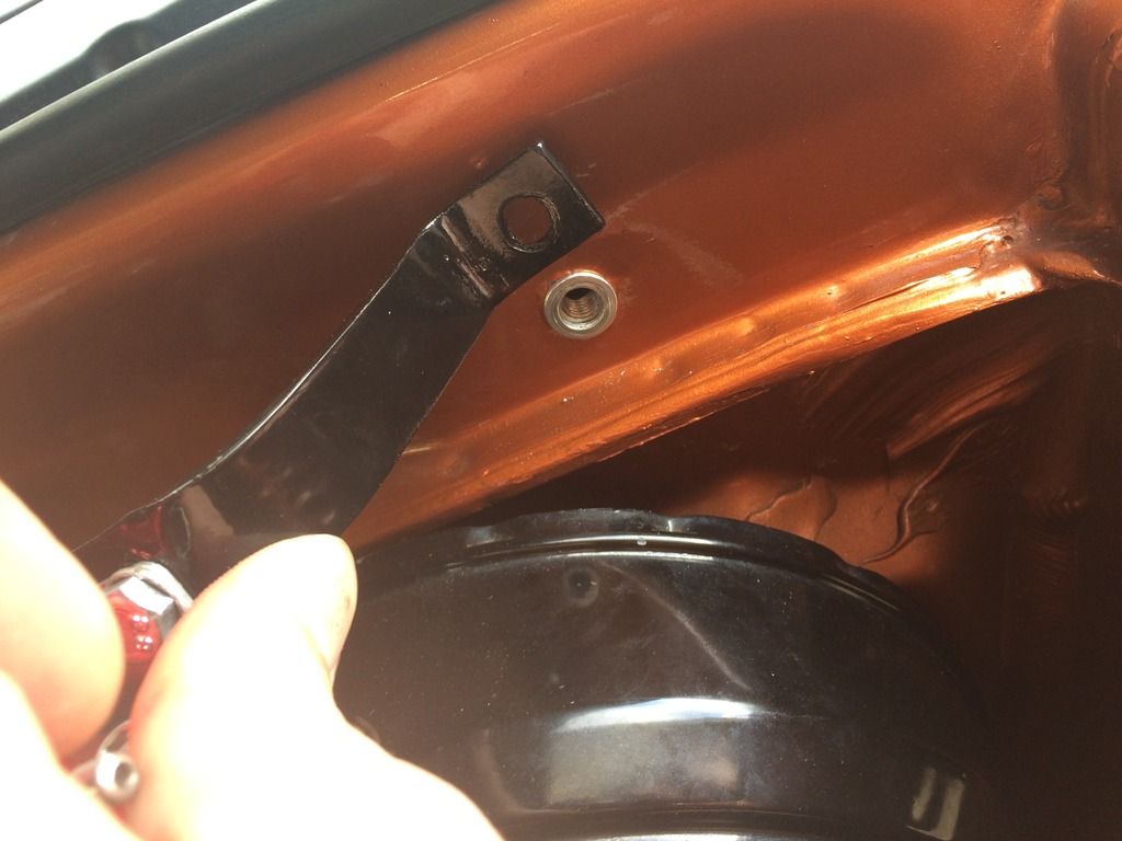

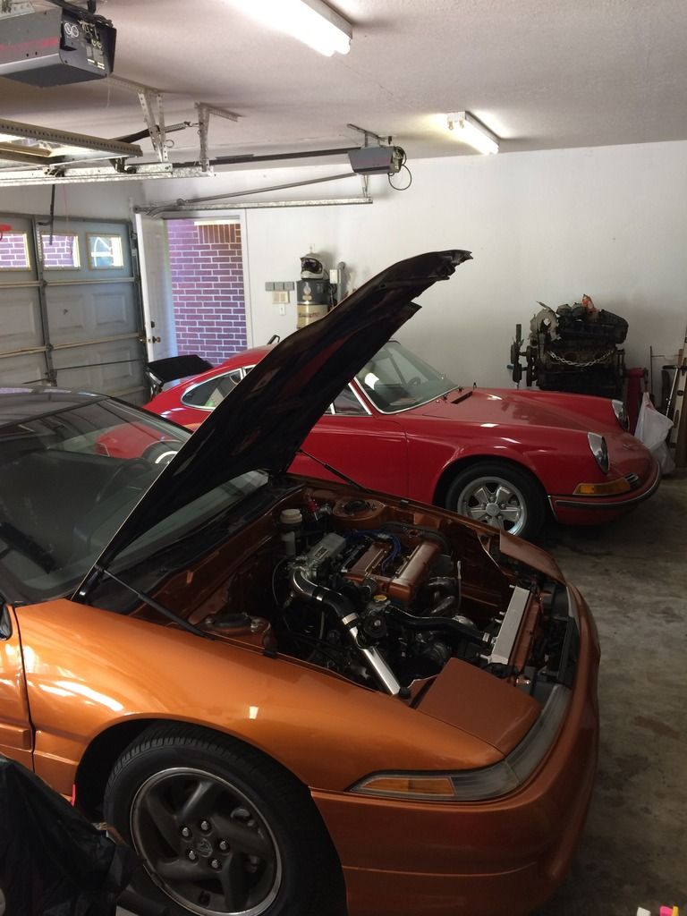

Got the afpr and return lines finished up nicely. I couldn't find a spot I liked for it that didn't clutter up the part of the firewall that looks really good, so I made a little bracket to mount it above the brake booster. It's also mounted leaning back at an angle slightly for two reasons: 1) to clear the hood, and 2) so the fuel return fitting doesn't hit the booster. It snakes around the booster and down where the factory lines used to be, all the way back to the tank.
I also figured out that nut-zerts were a thing, and they are incredibly useful, and give a pro looking mounting solution pretty much anywhere you can drill a hole.

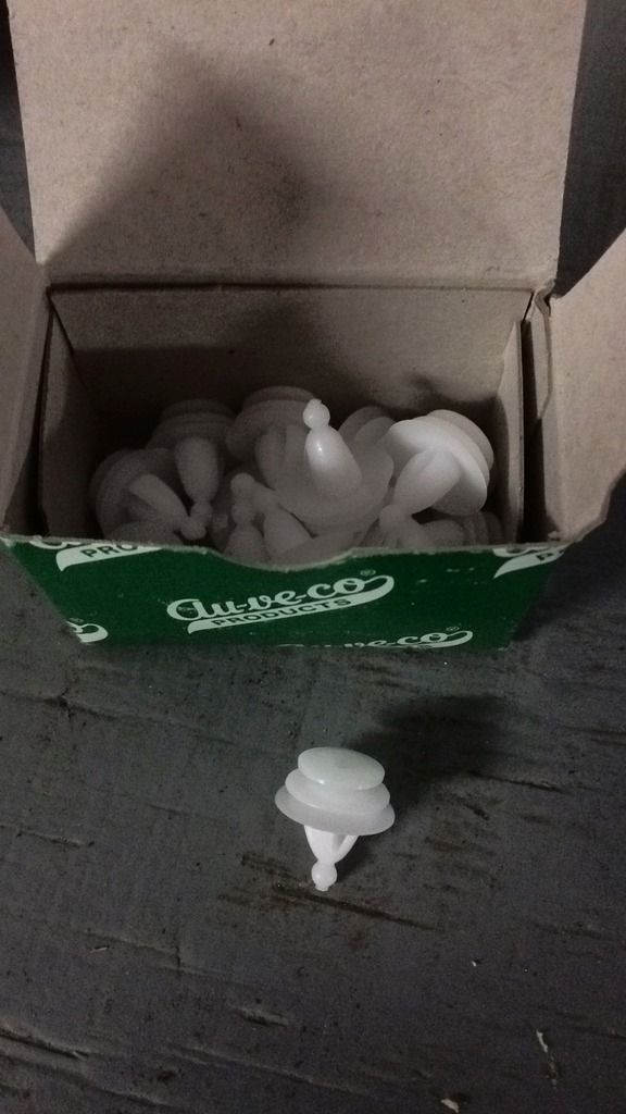

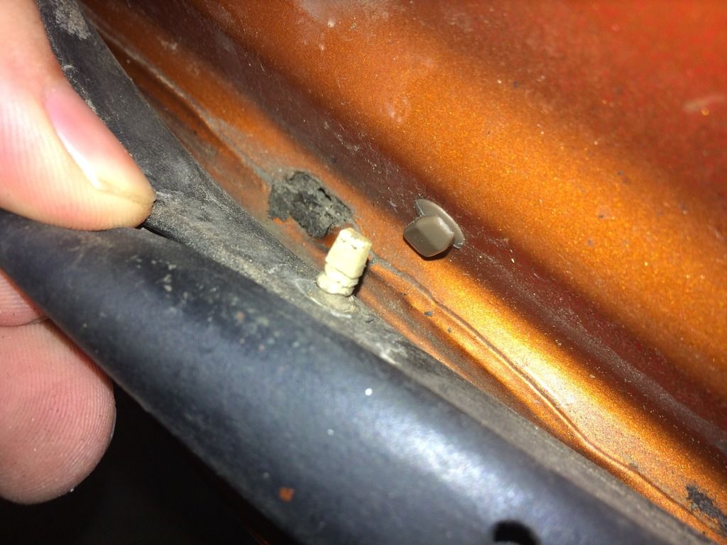

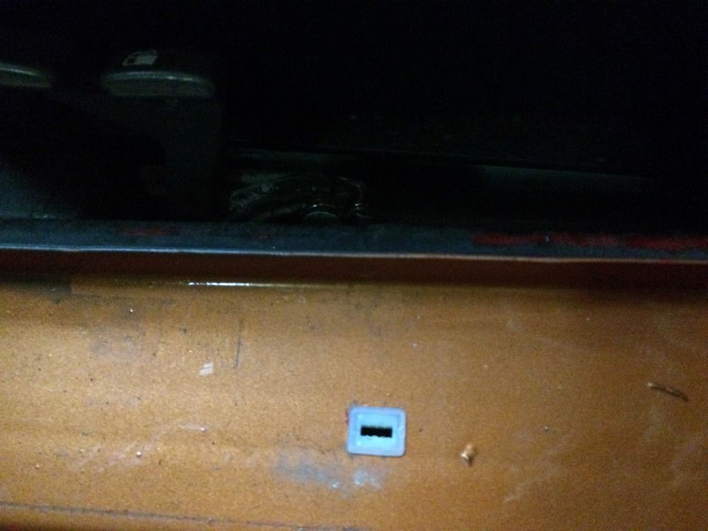

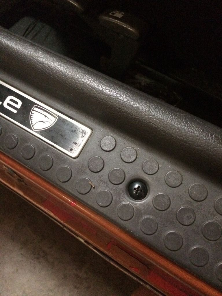

I ordered a bunch of little OEM fasteners I needed to help clean up some of the interior. I found the door weather stripping T clips, and a whole box of those little screws littered throughout the interior, plus some grommets for them. New door panel clips will be here soon as well. It's little details like this that make a really nice car.
The driver side door kick panel had the tabs broken off so I found these little inserts for them.
Good as new after a little wipe down.
These are the little T clips. The old ones didn't stay in the door anymore. The weather stripping itself has seen much better days too, but at least it stays on the door now. The new one is the dark brown one.

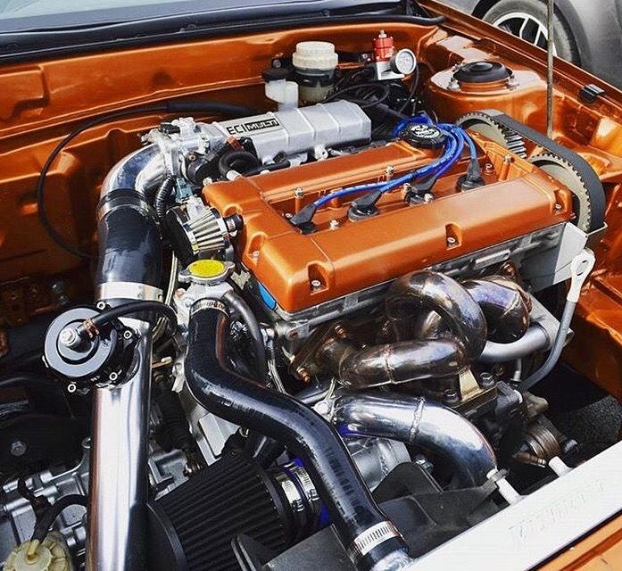

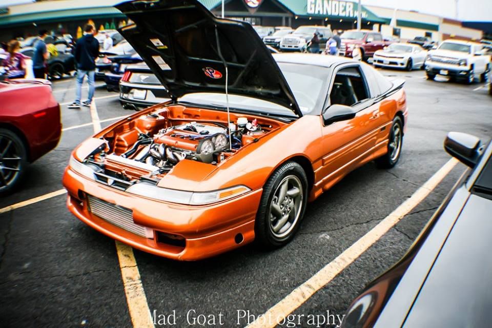

And here's some nice pictures of the car since it's been out and about. (Ignore the filter and overflow bottle for now, they're just temporary until I come up with a cleaner unit.) Next thing I need to do is get the full exhaust fixed so I can breathe inside this thing LOL

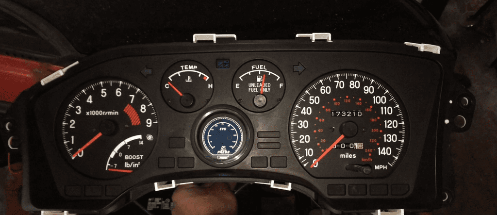

Been meaning to do this for awhile, and finally got the old turbo cluster out of storage.

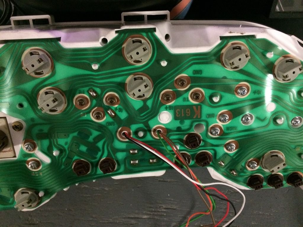

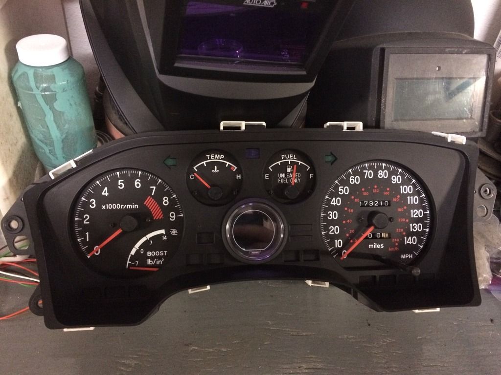

Pulled all the junk out of the oil pressure gauge socket, and used a little cut off wheel to knock out the supports for the screw holes. These screw holes came in handy for running the wires. Wasn't that hard really.. the worse part was trying to get the gauge itself centered. The little U bracket that comes with it to bolt it to a gauge pod had to be cut down and modified quite a bit, but I'm happy with how it came out.
The biggest reason for this was to not clutter up my OFH (and I don't have any more empty gauge pods). I didn't want to tee anything, which means I'd have to remove either the dummy light sensor, or the gauge sender. Remove the factory gauge and it's no longer an issue :)

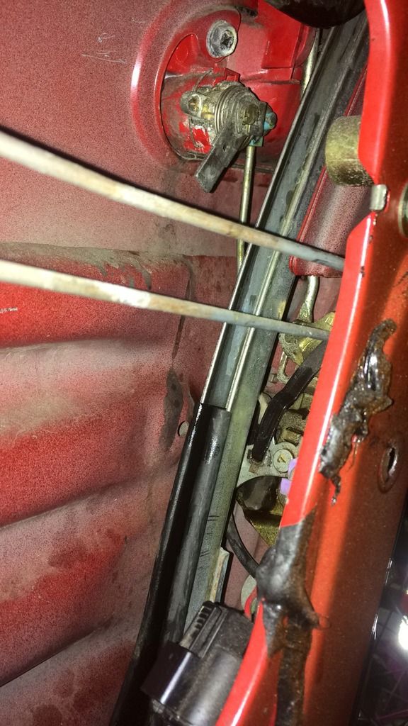

Also fixed the passenger window. When rolling it up, once it got about halfway it would seemingly get caught and rock forward putting it in a bind. Turns out the little rubber sleeve it rides in had fallen all the way down. I cleaned them up real good and lubed the crap out of both sides and the work great now. Easy fix! ..and I thought I was gonna need a regulator or something.

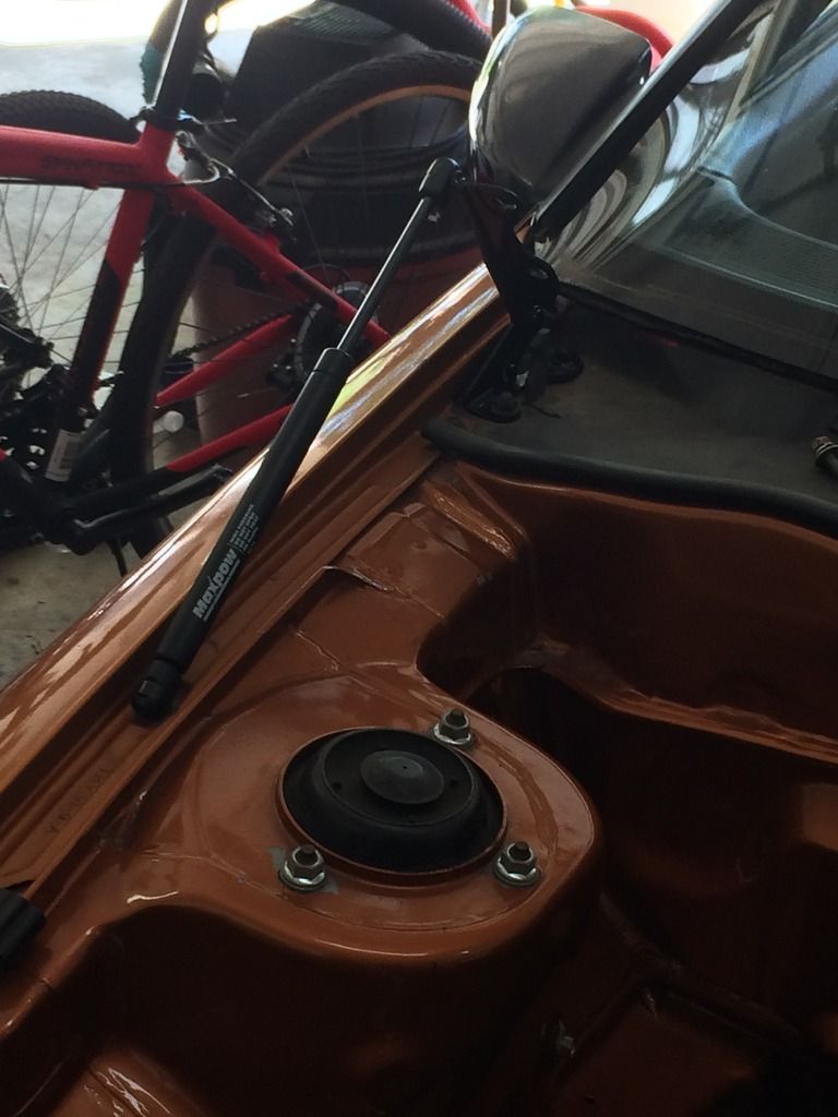

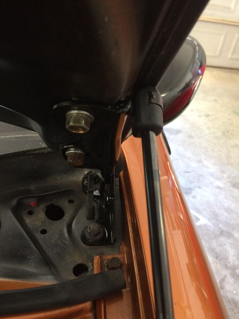

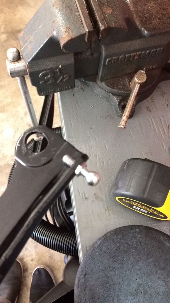

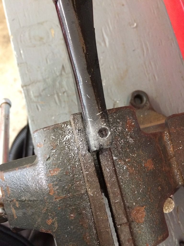

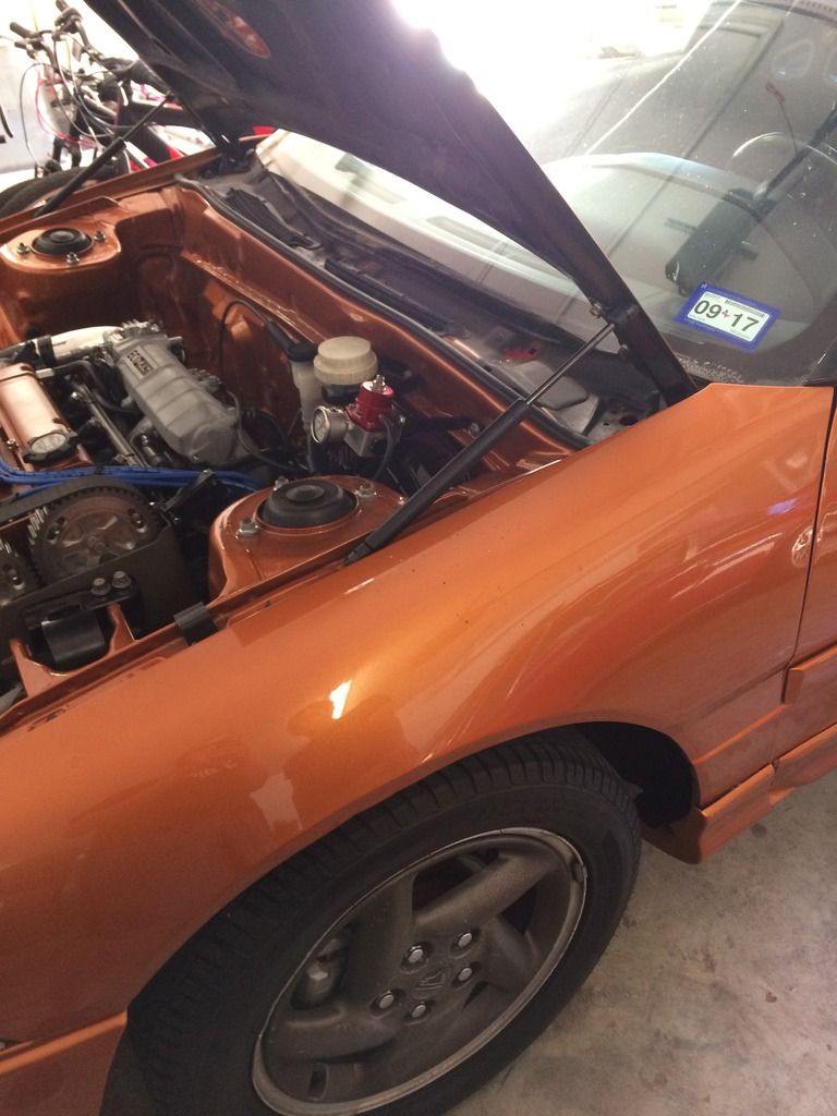

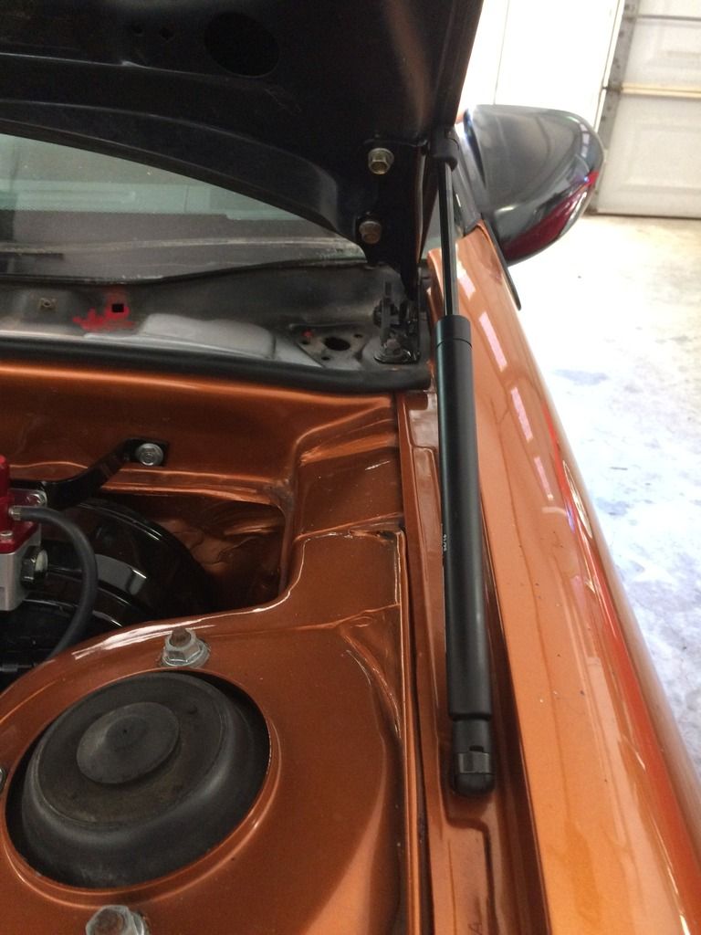

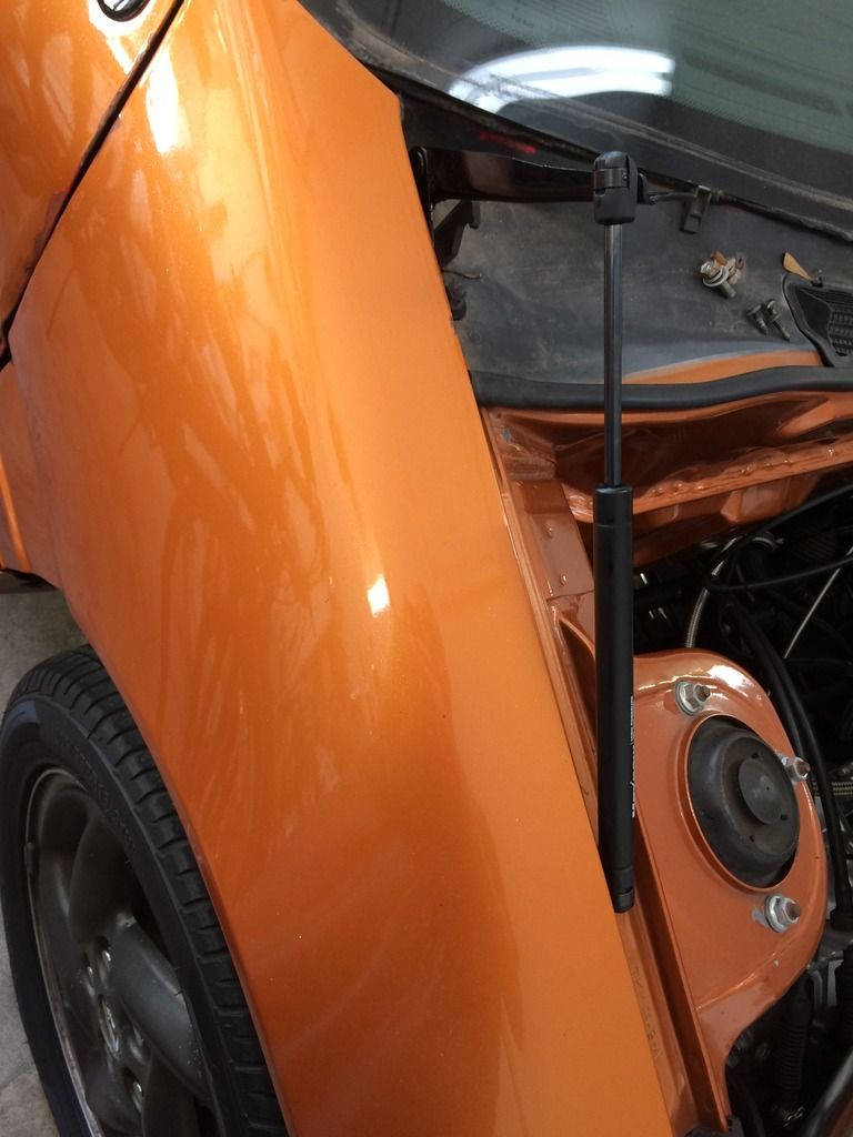

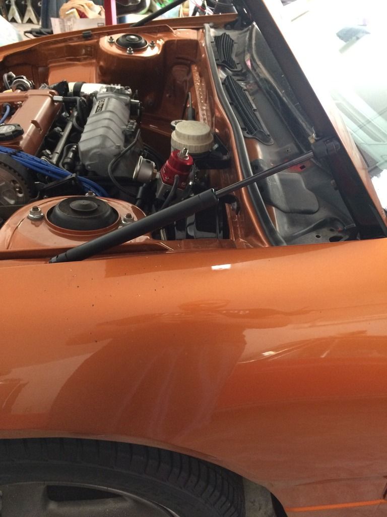

Since nobody offers a hood strut kit for our cars anymore, I decided to make my own, and for only $25.
All you will need is:
Ball studs:
https://www.amazon.com/gp/product/B00J8X4SDU/ref=oh_aui_detailpage_o03_s00?ie=UTF8&psc=1
And hood struts from an 02/03 Acura TL:
http://www.ebay.com/itm/2-xHood-Lif...03-Acura-TL-/282155488054?hash=item41b1c71336
(I'm sure the ebay listing will disappear. Just search for the Acura's struts

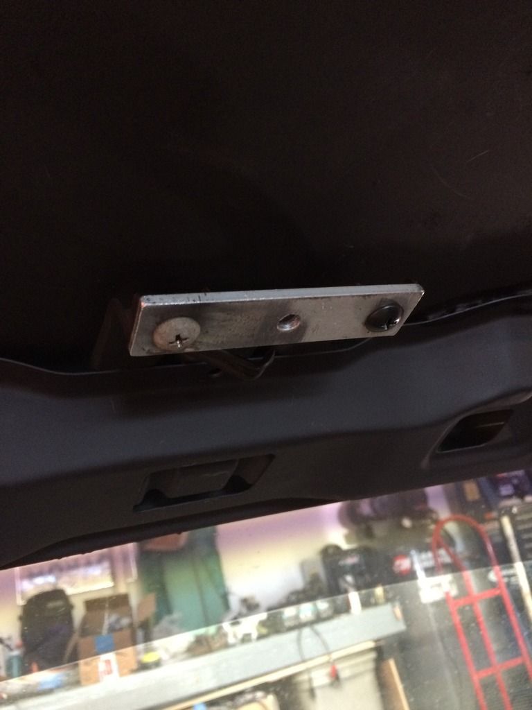

Started by taking off the hood and hinges and drill your hole.
I just happened to have a bit that was the perfect size for the stud, and the stud actually tapped itself going in.
This probably would have been just fine.. it was plenty strong. But after cutting down the stud so it wasn't so long (nearly flush), I went ahead and welded the back of it for added strength.
Replace this fender bolt with another stud.. it bolts right in.
Now just pop the struts on and you're good to go.
It's a pretty tight fit but there's really no way to mess it up. The ball end is just short enough to clear the fender with the strut attached.

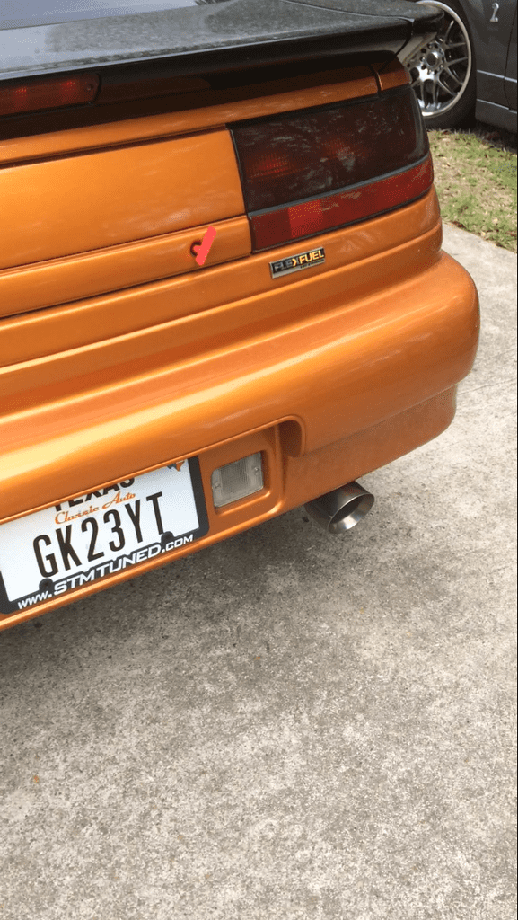

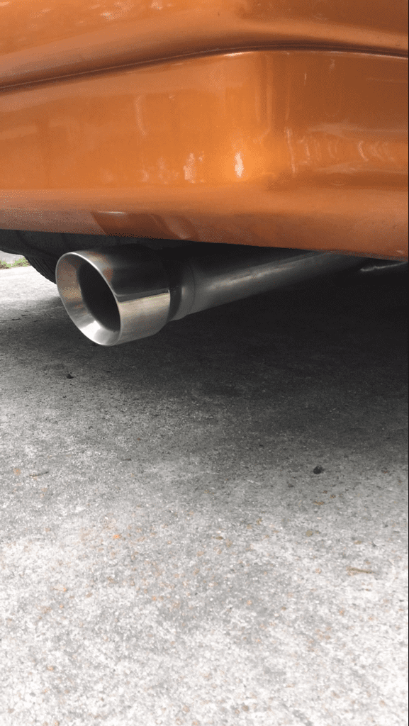

Got a full exhaust made up for the car, nothing special.. just 3" pipe from the down pipe back with a neat little tip I found for like $10 on summit. Looks great, sounds great, and doesn't rattle my skull anymore..

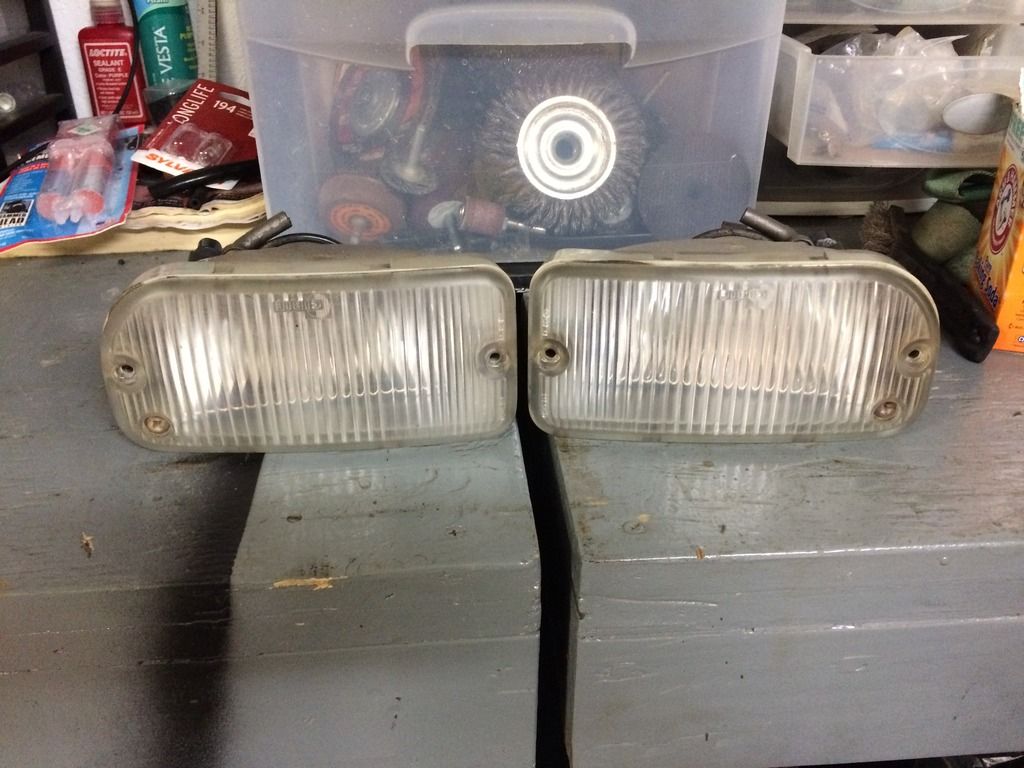

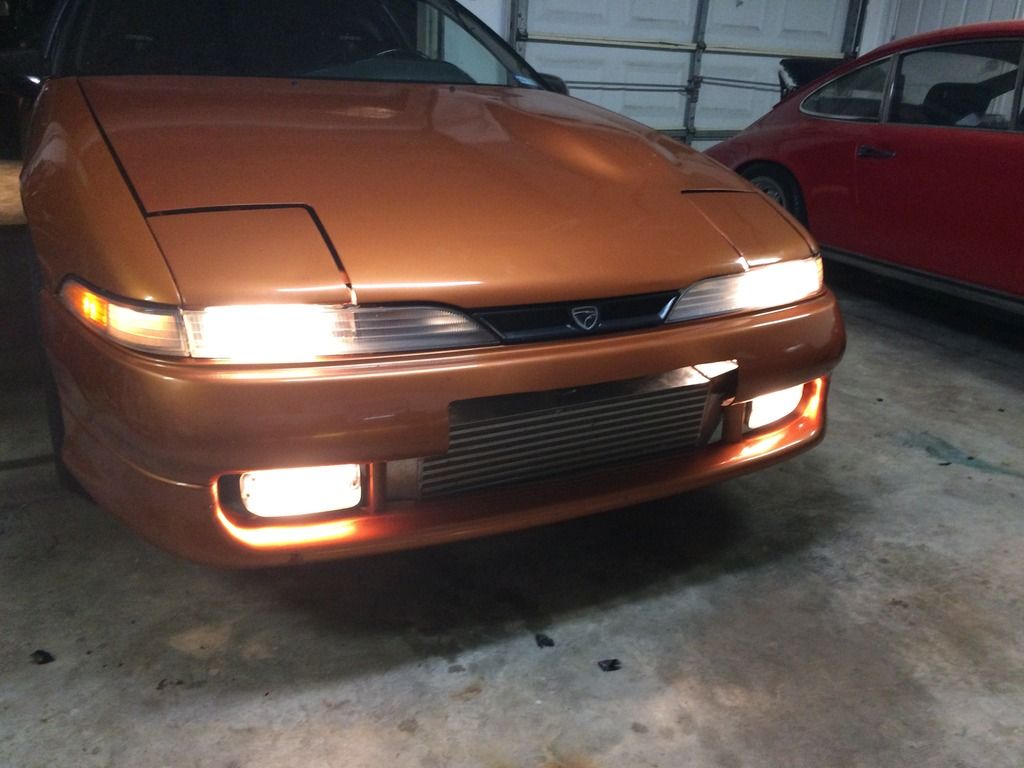

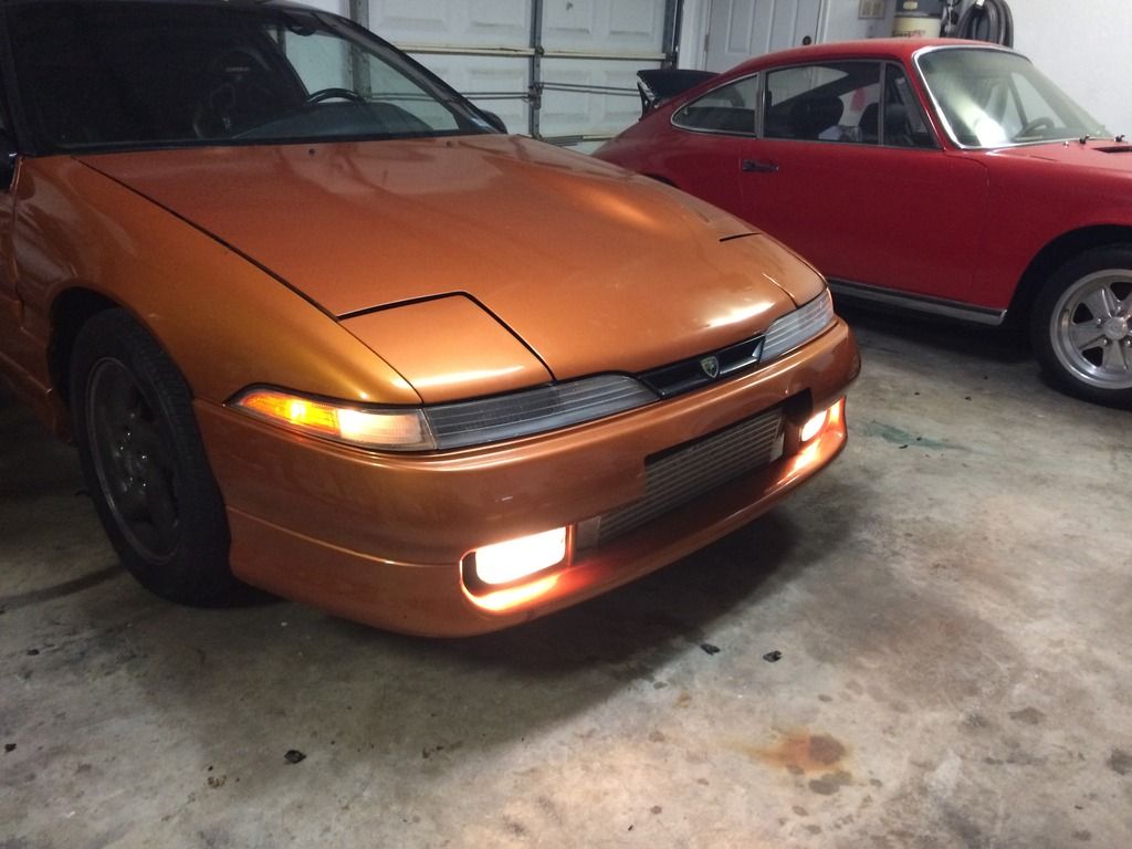

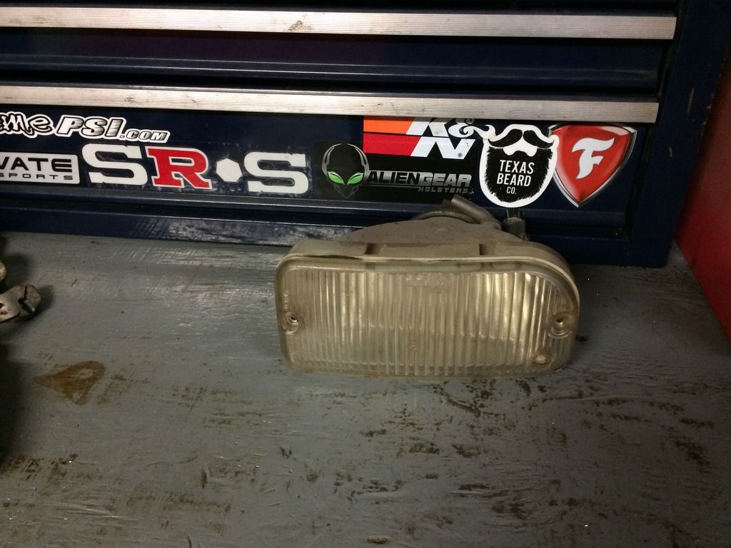

Found a nice set of foglights to cover up the holes. You could see the frame and everything without them so I figured I'd find a set and wire em up. This was what they looked like when I got them and after I cleaned them up. Didn't get as clear as I would have liked.. I think if I pop them open and clean the inside out too they would look even better.

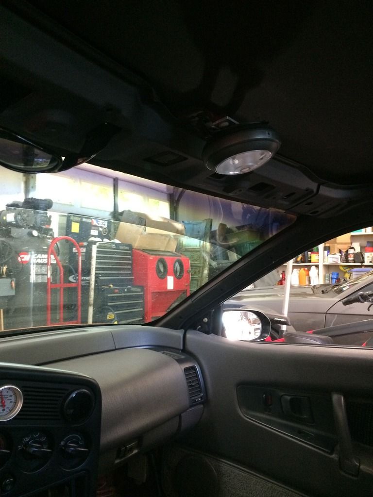

Had to fab a little bracket to mount my dome light. I tried some magnetic strips but the sun melted the adhesive the first day it was on LOL.

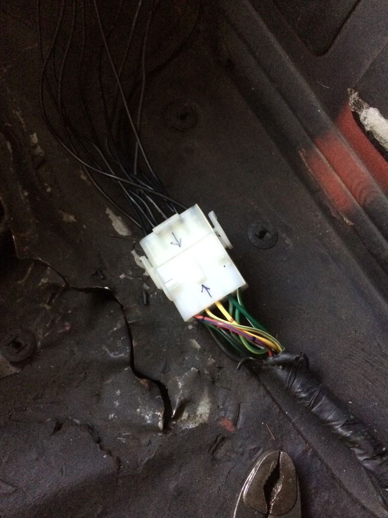

Finally got around to re doing some of the wiring in the rear. No more temporary bullet connectors

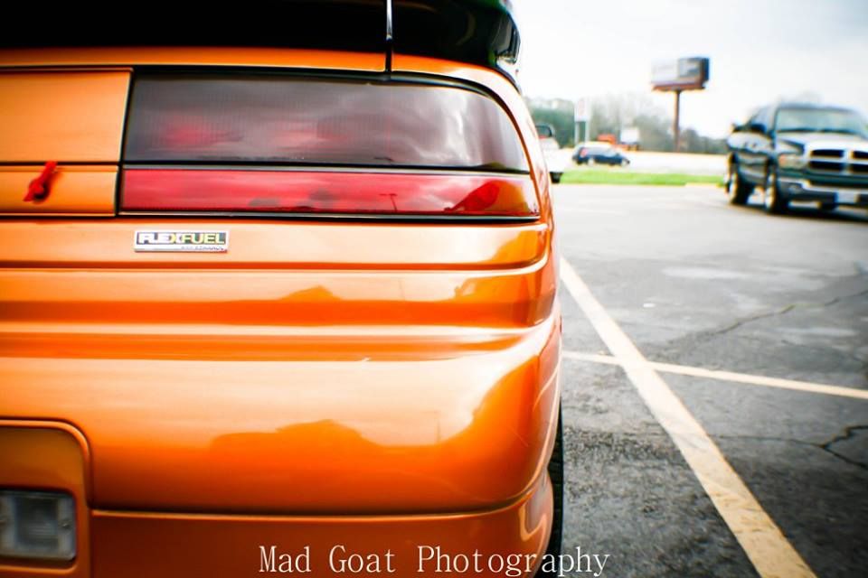

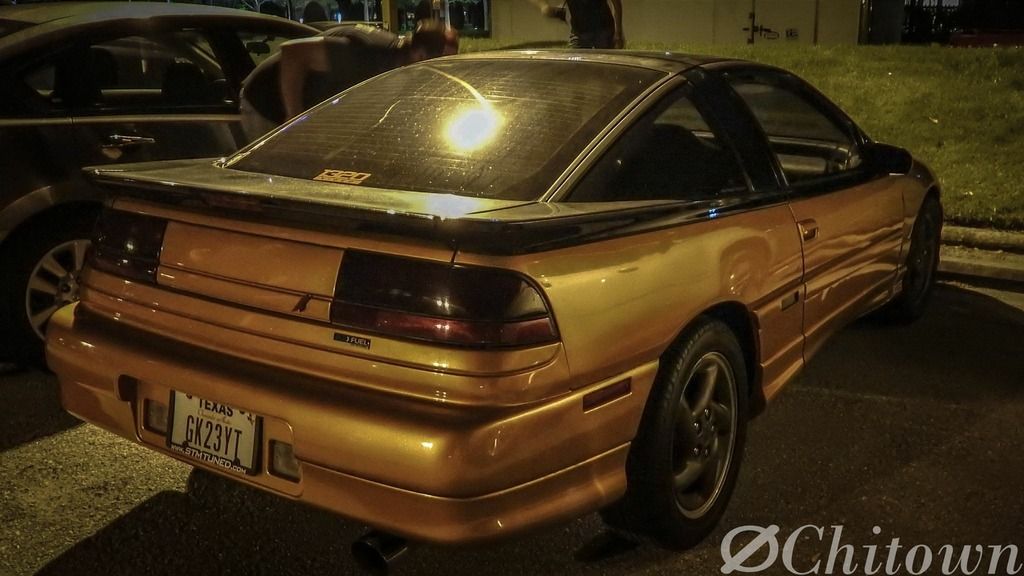

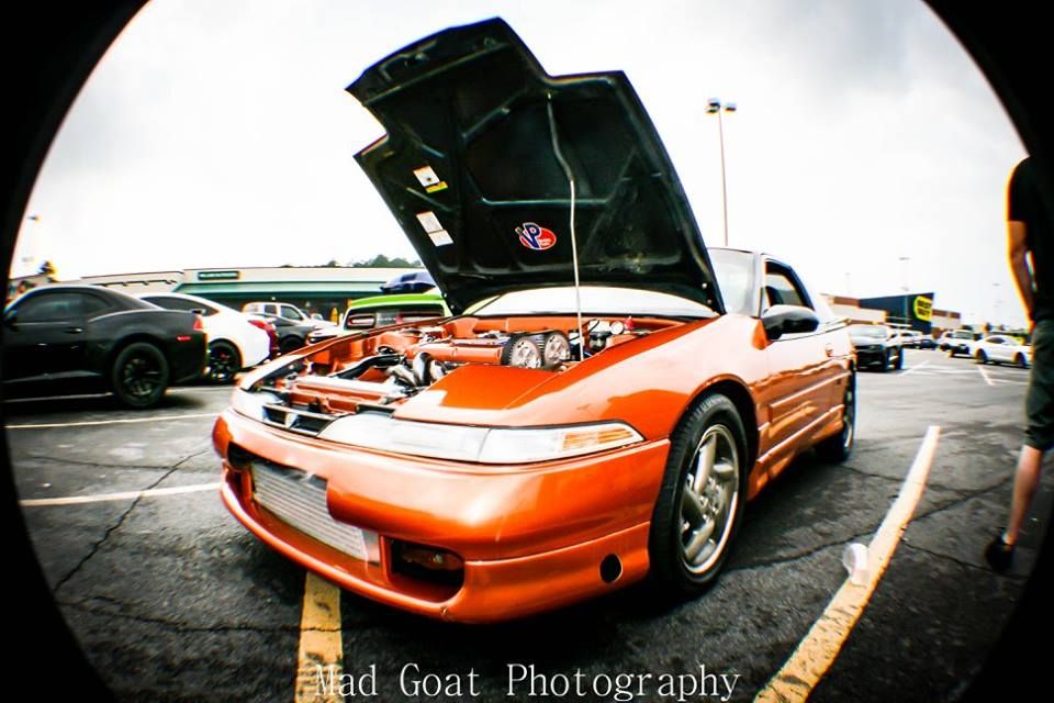

And lastly just to brag a little bit, some friends talked me into bringing the car to TX2k17, so I went for it, and it didn't give me a SINGLE problem. There was maybe 80 miles on the motor, and I drove it 340 miles all to/around Houston and back to Orange. Drove x4 the miles that were on the motor in one trip haha.
The car (even more so Jake's 1g) got crazy attention from all kinds of people. Seems like everyone used to have a dsm back in the day and misses it like crazy.

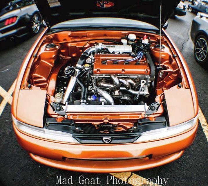

Found some pictures that Tuners member Sleeper1ga took and posted to the forums.
