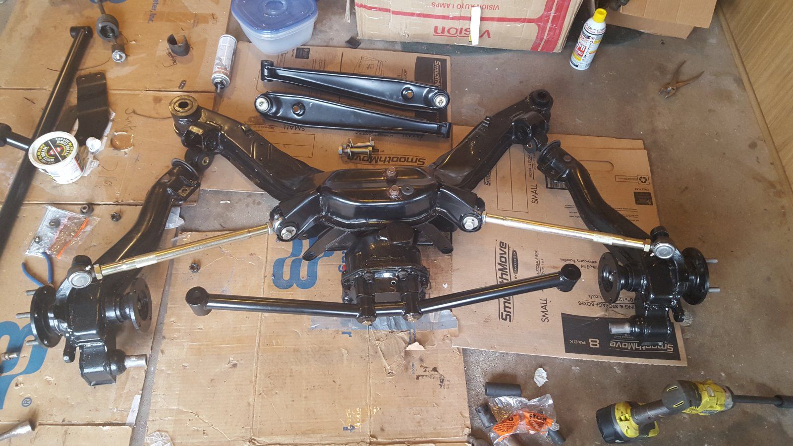

Here's the front subframe back from the powder coater! It's a semi gloss black. Finish is super durable and looks great. Just to ask you guys think I should stick with this color or run a more flat black color for everything? Just kinda wondering.

Well I got the Subframe back together and just got it in the car. I also POR15 the whole bottom are where it mounts in. This is basically a paint that prevents any rust, not that the car is rusty but I figured I'd get it done while it was out :)

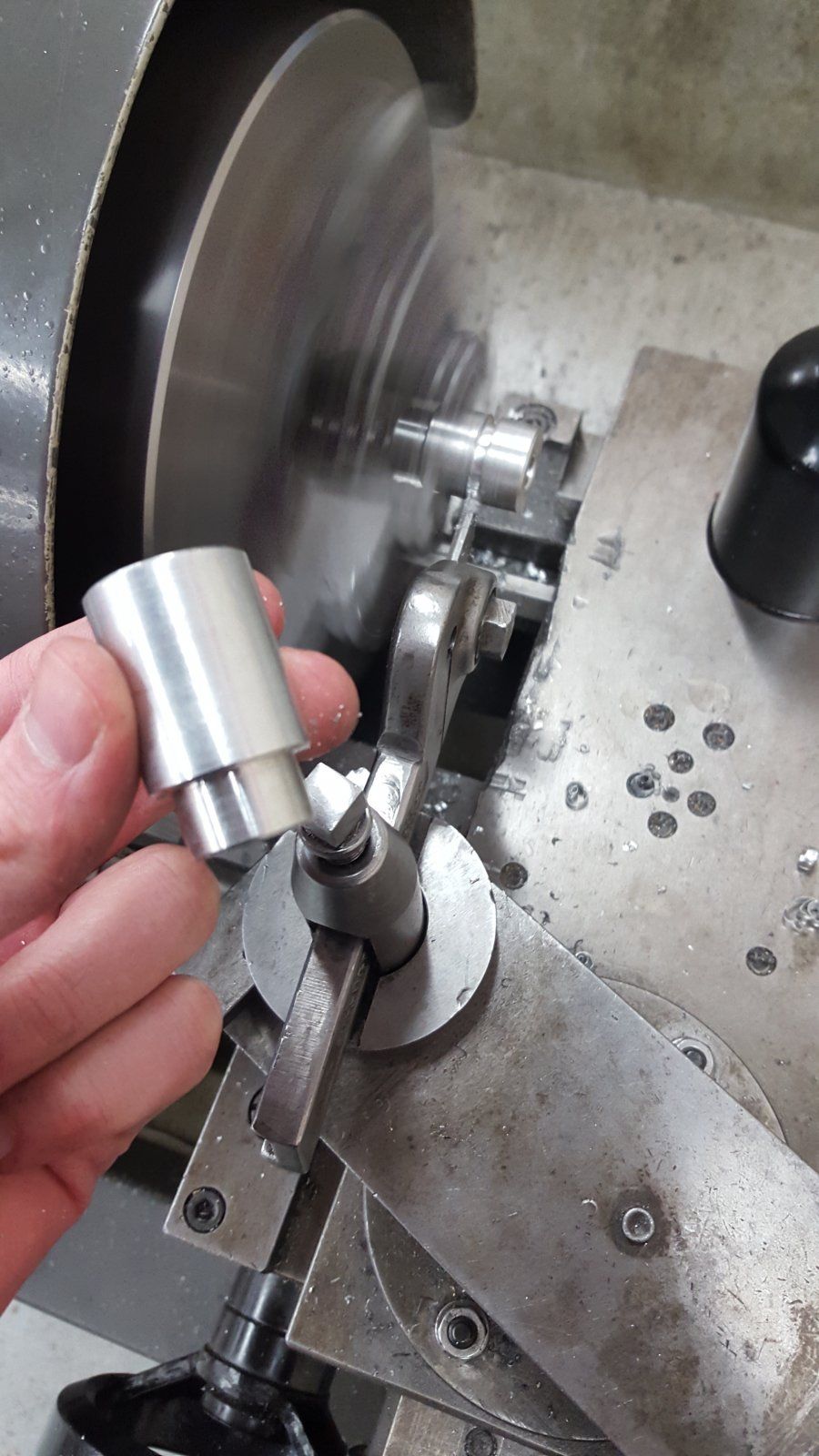

I also had to do quite a bit of machine work on a lathe to get the upper control arms to fit. Took over half of them off!

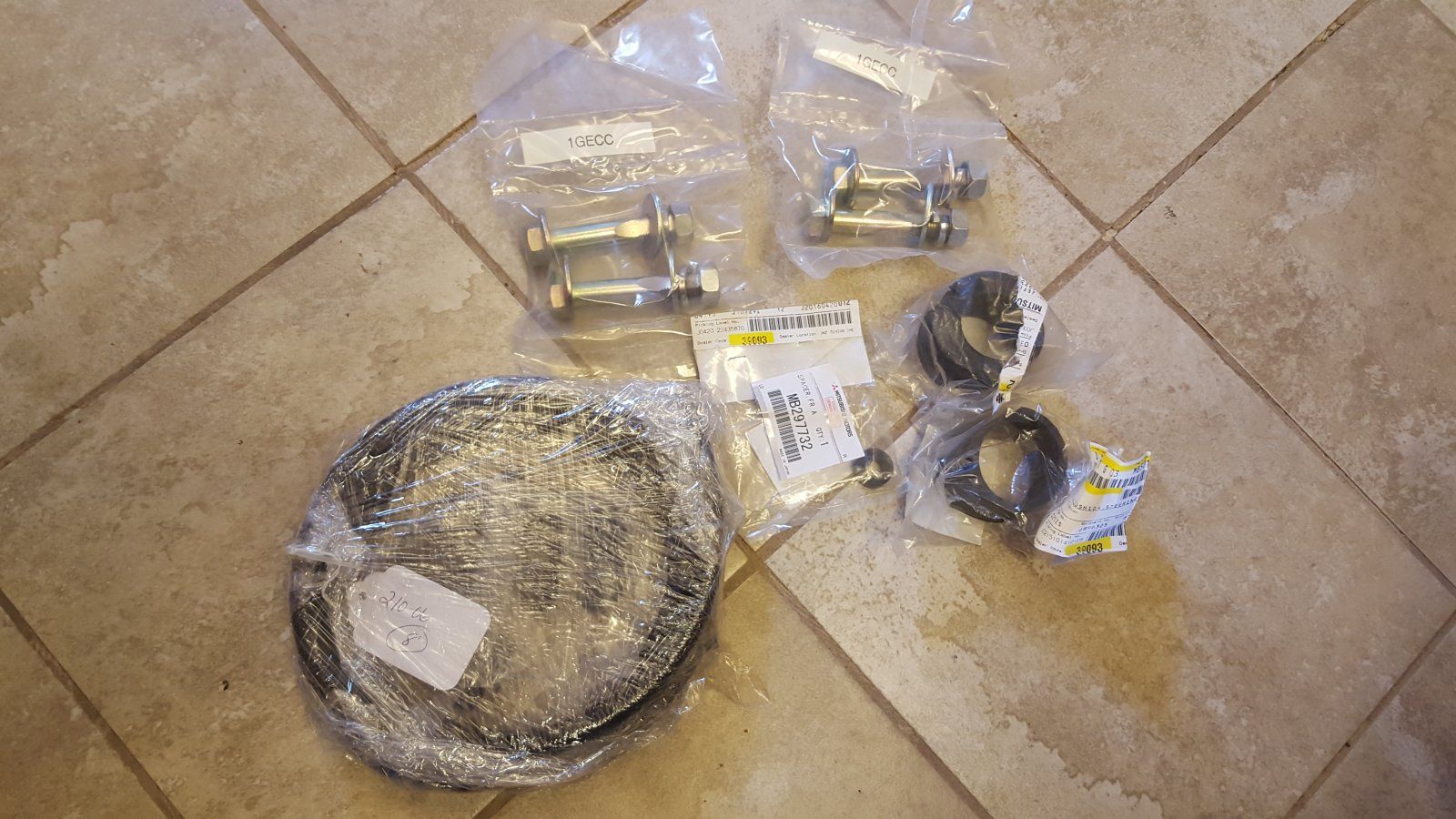

Also picked up new asentric bolts from JNZ as well as a transmission cooler cooler kit. I'll show how I mounted this guy later on!

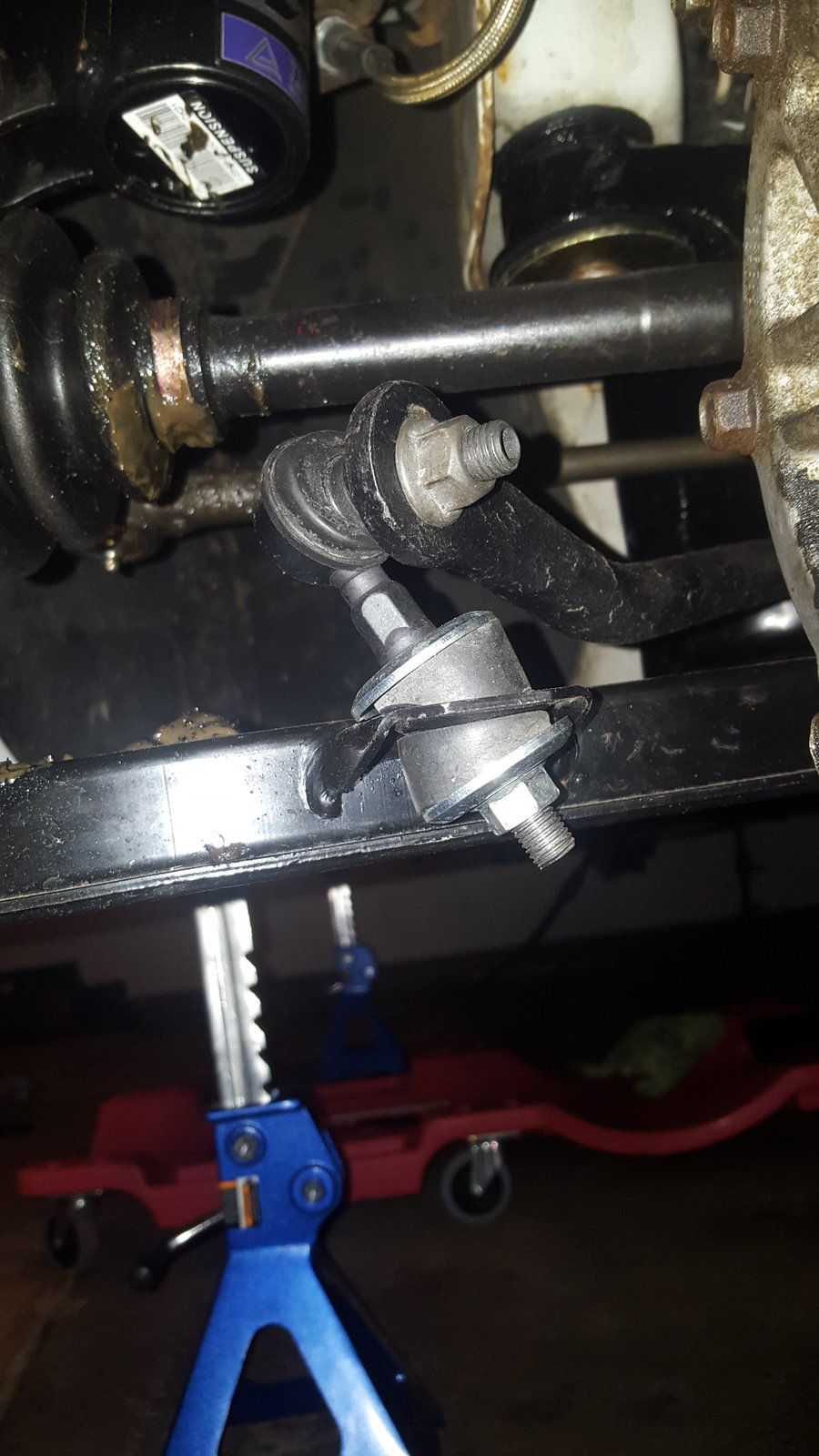

So I ran into a couple of complete nightmares along the way of getting it back together. I have a car show I wanted to be at this upcoming weekend so I have been working day and night without taking breaks to do anything else pretty much. The original sway bar links wouldn't work with the new Moog arms, or work with the 1.8l style OEM rubber bushing type sway bar link. I found out Moog made a special replacement part for this though and got it overnight shipped to myself.

Nice build. Do you happen to have any pics of the front sway bar link set up with those new arms?
Yes man sorry for being so inactive lately. I had a death in the family and have been kinda devastated and not messing with the car for a week or two....
I'm not actually 100% positive If I used the correct part here but it's what Moog told me to do. I actually had a big hassle once I noticed that the arms were different.

Car is looking awesome. Was the swaybar end link just on the wrong side? I went with moog and had no issues
You mean as in the swaybar flipped upside down? Just curious.
Forgot what I did but I ended up resolving it. I think I possibly got parts for a 1.8 originally? Or I flipped the swaybar was awhile ago!
Not that the sway bar was upside down just that the endlink was flipped from the outside rather than the inside of the swat bar.... Either way sounds like you have it sorted and the car is looking awesome man!!!
