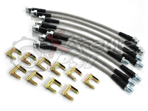

Ultimately the caliper choice came down to what would work with my existing 1g SS brake lines. These are the lines I already had installed:
Since 1gb "big brake" calipers are NLA, I opted to purchase reman 3kgt base model front dual piston calipers with brackets. These do not take a banjo fitting like the 2g calipers do. I found them at Summit Racing but RockAuto has them too. I also bought pads and rotors for a 93-94 turbo DSM. Everything just barely fit - rotors under the dust shields and calipers under a stock-size 16" rims.
