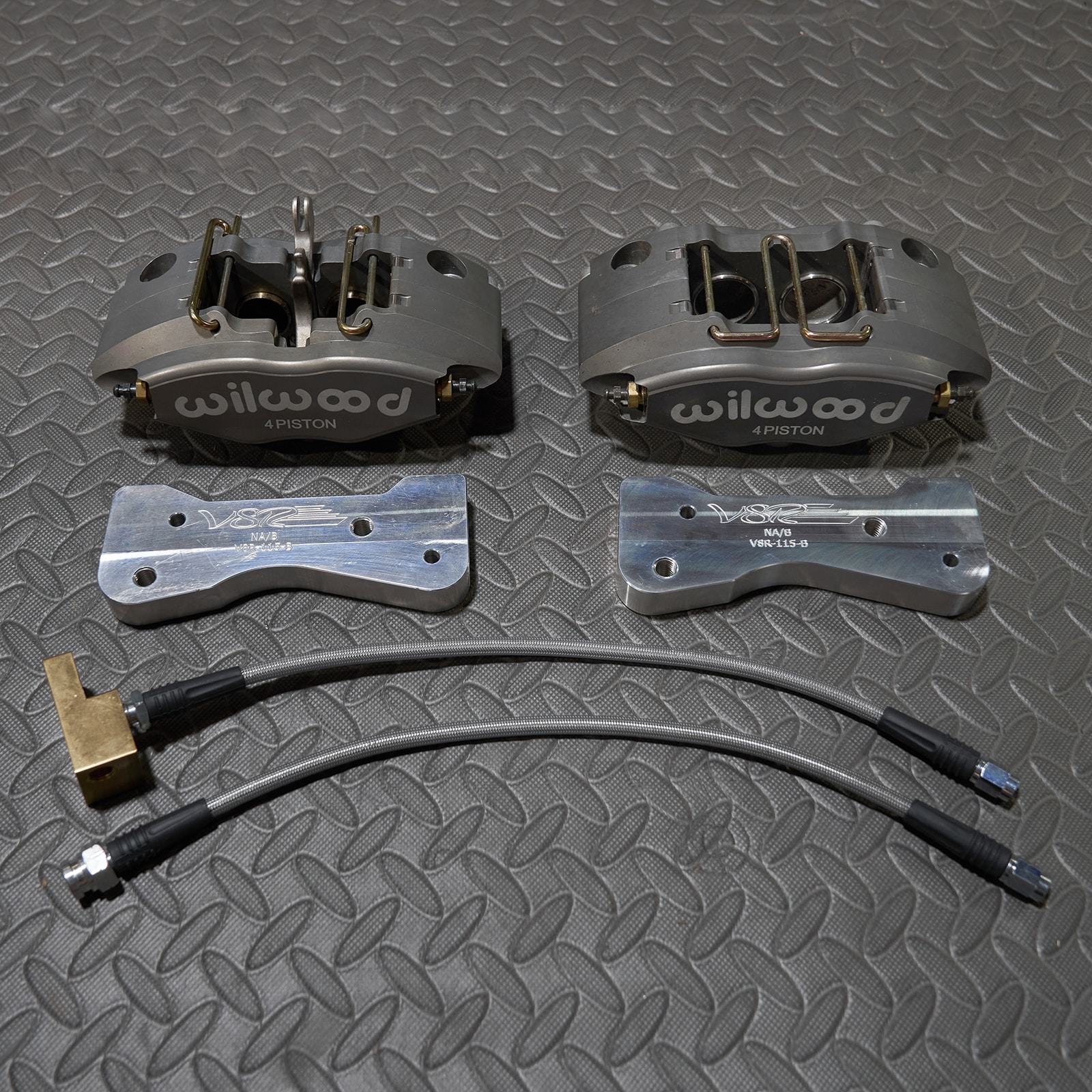

Flyin miata has one that uses a wilwood powerlite in an interesting way for the Miata. It's not enough to lock to drift LOL. But it will hold up an incline.

If you're still looking for a way to do a parking brake on a 1g. I've stated before both flyin miata, and also v8roadsters for the Miata use a wilwood. I believe they also use this caliper on some datsun conversions.
