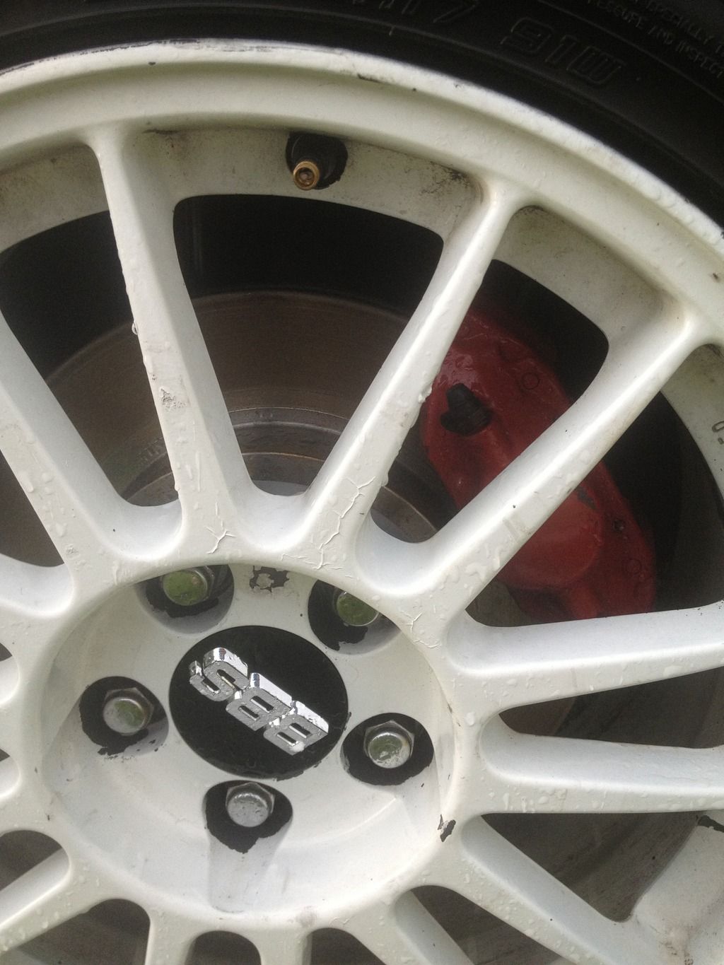

I also needed rear brakes pretty bad. I went out and bought rear evo brembo's and rotors which I installed today. (Yes, I will be redoing my wheels sometime this year)

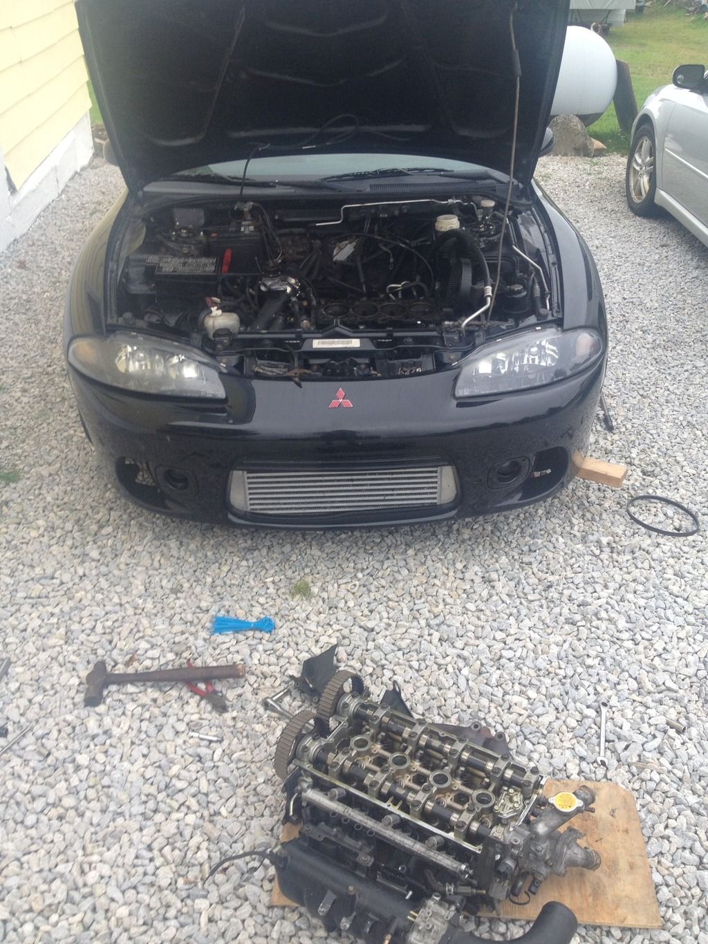

This morning I swapped out spark plugs for new BPR7ES and it cleared up and I was able to turn the boost back up while watching my a/f ratios. I parked the car for a few hours and when I got into it to move it I started to get a very loud tic from the middle of the upper head. I took the valve cover off and everything seemed to be working properly. Took the plugs back out and rotated the motor by hand and it was spinning freely. That's a huge relief so I did some research and it looks to be a lifter going bad. I ordered 3G lifters and hopefully this will go away. Should be here this week but I probably won't be able to get to it for another two weeks because I'm going on vacation.

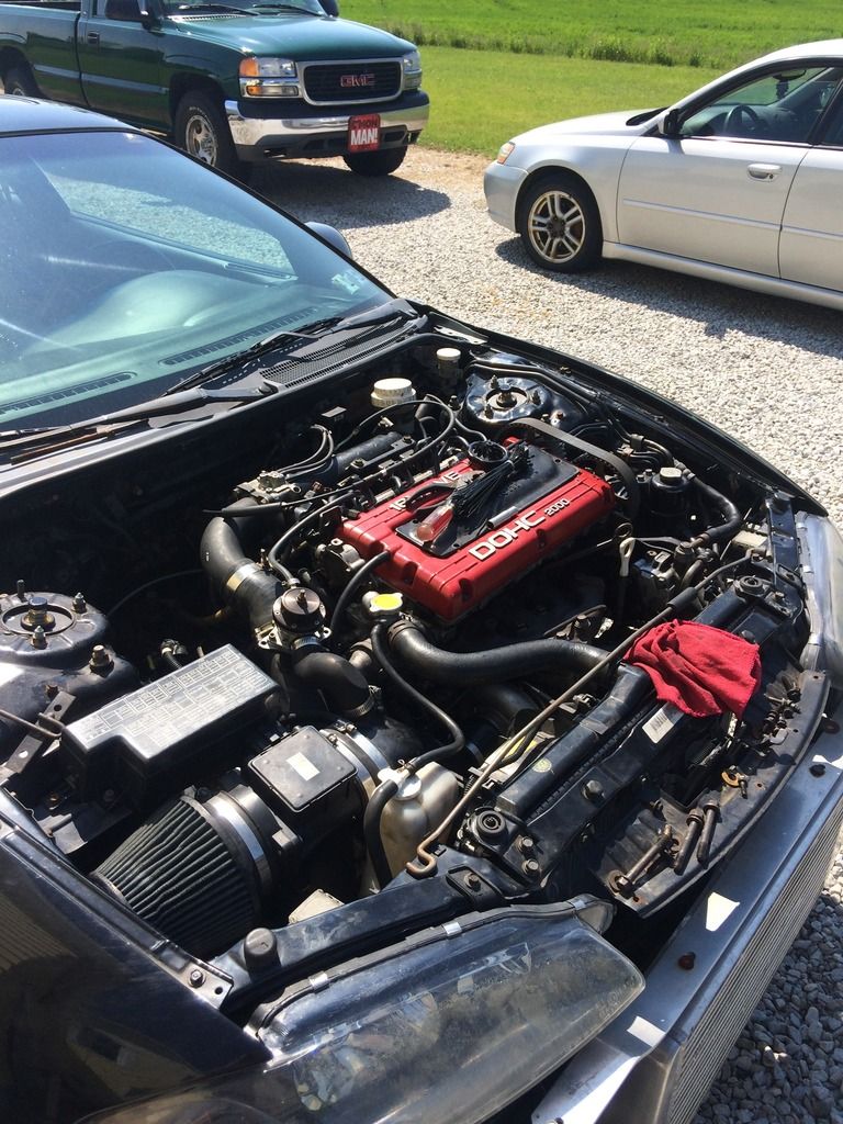

Here's a few pictures from the event.

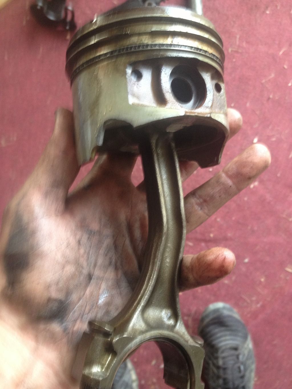

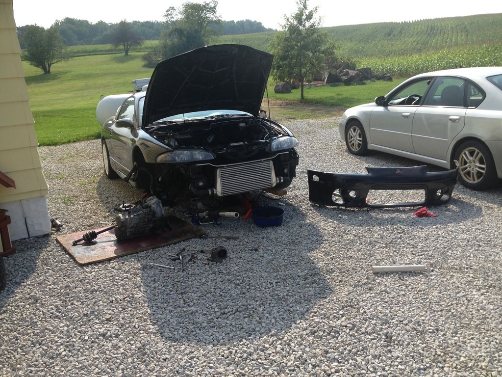

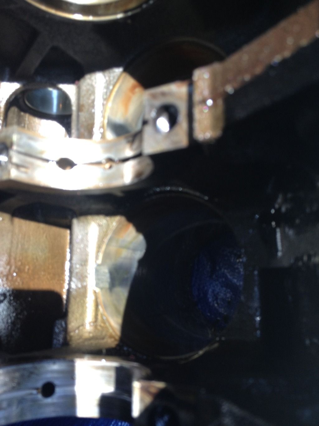

So I have a said, but at the same time exciting update. A few months ago I decided to swap the 20g on to the DSM. The swap was the biggest PITA because everything went wrong. Bolts snapped or stripped and leaks from everywhere. After I sorted everything out, I took the car for a test drive to see how the setup was working. I got into boost and in a split second I seen my boost gauge hit 30+ psi and I let off instantly. As soon I lifted I herd a pinging noise that came from the motor. Went home and did a compression test and cylinder 4 was very low. I figured I bent a valve so I took the head off to assess the damage.

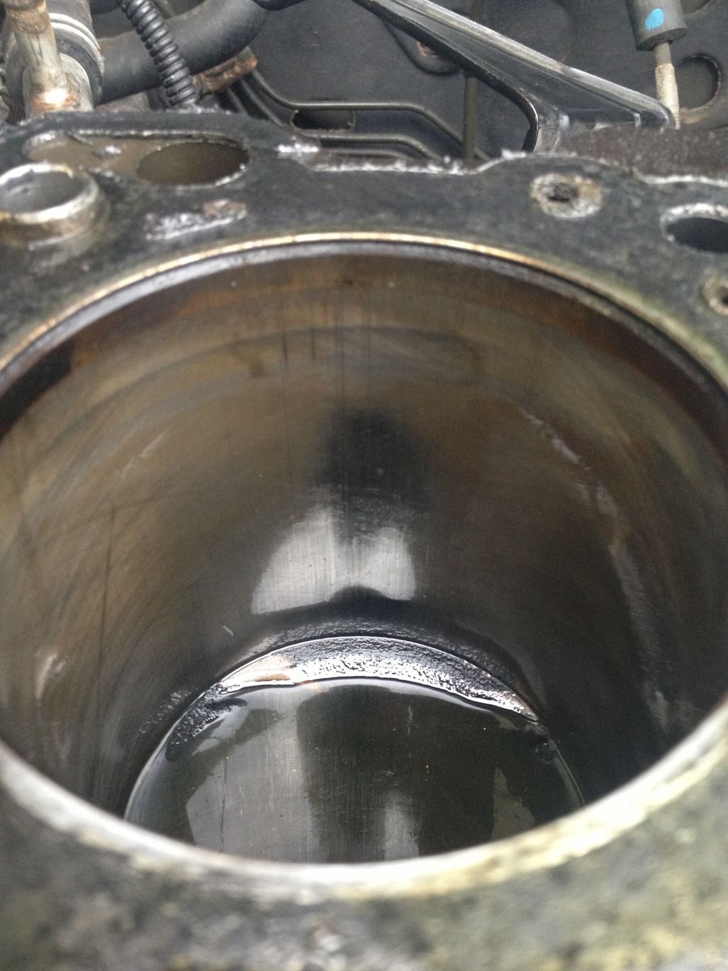

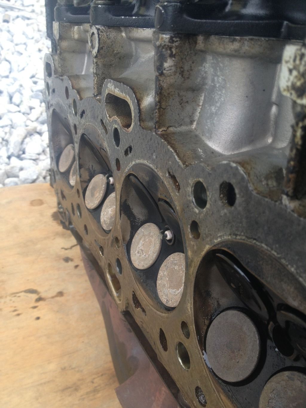

After realizing my valves were good, I realized there was something wrong with the bottom end. I thought it was blown piston rings because of skratches on the cylinder wall.
Decided to pull everything to tear the block apart and this is what I found.

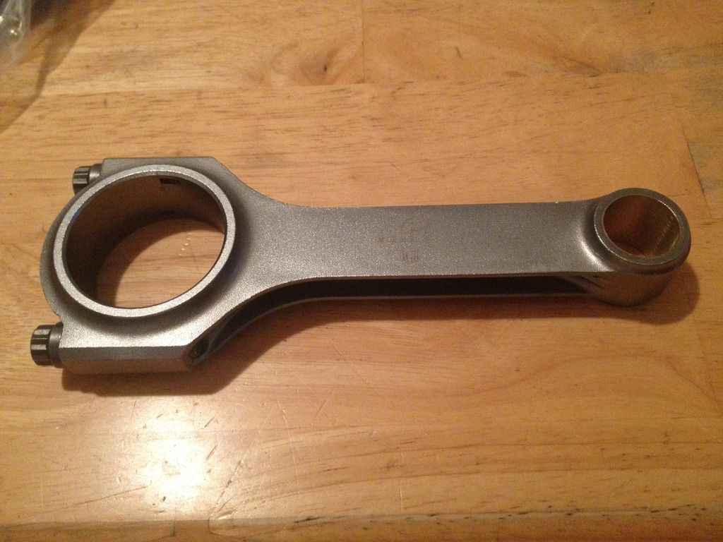

Here's a picture from where the rod hit the block.

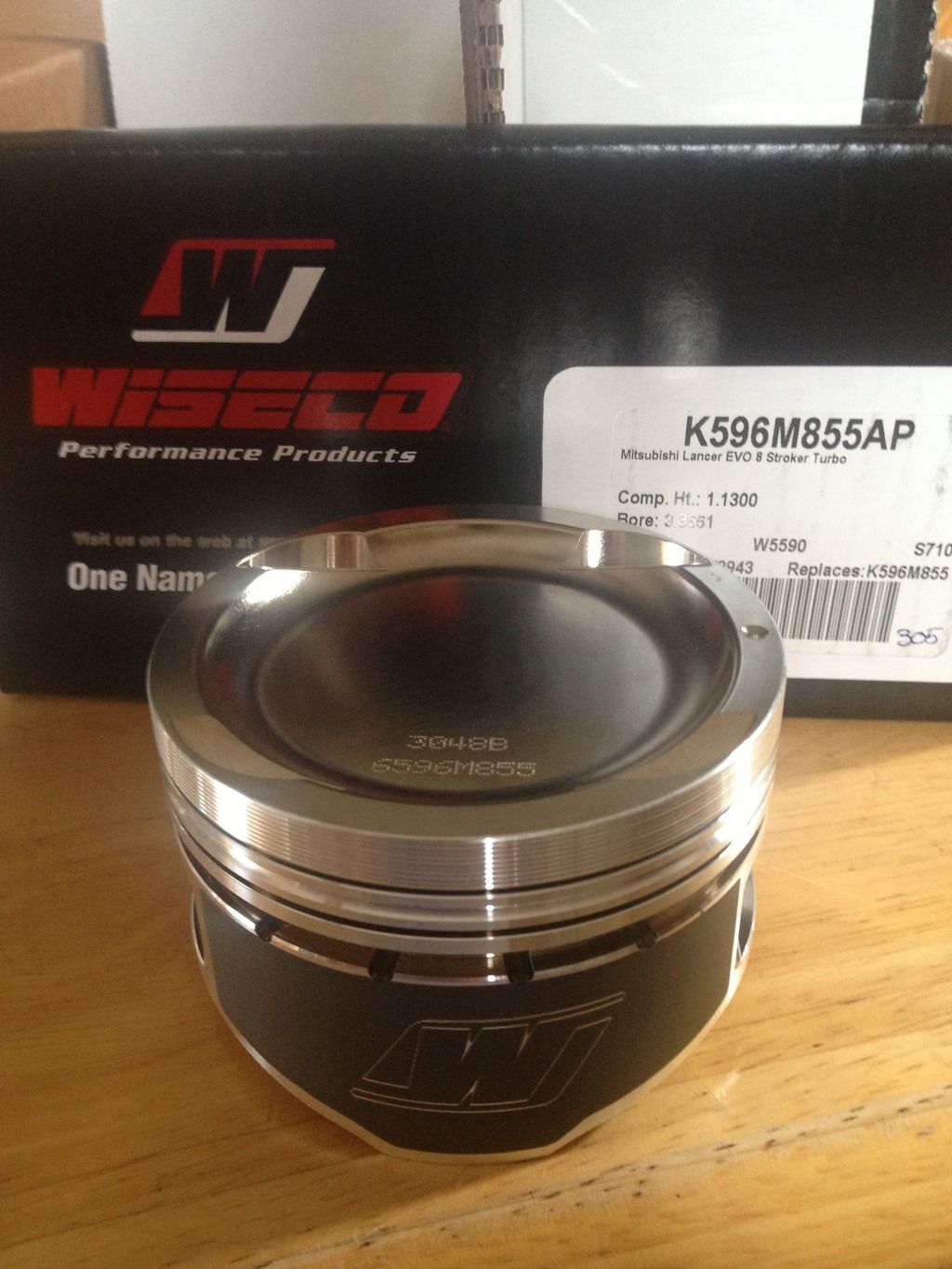

So after realizing I'm gonna have to put more money into this then what I wanted, I decided to go all out and try to produce a a torque monster for a very fun street setup and autox car (might be a little much for autox but screw it). The parts are all ordered for my 2.3 stroker motor. The block was decked and bored over .02 and I'm picking that up tomorrow morning after work. Crank should be here soon and waiting on bearing from them being on back order. I went with wiseco 9.0:1 stroker pistons and eagle rods.

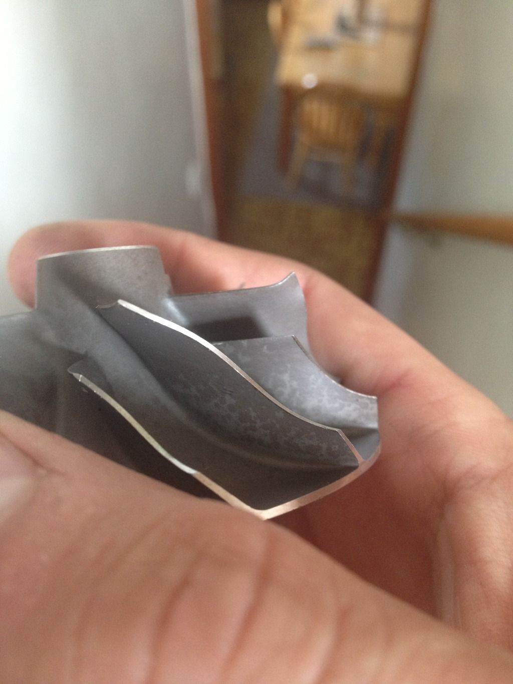

On a whim I decided to check out my turbo just in case and what I found really upset me. The new compressor hit the housing and bent some blades and screwed the compressor housing up.

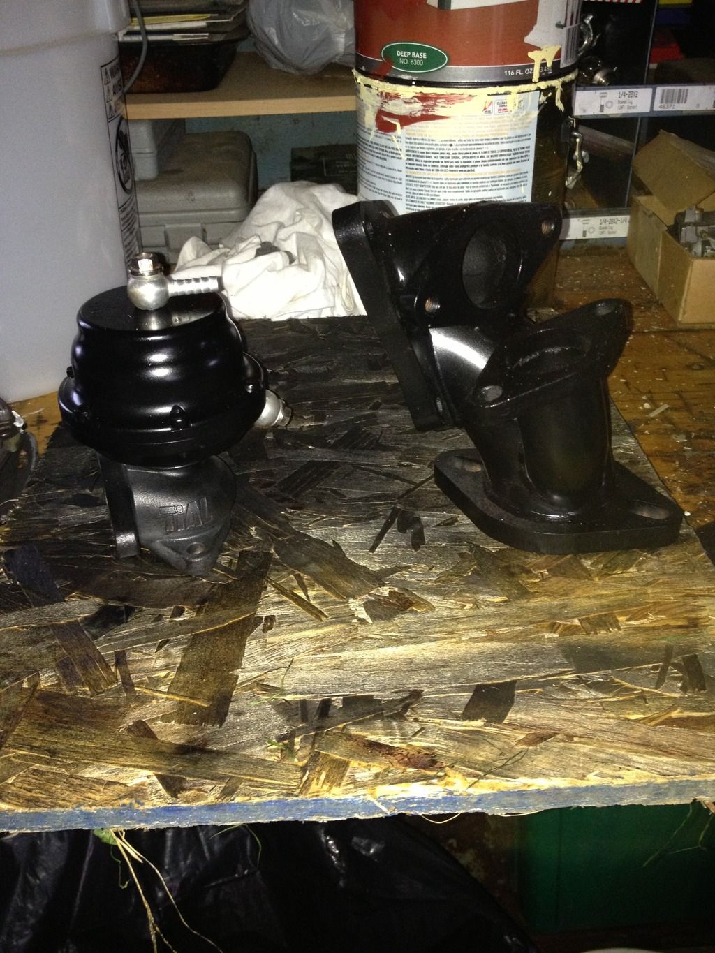

After seeing this I said screw it, lets do some more research and have decided I'm gonna go with a TD06H turbine wheel in a 6cm Hotside. From what I've read this turbo works extreamly well on a 2.0 and spools around 3200. Everyone that has ran one that I've talked to say its their favorite 20g that they have run. Also herd that on a 2.3, it produces A LOT of torque and that's my end goal and this thing will spool like a t25 but with a lot more power. Also decided to go external wastegate and picked one up. The previous owner didnt know what spring was in it so ill have to find out that but I painted it and I have to say it looks very good.

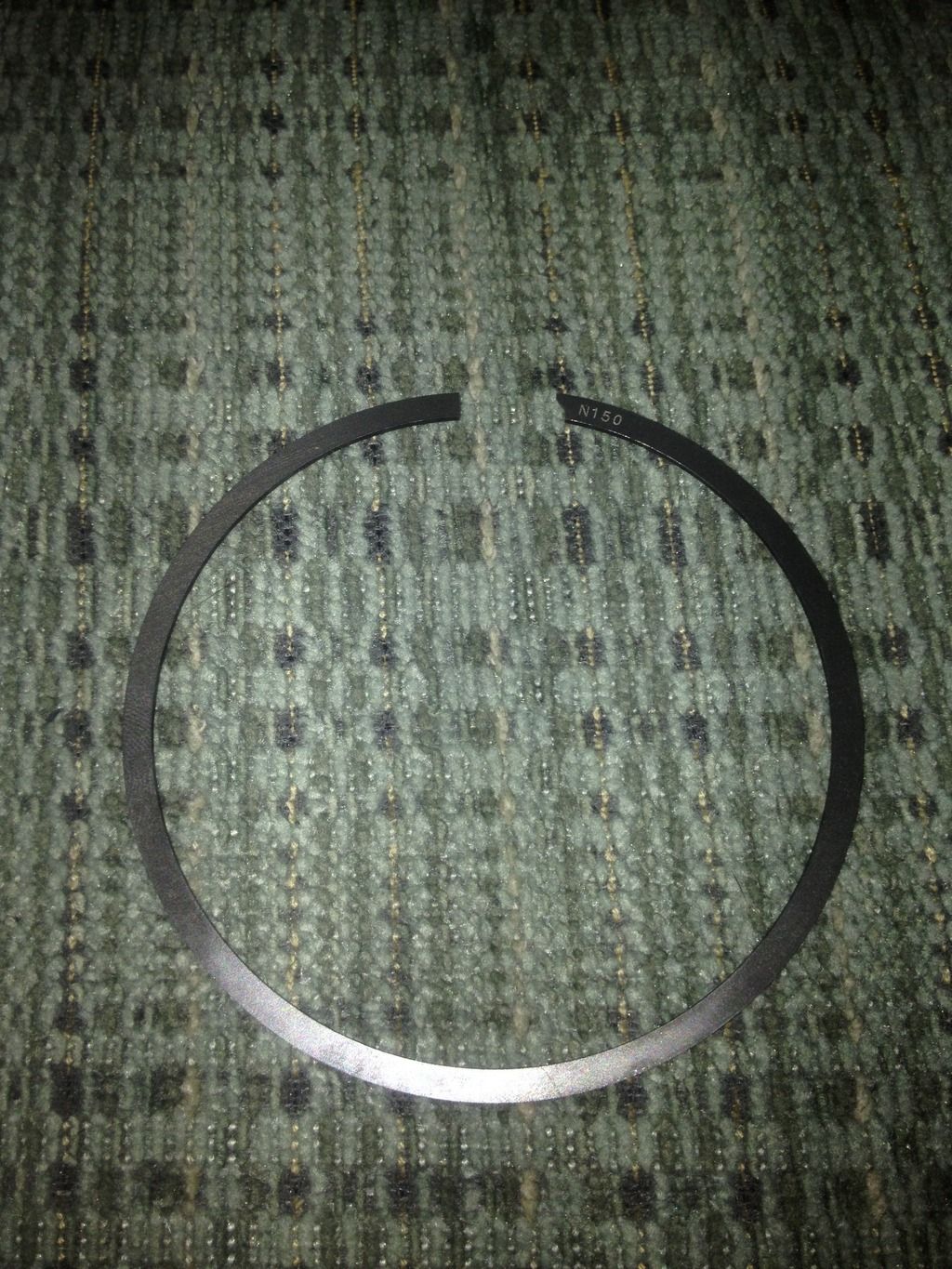

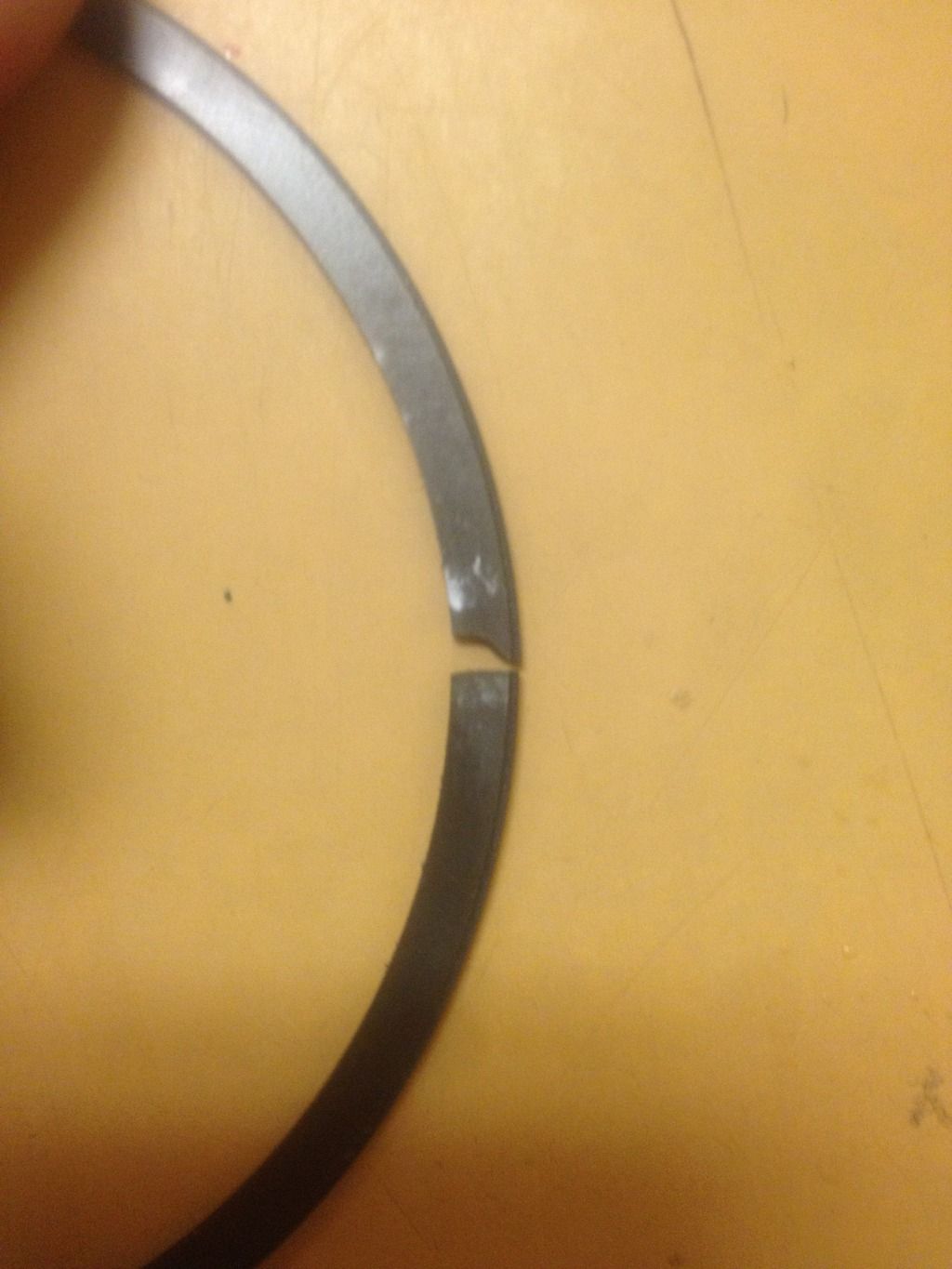

Well putting the motor back together didn't go as planned. My buddy had some issues that would allow him to come and it was my birthday weekend and other friends wanted to take me out. So I decided to put the motor together a different day. Last Friday I drove 2 hours to my buddy Aaron's (GofaST4life) house to get my engine stand so I could. Couldn't stay long but it was great to see him and how Wendy is coming along. Anyways I get the motor all set up and start grinding down the rings. On my third cylinder I started grinding down ring number 2 and this happened
Pretty annoyed about it but I have another set of rings on the way. Should be here Monday and ill hopefully grind it down and then have the head put back on. Slowly but surely she's coming but she's putting up a hell of a fight LOL.

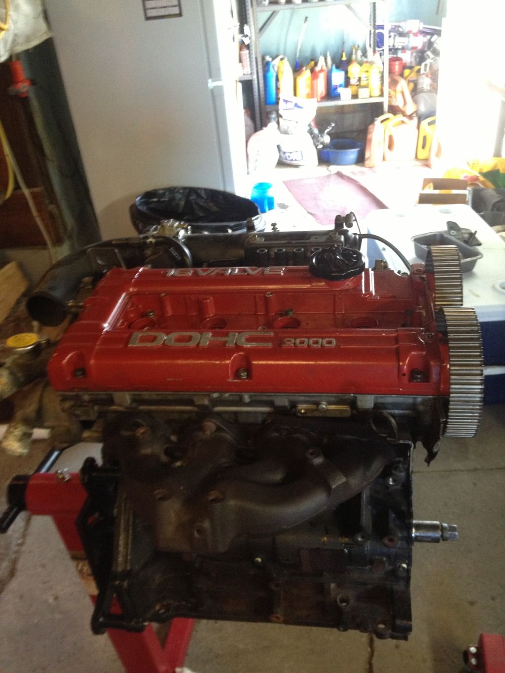

Well, the piston rings came in today, which is weird because today is Easter (happy Easter everyone) and I got too excited to not do my final ring today. So I ground my ring down and put it in the block. I didn't feel like stopping at all. Put the ARP head studs in and my cousin helped me lift the head up and slide it over the studs. We torqued the studs in sequence then I bolted the valve cover on. I still need to do the oil pick up, oil pan, and the entire front of the motor but I'm happy that I got to work on the motor because it was so nice out. The heart of Betty is coming along nicely.

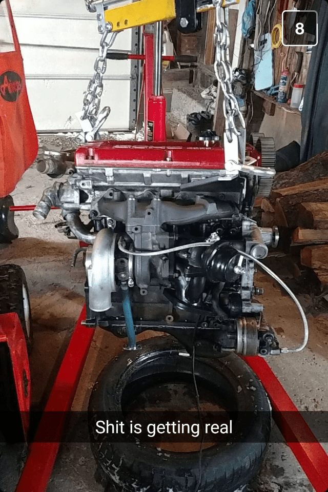

Long time coming, but I do have an update. So I put the OEM BSE kit in and buttoned everything up again. Tried to prime the motor and it still wasn't priming for some reason so I took the pan and oil pump back off and rebuilt the oil pump. After that I put everything back together, again, primed the motor but pumping the oil into the OFH like someone suggested to me and that worked great. I also took a drill to the oil pump gear after the motor was primed to make sure the pump worked correctly, and it did. Next was putting the clutch on and buttoning up the tranny. That went pretty smooth, but I also had two extra pairs of hands that that helped a lot. Next was to drop everything in, and it was kind of a pain, because of the new motor mounts, and just getting everything lined up with not a lot of sunlight left in the day. I got it to a point where the engine was secure in the bay and came back to finish it the next day. Got everything bolted in the next morning, and got it ready for all the other things I had to do. Ran the new clutch line, bleed the huge brakes I put on, put the t-case on, subframe, ect ect. The car went together pretty nicely after the engine was in until about 3 weeks ago when it was time to start it up. I plug the connector into the OBD2 port and couldn't connect at all. No matter what I tried it wouldn't work, so I tested pin 16 and it was only getting 7-8volts when it should have been getting 12. I've tried tracing it back, trying a new 12v sieve and nothing is letting me connect to link. I'm having a local guy that's very good at wiring come over on Friday to check it out. It makes me cross my eyes so I said screw it but all in all, Betty it one step away from being started and I'm so pumped. This car is gonna be a monster.
