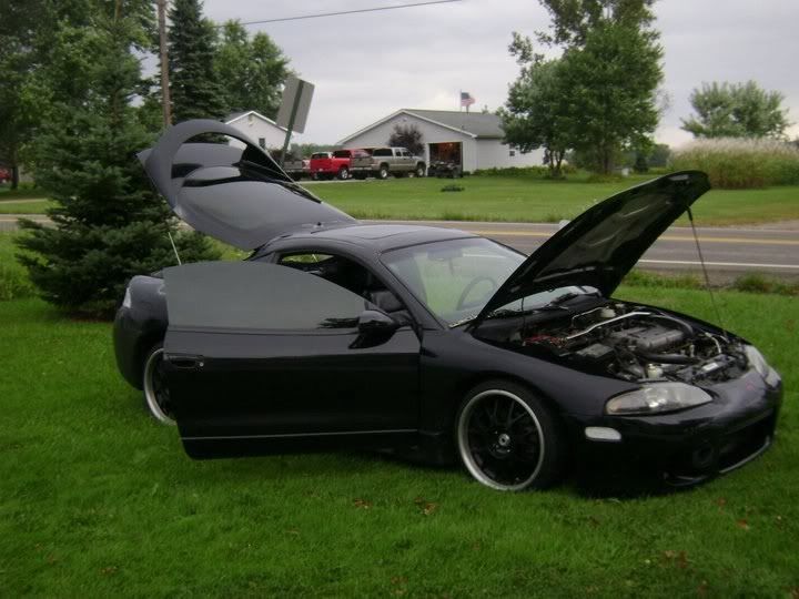

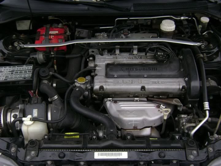

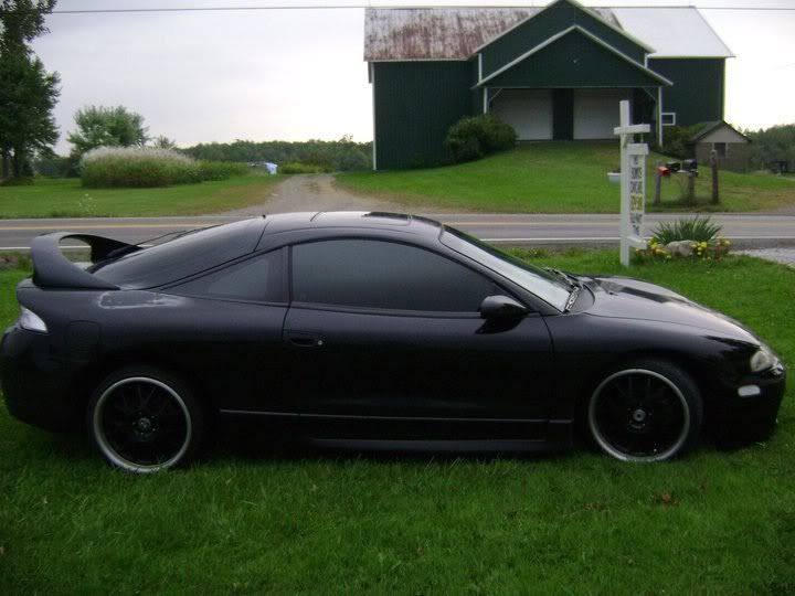

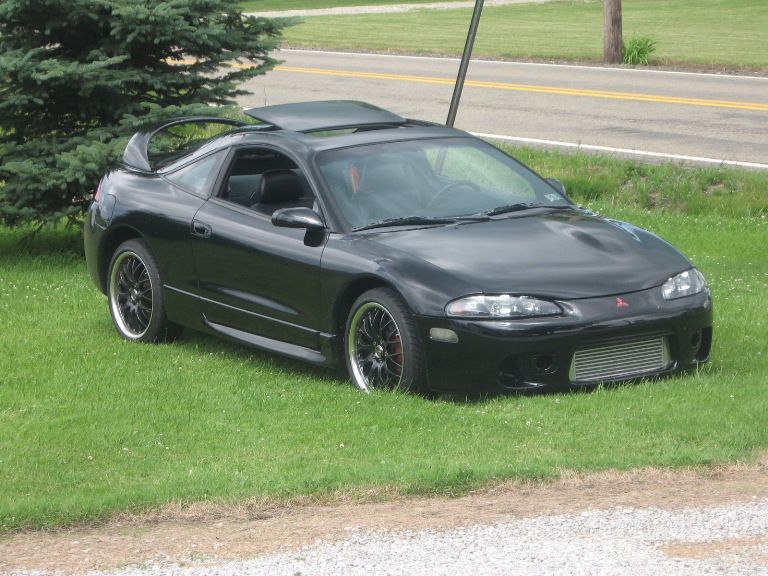

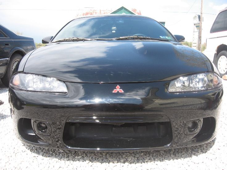

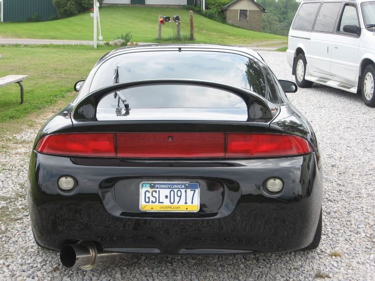

I don't know why I never made a build thread but I guess it's never to late to start one. I've had my 1999 Mitsubishi Eclipse GSX since 2008. Took me 3 years to find her and I also worked two jobs to pay for her. Had 95,000 on her when I bought her and was mostly stock beside some crappy lowering springs, strut tower bars, hks high power muffler and rims. Had sun fade but besides that it was the cleanest dsm I've ever seen in person. No rust anywhere. Here's a few pictures from a few days after I picked her up.
I soon swapped out for stock tail lights

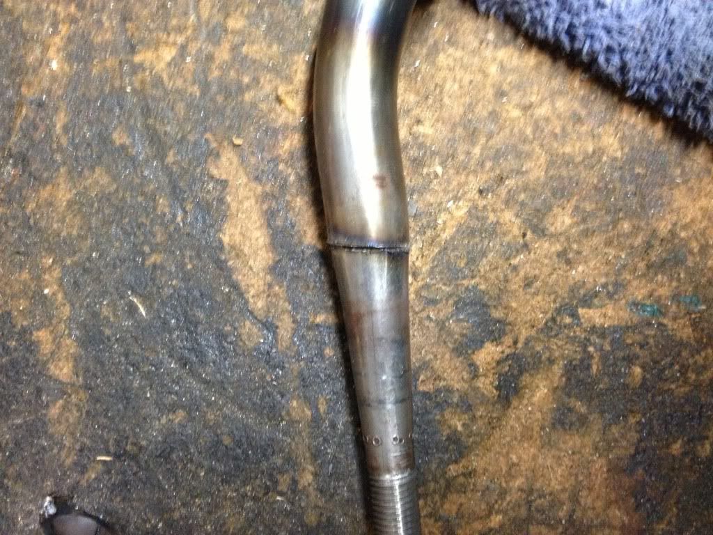

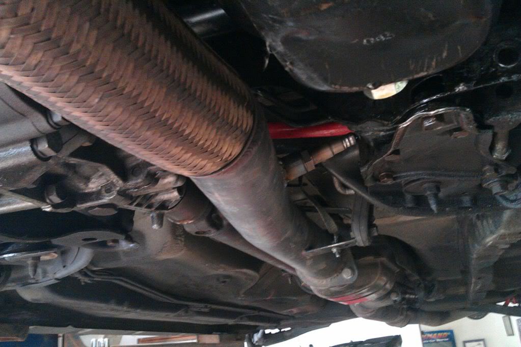

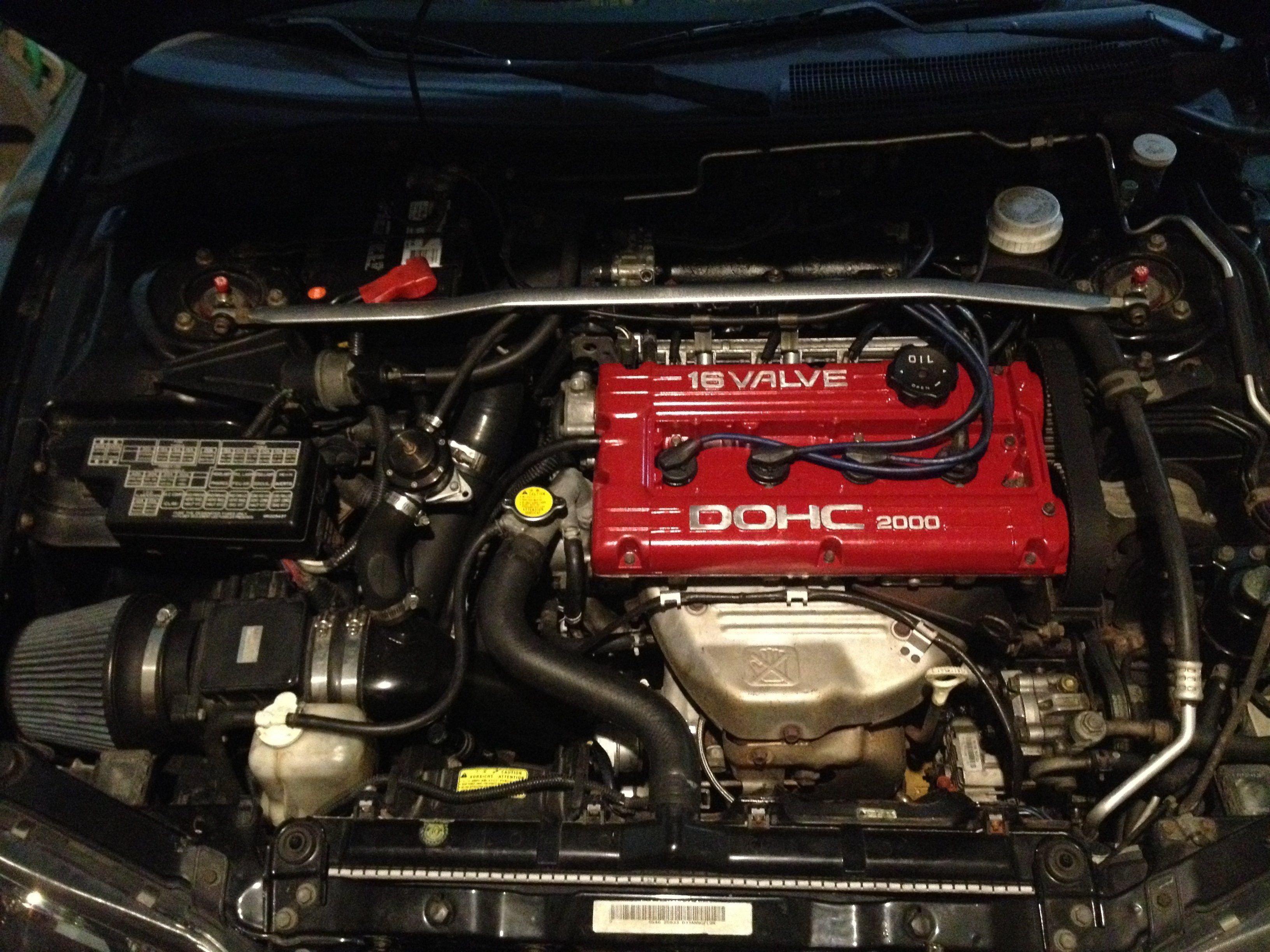

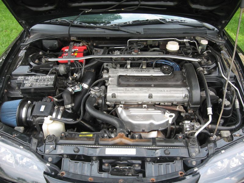

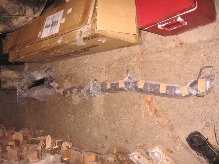

I ended up raising the car back up to stock and removing the tint because I got a few tickets for both. I started school and worked full time just to cover my bills so I didn't do anything to her for awhile. After I graduated and got a good job the first thing I did was buy my exhaust and intake. Bought a RRE downpipe test pipe and cat, apexi n1 cat-back and injen intake.

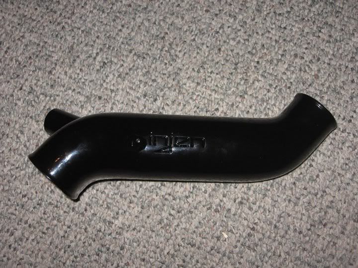

Was never a big fan of chrome/polished parts under the hood so I had the intake powder coated and turned out good for $5

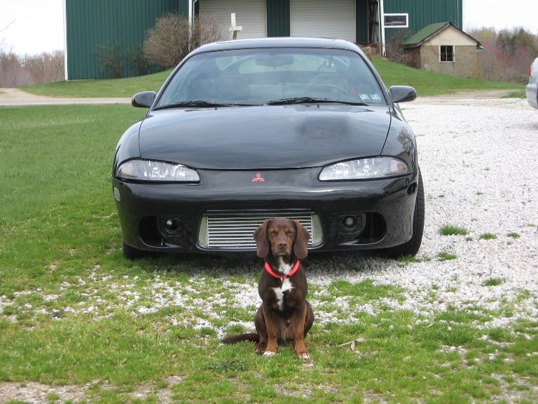

My plans where to stop there on performance upgrades but like the rest of us I got addicted so I added a boost gauge and a mbc. Still wasn't happy so I bought the punishment/cx racing fmic kit with black piping and a ngr type s bov then painted the car. Right after paint I replaced my rims with DR-19s cause the old rims where scratched and getting worn because of the previous owner.

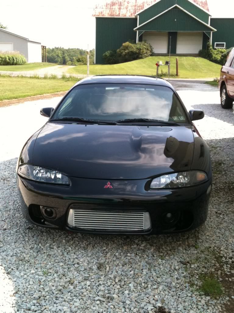

About mid sumer I was finally strong enough to work on the car. After I was aloud to drive again I was getting tired of the boost creep problems so I decided to go back to the stock turbo so I could drive it like I wanted to until I had dsm link and a wideband. I've always love the thought of a stock turbo look with a kick so I bought Fp big t28. The car pulls much better on top the the t25 ever did and am very happy with it.

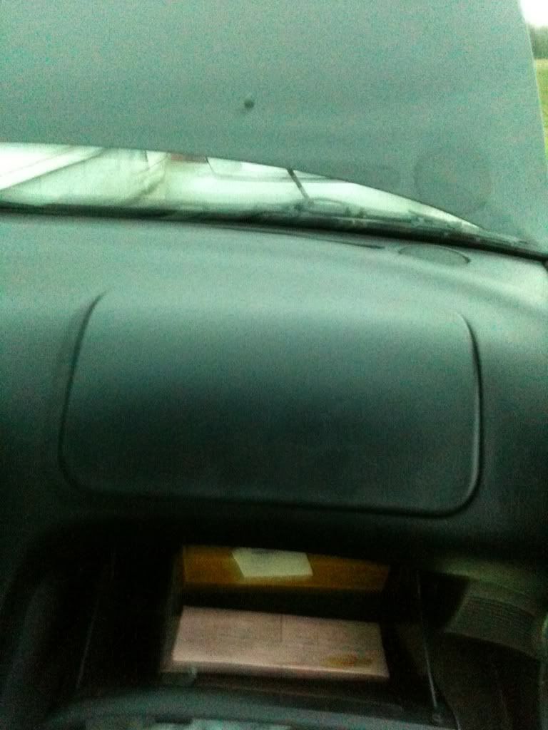

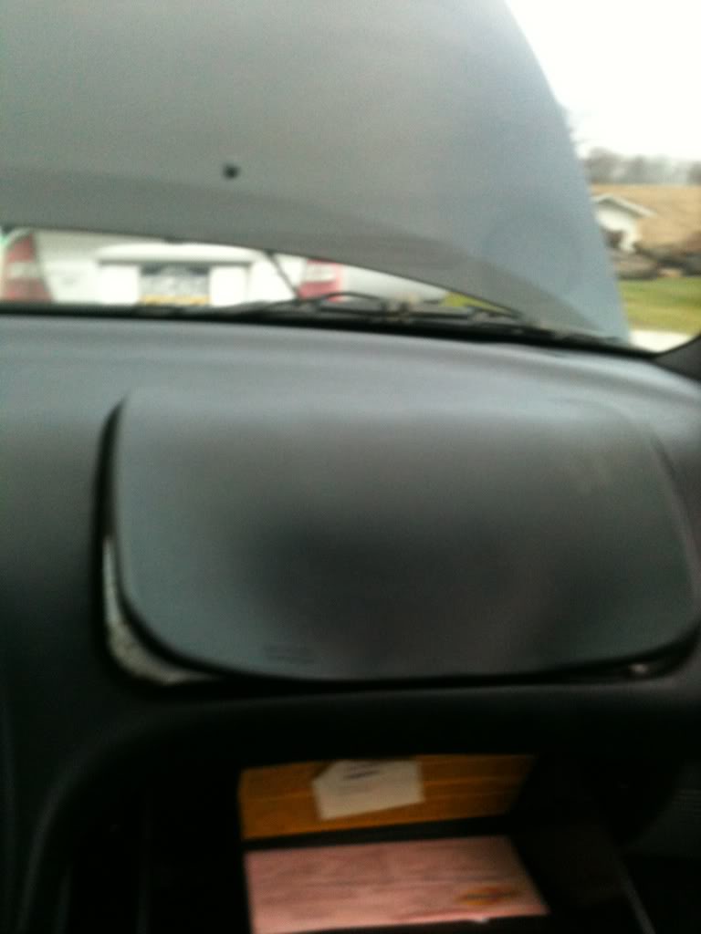

After this I decided to take care if my airbag. After getting in trouble a few times for the tint I took the tint off and as soon as I did that the airbag started pealing and just got worse and worse. I bought a used airbag from miller import and was very easy to swap out.#

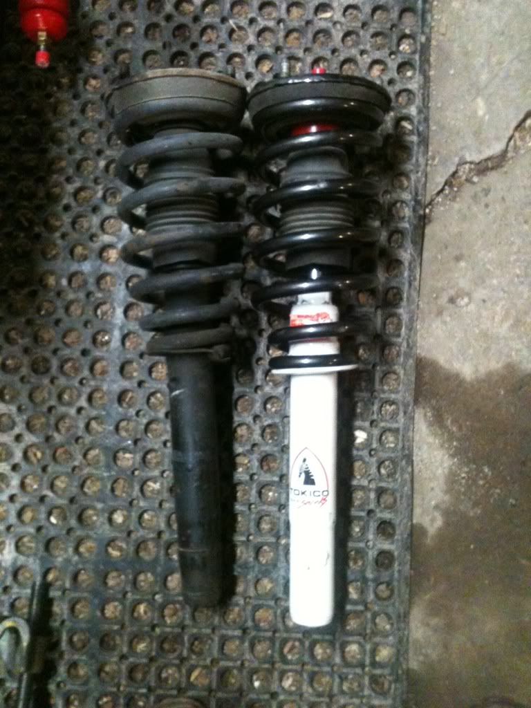

Over the winter I've bought EPROM, Dsm link, fic850cc, innovative wideband, tokico illuminas, prokit springs and a polyurethane bushings kit. These parts will be installed as soon as the weather breaks which I'm hoping is real soon.#I'm planning on running 22psi but only if the tune is safe enough to.

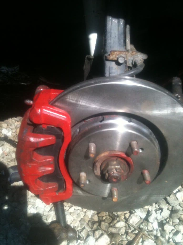

Got my outlander brake setup installed and love this setup.

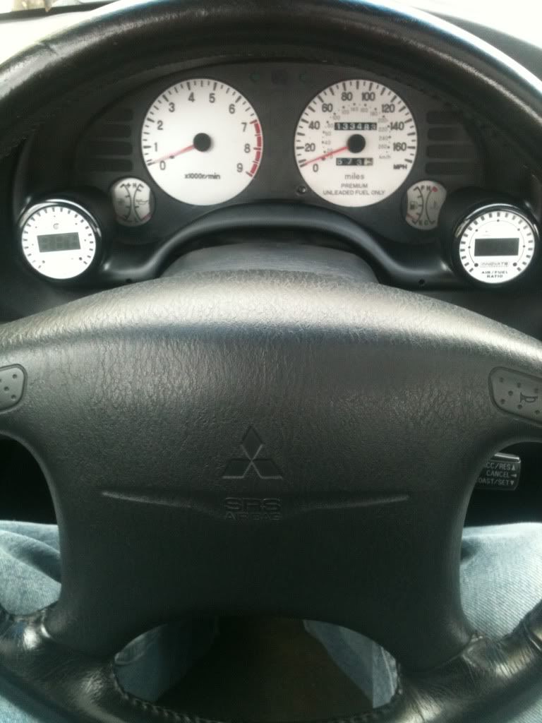

Got my innovate MTX-L wideband and new innovate boost installed. Love them and recommend them!

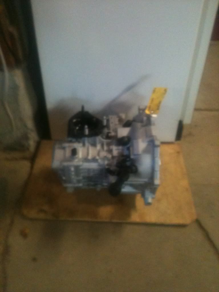

I got my energy suspension bushing kit and rear sway bars installed but don't have pictures. I tipped out my transfercase and installed a brand new one from Jacks

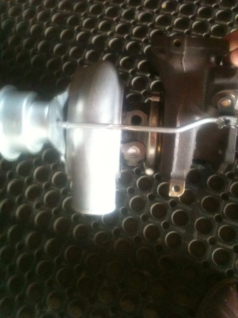

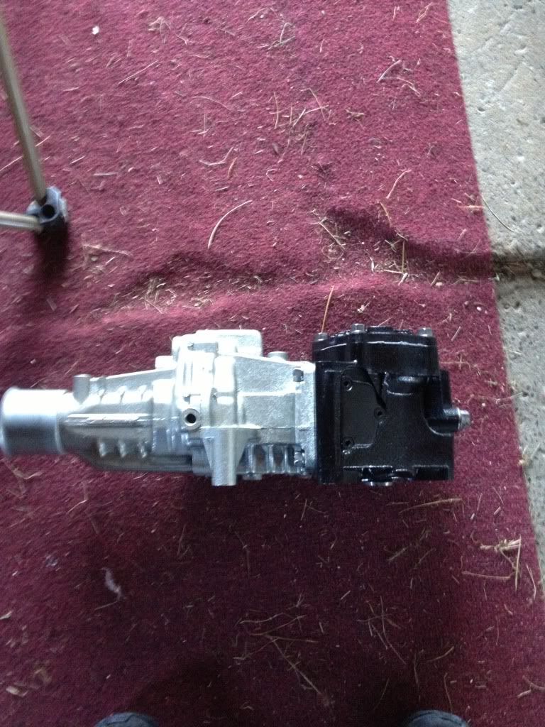

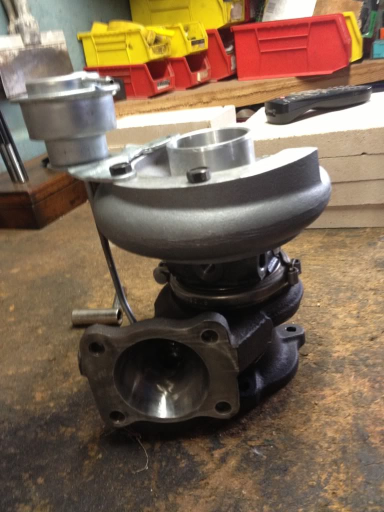

On the side I've also been building a TDO5H 20g from my old evo 3. Took the old wheel and housing off. Bought a TDO6 cover and been in contact with Justin to get the wheel. I took the internal waste gate from the 16g and flattened the bracket and cut a little bit out of the arm for it to work with the cover.

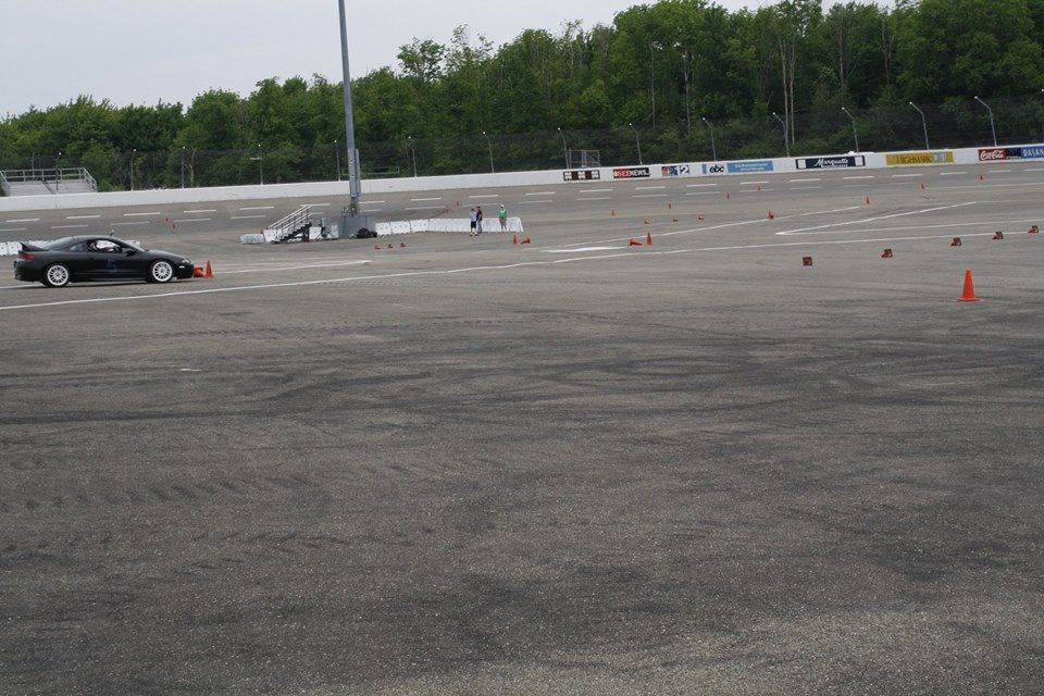

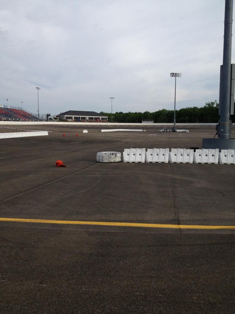

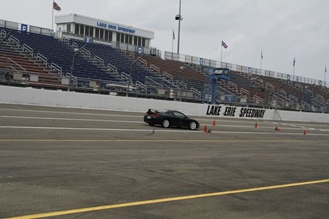

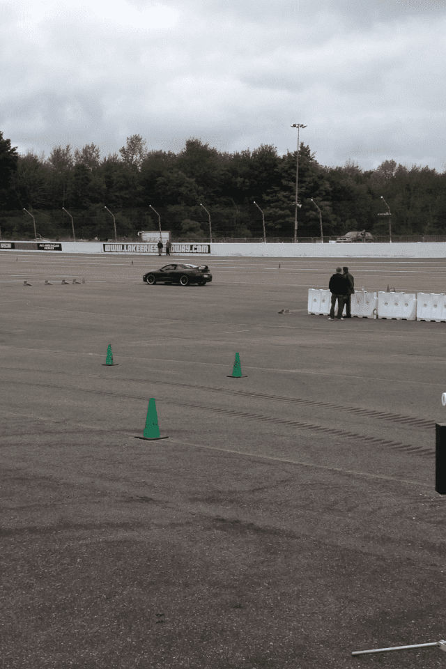

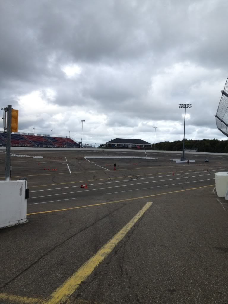

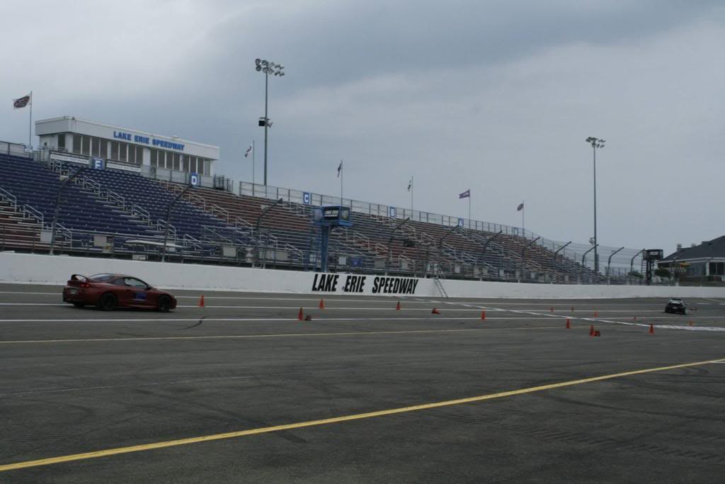

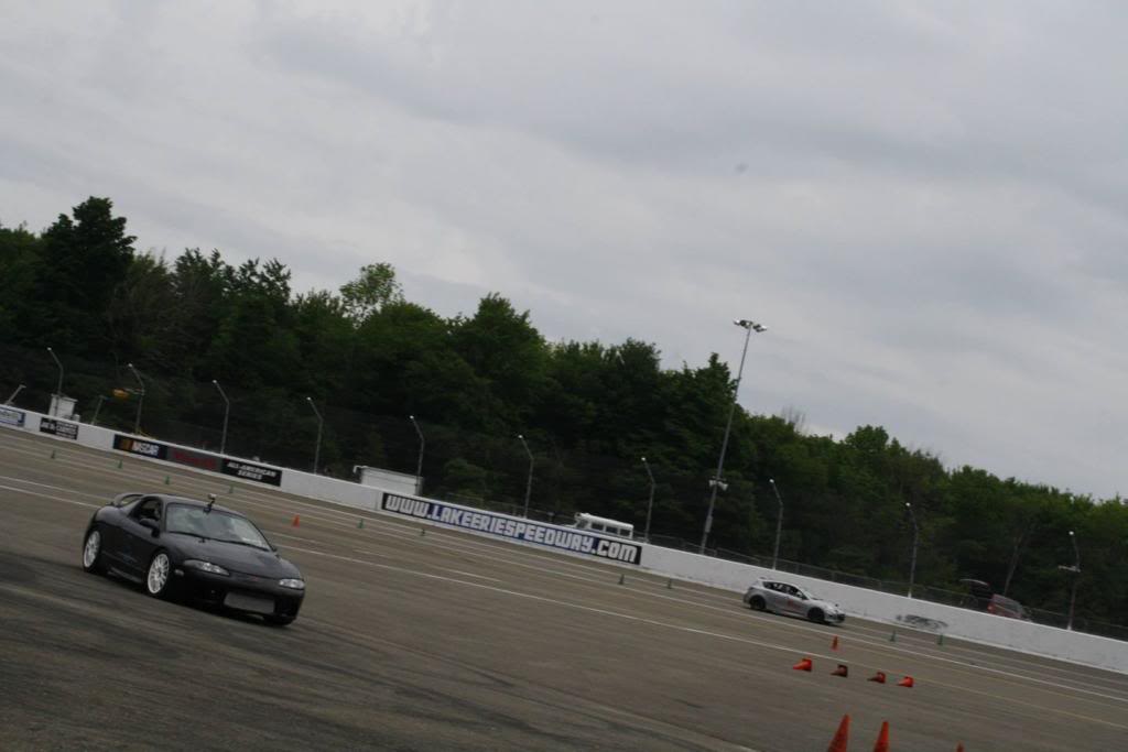

So I competed my first autocross event yesterday. I've rode with my buddy Aaron quite a few times before and I knew that this is what I wanted to do. So after so many problems this year with the car she was finally able to get out on the track and let me say THAT IT WAS A BLAST! The goal for the day was to get at least a 40.99 I did my first fun of 45.xx the day consisted of 4 passes in the morning and 8 after break. On my last run of the morning session I pulled a 41.4 and was so pumped. The session after break my first run was a 41.7 I believe so I was getting more consistant. After a few more more runs I finally broke into the 40's with a 40.328. I was so pumped I met my goal so for the rest of my runs I was just trying to get more smooth and consistant. My 7th run of the second session felt pretty good (besides the fact I still had my POS all season kuhmo that make the car handle like crap and want to kick out) and I was blown away by the number when I came across the line. A 39.849 :hellyeah:. I finished 3rd in my class and it was only 1 second slower then most of the evos and stis there with bigger brakes and way better tires. Lets just say I'm hooked and can't wait to get my other set of tires on the car. I owe a big thanks to my co pilot Aaron (GofaST4life) for the instructions and helping me see the course better. He did pretty well despite the fact he's having hesitation problems going around hard corners. The few shots I got from the day.
On the way to the event
Lake Erie Speedway

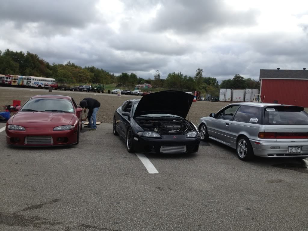

And the DSM crew representing!

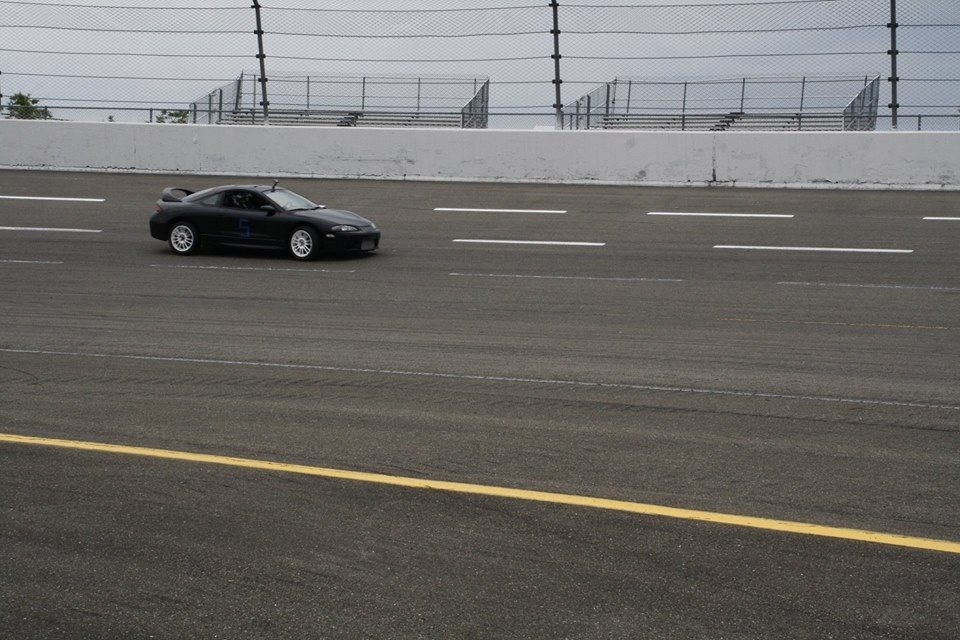

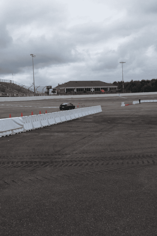

Some action shots

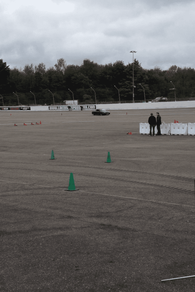

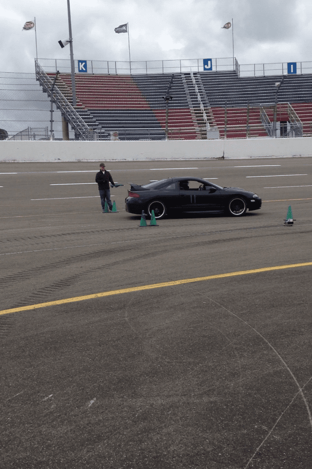

The last autocross in my area was this past weekend and even though I was only able to run a half day it was a blast like usual. When I left I was doing pretty good and was beating most of the WRXs and others in my class by at least 1 second I not more. I was deffentely not leading my class but was doing well for my experience and the wet track (rained over night and some while we were setting up the course). I'm not sure what place I finished and wouldn't be surprised if it was closer to the bottom because the track dried out after I left and usually times get better as you get used to the course.
Only racing shot of the day for my car and of course it's the run when the side marker fell out ROFL

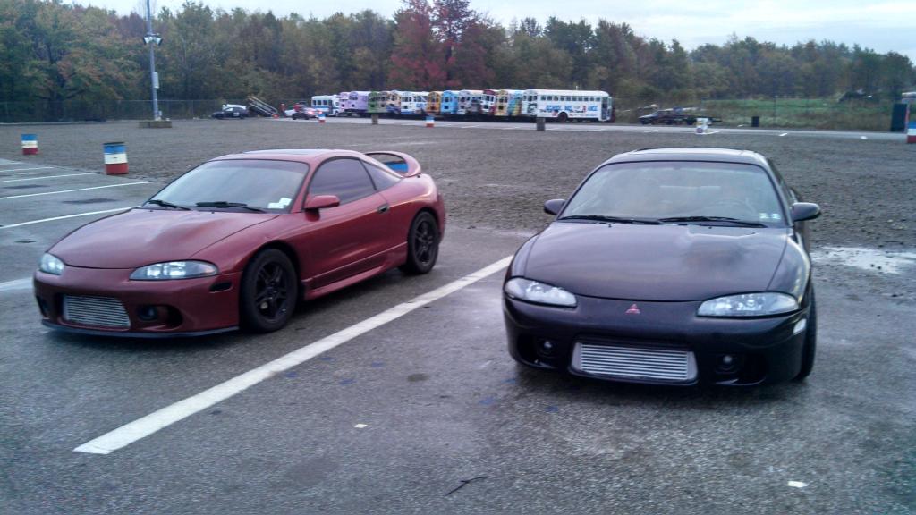

DSMs where well represented again because of my buddy GofaST4life. He beat my time by the end of the day but I'm happy because a Dsm did well. He has a lot more experience then I do and I shoot for similar times as him. Check out his build http://www.dsmtuners.com/forums/dsm...aarons-1997-gsx-street-autox-track-build.html

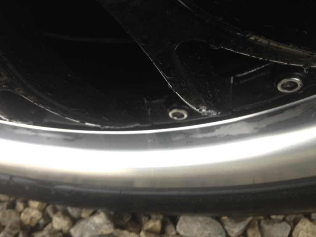

After cleaning the car up last week I found out that I have to repolish my rims so that's a project I have to tackle next time the weathers nice. :notgood:

Got my 20G wheel from Justin and finally put together for good. Can't wait to see what 24-25 psi feels like with some 272 cams.

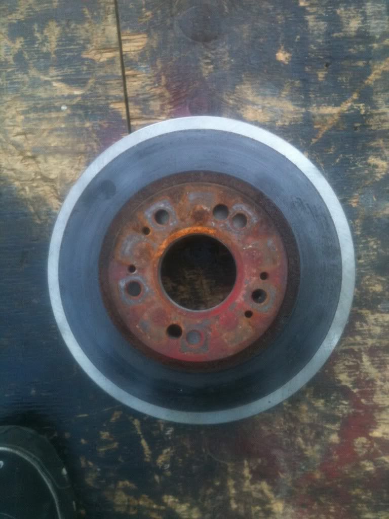

It's been awhile since I've updated. The cars been stored all winter and just bought a few parts and waited for spring. I got the car out a few weeks ago and decided to drive it for a little bit to cure my major condition of boost withdrawal. I finally got to work on the car on Saturday and got a little bit done. First the list of this years upgrades.
So far I have
DKS 272/272
3G brake booster
3G master cylinder

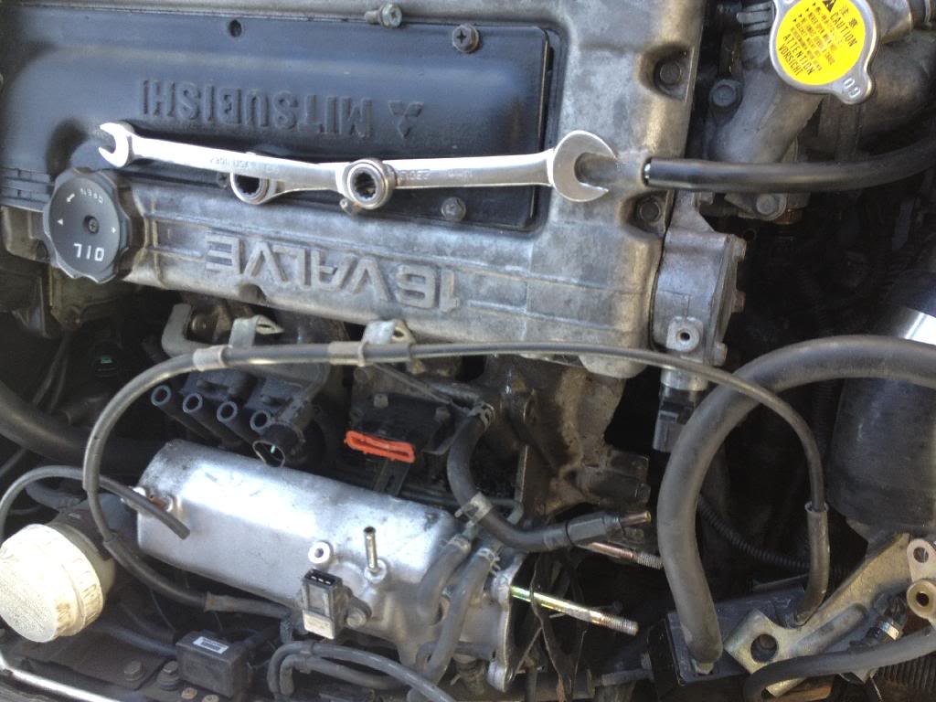

Evo 3 intake manifold
1g throttle body

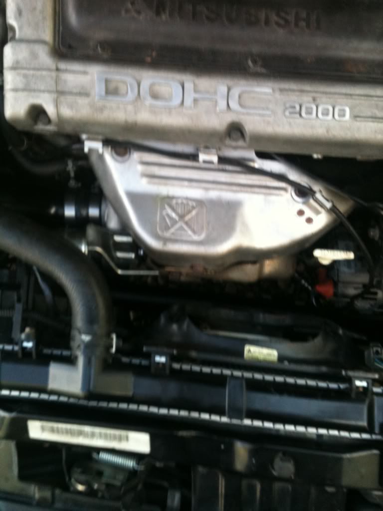

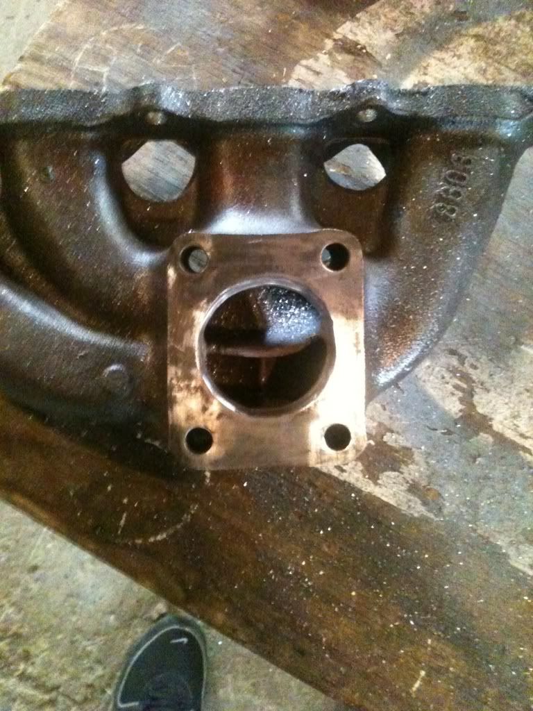

Tearing into it
Manifold off (needs a good cleaning back here)
Booster comparison
Booster installed

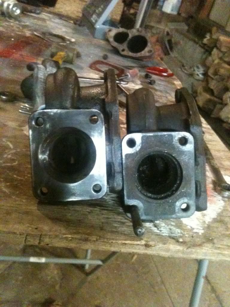

TB comparison
Evo manifold before and after
Mock up
I had to stop there because of the busy Easter weekend and then the weather hasn't been the greatest. I'll update this soon with results.
Finally got the car back up and running. Was having a high idle issue and low vacuum. Turns out it was a few vacuum lines hooked up wrong causing -2 vacuum at idle and my 1g TB wouldn't work causing high idle no matter what I did so I put the stock 2g TB on and it idled perfectly. All I have to do is bleed the brakes and I will be able to take her down the road. Hopefully I'll have pictures up by Saturday. Aaron and I are gonna put some serious wrench time in on Friday and if we get to it I'm hoping we get to a little project that will set the car off a little more.

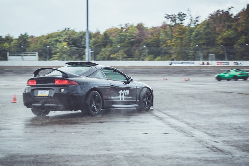

Had my first even today even tho I only got 3 runs in before it was called due to weather. Was just starting to get a feel for the new wheels and tires and let me tell you I love them. Turn the wheel and floor it and it still goes where I want it to. In my class of SM I finished 2nd and am very happy to say DSM's came in 1st, 2nd, and 3rd. Very good in my book even though I need to work on some stuff by the next event which is July 6th.
