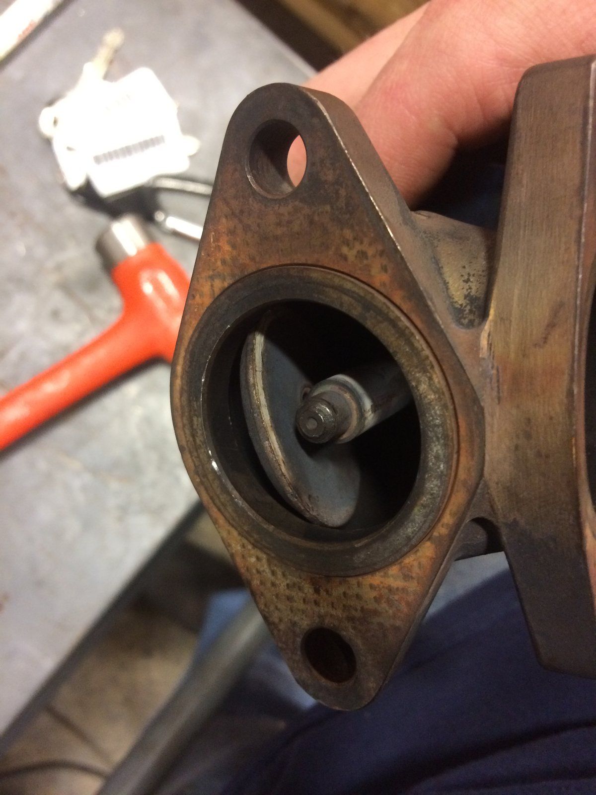

I was in such a rush to fix the turbo, I never got a chance to really look over the external wastegate and the plunger broke. By this time, the rescheduled event for Erie was coming up in 4 days and I couldn't get any wastegate here in enough time. So I did the only logical thing a welder would do. I put air to the nipple to pull the plunger back, reseated the rest of it, let the air go so everything would look normal, checked to see if it was sealing and welded it back together. Put o2 back on the turbo and reinstalled everything. So I found my lagging issue!!!

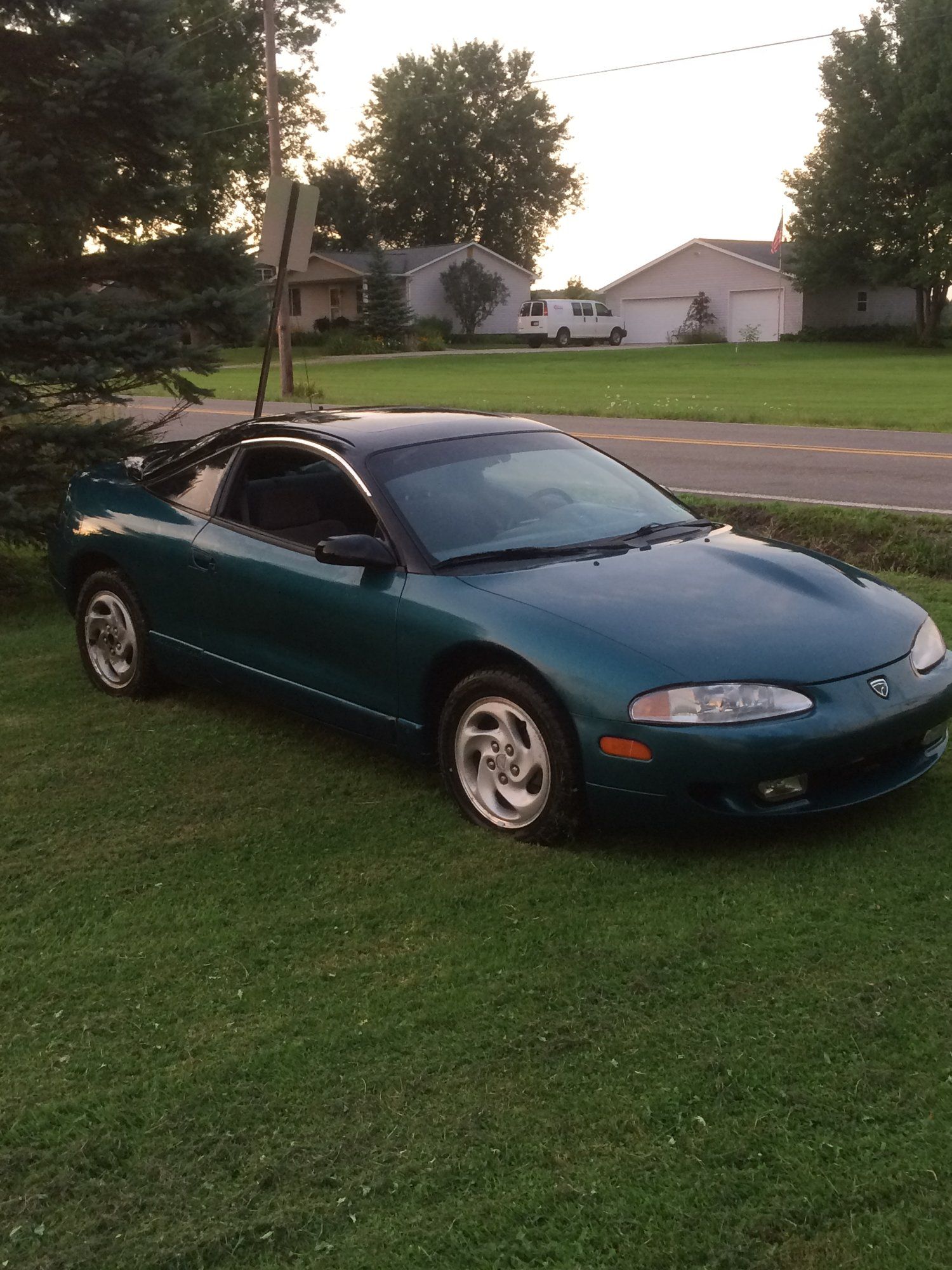

In the mean time, the shootout bug has bit me and I was itching to be there with a running DSM. Someone I know had a 96 awd talon manual sitting in his back yard for a few years. The guy wasn't very patient with this car and we all know you have to with these cars. He told it needed a new slave cylinder and a thermostat. Offered him 1300 and he took it. Best part is on the way home it rolled over 101000 miles. I forgot to mention it has the LSD rear end too
It's not the prettiest but what can you expect for 1300!

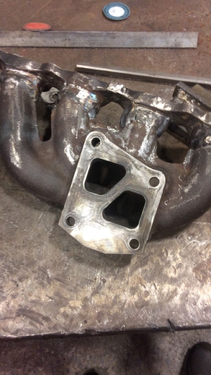

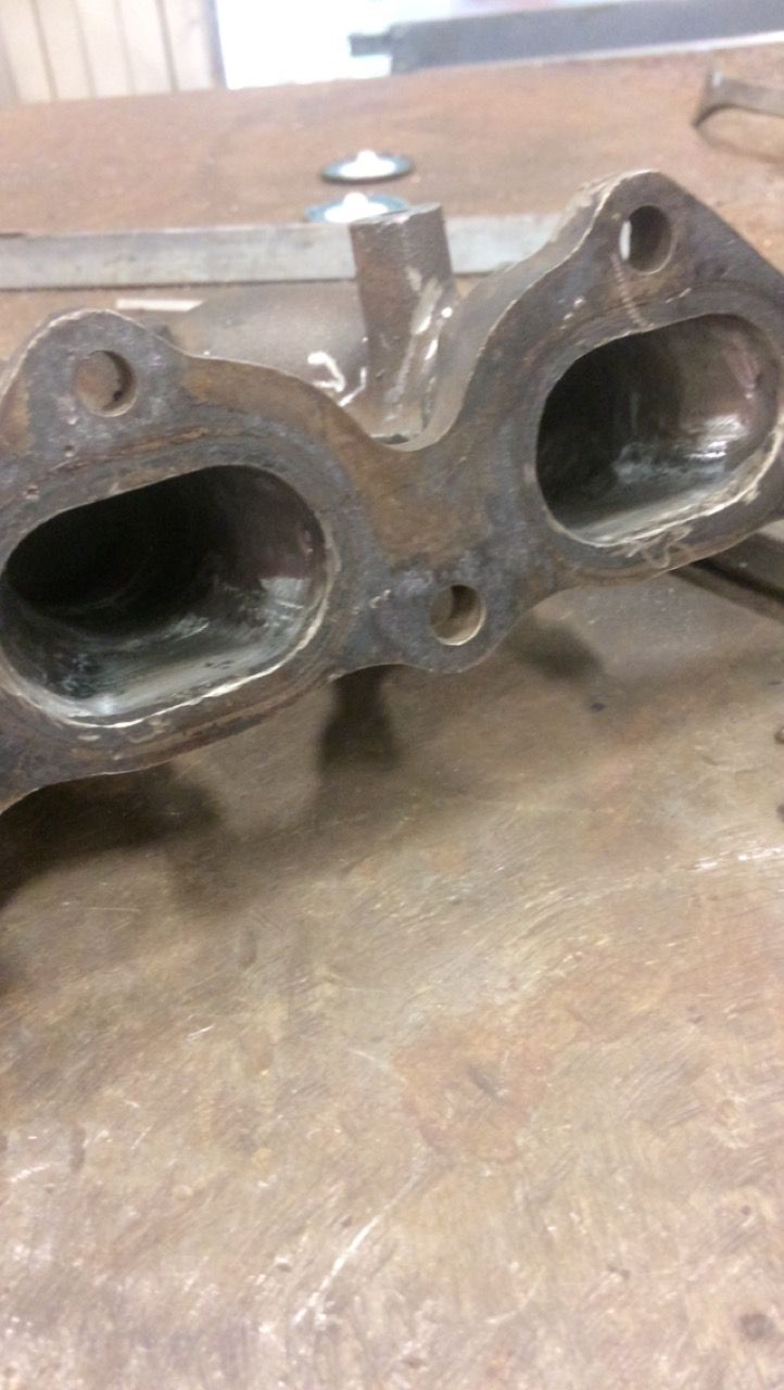

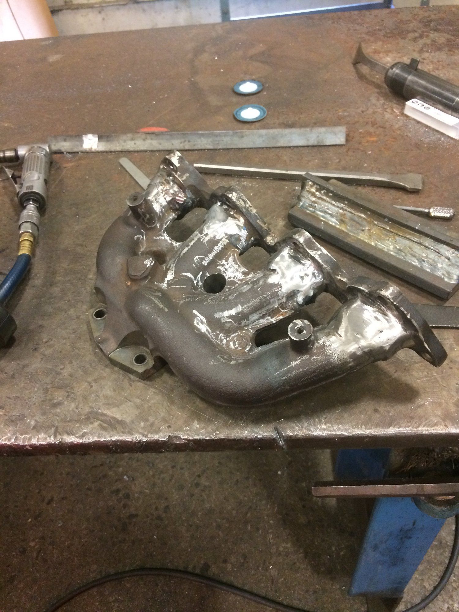

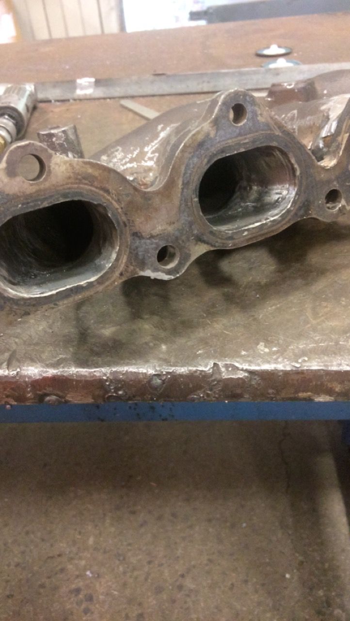

Anyways let's get to the update on Betty. It's taken me awhile get to this because I was doing it at work and I've been swamped their so that means little time but here's an idea of what's to come for here. These pictures aren't the finished project BTW. Still have to clean it up more.
I've been wanting to do this for awhile so I thought let's go for it. Evo x twinscroll coming soon!
Betty 2.0 is going to be a f**king monster man!
Cannot wait to get gapped! :LOL:
How about we call her Betty 2.3?
Small update
I received the X turbo and swapped out the stock wheel and compressor for the 20g wheel and cover I had laying around. While swapping I noticed it was leaking oil into the hotside of the turbo a pretty good amount so I bought a rebuild kit for it. I put everything back together so I could mock it up and my spare motor. On the back of the X turbo there's a bracket built into the casting which was hitting the block. Took it to work, cut it off to retest fit. Put it back on and now it JUST barefly hit the block. I was gonna grind off a little more until I noticed it was also hitting the coolant banjo bolt everyone shaves off when installing a decent sized turbo. Mine was already shaved from before and I didn't feel comfortable shaving anymore off so I went and bought a manifold spacer and now everything will work. I can't do much more until I have to motor on the stand and I can install the extended studs into the head. Next step is gonna be give the engine back a good scrubbing and possible repaint.
