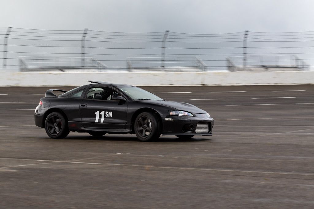

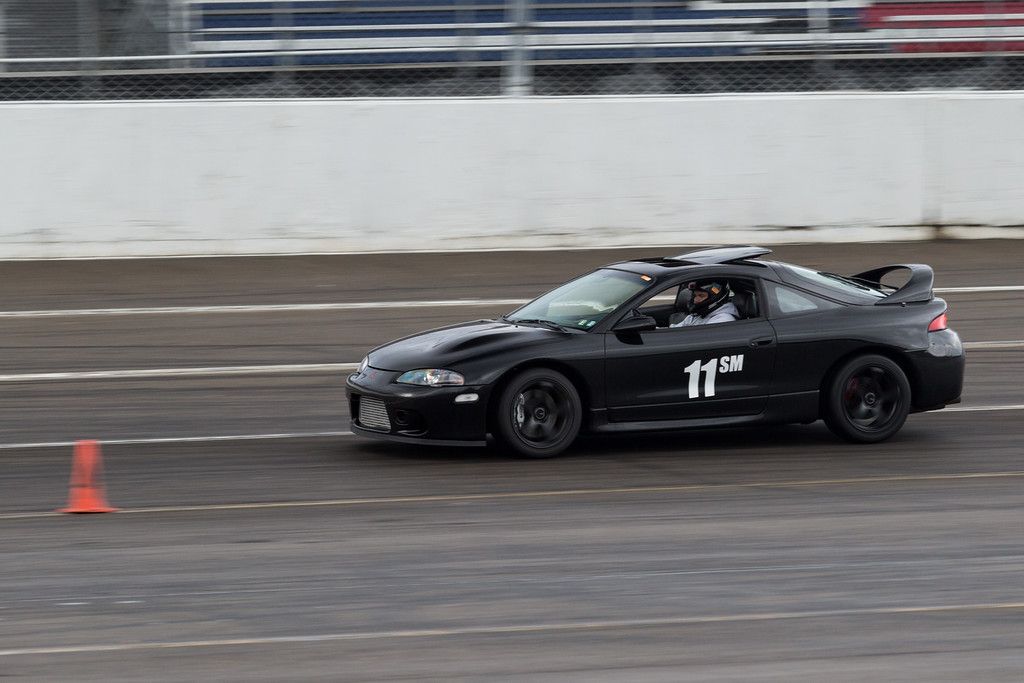

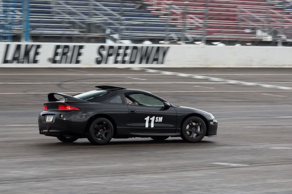

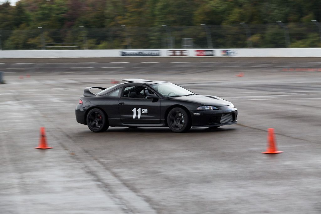

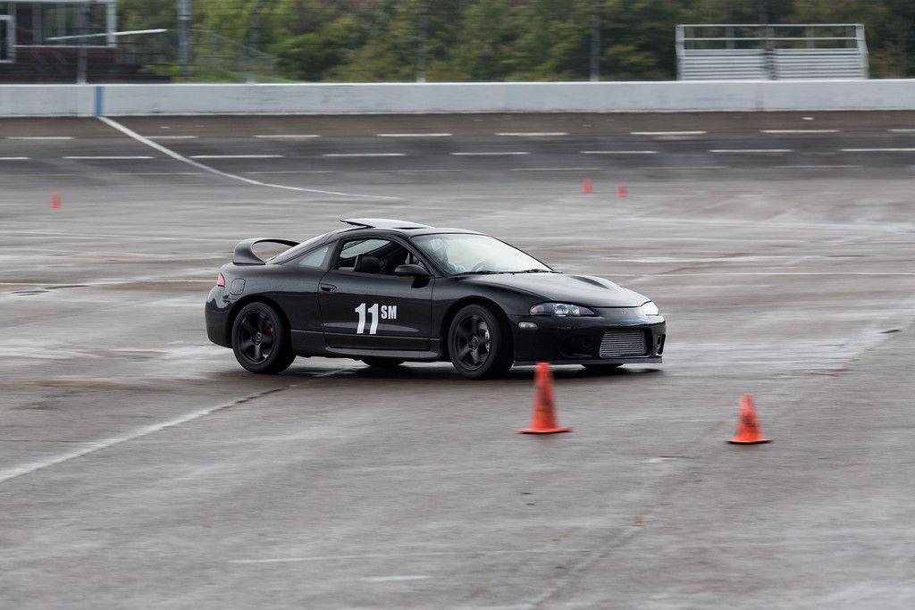

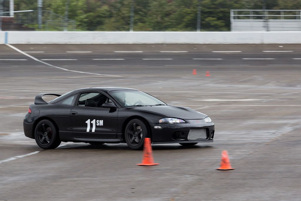

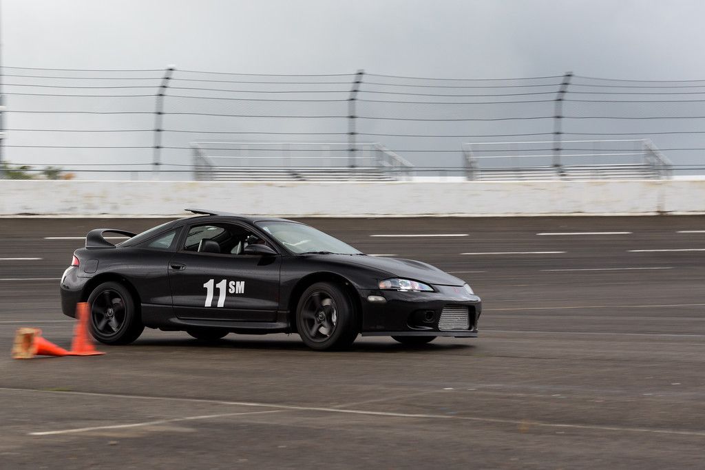

Autocross day! I wake up and it's raining. That put a huge smile on my face because I love autocrossing in the rain. Drive to the event and start working on setting up the course with a few other regulars and they decided to run the day like a pro solo would be run. You get 3 runs in the morning break to reverse the course and you get 3 more. You then add your fastest times from each segment together and that's your end result. I didn't think it was a bad idea seeming how it was our last event of the year and by now, if you showed up to even half of the events, you should have some sort of clue as to navigating a course and starting to get a feel for your car.
So we finish up setting the course up and I walk back over to Betty to start emptying her out and to start really preparing her for the day and the ground was nothing but a rainbow oil slick the entire way around the car.. checked my and it wasn't low. Perfect level, right where I put it. So I said screw it and went and finished up getting her ready. As I was getting her ready, it came to me that I hardly drove her in the rain on the way back from the shootout and was having a small oil drip a few weeks back. This was the first time since the in the rain since then too so I kept an eye on my oil level the rest of the day and I didn't notice a loss in oil.
On to the racing! The car felt strong but, I still need a lot of work with my driver mod in Betty. First run I spun out because I tried pushing a little to hard coming out of a sweeping left hand turn into a slalom. Second run was a low 42 and my 3rd was a 41.6 putting me in 2nd. First had a 41 flat and 3rd had a 41.7 so it was gonna be a crap shoot on the reverse course.
After we swapped the course we were launching downhill (I hate that BTW) and still wasn't fully used to launching on the new setup. Launches weren't all that great but my first run was a low 41. The next two were both 40.9's and I knew there was still plenty for me to work on to get better on that course but, unfortunately that was it for my second half of the day. The other two cars I was competing against put down a 40.7 and a 40 flat but at the end of the day I was only .8 off the leader after my second event of the year with her and still on a safe/conservative tune. Driver mod is needed badly as we had fun runs after the event and on local was trying to give me pointers as he noticed I was taking a counter too tight. I got it down to a 40.6 but still knew it was me messing up and not tyebcar. On the safe tune, I'd say the car with a better driver had a 39.5ish capability.
All in all, it was a fun day racing and I know that next year will be even better as she will be mostly a designated racecar going to e85, which I'm planning on doing this Friday. Saturday a friend and I are going to battle it out at the local 1/4 mile. He's running a procharged 05 GTO the runs 12.3 but capable of more. I'm hoping to beat him with the tune but I haven't drag raced in awhile either.

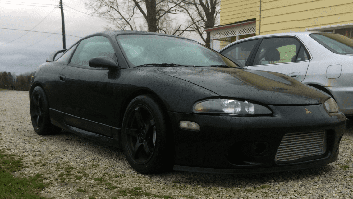

Your car looks really good on those Enkeis. Thumbs up*
Thank you :D

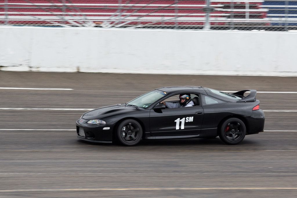

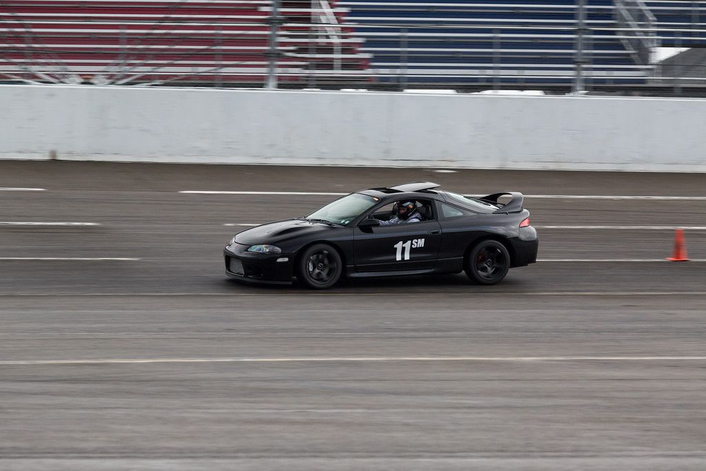

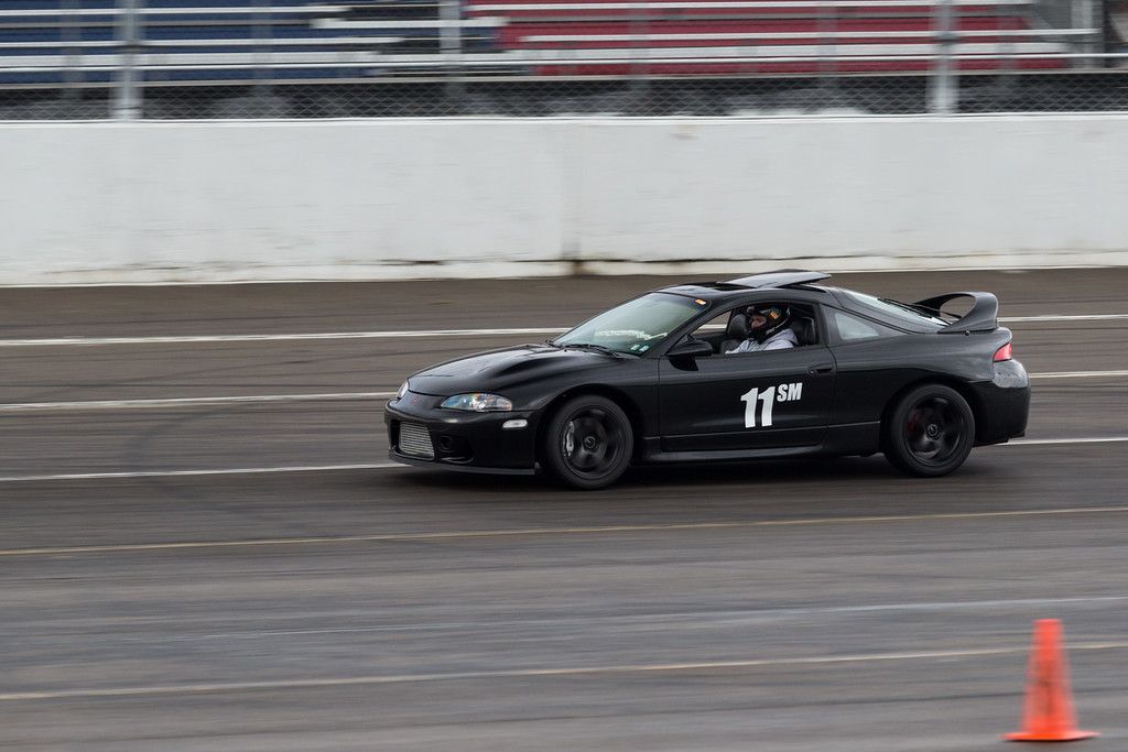

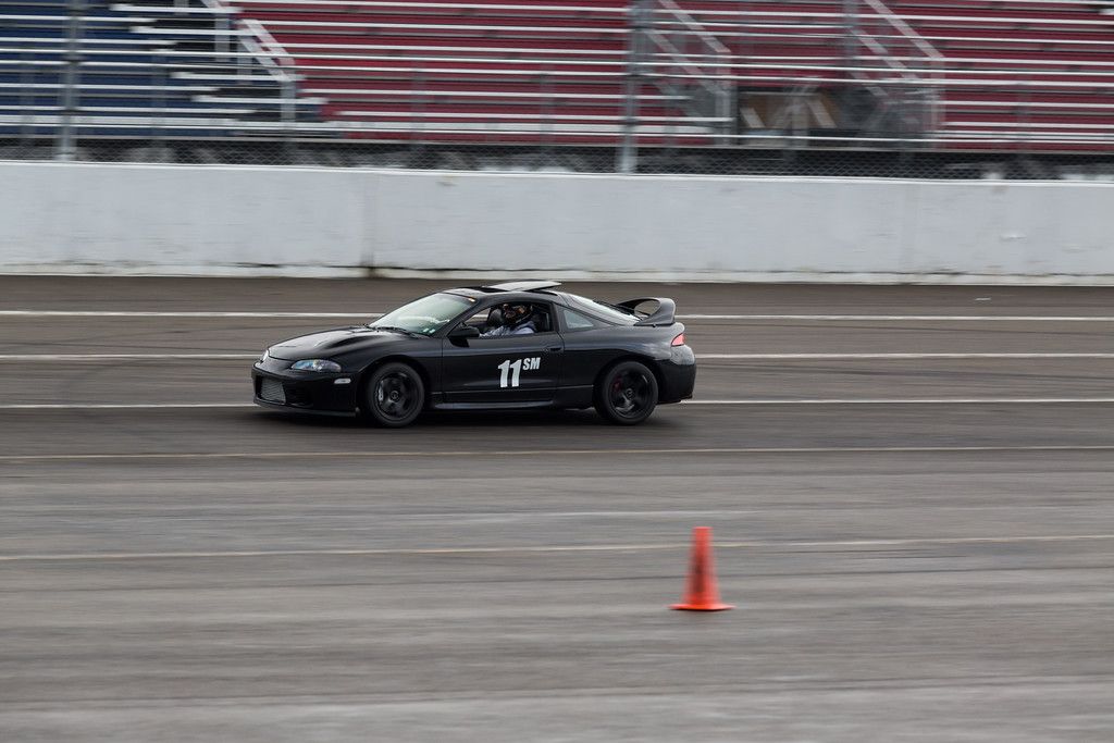

Recap of my Sunday!
With the brakes bled the night before, work wanted me to come in all day Sunday, but I told them I had plans to race so we compromised and I worked 3am-7am while another coworker picked up the rest of it. I woke up a little after 1am to make sure I had everything packed again before I hit the road for my hour long trip to work with Betty. The good thing about my work is that it's half way between Erie and Pitt Race, which made the trip a little easier on the car. I work the 4 longest hours I've worked in a very long time because I was so hyped to really get some seat time in the the still new setup. I show up and the course layout is pretty fast and not the most technical. Myself and a few other drivers that came from the Erie region are training to be Safety Stewart's so we stuck together and walked the track as if we were the acting Safety Stewart's. Myself and one other member were aloud to be deputies for the event. I need one more, which I'm hoping to get at NEOHIO's test and tune in less than two weeks, and I'll be a certified SS before my region's first event on May 6th and 7th.
We got a total of 6 runs. Keep in mind, the car is still on low boost for the turbo I'm running (19-20), and a very safe tune.
First run, I was just trying to get a good line through the course and the car felt pretty solid, but I had a lot of rust on the driver mod. I pulled in a 52.XX, which I felt ok with, because most cars were running around 50-54 sec times on their first run.
Second run, I decided I was going to push it. That wasn't the best idea because the very first straight away with a hard turn, I over drive the car and locked up the tires, hitting a cone wall, ruining my run.
Run number three, I cooled back down and just tried to get the feel of the car again, and the best line. Came in at another 52.XX.
I was pretty far behind most cars in my class so on break, I talked to a few people to help me realize I'm still figuring the car out and it's been a long time since the car has seen the track a long with me getting back into AWD.
Fourth run, I tried to be much more smooth and work on getting the car to rotate a little more. Pulled in a 50.9 which helped me breath and relax a little more.
Fifth run I ran a 50.5, which was good enough to put me 4th in SM.
Run number six, being almost completely relaxed, but still working on driver mod, I let her rip. Rotating the car perfect beside a two spots, and braking early in two spots, it felt by far like my best run. I got a little more aggressive with the steering input and it paid off. Crossed the finish line and the display lights up a 48.5! Good enough to finish 3rd in SM. Only .135 behind 2nd place and 5.5 seconds behind 1st. Knowing not one person got faster than a 44.1 (he won nationals last year), there's no way someone ran a 43.0.
Ill take the results knowing I still could improve on that course. I have three more test and tune days before the points start rolling in. Plenty of time to get more rust knocked off and work on tuning a little more. So excited for this year to begin.
