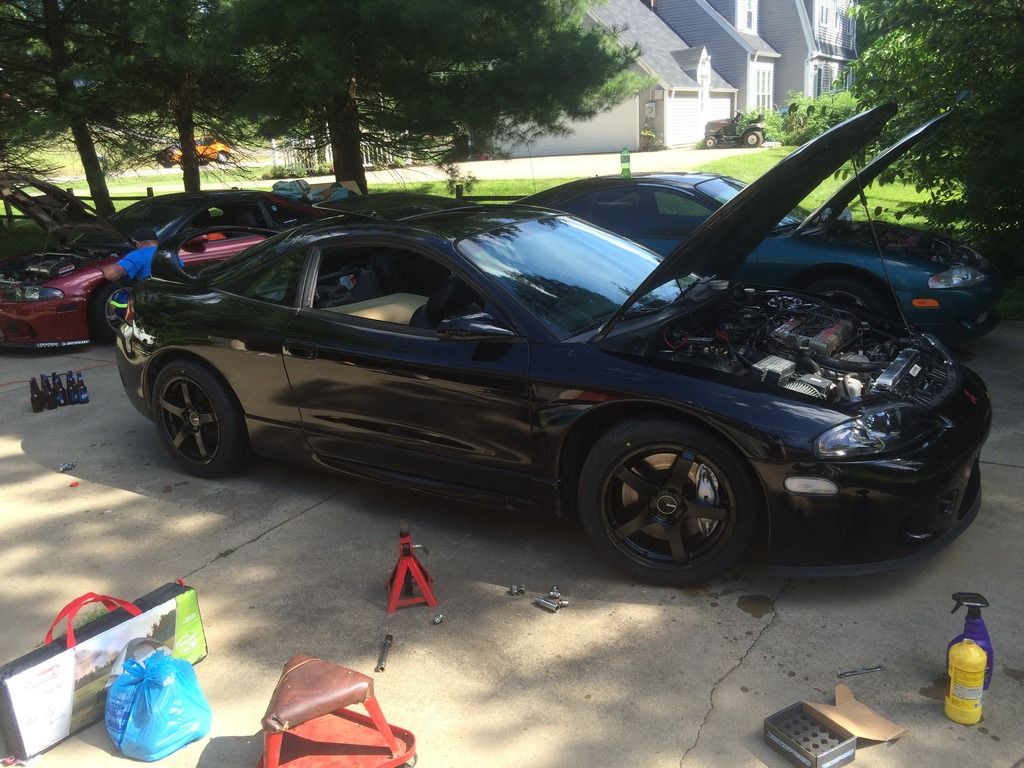

Update! So yesterday, a local that's very good with wiring came over and redid some wiring I had done for the gauges, and checked the obd2 port connections. It took him over and hour but he finally realize there must be a loose connecting by the port and made it so the wire had a solid connection. I plugged in link and it connected! After that, I had to switch the displacement and prime the fuel pump. After that, I jumped right in and turned the key and she started right up. No leaks or anything. I was pretty shocked about that. Then it was time to take her for a little spin. The car wouldn't go into gear, and I noticed the pedal was extremely soft for a 2600 clutch. Softer than stock and it was having a little problem coming back up. I'll be bleeding it more today, and hopefully that fixes the problem! She sounds awesome and I can't wait to drive her.

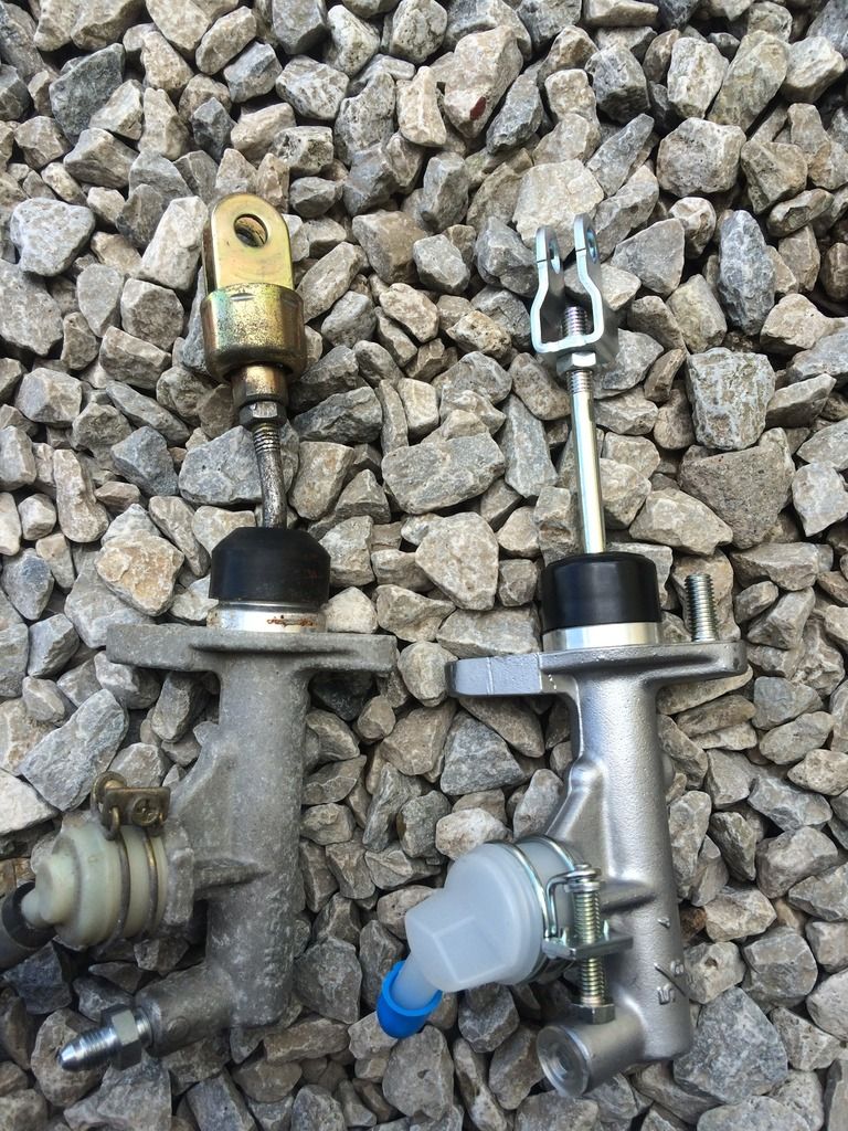

I spent many hours trying to bleed my clutch line the other day to realize my brand new slave was bad. So I put another slave on, bled the clutch and still couldn't get it into gear. Tried messing with the clutch adjustment and no matter how far in or out I went I couldn't find that sweet spot. I have a new master coming and also an extended slave rod. Now I know this is a bandaid fix but I'm only doing this to see if this will determine if I have to drop the tranny again and shim the ball. I really hope I don't and everything works great with the new master. Goal is for Betty to be race ready for the shootout. Let's hope she is.
TODAY was a big day. I pulled the old master out and just look at the difference.
I swapped it out and bled the system and she went right into gear.

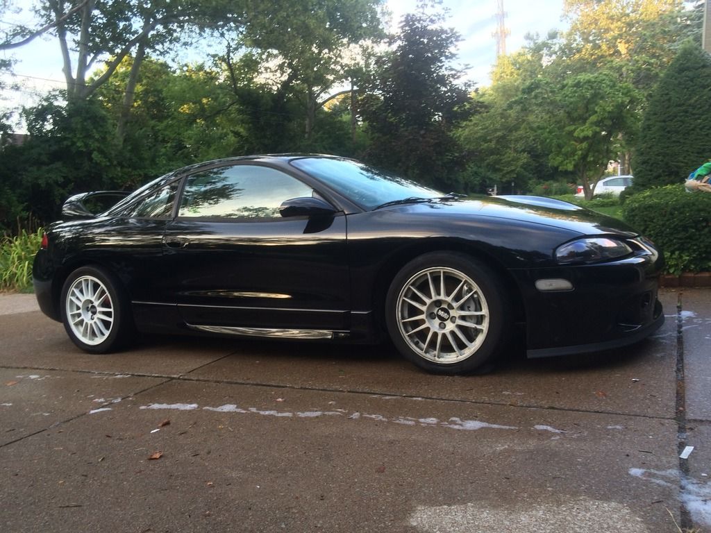

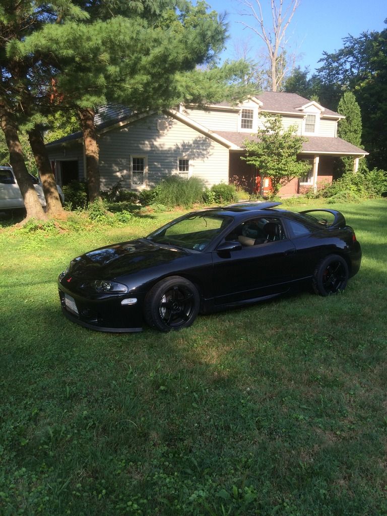

Here's a picture proving she moved :)

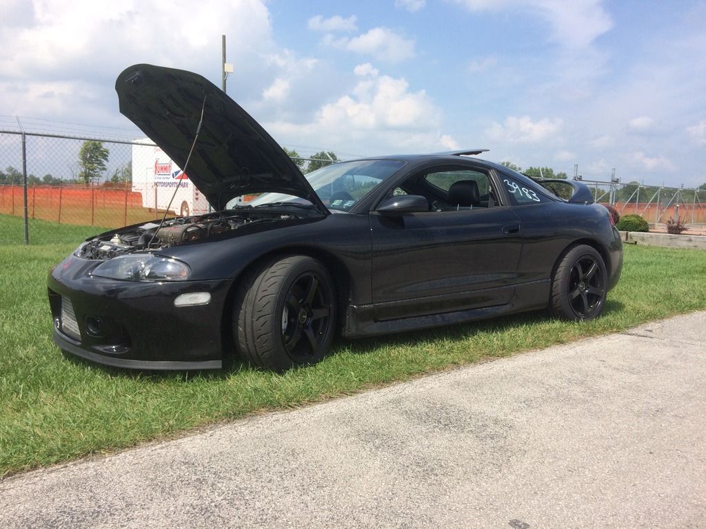

When we got there and it was a relief. I put a lot of hard work into her this past year and she almost didn't make it, but she did. Felt great rolling in with the two of them.
Finally parked Betty and a lot of people came up and started asking questions about her. Checked out some awesome rides there and then it started to fade out soon after that. We hung out for a bit so we weren't standing in line at the gate and just enjoyed and thought about what we did and what the past year has put us through.
Finally got to the track and we parked the cars for the night and just watched the cars run till 10. We road back in Justin's talon to Aaron's house because Justin got called back into work for the next morning.
In the morning, Aaron and I grabbed his truck and picked up a trailer and headed out. Got to the track around 9 and Autox started at 10. We prepped the cars and headed over. On my first run, the oil filter housing rattled loose because the motor has the BSE kit apparently. I spilled 4 quarts of oil on the course but lucky I shut it off in time to save the motor. That wasn't the case for the turbo tho. This ruined Autox for me so I focused on Aaron finishing and competing well. He did very well for what he had and finished 2nd in the event.
After the event we towed and jacked up Betty to get a good look at the damage. Lucky it was a simple fix and we filled the car back up with oil and decided to pack it up for the day because a storm was coming in. After the storm we loaded Aaron's car on the trailer and decided I'll drive Betty back to see if there were gonna be problems for my trip home the next day. We stopped about half way so I could get gas and the car started surging really bad. Fuel trims were off and decided to boost leak test the car before the drive home. Turns out the BSE kit rattled the ICS bolts loose. One was gone and one was about to fall out so that explained the idle problem. The next day we went back to the track and just enjoyed walking around. We ended up leaving around 5 because I had to work in the morning and we still planned on having dinner before I left for home. Left Aaron's house around 7 and noticed about a half hour into the trip, during a construction zone, that light smoke was coming from under the hood. Figured it was still some oil burning off and I would stop at the next rest stop only a few miles up the road to check everything out. Turns out I was leaking a tiny bit of oil again but couldn't tell from where. My guess was around the turbo drain. Oil levels where still good so I kept going. About 30 minutes from home it just started down pouring. Couldn't see anything as my wiper blades decided they wanted to fall apart at this point. I pulled over two more times just because it was so bad. Normal 2 hour drive took me close to 3 but she made it back in mostly one piece. All in all I was happy with the weekend. Betty made it to the shootout and back and Aaron placed. Couldn't have asked for much more for the situations we faced.

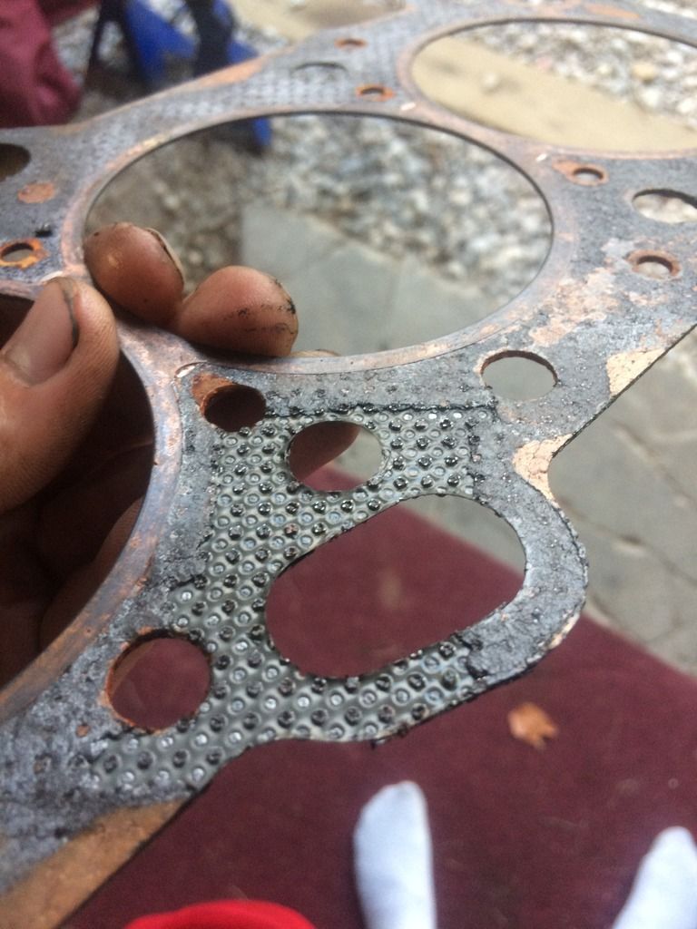

Well I got home from work and had some time so I started tearing down my stroker motor down. Took the cams and headstuds out for the current motor andhead studs. Pulled the head and found this. Not sure if it's a faulty head gasket or if this is from then copper spray I used for the motor.
What are your plans for the stroker motor? Just a quick rebuild and have a spare motor.
What I would love to do with it is take it to a shop and have them OK the quality of the build. This was my first motor I built but someone that knows what they are doing, checking things over, would be one less thing to worry about. Was thinking about sending it to boosten or take a drive up to STM to drop it off. I talked to boosten at the shootout after the oil filter came loose and got a quote and didn't think it was bad at all. After that, I'd drop it in and sell the stock 2.0.
STM is great but i think they have Buschur build their motors right? Might as well just start there.
If I have to buy a motor any time soon. I'm going for a Boostin STG3 2.0 long rod. He has proven that him and his company know how to build motors that handle power. You sticking with a 2.3 for autox?
