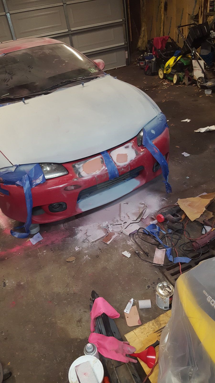

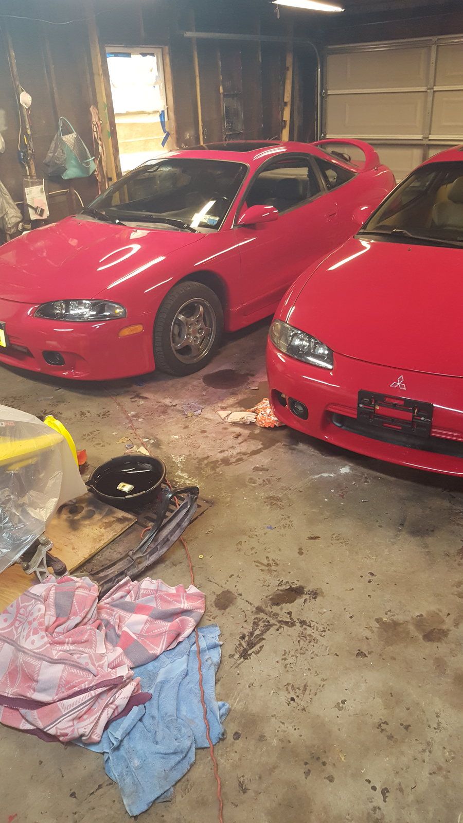

Bought it November first for 800 dollars, missing a few interior parts I ordered, needs to be painted badly bought the paint will be painting it myself in my friends booth in two weeks, couldn't believe how much power these cars got

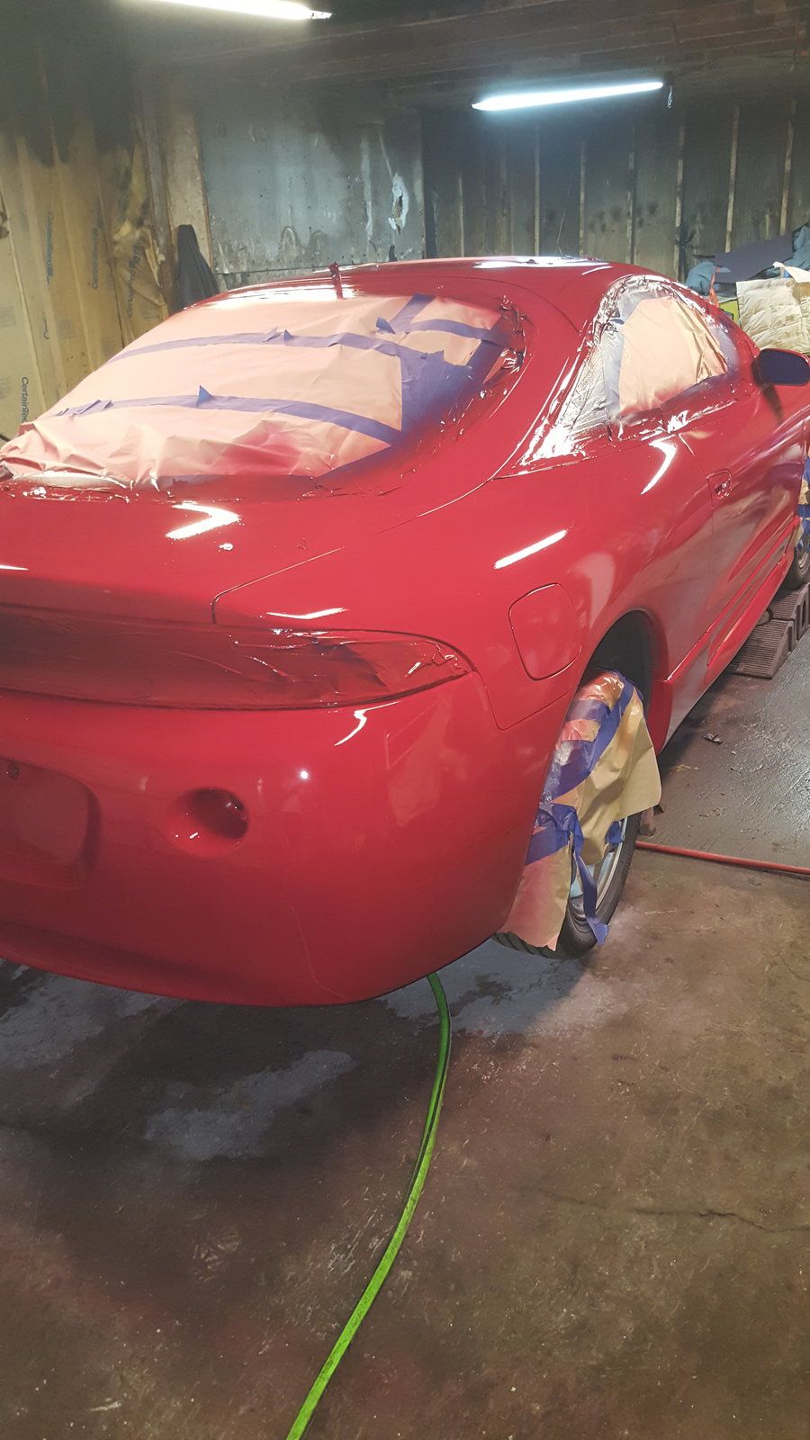

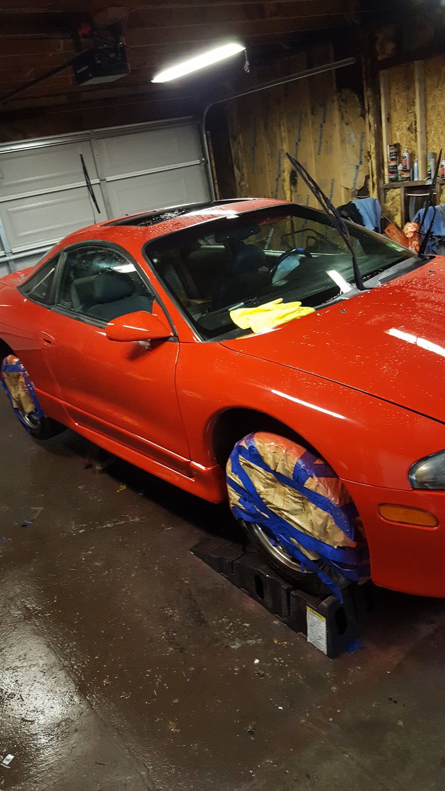

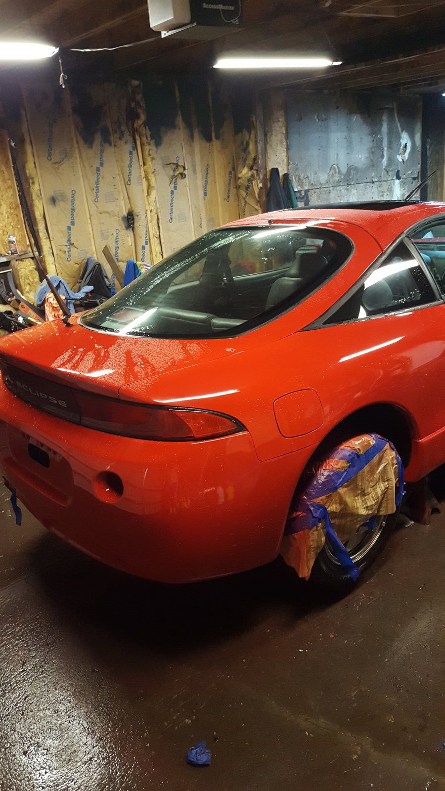

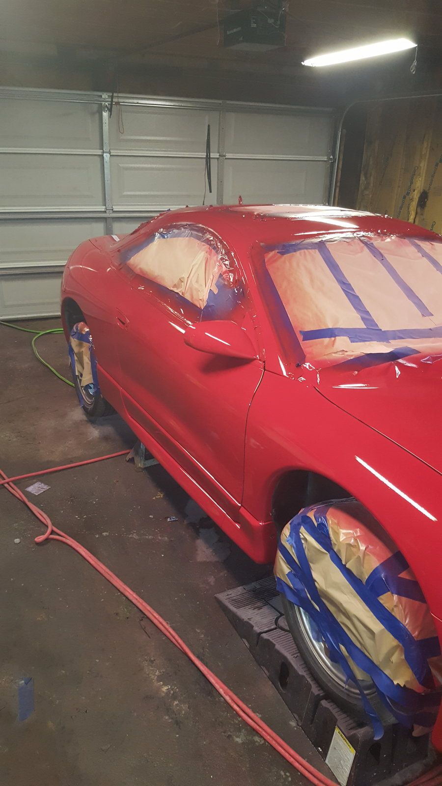

Painted it tonight waiting for the air to clear to get pics up, gotta wet sand and buff it tomorrow, the car is a surprise for my husband

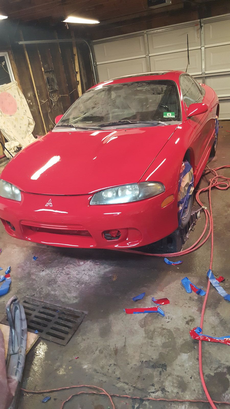

Here' the pics I will post more after I cut and buff it, will also be sanding and buffing the lights, on my other two cars they were worse than this! And they buff to brand new shape!
Don' know who to reply to, so to everyone thank you very much for the compliments, and Vegas smith sure I'd help you out, just bring the car to ny, I'm getting ready to sand and buff it then it will have a deeper shine, I used a fresh air helmet and the hose fell off so I threw the gun down and ran outside, I pulled the hose out reattached but had a drip fall on the fender, not very noticeble but most of it should send out, surprisingly no runs or desert storm dry spots
This turned out great! I think your husband is going to love it.
Just curious, what was the total cost for supplies? I tried using some duplicolor perfect match rattle cans to fix up some minor scratches and I'm not at all happy with the results. Would love to just buy a spray gun and do it the right way.

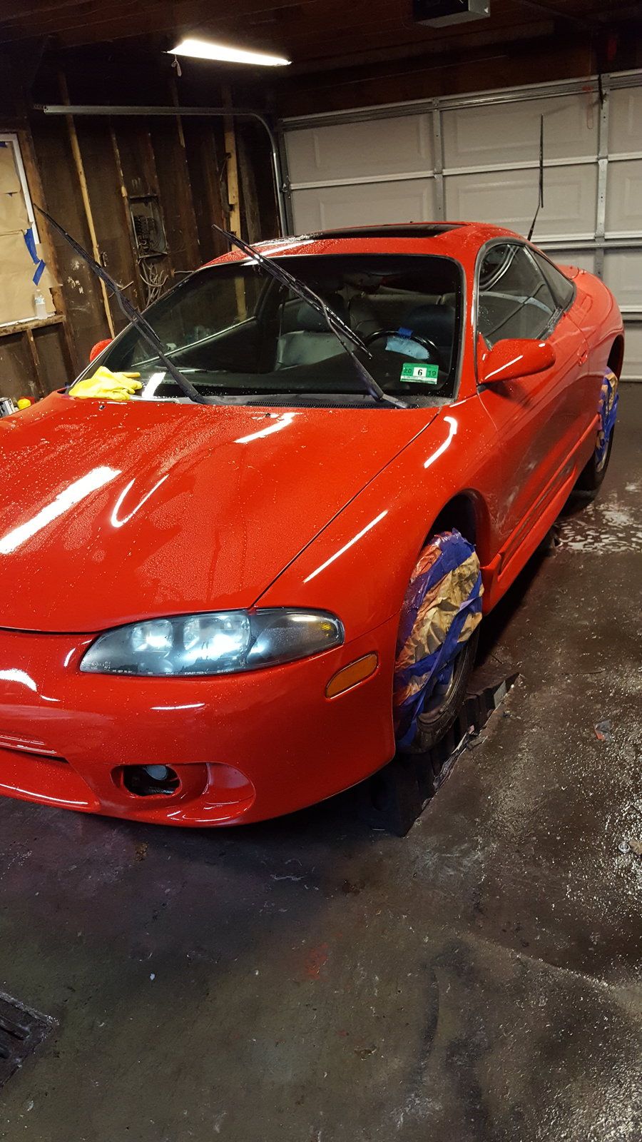

Total cost was about 400 I used shopline clear and omni base coat, the car looks even better! I just got in from sanding and buffing, it looks just like me gs in my signature now, gotta take care of a few things in the house and will be back out to get update pics before 12 midnight, thank you all so very much for the compliments, nice cars everyone!

The paint looks great, btw. I have a question though. Are the bumper mustache and air duct insert taped off? Or did you paint them red?
I painted them red, they were badly faded, I did remove the frames frome the fog lights and tape them off, I'm going to paint them flat black and put back on, but I think I like it stash less LOL if I decide I will mask off and paint the mustache and cover flat black
I use an led flashlight to put my clear down, no runs and no dessert Strom dry spots, you shine the light as your painting to see it look nice and shiny then continue to clear the rest of the panel and car this way, it is how I was shown to do it and it works best!

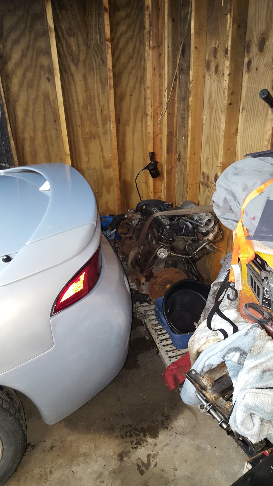

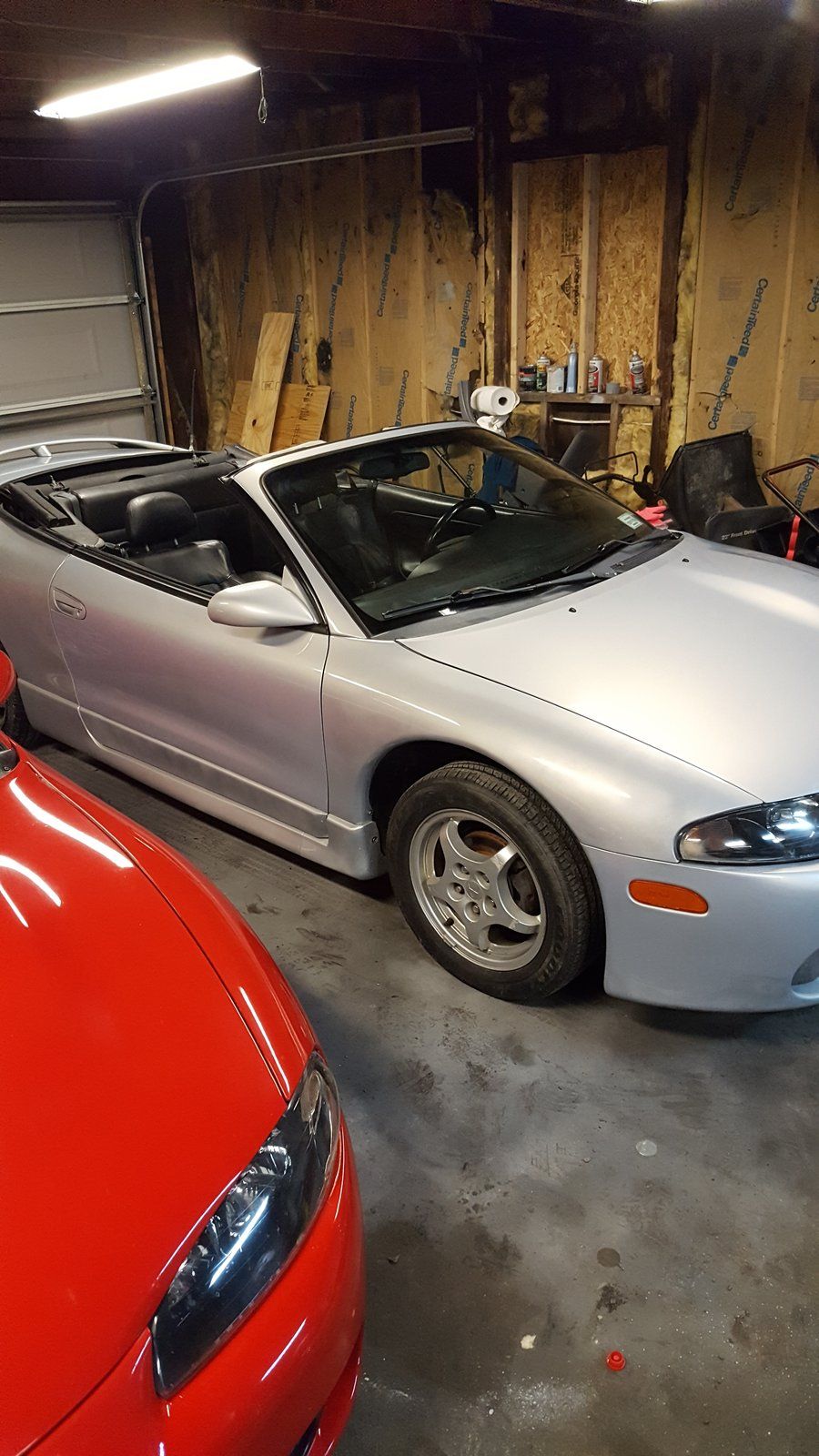

Everyone I'm getting ready to paint Ole miss miss match, should I change the shade of the silver? Don' wanna pull engine/trans ect or I'd go red like the other two I painted, lmk your opinions thanks
myself I would stick with silver if you could get the same silver it is the same color code as my old 99 GST was loved that smokey silver color since it was so different compared to most of the DSMs and it being the same red as the others it may get old seeing the same color on all of them.

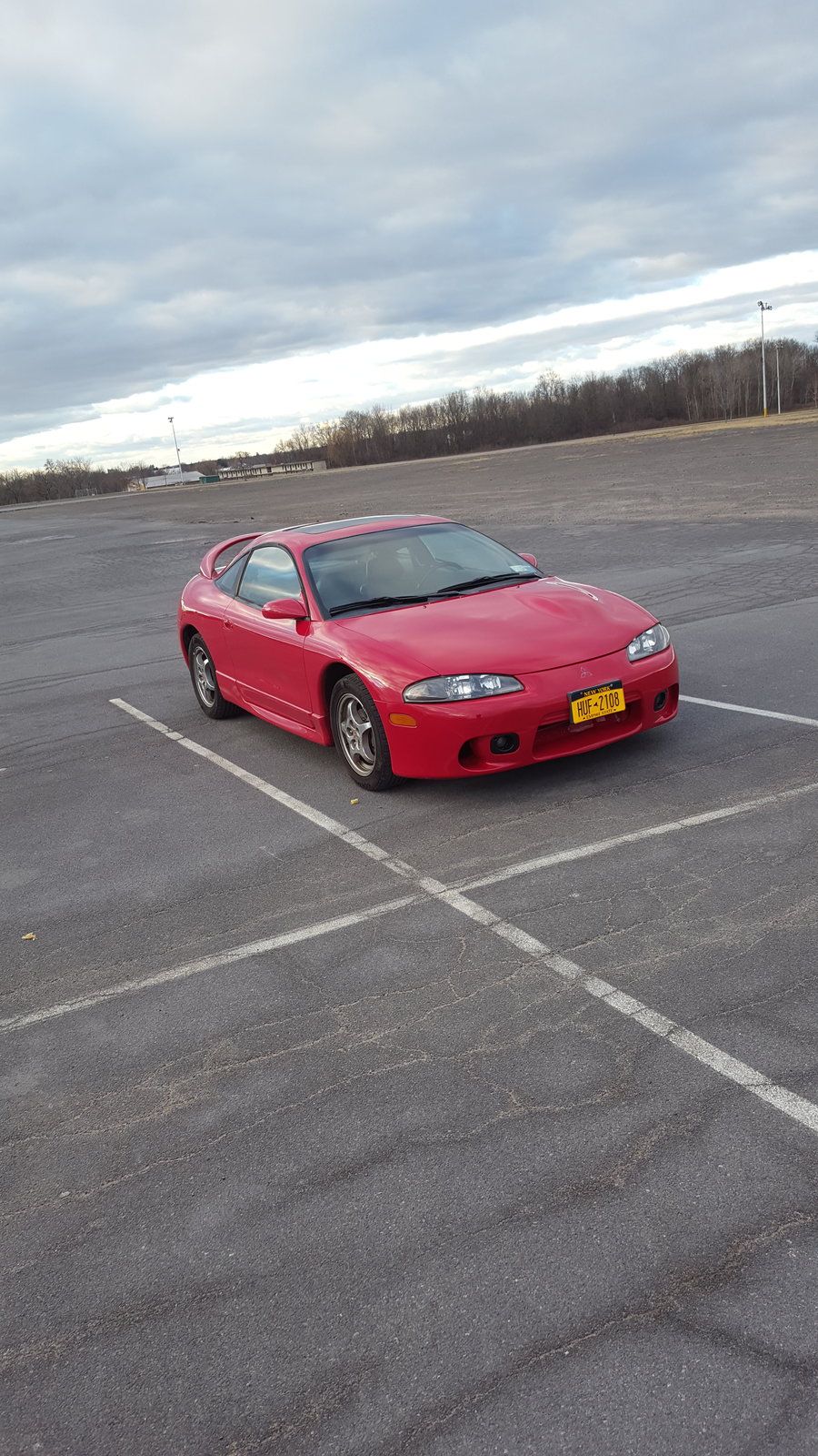

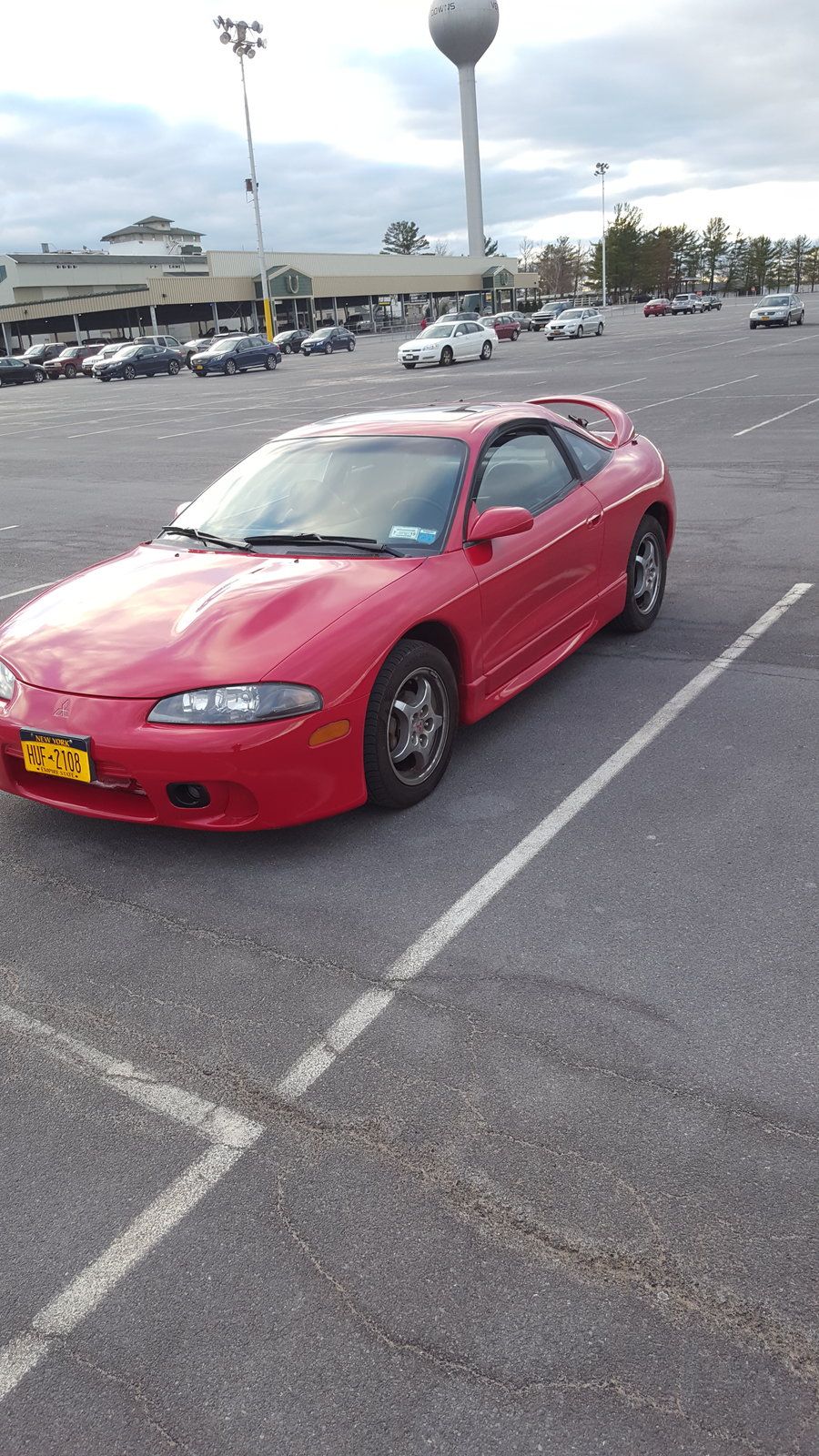

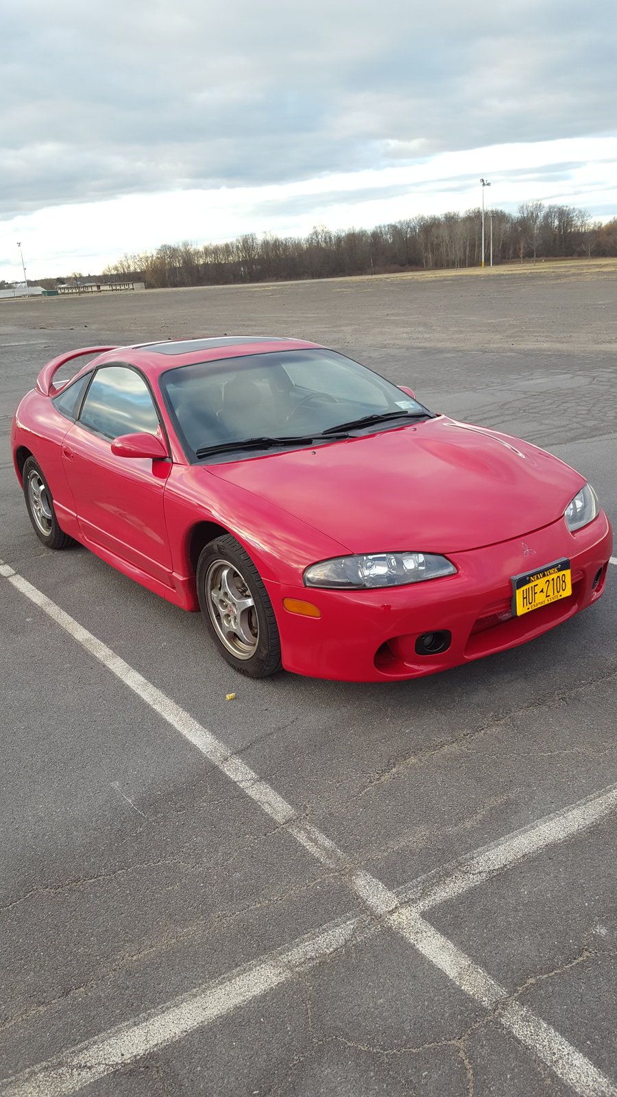

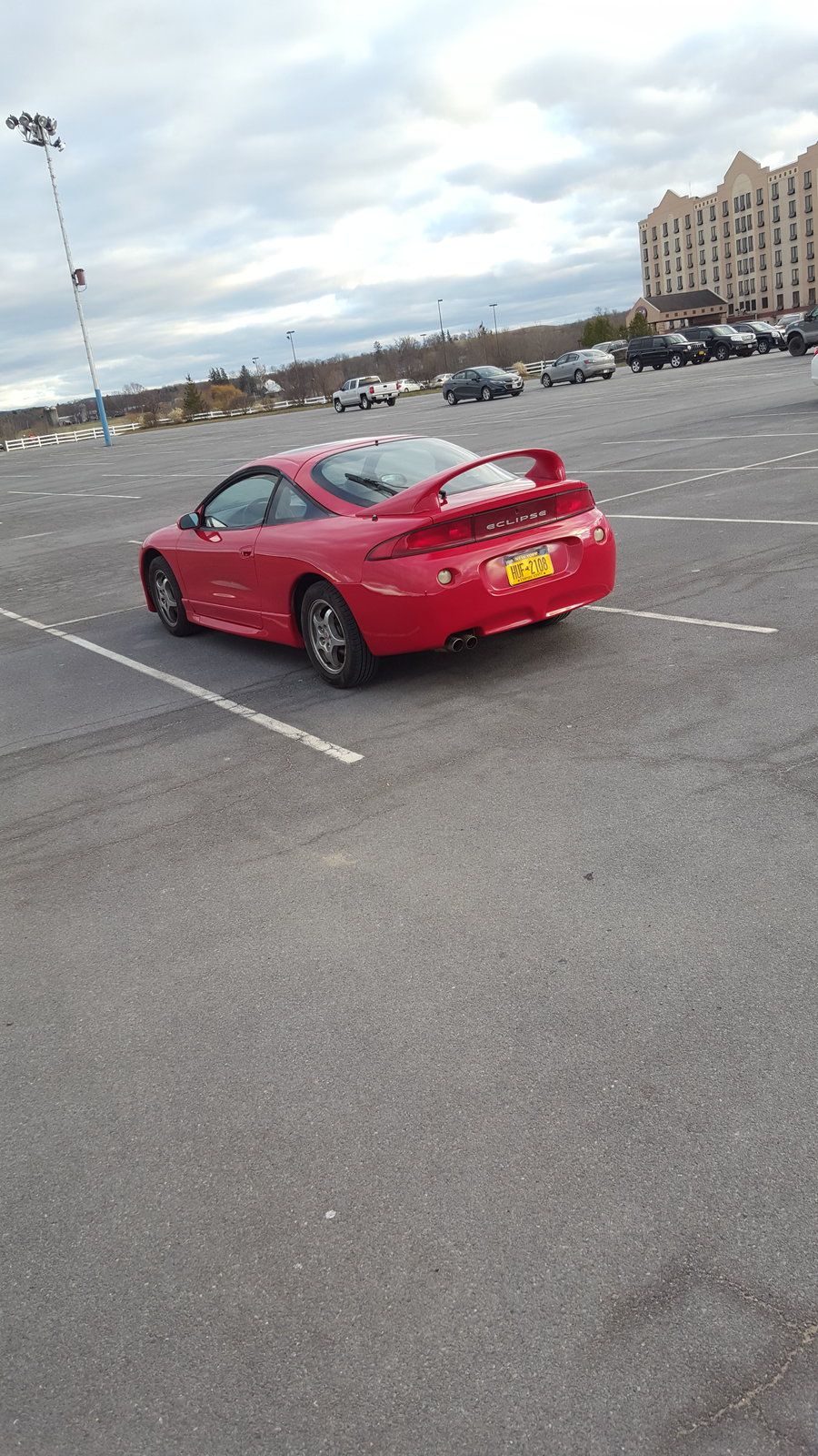

So I put it on the road yesterday drove it today, taking off road tomorrow because it' winter up here, drives like new! It' all together and missing nothing, now to get the car over to my parents house to have it wrapped up for my husband to open like a gift in their garage, last photo shows my nt next to it, wish him well as he is back in the hospital again:(hoping he can get his health in shape soon, gotta run back to stay with him, just thought I'd show you guys how it turned out, also this car is wayyy faster than I thought! Once the turo spools up its like a very fast v8
