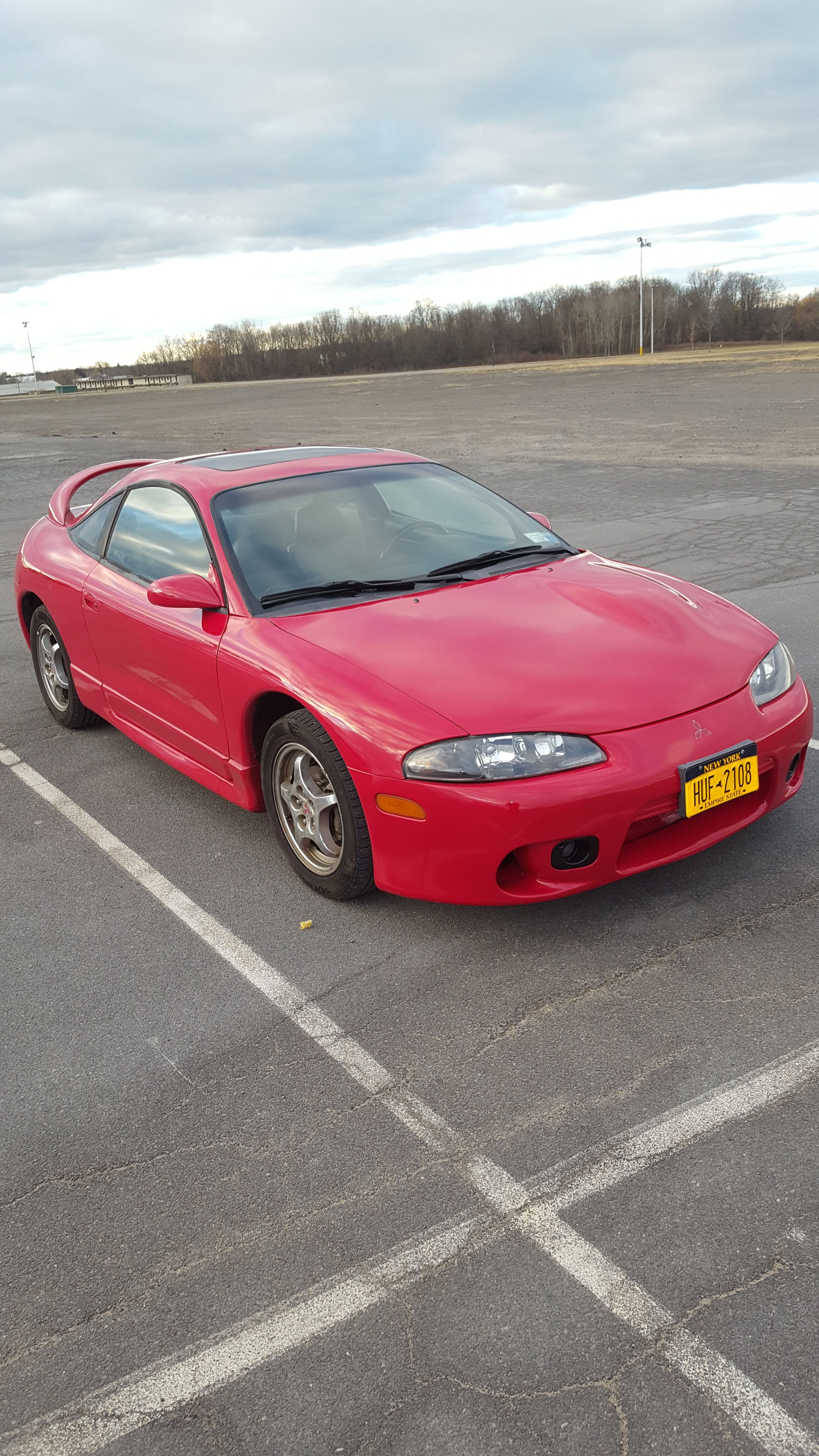

Bought it November first for 800 dollars, missing a few interior parts I ordered, needs to be painted badly bought the paint will be painting it myself in my friends booth in two weeks, couldn't believe how much power these cars got

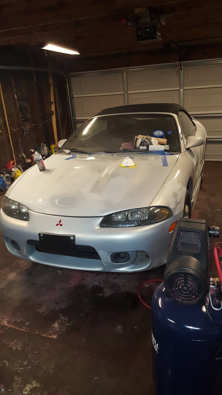

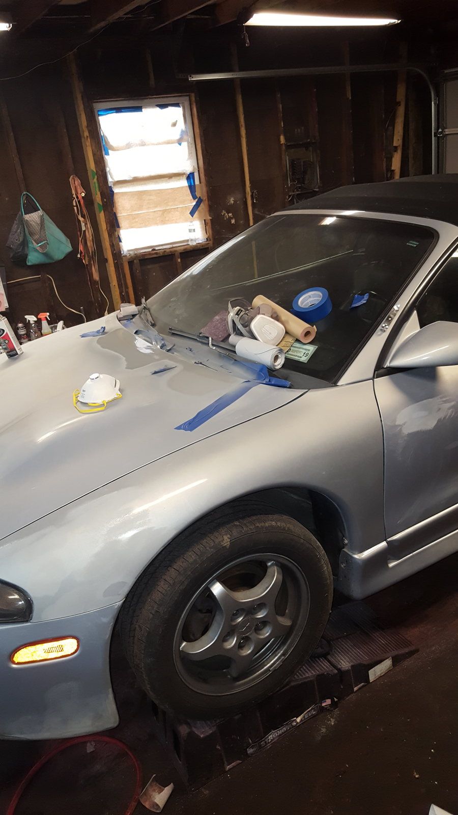

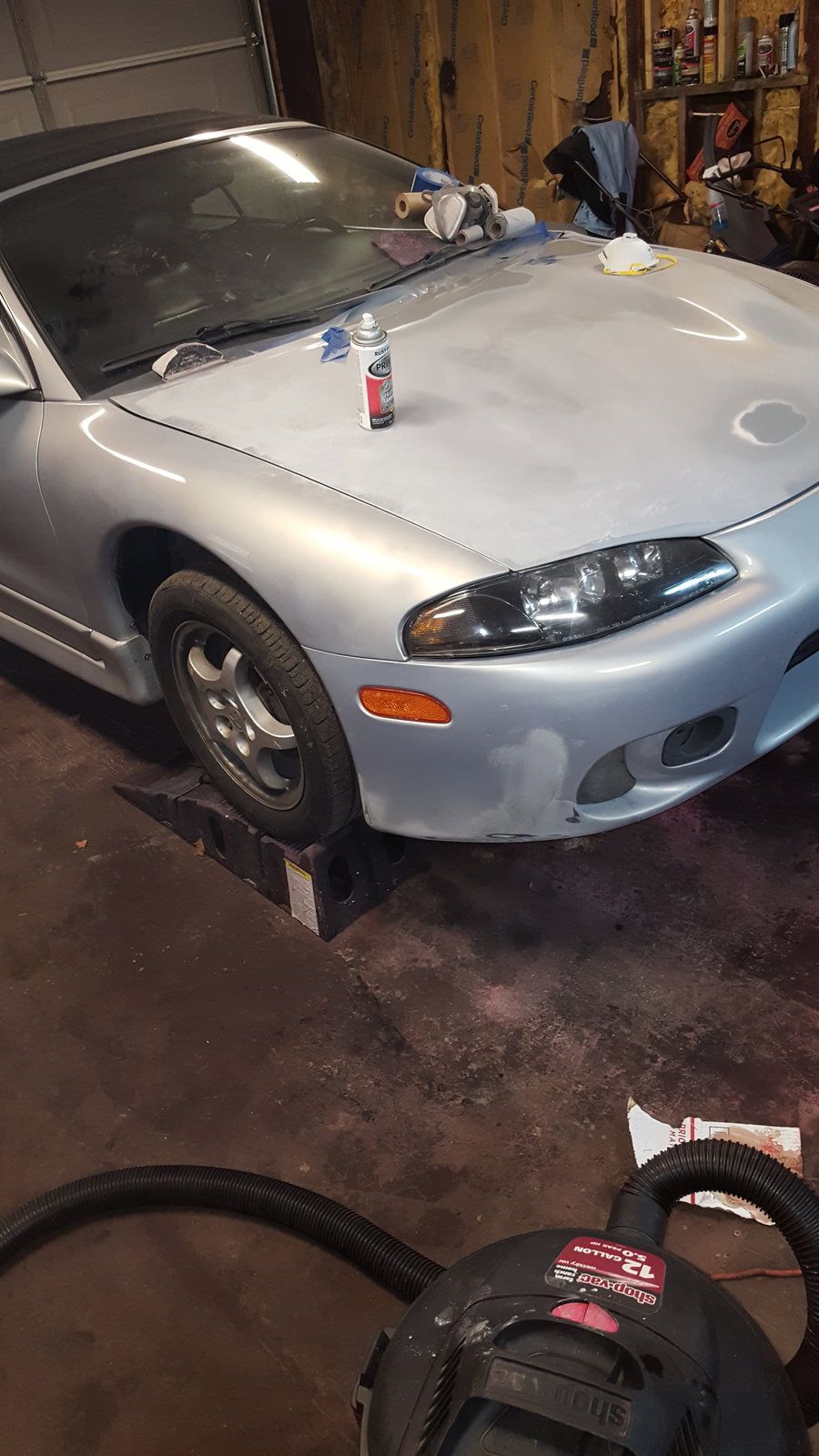

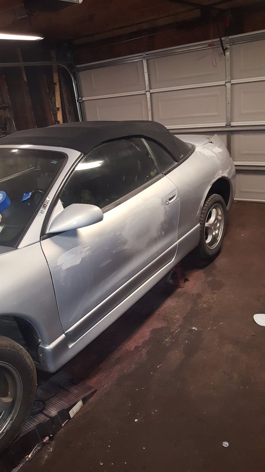

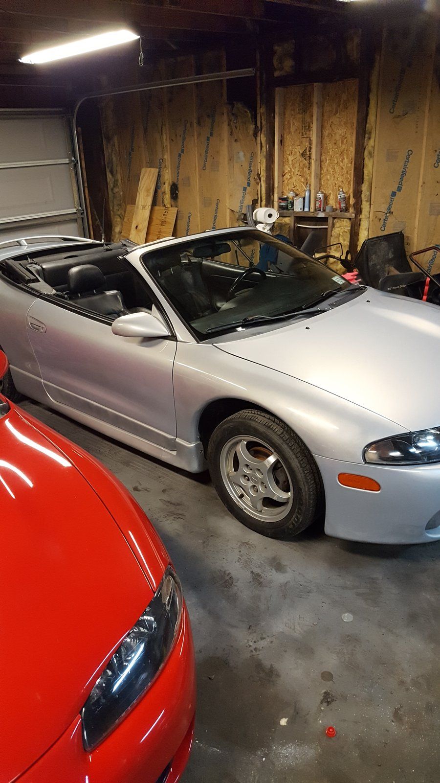

I have the gst down to my parents, started on my spyder Thursday here' my progress so far, paint for this is more than the red car! Any paint code suggestions as far as similar color for less? Also I'm bad with metallics and always get light spots and tons of mottling, should I just paint it a straight grey without metallics? If I do I don' plan on jamming it so what do you guys suggest

for the silver I found the paint code as Color Code: A52Minden Silver Pearl hope that helps.
and I normally cut with with a small ammount of reducer for the color coat and then go with a 25% reducer for the flash coat and I have my gun set at 60 PSI for flash that seems to help make the metallic to flow out more even.

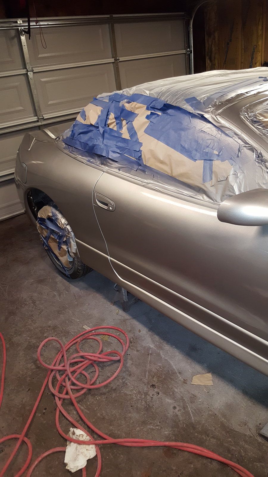

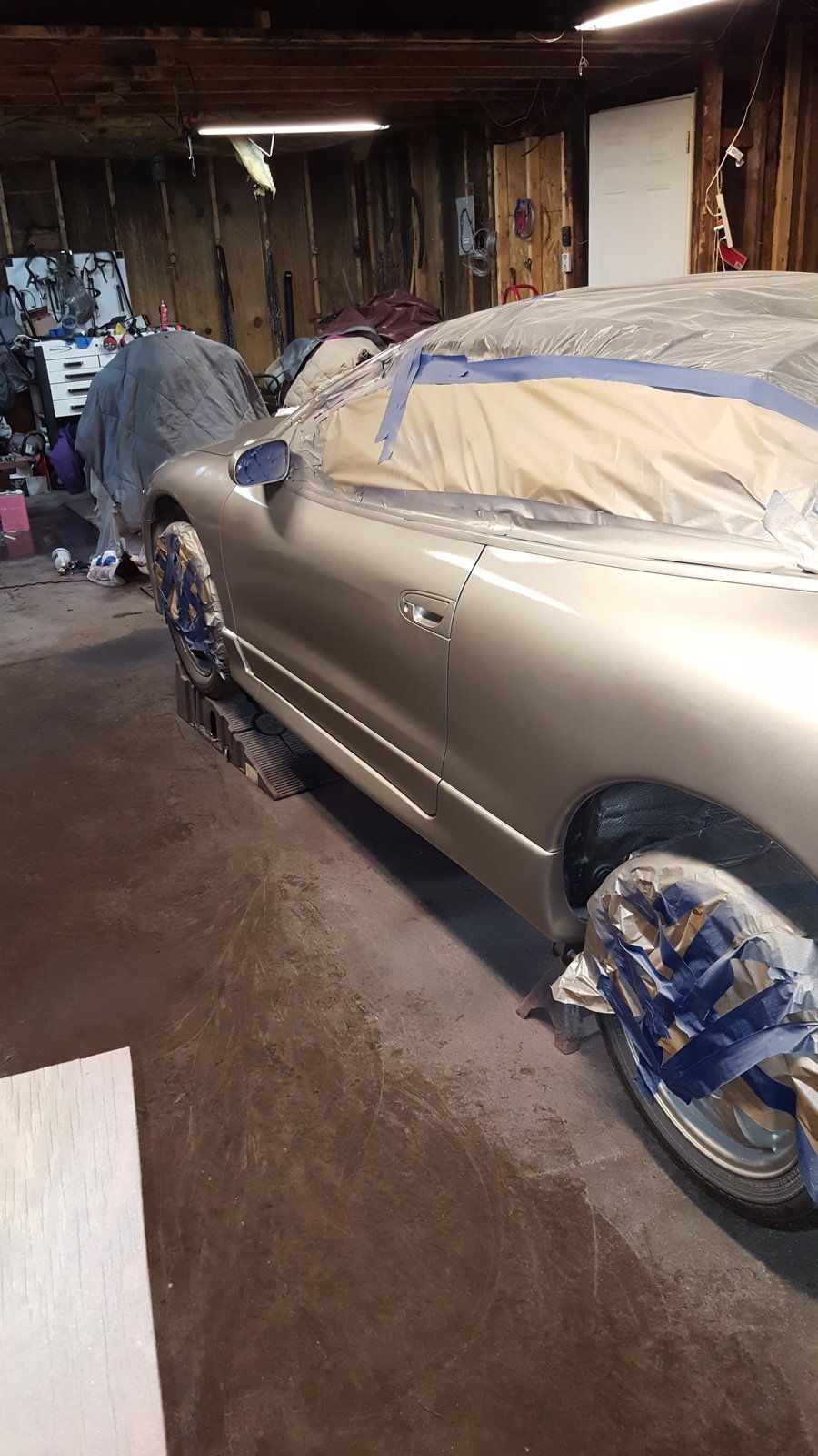

Hey everyone, I'm going to be painting my spyder in an hour, been busy with work and the kiddos so I bought code ws2ps2 it' a bright silver, I dislike the pearl look, I'm going to try the high pressure base coating, and as for my husband he has seen a pulmonary Dr many times, the doctors are saying this is a restrictive lung disease, no medicine can help its something to do with the muscles for breathing, but thank you very much for your advice will have some pics late tonight

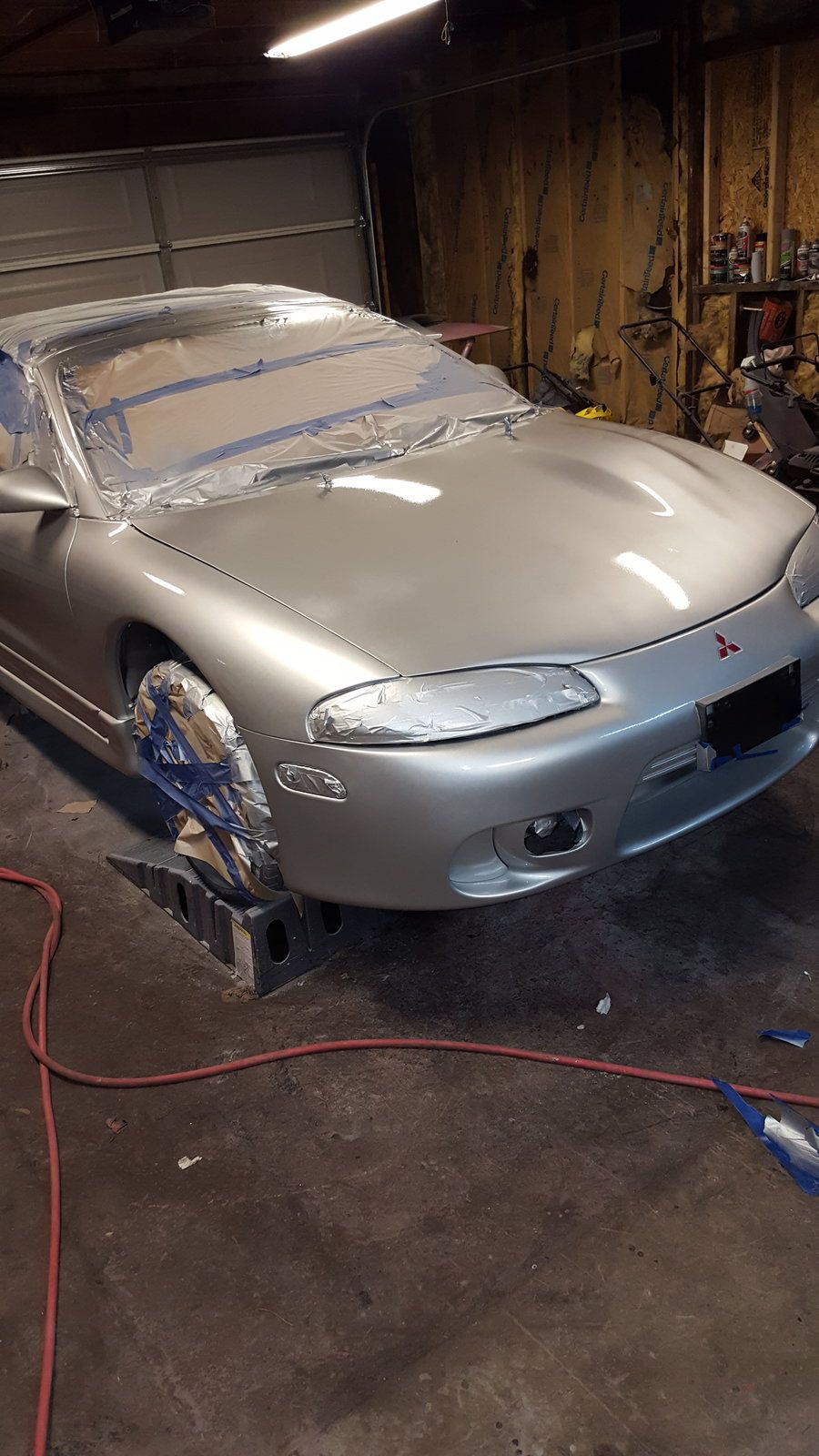

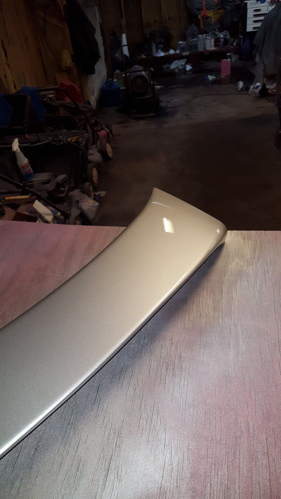

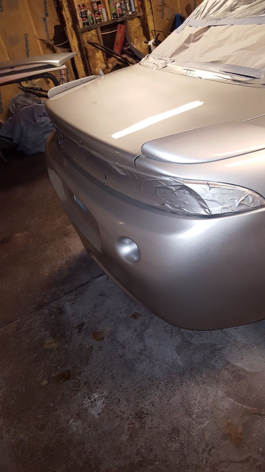

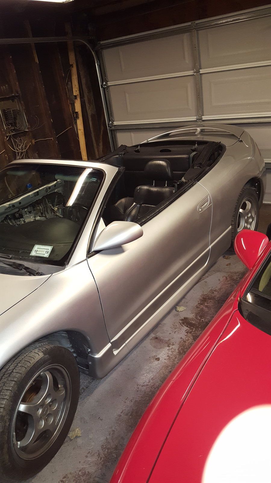

I' very sorry to here that, I use a fresh herbs air respirator helmet, here' the results, not sanded and buffed yet, my husbands is from nerves in his spine causing diaphragm weakness, I think he'd be better off with lung disease, at least then the medicine would give him relief efforts, those inhalers like Spiriva and stuff do nothing for him, I hope this week the doctor appointments pay off, I hope you feel better, if you want tomorrow I'll get a pick of my setup, its' a pump you put outside and a air hose hooks to it that hooks to a face helmet, you can' smell anything and I've actually set off bug bombs in there with it on and didn' smell a thing, this was a few summers ago when I painted my truck
looks great so far and looks like the metallic laid down great without the separation. yeah I bought a full freash air resperator that will take some getting used too since I was old school when I painted cars an that brother said when I painted he wouldn't walk in because all he seen was a shadow moving around blubs of lights and he couldn't see them very well either just a bank of glowing spots..LOL

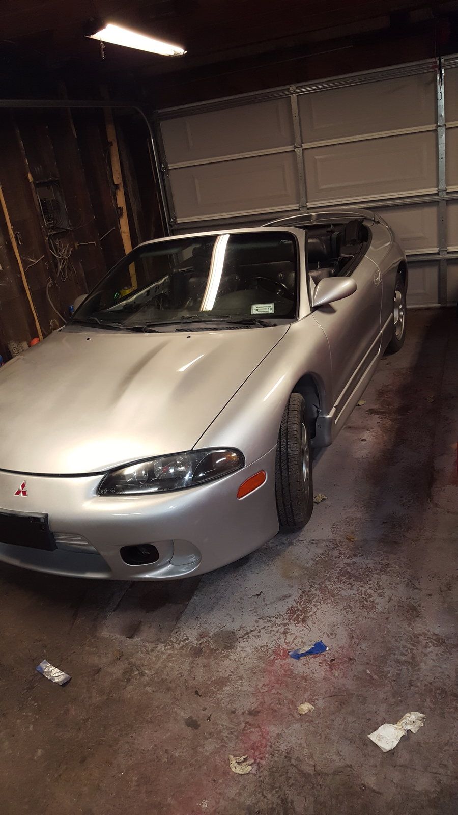

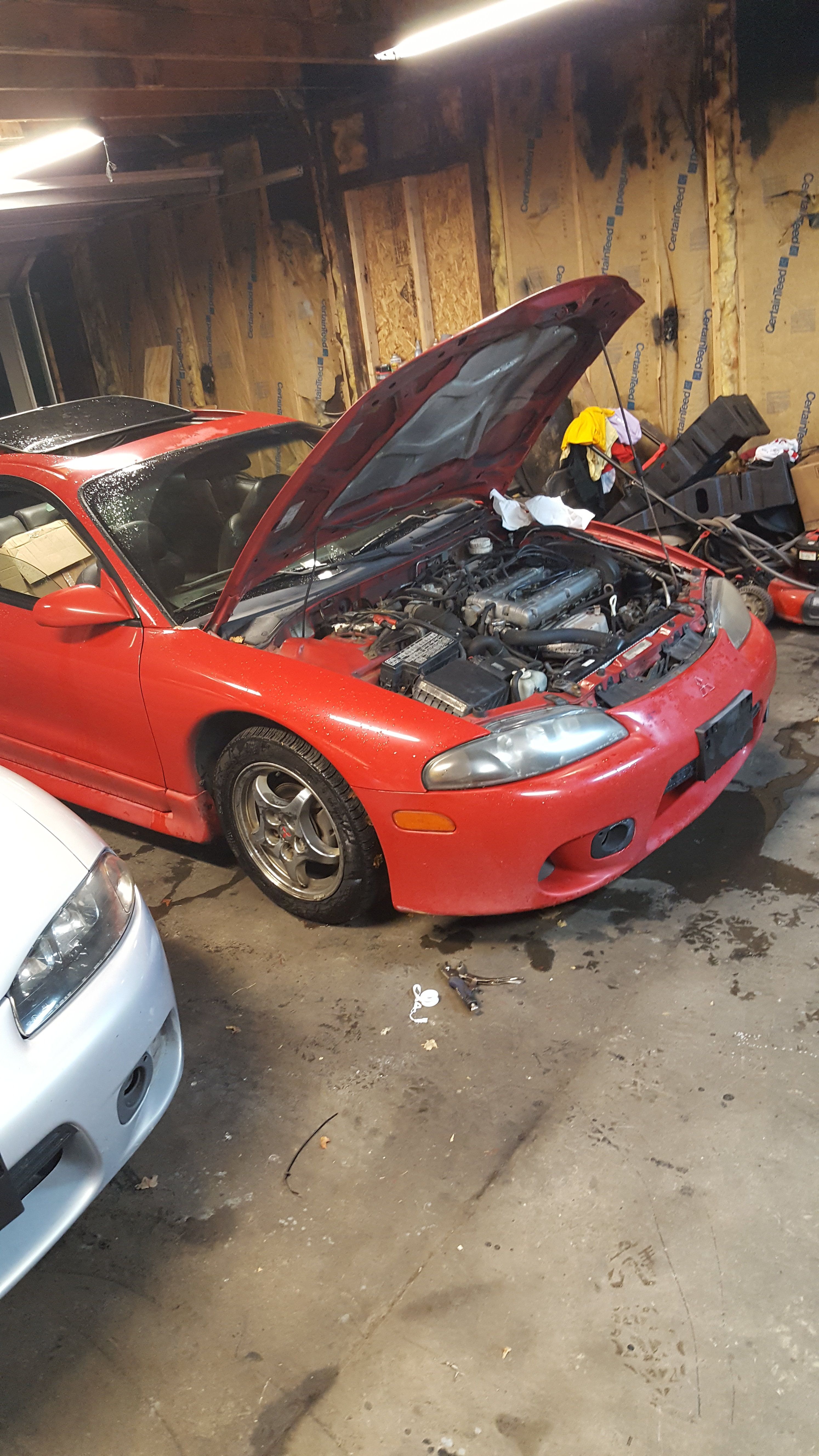

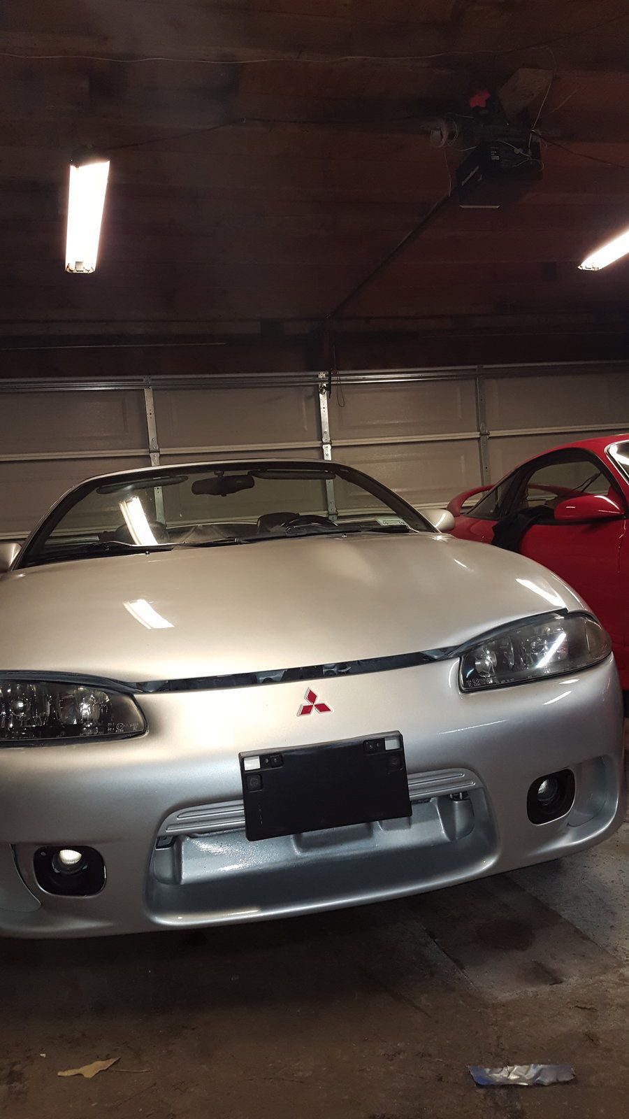

Here' an update on the car, now I gotta learn how to do the timing belt before spring on the 4g64 and 4g63, the gst is at the families wrapped up in the garage, so from there it will be back here and I want to get them changed before spring, a user here showed me the tool I'll need for the timing belt removel, done this probably 12 or more times on the 420a cars I've owned and 4 times on my current one, is it harder than that? Anyways here' how the spyder came out, I didn' like the ugly brownish purplish hues it had in it at all, so I went with a chrysler silver, I love the shade! Last photo is before
they really are not that much harder to change one thing you will find out is they use a automatic tensioner that will need to be compressed back into cylinder that is the hardest part of the job since you can't really force it or you will bend the shaft sometimes its just easier buying a new one since it come with the pin in it holding the rod in that is easier normally except getting that pin out of the rod since it does love to fight you coming out.
The 420a is like that, and I bent mine! But it still works so I used it anyways since it was less than a year old works great still, but I agree better of getting a new one
